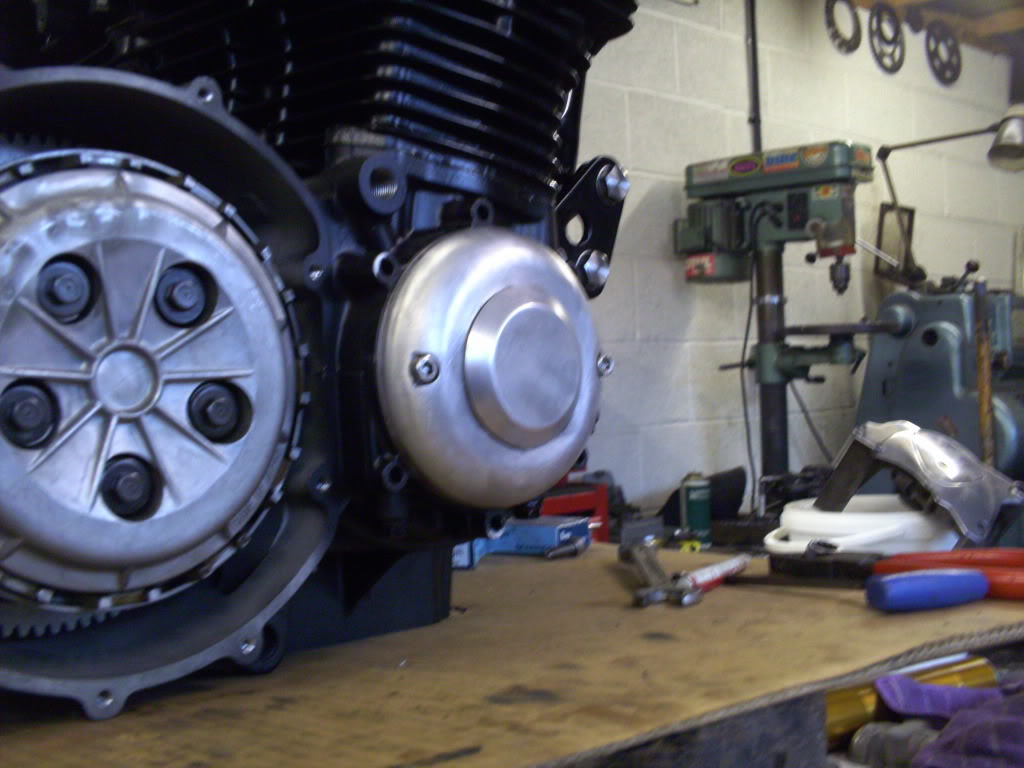

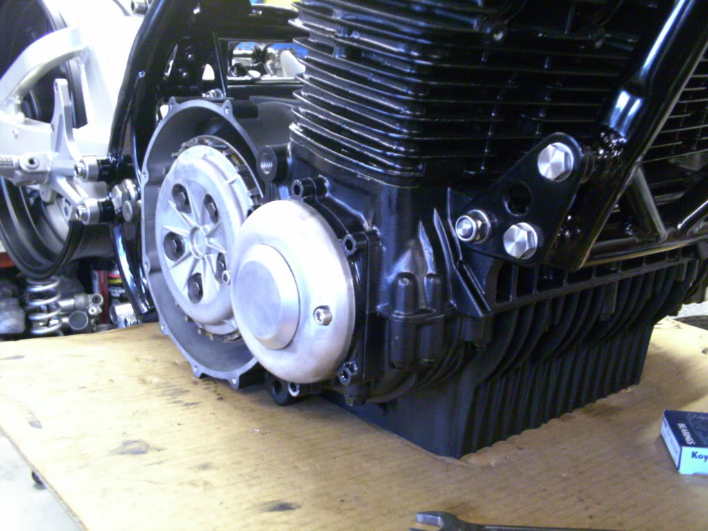

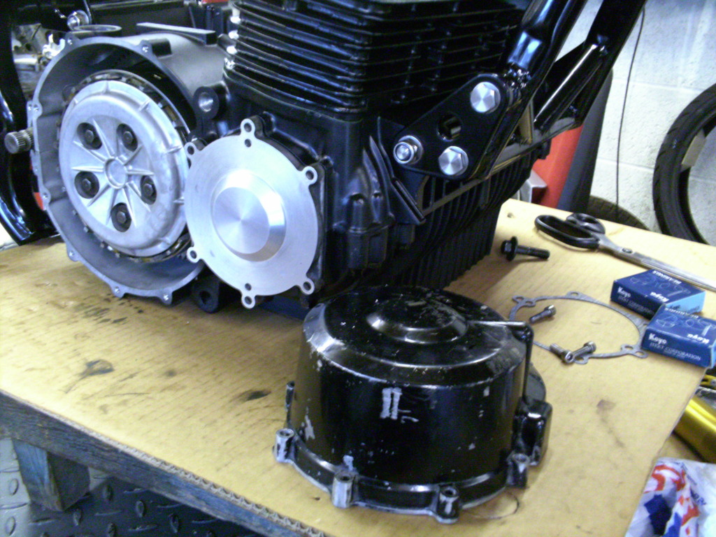

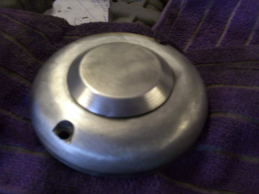

#125 PostAuthor: zed1015 » Mon Nov 19, 2012 10:13 pm
After making the rounded ignition stone guard i've decided that the blanking plate for the original points location looked a bit pants and needed something else
So i removed the turned center which was just a press fit and welded it in to a later points cover which had enough meat on to allow a matching profile to be shaped on it
Think that a big improvement and it actually matches the stone guard now.

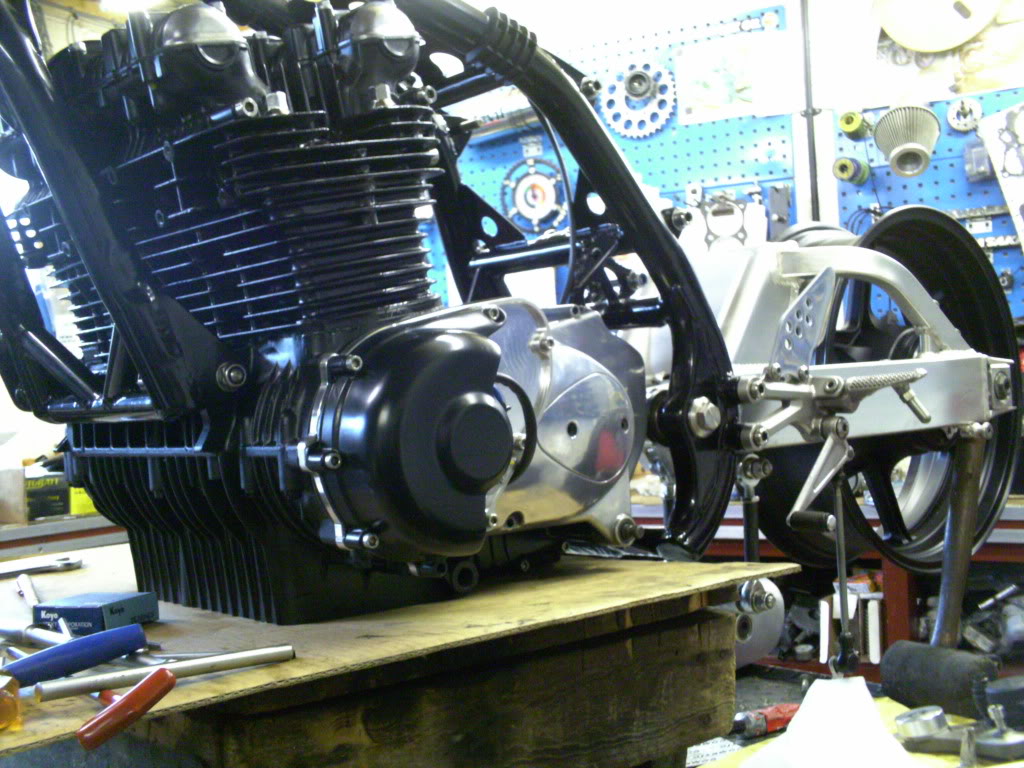

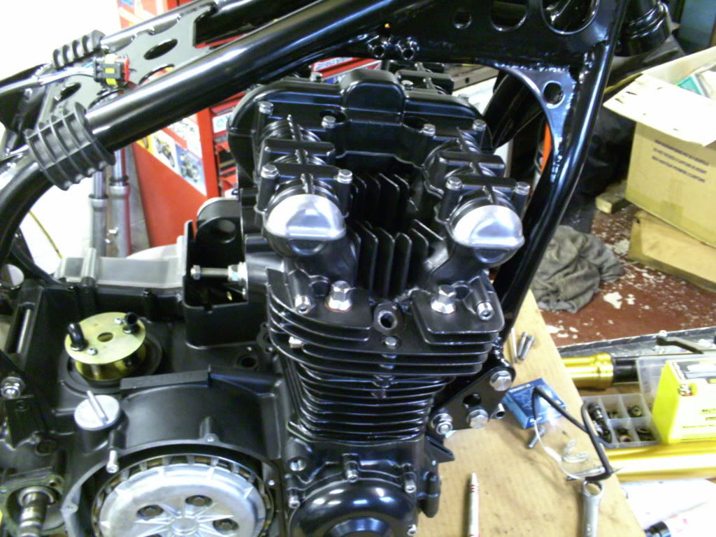

#126 PostAuthor: zed1015 » Thu Nov 22, 2012 2:22 pm
Top end done and re-designed blanking plate painted.
Stone guard painted and on.
Decided to leave it plain for now

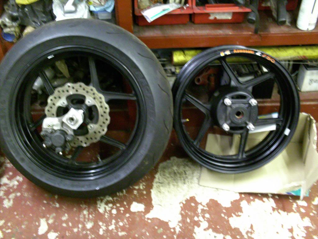

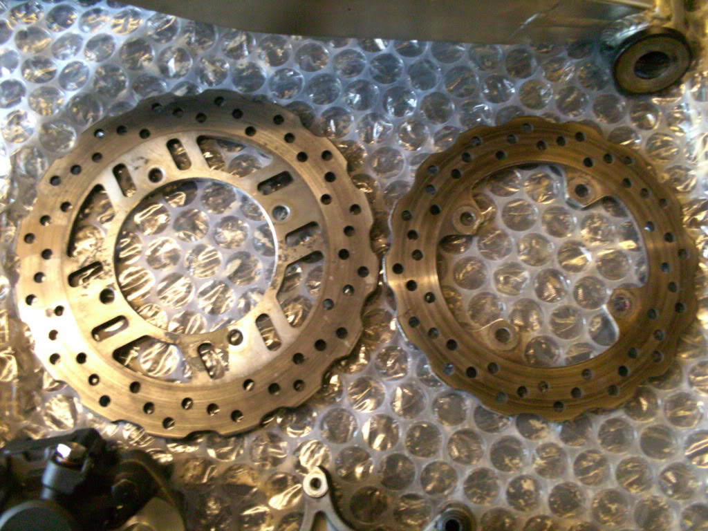

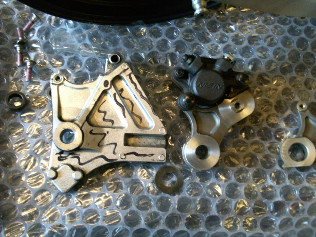

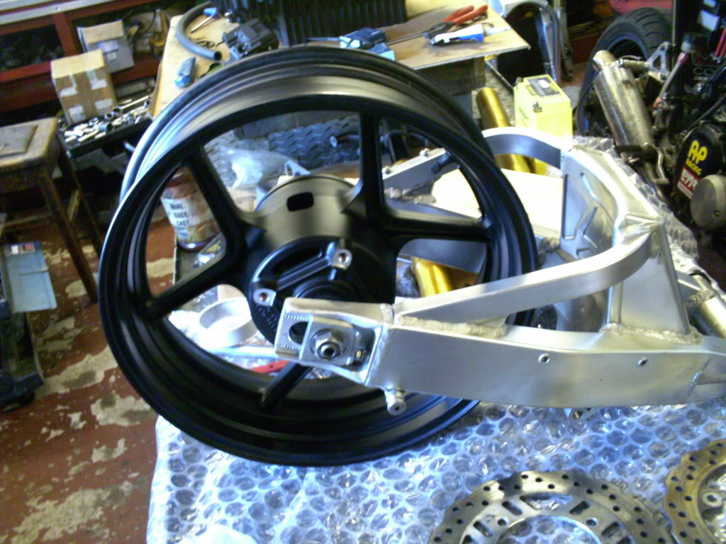

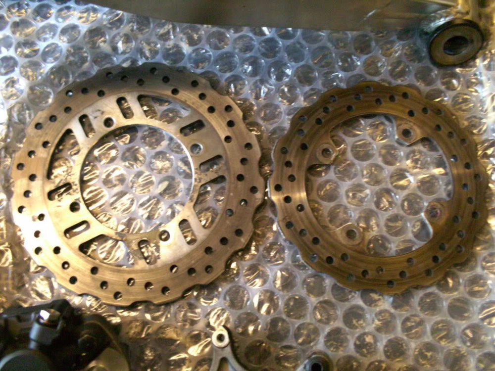

#130 PostAuthor: zed1015 » Sat Dec 01, 2012 12:20 pm
Finally sourced a matching 5.5 inch rim from a Z750 to replace the ZX10R's 6 inch which i used for the dry build and is too wide to get correct chain alignment whilst keeping the wheel central.
It took three attempts to find one that was straight ( bloody time wasting ebay con artists ) which left me an extra £30 out of pocket as i couldn't get my return postage refunded for the wonky two i sent back :evil:
It came bare and i'd hoped the zx10's disc etc would fit.
No chance! :roll: so back to ebay to buy a disc which on arrival i find it is 30mm larger in diameter and my modified R1 caliper and hanger are useless :(
Back to ebay for a z750 caliper bracket and a small stroke of luck as kawasaki have kindly changed the brake caliper mount design to take the same nissin as the R1 so all is not lost :)
It's a fair old lump so all the shaded areas need removing before i use it.
Just as things are looking up there's another kick in the balls as the 750 wheels hub is nowhere near the same as the 10s and is suprisingly wider and offset to the right so i'll have to start from scratch and make all new wheel spacers etc.
This is the point i shut the shed door and went to the pub before i chucked the whole lot in the nearest ditch :lol:
