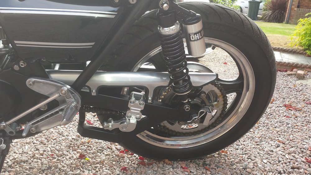

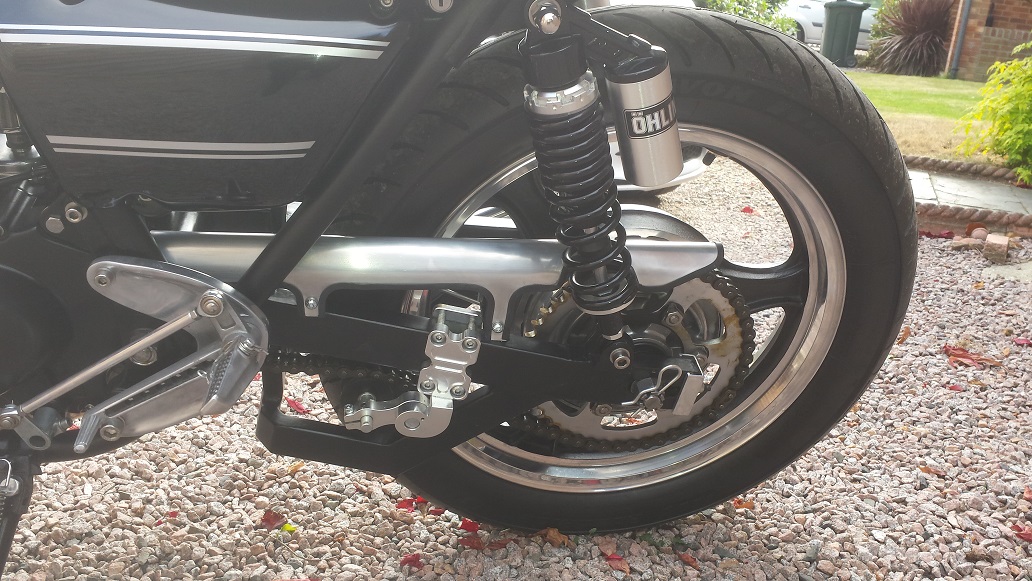

It's fighting me all the way...
Chain fitted, no problem. Rear wheel aligned and tightened up and...
... the chain is hitting the swinging arm brace! Okay, so it's only just kissing it, but it's enough that I'll need to take the grinder to the lovely shiny swinger...

Can you not put a chain tensioner on it to lift the chain away from the swingarm?

warren3200gt wrote:Can you not put a chain tensioner on it to lift the chain away from the swingarm?
I did consider a tensioner of some kind, but that'd require more surgery to the swinging arm than a mere bit of grinder-induced 'clearancing' - I'd want it to be a bit more subtle than a bolt-on tensioning device ;-)

There is one that is spring loaded and mounts off the swingarm spindle tube. You can hardly see it when fitted. But........... I can't remember where I saw it or who makes it!

warren3200gt wrote:There is one that is spring loaded and mounts off the swingarm spindle tube. You can hardly see it when fitted. But........... I can't remember where I saw it or who makes it!
There ya go........... http://www.monstercraftsman.com/categories/Tensioners/
