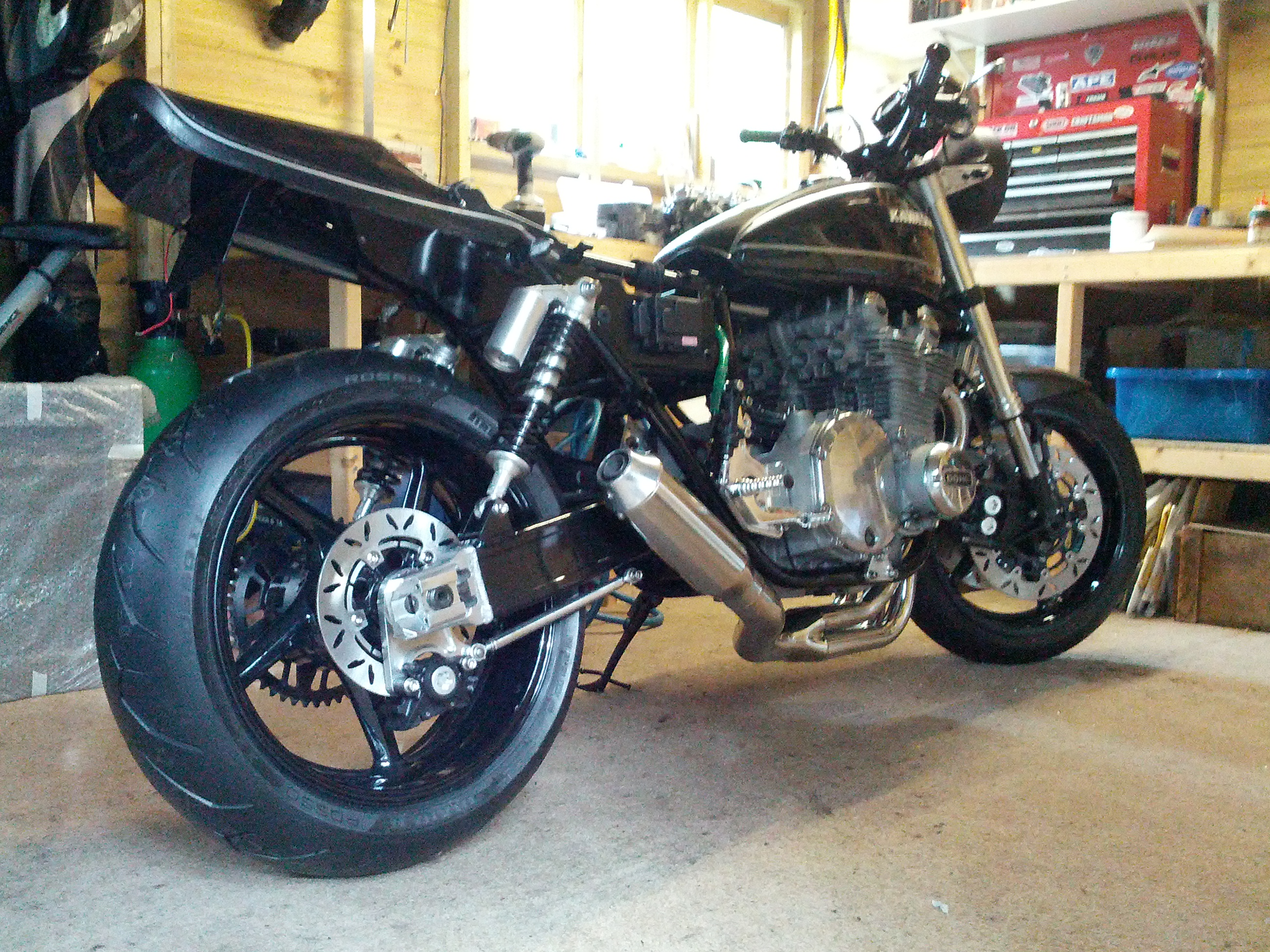

Nearly there
At this point things were happening very quickly and i was building the bike up quicker than i can photograph it, so apologies for the lack of photos, i will endeavor to take some more detailed shots over the next week or so.

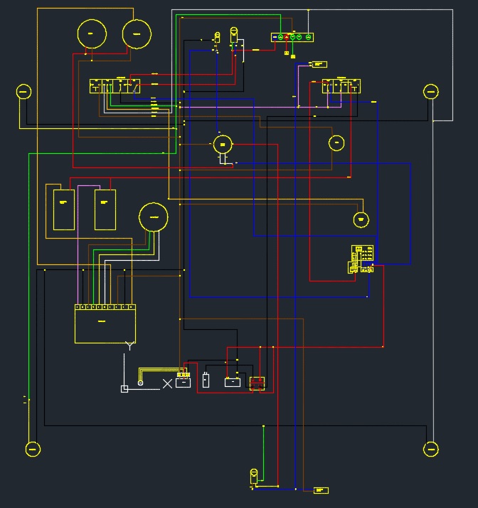

I was building the wiring loom from scratch as the old loom is a right dogs breakfast of broken, hard wires covered in filth with missing connectors and seeing as the original bike had points, separate reg and rec and that all the electrical componentry is modern stuff it is less work to build a new one on the bike.
I started by knocking up a wiring diagram on Autocad:
Electric are very boring and tedious. That's why i am a MECHANICAL engineer. It took me a bout 4 hours to do it referring to standard Z1000, ZXR750, ZX6R schematics and the various wiring diagrams that came with the ignition etc.
It took me about a week of nights in the shed to complete.
Time to sling on the front calipers, exhaust and rear sets and a load of other gubbins:

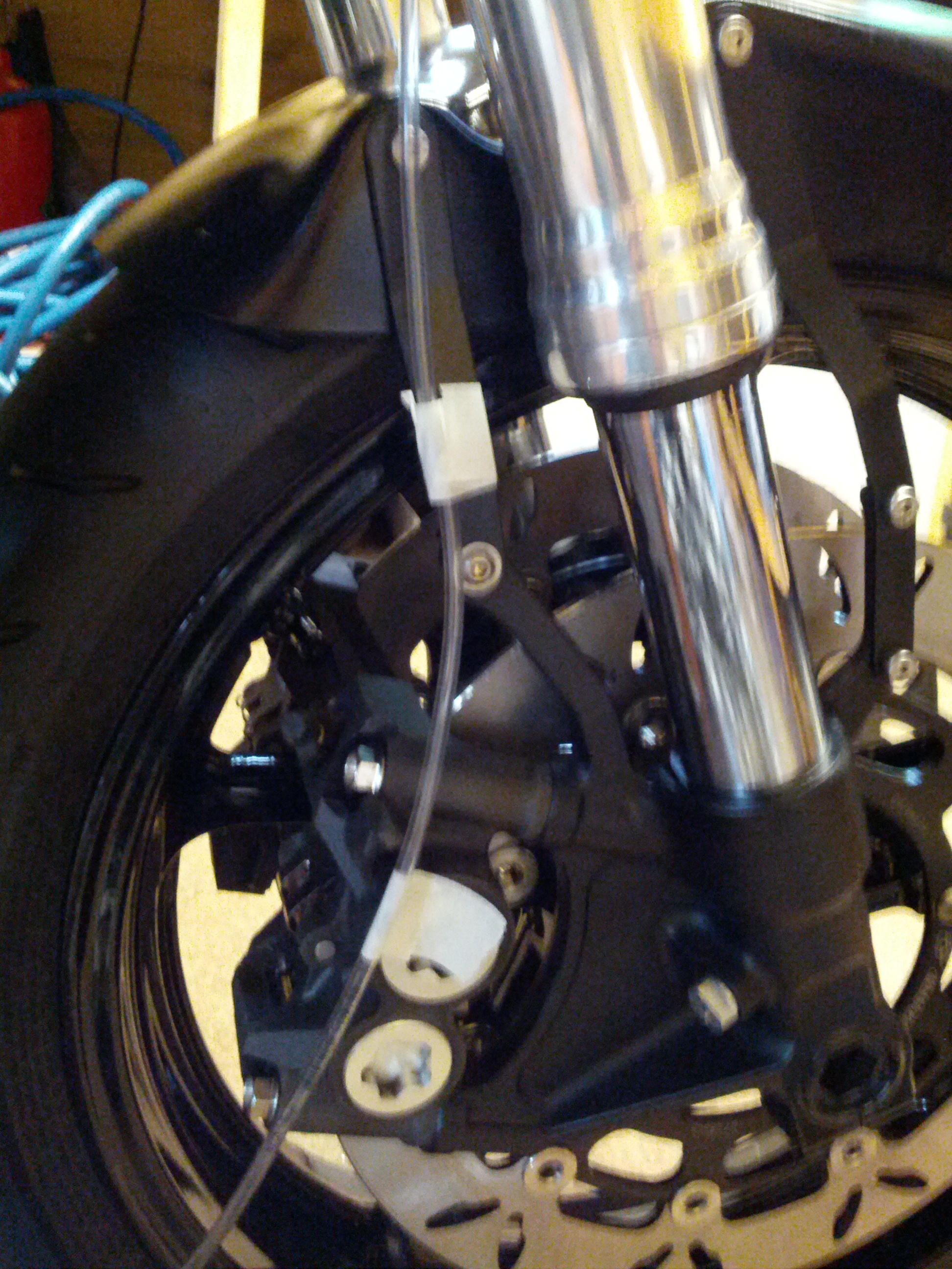

Then measured up for hydraulic lines:
I opted for Venhill lines as I wanted to keep the almost British theme. They are a bit pricey but i like their swaged nut and replaceable system so i can change the line length easily if i want to extend the forks much. But i allowed +50mm on the front lines to allow for this. I also have some better plans to route the front lines. More on that later....
