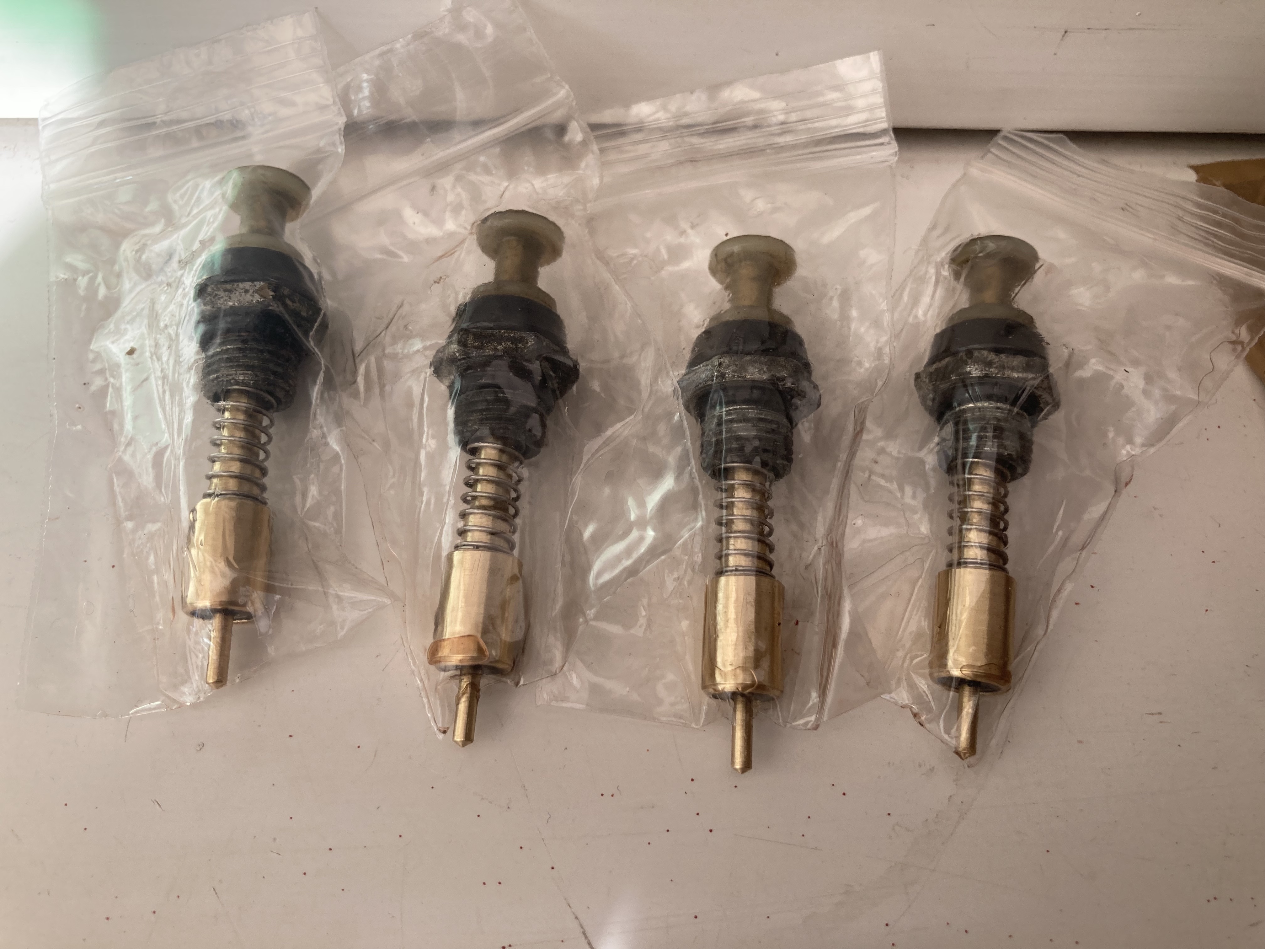

So following some sound advice I took my Choke Plungers to Rob Meggitt as I didn't realise how close he lives to me.
A few days later, these arrived in the post:
And I fitted them and set up the Carb Slider sync gaps with a 2mm drill then fitted them to the bike and boxed it up. Previously there ware all sorts of problems as since I had thumb thick black fuel line I wasn't sure there were air locks or just simply no flow. So I took the option to get some Tygol translucent Silicon pipe and fitted that too - which also get rid of four joints too. This made a big differnce as well.
Fired it up and much, much better than previously and improved as the engine warmed up.

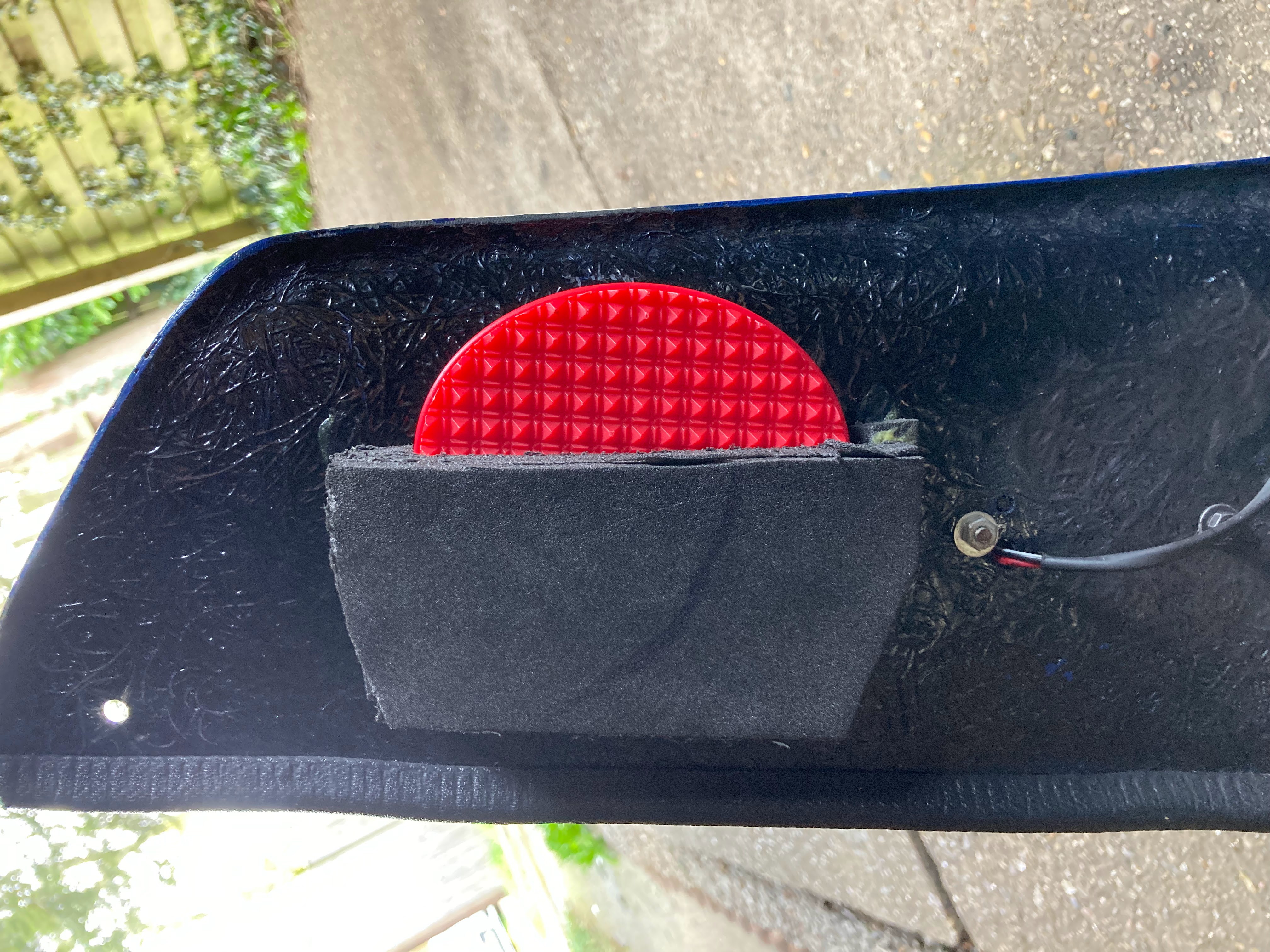

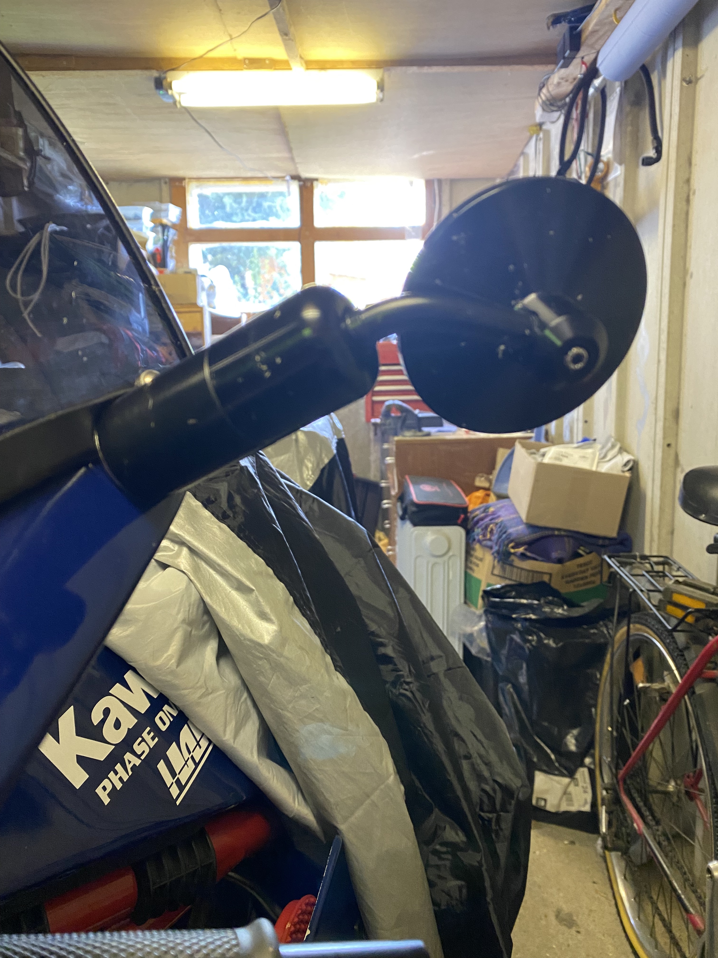

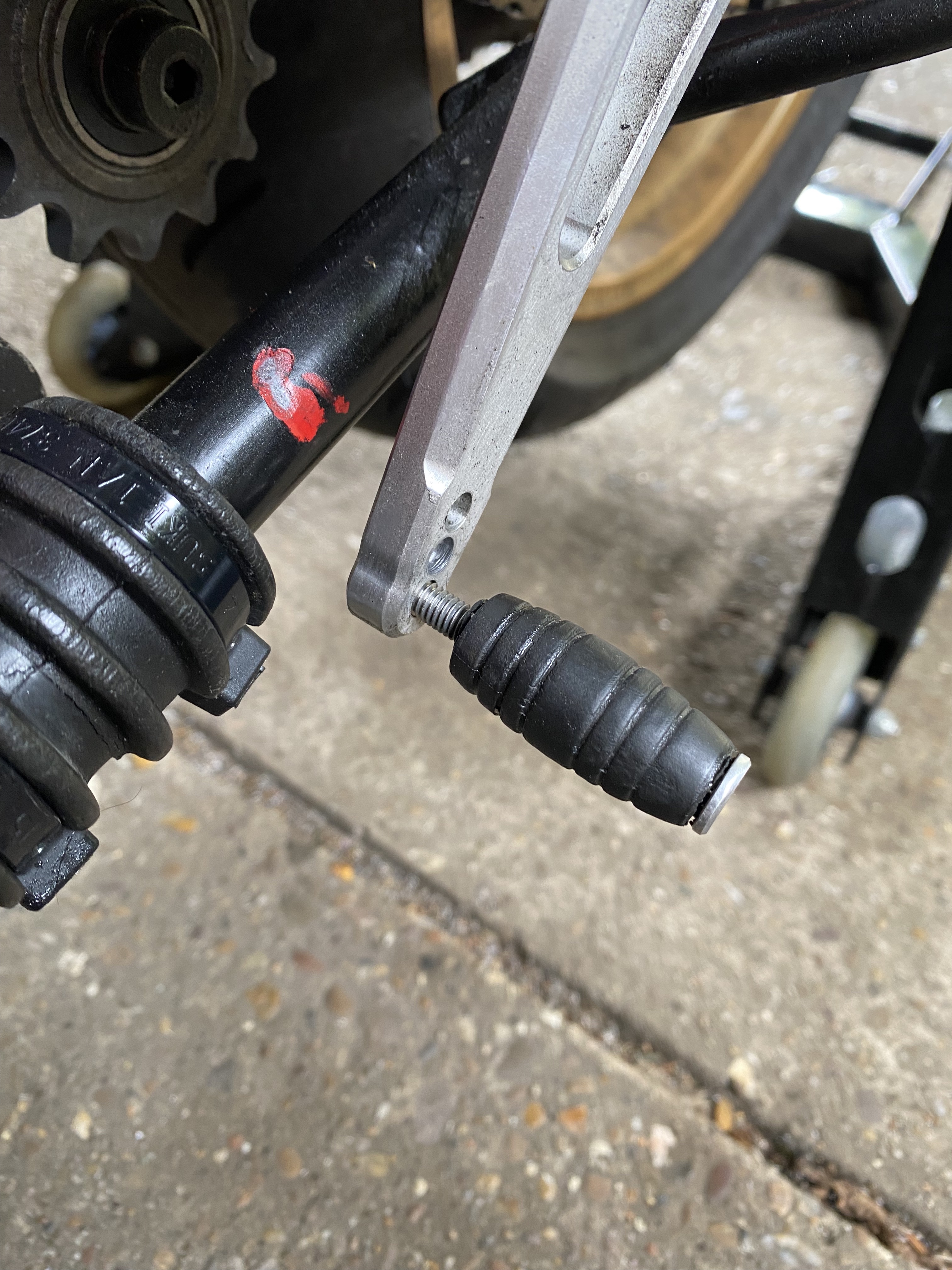

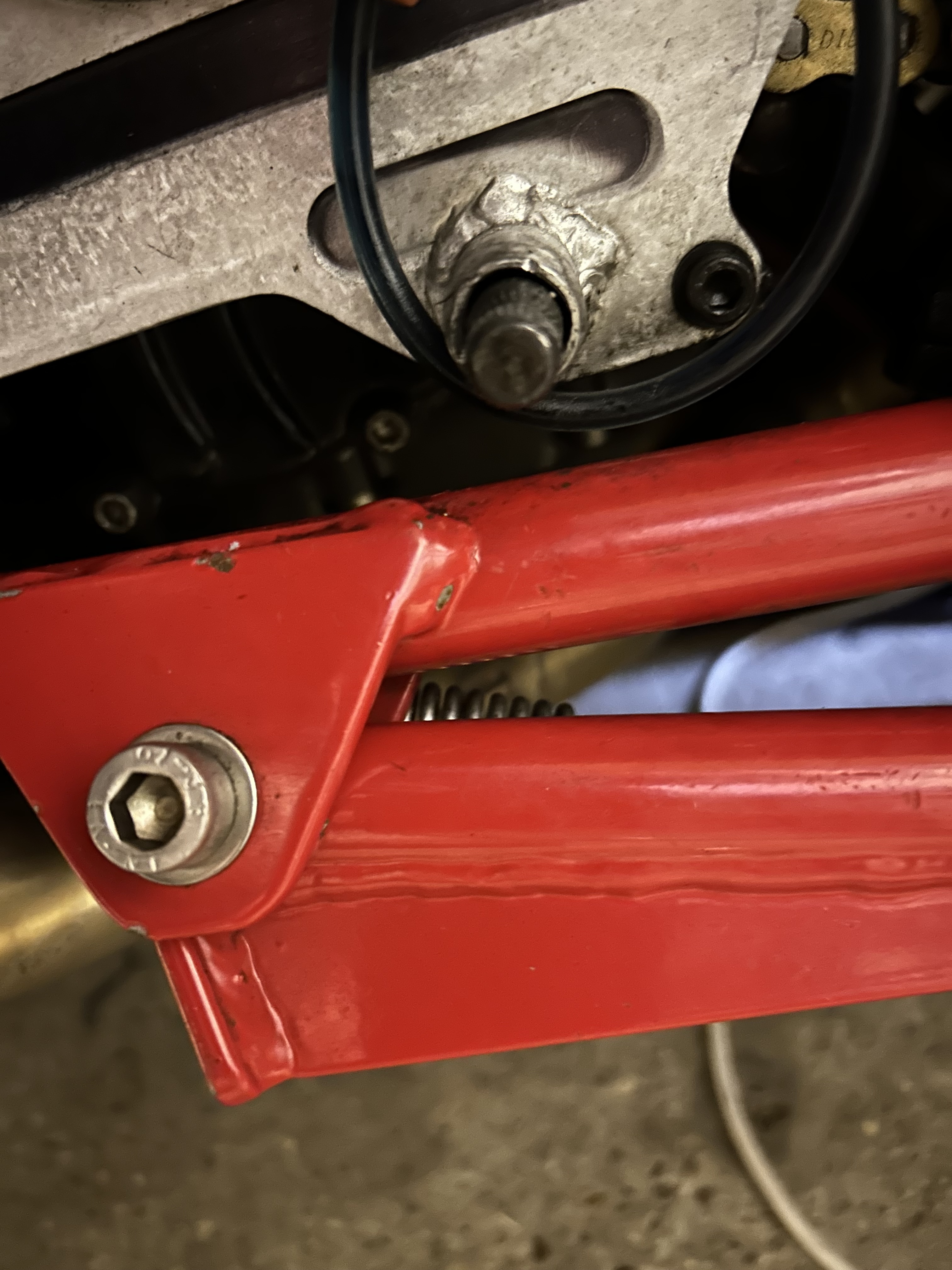

I made a few additions to the mirrors. These are eBay knock off of Oberon and easily come apart to use longer mounting bolts to space them out past my shoulders. I had some black nylon bar machined to the size and diameter needed to tidy them up. Then they are also the top fairing mounts.
Another thing is that I needed somewhere to keep the Side Stand Foot instead of sticking it in my pocket or bag so cut and glued some closed cell foam to make a holder.

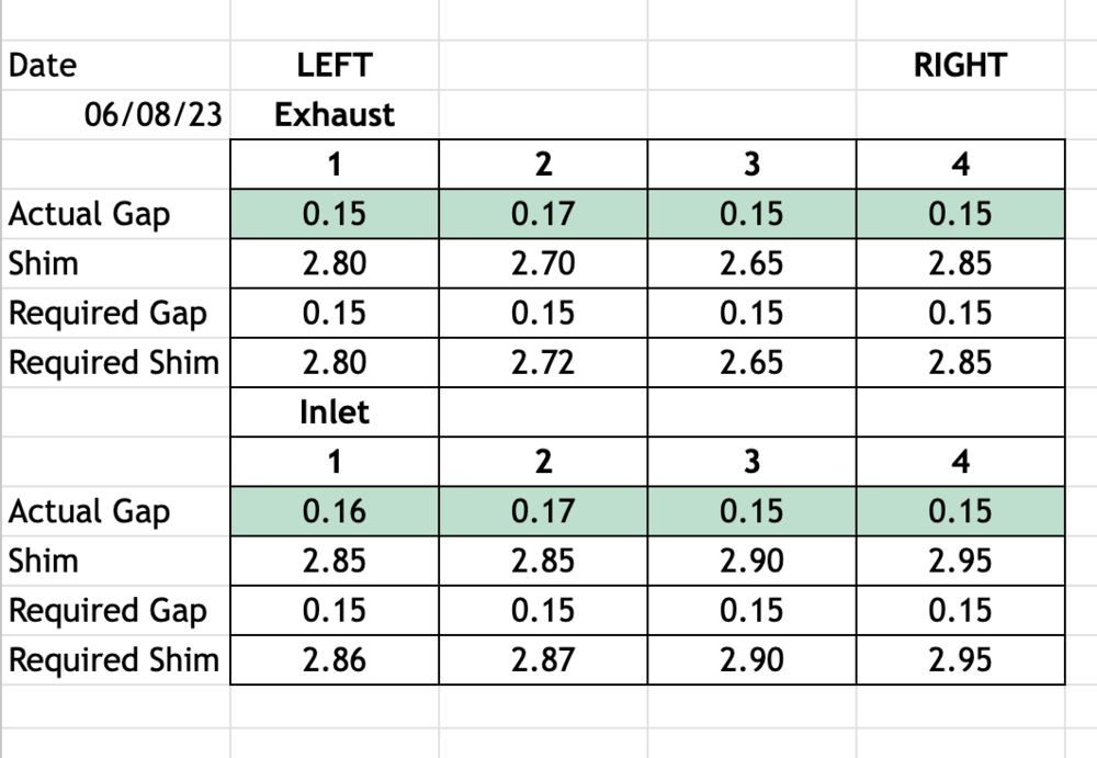

Then onto the Valve clearance check:
So I found them mostly ok:
Apart from #1 inlet and #4 Exhaust, so the Shims need changing on those and I think I'll change all the others too to put them closer to 0.15 mm.

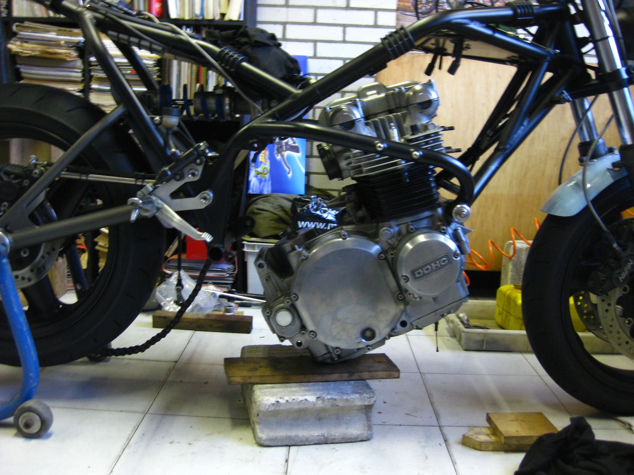

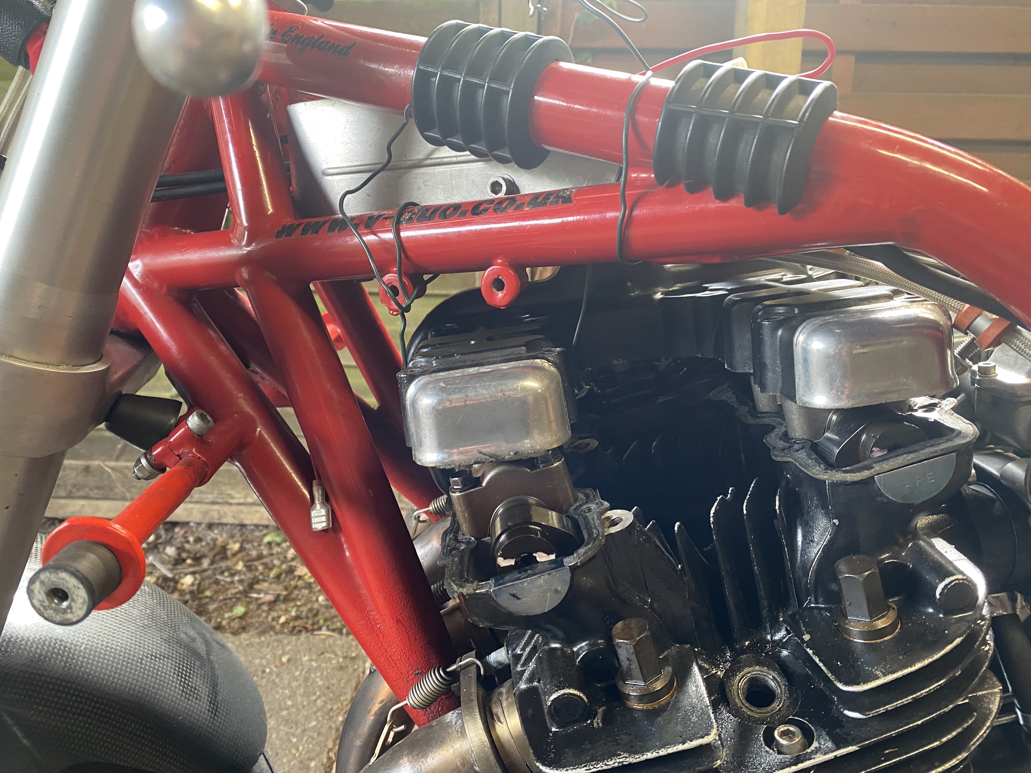

I can't do the Head jobs with the engine as is 'cos there's no room - can't get the shim tool on the inlet valve.
So this is the scenario for the work, only using a car jack to lower the rear end

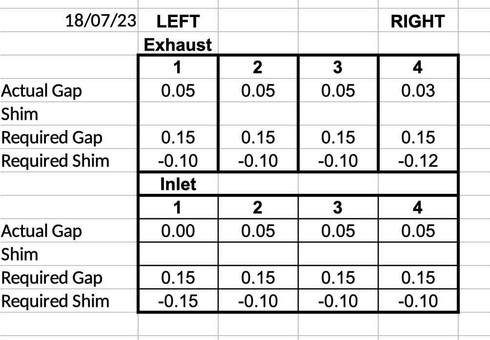

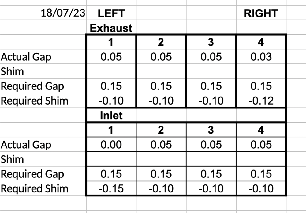

Re: HowieD's 'arris
All of those shims are too tight and you will have certainly been losing power on 1 and 4.
Never set them at or let them go below 0.10mm.
0.10mm is the minimum clearance at which the shim should be changed.
Always aim for 0.15mm and if the next shim size takes it a little higher to 0.16mm - 0.17mm that's ok..
Re: HowieD's 'arris
zed1015 wrote:All of those shims are too tight and you will have certainly been losing power on 1 and 4.
It's only when I went on the How Too's pages about Valve Clearances did I see the reference to burnt out valves and a Service Bulletin about them - do you have a copy anywhere by any chance Rob ?.
I'm just awaiting an opportunity to be able to start on it all next week - parts and oil on their way :-)

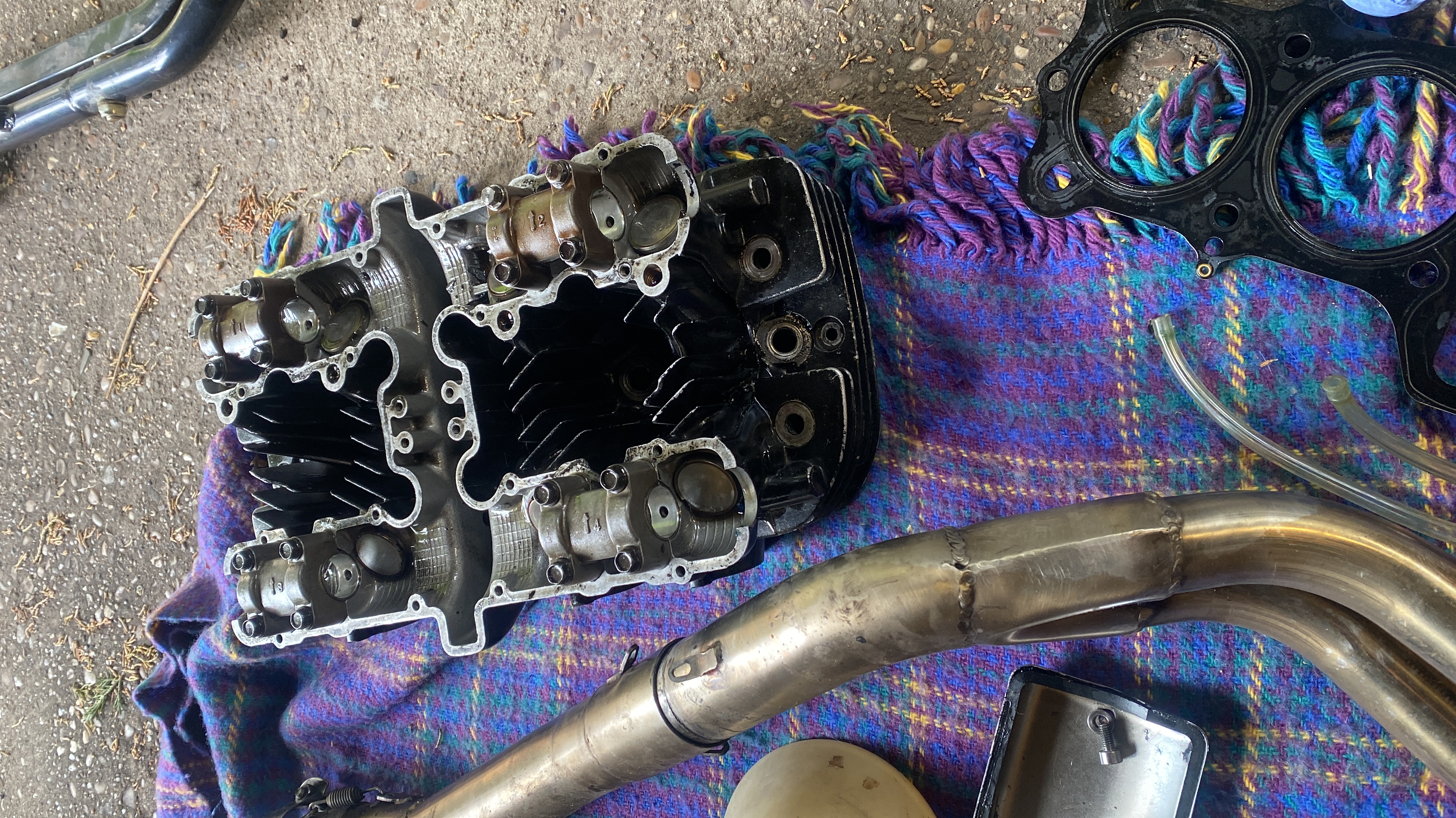

Well in that time I've hand to remove the head for some fettling at the premises of that well known Z Guru zed1015 (TYVM Rob

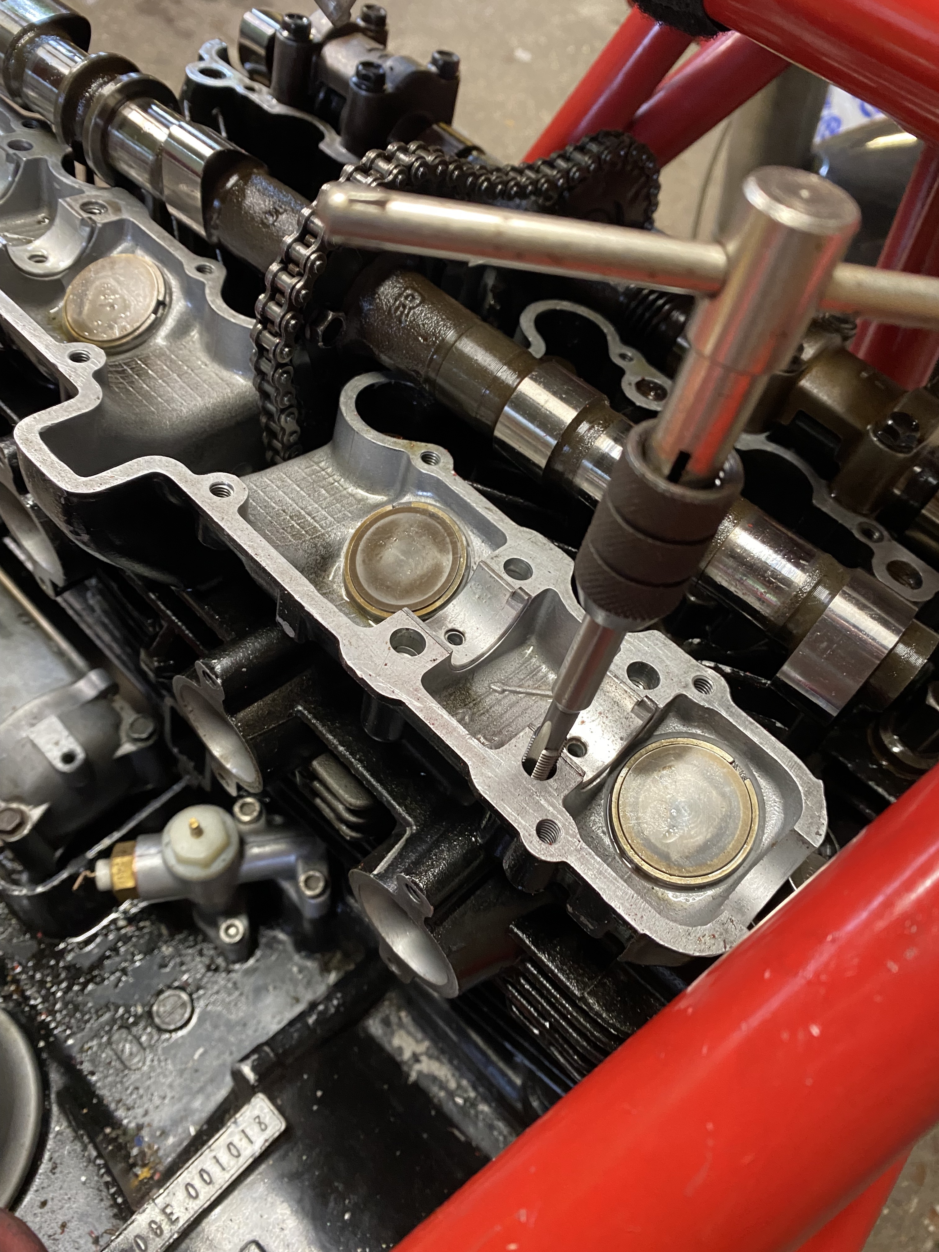

Stripped a thread on the Cam Cap so had to do a Helicoil repair - once the kit was delivered from the Bikers Toolbox. £38 for a kit seems a bit of a bargain compared to other vendors.

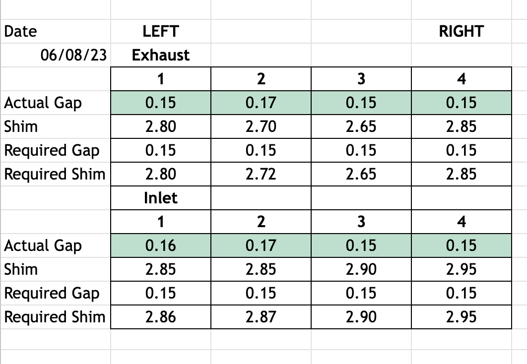

Took a few goes to get the Shims right and some postal delays for the new ones to arrive in two batches but happy with the resulting gaps now:

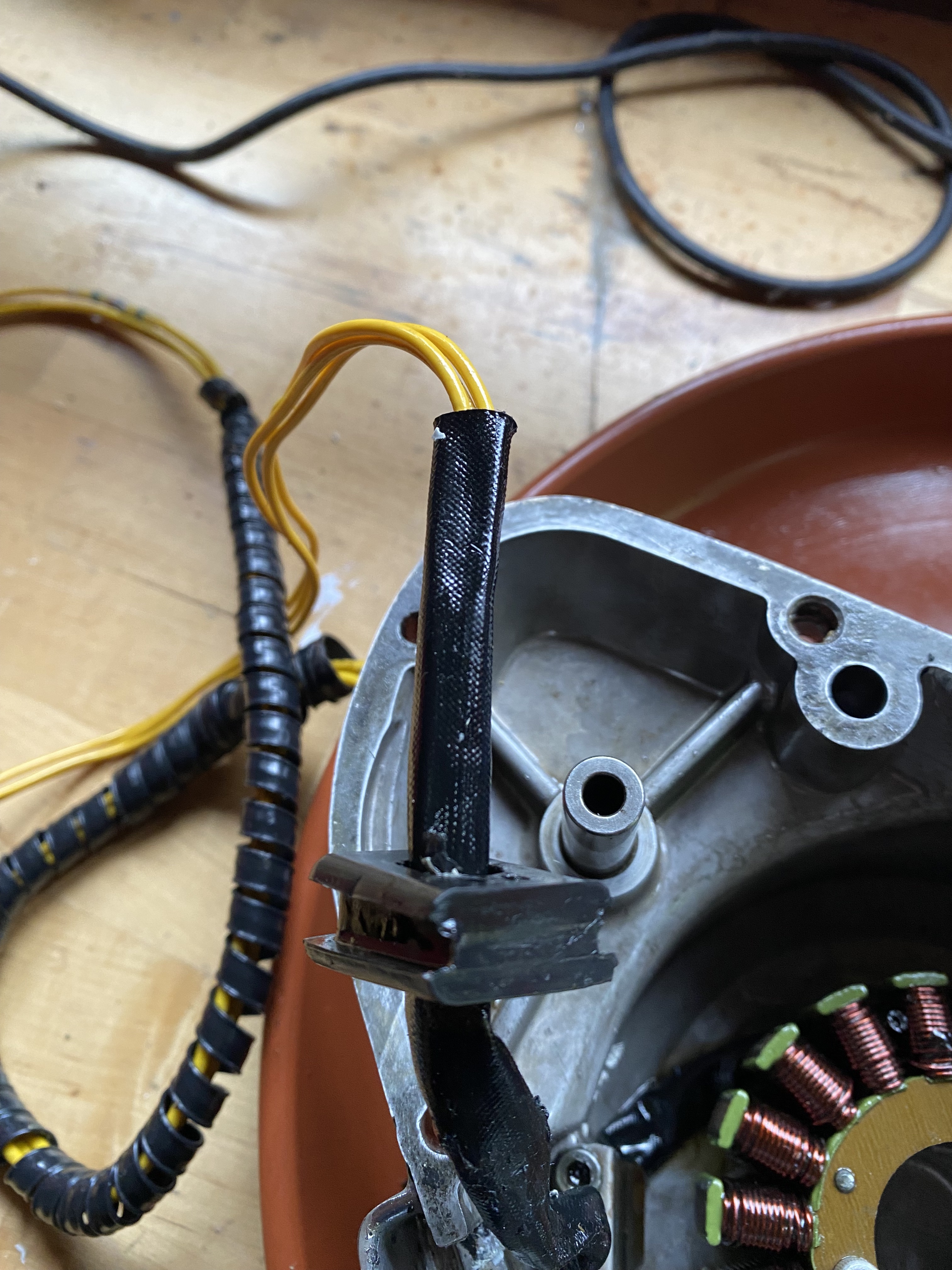

Then, once the shims were done, the engine bolted back into place, it was time to turn the attention to the cause of the oily boot. Not a good idea to put a conduit path through a grommet. Oil was tracking through the sheathing to the outside air, then my boot.

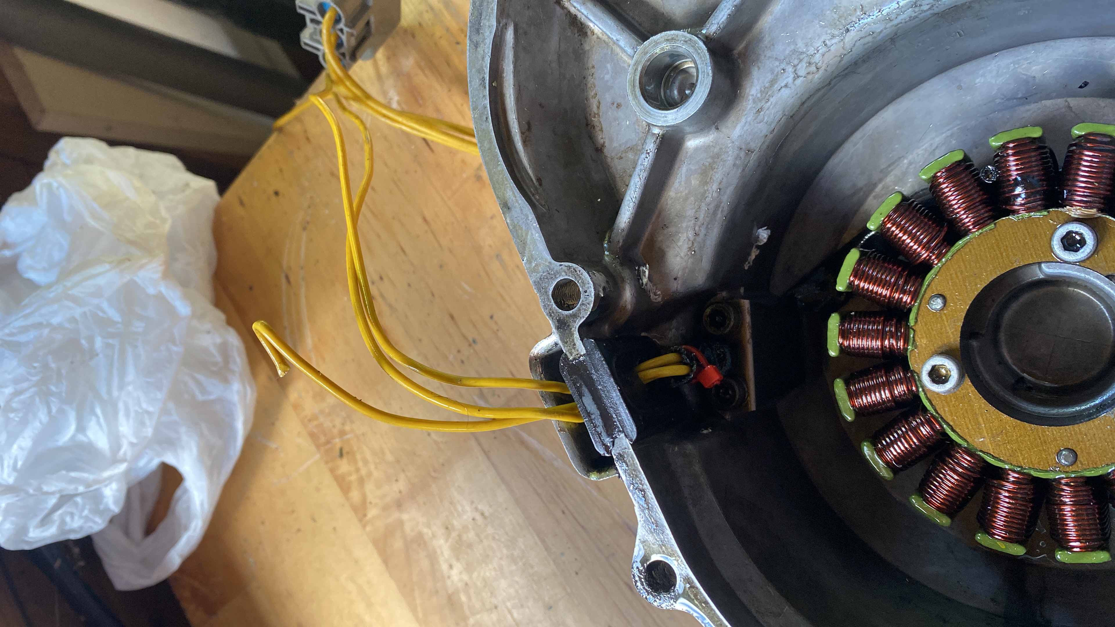

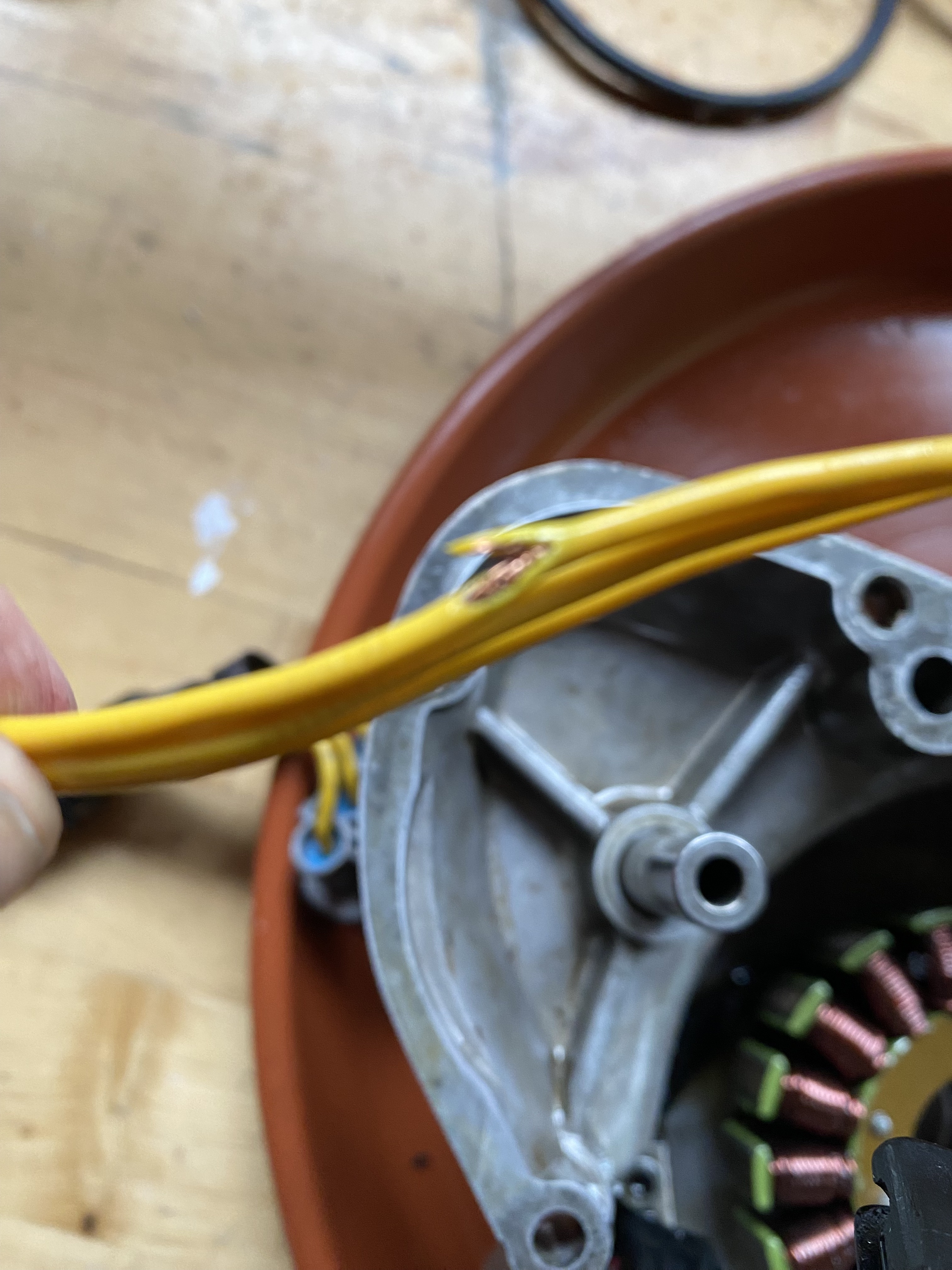

Then once the sheath was trimmed back this horror was discovered:
Cut the wires back and connected to three core tinned cable in one length to a new MOSFET Plug. Then tested for continuity to make sure there were good connections. Protected the lot near the generator with a new grommet and several layers of Heat Shrink.

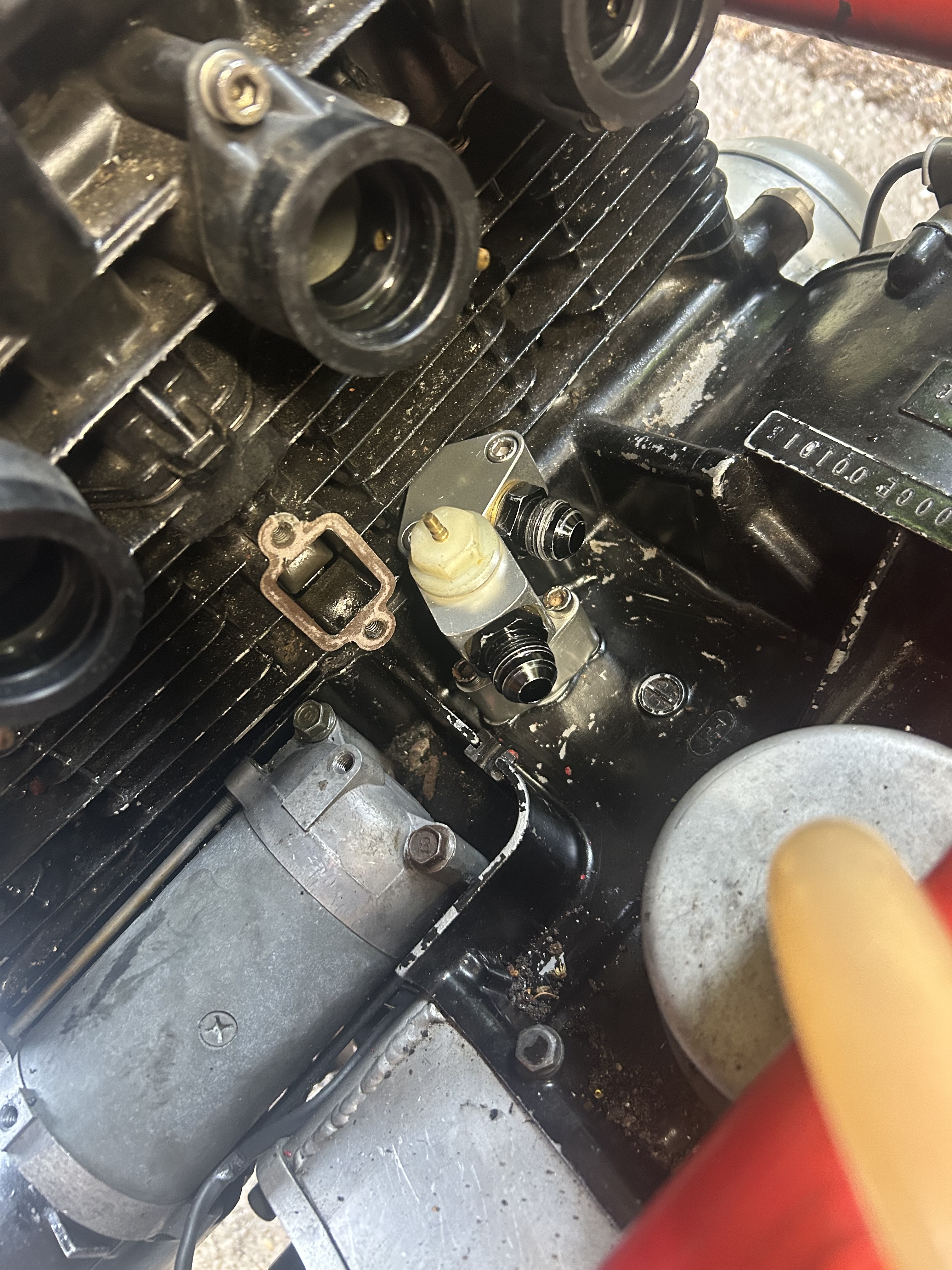

Test start and check for leaks - #2 Exhaust blowing, so reseated the copper ring to seal it - all good on the second attempt.

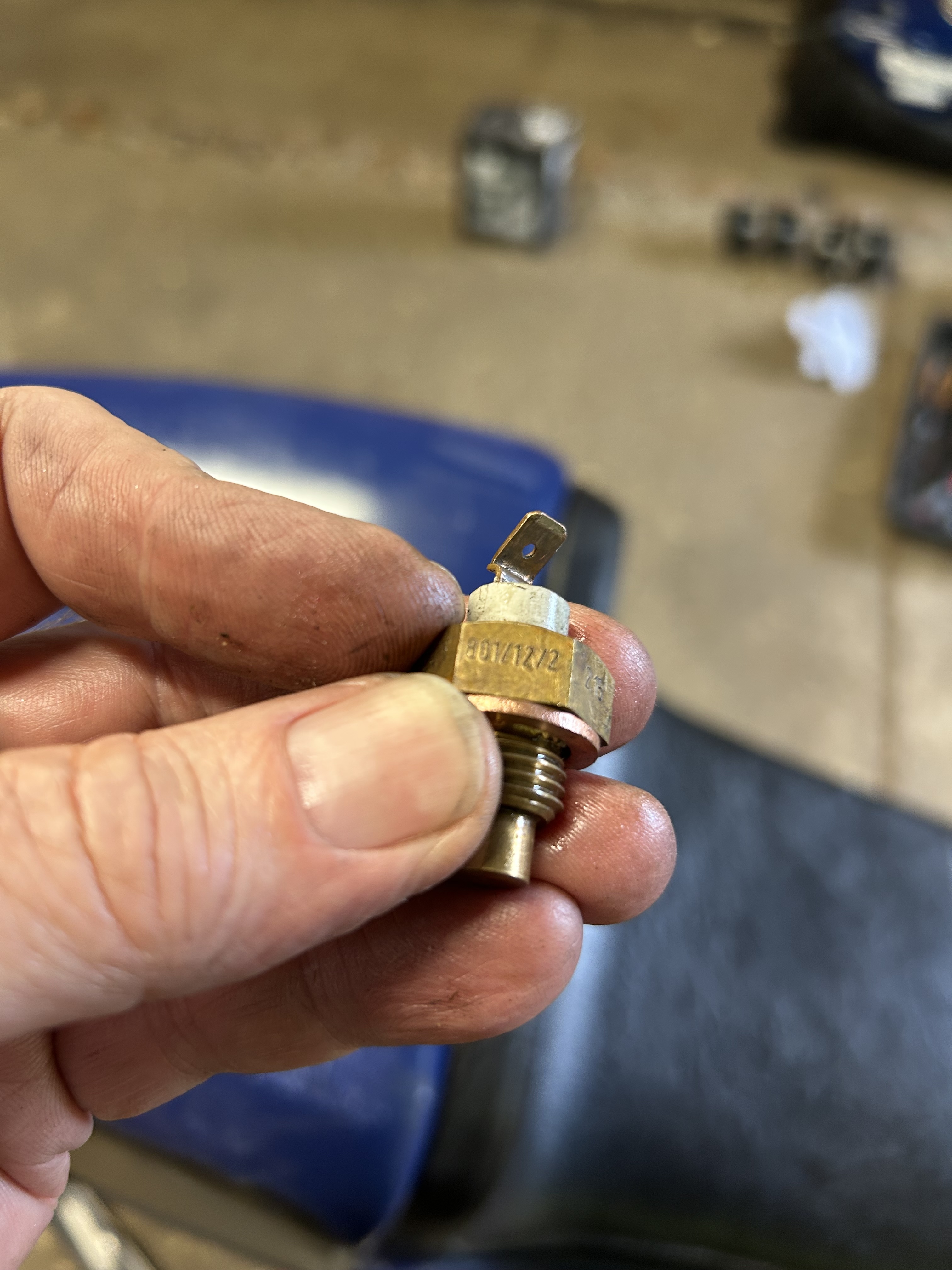

Issue 1 - Oil Temperature Alarm when the oil Temp hits 150DegC. (Oil T)
I have a full on Motogadget set up and one of the settings is to give an alarm when the Oil T hits 150 DegC. When Horace was built an oil cooler was fitted ''cos trendy and all that but the Oil T was only getting to 80 odd Deg and I thought that might be too cool to boil off and the sight glass window was mostly covered in mayo even after a run. Also I was worried about the run of the oil lines for chaffing and leaks and Z1's didn't have a cooler fitted anyway.
I took a run out with the aim to have a bit of speed fun on my local motorway only at the start of it the oil T was showing 130 already after a steady run then rapidly rose past the alarm and I saw 178DegC which was mad. I mean when does a Z1 lump go super oil T hot with normal riding eh ???
The Oil T Sensor is a VDO one from Motogadget and I couldn't find any other as on the VDO site the short one I have is superseded and it looked too long to fit. So I bit the bullet and forked out €54 for one that promptly got lost in the post !!
Meanwhile, as a precaution, 'cos I wanted to keep on the road; I changed the oil and refitted the Oil Cooler. Out for a run and the Oil T stayed below 100DegC.
New Oil sensor still lost in the post. In the meantime, eBay, was obviously stalking me and showed be an VDO Oil T Sender that I was looking for on the Classic Beetle shop at £14 !! so I grabbed one of those quickly for a next day delivery. It promptly arrived, as did the Motogadget one ! The Classic Beetle one also had the copper washer with it too.
There's a test procedure that I found and a graph of expected resistance so I whipped out the one fitted and tested them and found both new ones had an ambient temperature resistance 200 Ohm higher than the installed one 1100 vs 1300 Ohm which is about 20DegC, which would explain the over reading of the Oil T, maybe.

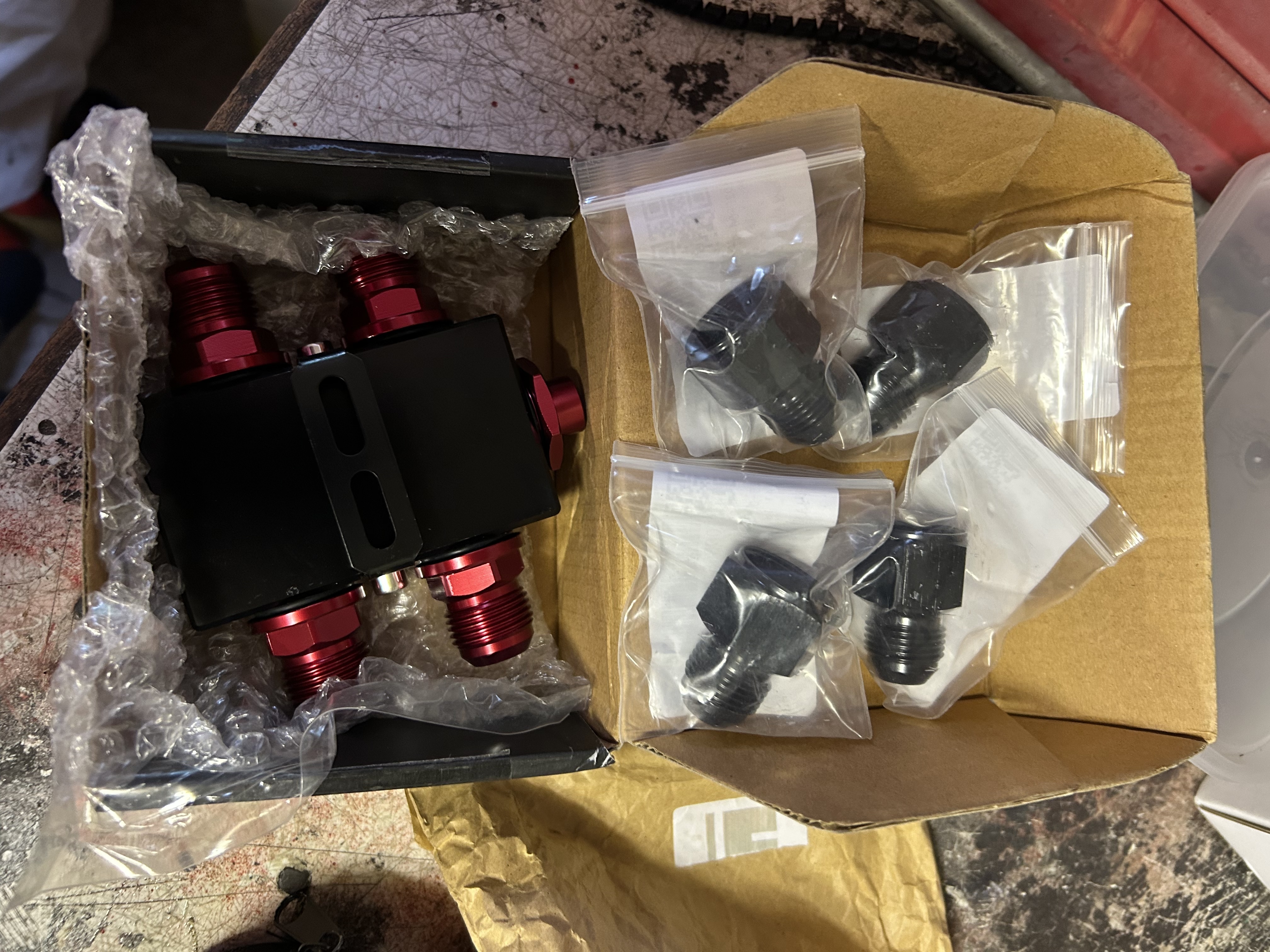

Oil Cooler install - I sort of fitted this temporarily and routed the hoses outside the frame on the fairing brackets and was intending to fit a thermostat at a later date (once it arrived from Alibaba - three weeks for a next day delivery or something). Anyway, I mentioned it on another message board and one interesting answer was 'why fit a thermostat?' So after a bit of a think I didn't fit it once it arrived, I passed it on to another Z owner who had seen Neil Conway's FB post about this particular unit.
Out for a blast and the max Oil T seen was 110DegC even with a bit of spirited riding to try and get the temperature up.

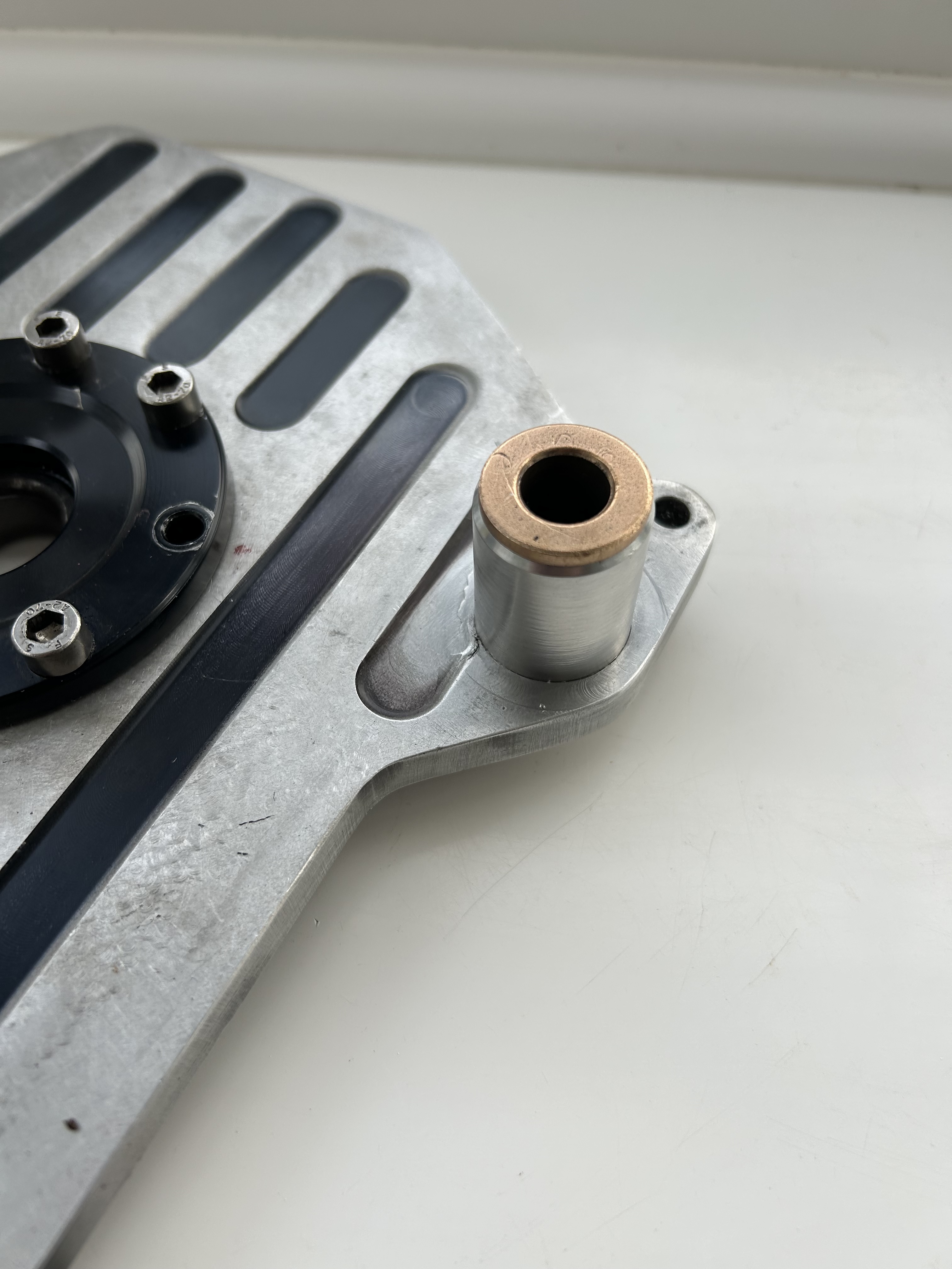

Issue 2.

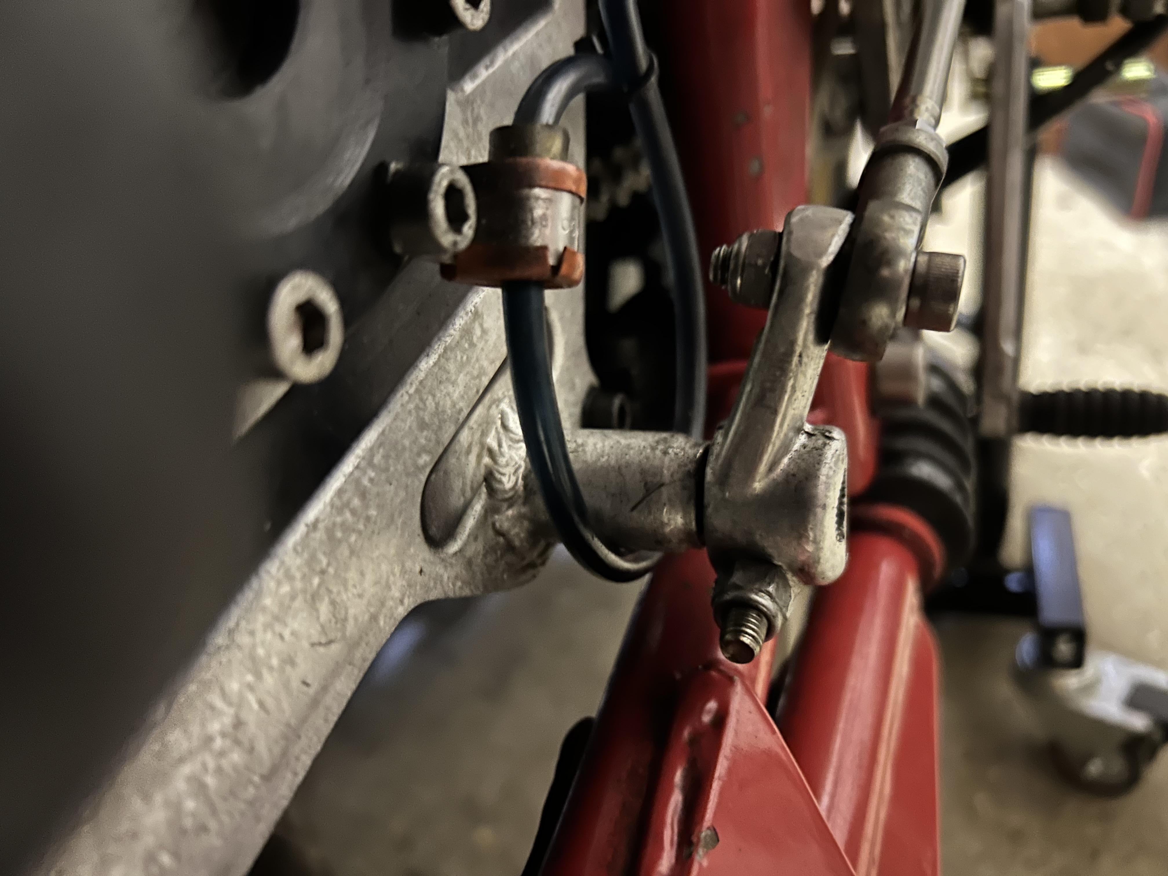

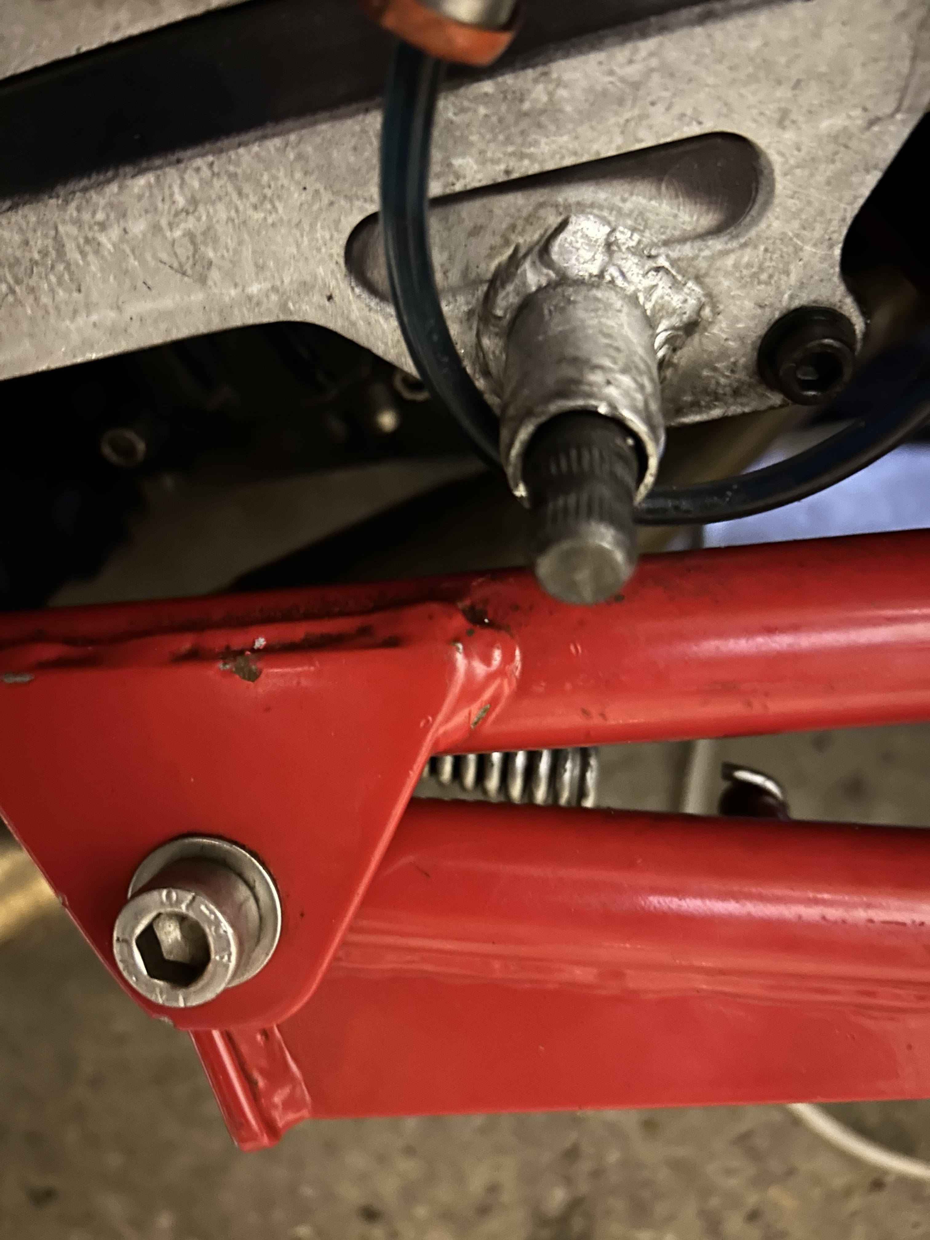

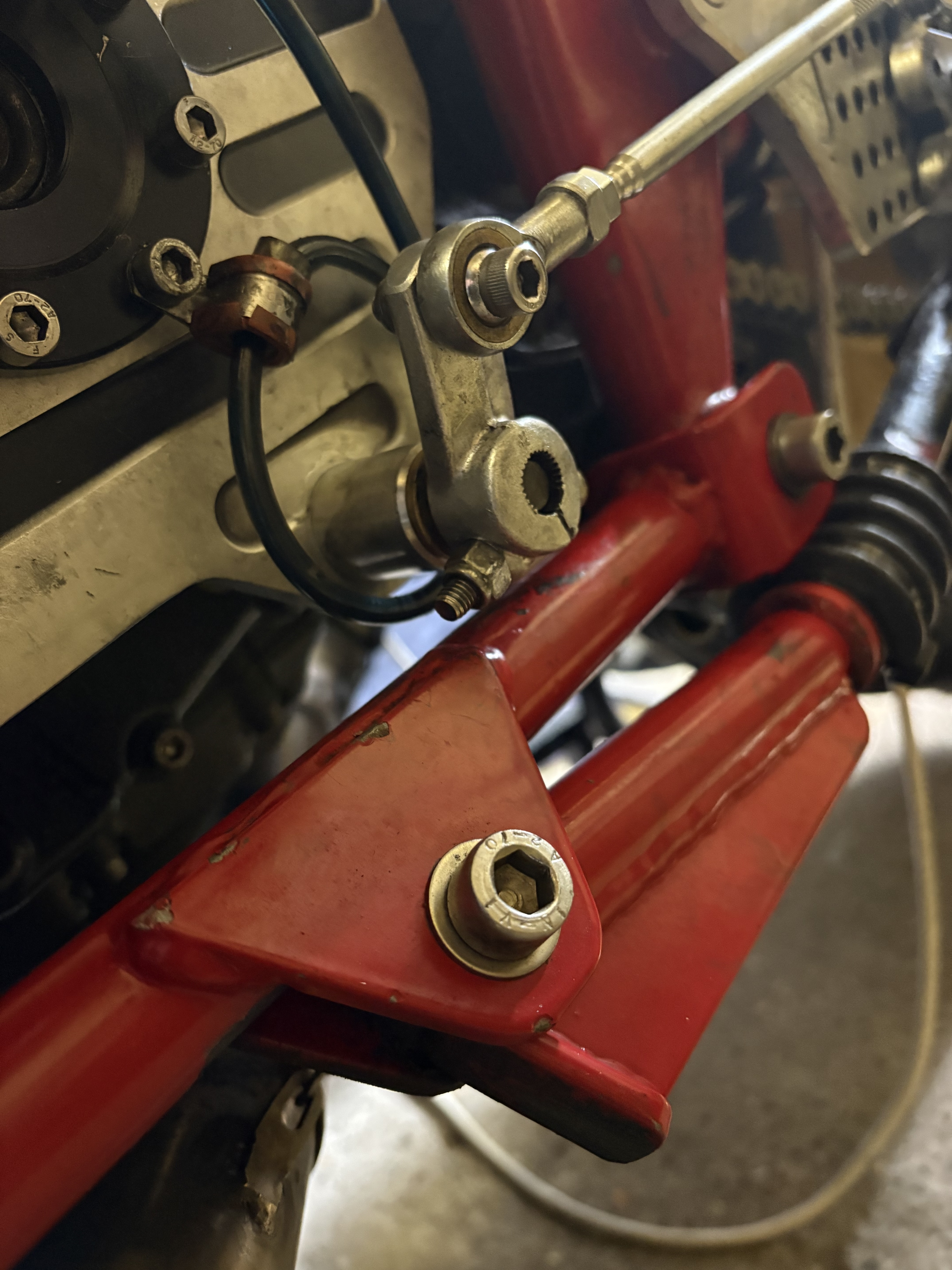

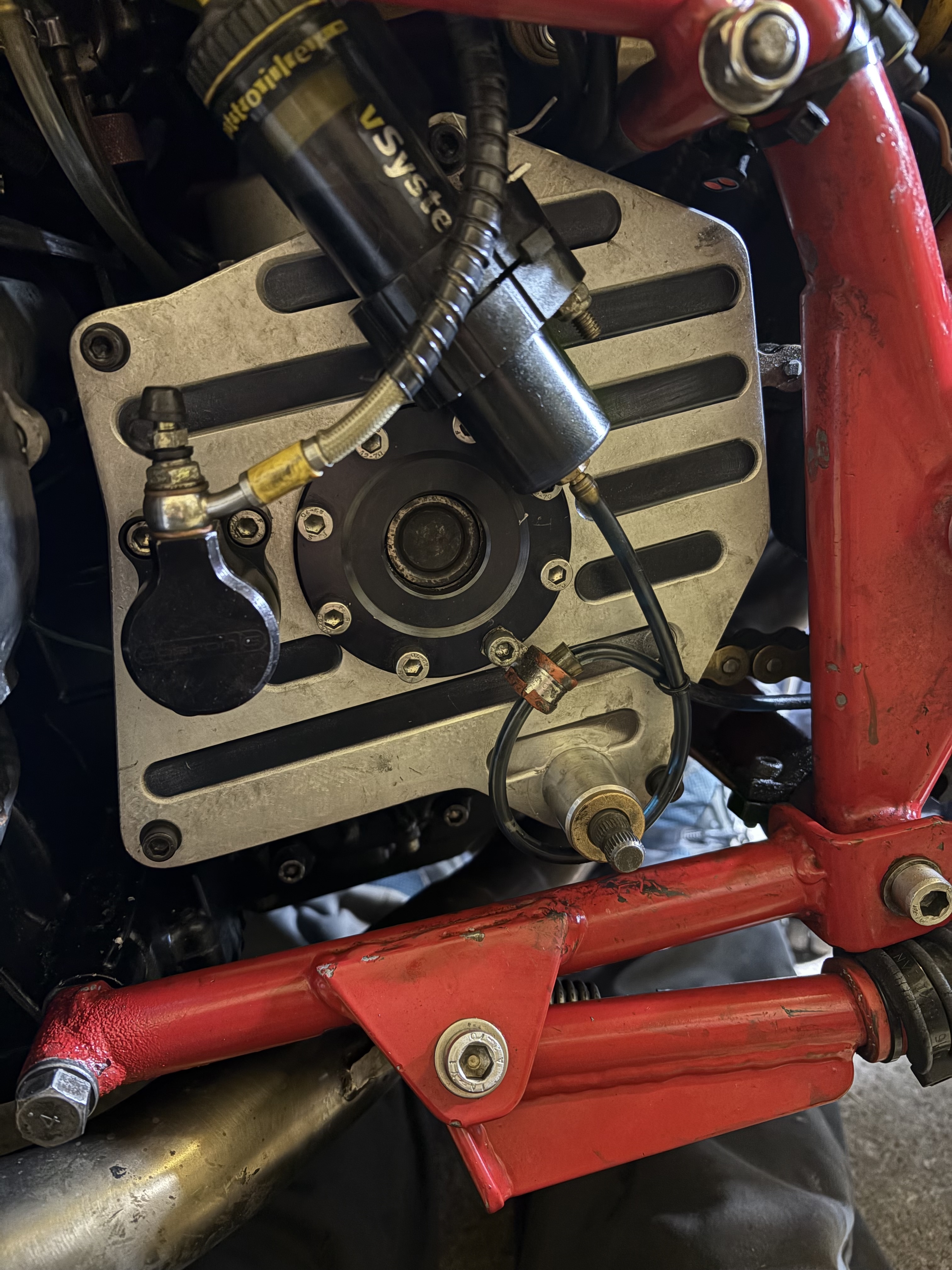

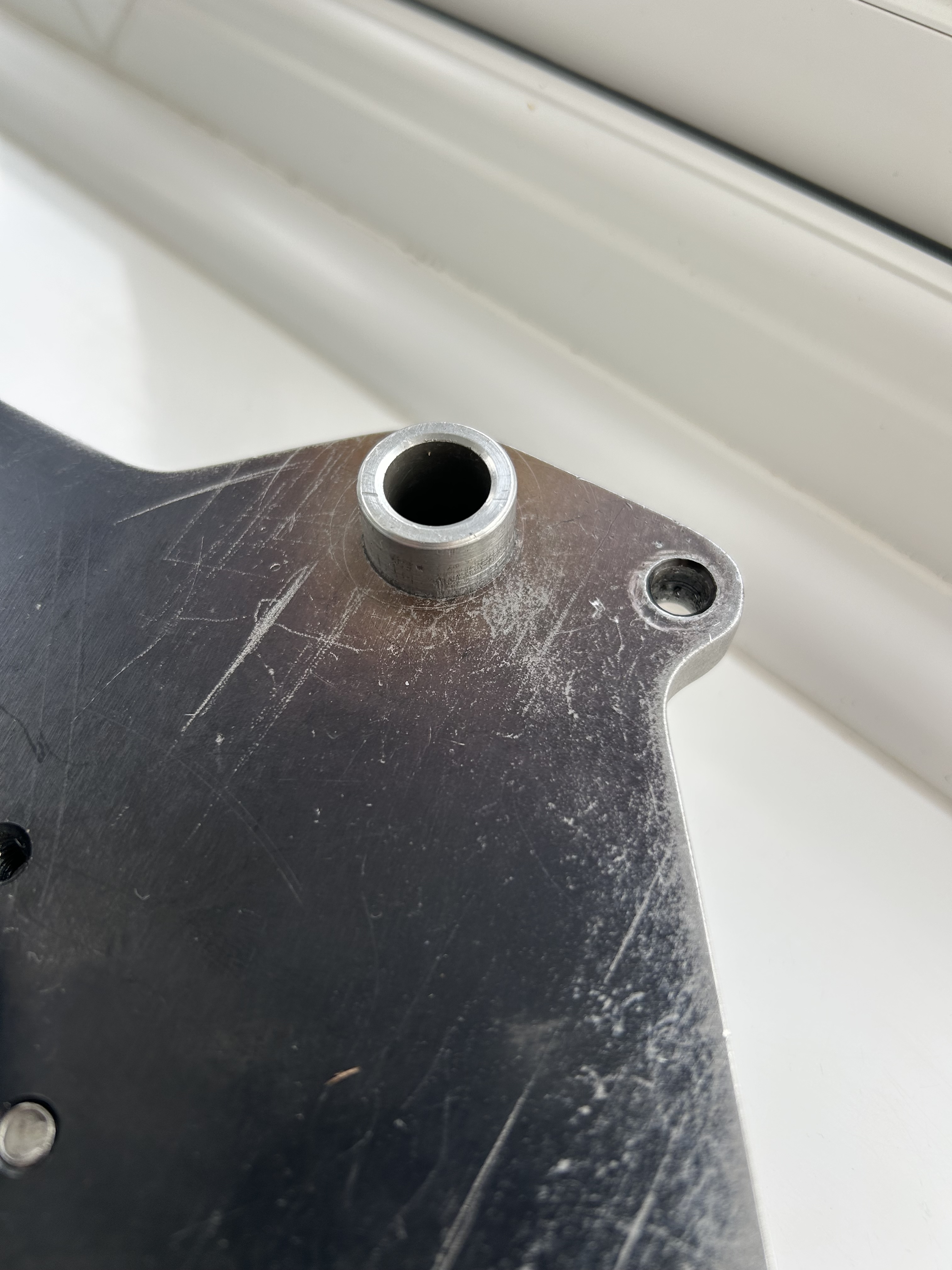

On my last ride out on Horace, I noticed the gear change was even sloppier than previously, even missing gears sloppy.
Checking out the mechanism showed me that about 1/4 of the movement was taken up with pushing the Gear Change Shaft forwards. The Boss on the outrigger plate had very badly worn.

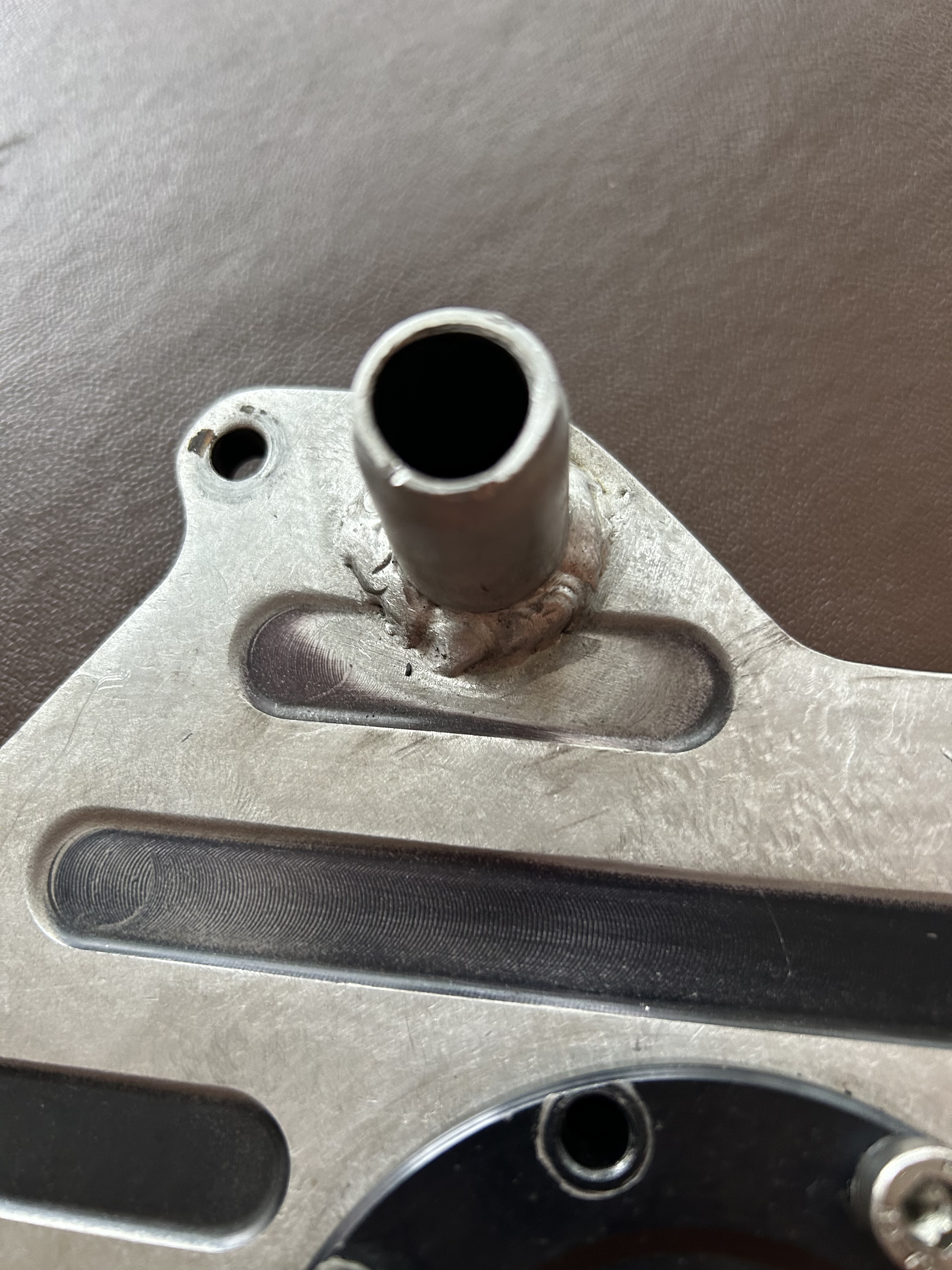

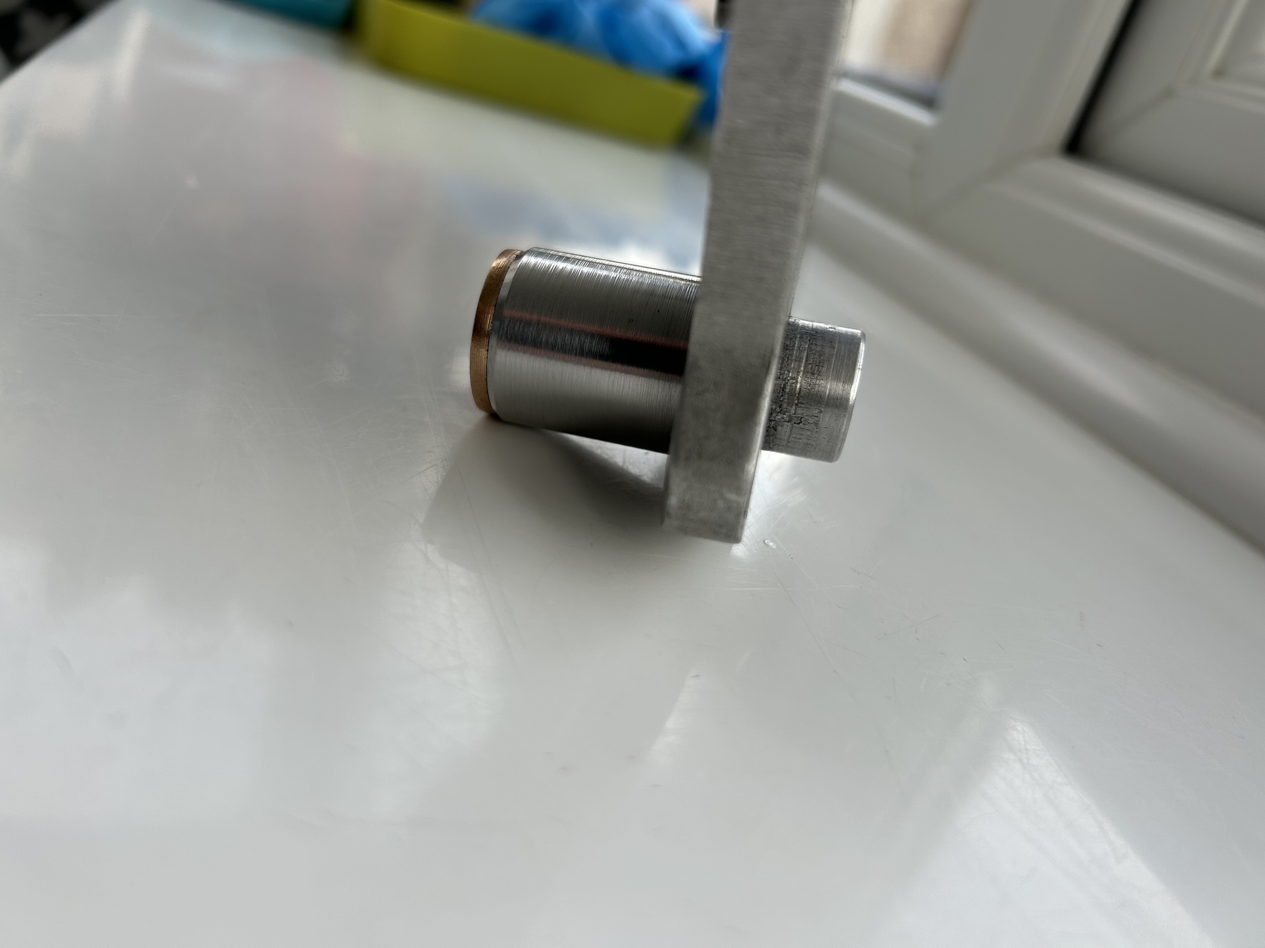

So I took the plate to Rob Meggitt and asked him to have a look and see what he could do.
Rob came up with a very nicely machined solution and repair.
Here's the pictures of the worn out Boss:
And here is Rob's masterpiece:
So that's all sorted too :-)
