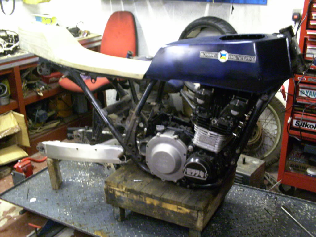

Finally got some time to work on my own bike and had a slight change of plan in the process.
I've decided that the 1428 motor may possibly be a tad too powerfull for the little lightweight cafe racer so i've decided use it as a basis for a nice minimalist Moriwaki rep.
I'm slowly collecting parts for it but will resist any major work until the cafe racer is done.
Here's where it's at so far.

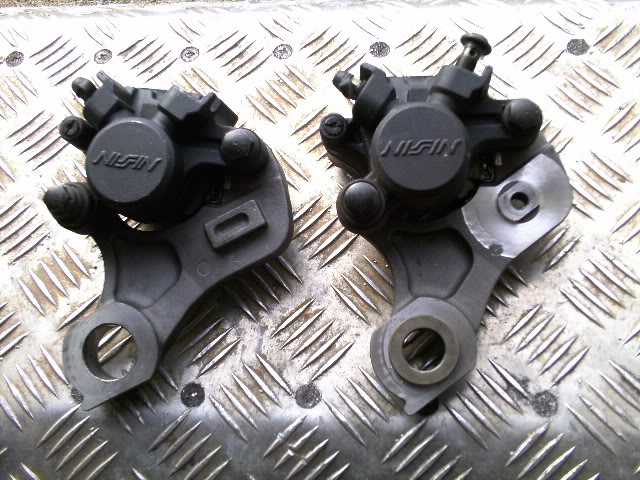

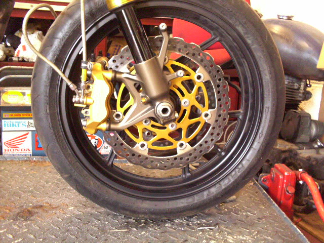

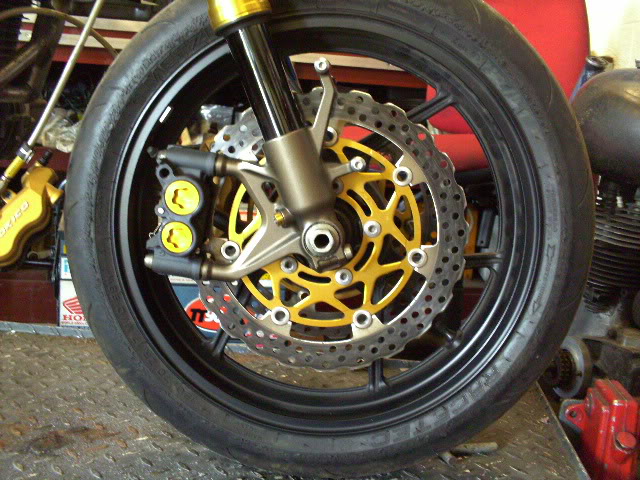

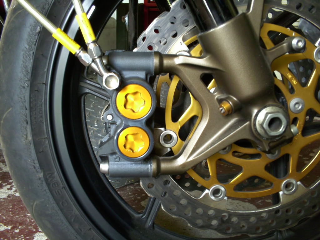

Don't like gold too much so have replaced the zx10r calipers with those off an R1.
Pretty much a straight swap but the R1 calipers sat too high on the disc (shown in this pic)

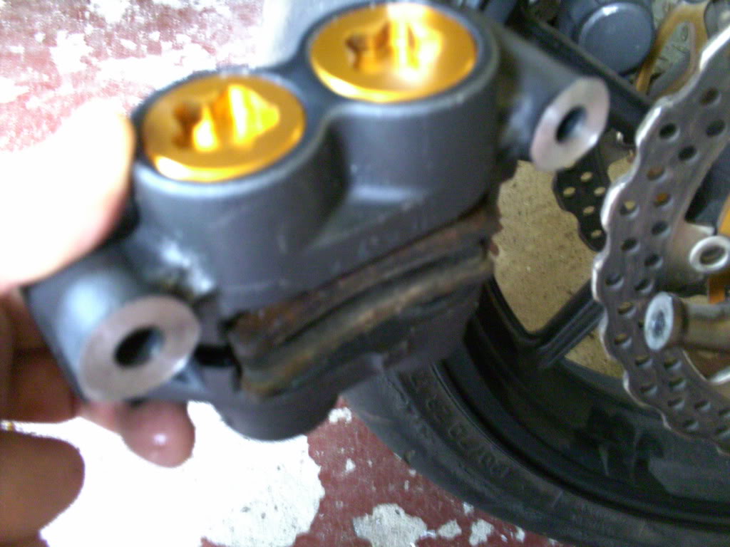

So required 5mm removing off the calipers 'feet'
And, Hey presto! another job done.

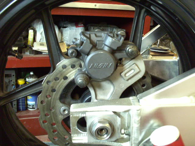

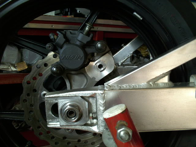

Posts: 4040
#25 PostAuthor: zed1015 » Sun May 27, 2012 11:14 pm

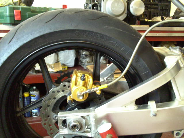

Next up was the rear caliper, again nasty gold and would also require fabricating a hanger.
R1 caliper and hanger fit the disc perfectly

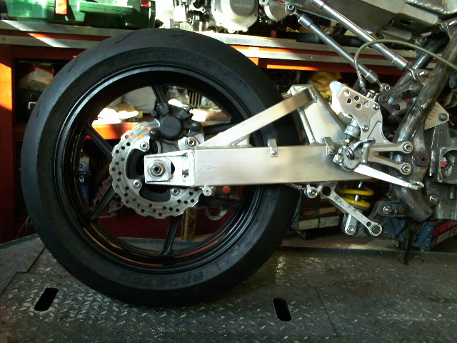

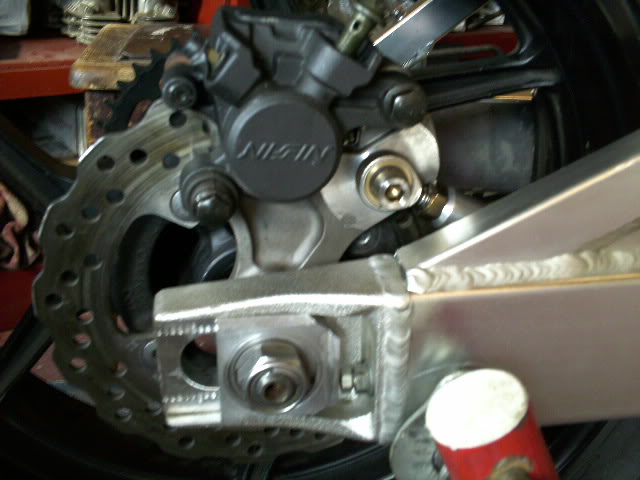

Just needed modding for a torque arm and sleeving for the smaller spindle

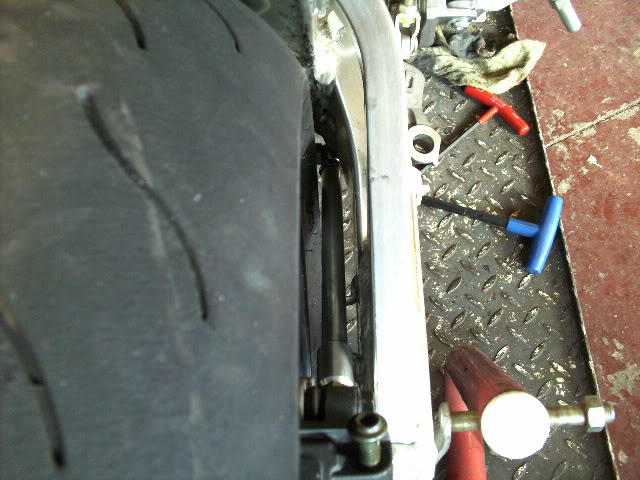

Now to squeeze in a torque arm
Which just slips past the tyre

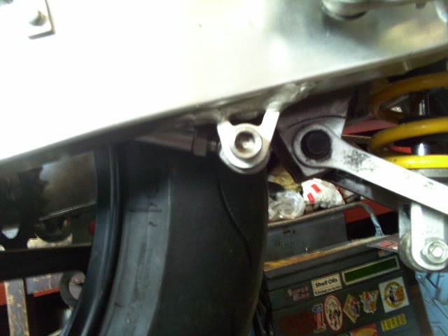

And anchors here

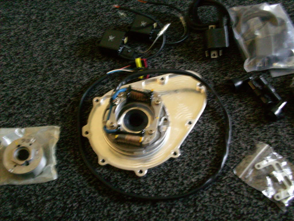

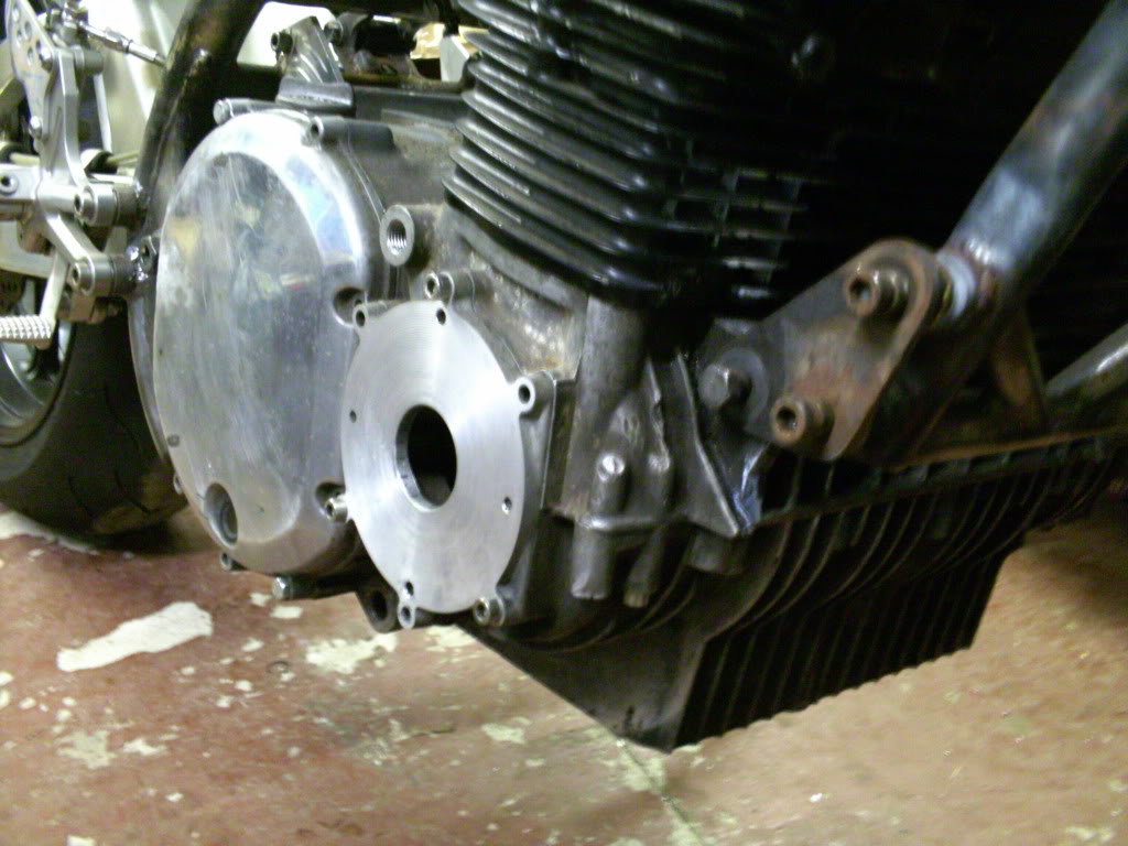

Have also machined down an old damaged ignition housing which will have the old oil seal hole plugged with a nice bit of turned alloy to keep the oil in.
This is due to the arrival of a self generating cdi race ignition that runs in place of the alternator :D
A small total loss 12v M***D battery will now live in the seat tail to take care of the brake light and horn to keep plod happy :wink:
Can we have some more info on this please Rob?

#30 PostAuthor: Pigford » Mon May 28, 2012 10:46 am
Is that an ignition from Electrex World Rob :?:
