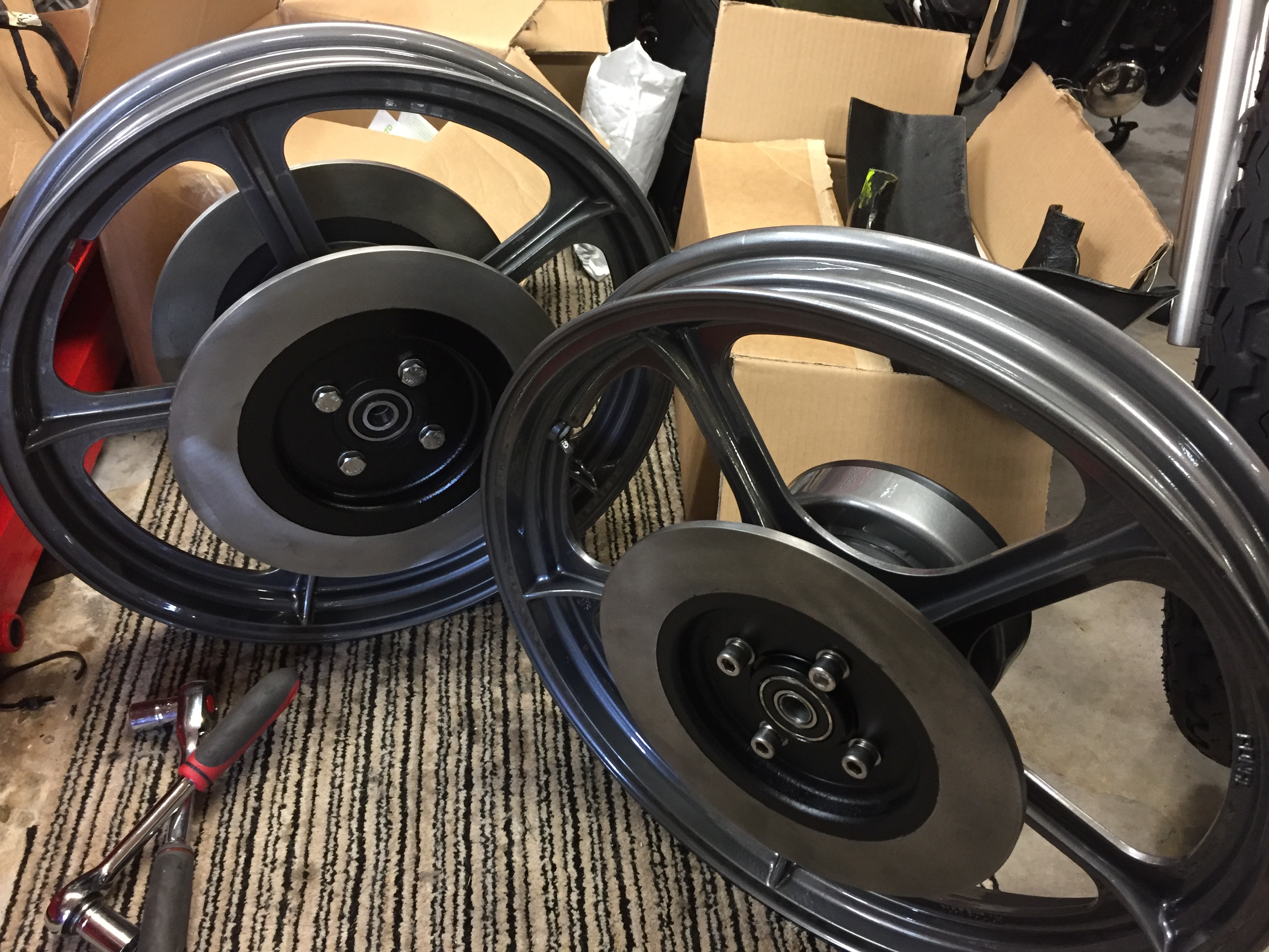

wheels done, coated and new bearings, cast discs cleaned and painted, those wheels weigh a ton with those discs - only needed 25g weight to balance with tyres on

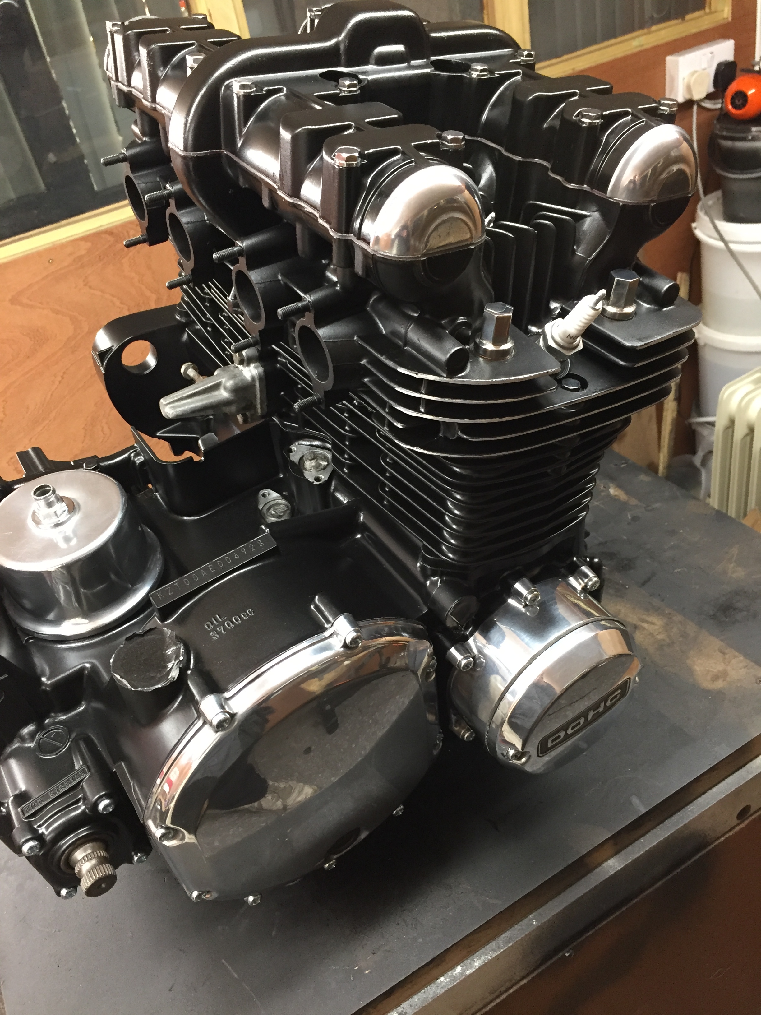

engine done, painted vht tough black, sump vapour blasted and covers polished up , clutch fine, no wear on bores or pistons, gave bores a slight hone , rings perfect -no blow back on pistons at all
Will also note that all inlet and exhaust ports were filled with petrol
and left to stand on each side so that the valves were holding a vertical column of petrol no weeping at all after 2 mins , one had a slight mark after that period so pretty satisfied that there are no problems there

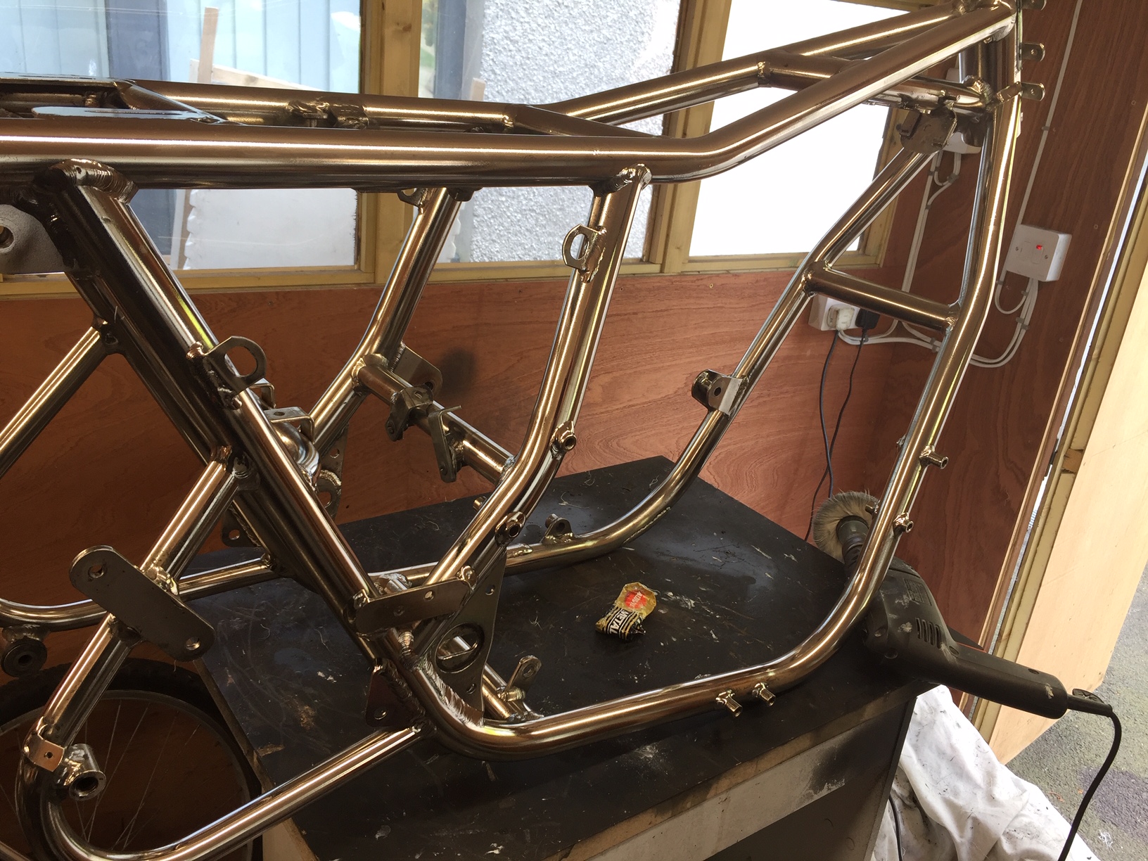

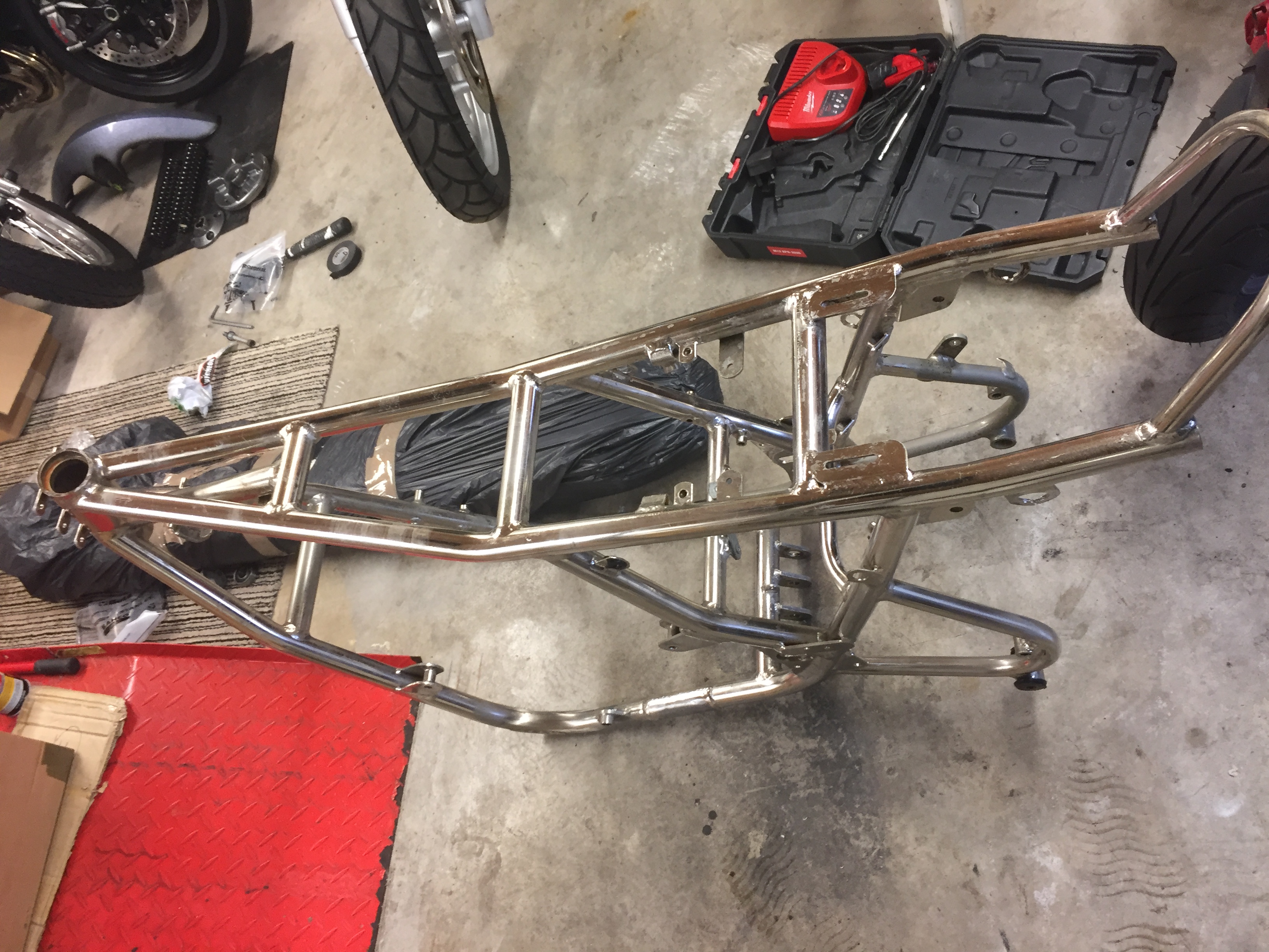

frame paint stripped 4 times.. and I will have a go machine polishing the frame with a drill and buffs, it looks shiny in the photo but not so great at this point in real life as I've tested a down tube and it came up really well- and use a nickel plate for the repair where the side stand was cut off

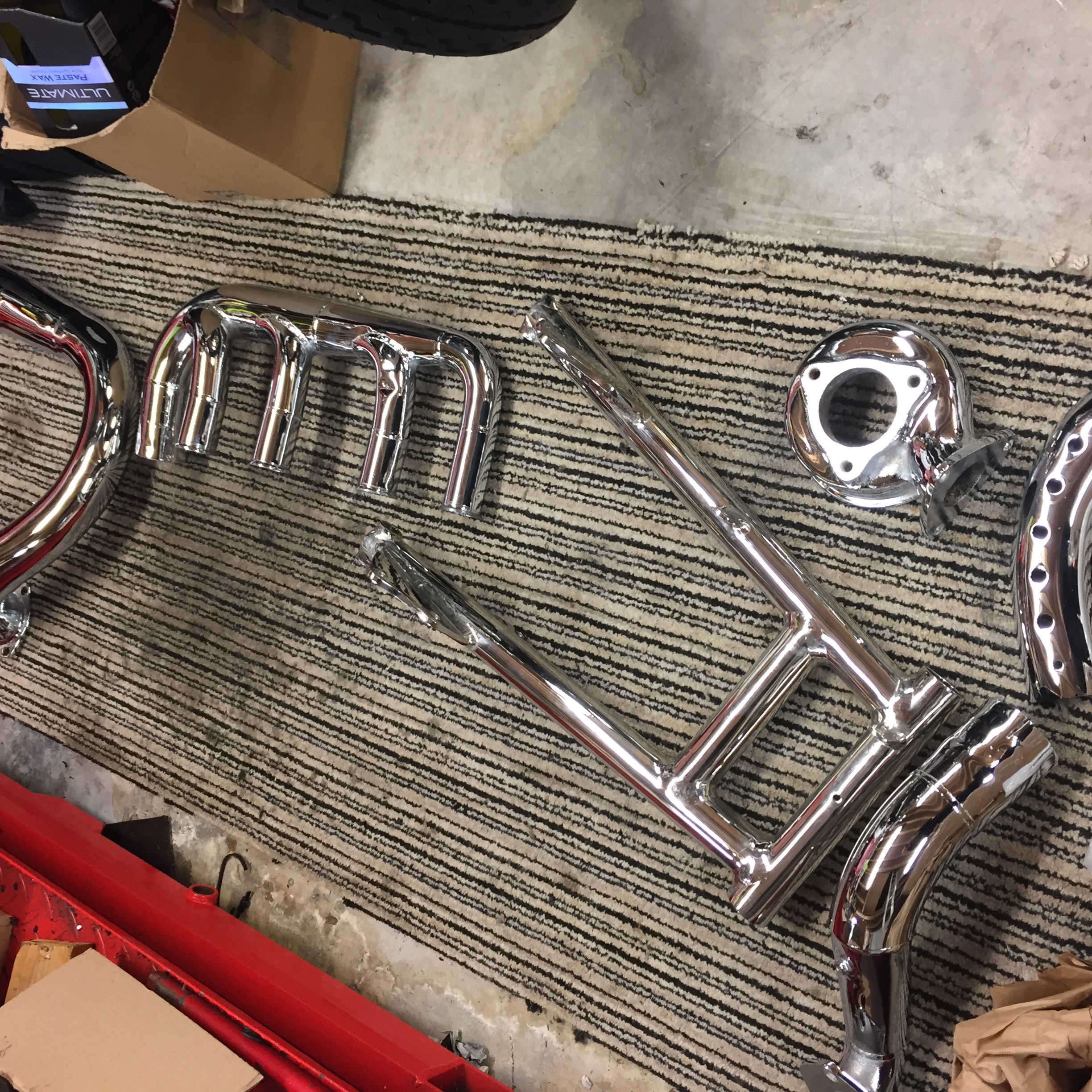

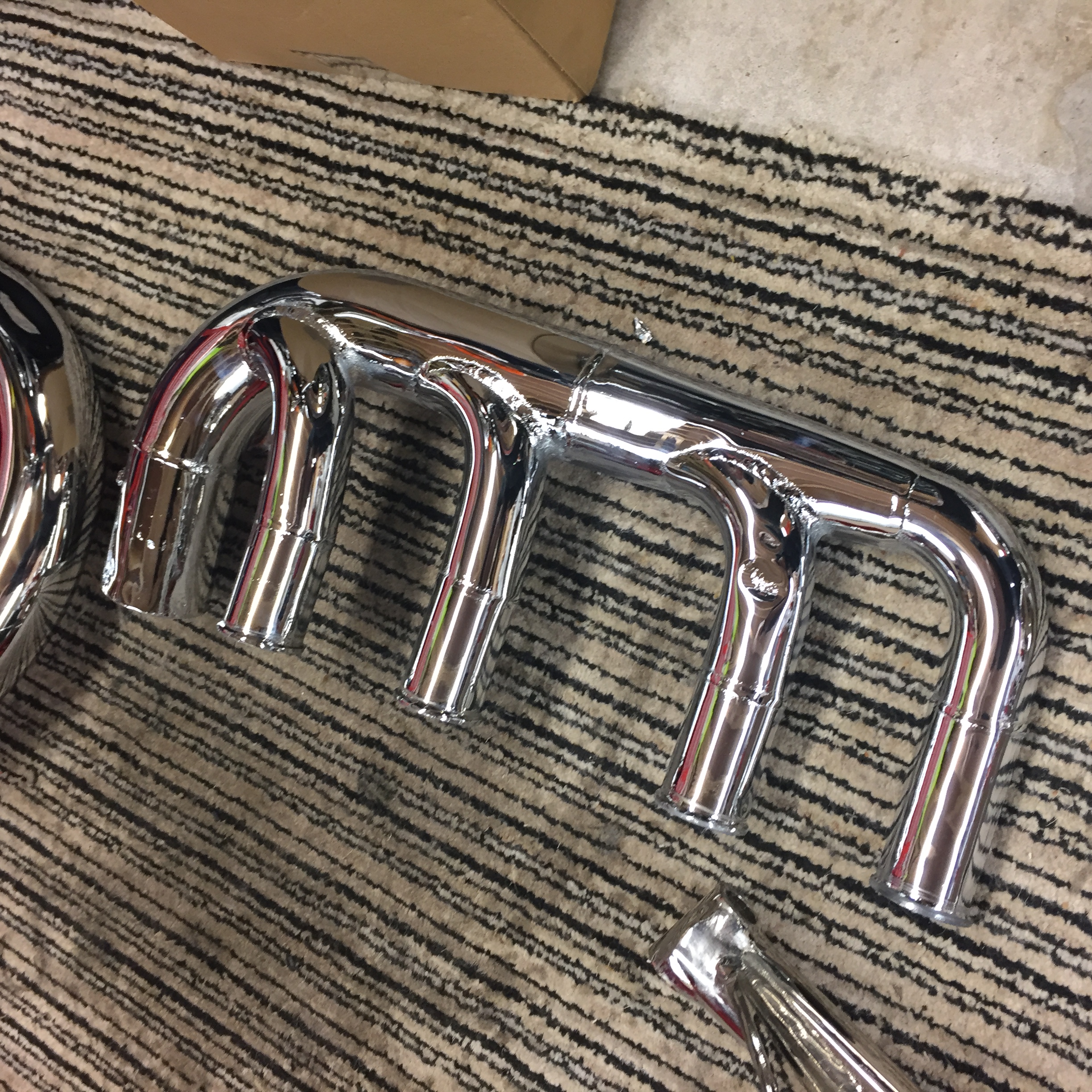

got springs from rear girling units back from powder coaters , in black as original, so will refinish shock, replated swinging arm and all chromed exhaust system, turbo housing (was chrome originally) due back in a few days time , Chrome and nickel £1k!

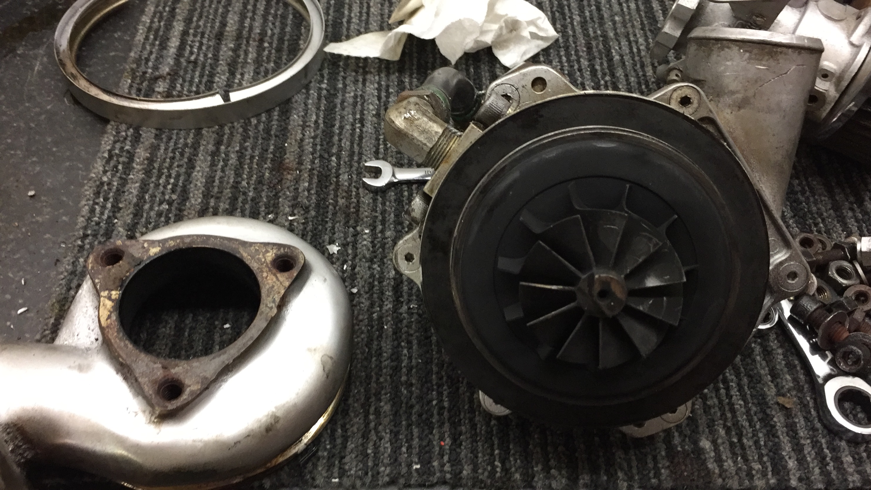

looking at the turbo wheels in the prototype rebuild manual , this looks like the same A flow turbine?
certainly not the smaller turbine, this wheel has the extension to the blade before it folds over which I dont think the smaller turbine has ?

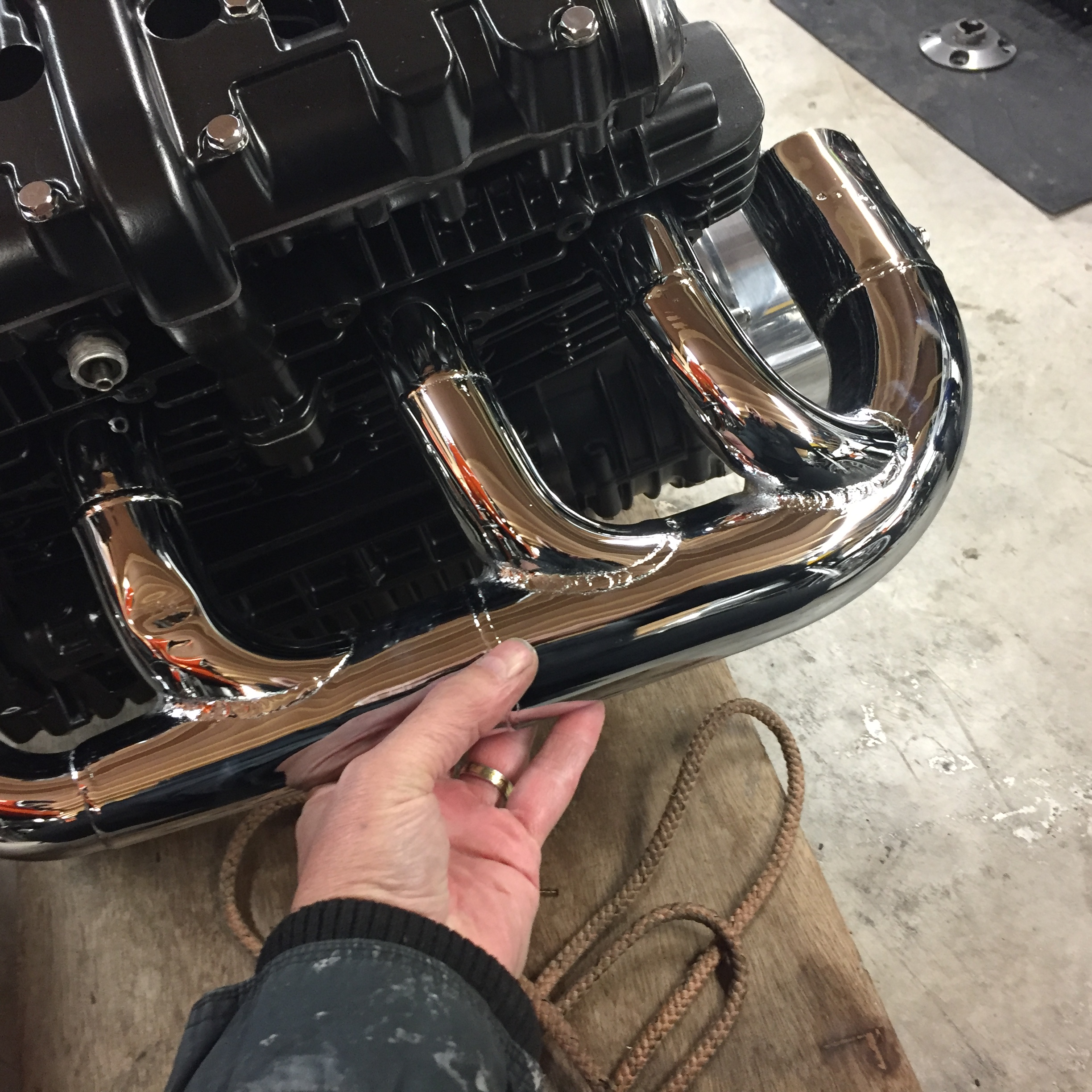

Some bling back,
, from Doug Taylor Bristol I’ve got some heat insulating paint for the exhaust inner face to stop blueing, frost sell it , can only go on clean metal so now is time to do it , will it work ? Log header is quite thin, re nickel on swinging arm looks awesome , so if frame doesn’t polish up it will get same treatment, so that would add 2 months to build and another 1k

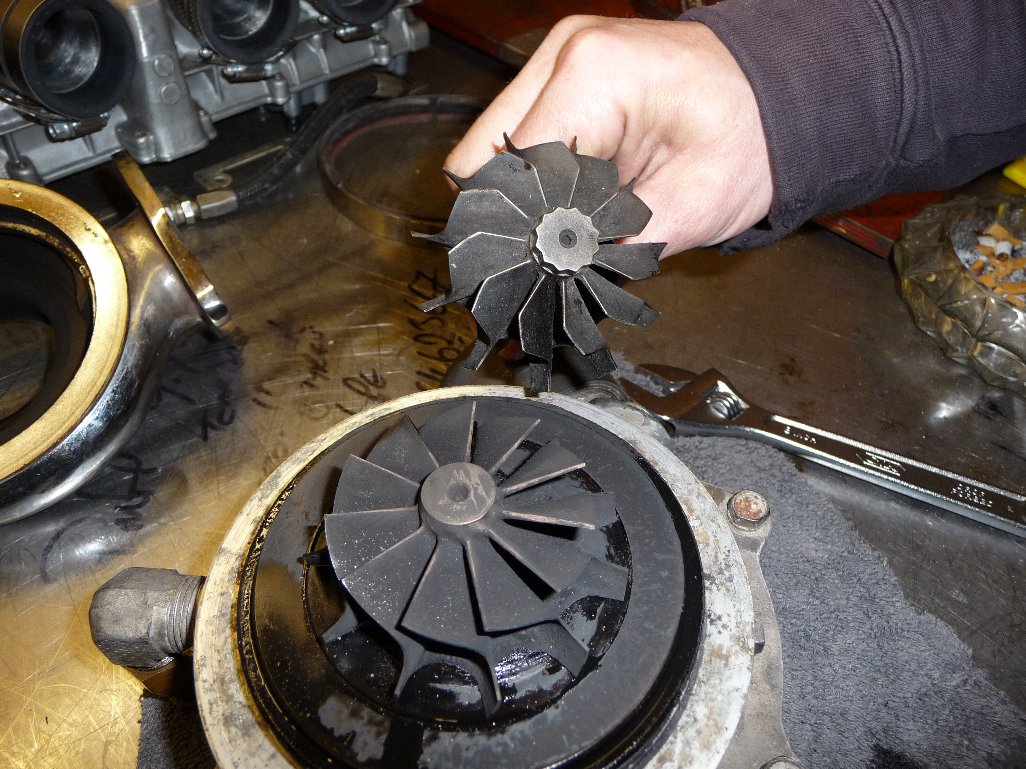

Ray, the one in yours is the F-flow. I got them the wrong way round in the manual.
The A-flow has cutaways like the one in my hand!

If that turbo is going to get any proper use I would seriously consider replacing the pressed turbine heat shield with a solid one.
The pressed ones tend to warp and rub on the back of the turbine which eventually destroys them and the excess heat generated by the friction is not good for the shaft and centre bush.
It looks like the one in Wills pic might already have one fitted.
The centre bushes are like hens teeth to find and the turbo is practically scrap once they are past their wear limit.

RAYZ1 wrote:Some bling back,, from Doug Taylor Bristol I’ve got some heat insulating paint for the exhaust inner face to stop blueing, frost sell it , can only go on clean metal so now is time to do it , will it work ? Log header is quite thin, re nickel on swinging arm looks awesome , so if frame doesn’t polish up it will get same treatment, so that would add 2 months to build and another 1k
Heat resistant barbecue paint inside the headers helps stop blueing, believe it or not.

on turbo headers them pipes will glow red in the dark .ive had freshly chromed pipes blister with the heat.could of been falty jpb
Re: S&S Silver Saxon #8
neilbarrett wrote:on turbo headers them pipes will glow red in the dark .ive had freshly chromed pipes blister with the heat.could of been falty jpb
Absolutely, on my z1b I coated my headers with bbq paint and then old engine oil after drying out , old engine oil is s classic car trick for headers on big block Chevys etc to stop or reduce manifold blueing , in this case went for special 1800 deg paint designed for the job , not cheap , but neither is chroming , I will treat s new 4-4 with it as well

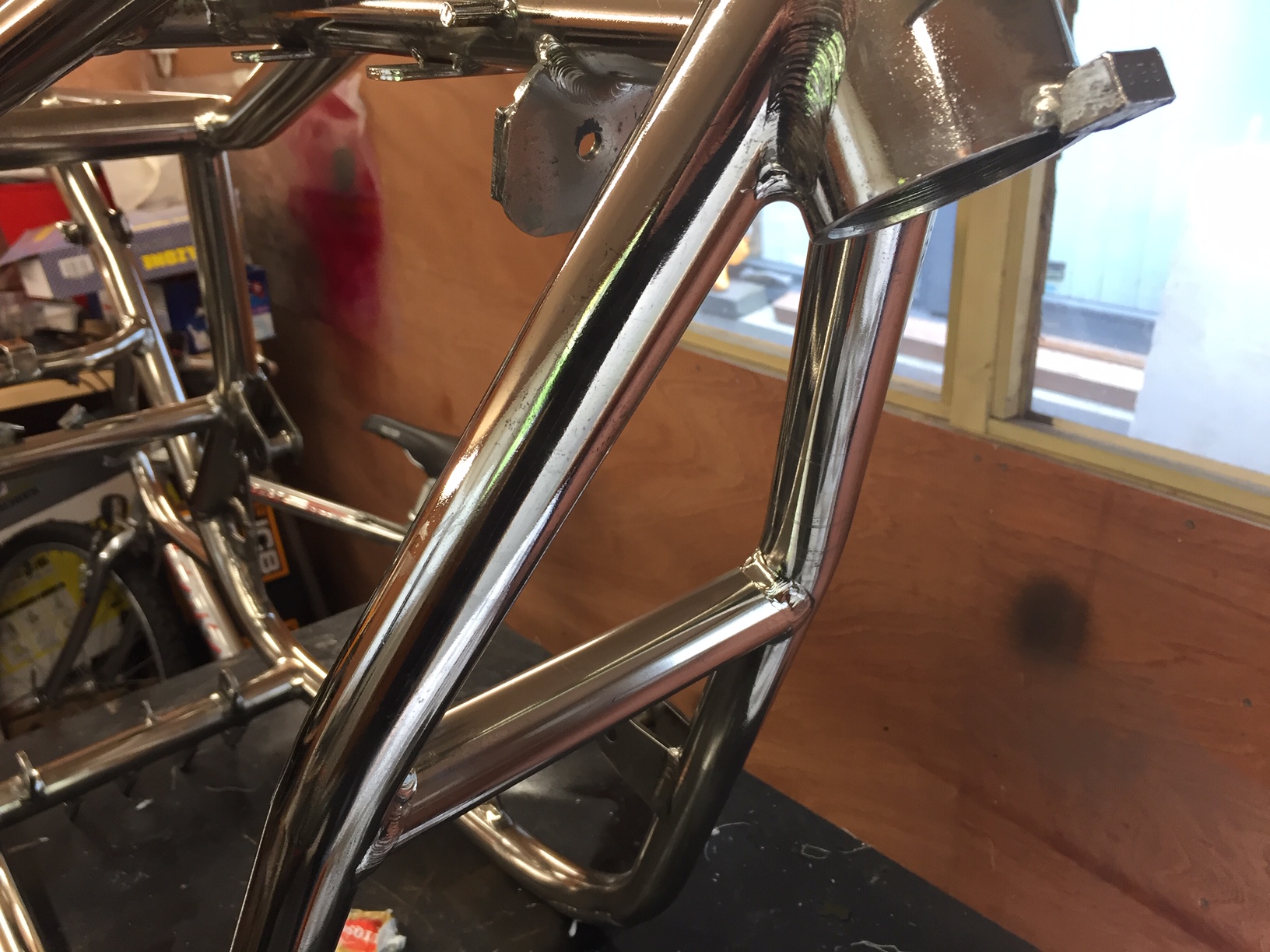

, Bit of a break in work , but stole some time , after 4 paint strips and 7 hours machine polishing is now helping to return the frame to a decent state, there are a couple of areas I will touch up the nickel with a wand plate kit , notably where the hole from the side stand has been plated over
I think 2 or 3 hours more and it should be ok to build up. The S/A is replated as there was so much rust under the plating from stone chipping , the frame was relatively free but heavily oxidised, much harder than alloy oxidation , just all the brackets to do now and re-galv the engine bolts, If the frame hadnt come up so well I would have re plated , but I have seen replated rickman frames , inc my S/A, no matter what you say they buff out the beautiful brazing work so its flat , and Im not in a hurry to acid dip the frame to remove the old nickel
