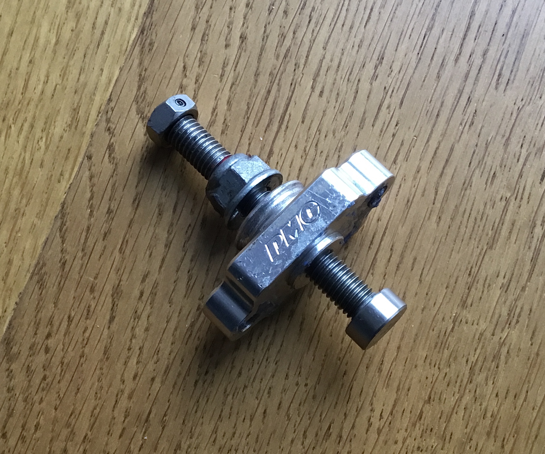

This was the cam chain adjuster on my engine.you guys know anything about these? Any good?, no good? Is it better to return to std one? Shouldn’t there be some sort of plastic/ rubber end piece that presses against the chain?
FOZ1A
Posts: 302
Joined: 21st Oct 2003
Location: surrey
Re: Z1000A project
#17 PostAuthor: FOZ1A » Mon Jan 25, 2021 3:59 pm
That is how its supposed to be, dont go back to standard.
foz
Posts: 4034
Re: Z1000A project
#18 PostAuthor: zed1015 » Mon Jan 25, 2021 4:09 pm
Manual tensioner, best thing you can have.
Can't back off under any circumstance.
It pushes against the tensioner roller, not direct on the chain.
Need to adjust carefully so as not to over tension the chain.
It's a simple procedure once you know how.
Best done with cam cover off on initial install.

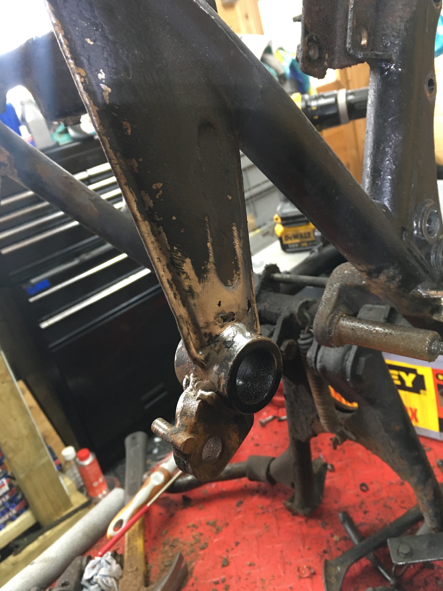

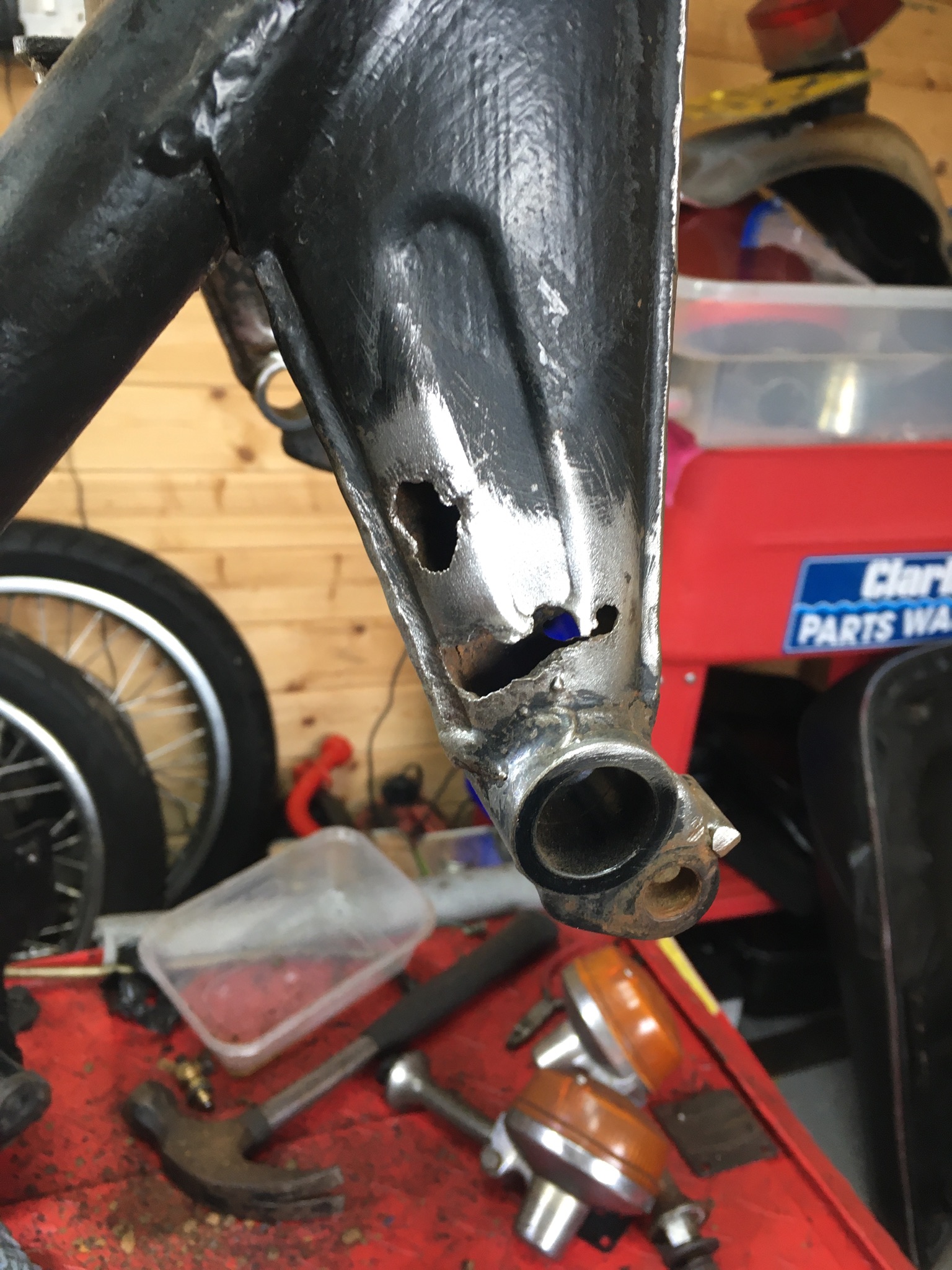

#22 PostAuthor: Johno23 » Tue Feb 16, 2021 4:56 pm

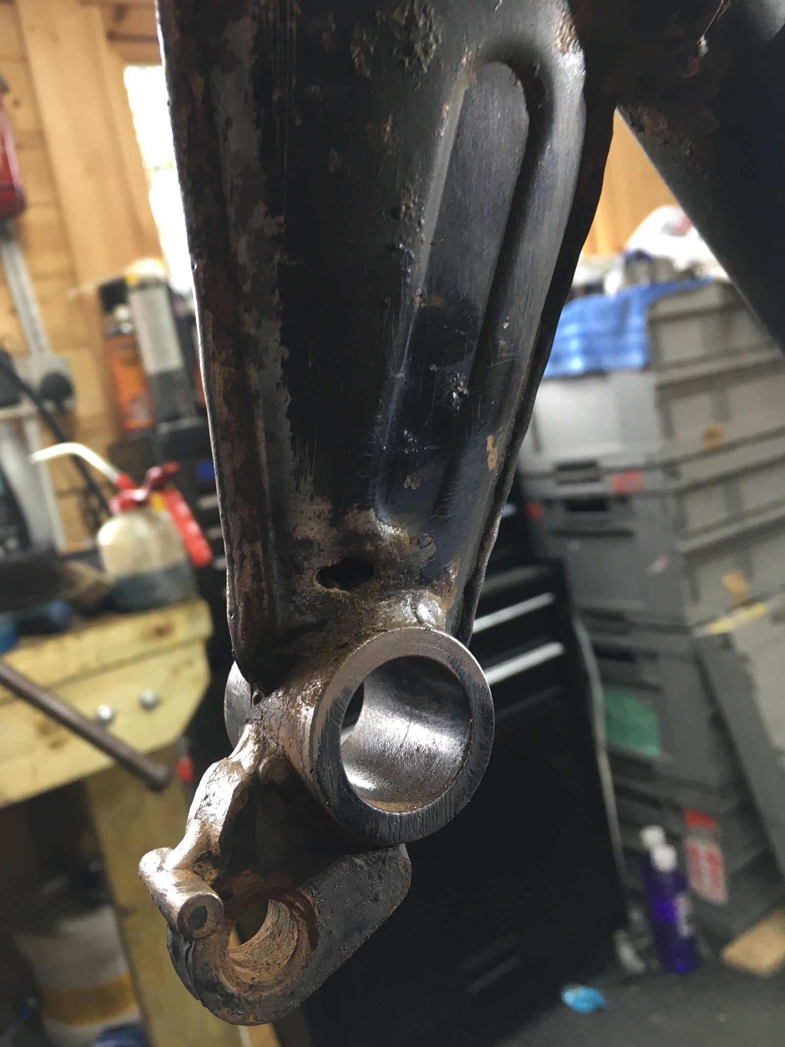

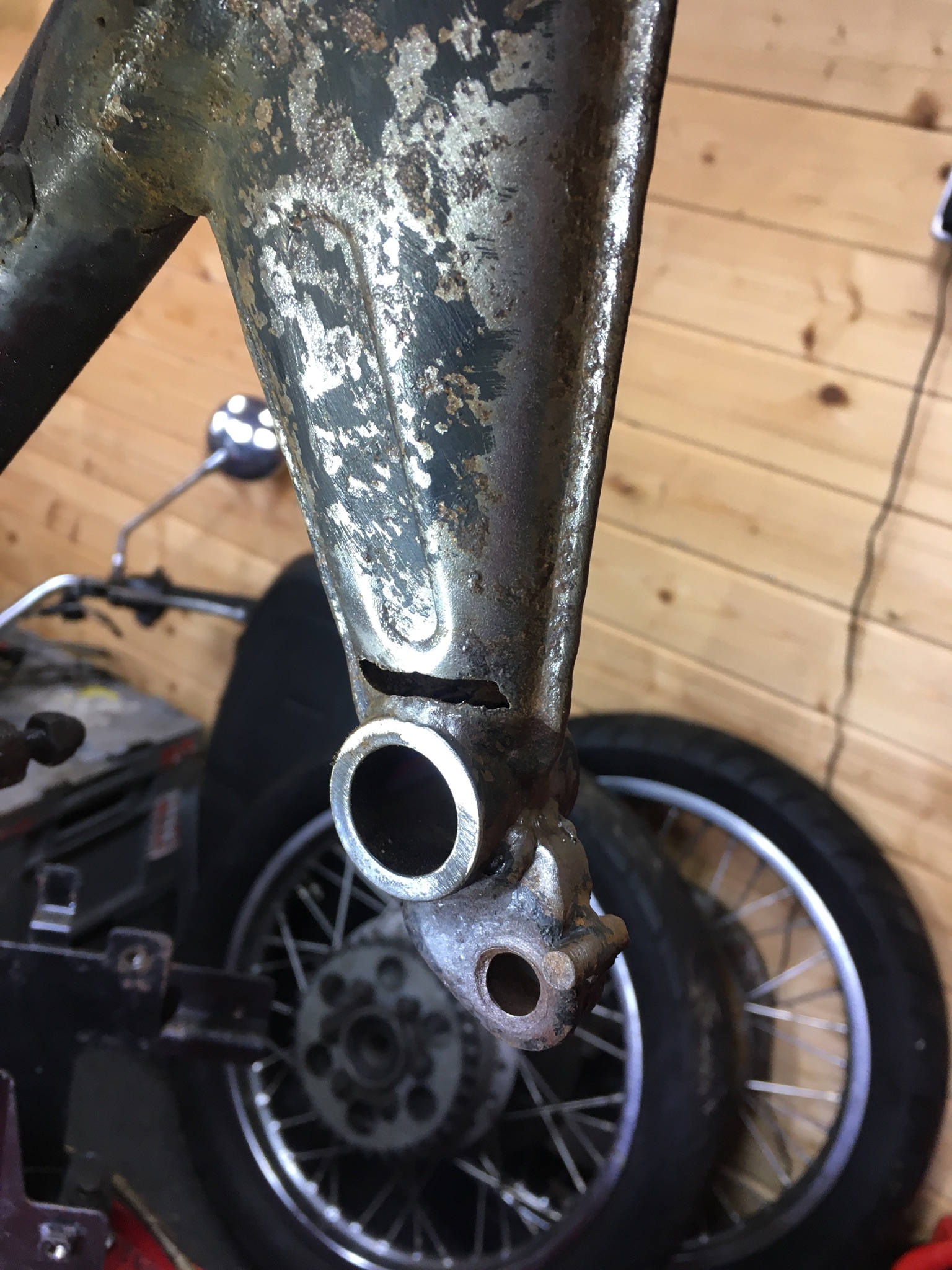

Guys, what’s the best way to sort this out?
DavidZ1R
Posts: 1513
Location: Bolton Lancs
Re: Z1000A project

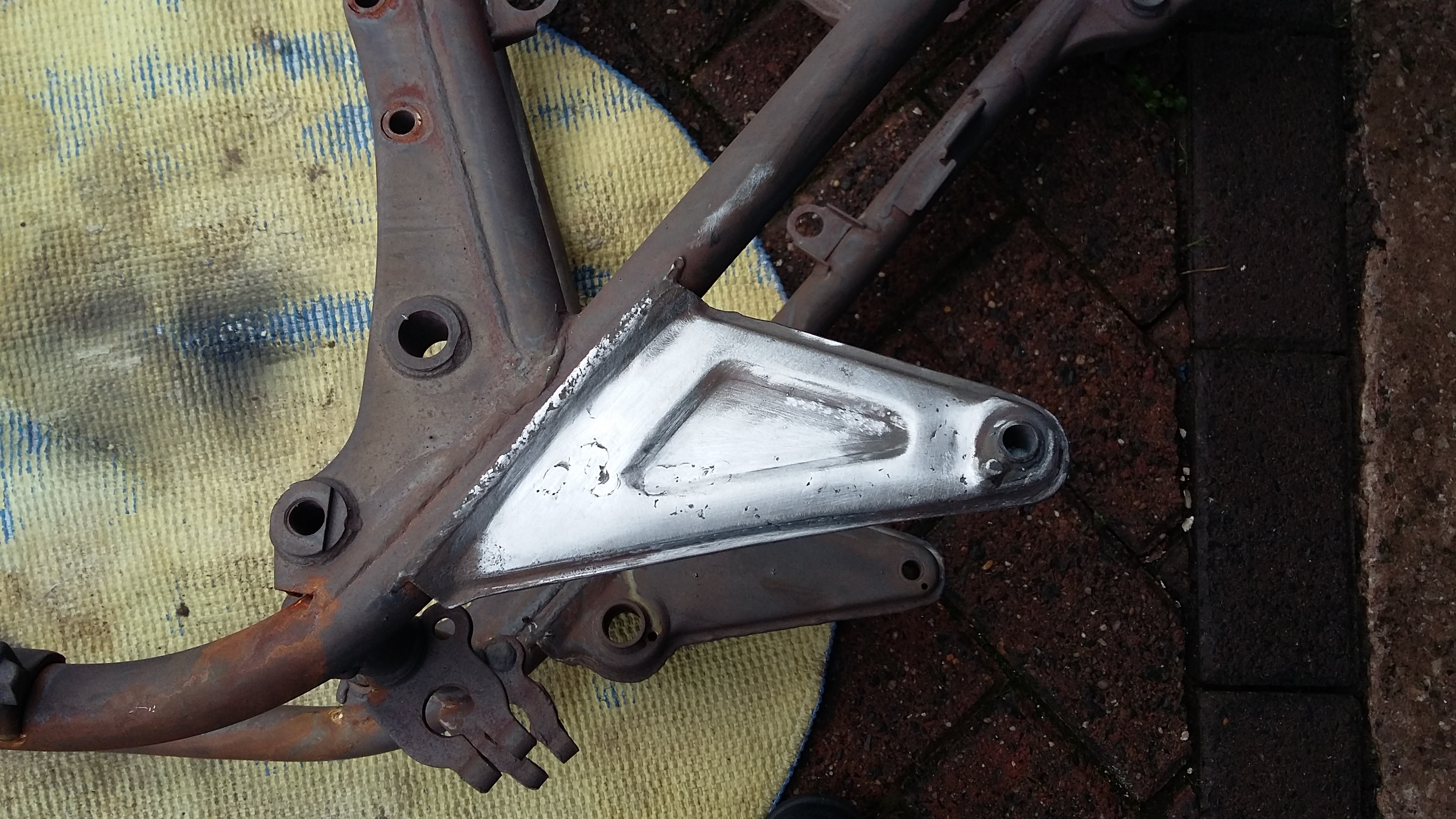

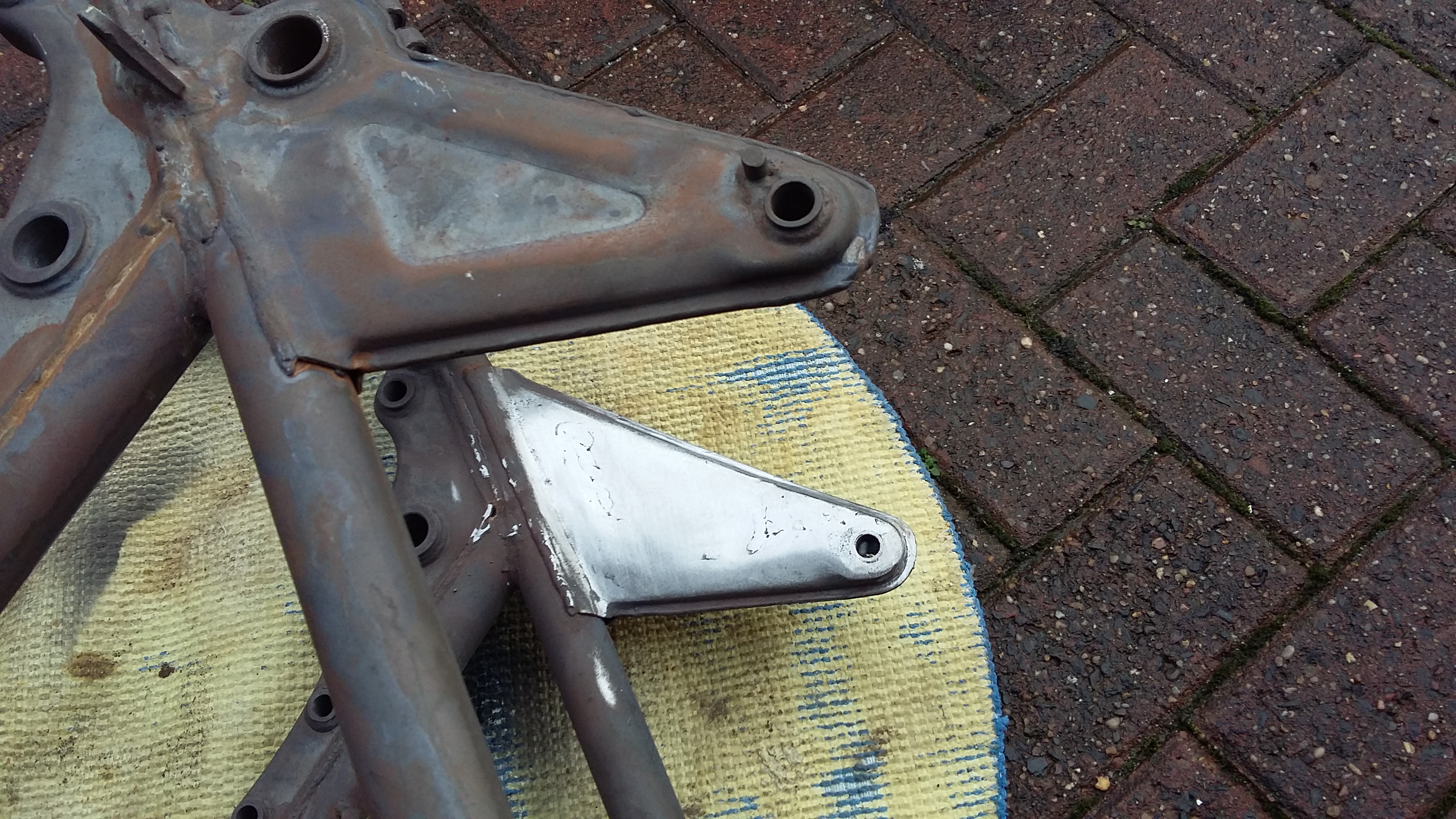

#23 PostAuthor: DavidZ1R » Tue Feb 16, 2021 5:09 pm
I had the same on my z650, a local garage guy opened up the hanger from the back welded up a plate, filled the holes up, re weld a plate on the back, ground down, you would never know

#24 PostAuthor: Johno23 » Tue Feb 16, 2021 6:14 pm
Looks good! :D I’ll hunt out a welder..........cheers.

#25 PostAuthor: Mr Bump » Tue Feb 16, 2021 8:12 pm
Might it be worth getting the whole thing sand blasted before you take it to the welder, just in case there's any more horrors?
Unlikely, but you'll be cussing if you have to take it back to the welder for a second go.

#26 PostAuthor: Johno23 » Thu Feb 18, 2021 11:44 am
Mr Bump wrote:Might it be worth getting the whole thing sand blasted before you take it to the welder, just in case there's any more horrors?
Olly
Cheers, yes I might do that. Although it does look pretty solid everywhere else.

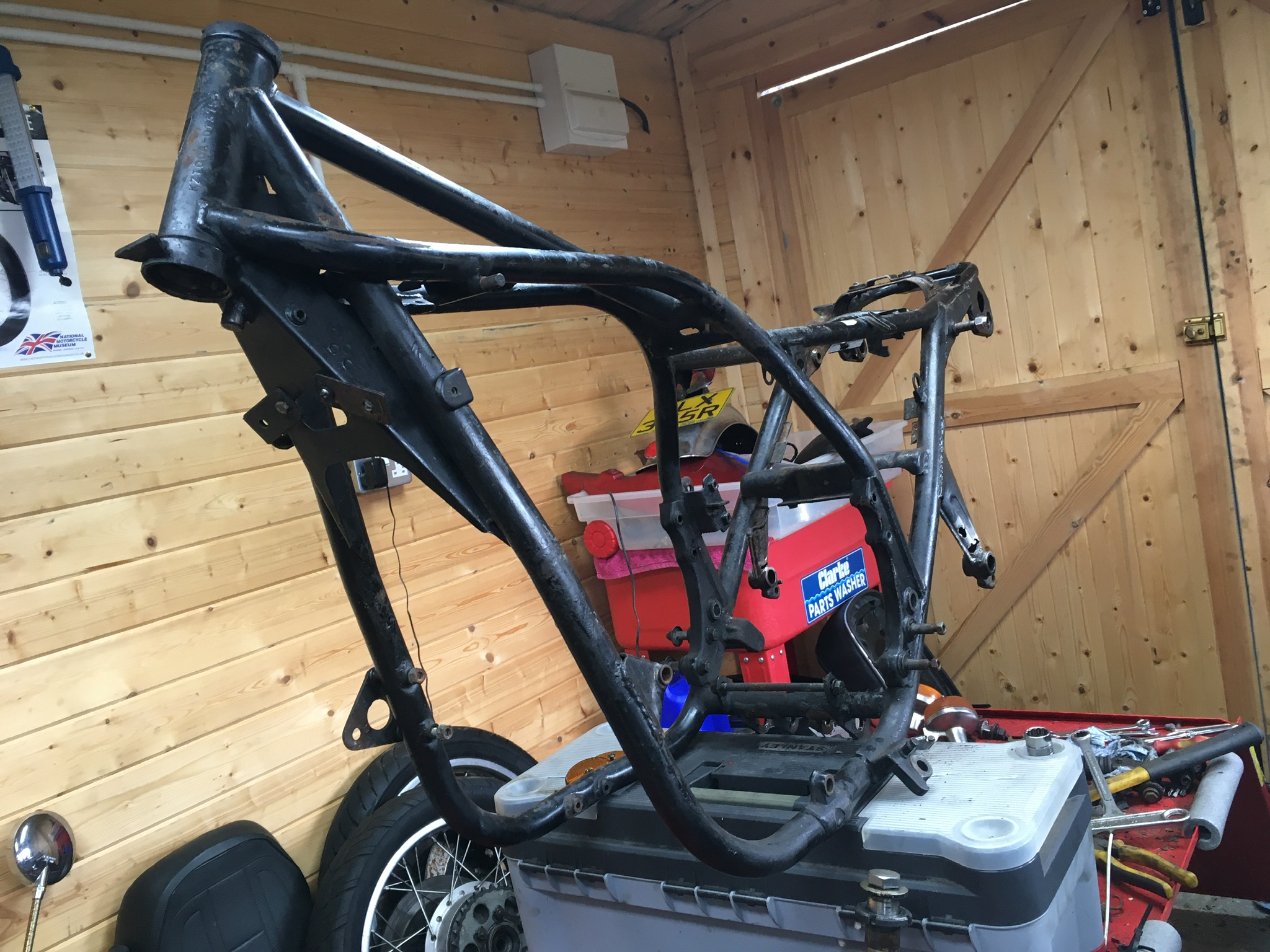

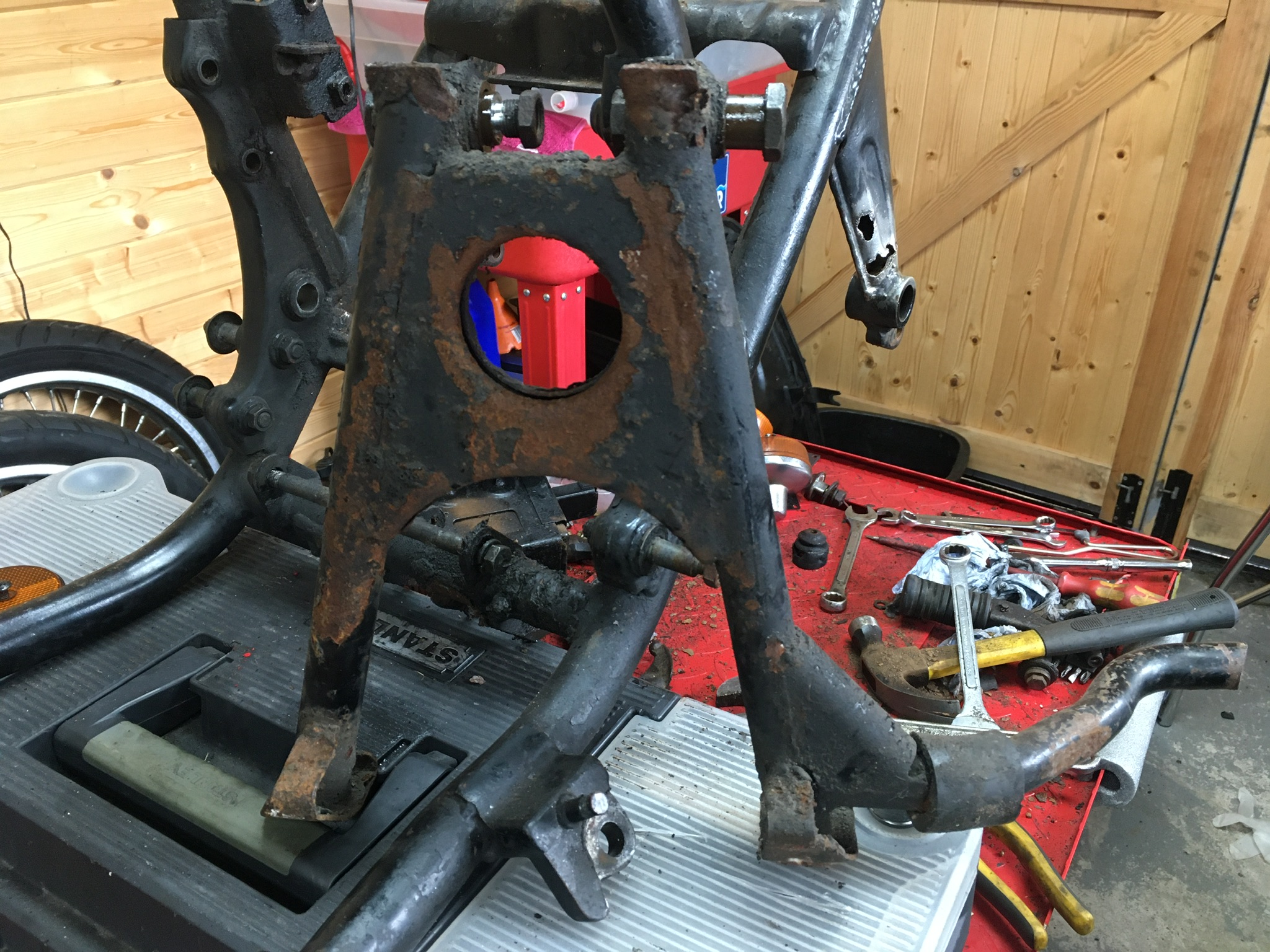

#27 PostAuthor: Johno23 » Sat Feb 20, 2021 8:59 am

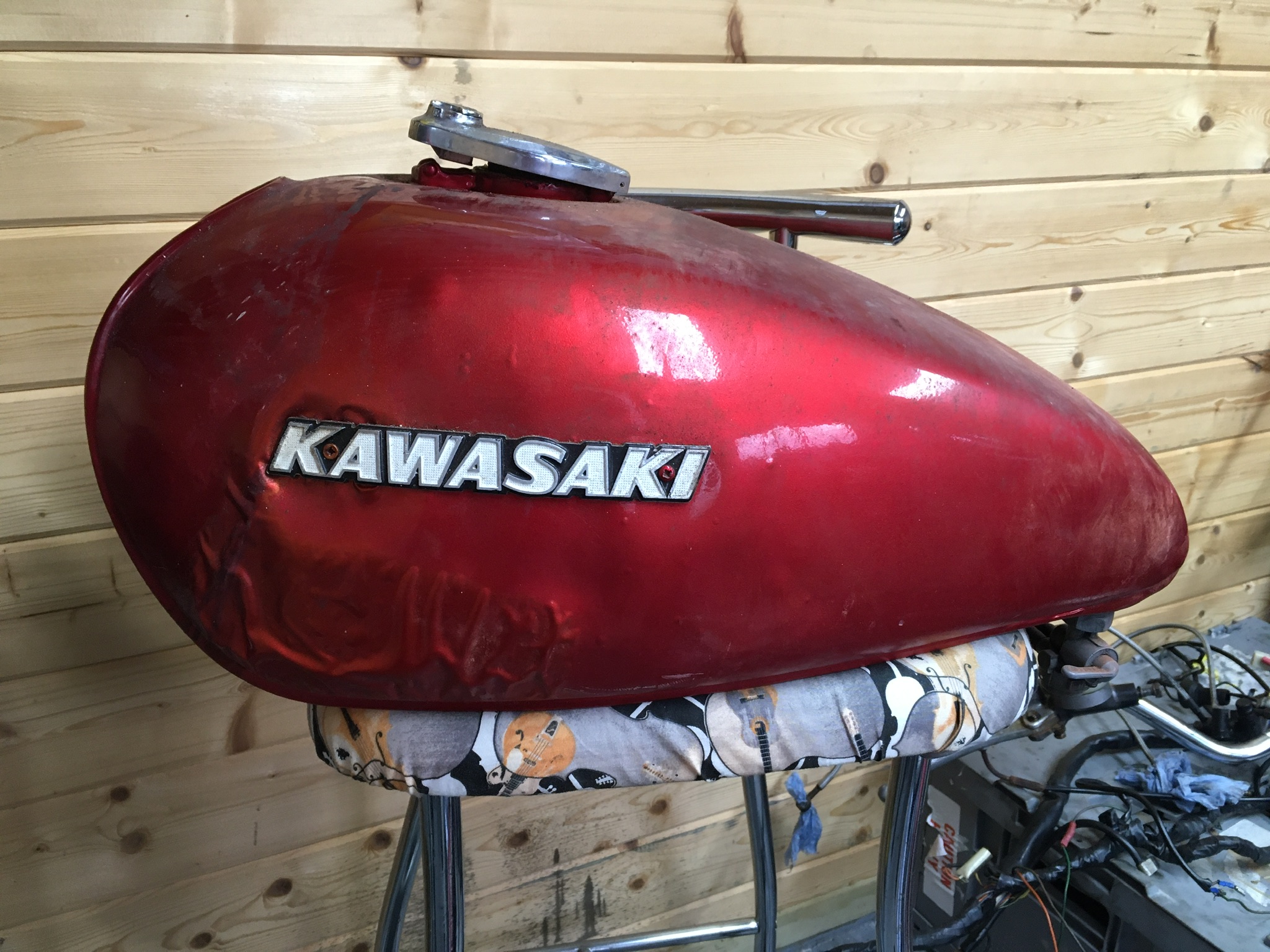

Well, I found a welder who can do it :D so have now dropped frame off to him, should get it back end of next week with a bit of luck.then off for powder coating. Main stand isn’t looking too good................. or the tank! :(
