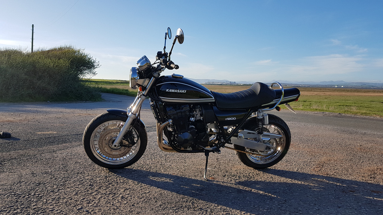

I had it in mind to fit the B12 forks with the DL offset yokes to mine, but tried just the Bandit wheel in the standard forks and I like it, gives it more of a period look I think. and it still handles. i might fit the bandit front end down the line but i'm happy with it as is, it just sits nice and with the short LTD chrome mudguard :D

Hard Road wrote:I had it in mind to fit the B12 forks with the DL offset yokes to mine, but tried just the Bandit wheel in the standard forks and I like it, gives it more of a period look I think. and it still handles. i might fit the bandit front end down the line but i'm happy with it as is, it just sits nice and with the short LTD chrome mudguard :D
Real nice! i know ill be put on a hit list for saying it but the bandit 1200 front end looks like it belongs there, Gs1100E swing arm? same as whats on mine.

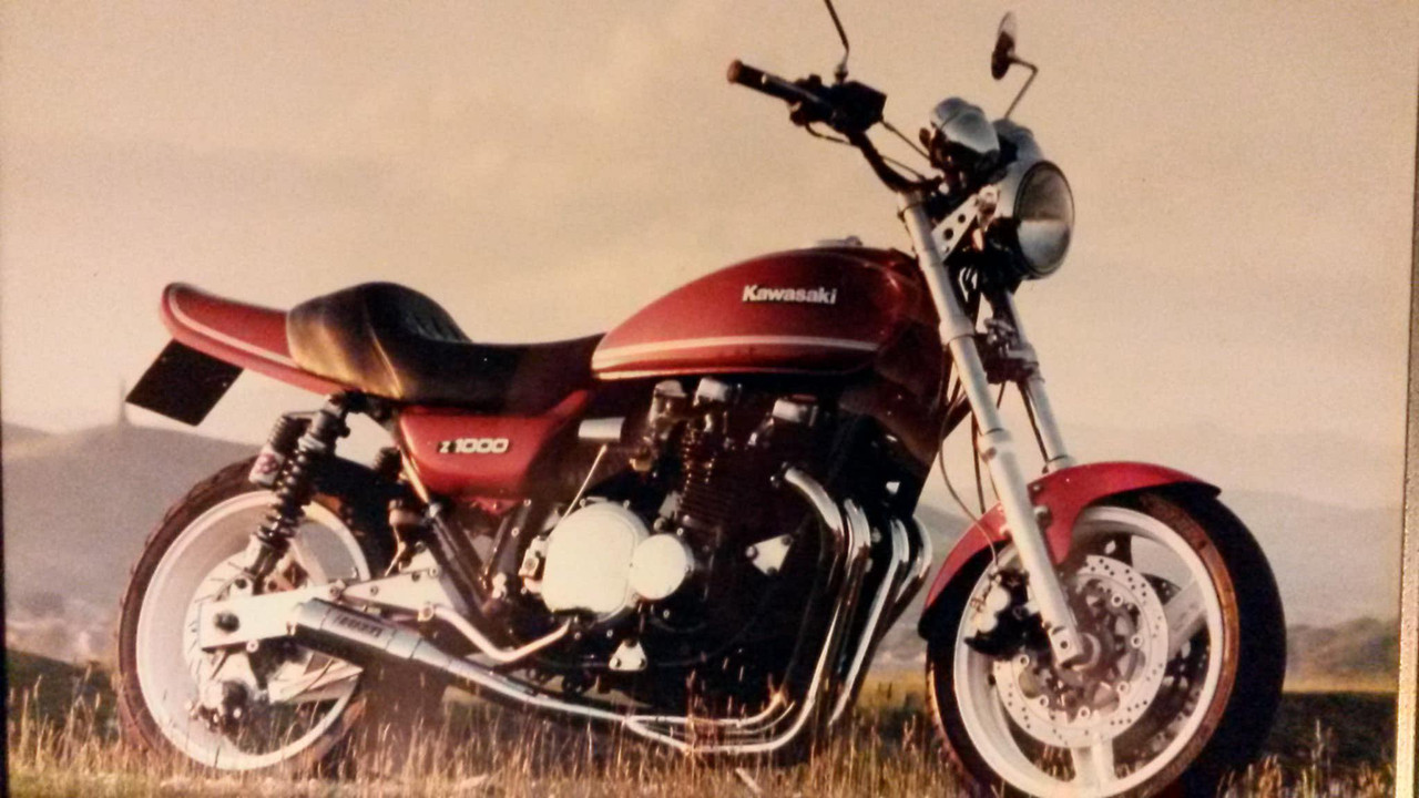

can you see a pattern with the colour scheme :oops:
but my first one was red :D

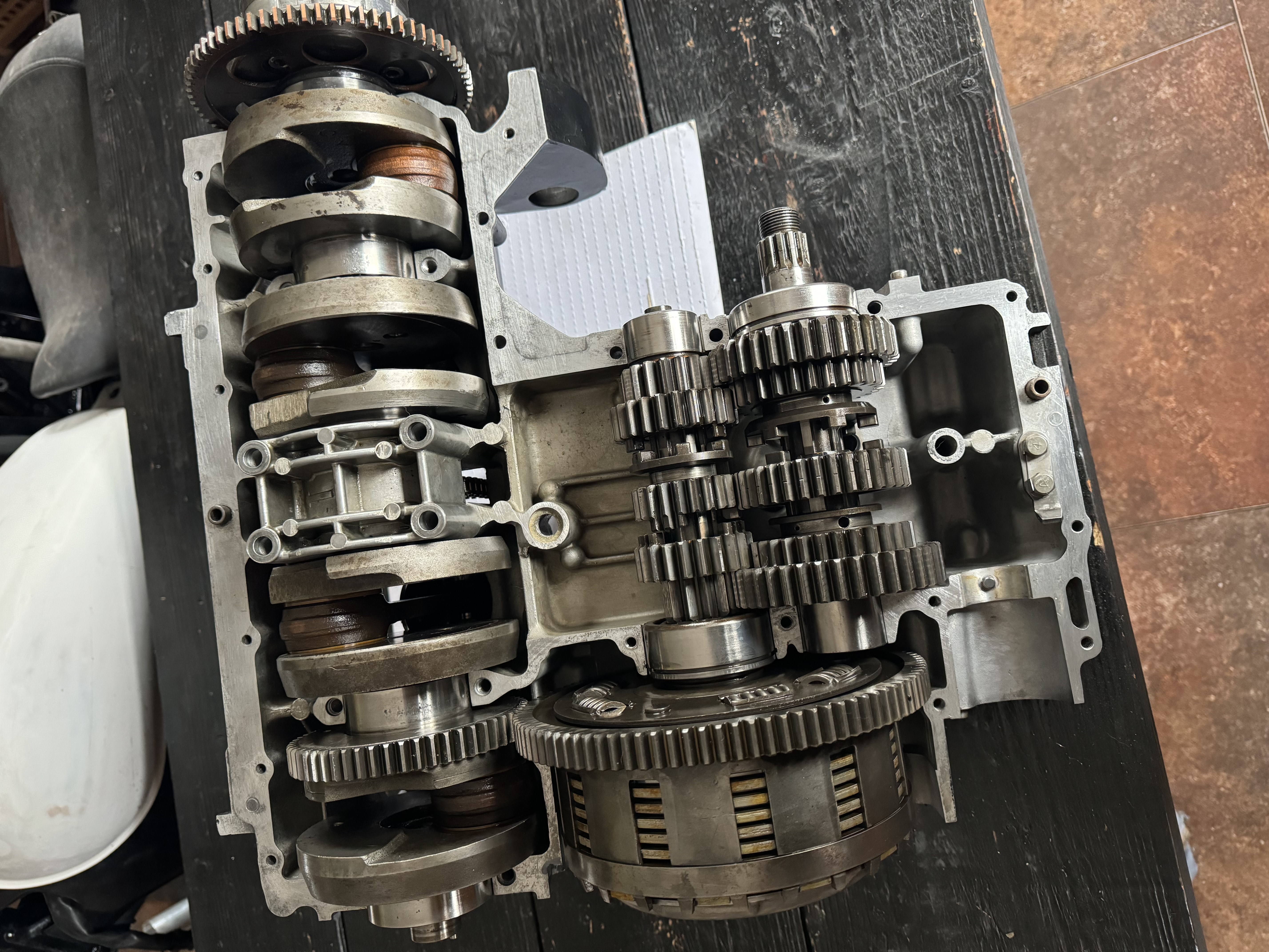

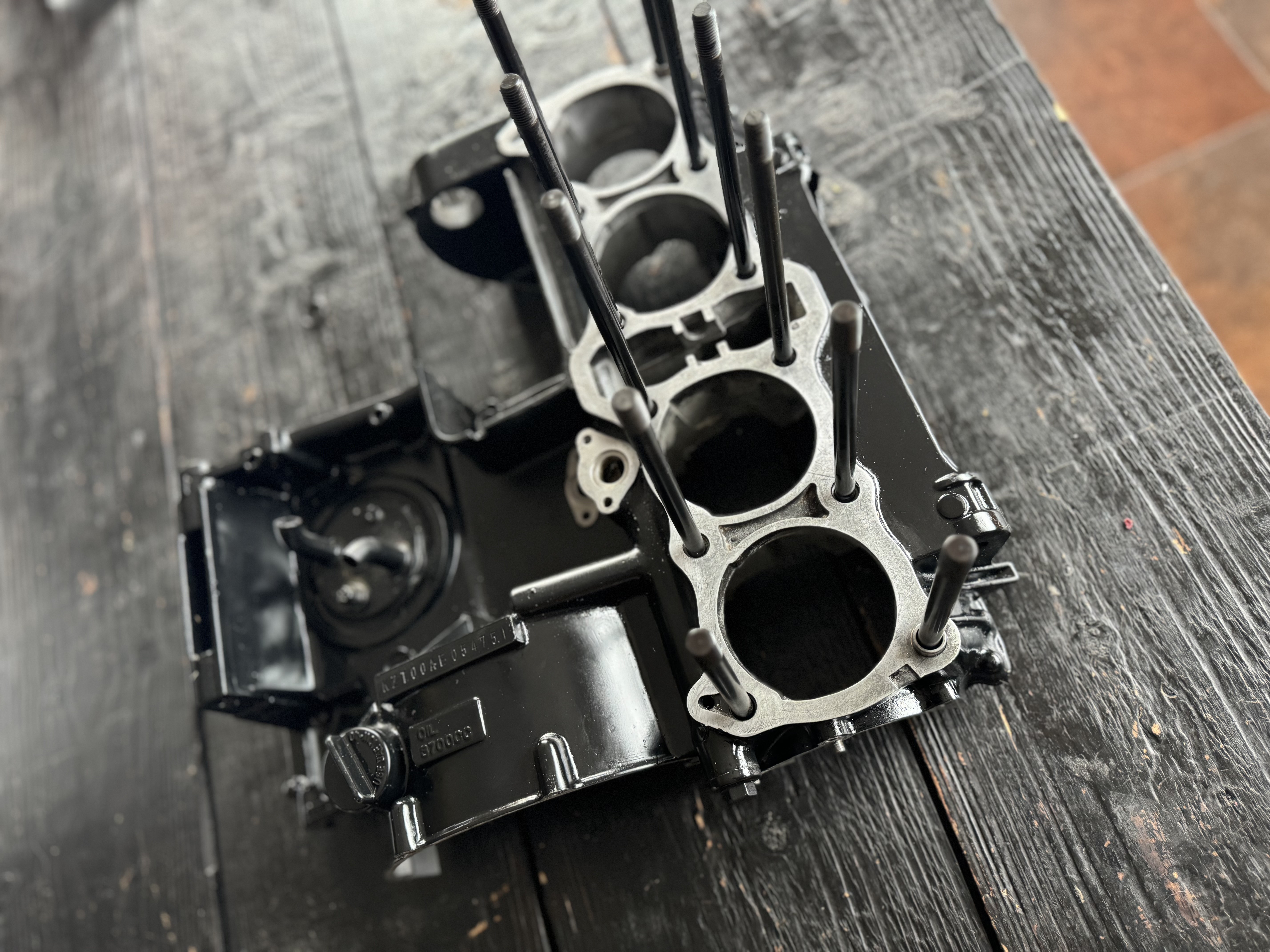

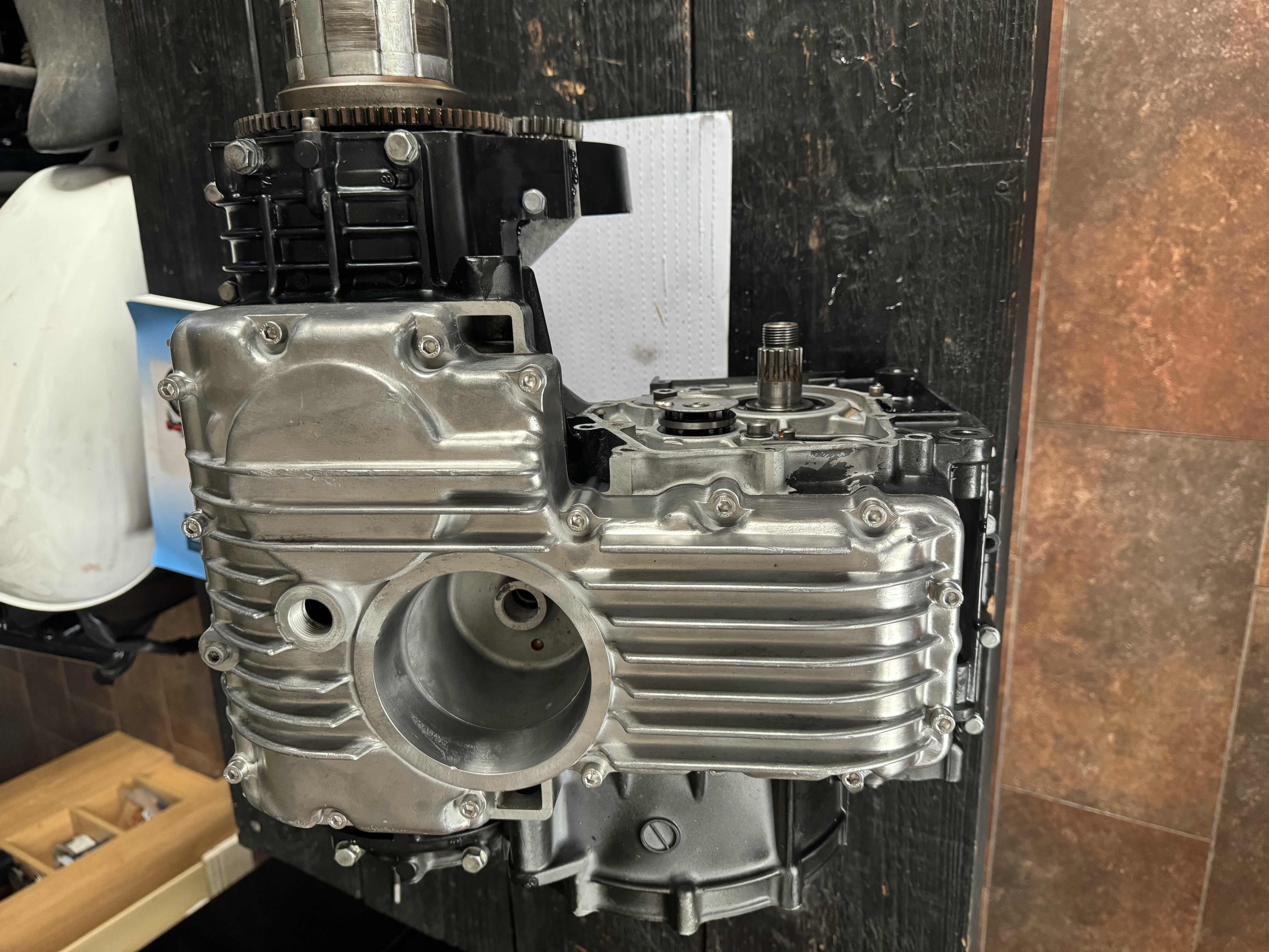

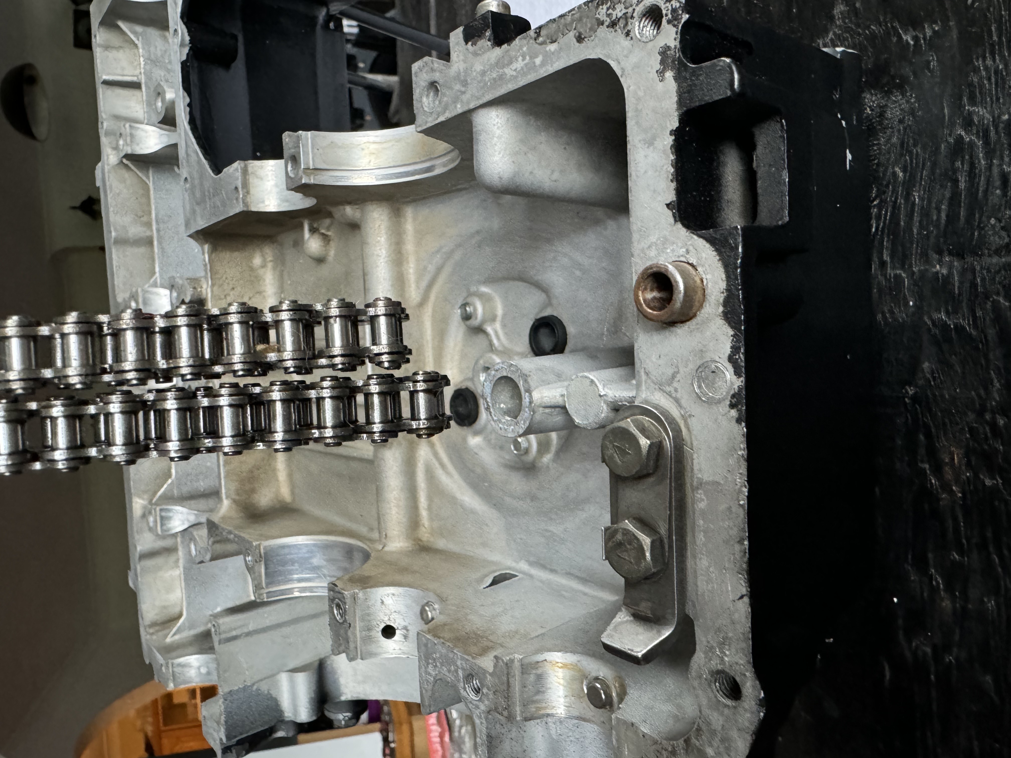

Bottom end rebuilt today, swapped the innerds of the 77 to 78 cases, APE heavy duty studs, new cam chain, o-rings etc. Everything was fine in the bottom end before the swap. Tomorrow engine in the frame and maybe get her back on her wheels.

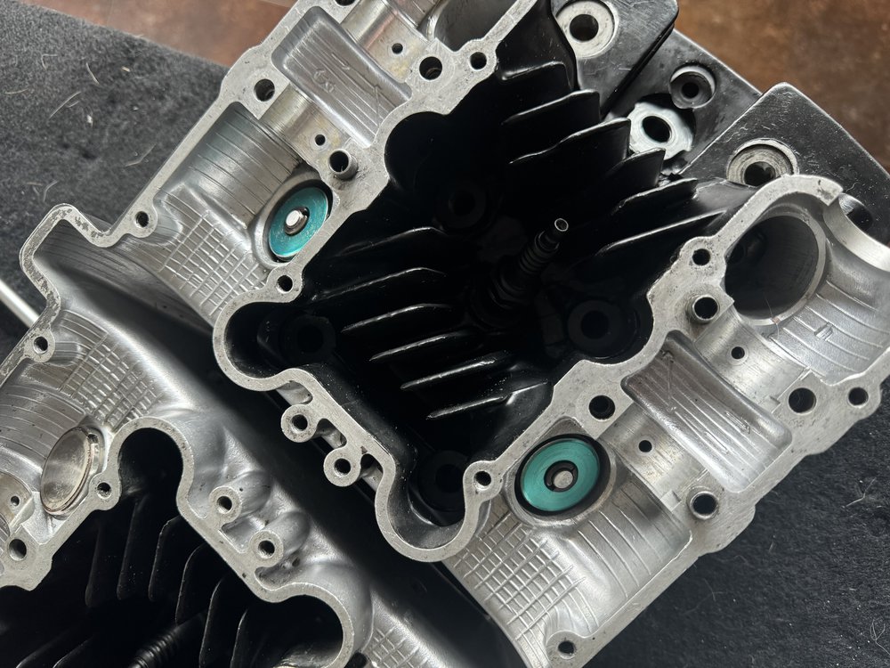

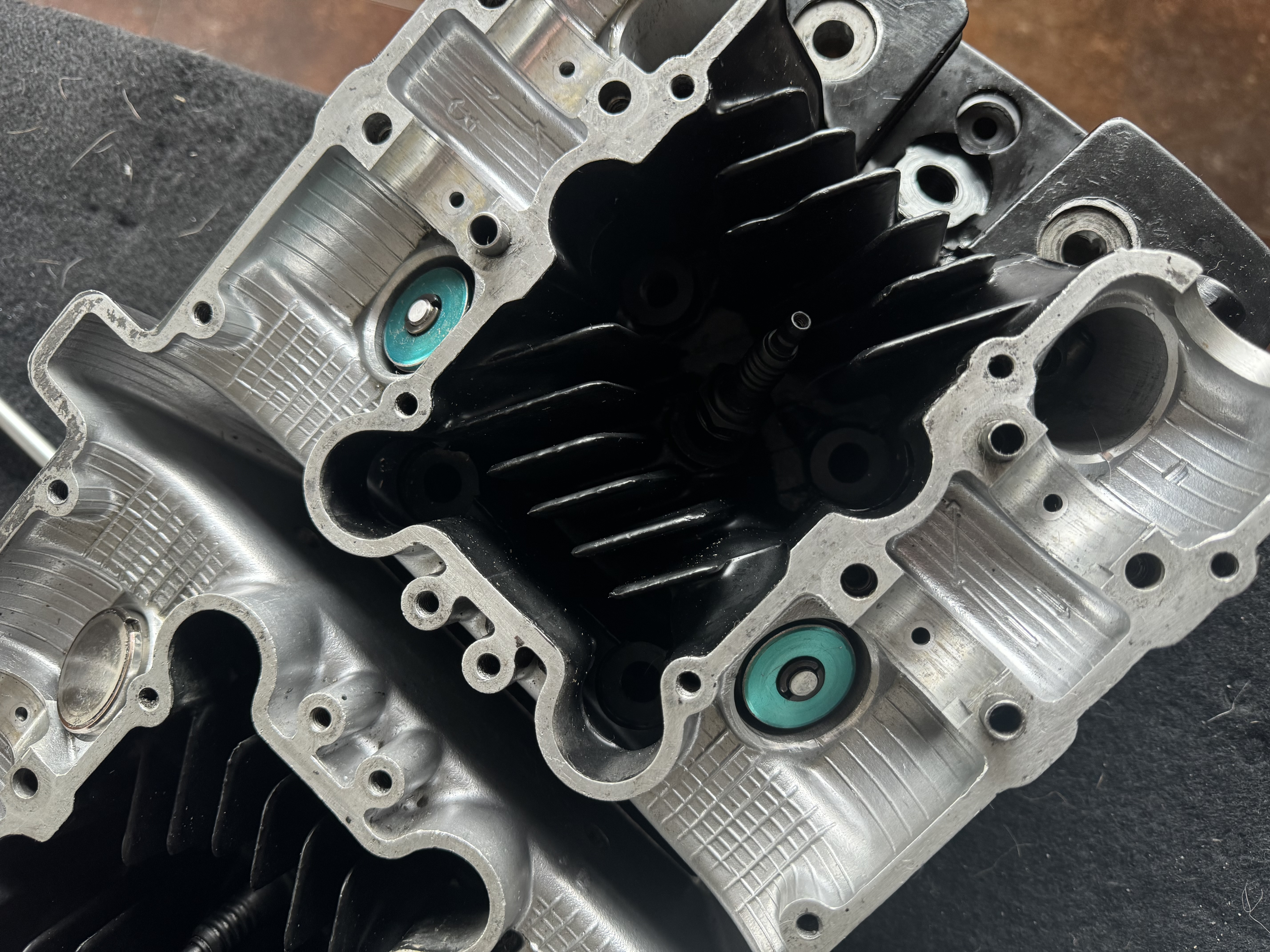

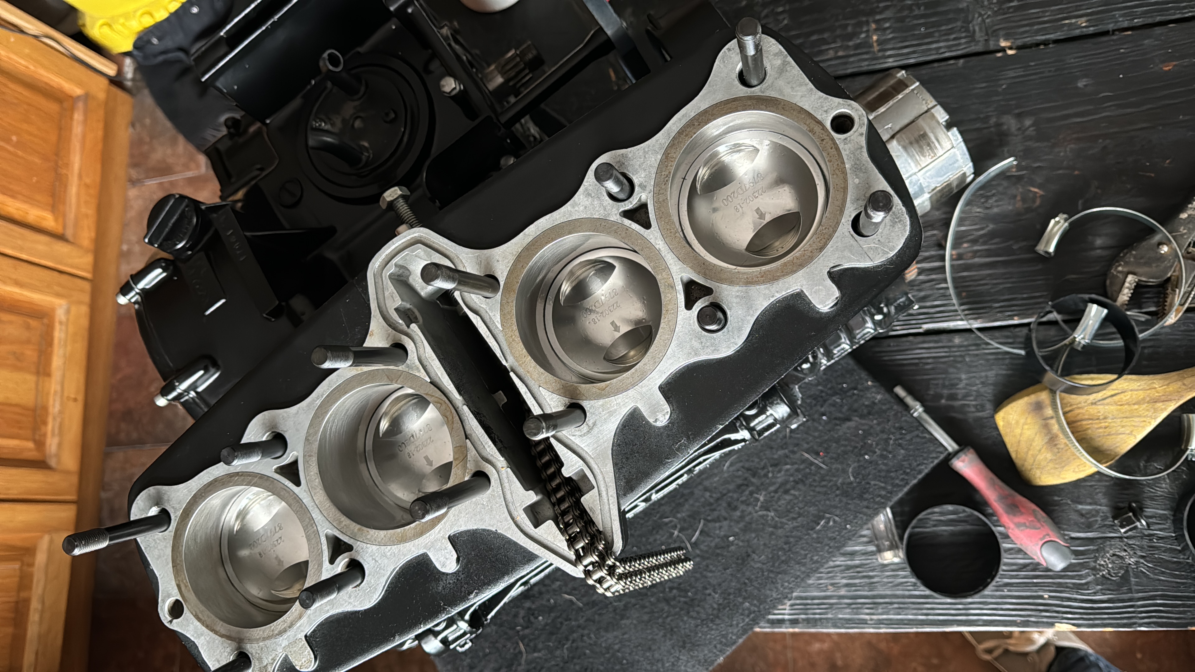

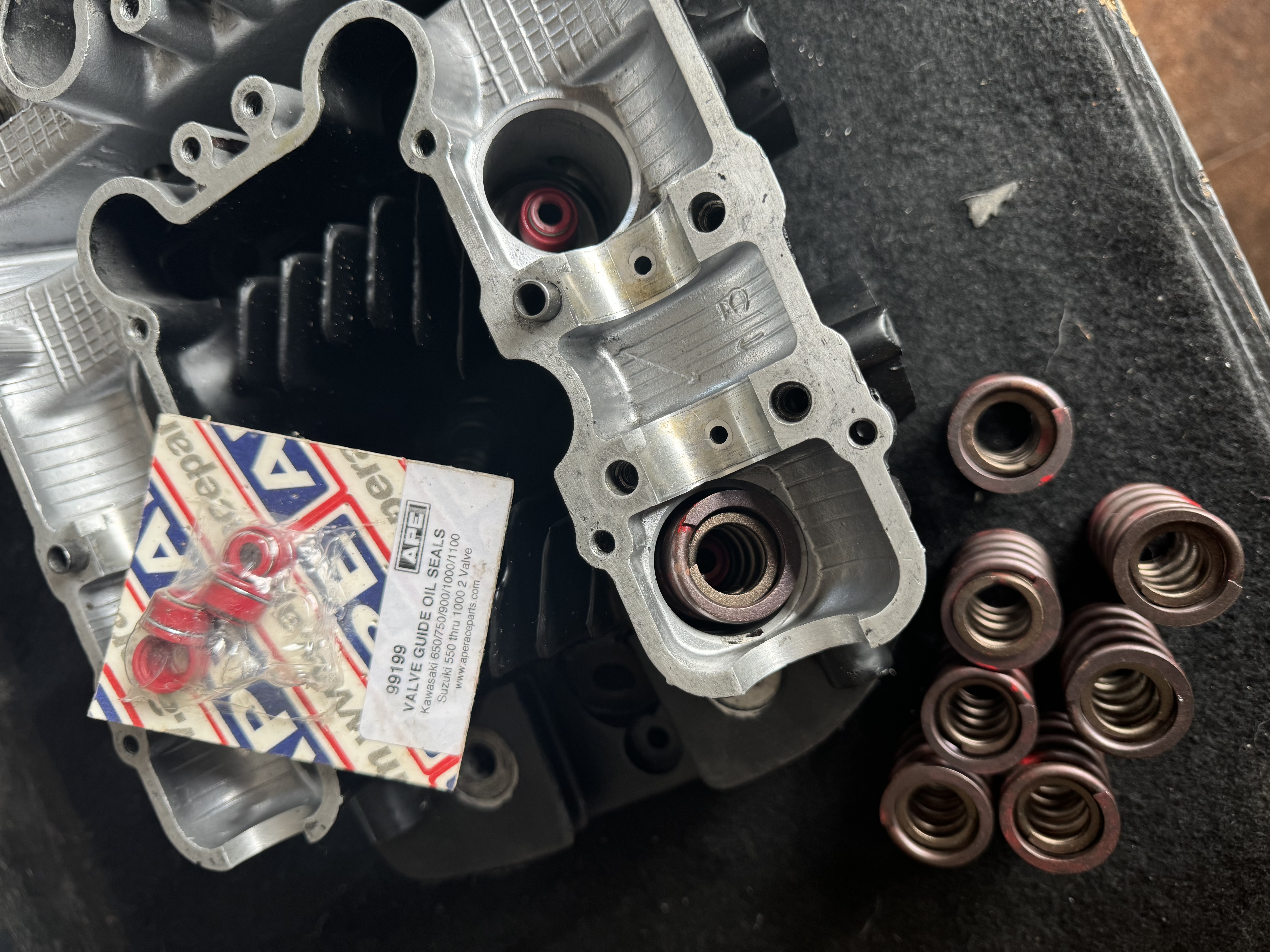

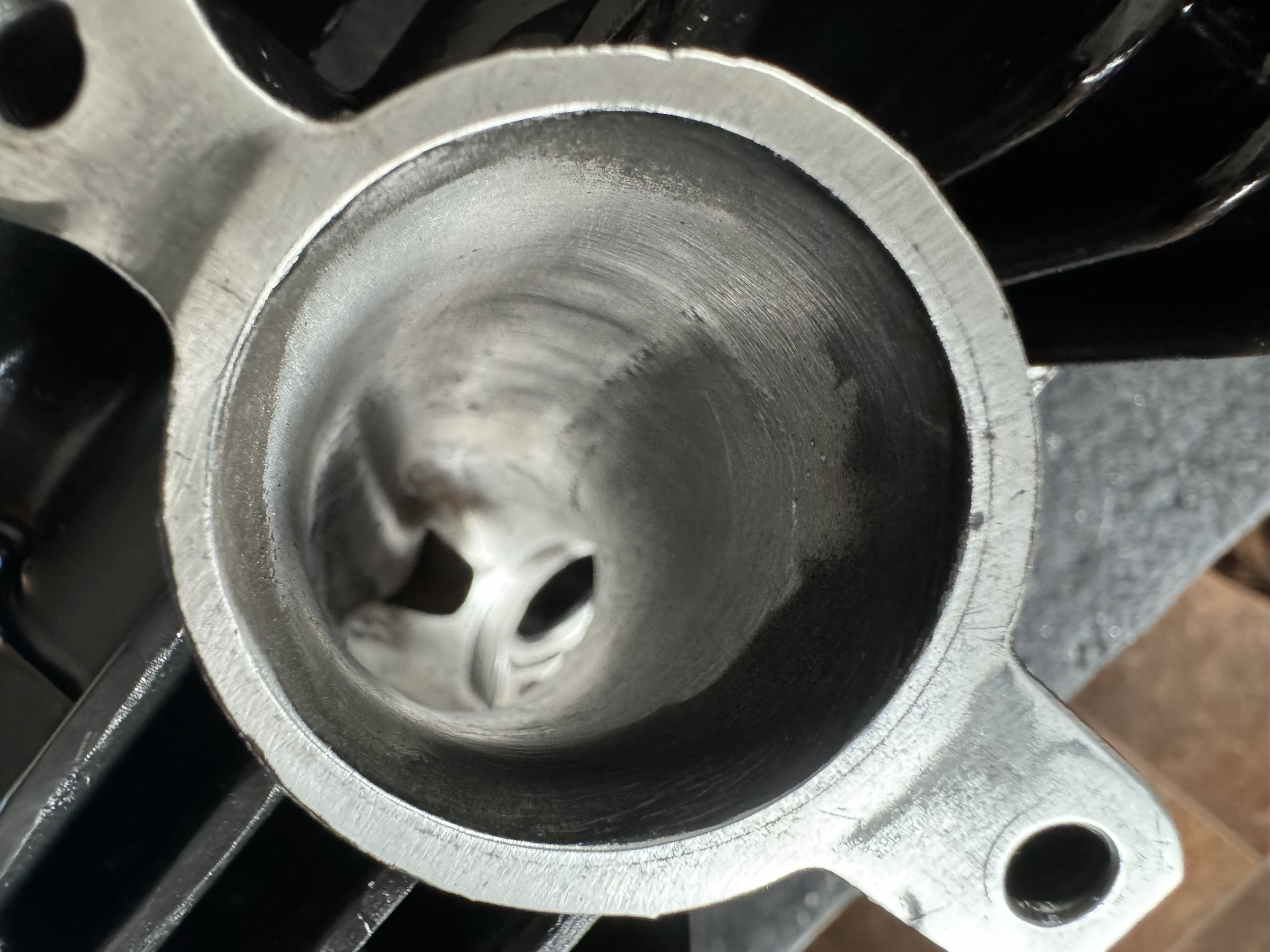

Finally got around to sorting the top end after what felt like forever waiting on everything I needed. Wossner 71.94 big bore, ported intake, Ape seals and springs, heavy duty retainers and cotters.

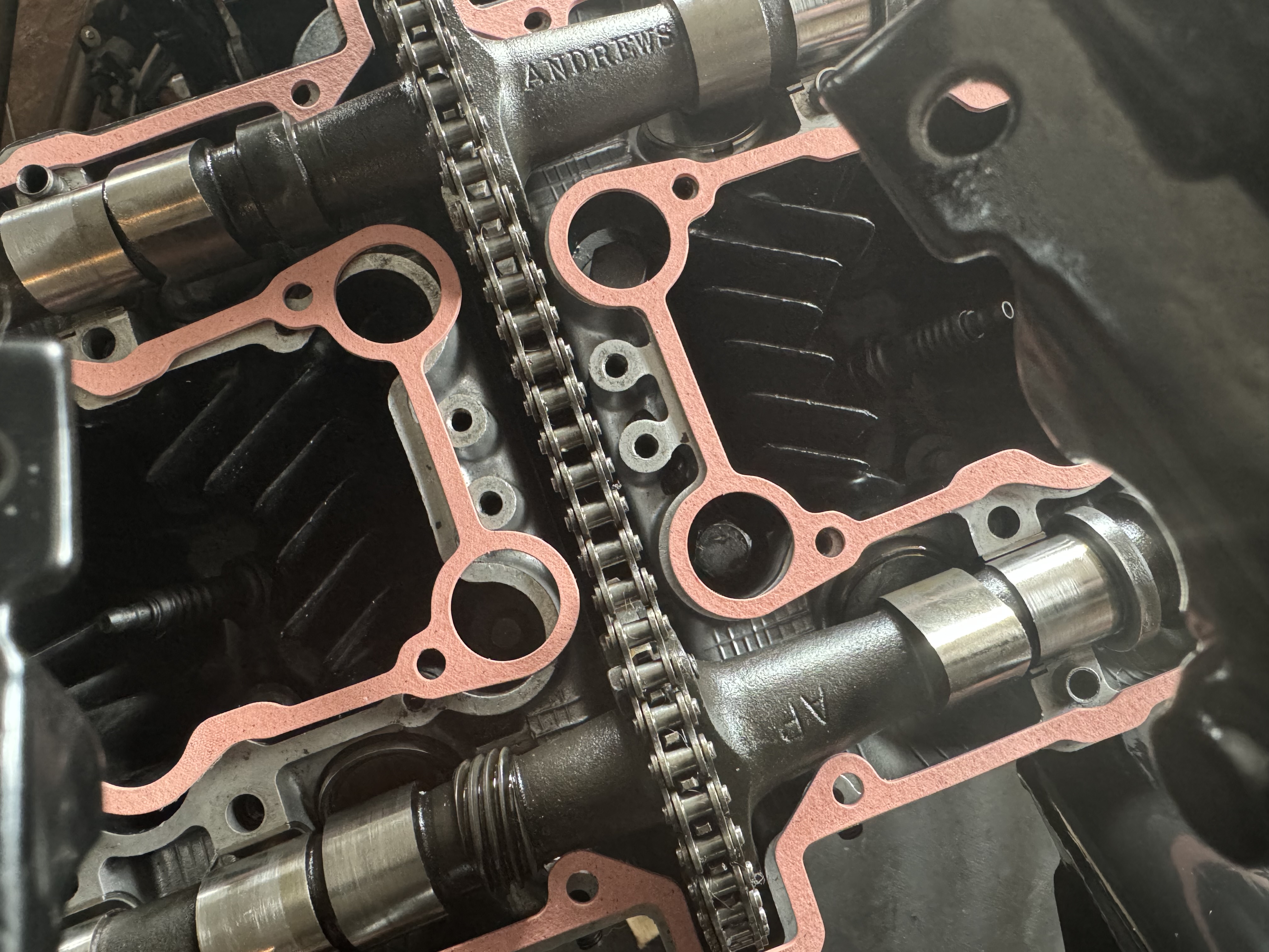

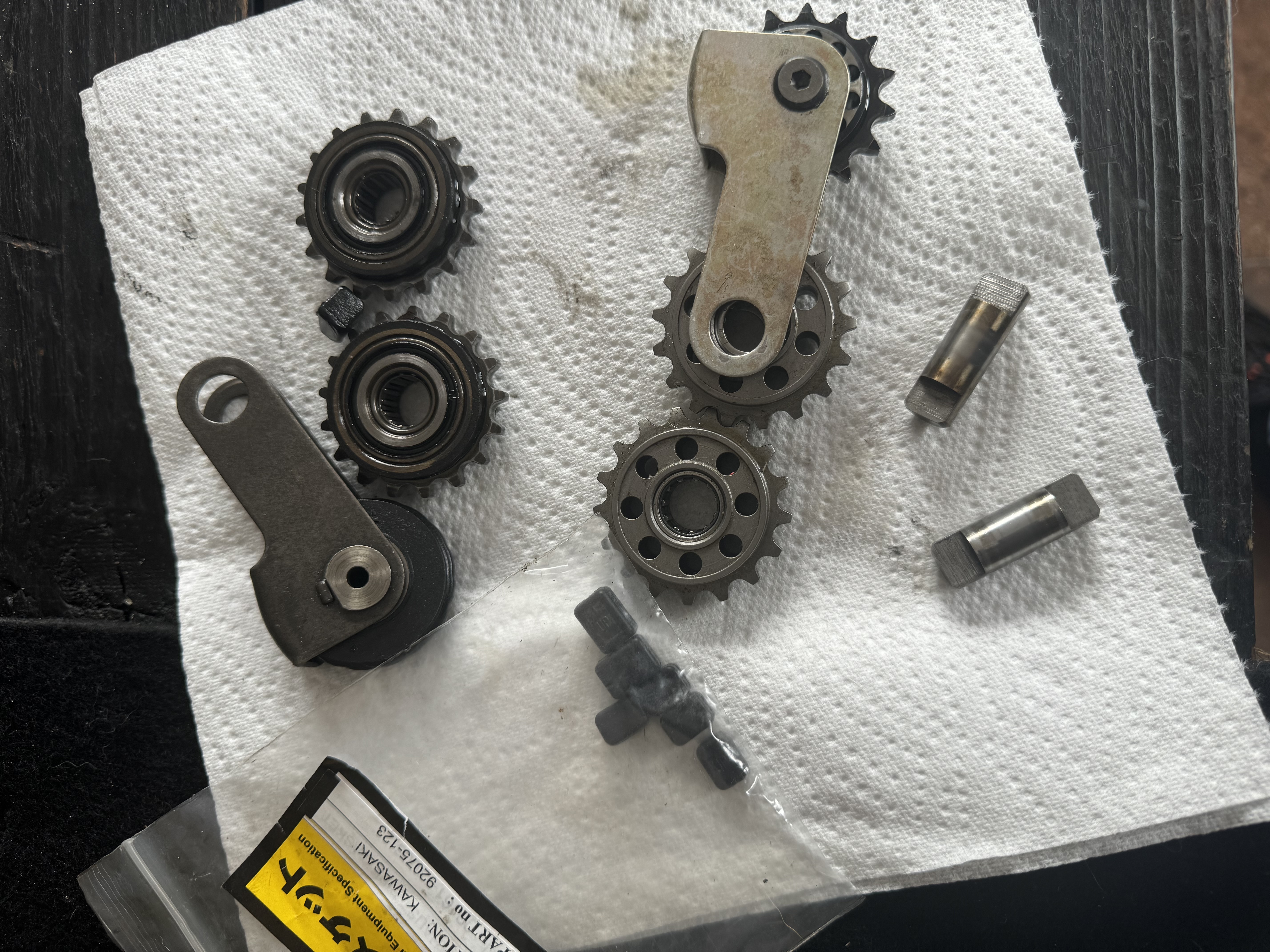

Engine is in the frame now, Wiseco 72mm gasket. Andrew’s cams and upgraded the cam chain, idlers and tensioners and Andrew’s cams. I’ll set the timing and finish off tomorrow.

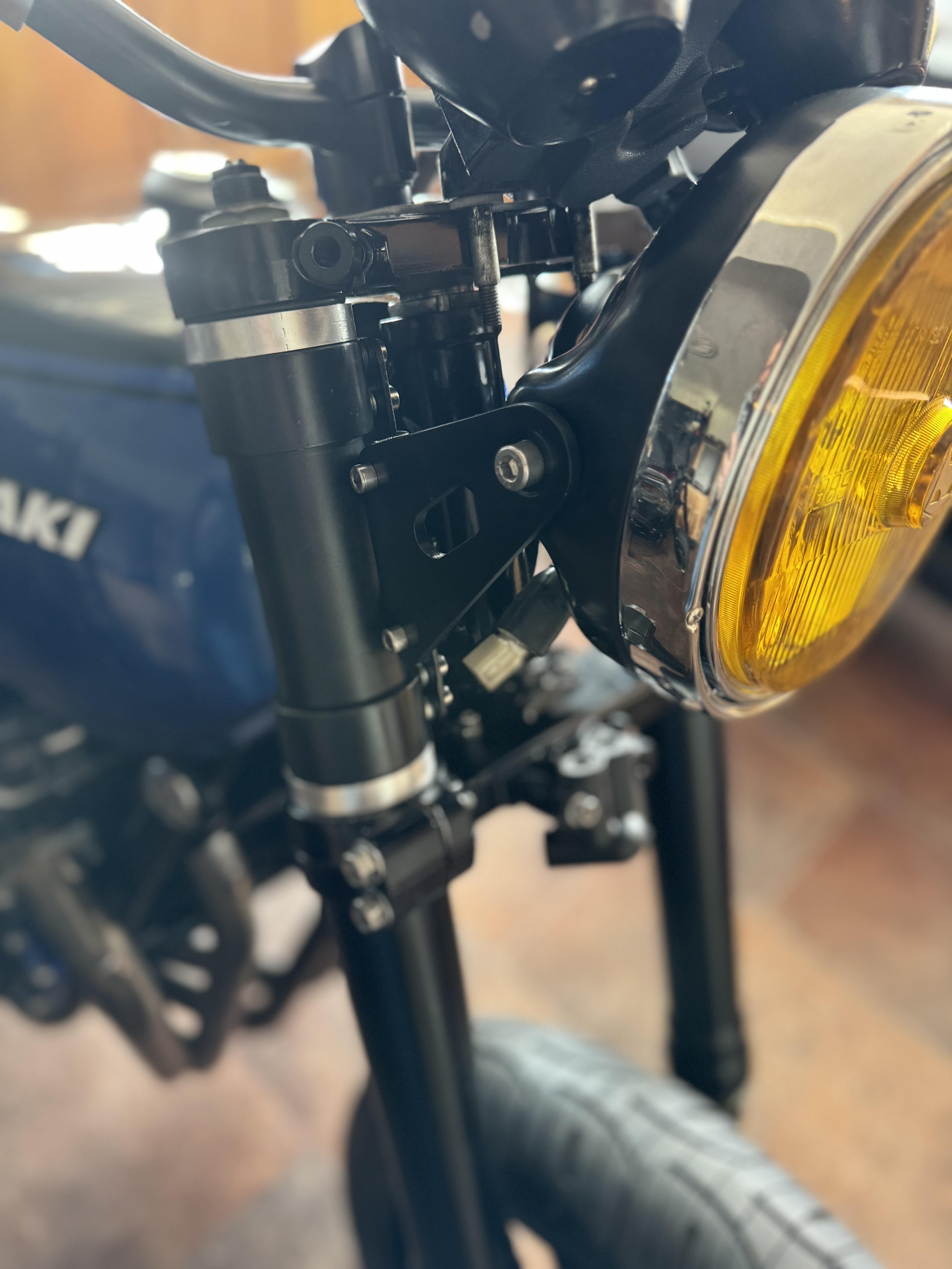

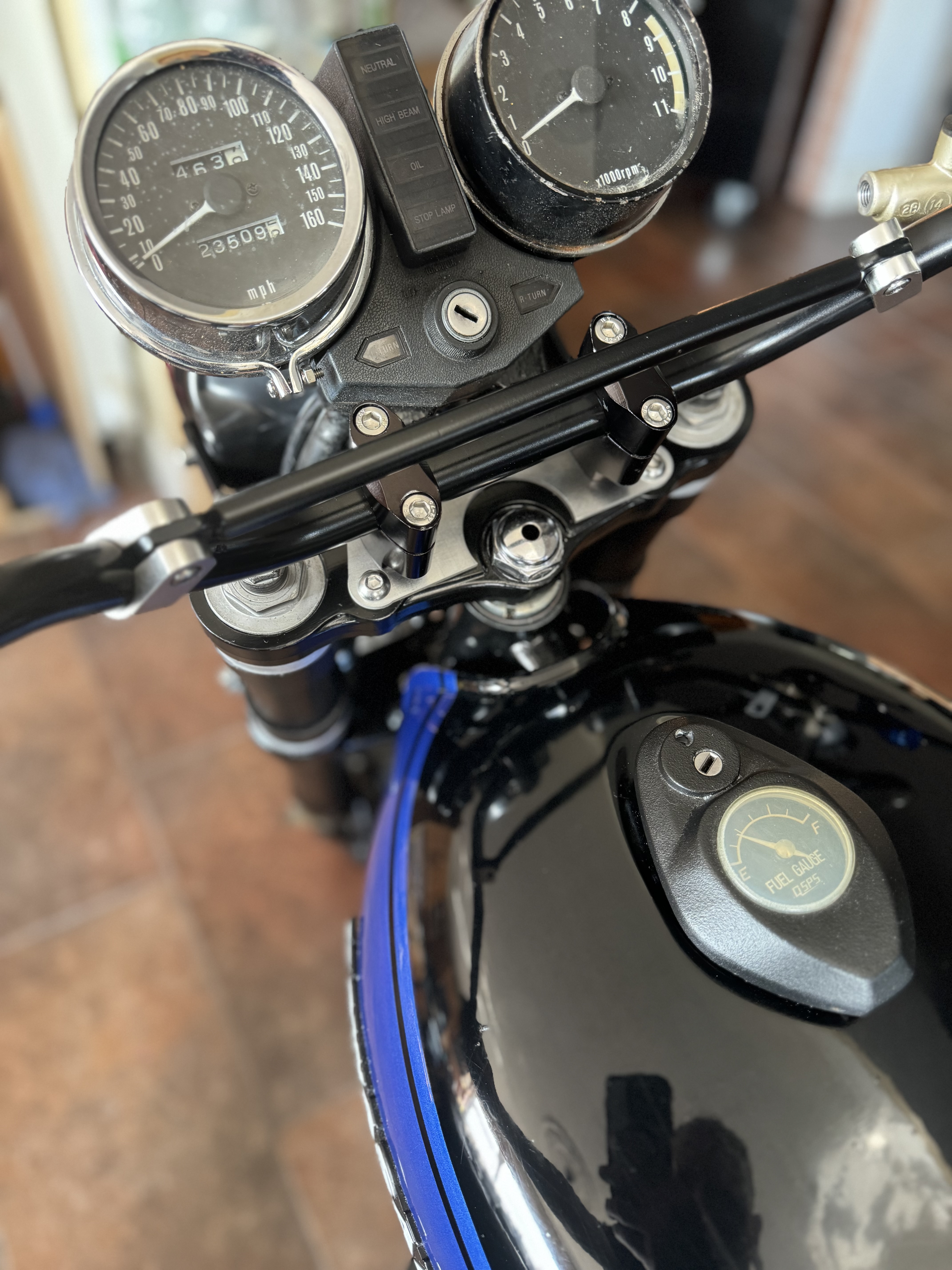

Yesterday was spent figuring out a tidy way to mount both the standard z1000 box a headlight bracket for the 50mm forks. I basically used th bandit 1200 system and chopped it up and with some fabricated spacers everything fits snug and solid. The clocks are mounted from a custom laser cut bracket that fits over the standard GSXr yolks.

Looking good I like that fuel gauge not seen one like that before can you take a picture of the under side cheers tony

Yea mate ill take some photo but if you google "QSPS kz1000 fuel gauge" you will find them, there are super rare now and fairly costy. I got mine for about £35 a good while back, pitted and missing the lock cap. Iv a busted up one ready to do a bit of surgery to it. These go for arounf £250 4to £350 in japan at the moment, insane money for a petrol cap.
