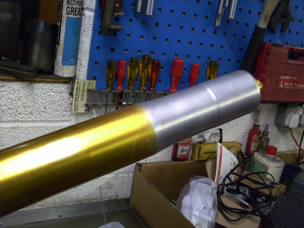

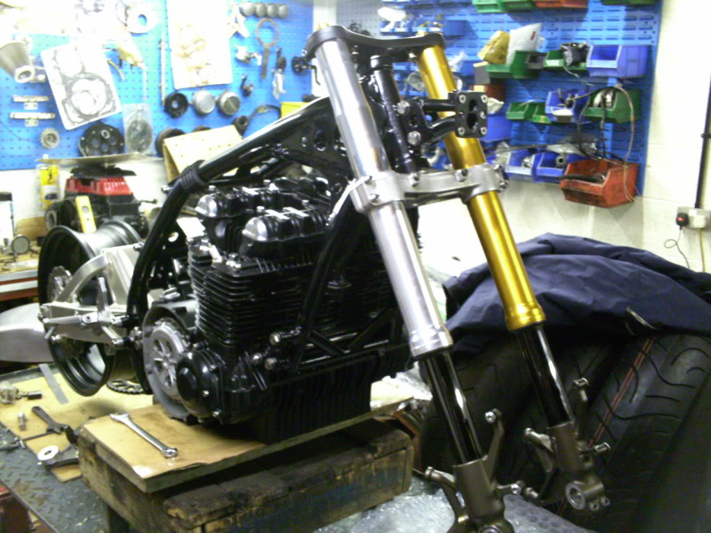

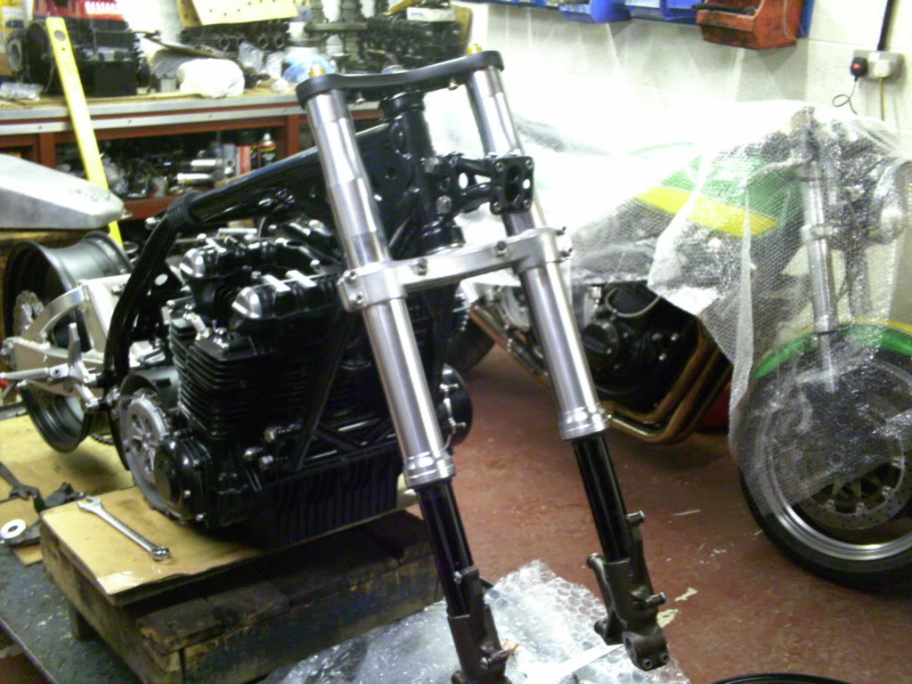

Decided to get on with the front end whilst i wait for a back sprocket to turn up.
Fitted new taper rollers, painted the top yoke and slotted the forks in.
Quickly came to the conclusion that the gold anodised forks look shite so had to do something about it.
Had bought some Sodium hydroxide crystals from Gateros plating to strip the anno from the R1 calipers gold stars so decided to do the same to the forks.
Only fly in the ointment was that i had rebuilt them with new seals etc after i had extended them.
Not wanting to pull them apart and risk damaging the seals just yet i decided i had nowt to lose by having a go at stripping them whilst they are in one piece.
As they say on the telly .. DO NOT TRY THIS AT HOME :lol:
After a bit of experimentation with the concentration of the solution and suitably equipped with goggles and rubber gloves i carefully set about sponging the sodium on the the leg.
After only ten minutes and a wipe with clean water i had this
Very suprised how clean and easy it came off and with no smutting .
Only 90 mins work from start to finish and i had this.
Spot the difference :D
Quickly perfected the technique and after another 20 mins job done.
Don't mind the gold on the damping adjusters so i'll leave it on.

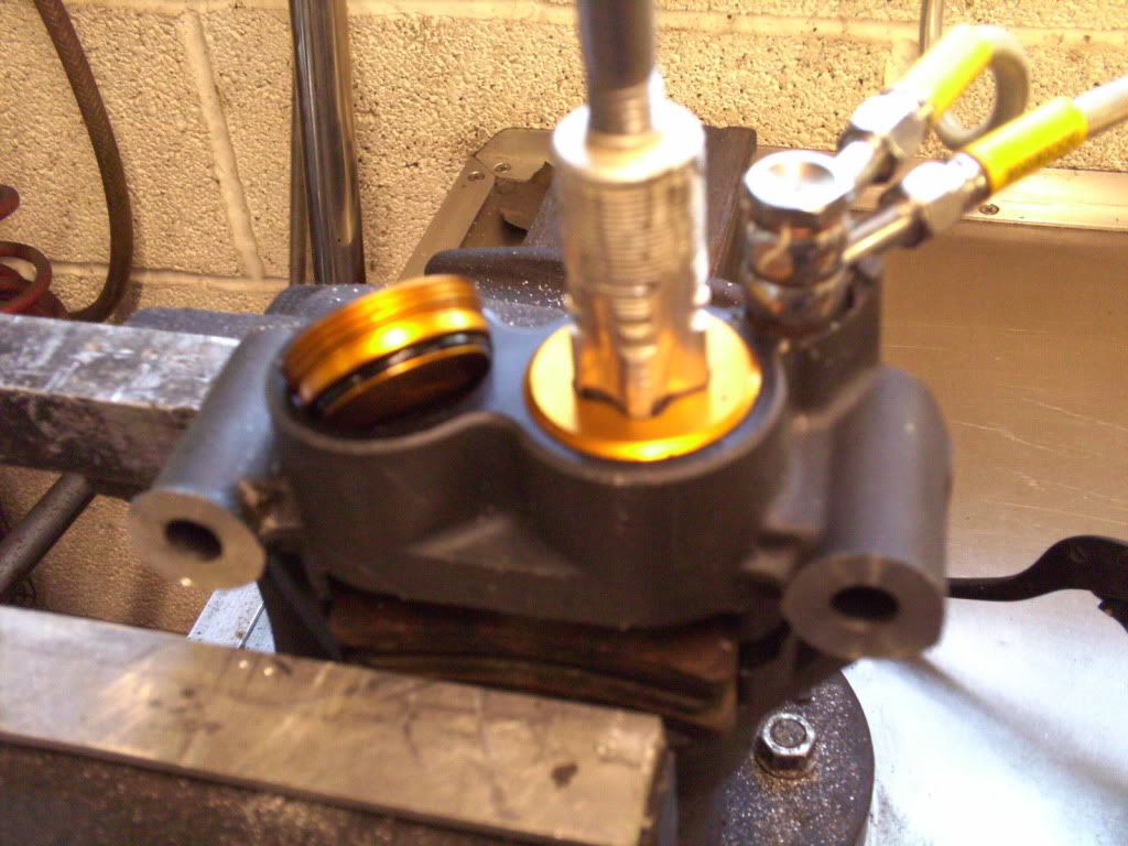

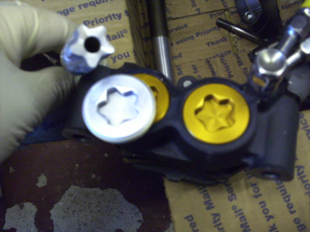

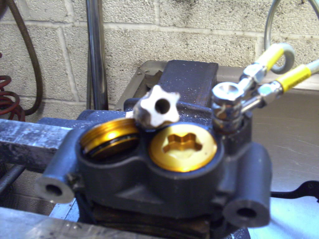

Same treatment for the calipers.
Pretty sure the grey finish on the calipers is anno too so not wanting to risk taking any of that off i knocked up a five sided tool to unscrew the gold stars
Nothing too fancy just attacked a bit of scrap ally with the angle grinder till it fitted something like
They came out much easier than expected and are only sealed with an 'o' ring and no thread lock.
One done and three more to go.

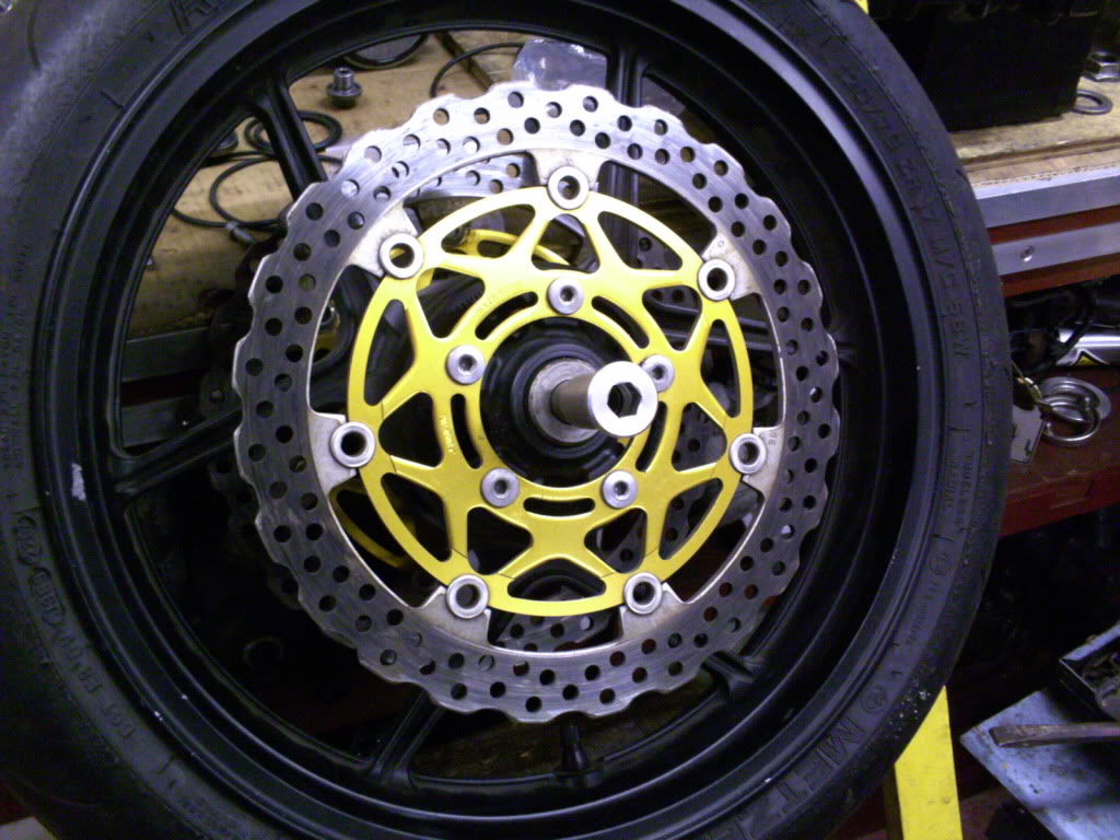

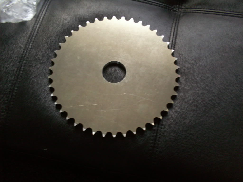

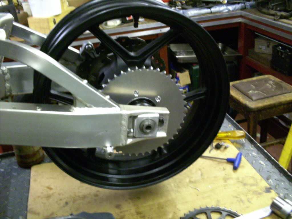

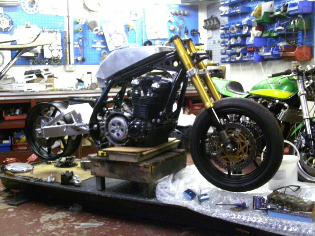

Very close to getting back on it's wheels.
Got a new set of tyres waiting to go on and received this dural blank rear sprocket from Dennis Trollop Racing this morning.
After some very carefull setting up in the lathes four jaw it was bored out to fit the zx10 sprocket carrier and just needs some stainless studs making to bolt it up.
Only thing slowing the progress to this milestone is the offending gold discs.
Really want black centers but not keen on painting them as they soon get tatty around the buttons and i don't think leaving them gold is an option, should i paint them black or just strip the anno back to bare ally for now ???

Posts: 891
Joined: 23rd Jul 2011
Location: Aberdeen,Dyce
#161 PostAuthor: z1000puddin » Wed Dec 12, 2012 10:43 pm
I assume the discs are stainless steel, if so..
Have you looked into Melonite QPQ coating ?
It is a Quench - Polish - Quench process or I think its full name is
Nitrocarburizing, polishing, and post-oxidizing.
We use this operation on stainless steel fasteners, it gives good corrosion resistance ( & prevents "Galling" on stainless steel threads) and it finish colour is almost a matt black finish.
The only thing I am unsure of is if they can mask of the pad wear area or if / how it would effect the disc .
eg warpage??
Stu
Zed til Dead
Posts: 4040
#162 PostAuthor: zed1015 » Thu Dec 13, 2012 12:23 am
The gold carriers are aluminium.
I can just strip them to bare ally and leave as is or paint black.
The more i think about it the bare ally is winning for now and i can change to proper anodised black centered discs at a later date.
