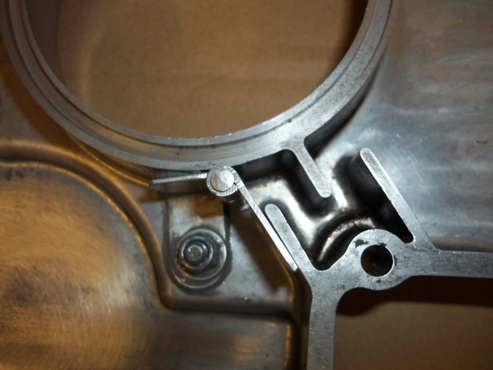

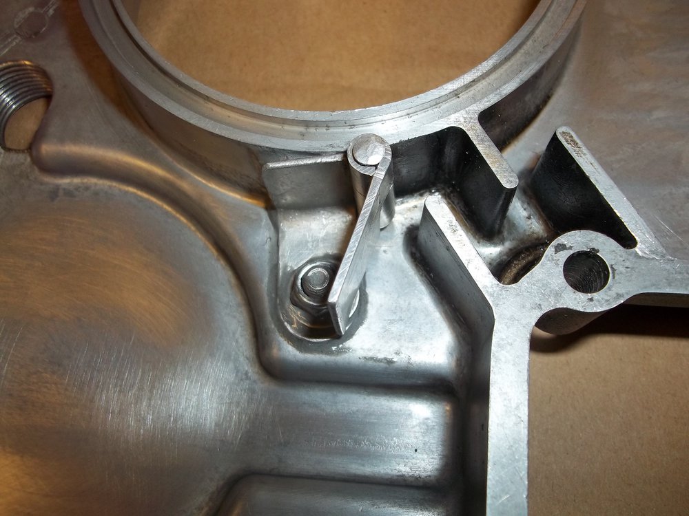

The gate has been put in 90 degrees out with the mounting bolt hole drilled in the wrong place.
The hinged upright should be against the wall of the oil filter hole with the gate "door" closing the gap in the sump baffle.
When installed correctly the door usually stops against the mounting bolt and in the case of the Geep pump stops against the pressure release valve .
There's a pic on page 1 (post 14) of the Orient Express build thread that shows one fitted .
As for that so called deep sump I wouldn't bother ( the Orient is just fine with just a gate) it's practically useless and the braided earls hose actually aids surge by allowing a path for the trapped oil to feed back to the gearbox end, defeating the object.

Brilliant, thanks Rob and thanks Sanderz! Makes life a little easier with those two answers! Decision made then, original sump with a repositioned gate it is!

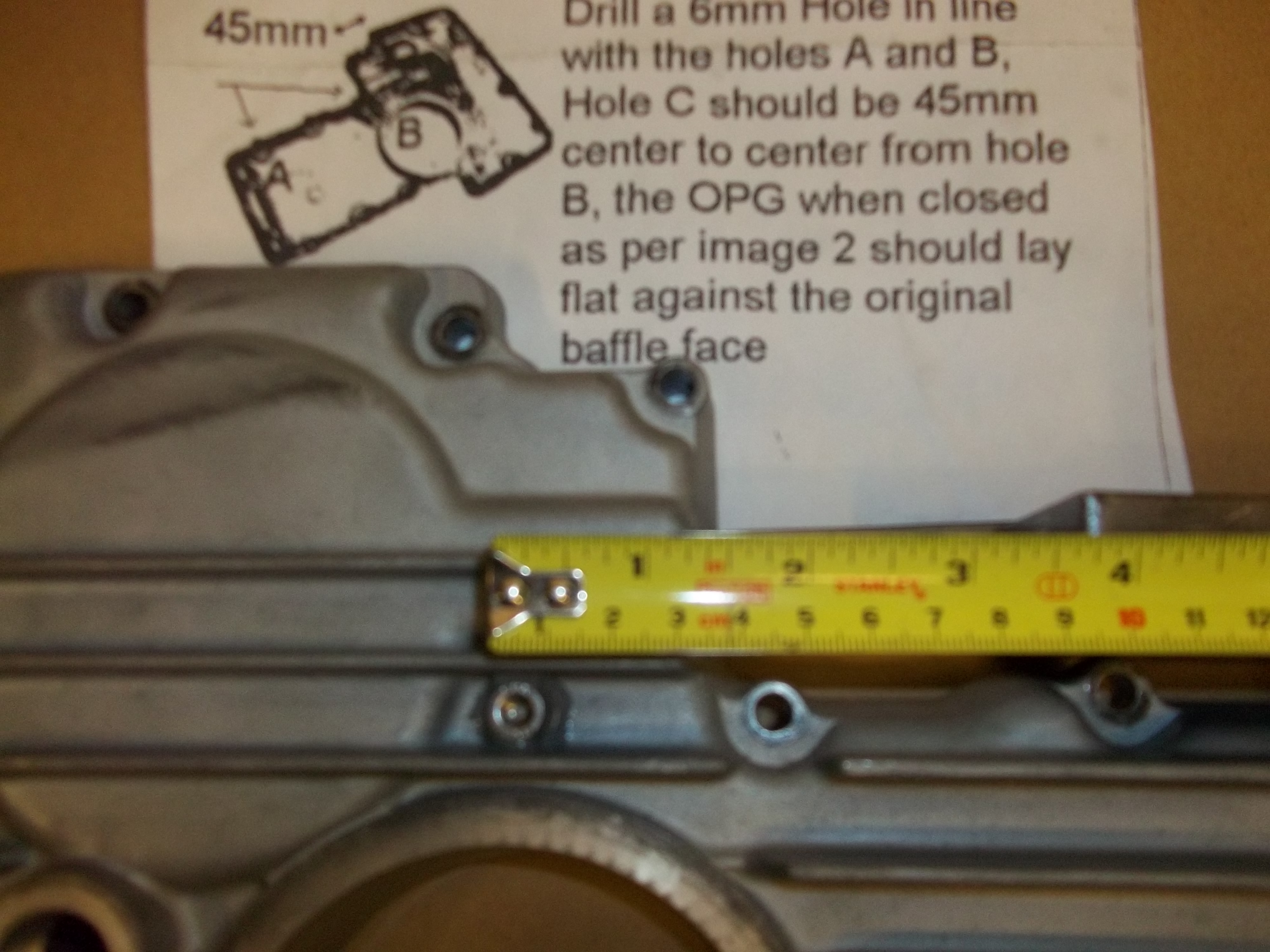

So, with the option of an expensive aftermarket deep sump being well and truly out-the-window, the oil gate was being transferred into the 'good' original sump (complete with now irrelevant oil level sender).
Hole drilled and finning relieved on underside so that the allen-headed bolt would sit flush.
And the gate bolted into place, in the correct orientation this time!

...errr, no.
You can just about see the mark where the body of the pressure relief valve was hitting the nut holding the gate in place...
Hello Mr Grinder? Are you available for a few minutes?...
Enough clearance created and the circlip that holds the spring in place can still be fitted.
