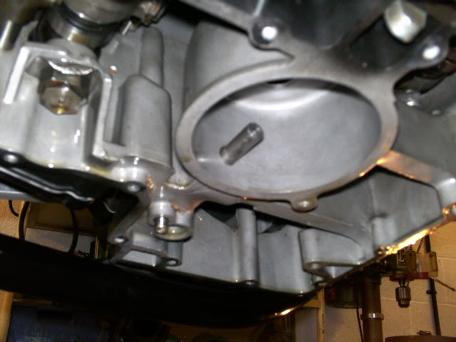

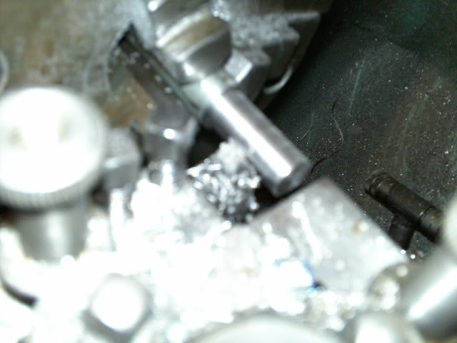

This was really bad news and would mean an engine strip which gave me thoughts of giving up and selling the project. After an hours swearing and kicking anything but the bike i decided to get my brain in gear and try and sort it without mass destruction. I came up with the idea of drifting the leaking plug out from inside the engine and out through the frames mounting lug. After draining the oil and pulling off the sump and oil pump i found there was luckily just enough room to get a suitable drift inside the filter housing and into the oil gallery.

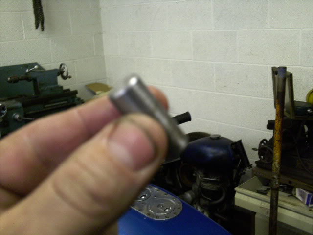

After a few taps the plug moved very easily and emerged out of the frame lug ( Too easily in fact and the donor motor was a minter, untouched from the factory when i got it )
And here it is.
A swift session on the lathe produced a slightly larger replacement which was duly fitted and everything was re-assembled.
I've now replaced the oil so i'll have to wait till the morning to be sure i've cured the leak ,Then i'll be a happy man again.

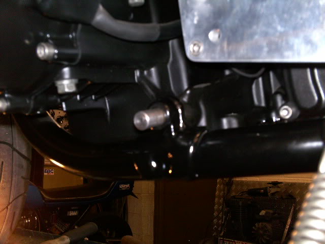

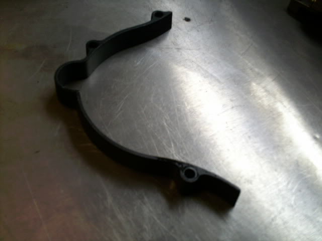

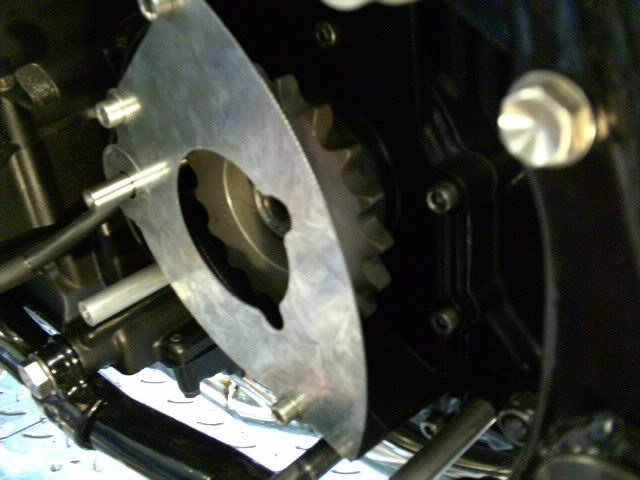

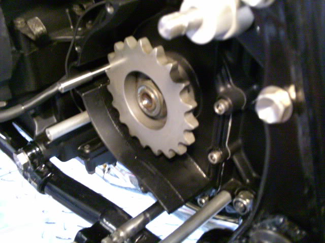

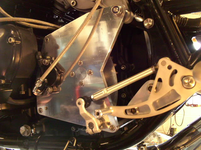

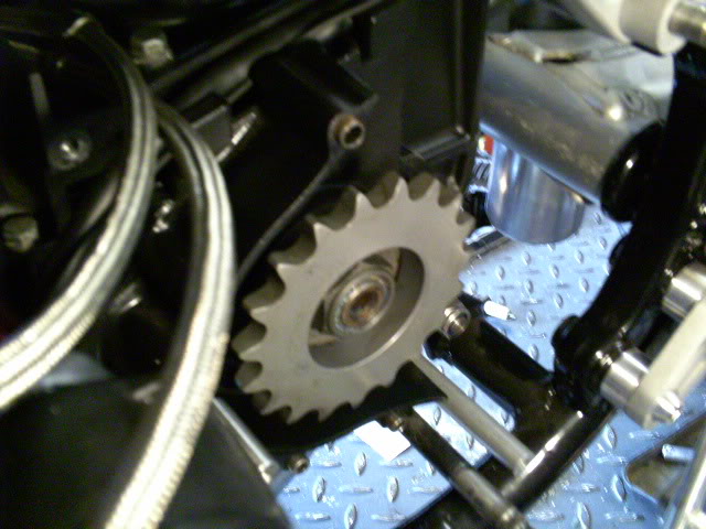

Oil leak is cured and now finally got round to fitting the 19t 5/8 offset front sprocket today. Though this threw up the small problem of the steel side cover not fitting due to the sprocket now sitting outboard by an extra 15mm . This would mean chain lube etc would not be contained within this area and fly off all over the place.
After a bit of head scratching i came up with idea of extending the casing by taking a slice off a spare cover .
And after fitting hollow location dowels it looked like this
Three longer cap head bolts later the side cover now fits with loads of clearance,
Outrigger plate refitted, hydraulic clutch bled and hopefully all this is now finished and can remain undisturbed and ready to go.

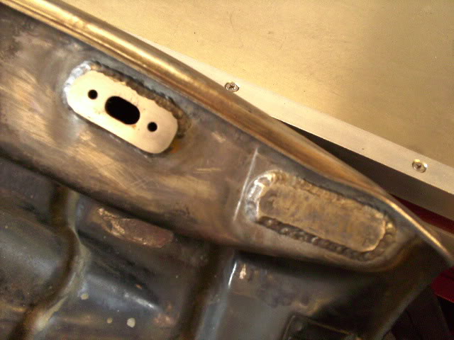

Ok. Here's what i've been doin. With the blower fitted there wasn't room for a fuel tap in the original place and i didn't have a zed tap anyway. So i've had to weld over the original mount and put a new mount further forward to take an unknown high flow tap that i found amongst my hoard of bits.

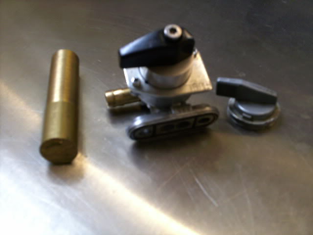

Trouble started when i spotted that this tap had no reserve so i've had to modify it slightly with home made internals and a handle off another tap. Original handle can be seen on the right and bit of brass bar will be the on and reserve level tubes with gauze filter soldered on when i source some. I've also fitted a small spring and ball bearing (out of a grease nipple) to form a detent so positive on /off/reserve positioning can be felt with a click.

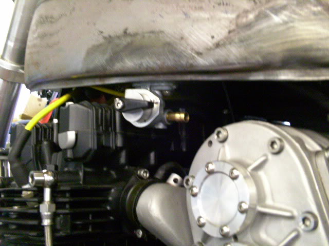

Tap shown in position.

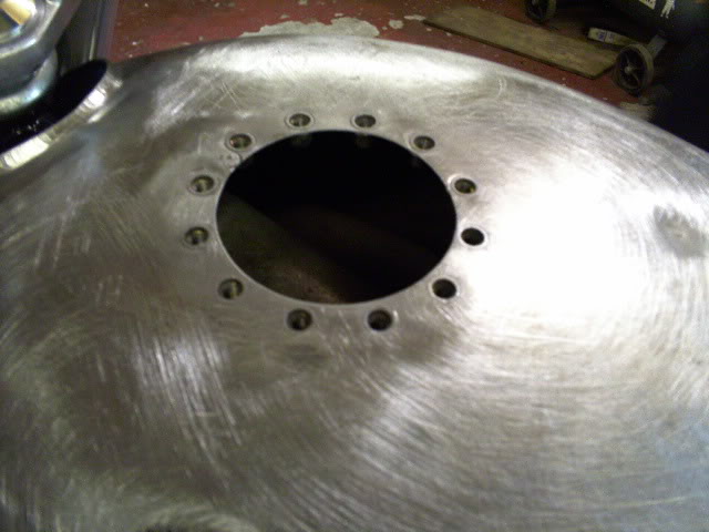

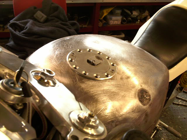

While i was butchering the tank i removed the original cap mounting and beat the recess flush to the surface. Then i cut out the opening and fitted some threaded rivnut inserts.
PICT0188 (1).jpg (74.2 KiB) Viewed 5043 times
To take my home made flush filler cap. :bow
