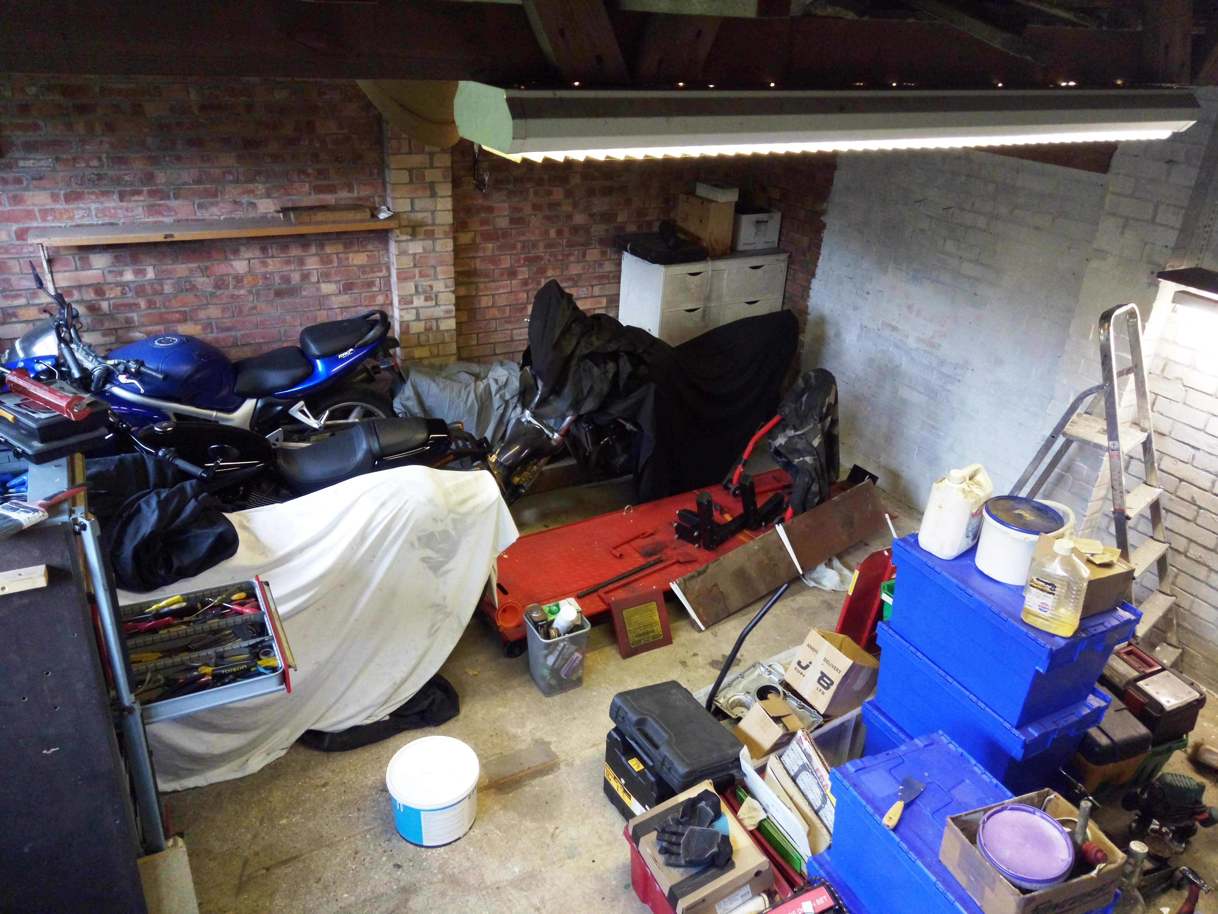

#182 PostAuthor: MDM » Mon Aug 21, 2017 4:28 pm
And the new garage, at last some space! But first it needs the walls painted white, and the floor painted too, then some racking / shelving put in place, and some decent lights instead of just two, and some electic sockets (again, instead of just two), and my work bench and storage cabinets need to be picked up from the old 'Shed of Dread', 130 miles away, and moved into this, already christened 'The Time Sponge'...

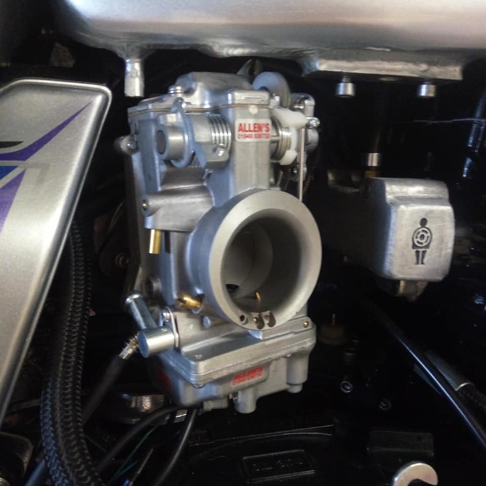

#188 PostAuthor: MDM » Mon Feb 11, 2019 2:39 pm
So, new year, and new found impetus for getting tings done. helped by the fact that I've laid a kitchen floor and won't get gripes about being in the garage again...After a lot of rooting through boxes and trying to find the 'safe place' where I put the bits that still need to be fitted, I finally found the Mikuni HSR.

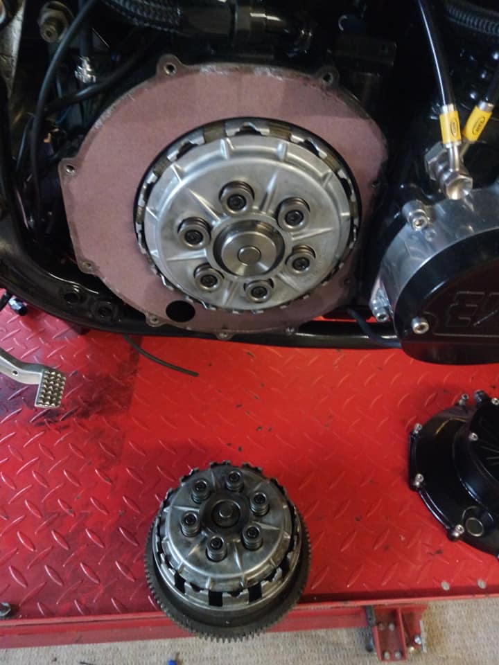

#189 PostAuthor: MDM » Mon Feb 11, 2019 2:40 pm
Buoy'd with enthusiasm, I also found the clutch pack, and whipped off the cover to get it fitted...

#190 PostAuthor: MDM » Mon Feb 11, 2019 2:41 pm
Hang on, there's one in there already? How did that happen? I don't remember fitting it...
Hey ho, at least I can fit the clutch lock-up while the cover is off, right?

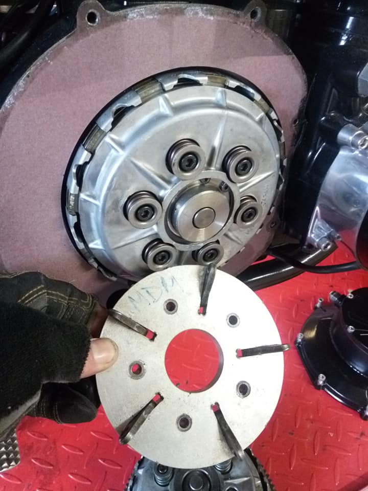

#191 PostAuthor: MDM » Mon Feb 11, 2019 2:43 pm
So that'll be a no. The lock-up is for a five bolt clutch, not the six bolt that I have...
I'm now wondering if I've got my lock-ups mixed up, as I'm sure I have another one somewhere that is supposedly for a GSX-R, maybe I got them confused? The problem is, I can't find it as it is also in a 'safe place'...
This isn't a case of one step forward, one step back. But more a case of several steps sideways...

#192 PostAuthor: zed1015 » Mon Feb 11, 2019 3:10 pm
Five bolt is for the earlier Z900/1015 pressure plate.
You would really be better off sticking an earlier steel basket in there too as they don't break when you put loads of power through them like the ally ones do.
