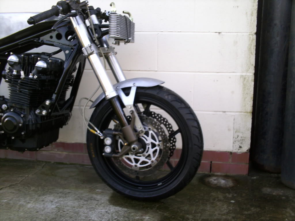

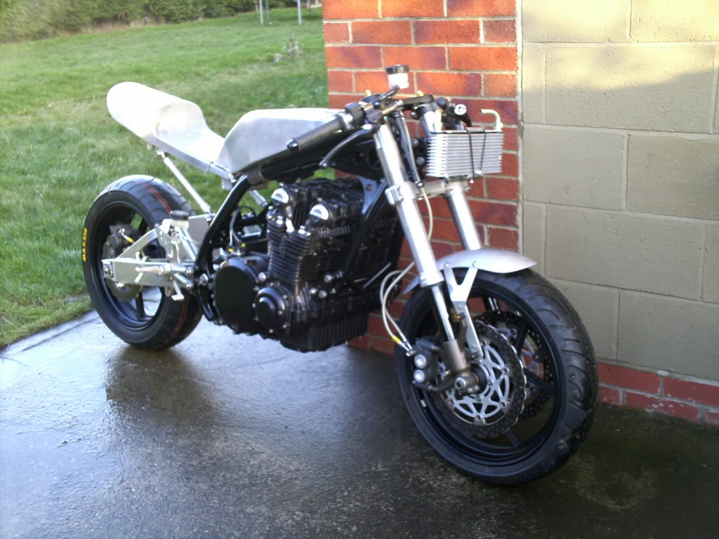

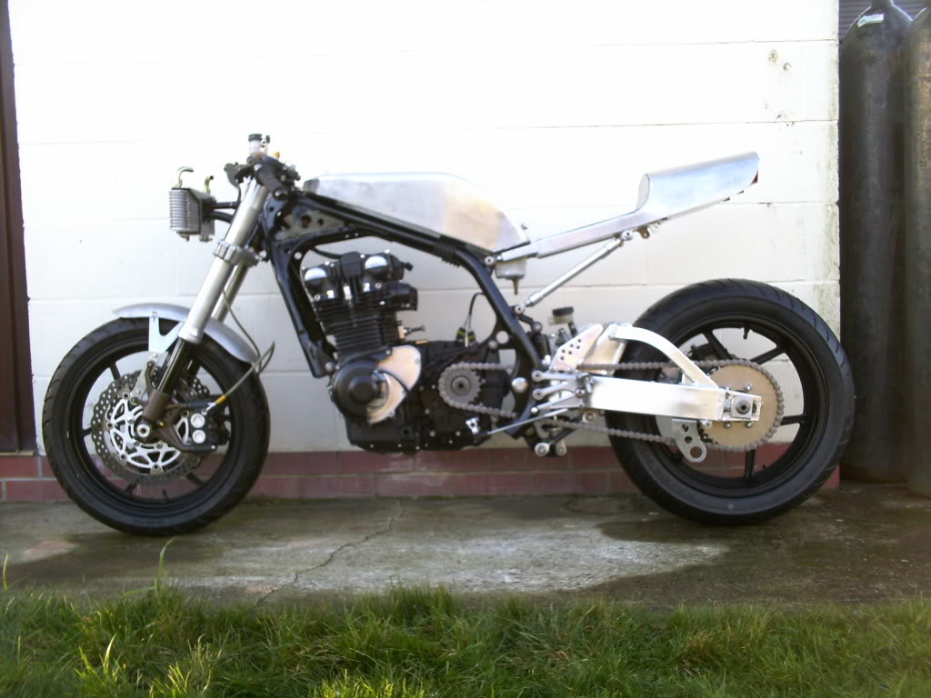

Mudguard mounted.
Not a lot of scope with the forks only having mounts on the front of the legs so some alloy 'Y' brackets are the best solution.
I plan to paint them black so they blend in and the polished guard will float above the tyre.
A quick mock up with the bodywork back on and a look out in the daylight to check the lines are right
Decided the bare ally looks good so the planned KR paint job is out and lots of polishing is in.

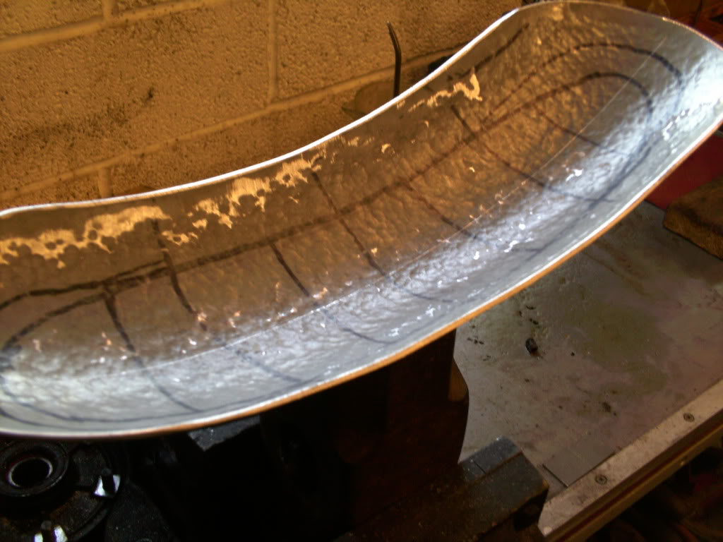

Going back to the front mudguard,did you use the xjr one as a bit of a buck?? Id love to have a go at making one,but have zero experience in doing that kind of thing,but an eager mind. Guessing a bit,but did you form the radius first to match the tyre and then beat the sides???
Id love to hear more,if you would be kind enough to share??
:D
Every silver lining has a cloud...
Posts: 4040
#206 PostAuthor: zed1015 » Fri Feb 08, 2013 8:26 pm
I didn't use the XJR muddy at all.
I cut out the ally plate the same width as the forks and guestimated the length needed (it could always be trimmed later) the ends were then radiused to match the width.
I used black marker grid lines as a guide.
Beating along the length pushed the metal sideways to curve around the tread towards the rim and beating across the guard helps create the fore and aft radius to match the tyre circumference.
That is a very simplified explanation as the curvature in all directions is a combination of both actions.
If you look at the pic you may see i don't go right up to the edge.
There is an unbeaten area around 15mm wide that is unstretched and this part trys to remain in the original shape/size which helps pull the sides round.
I have no training , everything i do is self taught and this mudguard was formed using only a ball pein hammer and 14lb lump hammer head in the vice as an anvil, no bag of sand or english wheel.
Time for you to get the hammers out :wink:
