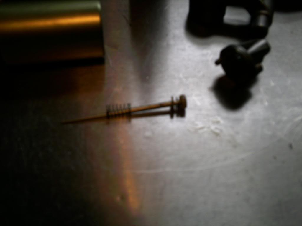

Yeah! the bottom of the slide bore needs cutting deeper to allow the slide to shut fully and then the needles need lifting by the same amount to re-position them correctly in the needle jet emulsion tube and that's the lot apart from a bit of fiddling with jets.

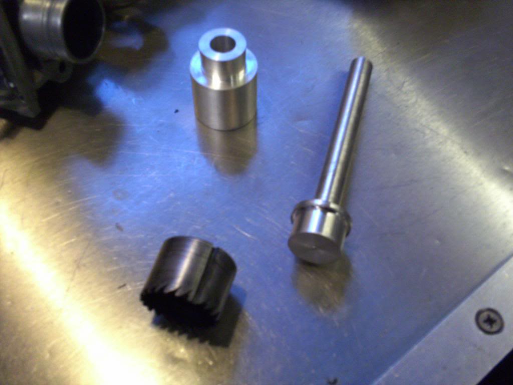

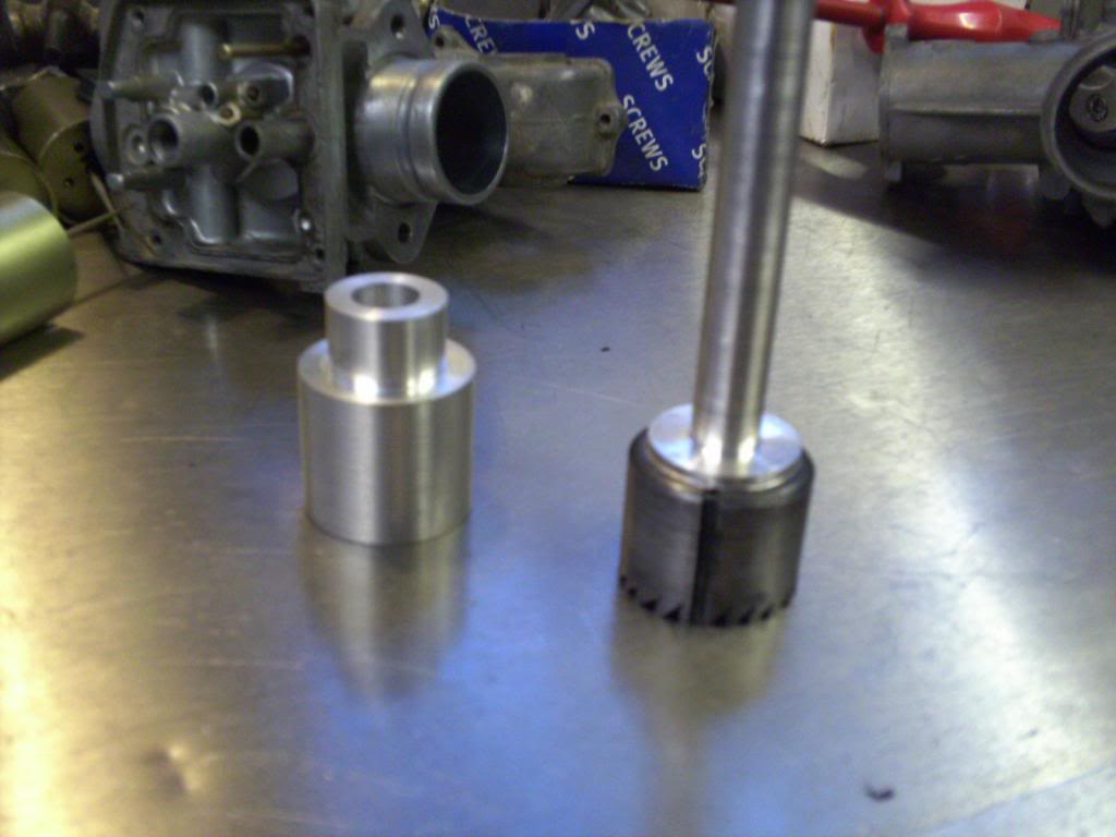

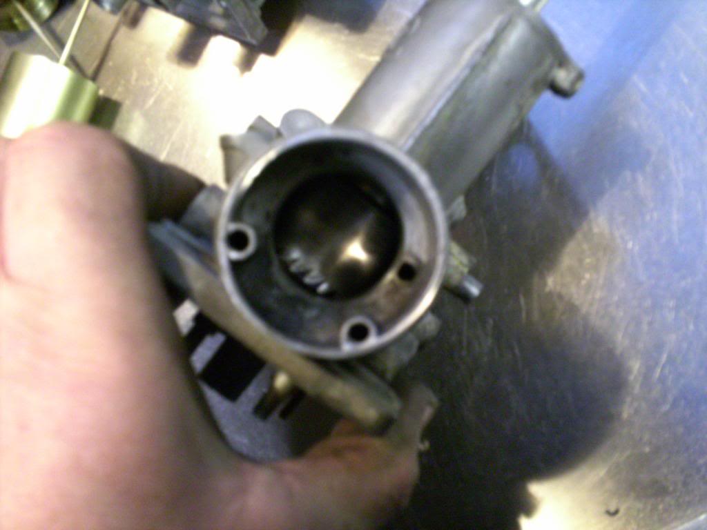

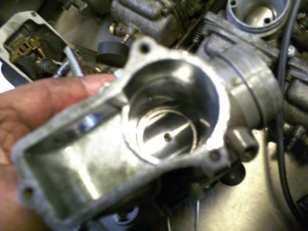

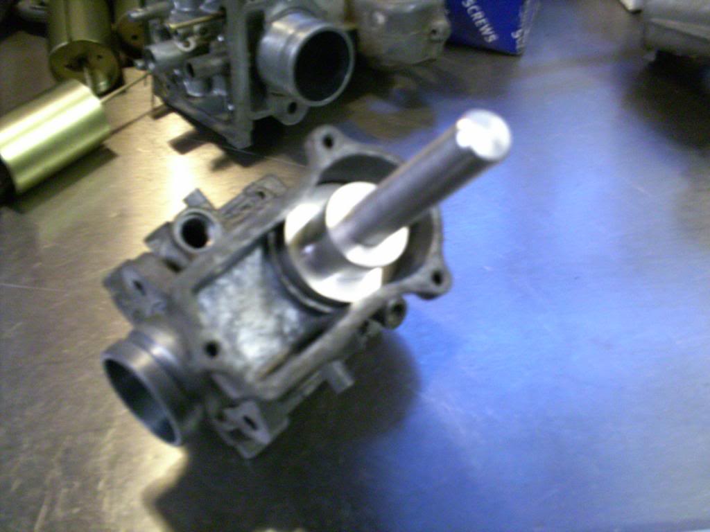

#233 PostAuthor: zed1015 » Wed Mar 27, 2013 9:43 pm

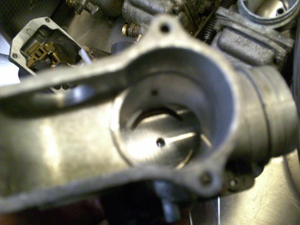

Slide groove cutter made.
A couple of bits of alloy bar for the guide and mandrel.
and an old steel bar end weight from the scrap bin for the cutter head.
Cutter pressed on to the mandrel and a slot in the side of the cutter allows it to pass past the plastic guide for the throttle slide.
Guide slots in after the cutter to keep everything square.
Ready for action
BEFORE
AFTER

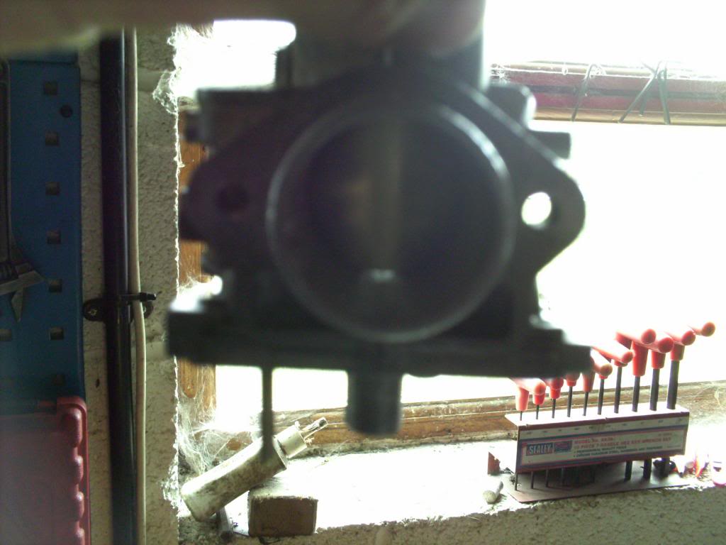

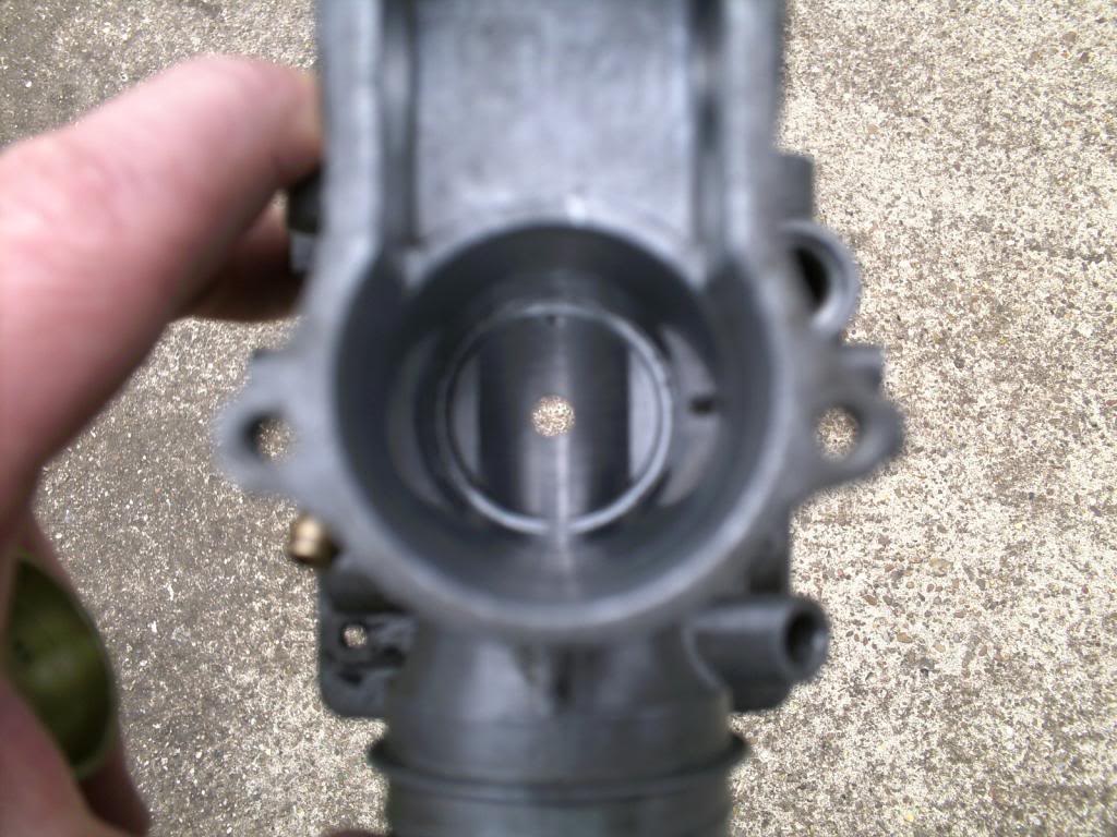

#234 PostAuthor: zed1015 » Thu Mar 28, 2013 1:19 pm

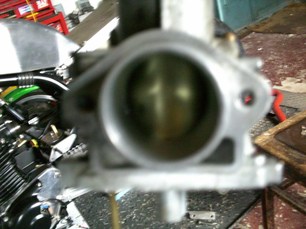

Had a bit of a headscratcher this morning when trying the slides and finding that they still didn't fully close
It took a couple of minutes for the lightbulb to come on and i realised that the underside of the slide was sitting on the outer raised portions of the carb bore either side of the slide.
I quickly cobbled together a heath robinson device using a piloted counter bore to reduce their height and was soon back in business.
Will have no such mucking about resetting the height of the jet needle as it is the spring loaded type so it's just a matter of replacing the thick spacer above the clip with an appropriate thinner one
A bit of jiggery pokery to open up the internal fuel galleries for increased flow and it'll soon be rebuild time.

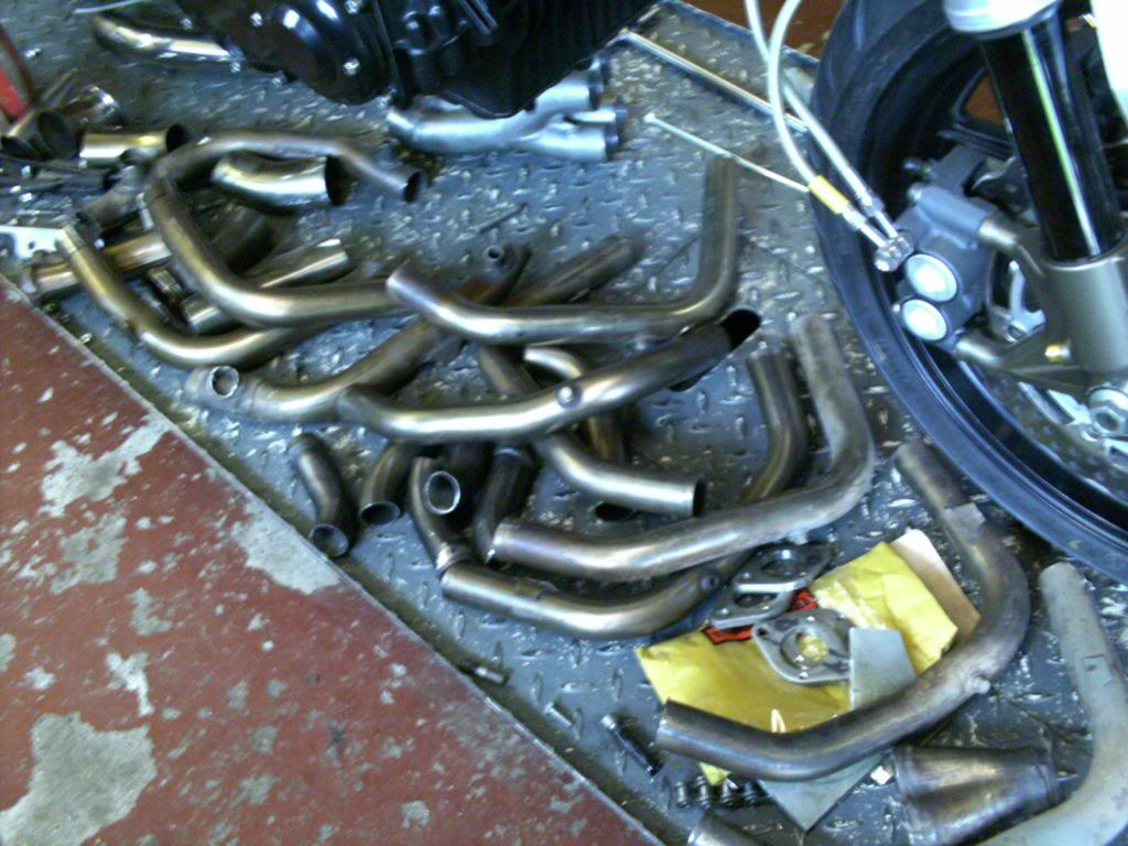

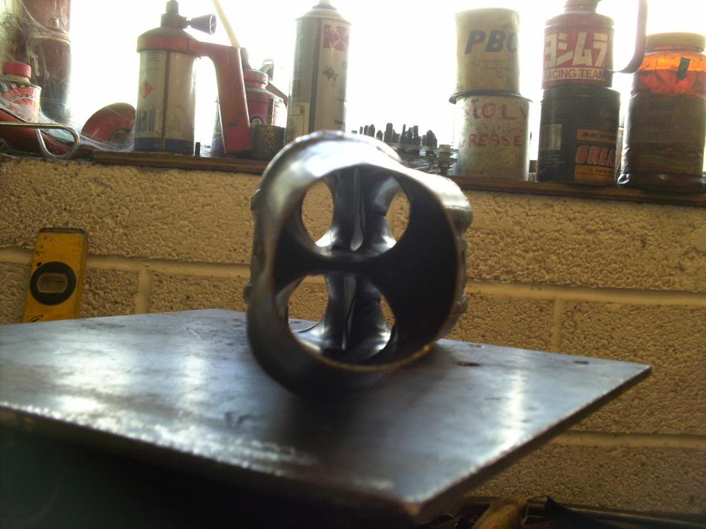

#236 PostAuthor: zed1015 » Mon Apr 29, 2013 12:12 am

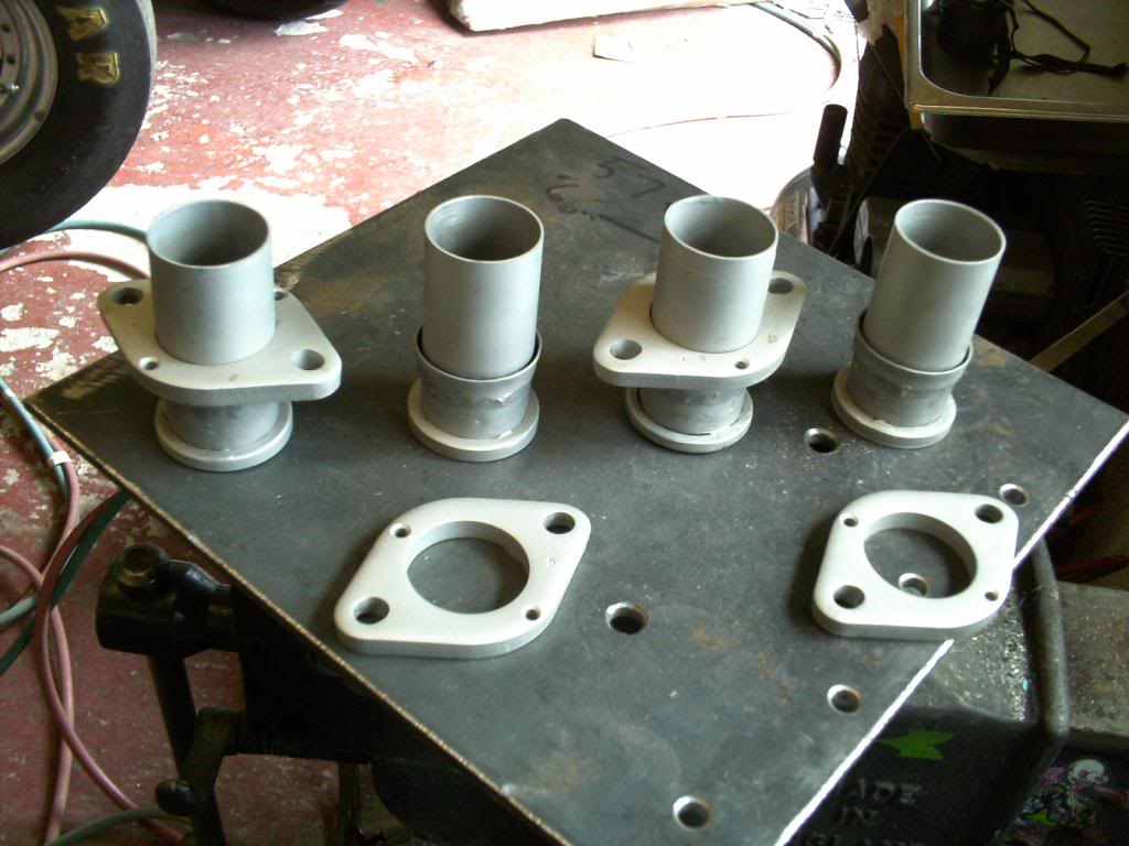

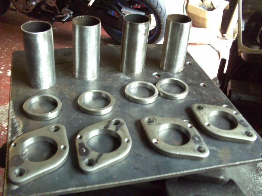

Made a start on the exhaust while waiting for some carb parts.

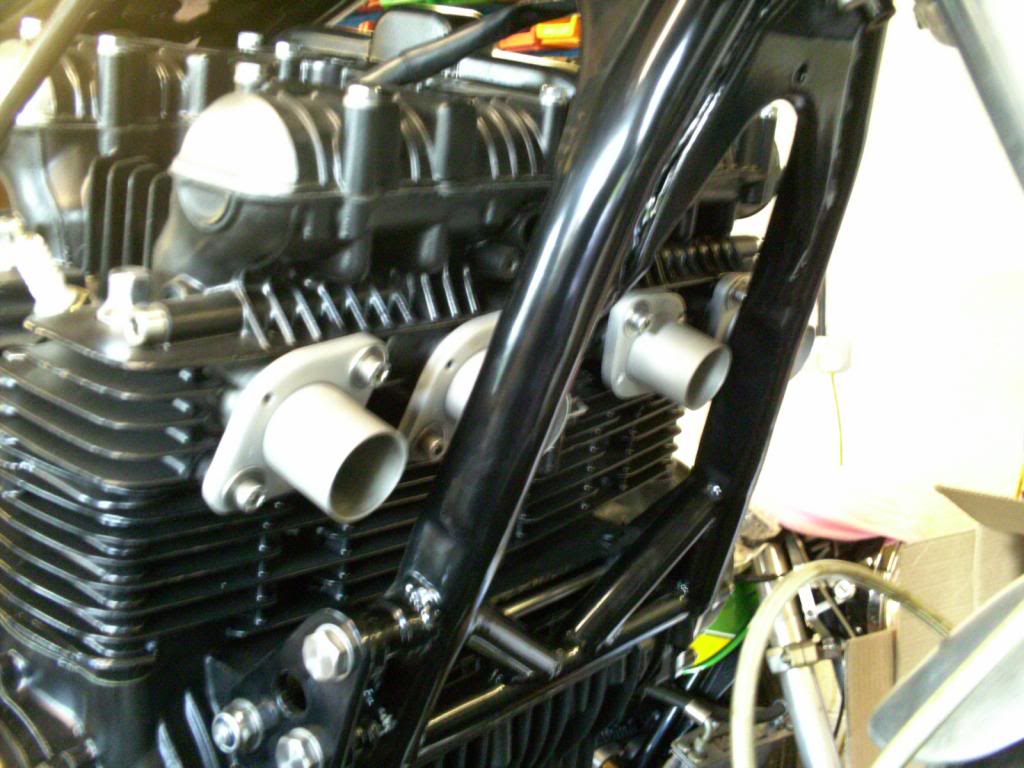

Started by whittling the collars that will sit in the head out of some stainless plate .
These are a very snug fit and won't need any gasket just a token smear of high temp silicone to seal.
Four short lengths of exhaust pipe were cut and some unknown stainless flanges i had lurking about were bored out to suit the pipe
Put them all together with some flared sleeves welded midway for the flanges to push against
And i have a set of spigots ready for some slip on downpipes.

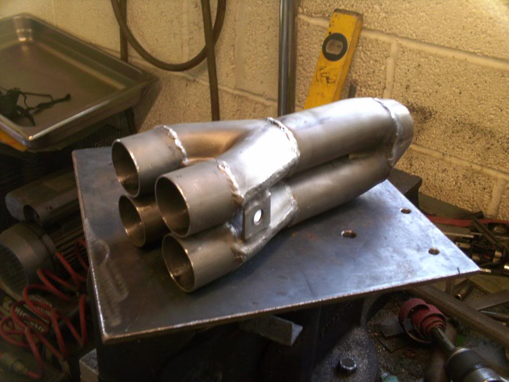

Next job was to construct the 4-2-1 collector .
A couple of reclaimed r1 and a zx9r exhaust systems donated their organs to the cause.
Now to conjure something out of this lot to link everything together. :wink:

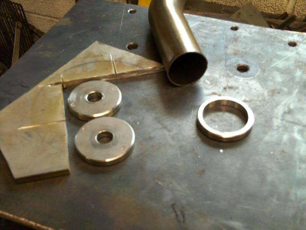

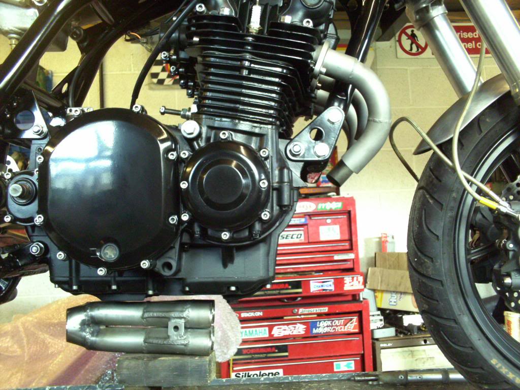

#240 PostAuthor: zed1015 » Wed May 22, 2013 6:55 pm

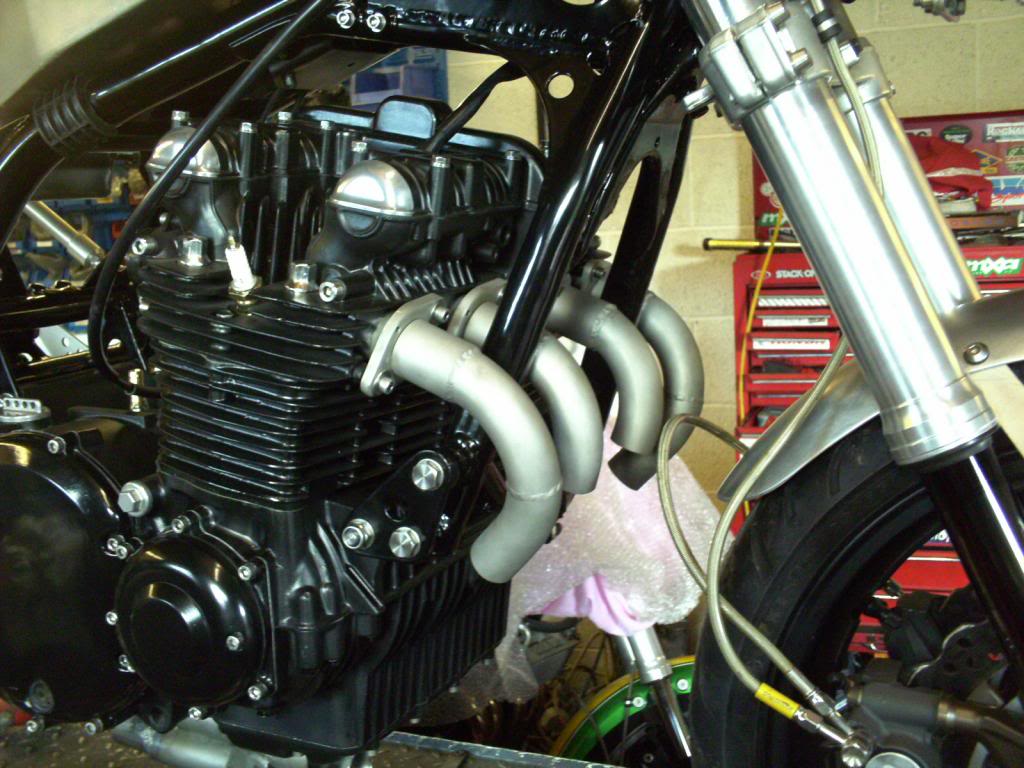

First bends done out of the head.
Outer pipes have been left extra curvy until the middle two are connected to the collector and i know what angle they need to be .
