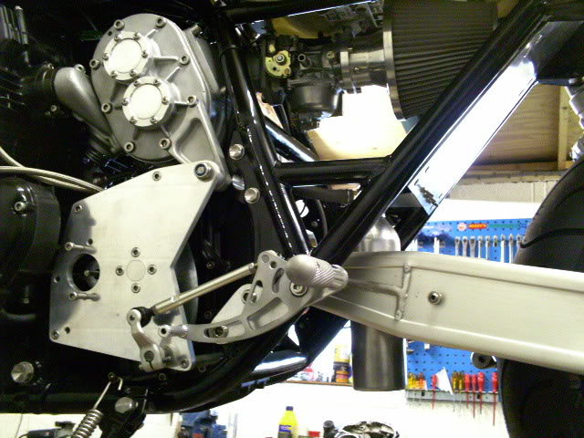

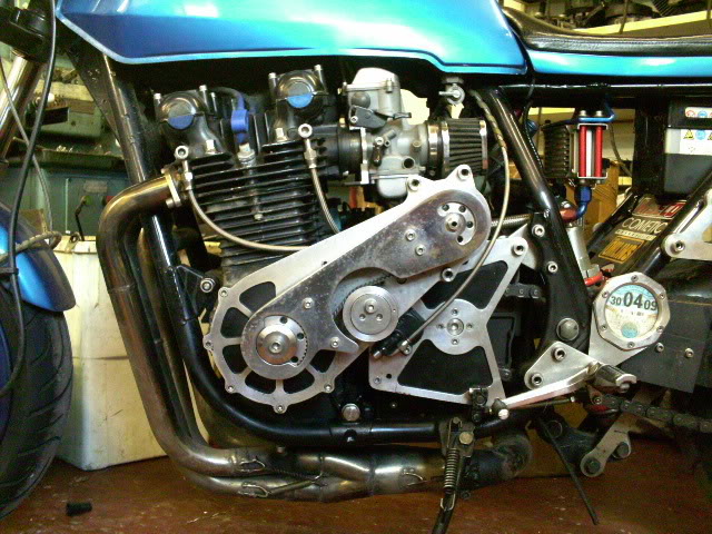

Can I ask you what sort of a set up there is to keep the chain from catching the front side of the back Tyre? I have GSXR running gear on my Z1 B with a dk out rigger front sprocket but practically no clearance.
Kind regards
John
Posts: 4040
Re: Supercharged Z1000
#262 PostAuthor: zed1015 » Sun Aug 09, 2009 2:52 pm
john wrote:Can I ask you what sort of a set up there is to keep the chain from catching the front side of the back Tyre? I have GSXR running gear on my Z1 B with a dk out rigger front sprocket but practically no clearance.
Kind regards
John
On my Z1R with ZXR running gear and 180 tyre (the widest practical) i've got a 5/8 offset front with home made outrigger bearing support and rear sprocket carrier with 8mm machined off the face to line it all up .With a 630 chain it runs very close to the frame and tyre but does not touch. I also made a polyethelene chain runner ( seen next to the tax disc in pic 1) that guides the chain and reduces side to side momement. On the Drouin i've got the same set up (pic 2) but going to a 530 chain which should give some more clearance but still may fit a chain guide just to be sure.

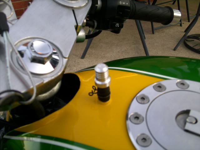

Along with a new gel battery i picked up this dinky motocross tank breather off evil bay which despite suspicions actually works.

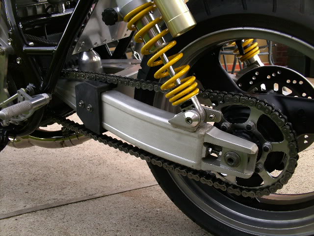

The 40t JT rear sprocket also turned up on saturday so i finished off machining the wheel adjusters and fitted a new chain .
A short trip this morning to the local plastics supplier provided a block of polyethelene which i've carved into a chain runner this afternoon and bolted it to the swinger
