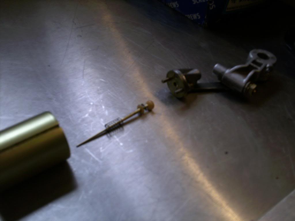

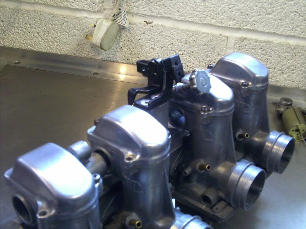

A few carb pic's as promised.
Getting prepared for the carb rebuild.
First pic shows modified cable bracket which now takes the std zx10r cables i'm using.
A much better solution than having to make one off cables every time they need changing.

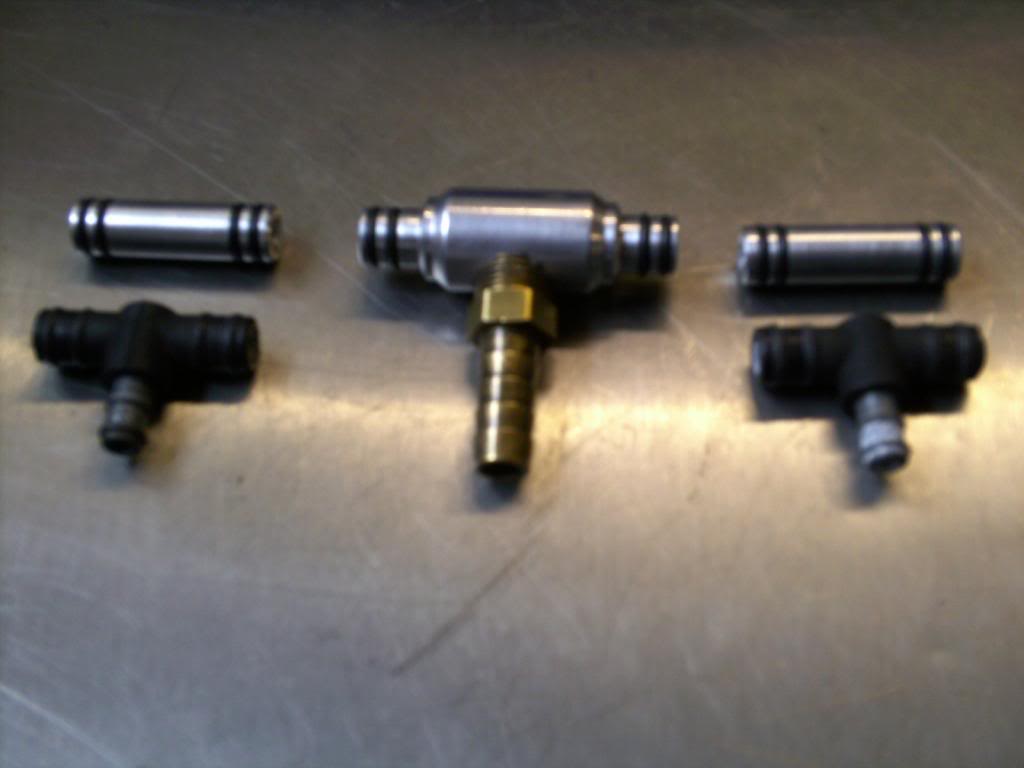

The original fuel tee's were dried up and loose and also set up for twin feeds.
I've turned up some snug fitting alloy, Viton 'o' ringed big bore replacements and converted to a large bore single feed to match the single fuel tap.
The internal fuel passages to the carb float needles have also been enlarged to take full advantage of these
With the carbs being bored out, the needles need lifting to compensate as they now sit lower in the needle jet.
Exact carb bores are now 29.4mm so needles need lifting half of the 3.4mm increase = 1.7mm.
By a stroke of luck the needles are sprung loaded with a plastic spacer either side of the clip.
Top spacer is 2.5mm and bottom spacer is 0.8 so as if by magic swapping the spacers over gives the 1.7mm lift I need.

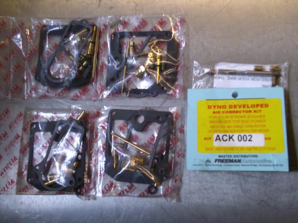

The actual bodies I'm using are GS750 which have both fuel and air screws so i'm replacing all the internals with GS1000 keyster kits and i've also sourced a GS1000 ledar air corrector kit for when I fit the bellmouths .
