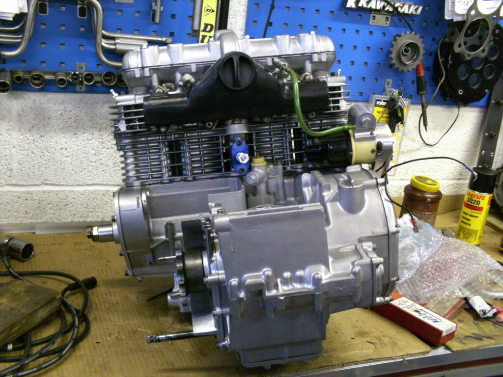

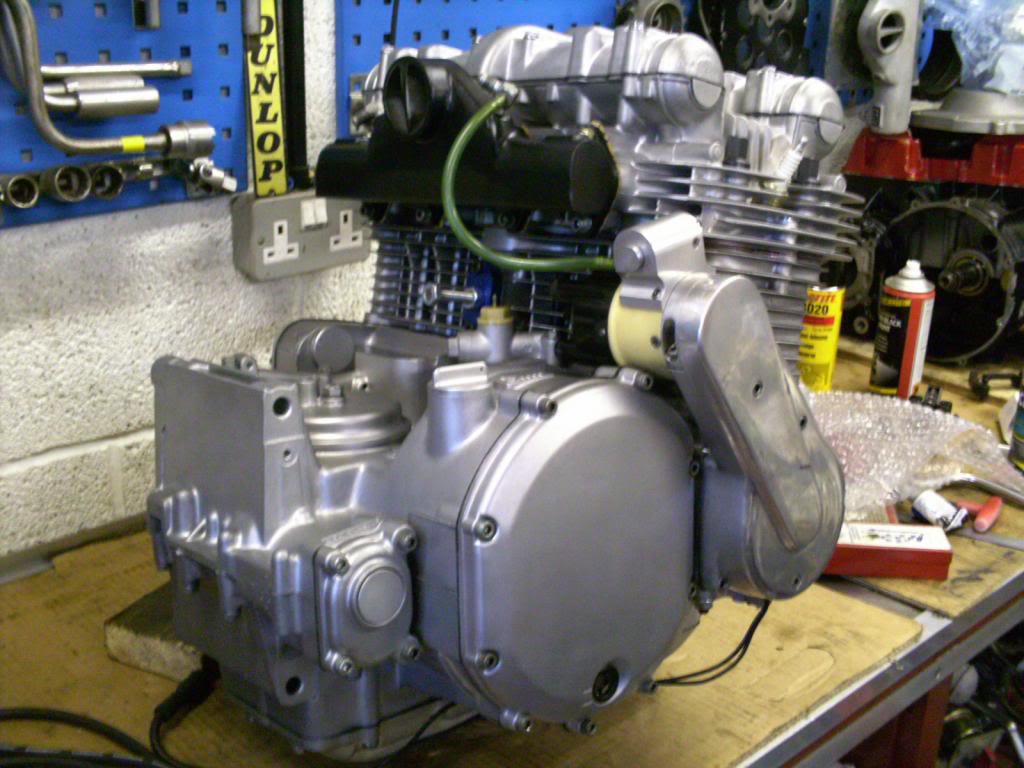

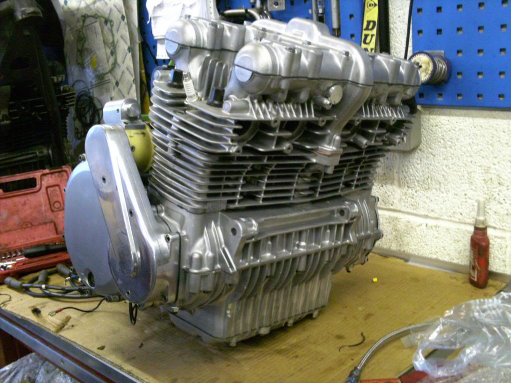

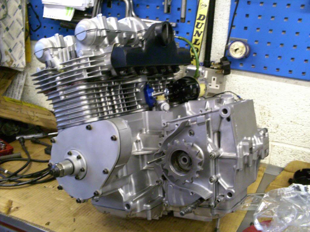

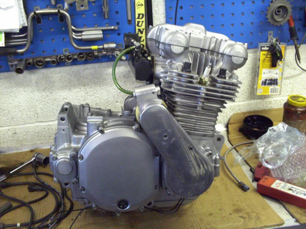

Few pic's of the finished lump.
Now with bill hahn ignition and plenum .
Later model camcover is fitted to keep the oil in until an early one is sourced.

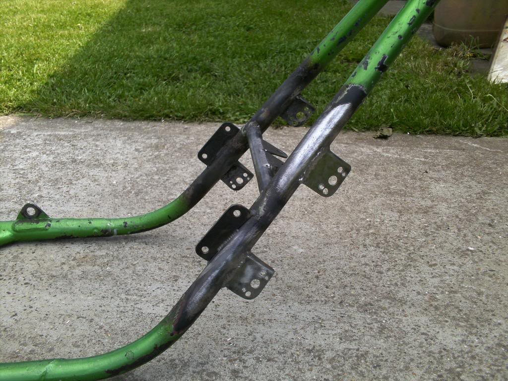

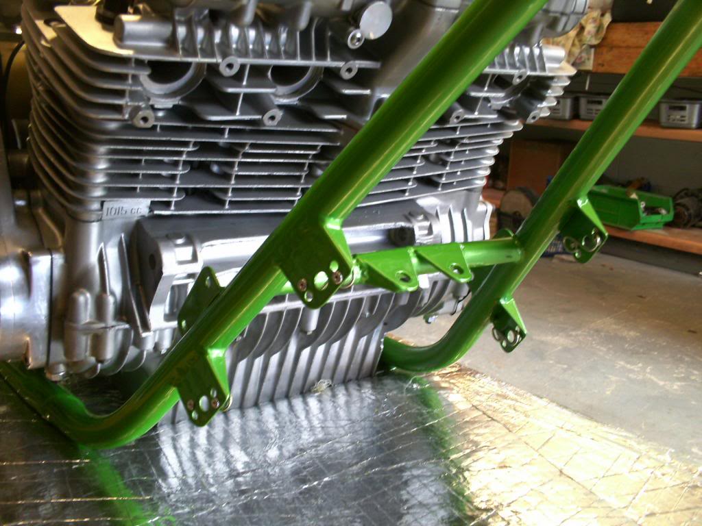

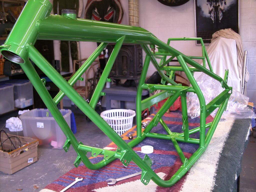

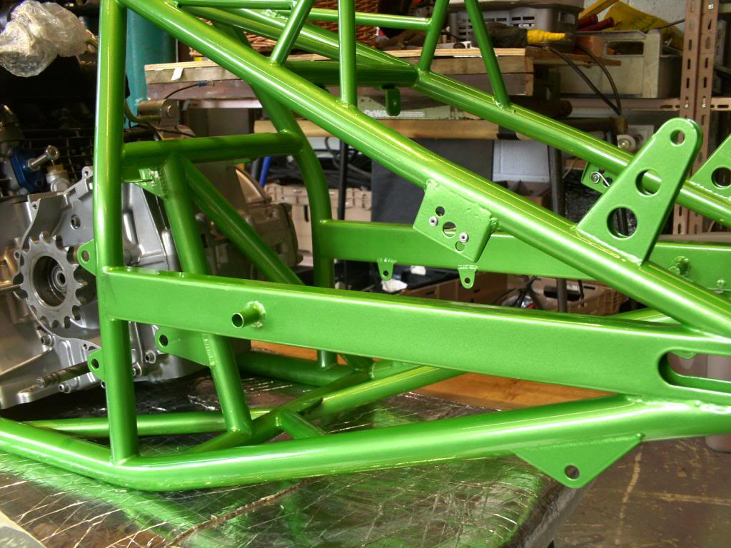

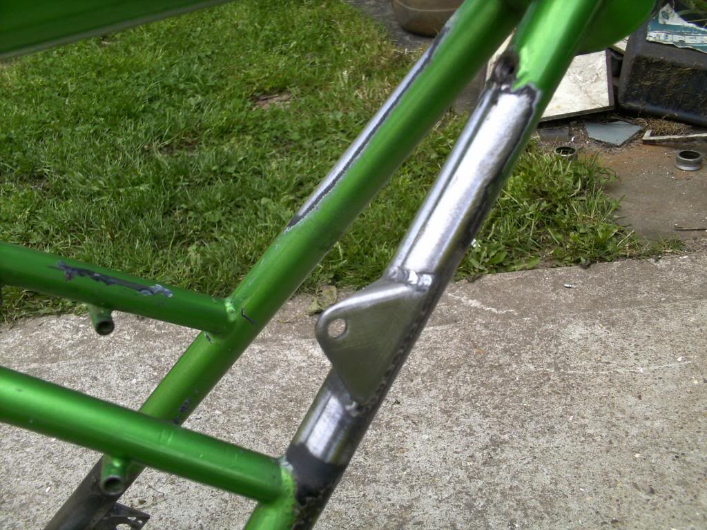

Frame.

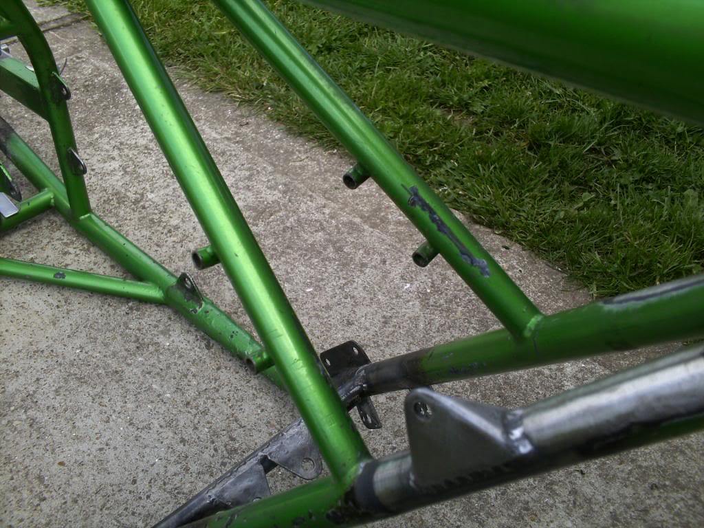

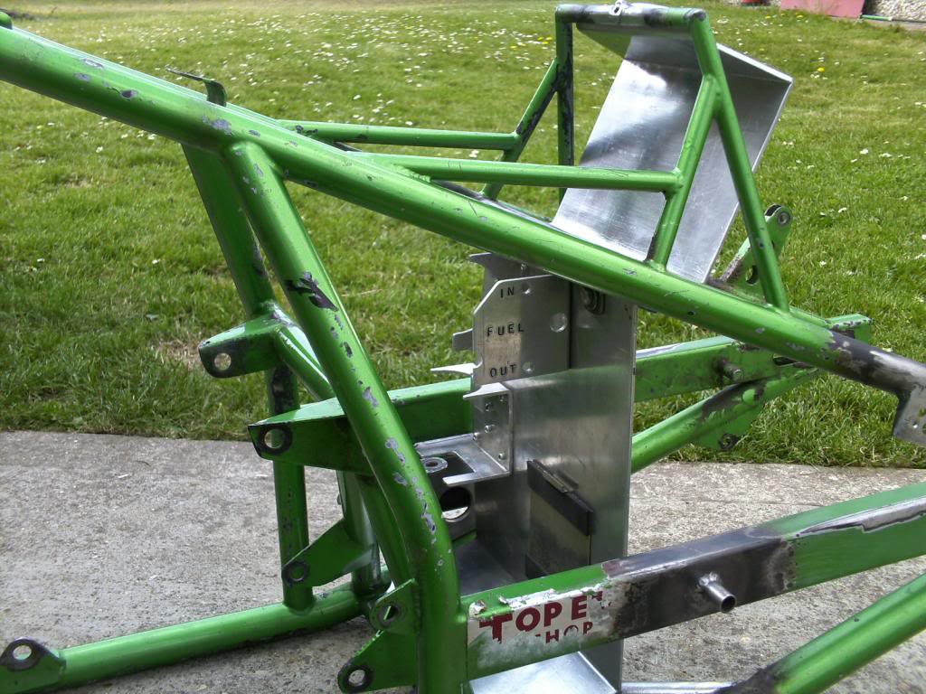

Nearly everything on the frame was zip tied or 'P'clipped on and it was all a bit shite so we took the opporunity to add some proper brackets and tidy things up a bit
Front got some tags for the bellypan/scoop dzus fastners.
And a proper mount for a steering damper

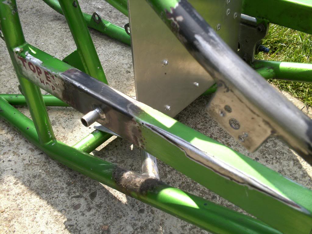

Rear got more dzus brackets for the seat and a tube welded through the chassis to take the airshifters fixing bolt.
Previous there was just a hole through the box section for a bolt which crushed the box section when tightened.

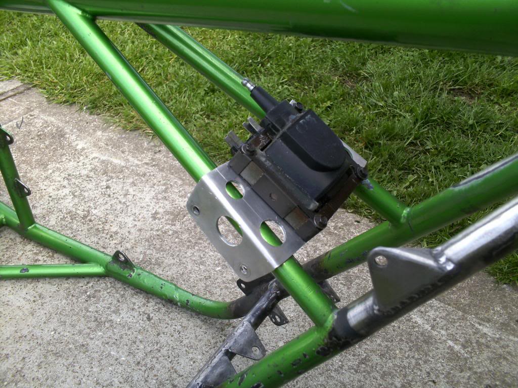

Ignition coil was originally slung off these tubular mounts with some zip ties
So some alloy brackets were whipped up to make things look more professional.

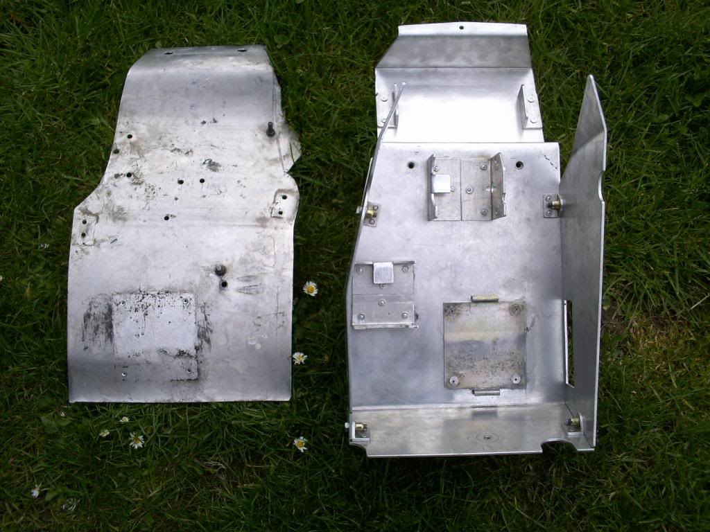

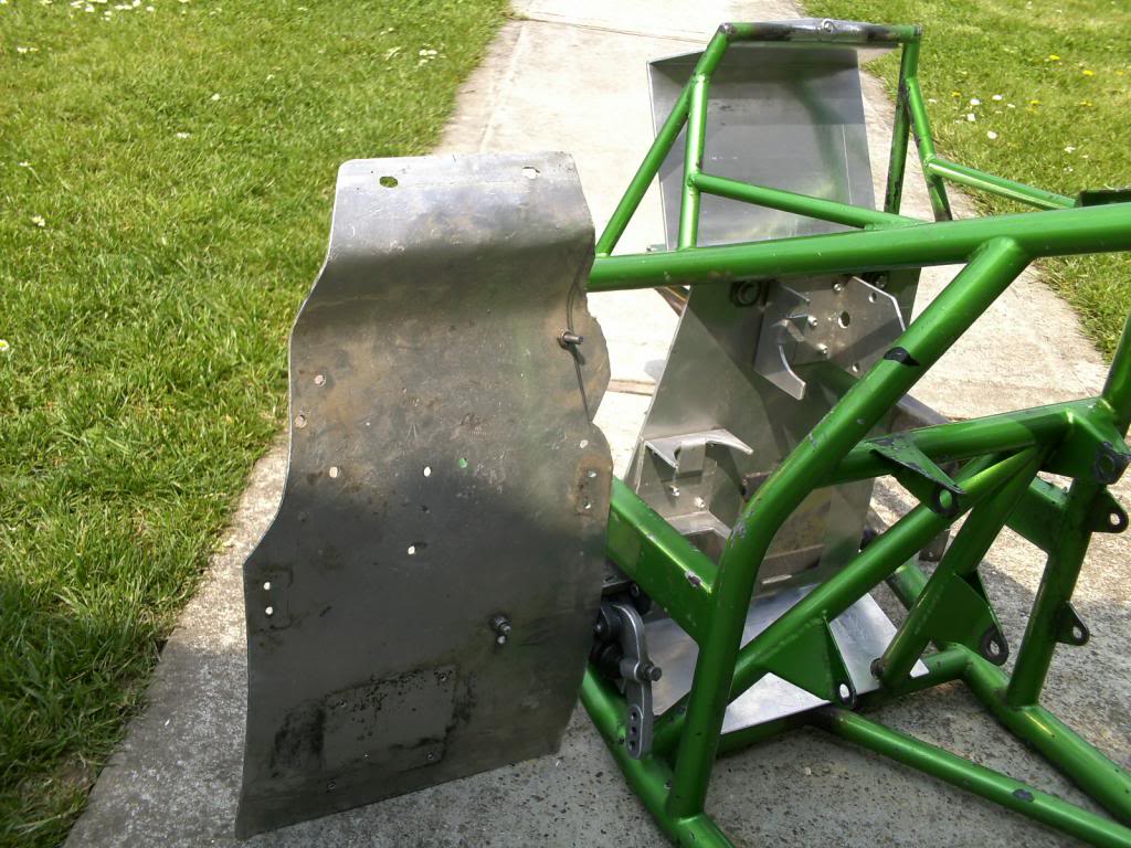

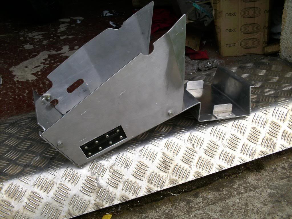

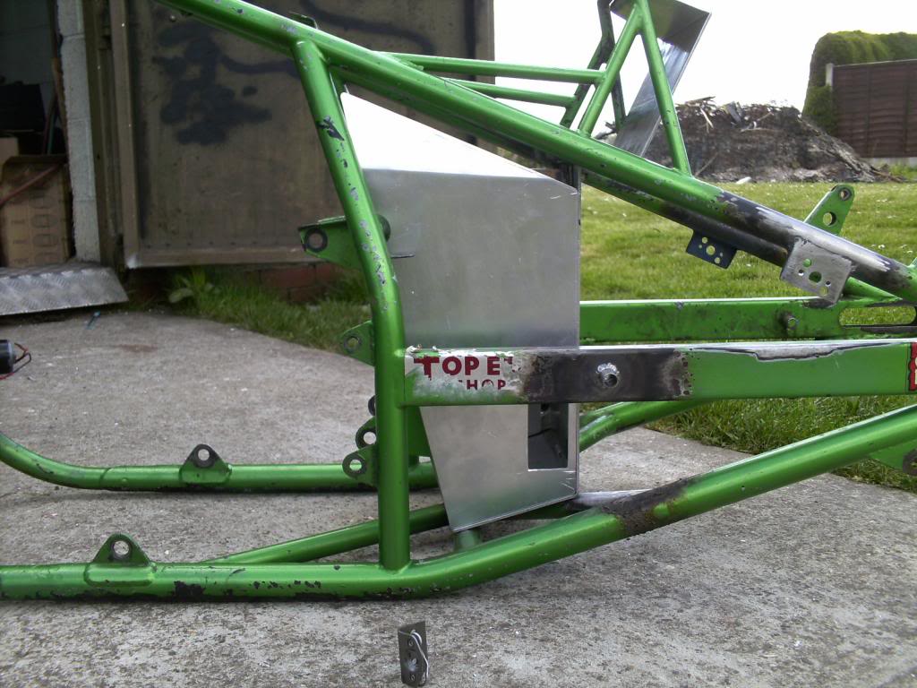

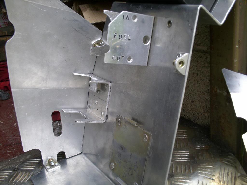

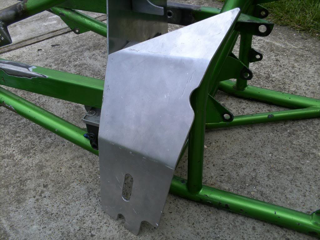

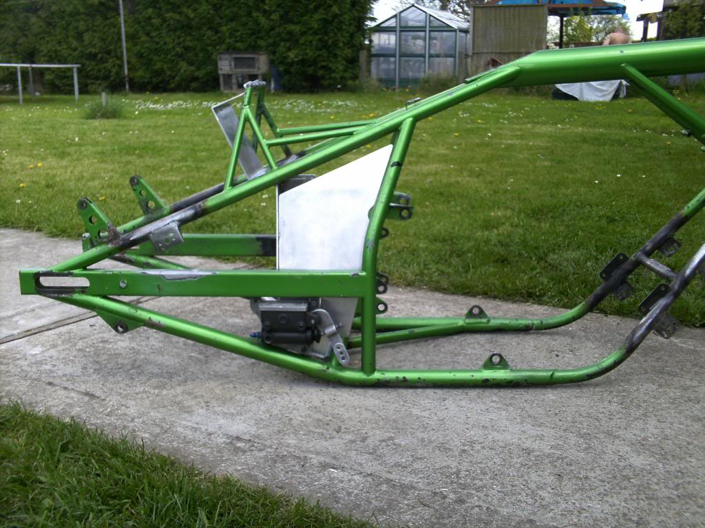

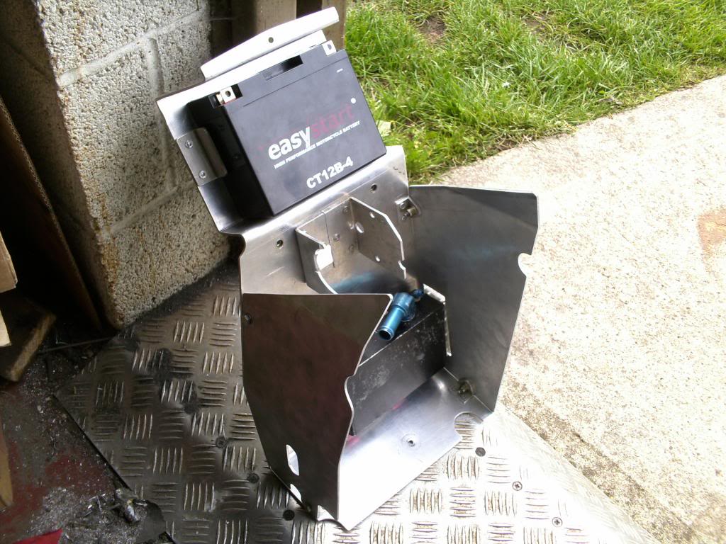

Next job was to make a decent rear mudguard / battery box with oil and fuel pump mounts
Orrible original item is on the left.
Again this was attached to the frame with zip ties and all the pumps etc were mounted to it in the same way

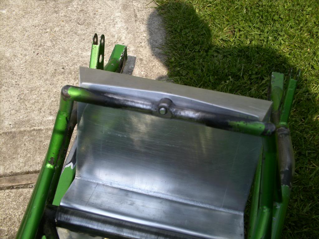

A threaded lug was welded into the seat subrame
And a couple more tabs to a cross tube below the new battery box hold my improved version in place.
A couple of side panels were made to hide all the gubbins then bent ,cut about and trimmed until they could be removed without fouling the frame etc
Unavoidable large gap at the top won't be seen when seat is on.
Slot in left side panel allows turbo oil tank level to be checked
Pumps will sit in these alloy saddles, Fuel at the top and oil at the side and all power switches etc will be on the left side panel
A slight improvement on the original ?

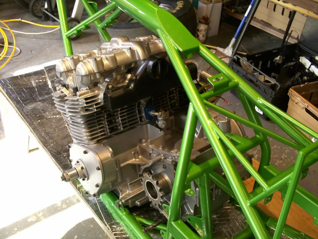

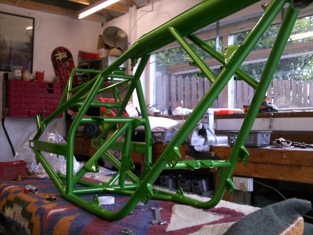

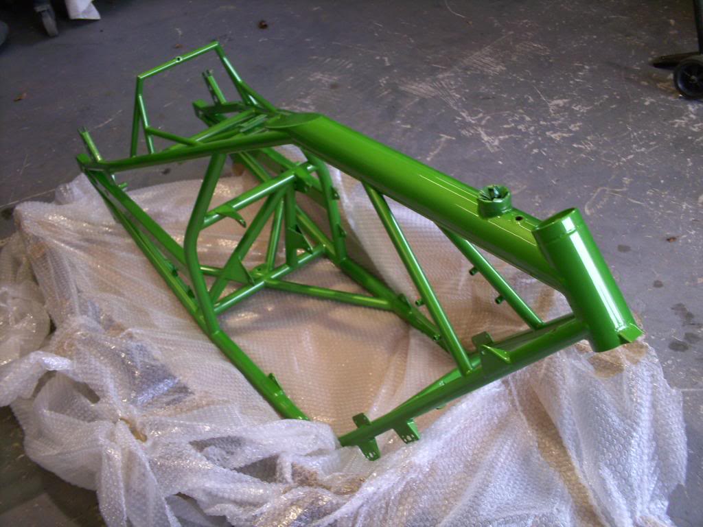

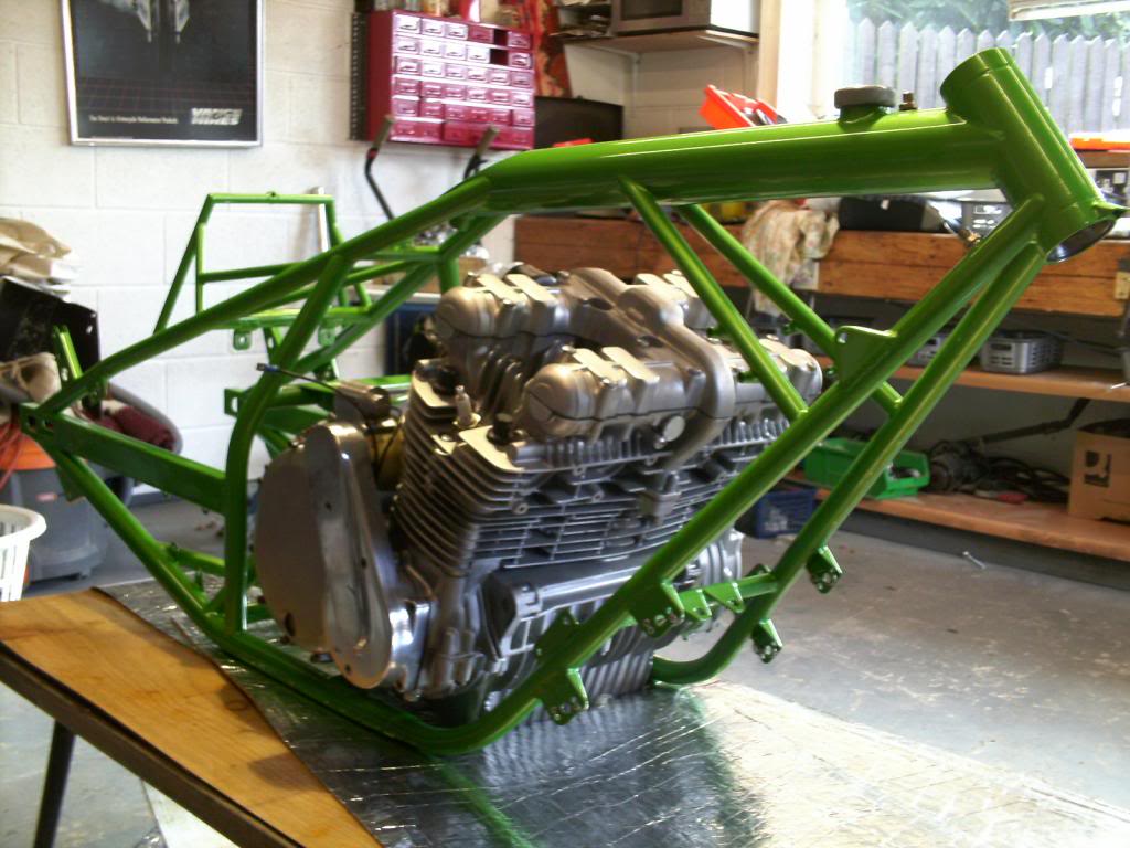

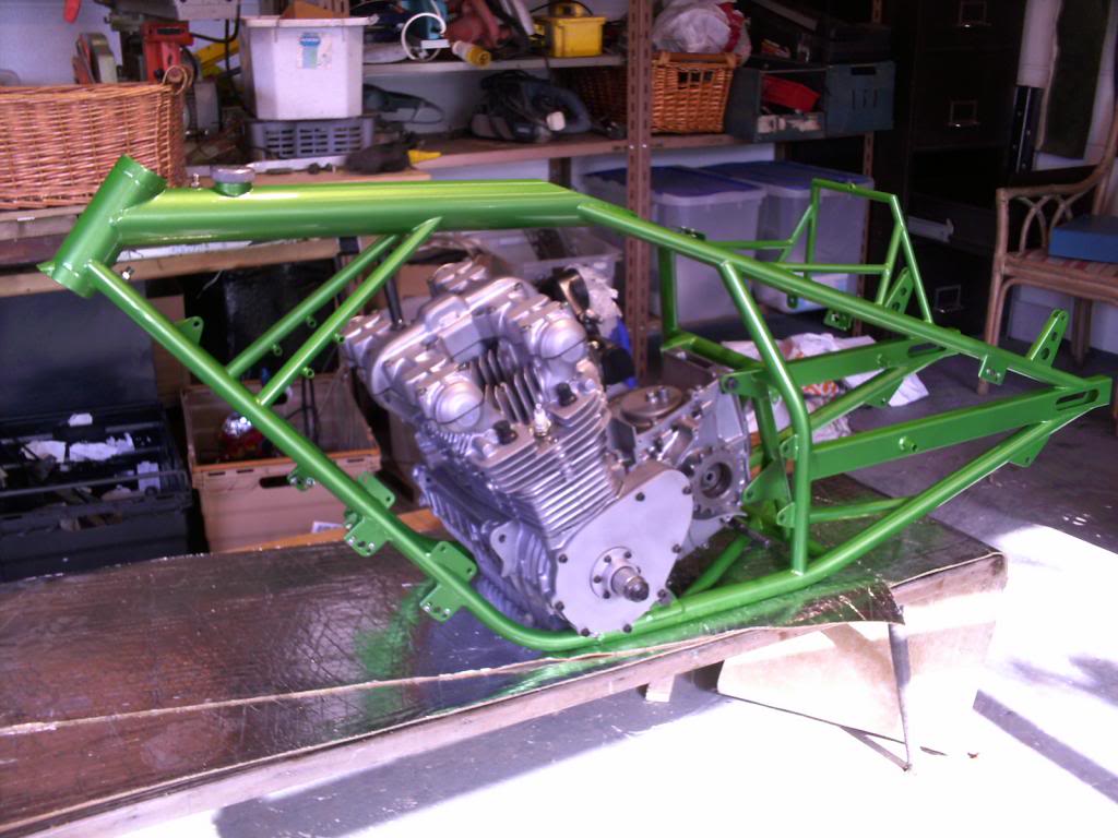

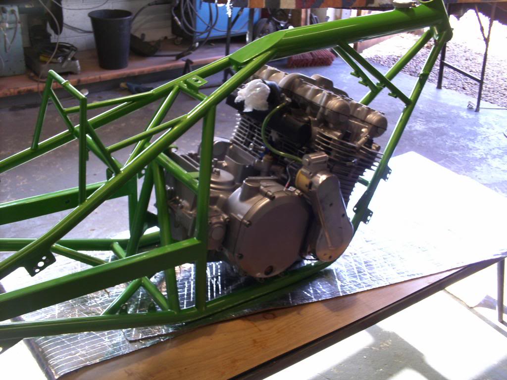

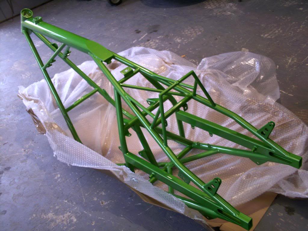

Frame mods finished and back from powdercoaters.
Dzus wires fitted.
And engine in.
