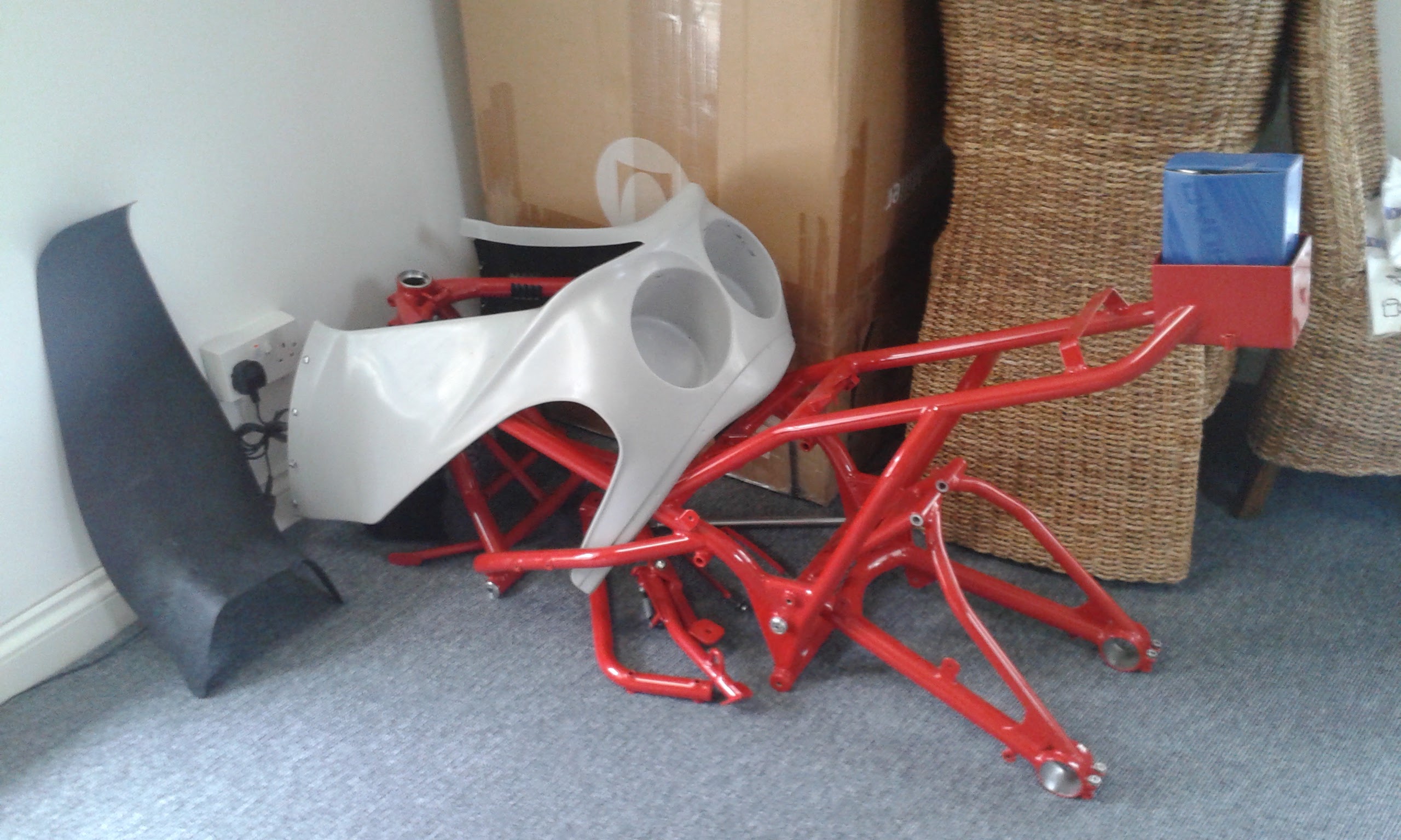

I dropped of the frame and bits to Harris in mid-feb 2016.... and collected them a couple of weeks back. To be fair to Harris they did tell me they'd finished just before Christmas so it 'only' took 9 months.
My recent free time has been spent on all this forum migration malarky but as soon as that's all done I'll be back on it. Plan is to have it back in service this summer.... well that's 'The Plan' - no doubt Real Life(TM) will alter it.
