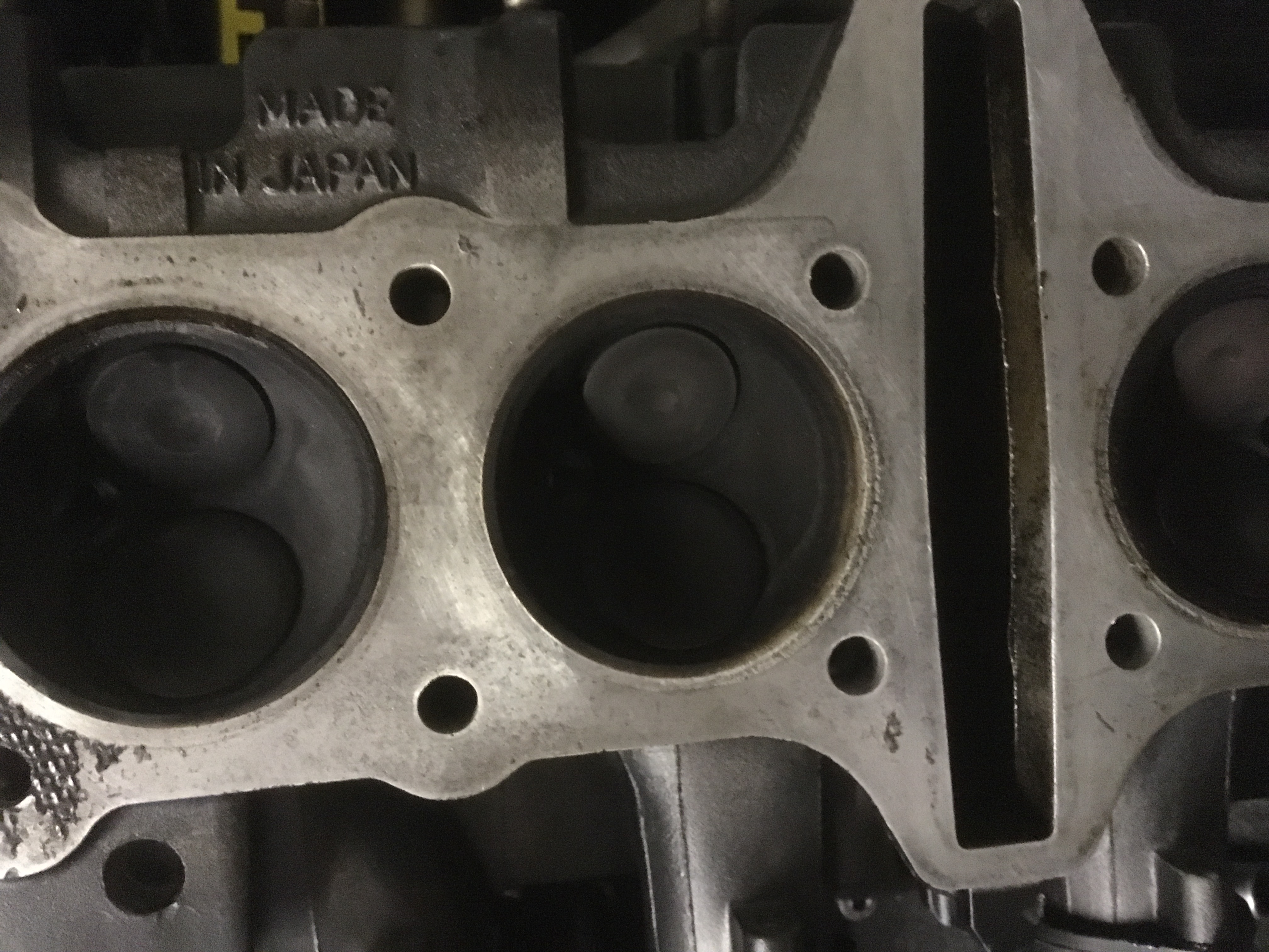

#34 PostAuthor: cakeman » Fri Sep 28, 2018 6:01 am
Here's a picture of the head.

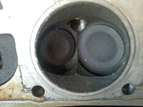

#35 PostAuthor: zed1015 » Fri Sep 28, 2018 7:53 am
It's hard to tell in the pics with all the carbon and shadows but that doesn't look like a Uni head so most likely a B.
If that's the case you want a B or a J head but the thread damage you describe could easily repaired by a good machinist like the head in the following pic that was repaired by Debbens.
Here's a clearer pic of a Uni combustion chamber to be sure.
Note the deeper "Bathtub" area of the chamber where the valves sit.

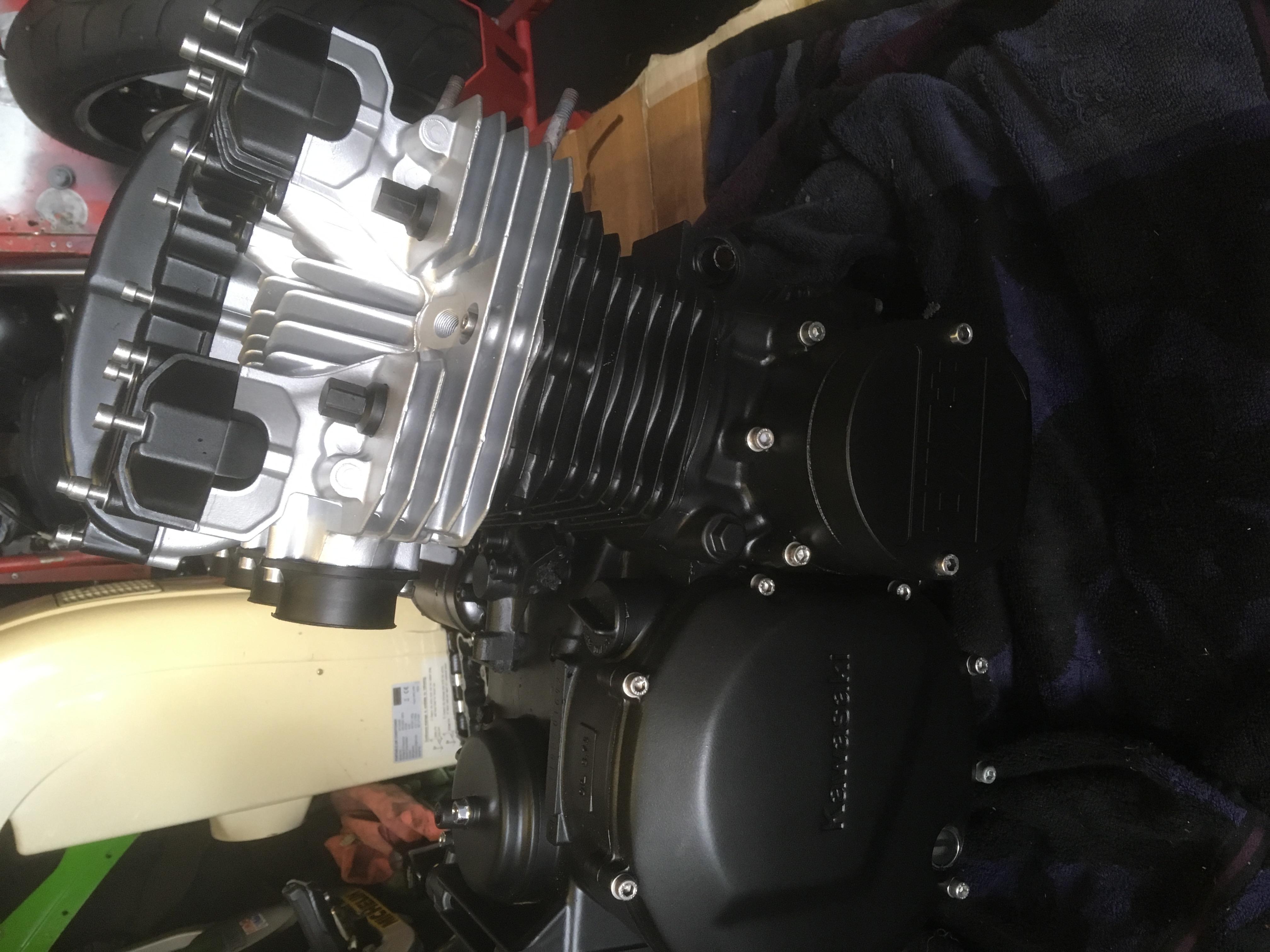

#37 PostAuthor: cakeman » Sun Oct 07, 2018 8:35 am
So, take two, engine assembled with new gaskets, valve seals etc. just waiting for the cam cover gasket to arrive and it’ll be time to put it back in the frame at last.

#38 PostAuthor: Al » Sun Oct 07, 2018 11:16 am
Looks great well done.

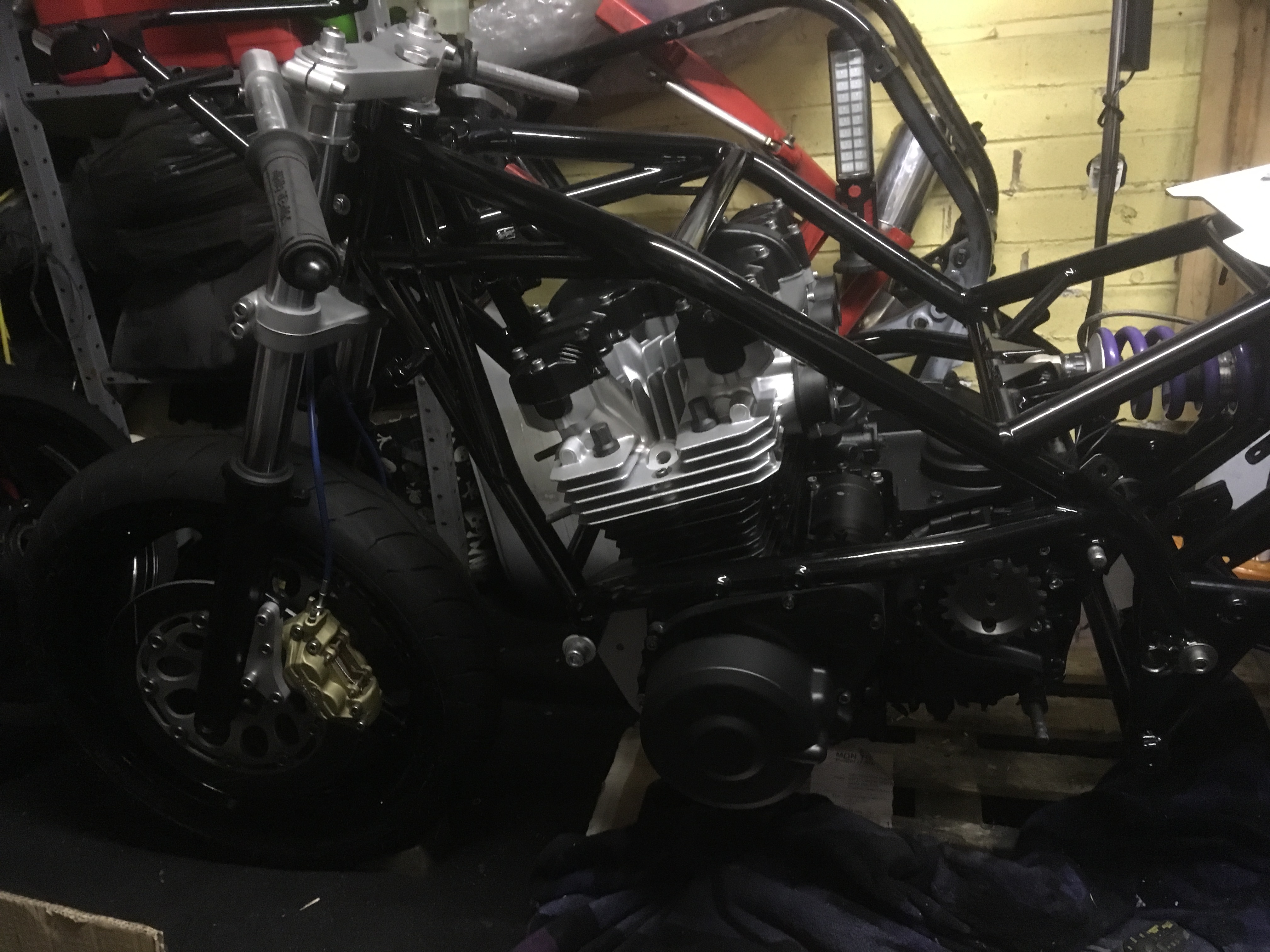

Engine in the frame and forks fitted. Apologies for the quality of the picture, it was late and a bit cramped lol.

#42 PostAuthor: deka » Thu Oct 11, 2018 4:38 pm
Looking good

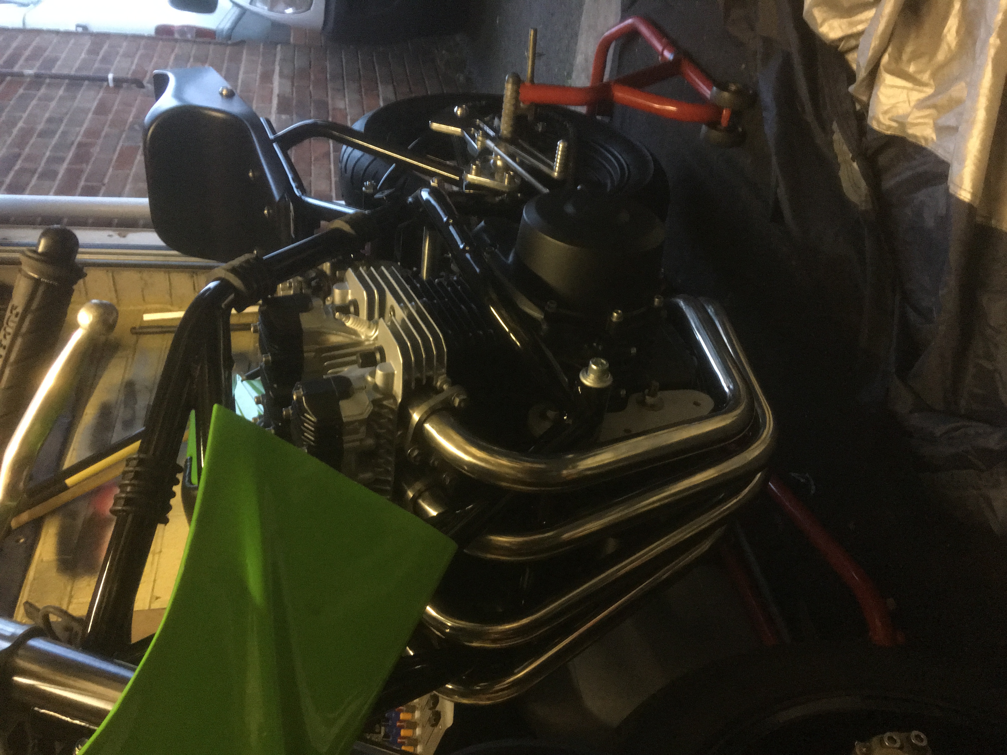

#45 PostAuthor: cakeman » Tue Oct 23, 2018 5:37 pm
Not updated for a while due to picking up some lurgy type bug but have managed a few bits and pieces. Rear wheel and spacers are all sorted, ended up using a gsx750f rear wheel complete with disc, caliper carrier and sprocket carrier, it all lined up to within a mill and the chain run is cock on which was a result, just needed a couple of spacers on the brake side which needed to be 20mm in length and another 25mm long with a 20mm bore and as luck would have it found the exact sizes on eBay for £16 in stainless. Also ordered a set of Delkevic downpipes from D&K which arrived today so I found a bit of time to get them fitted this afternoon, must say the quality is great and they fitted perfectly, very impressed for £170 and I only ordered them Monday afternoon. Here’s a pic.
