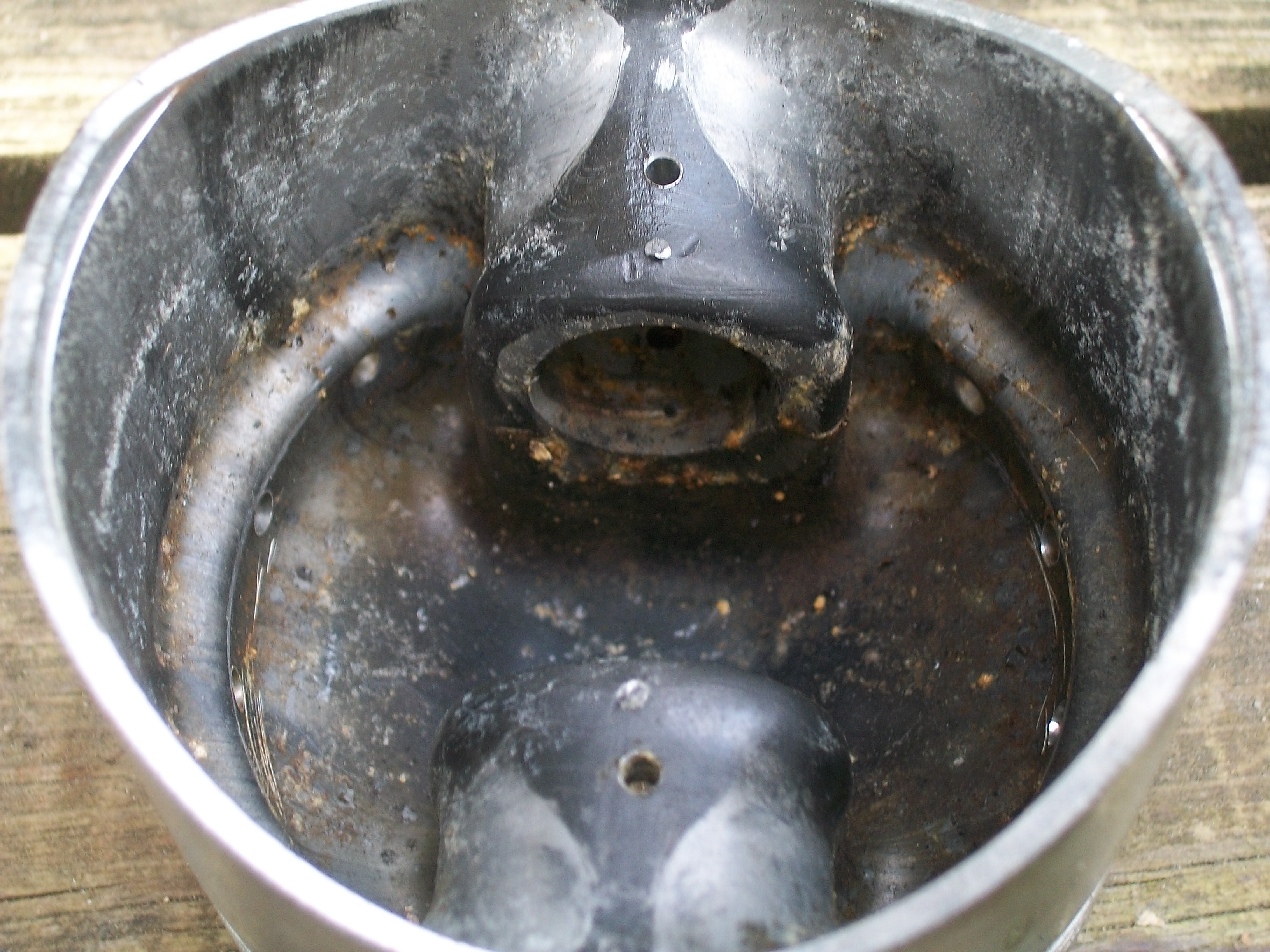

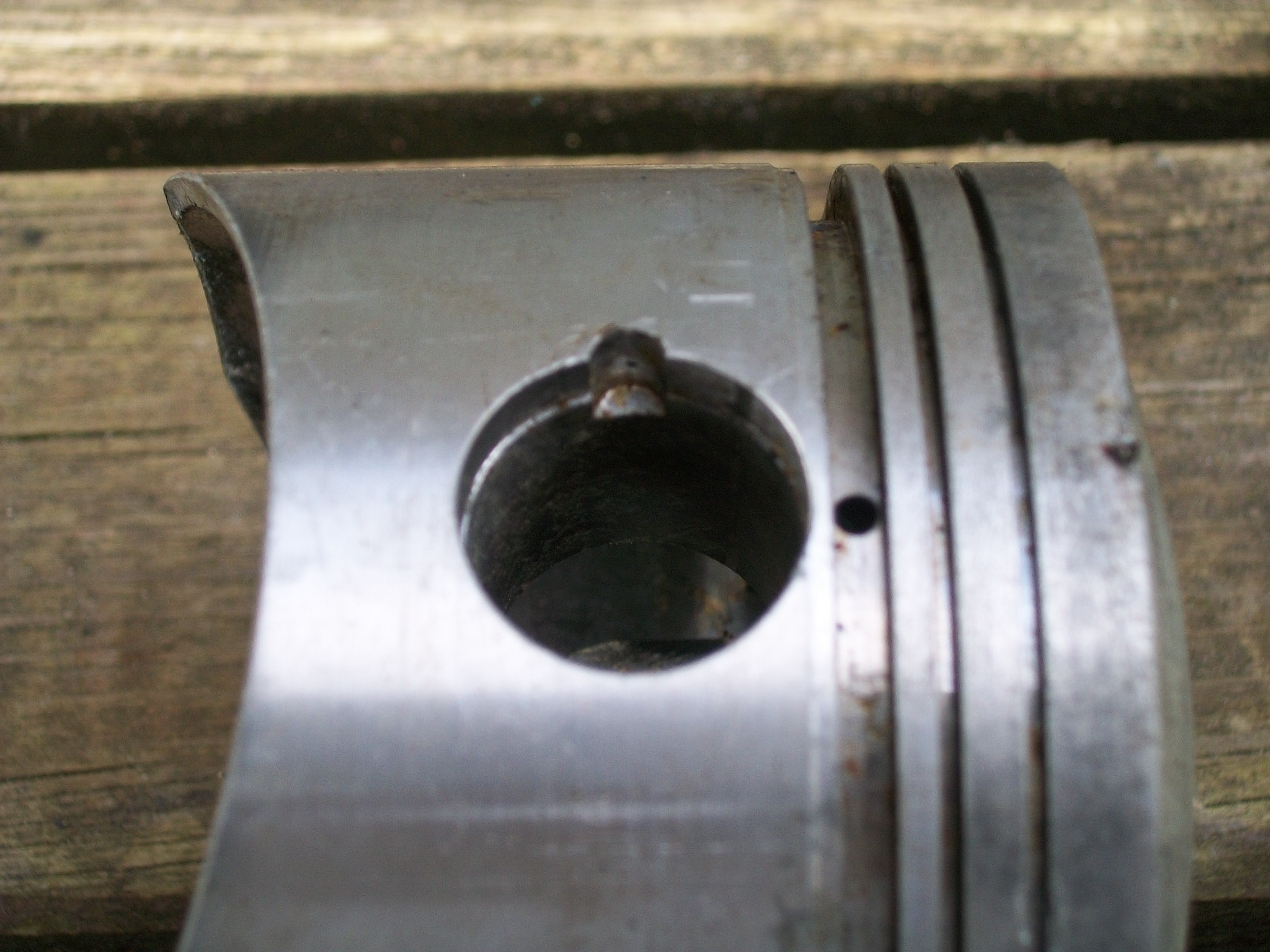

Here's a clearer picture of the spare pistons if they can be identified?.

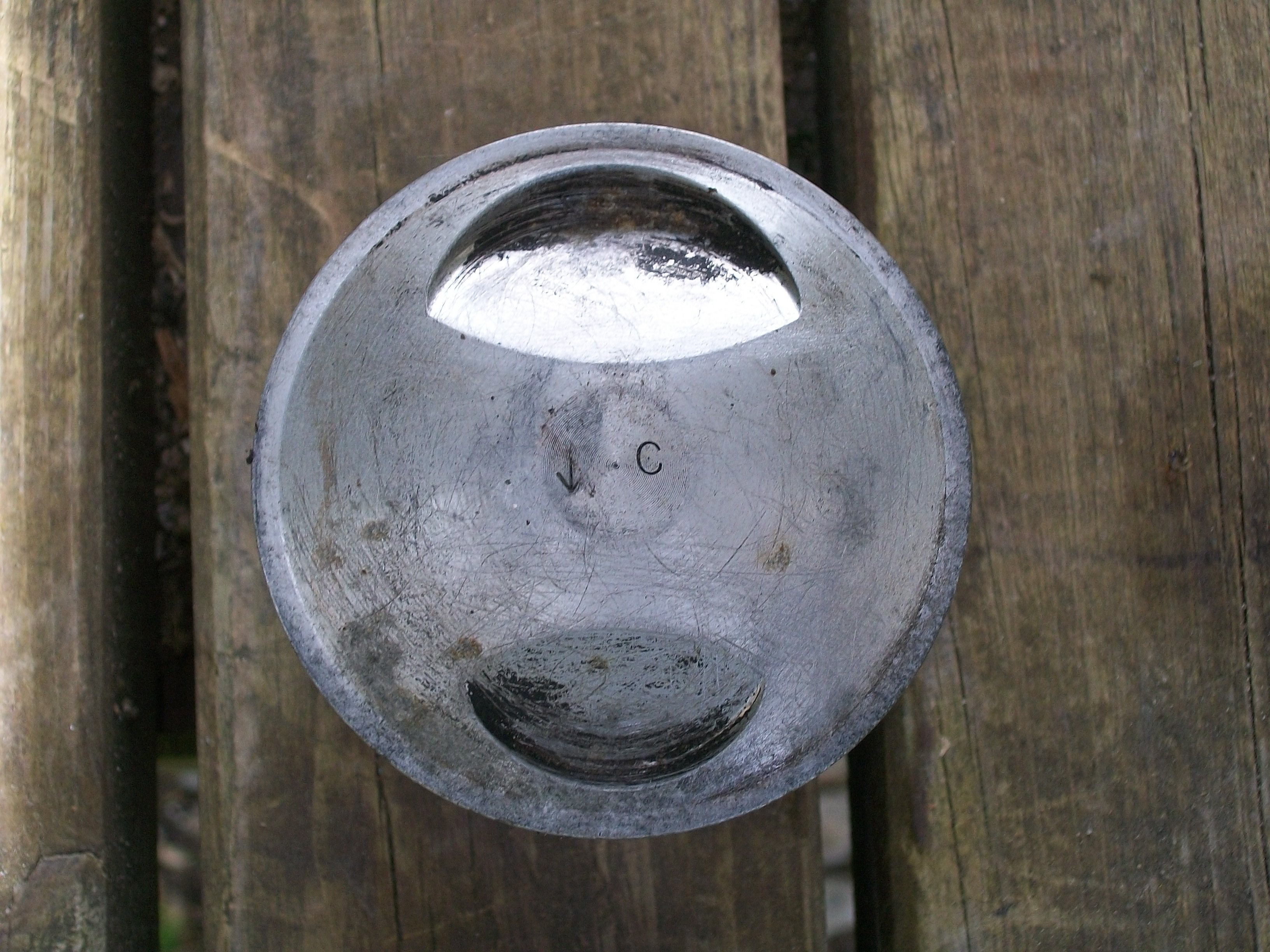

They look very much like Wiseco or MTC but have no markings so anyone's guess.
C mark should denote the XC ring type used.

The Wiseco/MTC's currently use the same make rings and the code XA- XC etc denotes the type preceded by a number which indicate bore size etc.
XA are thinner than the XC's.

Just for reference i have just measured a brand new Wiseco piston and the ring width gaps are as follows. Top and second ring thicknesses are exactly 1mm.
Oil control ring groove is exactly 2mm.
Measured the piston as you may not have rings to compare sizes and the bottom assembly of three parts would be sketchy to measure accurately.
These are the XG ring format.

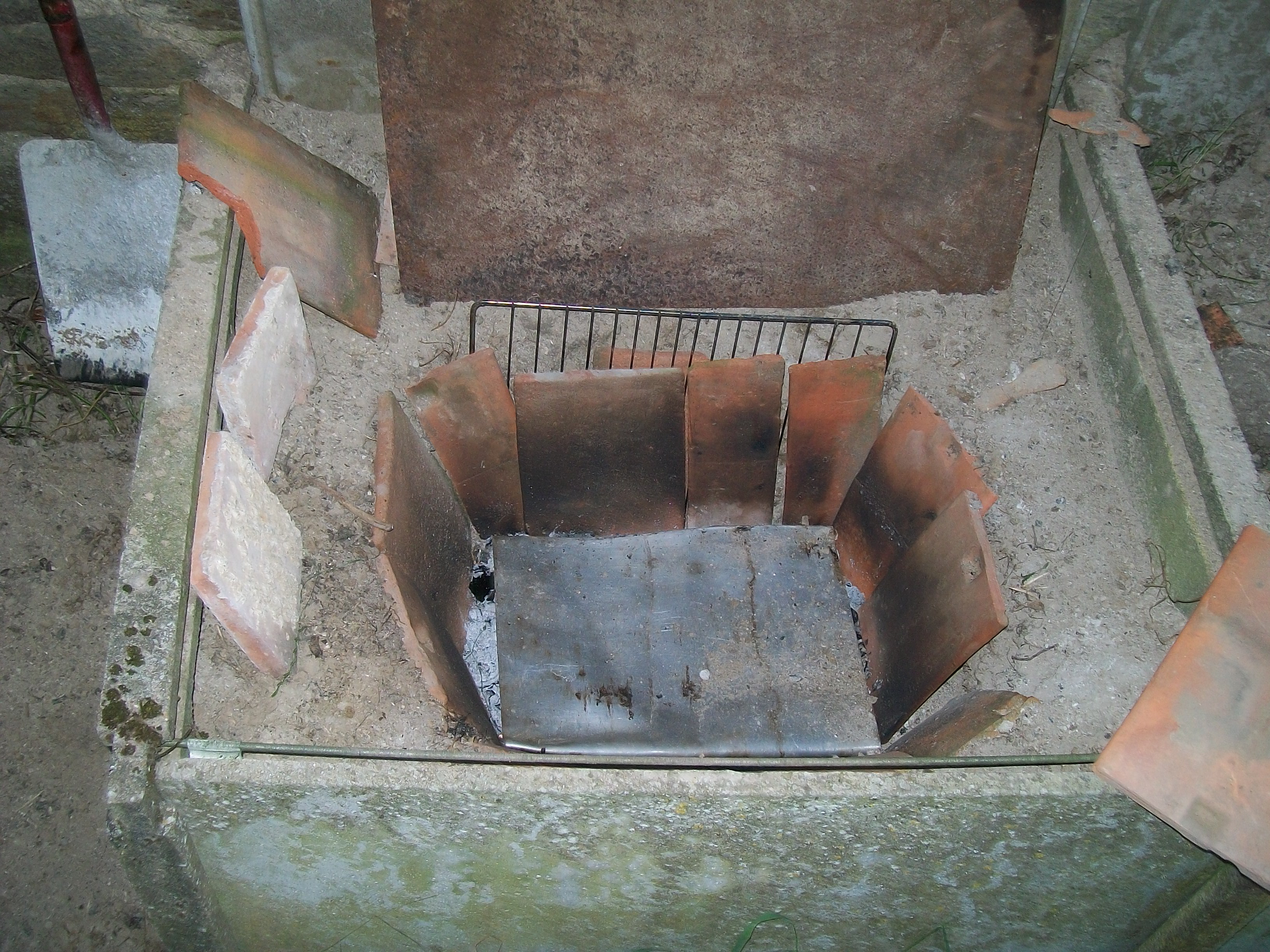

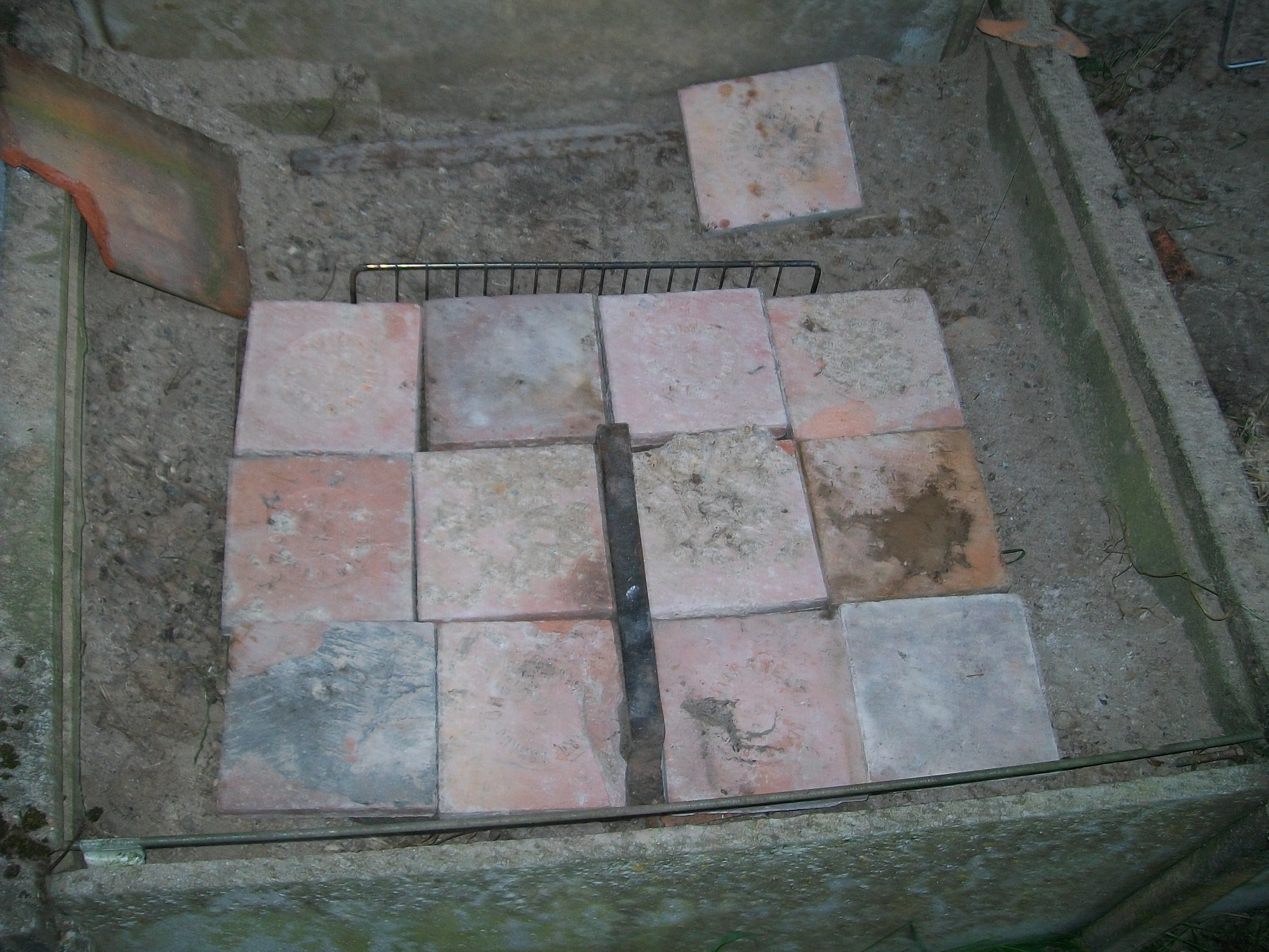

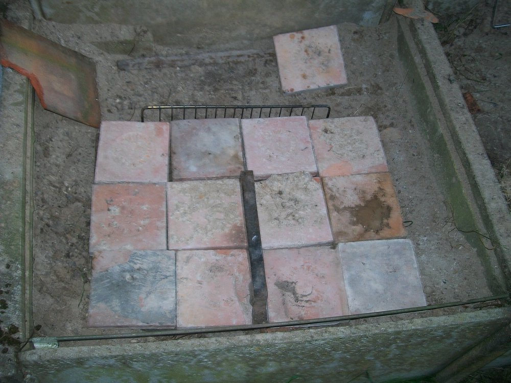

Got the liners out today from both sets of barrels. Didn't want to move at less than 170 degrees though. (I haven't got a press so wanted them to hand push out or fall) The first set gave me some fun, 170 degs, 3 came out, 1 got stuck an inch from coming out, then it had cooled down too much and was now too big to fit in my spare oven (didn't want to use the one in the kitchen due to oil fumes etc.).
Being somewhat buggered now, built this
The embers are under the tin sheet with small roof tiles and 1/2 inch floor tiles for insulation all in a rabbit hutch turned on it's side (not a hutch for kids to look at them in....). It didn't get it hot enough to get last liner out but it was hot enough to get it back in and now it fits in the oven again. Back in the oven at 200, sorted.

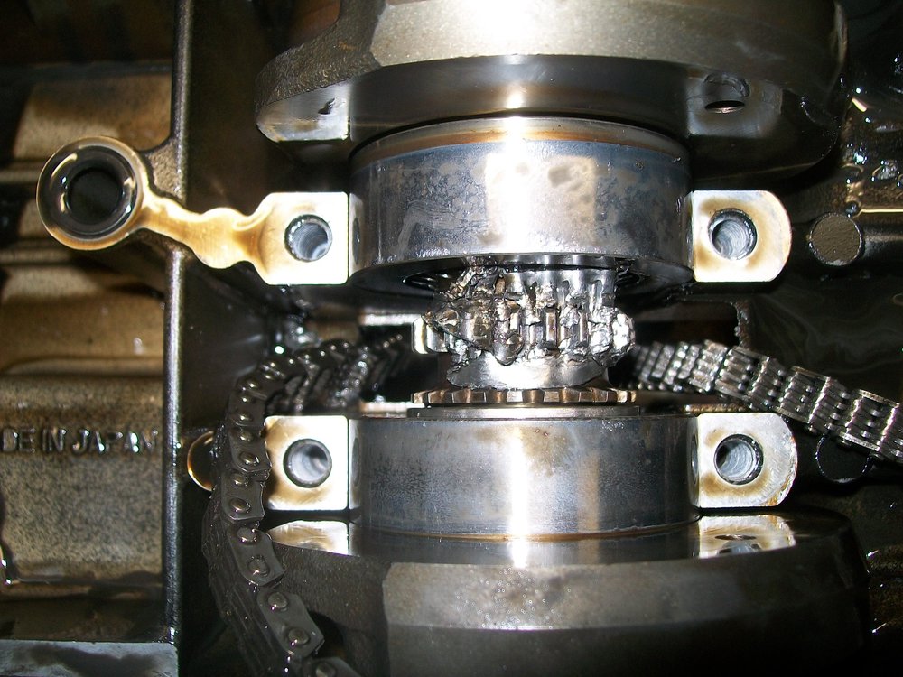

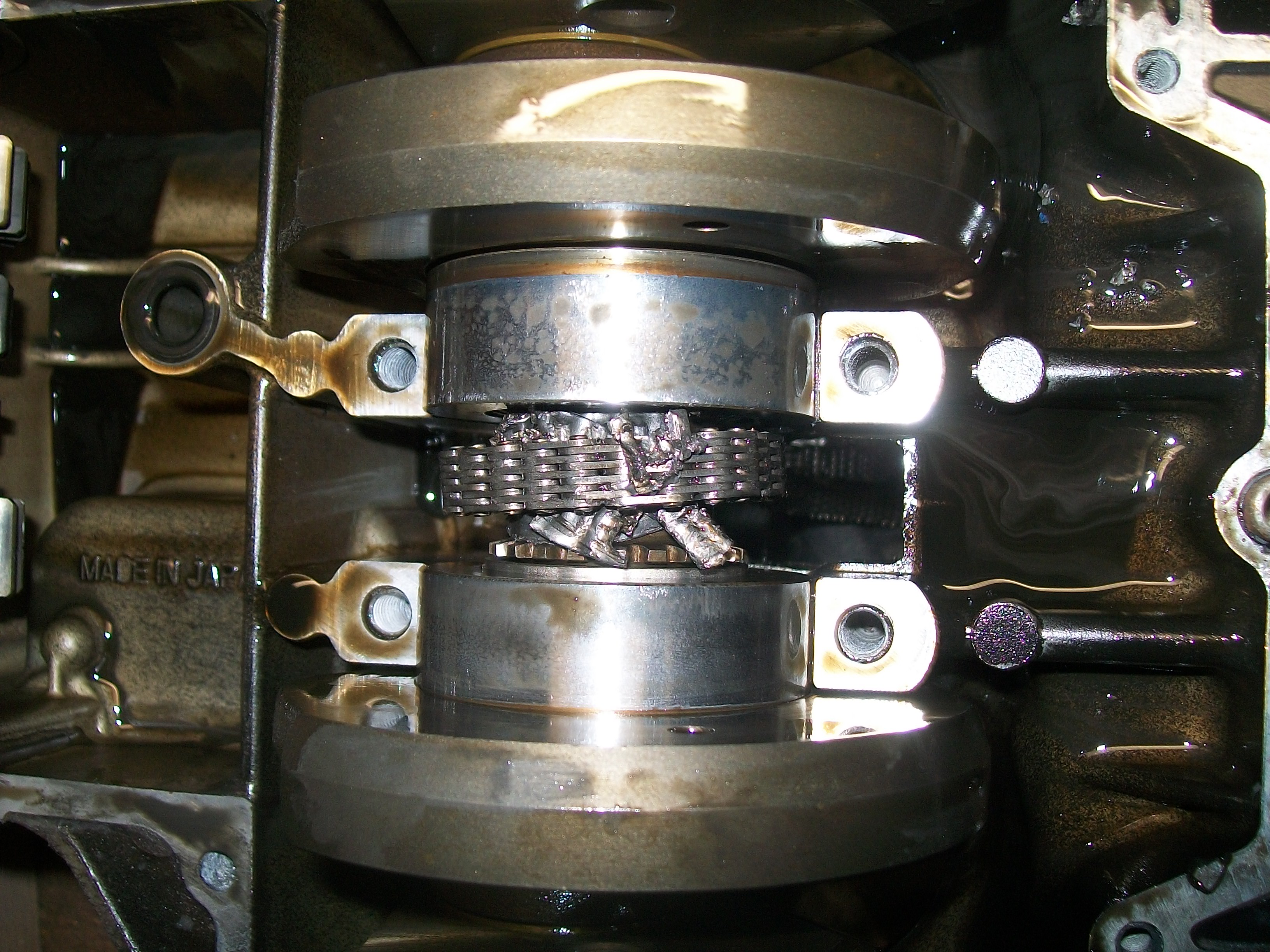

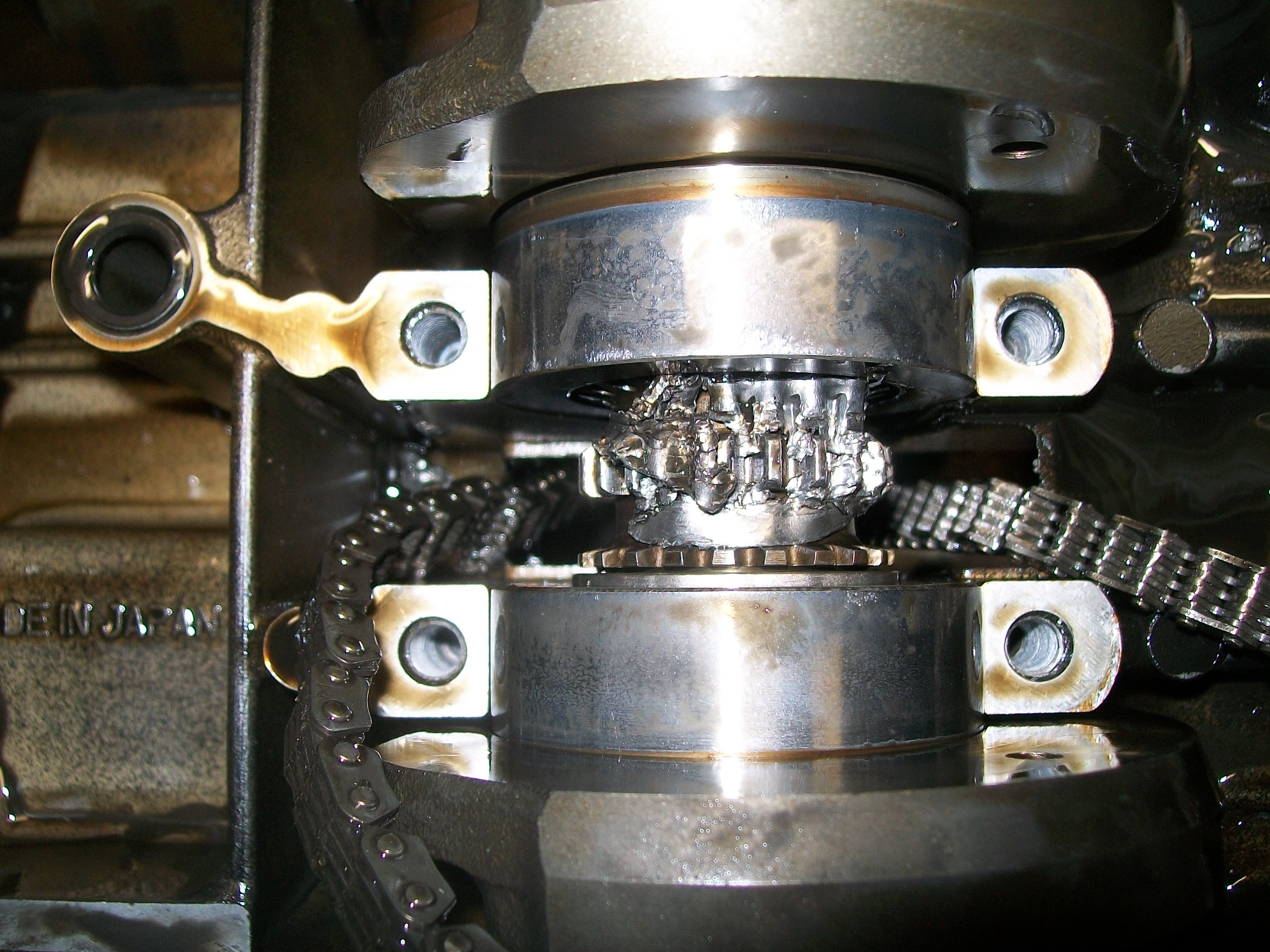

I think I know why the engine locked up..
The lump off swarf around the teeth looks like a bit of chain. The chain in the bike is damaged but I don't see that much missing. Thinking it maybe a bit of the old broken chain?

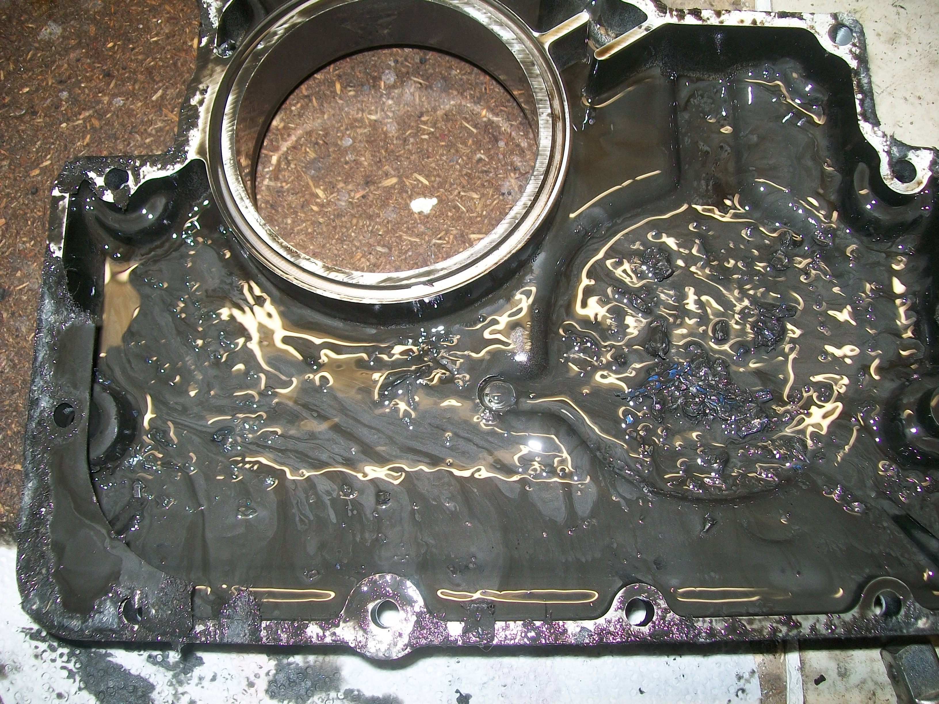

The sump was a bit off a mess, bit's of swarf and quite a bit of silicon.
Whilst taking the clutch cover off I did think the silicon was over used.

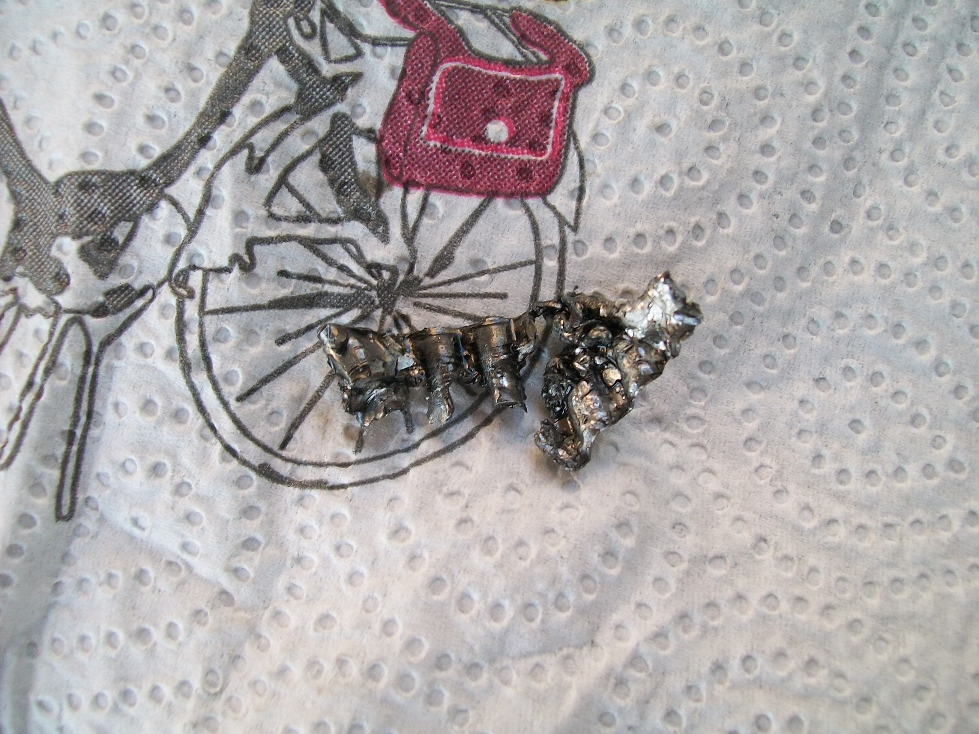

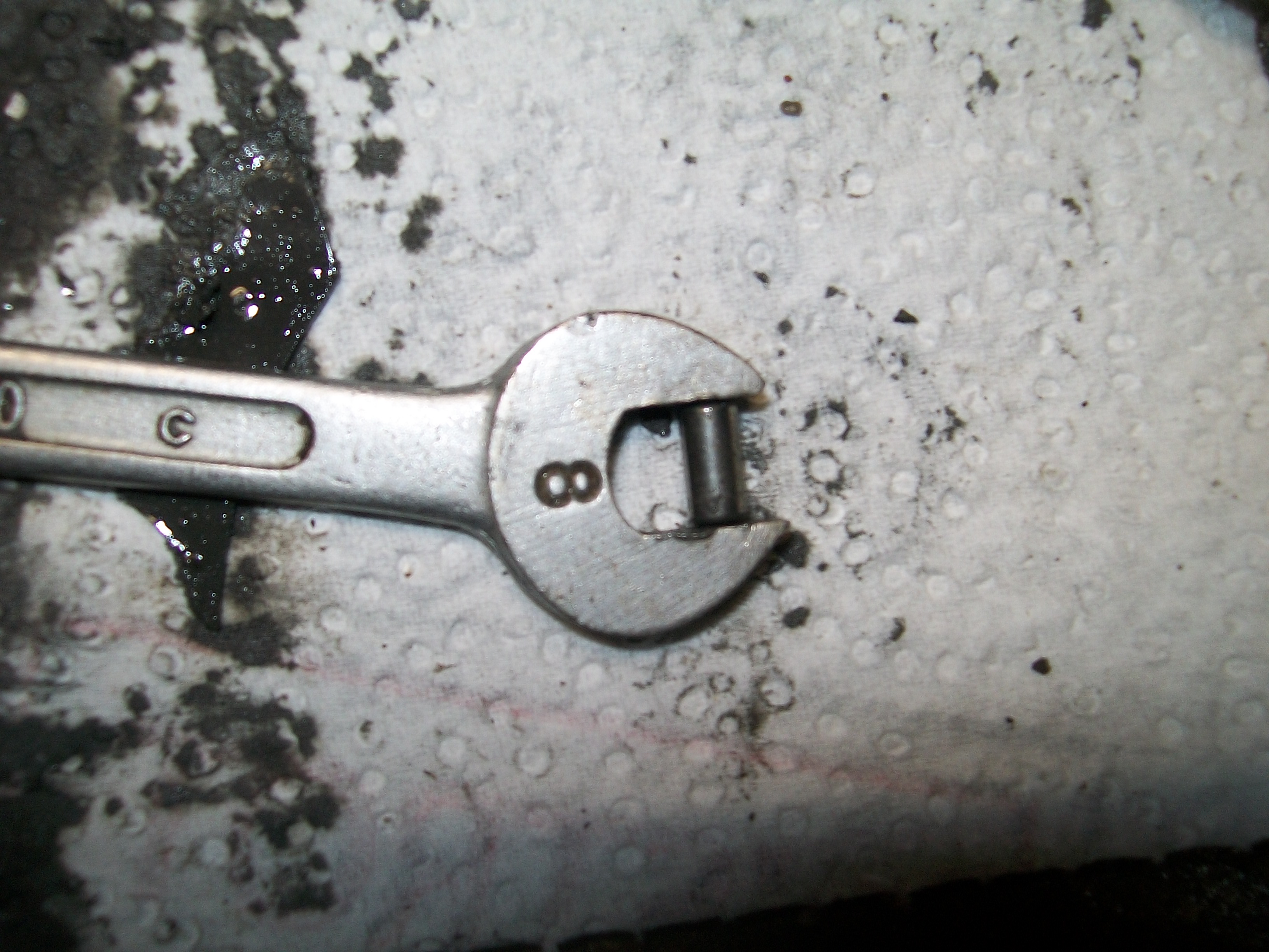

I also found this sitting on the strainer, obviously coincidence, but where is it from?

that looks awfull ! As far as I can see on the pictures I give my explanation as an amateur, not as a professional!!!
I think that the metal parts around the crankshaft sprocket are the remnants of a camshaft guide that fell into the camchain tunnel when a camshaft was taken out.
It was replaced and forgotten until the engine ran and got caught between the sprocket and the chain.
The little part of 8 mm could be the little pin that secures the camchain tensioner from pushing too far. It could have fallen out when the tensioner was removed from the engine. That could allso explain why the rear chain guide was so damaged, the tensioner wasn't stopped and continued to push.

Not sure what the piece of metal is, but I like the napkin !
Seriously though, that's a proper mess.
