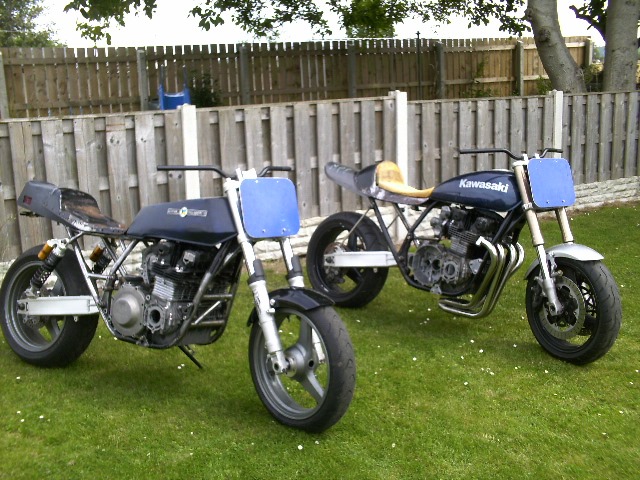

I've put XJR arms in quite a few zeds.
Including these two current builds.
Once the wheel has been centralised to the shock mounts, equal amounts ( around 5.5mm ish ) need to be machined off each end of the pivot to get the required 231mm pivot tube width + 2mm each side for the 1mm thick end cap and 1mm shim to take it to the 235mm required to fit the frame.
There's also enough meat to line bore the frame pivot to 20mm to take the 20mm spindle.
Much better than using the z spindle with an actual measurment of 15.8mm in the 16.2mm frame boss and achieving the stock .4mm of slack that almost makes fitting a stiffer arm pointless.

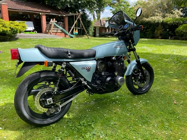

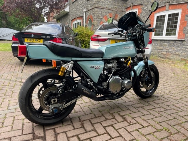

#38 PostAuthor: rpeters » Mon Jun 20, 2022 6:15 am
heres a couple of mine, first with 2002 SP and 2nd with 2007 gear

The Z1R pics confirm that I prefer the black to silver finish on the XJR13 arm. Haven't decided yet on the underbrace. My 1170 has 20mm swingarm pivot, along with bracing around that area of the frame. For the MK2 the frame has already been braced and powder coated before I got it, so don' want to mod the frame anymore than that. One thing I found odd, is that the standard 16mm pivot bolt (bought new from Z-Power) is a few mm to short, for the lock nut to fit correctly. Will need to fit a stainless half width locknut instead.
BTW how much longer, if any, is the XJR arm, compared to a standard Zed swing arm. From the pics, it looks as if the shocks are angled slightly more the standard?

#40 PostAuthor: rpeters » Wed Jun 22, 2022 6:13 pm
About 2.5-3.0 inches depending on where you land your rear spindle mate
