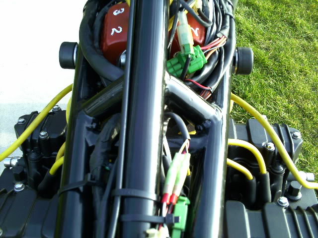

Here's some pics and info on the frame mods. This shows the usual undertank bracing. All the tubing used is from a donor GPZ305 frame, so its all genuine kawa.

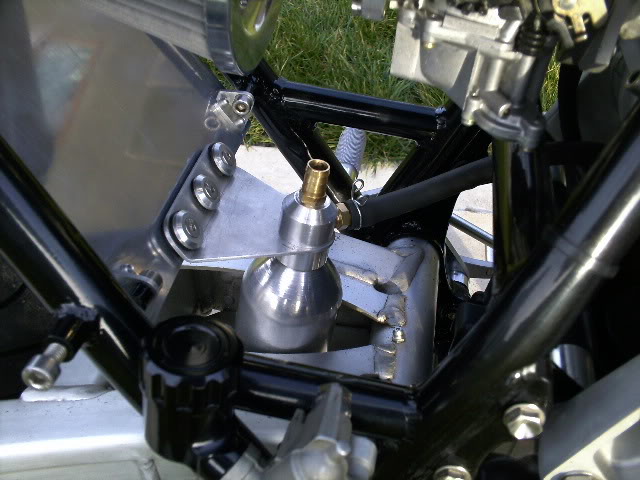

This show's bracing around swingarm pivot area and also rubber mounted catch tank i've just done.
Also the new swing arm spindle is of a larger dia than original so i rigged up a special cutter (that used the pivot as a guide) to machine out the frame pivot inserts, I then turned up some larger dia replacements and welded them in.

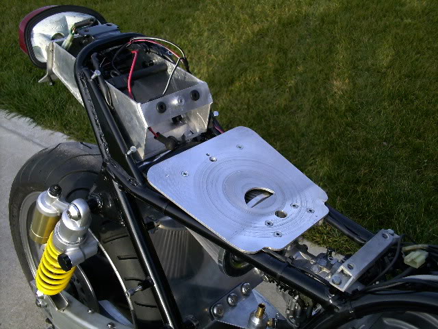

This shows the original rear loop which i repositioned and braced to mount the battery box and seat mount , The rear shock mounts have been re built bringing them wider apart to match the swingarm, Also shown is the alloy seat support plate so that the fiberglass UNATECH Z9 ZEDBUTT seat unit is not taking the weight of my fat a*se.

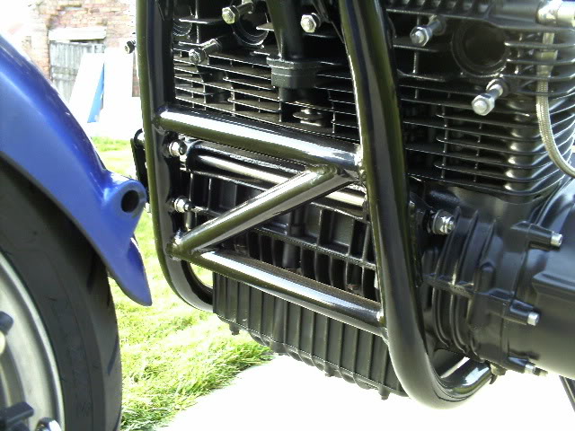

#38 PostAuthor: zed1015 » Sat Jan 31, 2009 4:50 pm
Bit obvious this one. Substantial (Z) bracing on front down tubes. The fastest bits of geep 305 on the planet :)

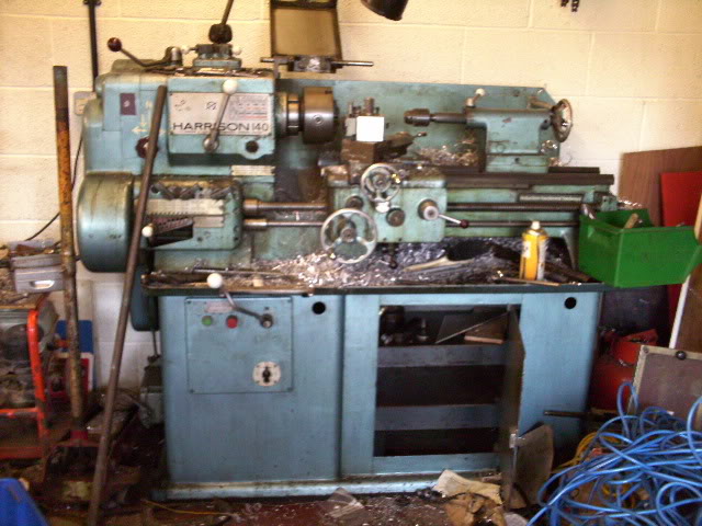

#43 PostAuthor: zed1015 » Mon Feb 02, 2009 9:56 am
Exhaust Craft wrote:Very nice,can you get the lathe a bit closer to the bike?
Hi.Exhaust craft. Here's a pic just for you. Got her to pose with the door wide open, OOER ! :oops: . Can provide more pic's in plain brown paper package. :wink:

#44 PostAuthor: Exhaust Craft » Mon Feb 02, 2009 10:12 am
You must have spent some time on the old lathe,making bits for the Z,your bike is going to be a work of art!

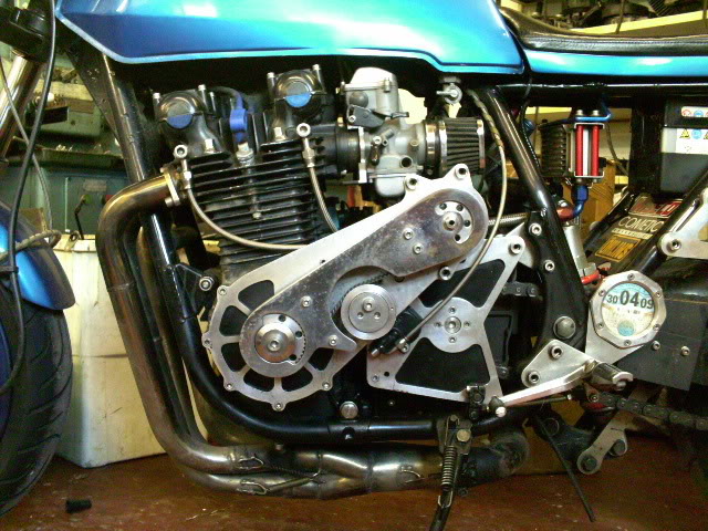

Best thing i ever bought, saved a fortune in time and money,Lost count of the stuff i've made. Bike would still be just a pile of bits without it. Here's a pic of my Z1R. Exhaust is cut'n'shut from donor systems and routed around filter housing. Am now looking for more pipe for the drouin.
