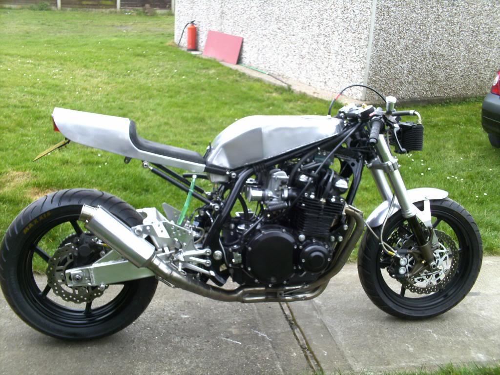

It lives again :D .
Engine all back together, it started first kick and ticks over nicely.
It is running in the pic honest!
A little smokey on the over run but that should clear after a few miles ( if it doesn't then those cheap replacement rings are rubbish and i'll be inserting a set of wiseco's).

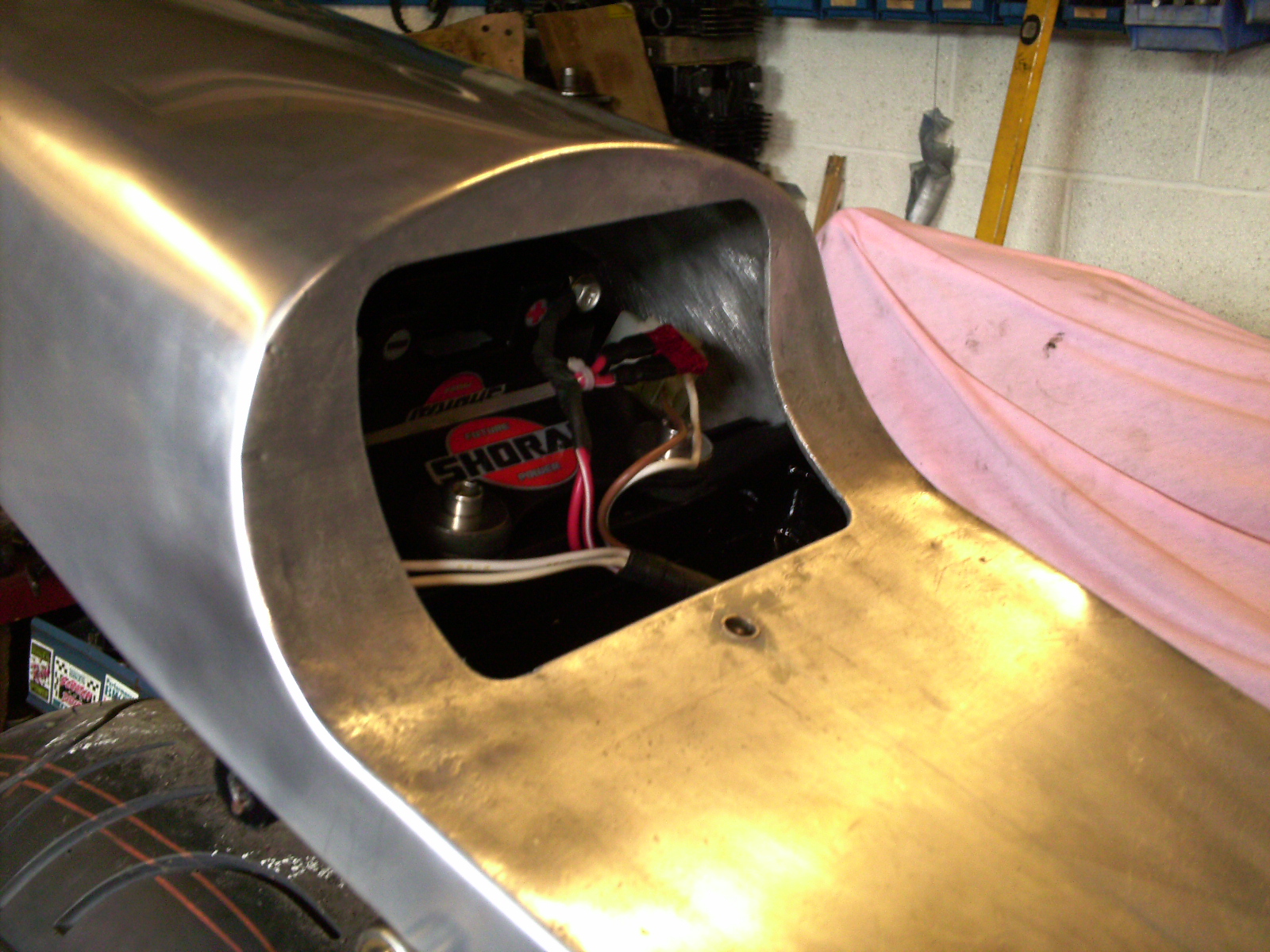

Simple wiring in the tail with main fuse on insulated spades

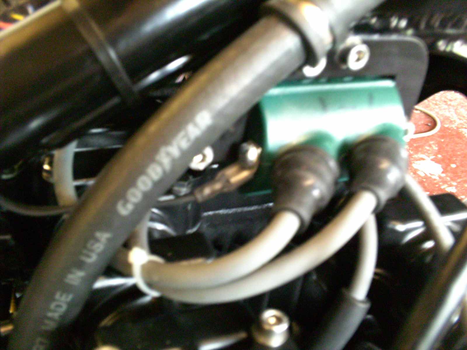

Dyna coils converted to spade fittings with screwed on surface mounts

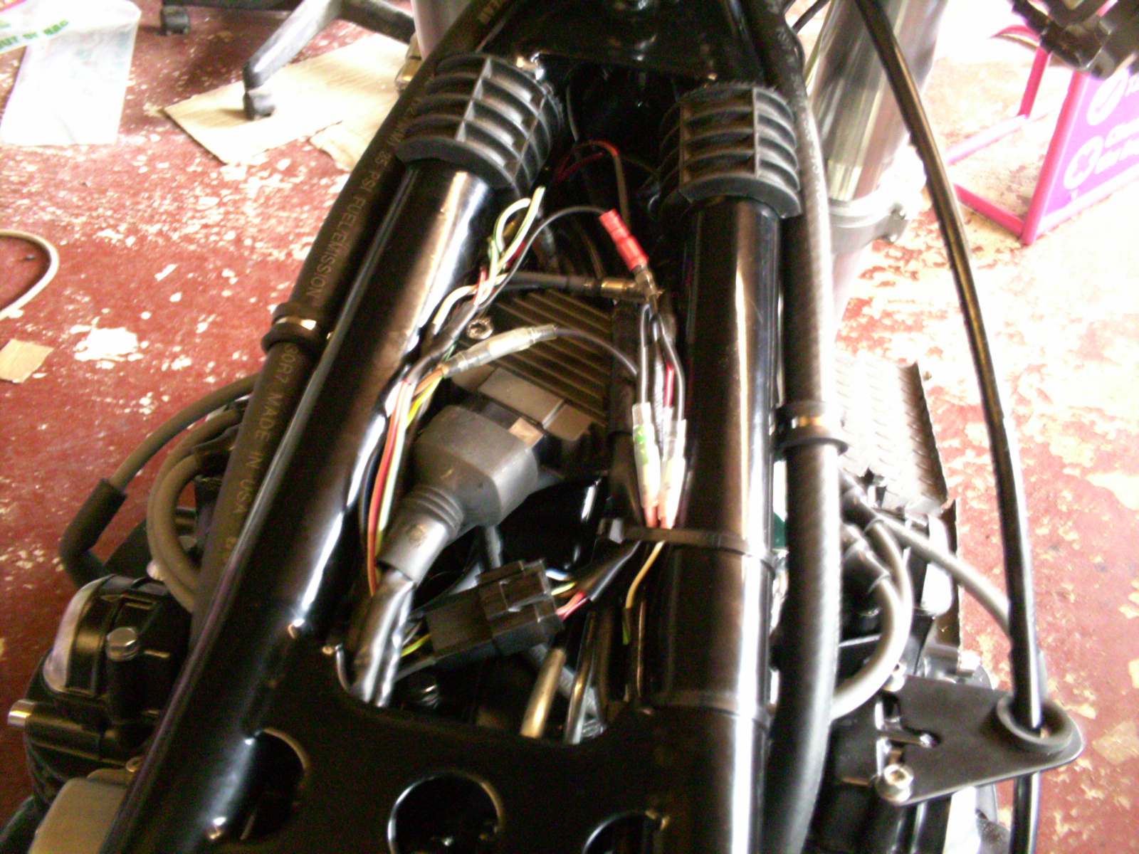

Rest of the wiring , horn and reg/rec just fits under the tank

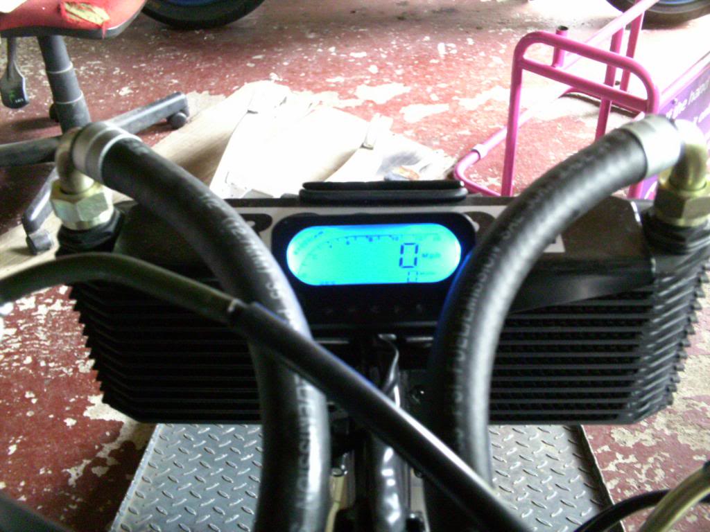

Riders eye view of the Danmoto speedo. It's very clear but couldn't get a decent shot with the camera.
