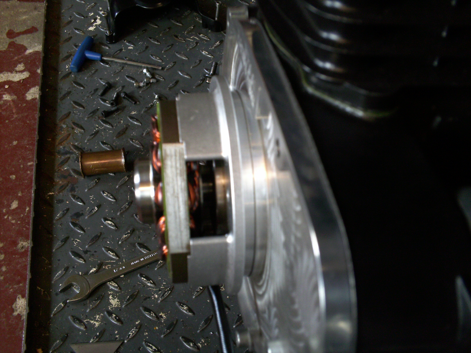

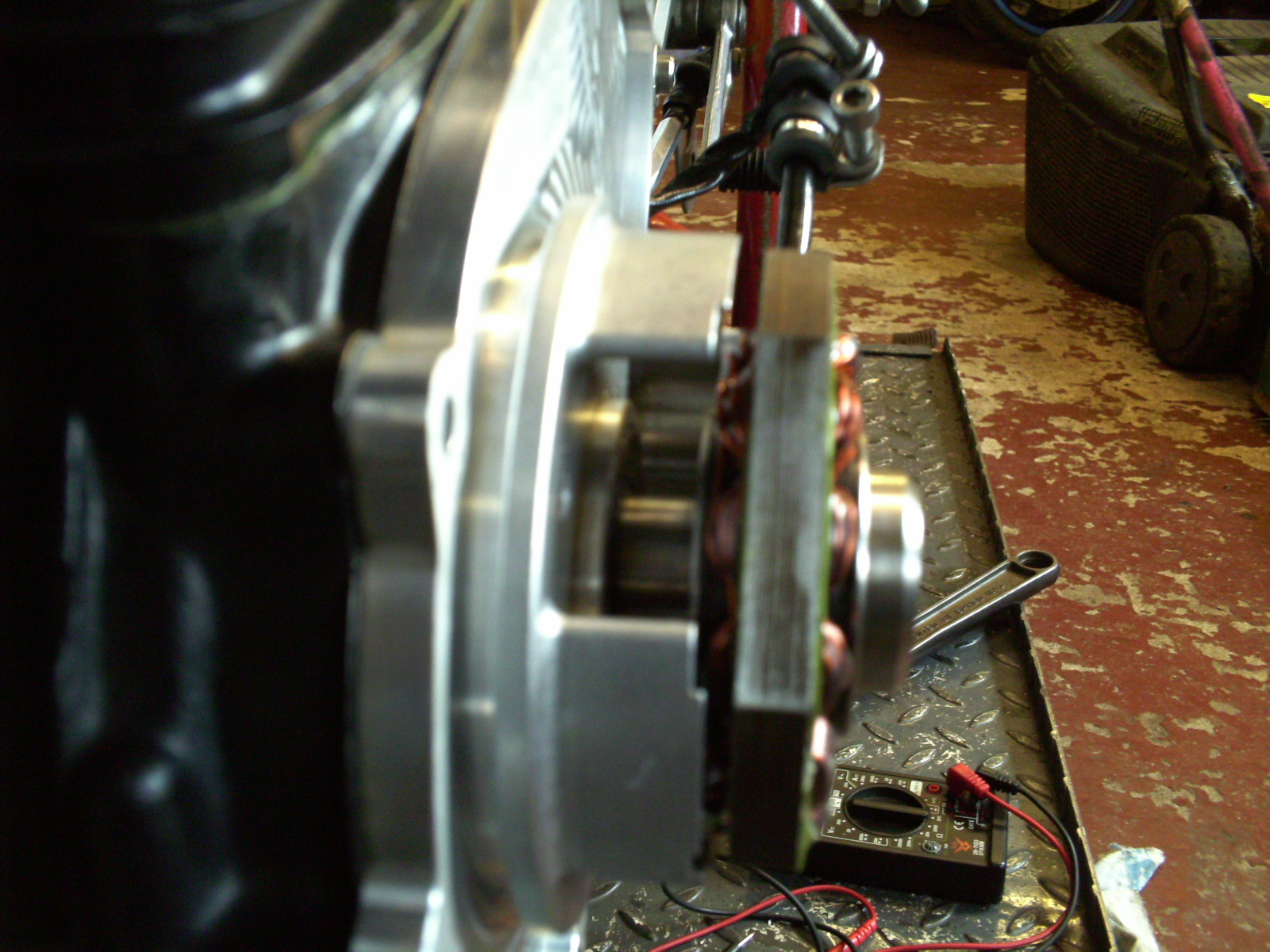

With my increased vigilance on the charging system after the Lithium battery failure and subsequent 1/2 mile push home i noticed the current battery read only an average of 10 volts after the good run out to the Squires meet on sunday.
On closer inspection of the Electrex alt i noticed that the windings did not sit central over the rotor and when slackened were pulled a full 6mm outwards by the magnetic field at which point it sits central over the rotor.

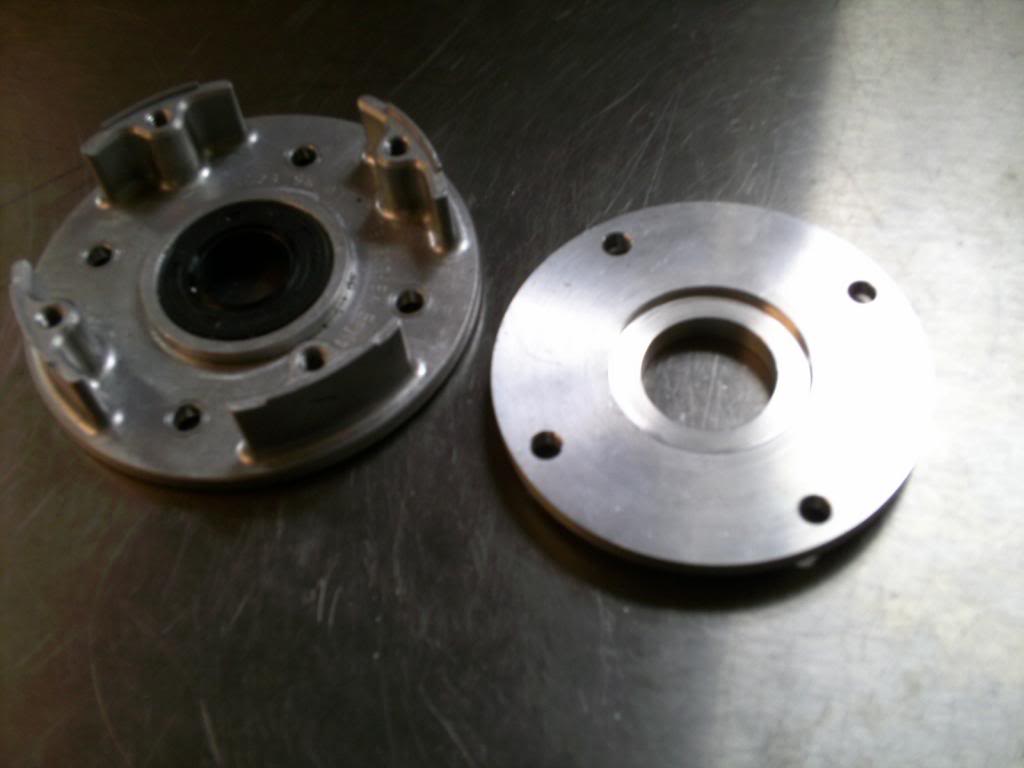

This can't be good for it's efficiency and is probably the cause for it not kicking out it's maximum charge so i turned up a 6mm spacer to sort it out.
Even with the spacer etc loosely slotted on everything sits where it should and i hope there should be an increase in output.

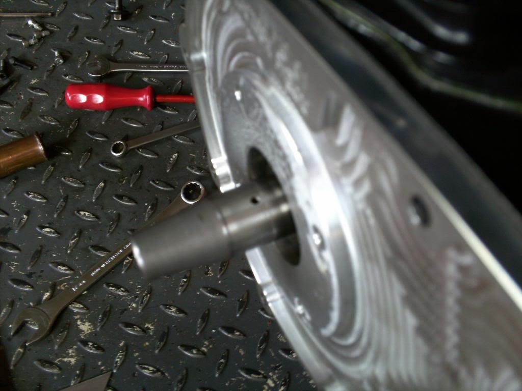

Not a very good advertisement for the accuracy of Electrex's products but to make things even worse i noticed some oil weepage from the crank seal and on even closer inspection it turned out that the now defunct oil feed hole for the starter clutch needle roller actually sits within the two lips of the oil seal and about a millimetre from spraying its load to the outside world.
If you look close at the pic you can see the shiny ring inboard of the oil hole where the inner lip of the seal sat on the crank nose.
Luckily my spacer solved both problems but at £500 quid for the alt i'm seriously pissed off at having to complete Electrex's development work and also pay them for the privilege

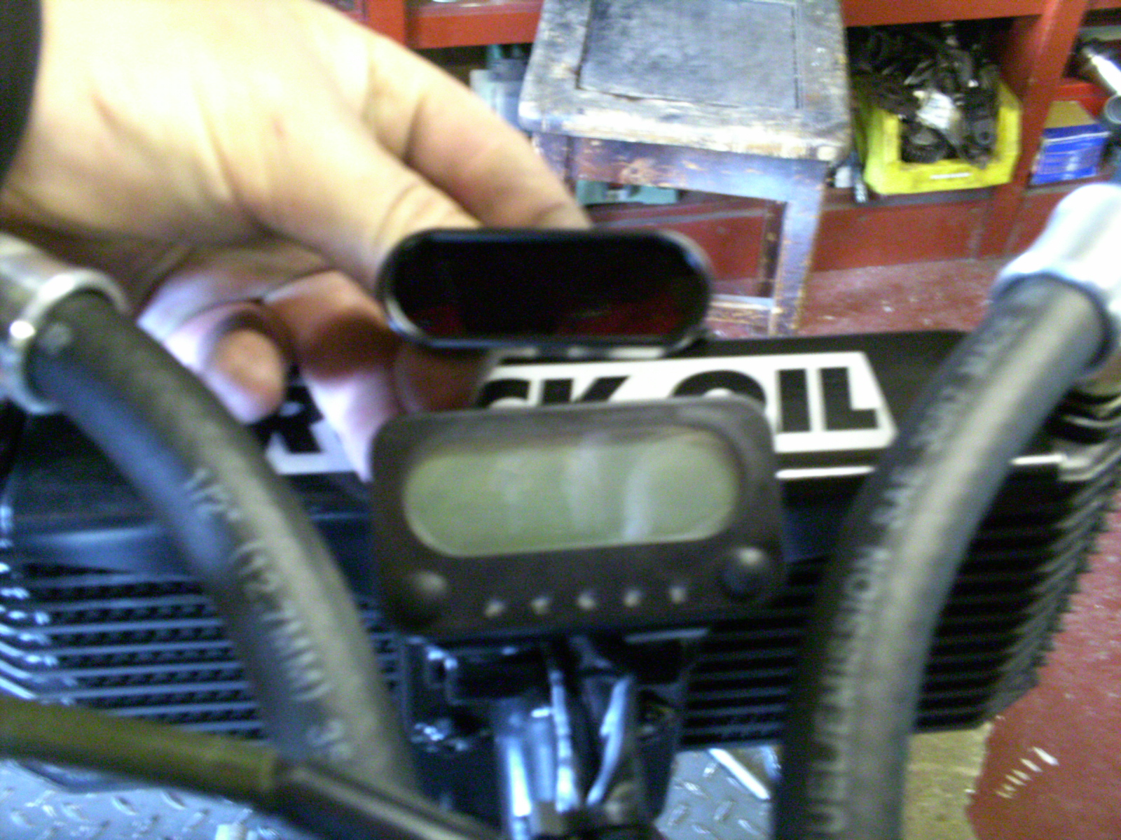

Another piece of shit purchase was the Danmoto nano cockpit speedo which never worked properly from day one.
It's only vaguely accurate at 33 mph and reads either zero or 975 mph at anything above or below and the tacho gave up the ghost on the first trip out.
Hopefully it's replacement, a billet alloy encased Moto gadget mini at twice the price will solve my problems and be even more inconspicuous than it's shitty plastic predecessor

I have fitted quite a few motogadget parts including a speedo and they have all been excellent. The speed sensor is tiny and therefore very unobtrusive. My only reservation is that the cable going to the sensor was very thin and didn't look butch enough to me given the likelihood of being hit by road debris. I put some heat shrink over the cable to make it more robust with a small piece of adhesive lined HS over the end of the sensor for strain relief and to stop the lock nuts rotating.
