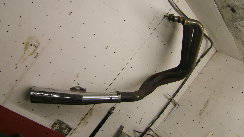

Mick Hayward wrote:Hi Ludders
Looks like its nearly there. Looking at your original pictures I like the style and shape of the exhaust. Do you have any info on its origins or what it is.
Mick
Hi Mick,
i dont know about the down pipes but the silencer is a Kerker.

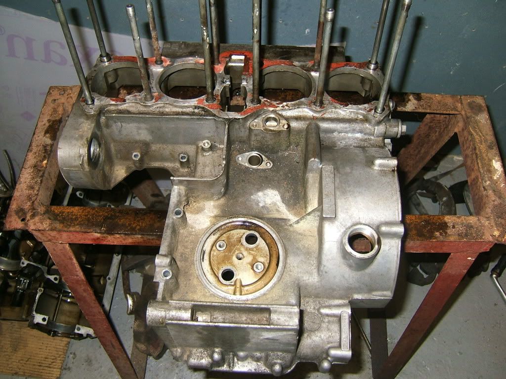

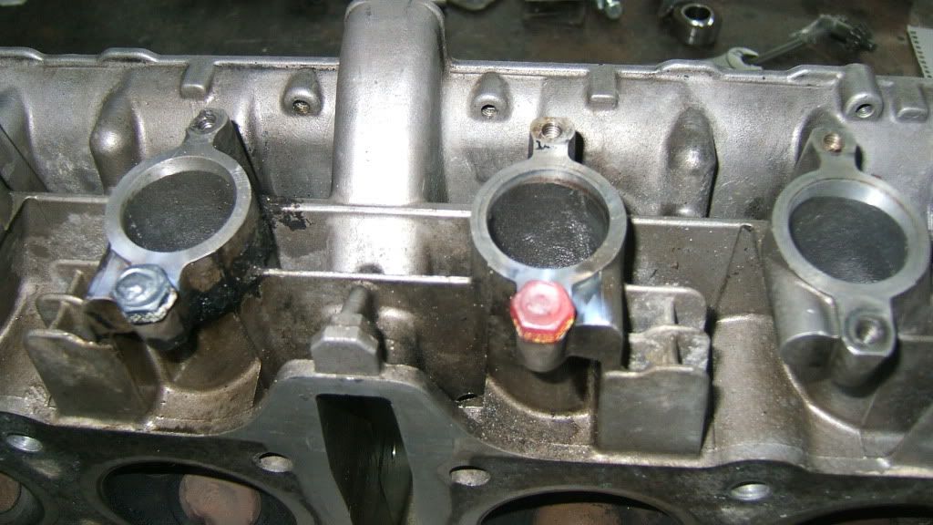

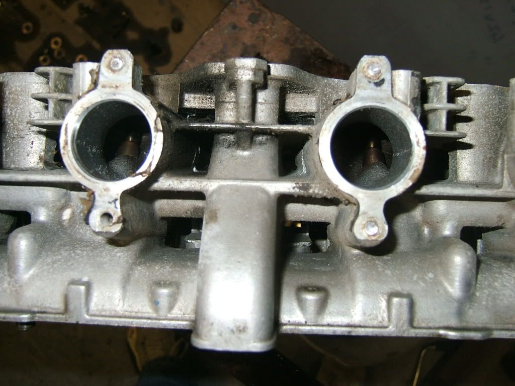

#50 PostAuthor: ludders » Wed Jul 15, 2009 7:02 pm
SO...........i stripped it down ,i was glad i did that, NOT :( :shock:.
what was going to be a strip clean and re-assemble turned into quite a lot of work and ££££££££££ :cry: .
After stripping the whole bike i had one grub screw that rounded off :o , the engine i broke a seized bolt in the crank case and four inlet screws in the head :grr :grr :swe
Now the task of getting the broken bit's out :roll:

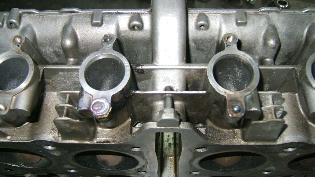

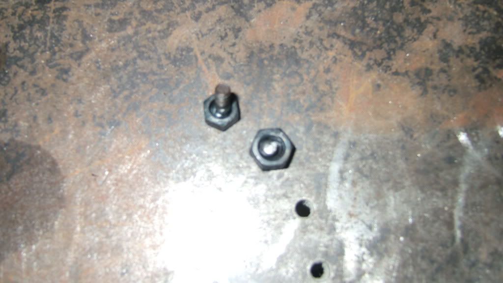

#51 PostAuthor: ludders » Wed Jul 15, 2009 7:26 pm
Firstly i tried an easy-out, that was about as much use as chocolate chisel.
:no :no
Then i MIG welded a nut on to it,, NO it broke of again, so i tried TIG welding a larger nut on and holding the power on at a lower amp to generate a lot of heat, hopefully to expand the bolt in the case thus breaking the seal, :hoo :hoo it worked, one down four to go.
z900 a4 , zx9r

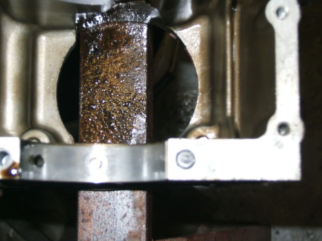

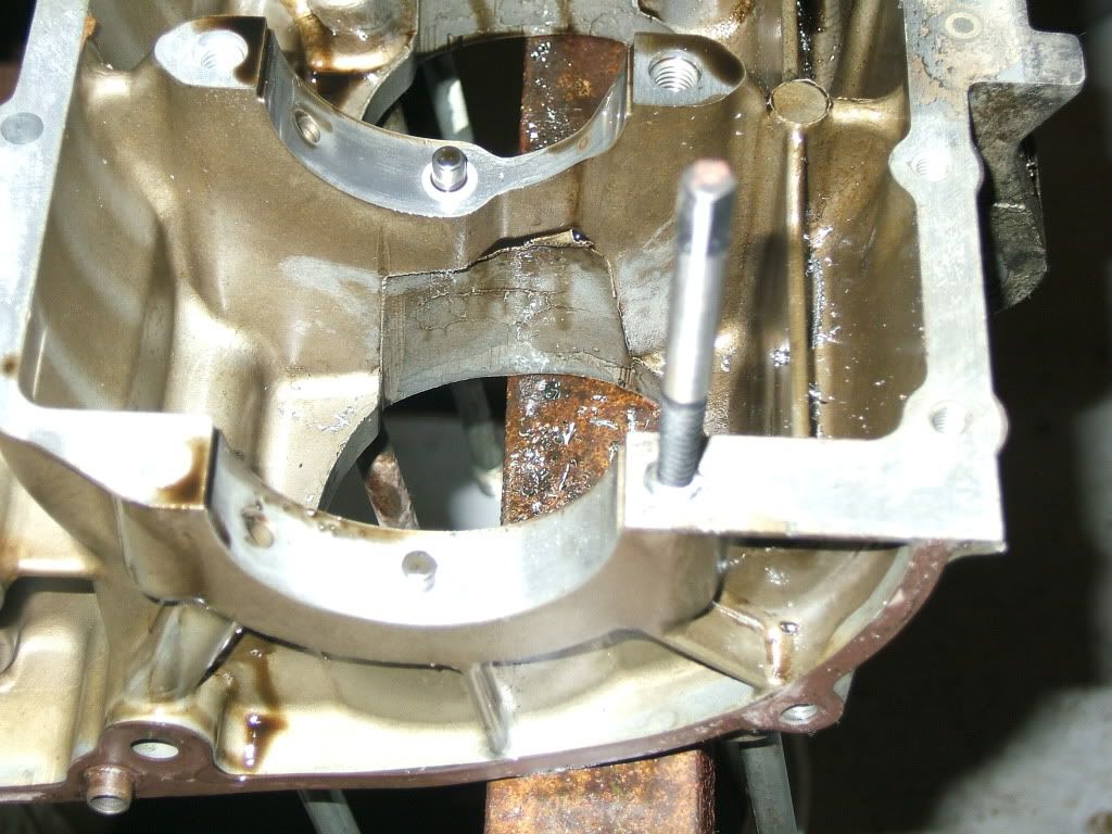

#52 PostAuthor: ludders » Wed Jul 15, 2009 7:31 pm
You can see on the right hand bolt i built up weld before trying to weld on the nut.

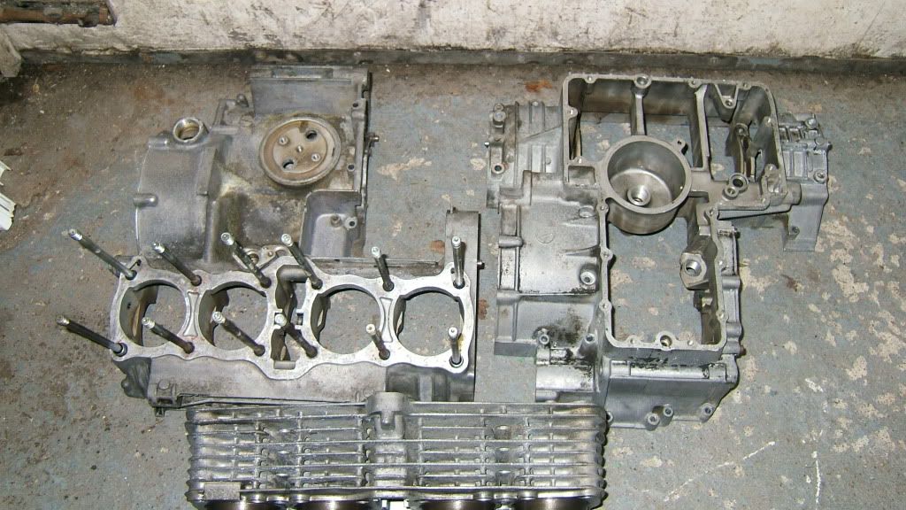

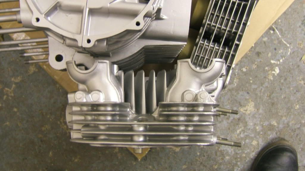

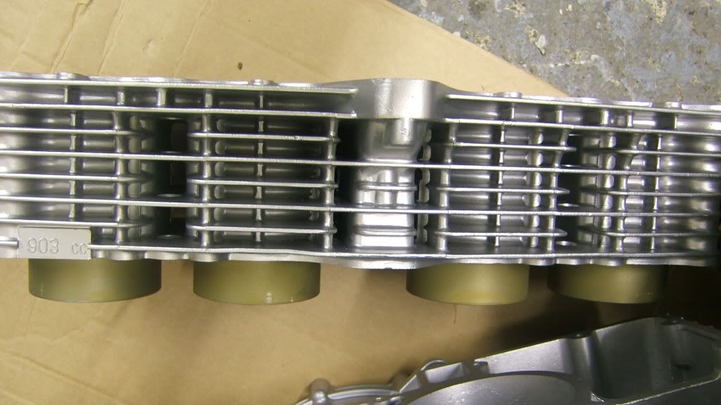

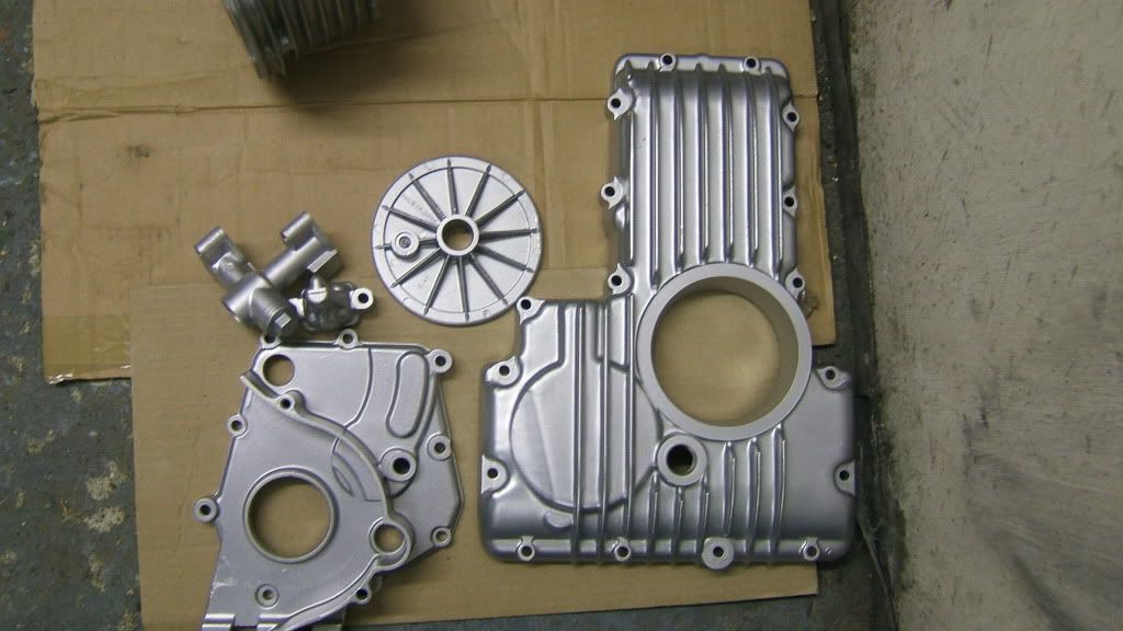

#53 PostAuthor: ludders » Sat Jul 18, 2009 10:50 am
All broken bolt's removed, thread's cleaned out with a tap it was of to the vapour blaster's, here is before and after.

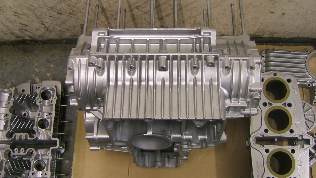

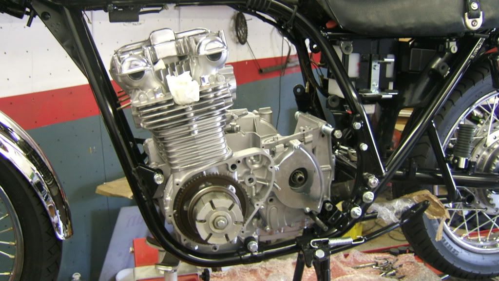

Although i was happy to strip the engine and head i did'nt fancy putting it back together :ooer so i took all the boxes and bucket's to a man who can ( mike ).
After he had inspected the engine then came the news that MOST of the engine was good,the bore's being the best he had seen for a std engine of this age :hoo :D .
Then came the news of the head, the valves and seat's being some of the worst. :cry: .
The head was fully reconed, new valves, seat's, guides, and all chain roller's and tensioner's.
The engine now assembled and back where it belong's
z900 a4 , zx9r

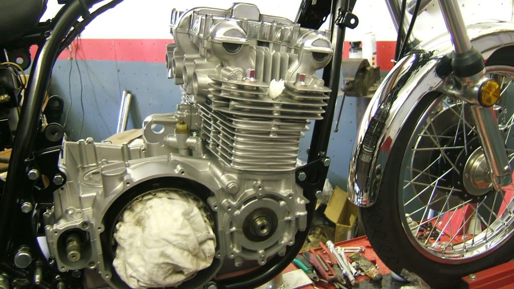

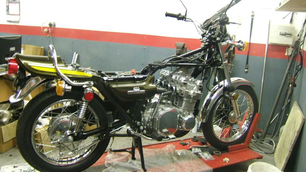

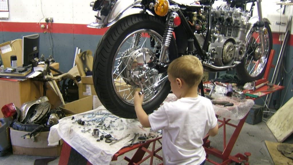

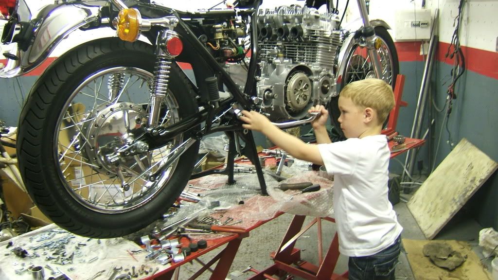

#55 PostAuthor: ludders » Wed Jul 22, 2009 6:21 pm
Number 1 mechanic doing a bit more :lol: :lol:
This is how she look's now, waiting for carb's to come back then i can finish her :D :D .
z900 a4 , zx9r
