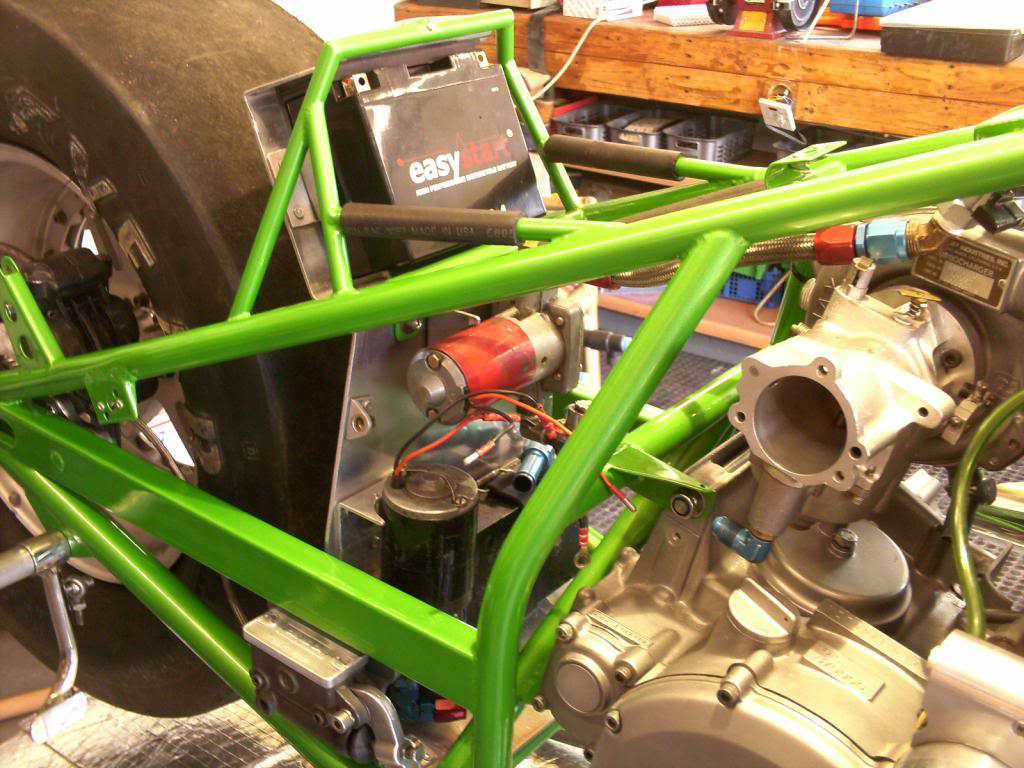

#49 PostAuthor: zed1015 » Sat May 18, 2013 11:15 am
buzzard wrote:Bike is looking good, look forward to seeing it run. Are you running a separate oil scavenge system for the turbo? Buzzard.
Yes! it's got a seperate electrical oil pump and tank for the turbo.
It always had these .
The oil tank window was originally on the right but you couldn't check the level as the rear brake master cyl was in the way.
I've moved it over to the left panel along with all the power switches etc so all pre flight checkable systems can be seen in one place at a glance by the starter operator.

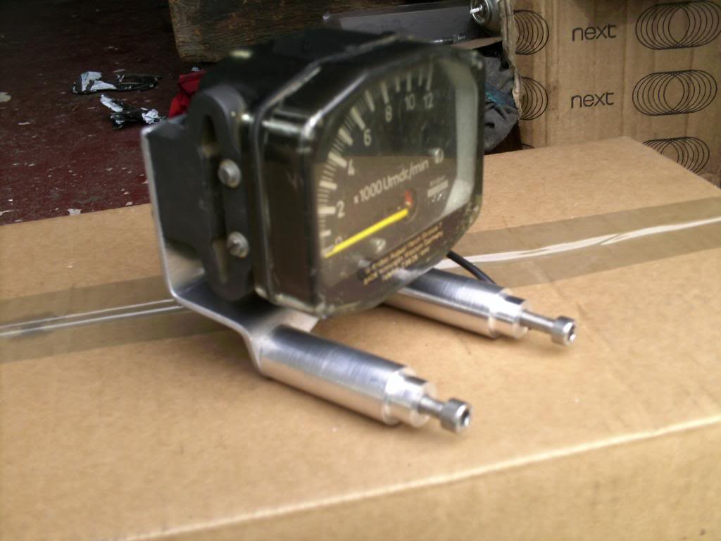

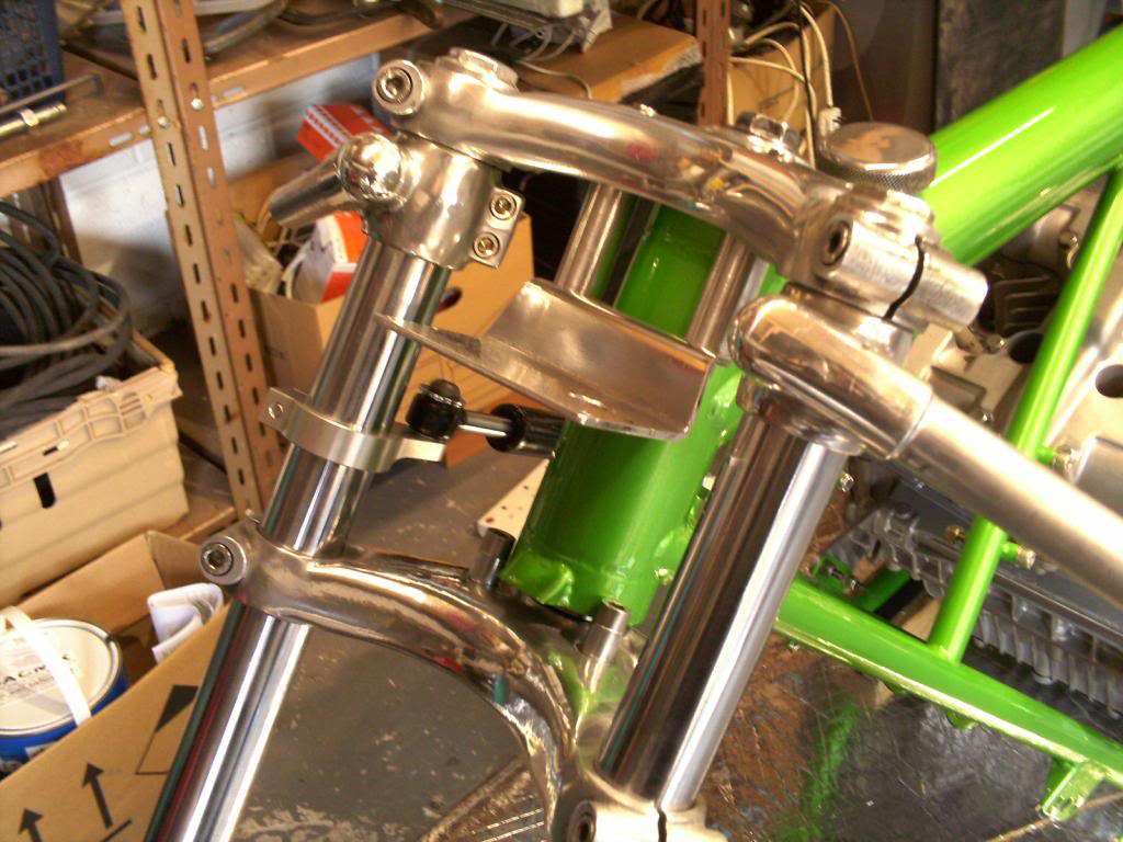

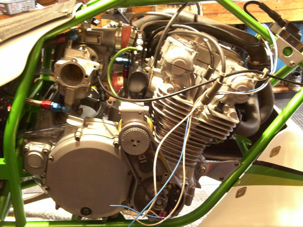

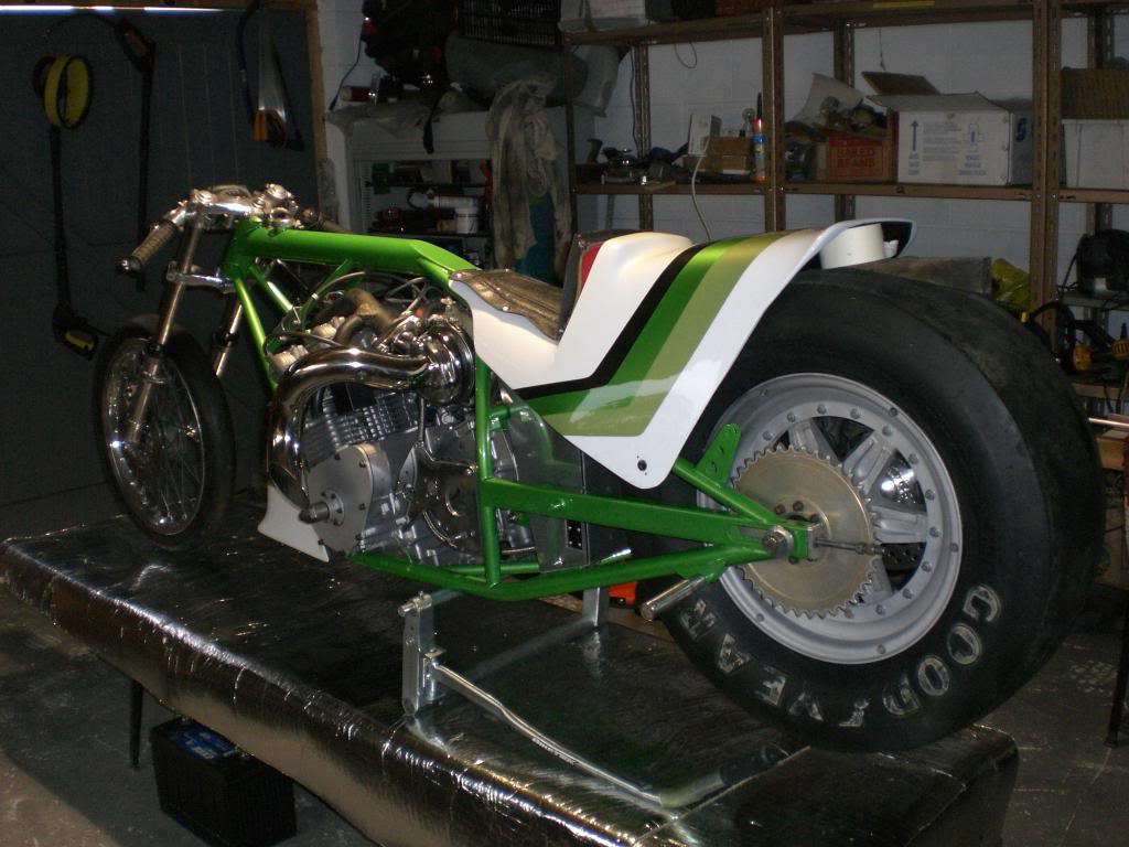

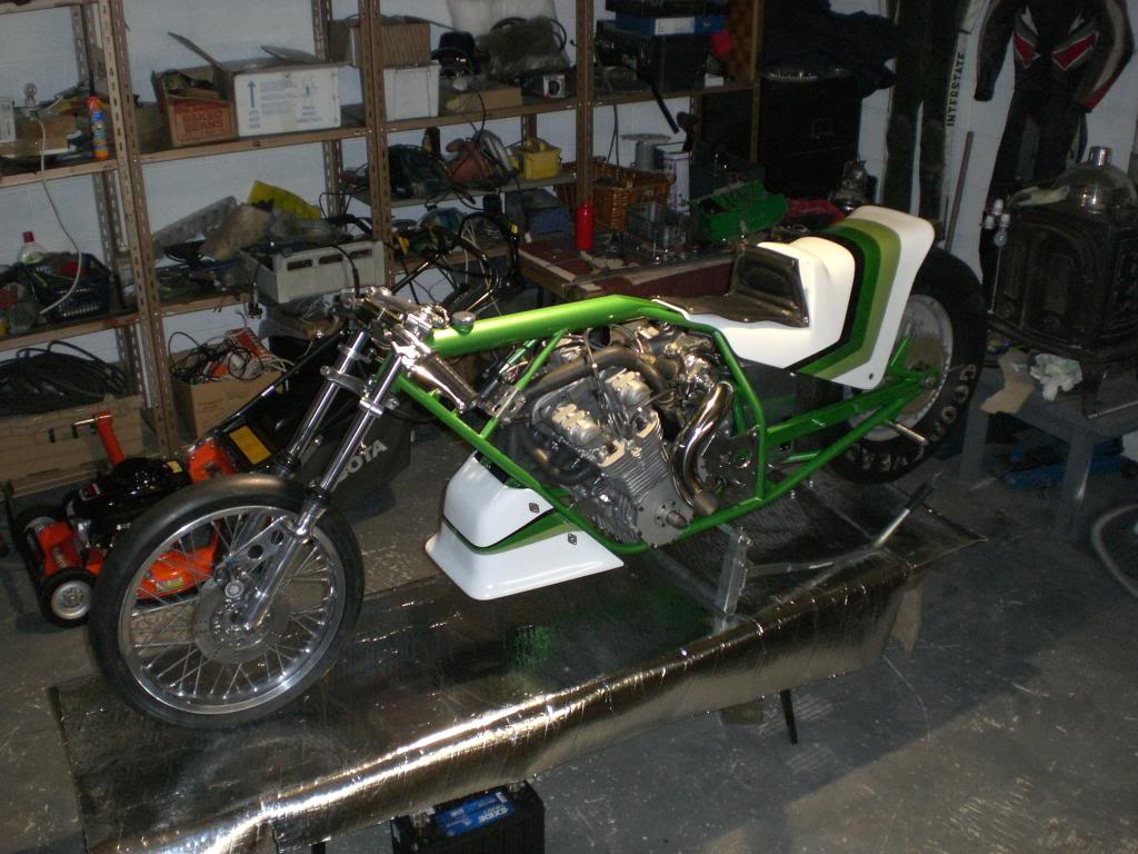

Been a while so bit of an update.
Krober tach mount made for top yoke.
And fitted

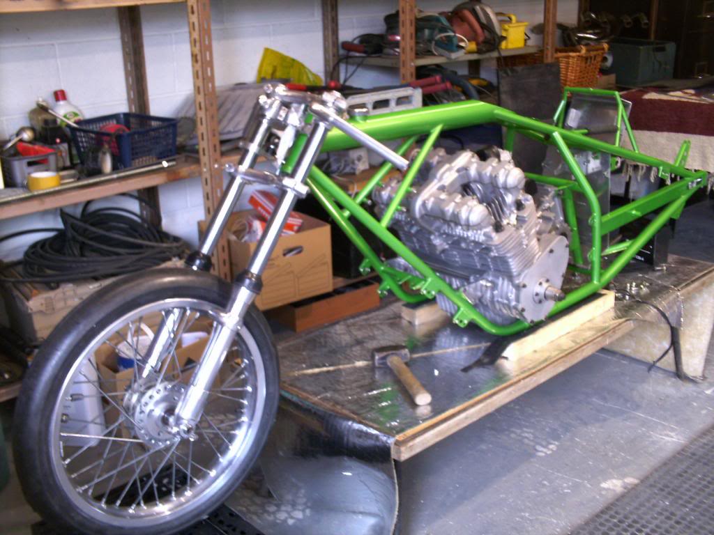

Front end in

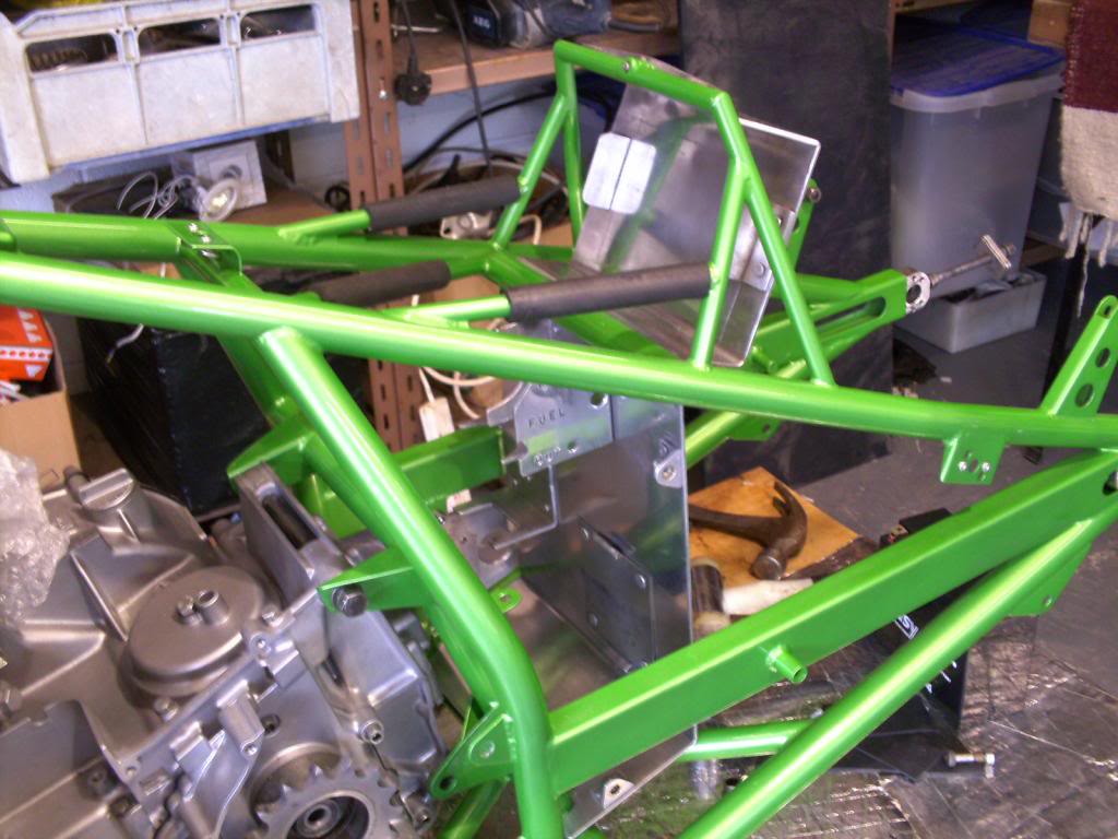

And rear guard

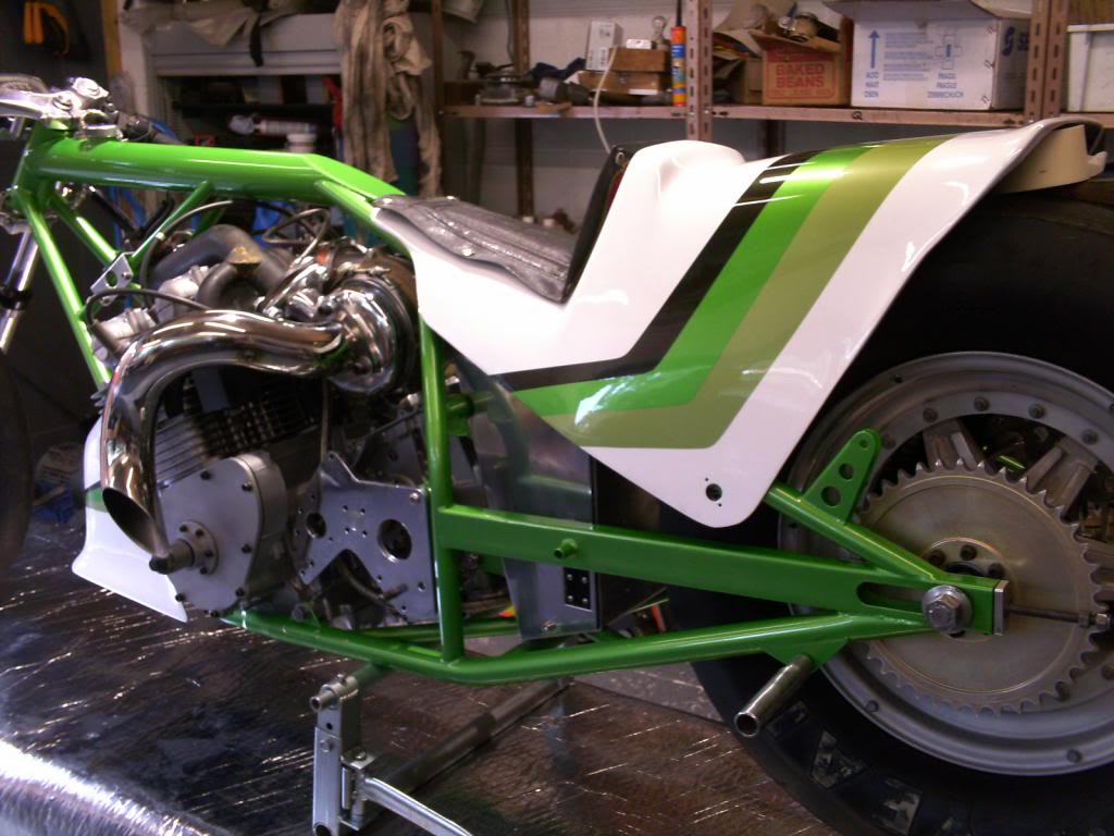

#56 PostAuthor: Al » Fri Jun 28, 2013 9:58 pm
Quality all the way.
Is the frame symmetrical? ie is it longer one side than the other. Is the front wheel, engine rear wheel centreline the same line? Or is it off set.
Is there a bracket or outrigger between the drive sprocket and the 'swingarm' (such as it is) on the drive side?
Fatty's Z1R pulls so hard on the chain that it shortened the distance by oval-ling the front crosstube of the swingarm and needed replacing with a thicker walled tube.
Barry's turbo / nitrous J1 ripped the swingarm mounting bracket off the frame and neither have the output of 30PSI even if they are carrying a little more weight!!! Barry's solution was an outrigger from the drive sprocket bearing (outer) to the swingarm mount which also stops the frame changing shape.
Posts: 4042
#57 PostAuthor: zed1015 » Fri Jun 28, 2013 11:42 pm
zorded wrote:Quality all the way.
Frame is symetrical but engine is offset to the left and rear wheel is offset to the right ( originally (way back when) the wheel was central until a wider wheel was fitted.
Outrigger plate is tied to the frame to reduce distortion under power.

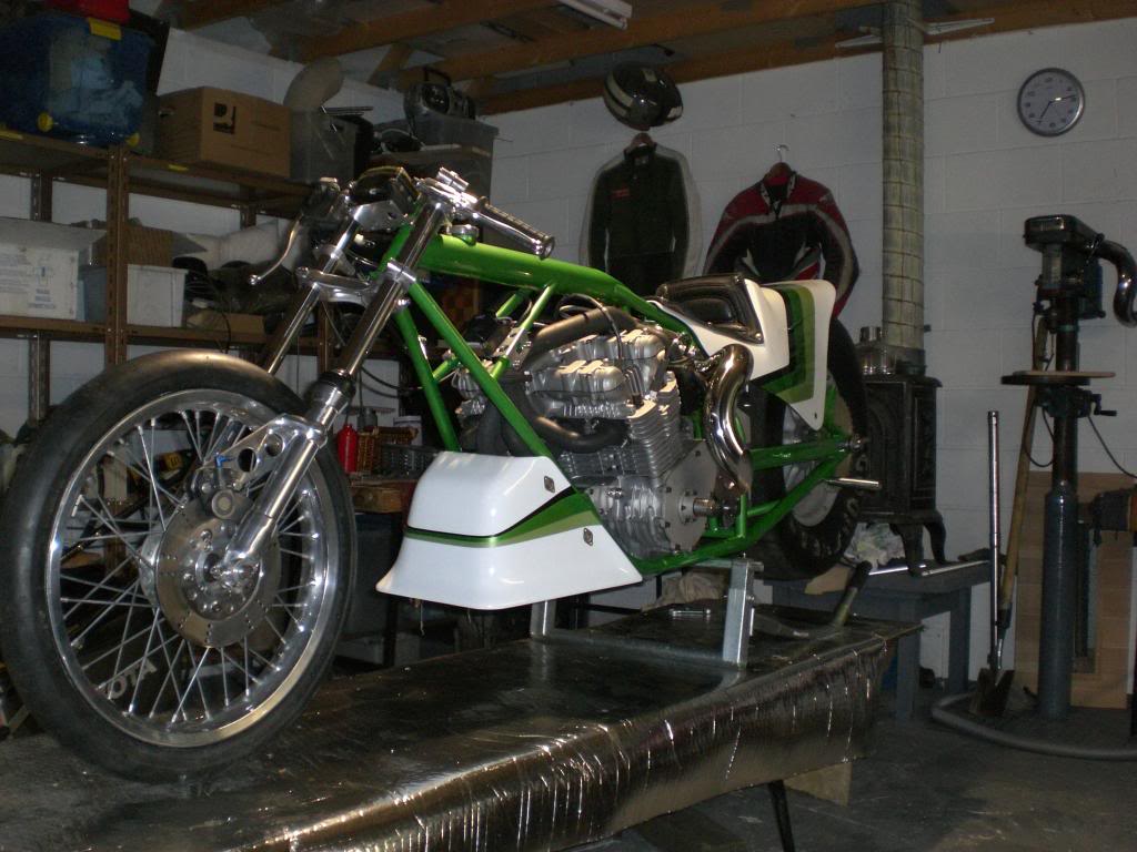

Posts: 4042

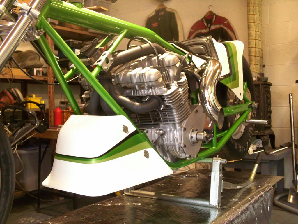

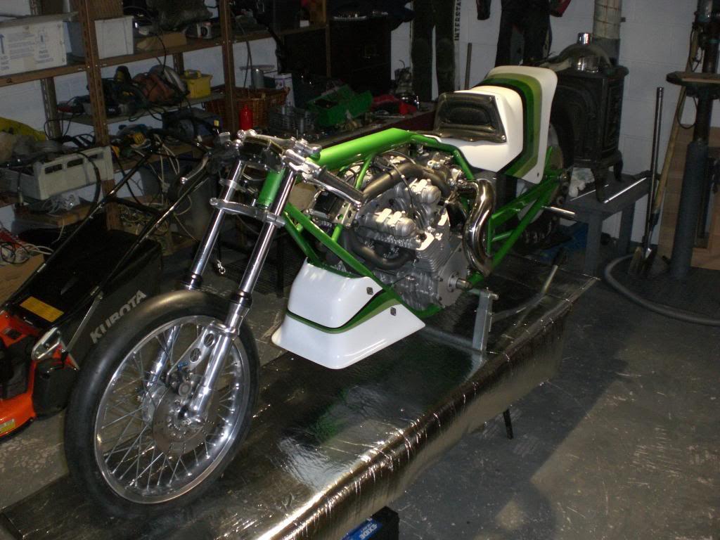

#58 PostAuthor: zed1015 » Sat Jun 29, 2013 1:05 am

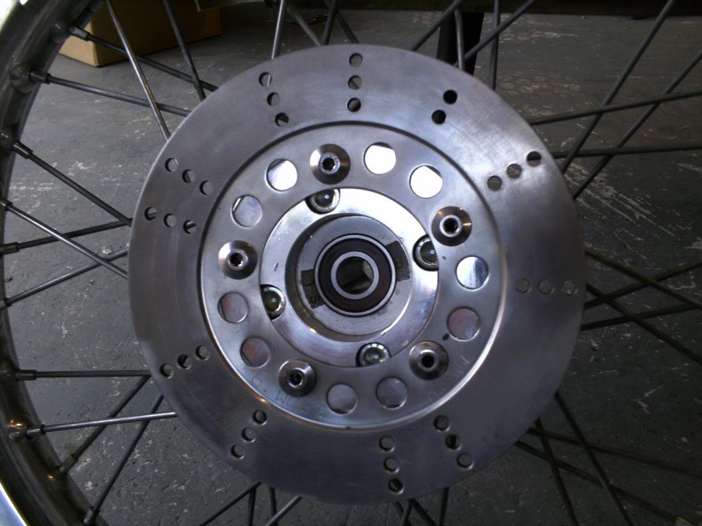

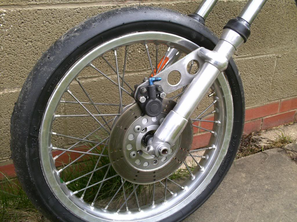

Original front disc was rusty/warped and knackered so as the bike will be sprinted a real working brake is needed.
An alloy adaptor was made to allow the fitment of an AR disk which was the same diameter and is still kawasaki part of course
Next job was to fit the pumps and turbo
I stripped and cleaned the turbo but it needed nothing except gaskets as it was virtually new when the motor blew all those years ago so just need the spiders evicting
Exhaust has been blasted and painted, carb refurbed and plumbing completed along with makeshift wiring ready for the first firing.
New exhaust outlet on and test fit the newly painted bodywork
Bare kosman rear wheel fitted with old tyre for dyno runs will be replaced with freshly painted spare and new tyre when it's time for some real action

#60 PostAuthor: ade woollams » Sat Jun 29, 2013 5:52 am
are those steves old leathers hanging up as well
