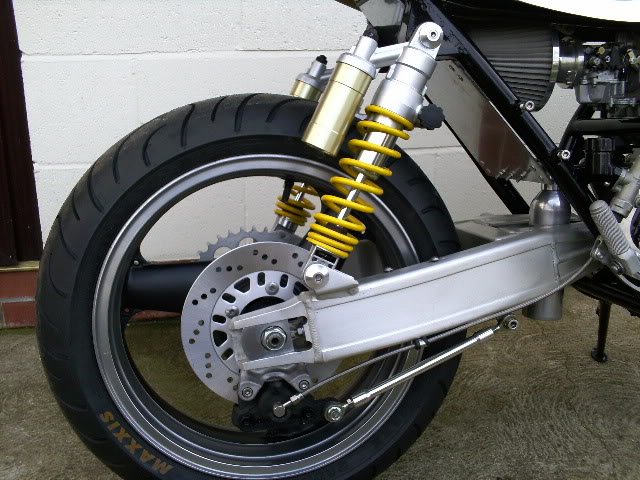

Back to the Drouin. Here's a pic of the back end. Swing arm is XJR1300 SP (chosen coz its got that JMC look) and needed narrowing at the pivot which i did with a home made cutter using the bearing tube as a guide. wheel is zx7r on fireblade spindle with new disc and caliper is suzuki Srad on zxr hanger and 8mm machined off sprocket carrier, all wheel spacers etc are ally, Torque arm is rose jointed one off and shocks are Gsx 1400 with yellow springs for that fake ohlins look.

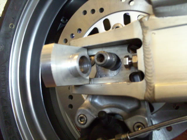

#47 PostAuthor: zed1015 » Mon Feb 02, 2009 11:05 am
Slots in swingarm are much larger than wheel spindle. I made adjuster blocks with integral sleeve to take up the difference.

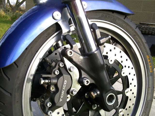

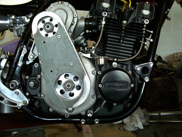

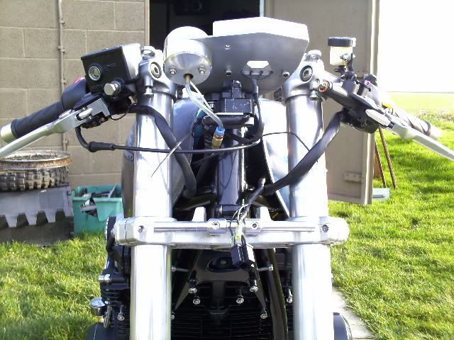

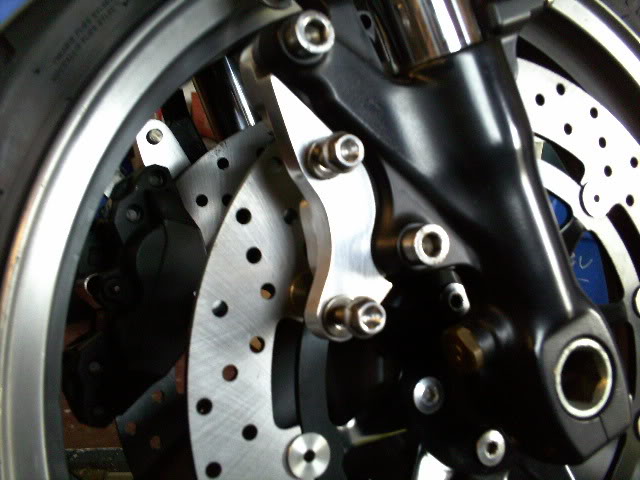

Some views of the front. Forks are zx9r-B on modded yokes, zx7 wheel,new discs,gsxr600 calipers and modified xjr1300 mudguard.
Pic 1 shows hand carved billet adapters to fit gixer 600 calipers.
Pic 2 shows calipers fitted and adaptor plates for rubber mounted cut down xjr mudguard
Pic 3. Front view awaiting headlamp with alloy dash,boost gauge and Vapor digital speedo/tacho + lever and switches. Beginnings of new headlamp mount can be seen on bottom yoke

#50 PostAuthor: rickman CRR » Wed Feb 04, 2009 12:32 pm
very neat job

#51 PostAuthor: Ginger Bear » Wed Feb 04, 2009 2:42 pm
Zed1015,
That 'BEAST' is getting better by the day. Good to see you're making such good progress.
Was wondering if you could 'enlighten' me on how your lockstops work. Is that some kind of adjuster on the frame?
I am not looking to 'Rip Off' anybodys ideas, but a bit of 'inspiration' wouldn't go amiss. :resp :enuff
Posts: 4036
#52 PostAuthor: zed1015 » Wed Feb 04, 2009 8:32 pm
Lockstop is now't special, just made one narrower than needed (using steel from an old z1000 engine sprocket ) then added threaded adjusters that can be spaced with washers/spacers to fine tune steering lock as close to tank as i dare and get most out of the reduced lock that resulted from using the modern zx9 yokes

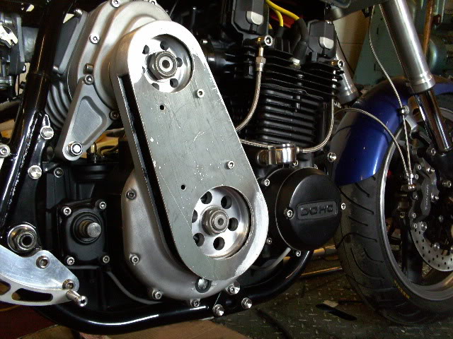

Have decided to make a new pulley guard as the original cast one is too bulky , too seventies and i do not want to cut it about. This is attempt one using 3mm ally sheet from a stray road sign kindly donated by a friend at the council. I cut out the flat pattern and folded it along the long front edge then after curving the remaining side strip over the top and bottom radius welded it up. I've cut a couple of rough holes to show the pulleys and to give me an idea how it will look.( think it needs more cutting about ).I would like to leave the pulleys exposed as i think it looks the biz but i really need something to stop me flares getting shredded.This attempt has turned out a bit on the large side as can be seen in pic one so am having another go tomorrow. All comments welcome. [img]

#55 PostAuthor: Ginger Bear » Sat Feb 07, 2009 3:46 pm
Zed 1015, that's lookin' really good. I agree a few more hole's would be good. Are you gonna polish the finished item?
Found these on ebay, should help with the 'flares'
Posts: 4036
#56 PostAuthor: zed1015 » Sat Feb 07, 2009 4:22 pm
Might do it black to compliment the alloy pulleys but maybe put in some polished alloy windows with stainless screws to give a bit of technical detail. Time will tell.

#59 PostAuthor: Dodgy Z1B » Sat Feb 07, 2009 6:25 pm
The wheel adjusters are pure genious and the caliper brackets a work of art Zed, I have problems trying to hacksaw in a straight line :)
