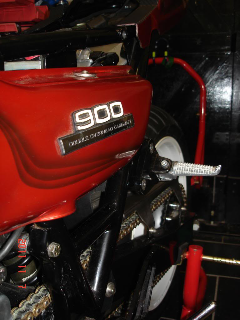

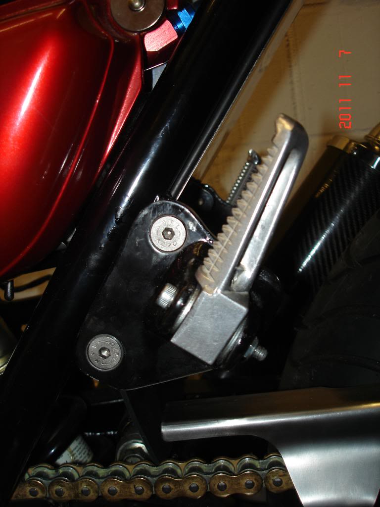

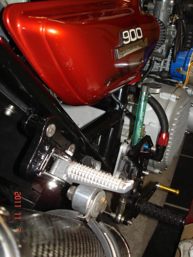

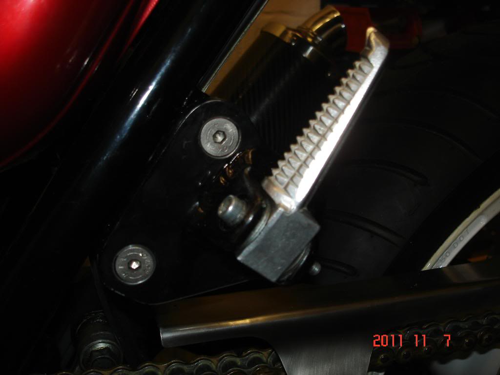

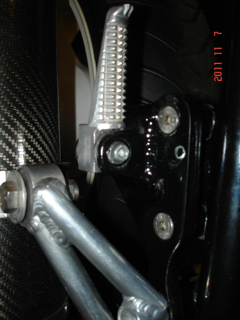

The rear pegs are now welded.
Dropped off late at night and had em back next day!!
Smett yer a fookin' star :up
Quality job!
and with them on after a lick of paint -

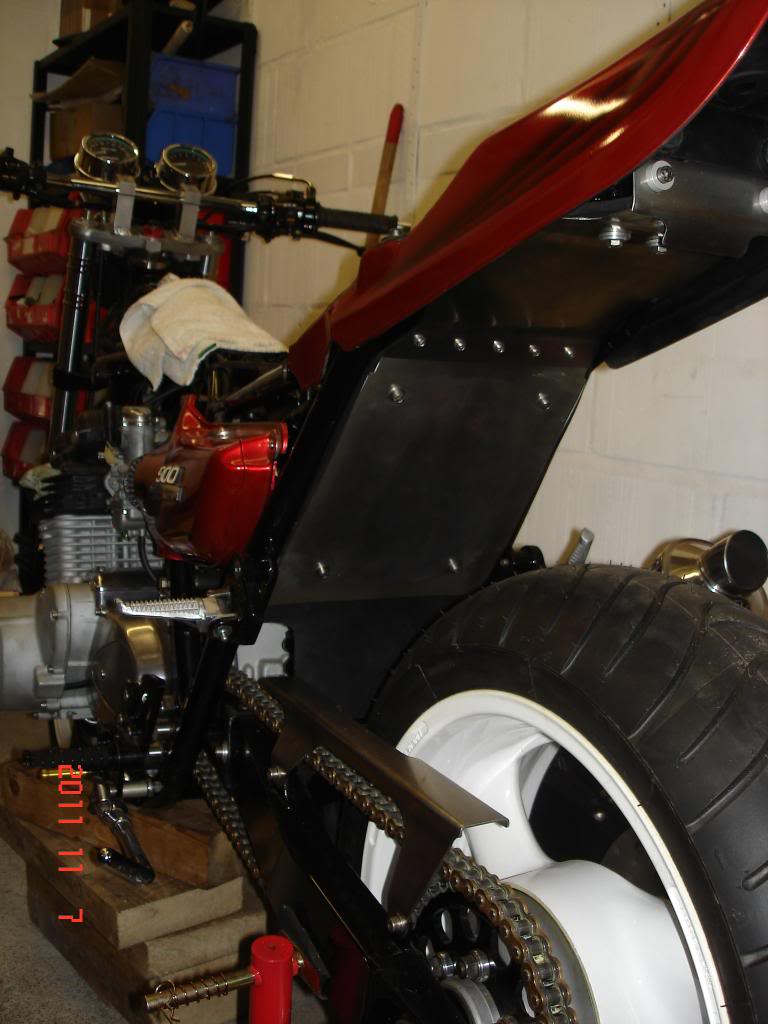

Still have to make a 'proper' mount for the back light - some brackets off the tail mount .......all ideas swirling round in the amoeba at the moment so until then its - WIP as usual :roll:

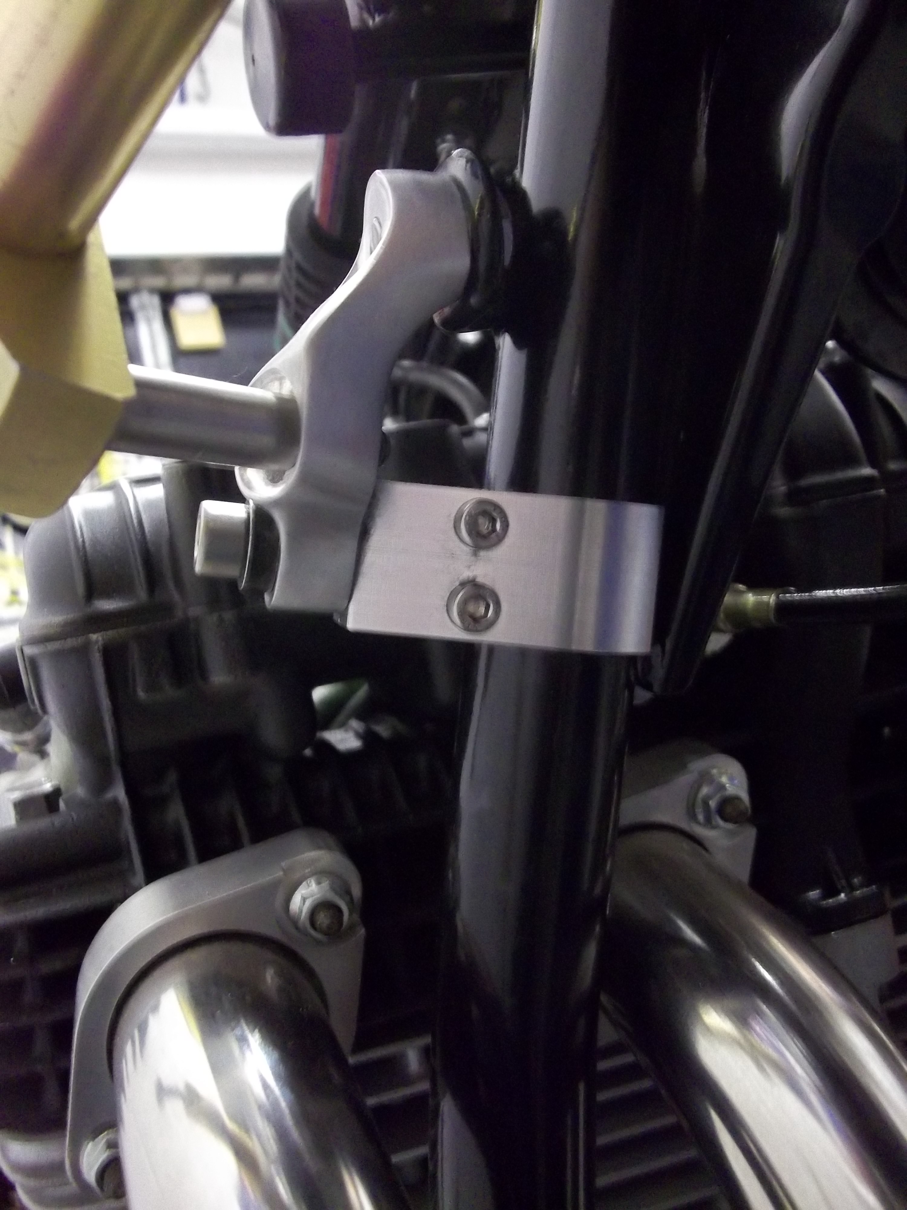

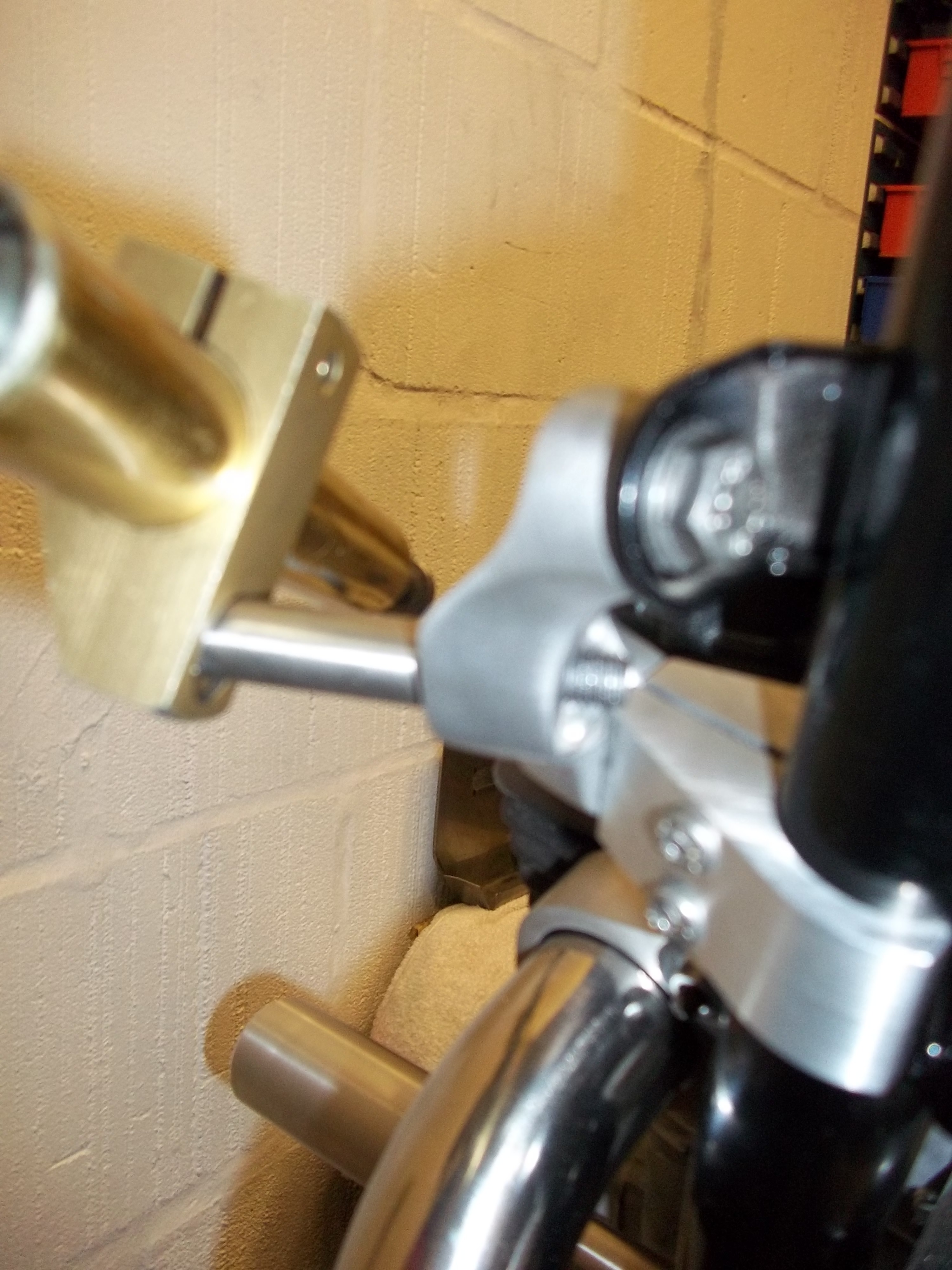

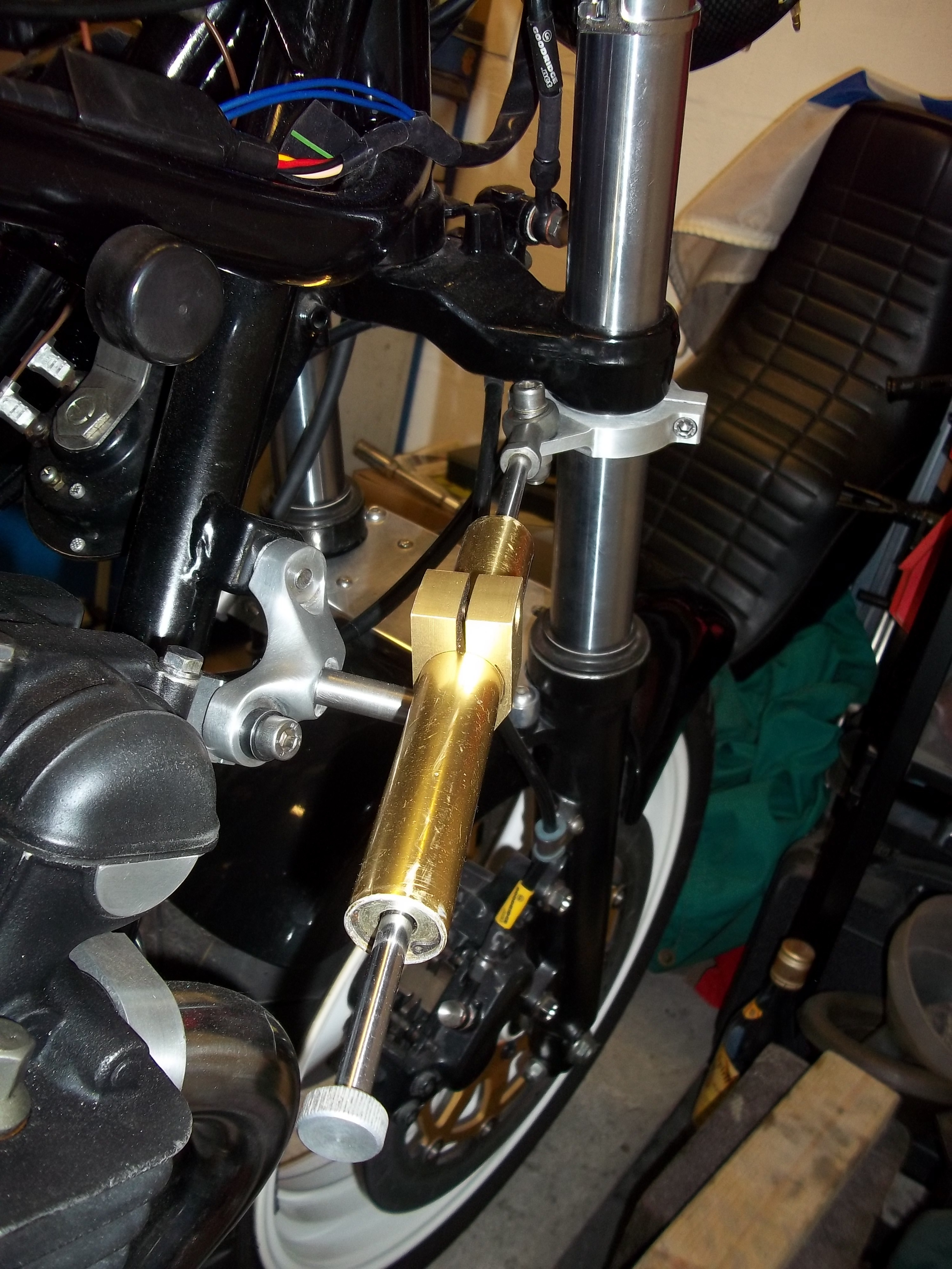

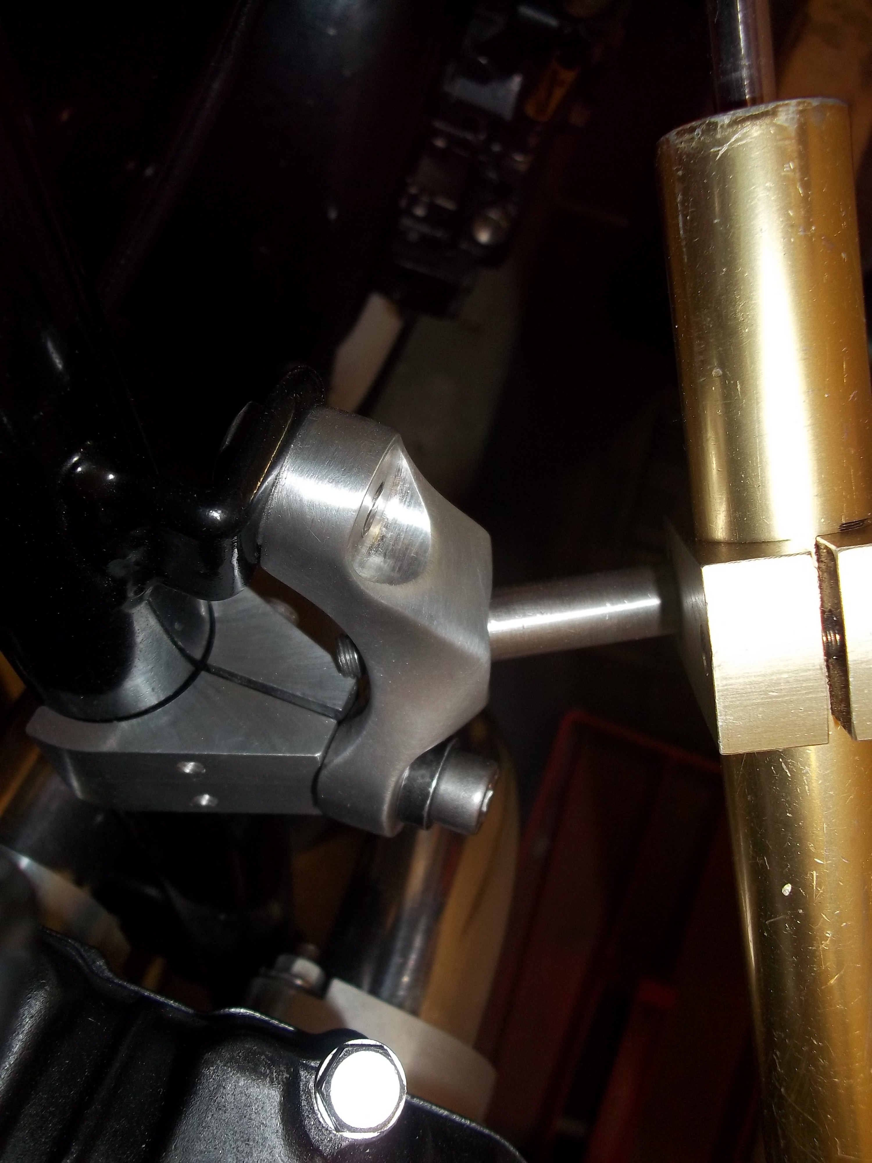

Soooo with plenty of 'unfinished jobs' on the list or initial ideas that need changing i had a look thro' me scrap box and armed with trusty hacksaw, faithfull drill and a draw of files cobbed bracket for the steering damper out of 3"x2" billet.
Numerous cardboard templates, a lot of cutting and filing, 20 brews, 40 tabs, 10 hours kip, a tickle with some fan grinders an' a dab with the odd spot facer and i had this -
Not wot i'd initially thought it would look like, but hey turned out 'alf right.
Just as well coz i dont want to make another!
Fork clamp is from Streefighter bling, damper is a 'hand me down' Sprint item and the frame clamp is from MPL Germany.

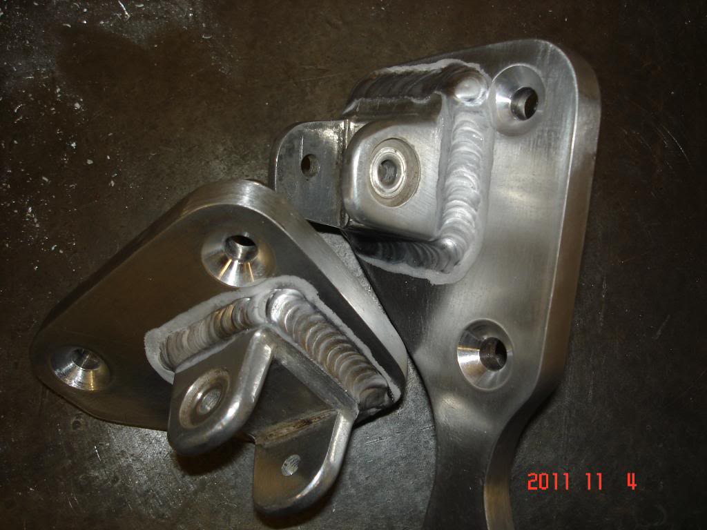

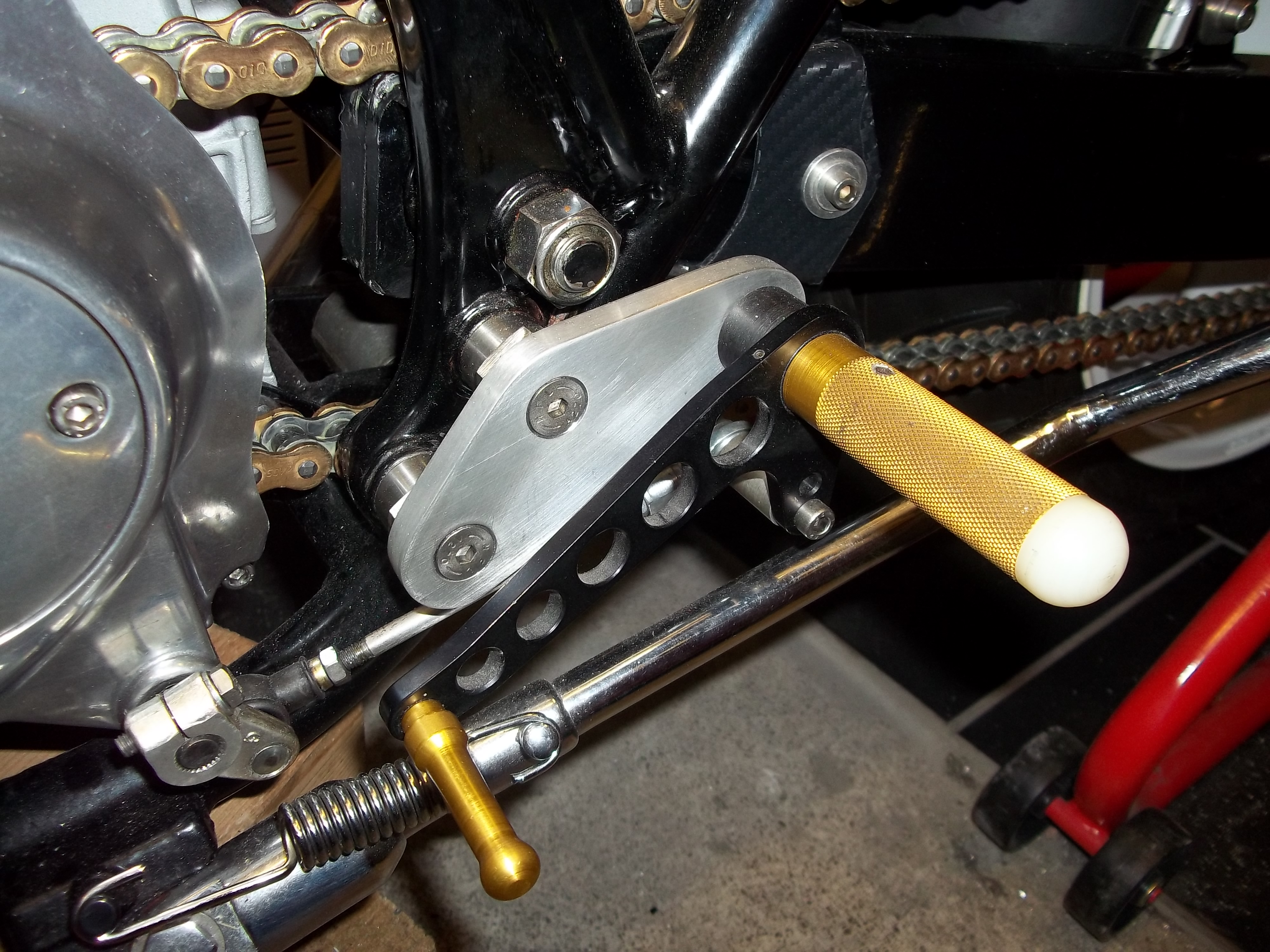

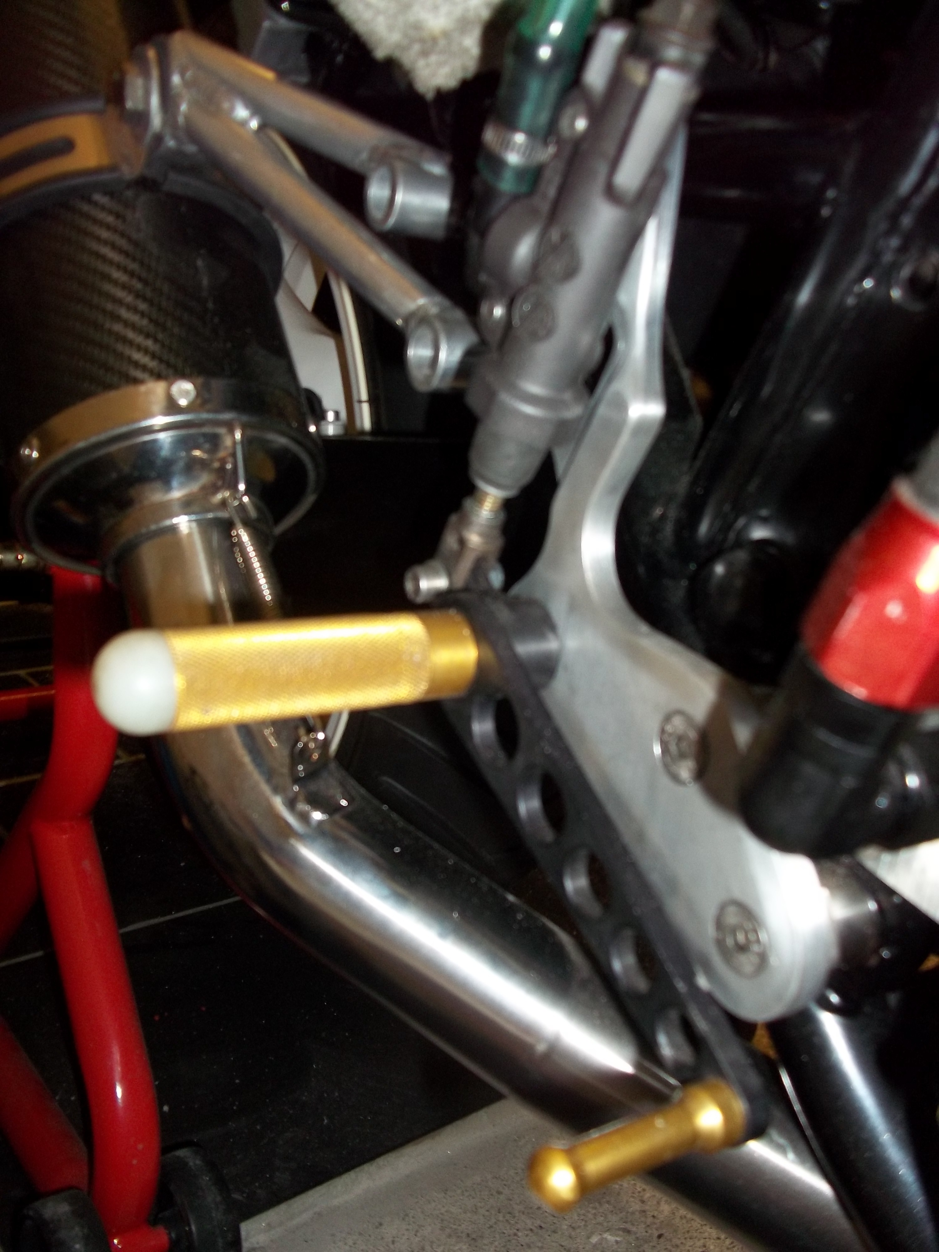

Next decision was to change the footpegs, even tho' i liked the black rearsets but ...... always a but aint there .....the gearchange was already using a large spacer and the rose joint linkage needed to be reversed (GB pointed this out to me in an earlier post) when i did so the angle increased on the rod and ... well long story short ive changed 'em.
Having had some Spondon pegs donated that were last gracing a YZF endurance bike circa 93-95 thought i'd use them if i cut some 10mm plate.
Que the saw, file, plenty of brews an tabs scenario an i had these -
