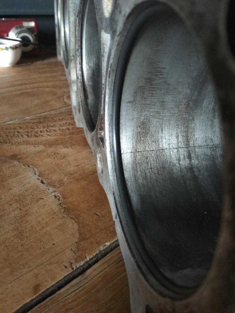

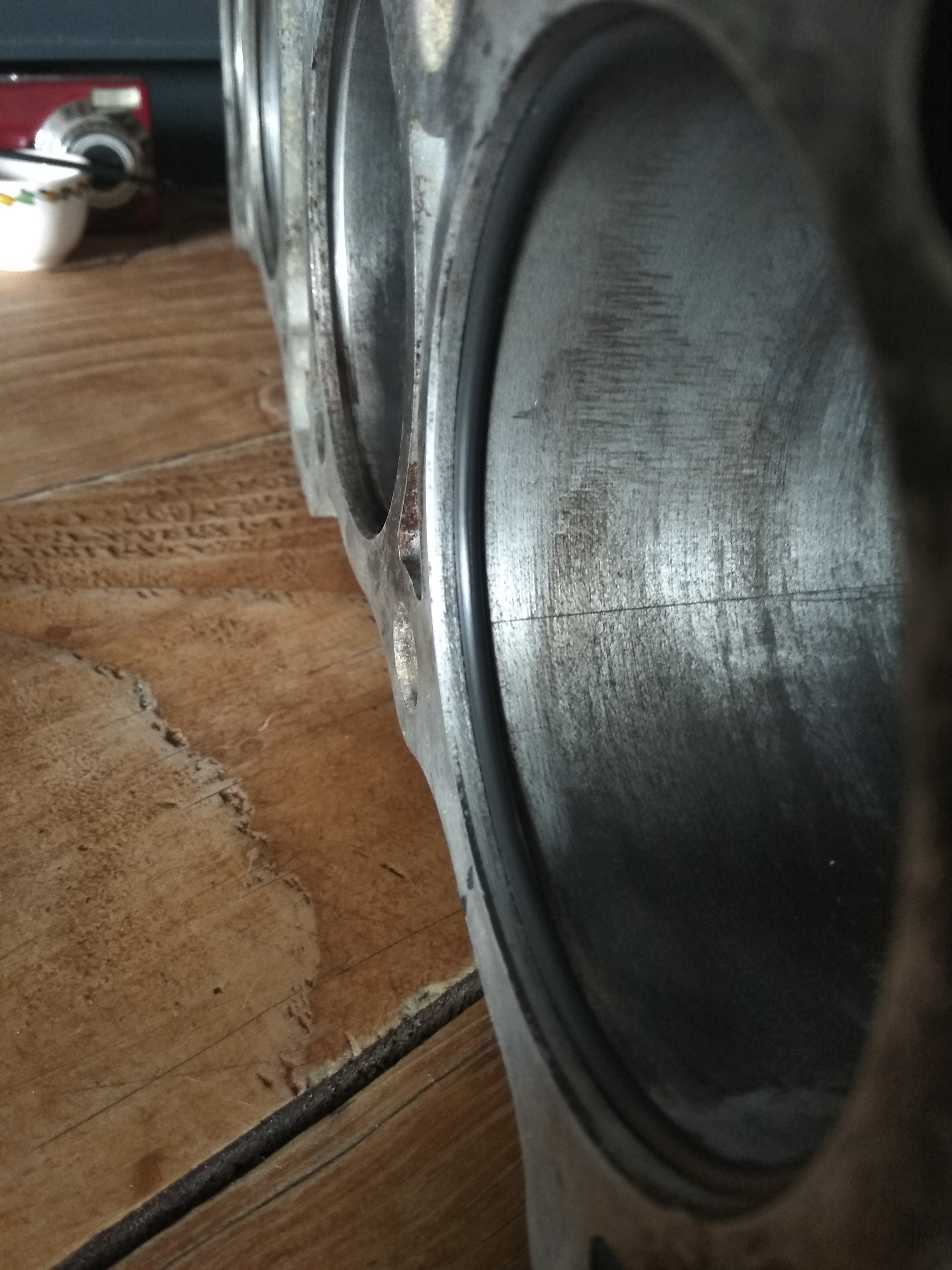

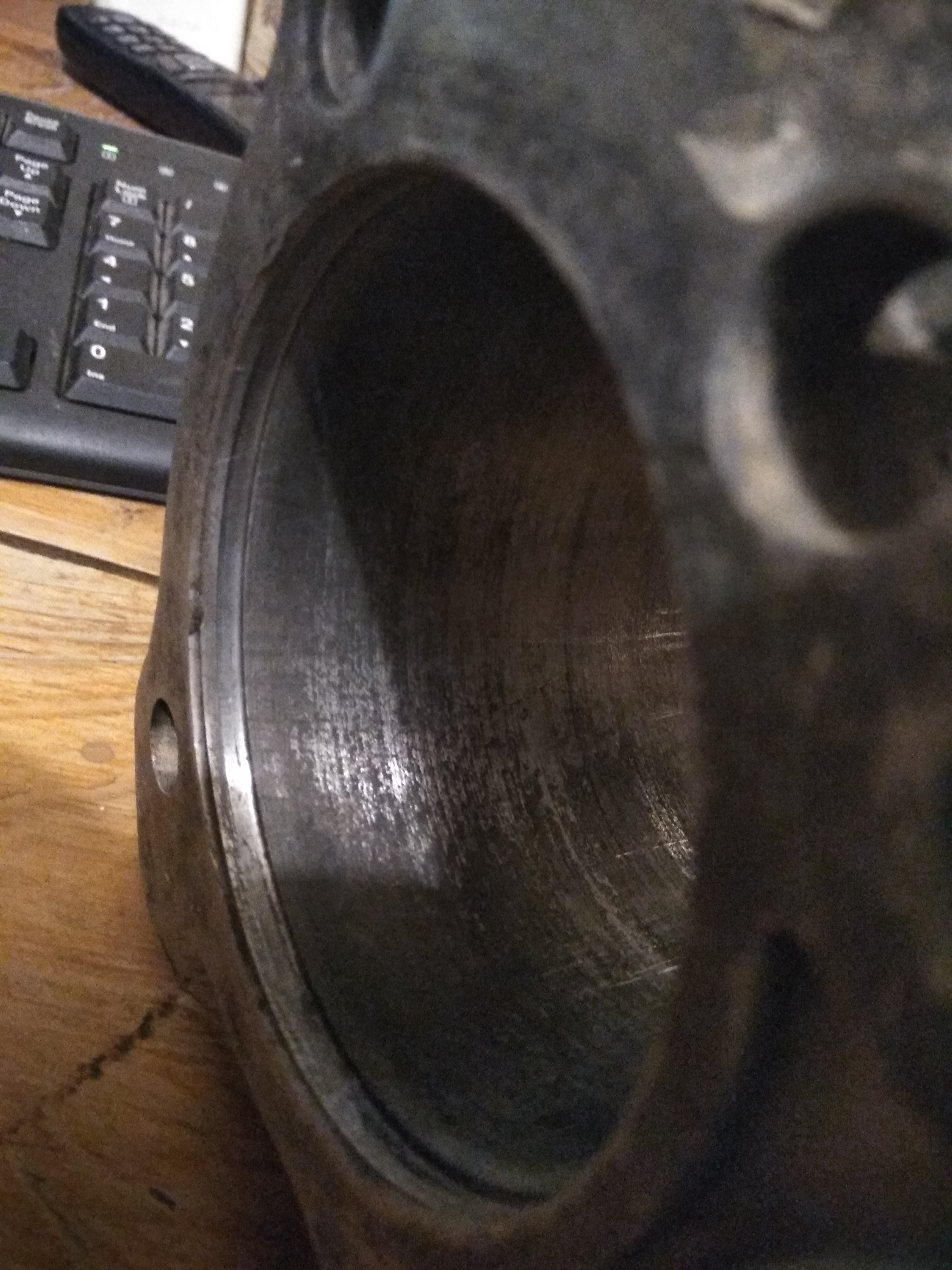

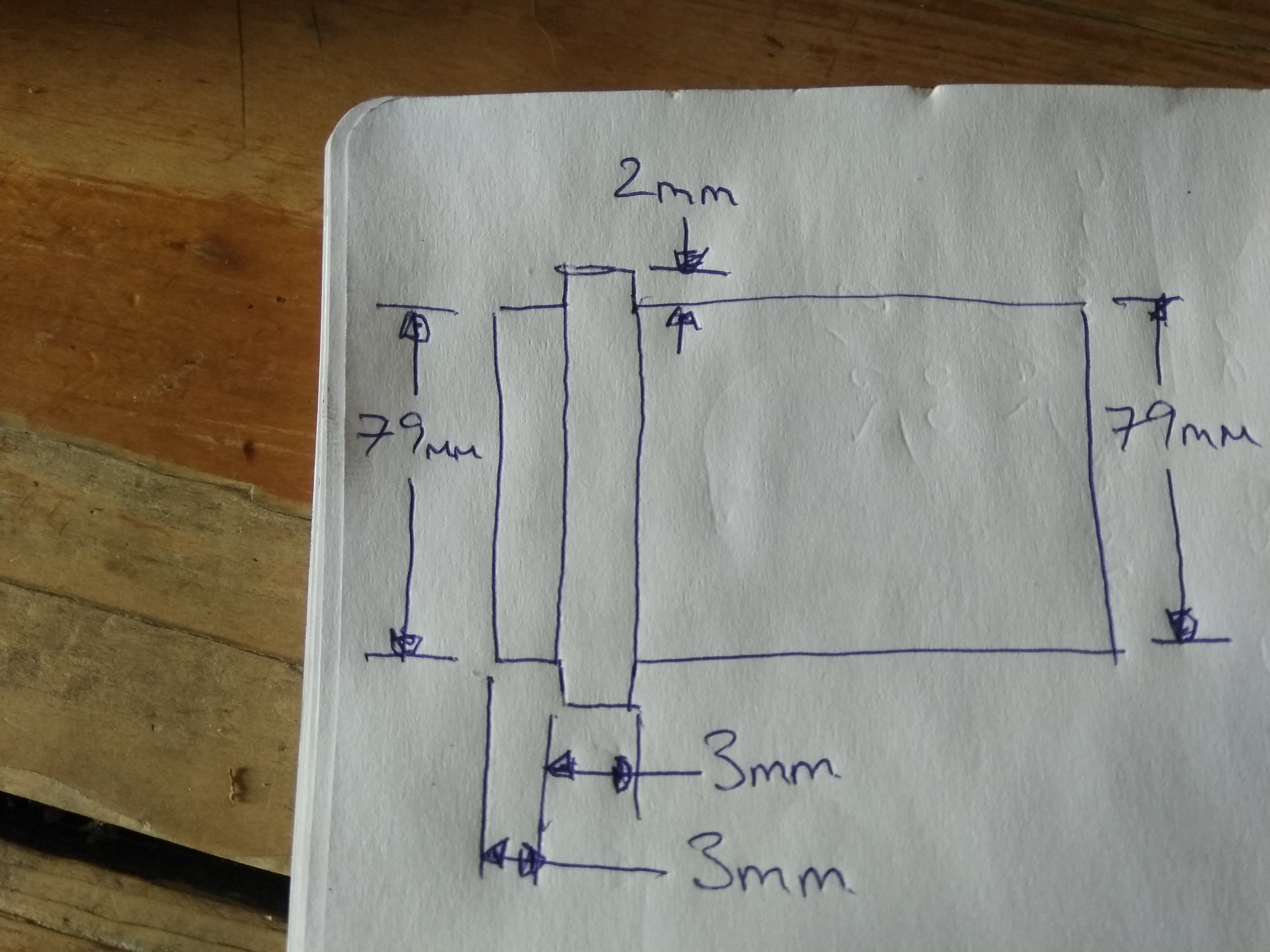

Thanks Rob but I must be missing something.
Here is a picture of the spare barrels with an o ring in place
And here's a quick sketch of the cylinder without an o ring as if it's been cut in 1/2 length ways
Liners back out anyway by the looks of it.
