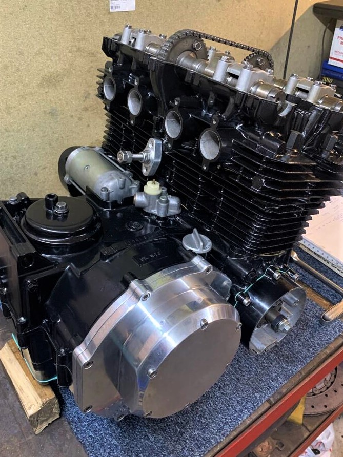

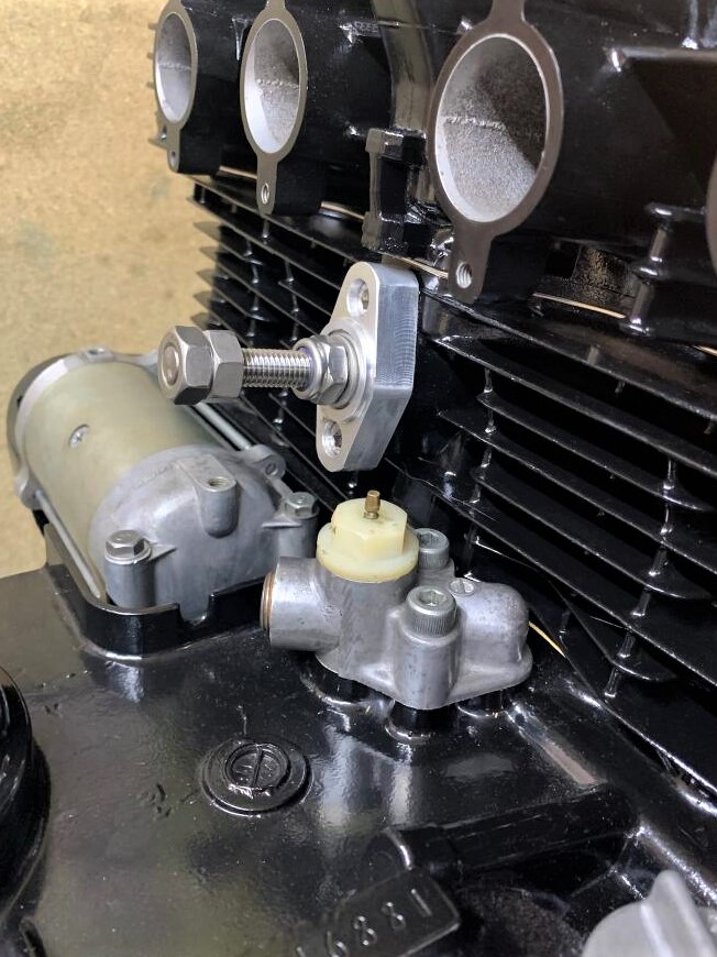

#77 PostAuthor: Bevelhead » Sat Feb 13, 2021 10:42 pm
Found a good set of cams, so the engine is now almost done. Also fitted a homemade manual camchain adjuster. Next is to source a set of manifolds to suite the RS34 flatslides, then they can be test fitted.

I'm sure you're fully aware, but don't tension the cam chain until the cam cover is on :lol:

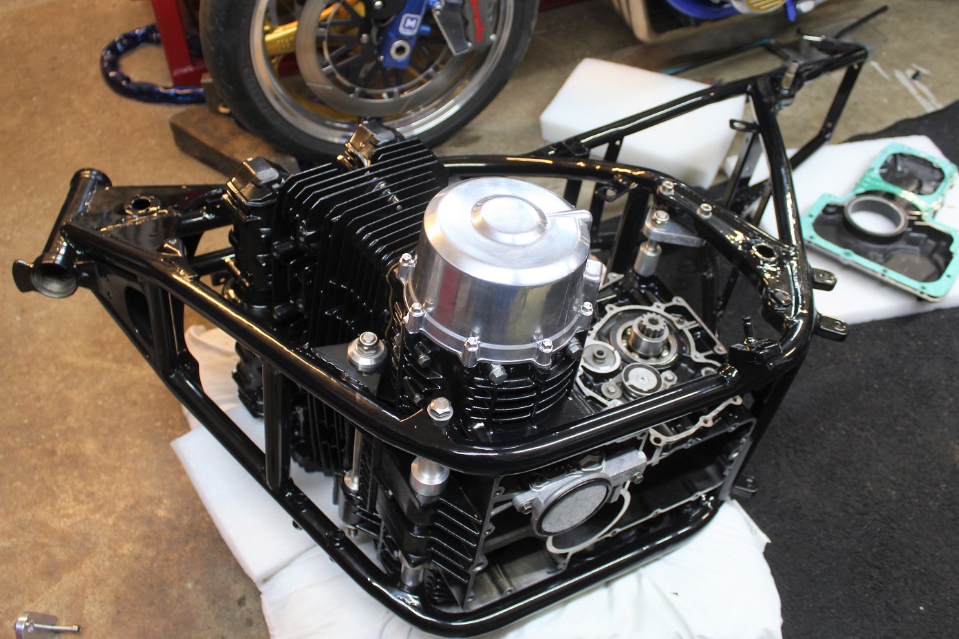

#90 PostAuthor: Bevelhead » Thu May 20, 2021 5:34 pm
Finally got the Gpz1170 engine in the Z650 frame, though it put up a fight. We had to remove the sump and cut back a tab that had been added to mount the Z1 side panel. The latter being done after the engine had gone off to be rebuilt. There's enough left of the tab that I can drill and mount a replacement for the piece we had to hacksaw off. Thankfully it behind the side panel so will be hidden from view. Note that the front rubber engine mount has been replaced with a solid mount, using top hat spacers.
