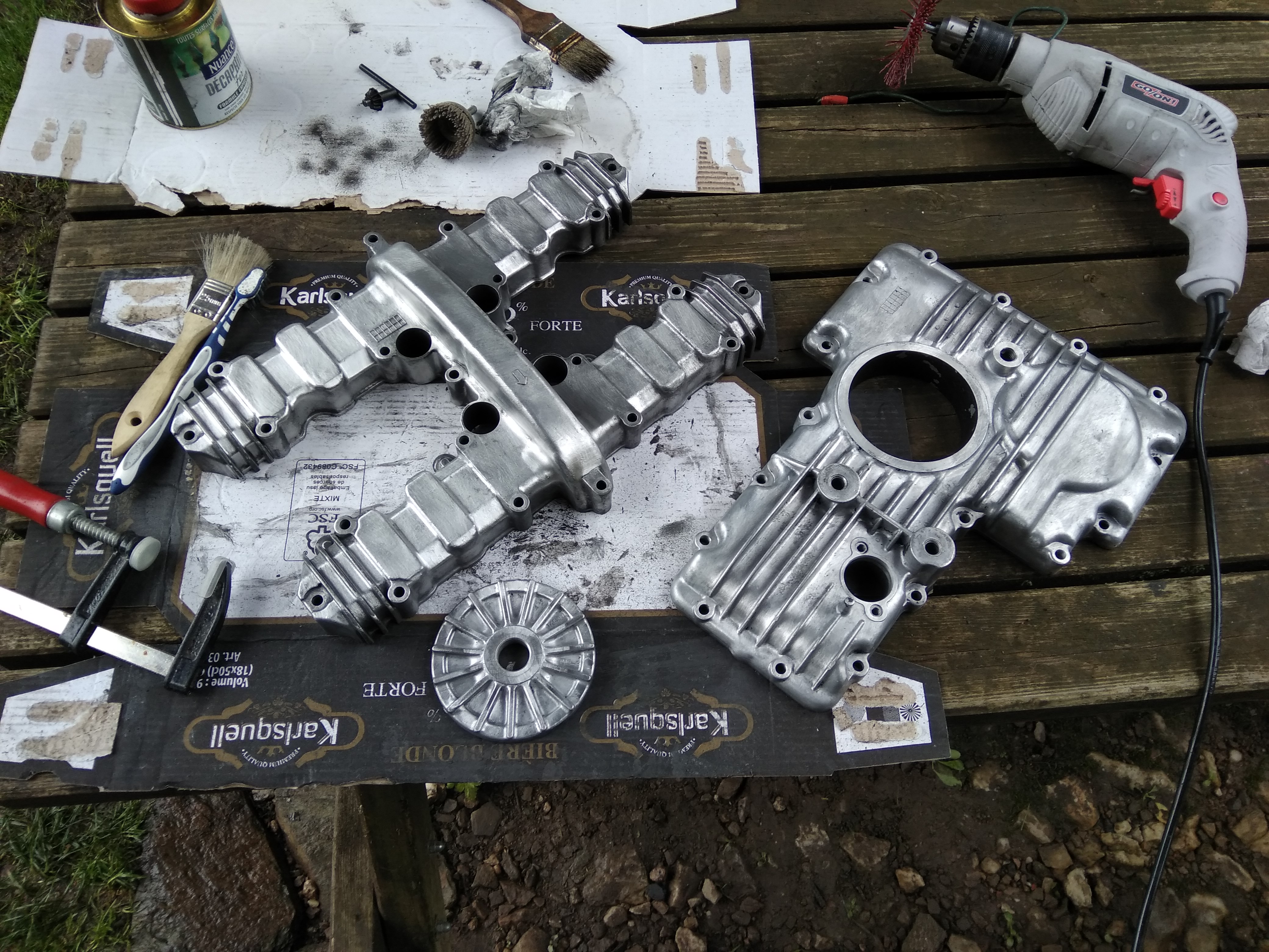

Finally bit the bullet with the engine casings. The blasters never replied. I did send photos of the engine, may have put them off if they're not kitted up for that. Got hold of a friend of a friend who's in a local classic car club. He gave me the details of a chap who does work on the members cars, unfortunately he only uses sand so he must do body panels etc. and I am nervous about sand blasting the engine in case it impregnates the ally. From experience doing a bit of sand blasting on oak beams in a house I know it gets everywhere no matter how much masking you do.
The hard way it is then, paint remover and nylon brushes.....
The sump pan almost did itself, stripper applied, wait, jet wash, repeat twice more in the places the paint hadn't lifted, bit of a scrub, done. I'm hoping the engine casings go the same way..
The rocker cover was a different story. Stripper, rotary brush..repeat, repeat, repeat...eventually got it almost done, will need a smaller brush to finish some less accessible places. Not looking forward to the head and cylinder block. The barrels still haven't got the liners in so I may cheat and plywood the top and bottom and sand blast it. The head will just have to laborious.

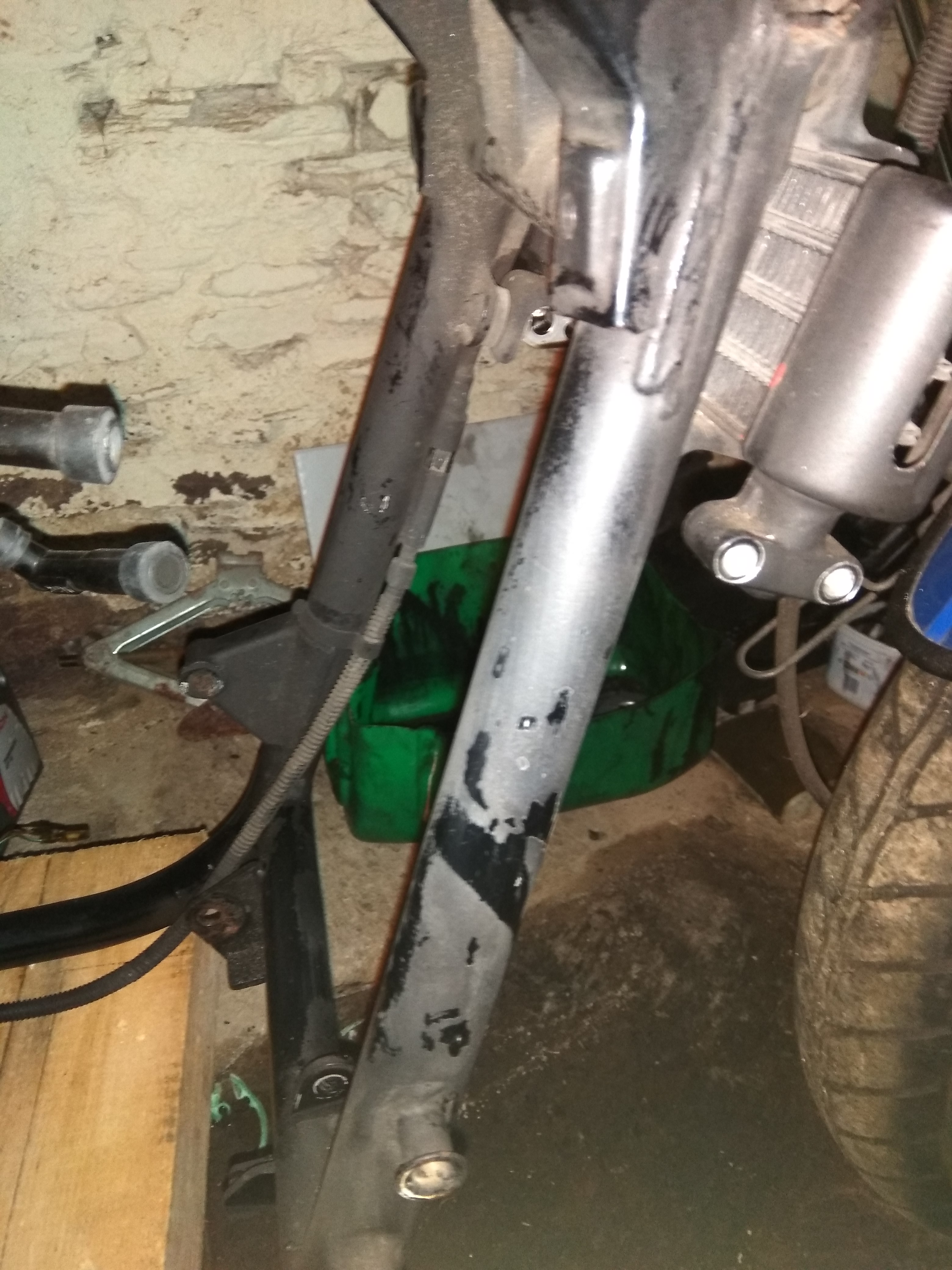

Started looking at the rest of the bike and it seems the front frame tubes have had a mist coat from an aerosol to hide some chips, which it doesn't, so I think the lot is going to get pulled apart.

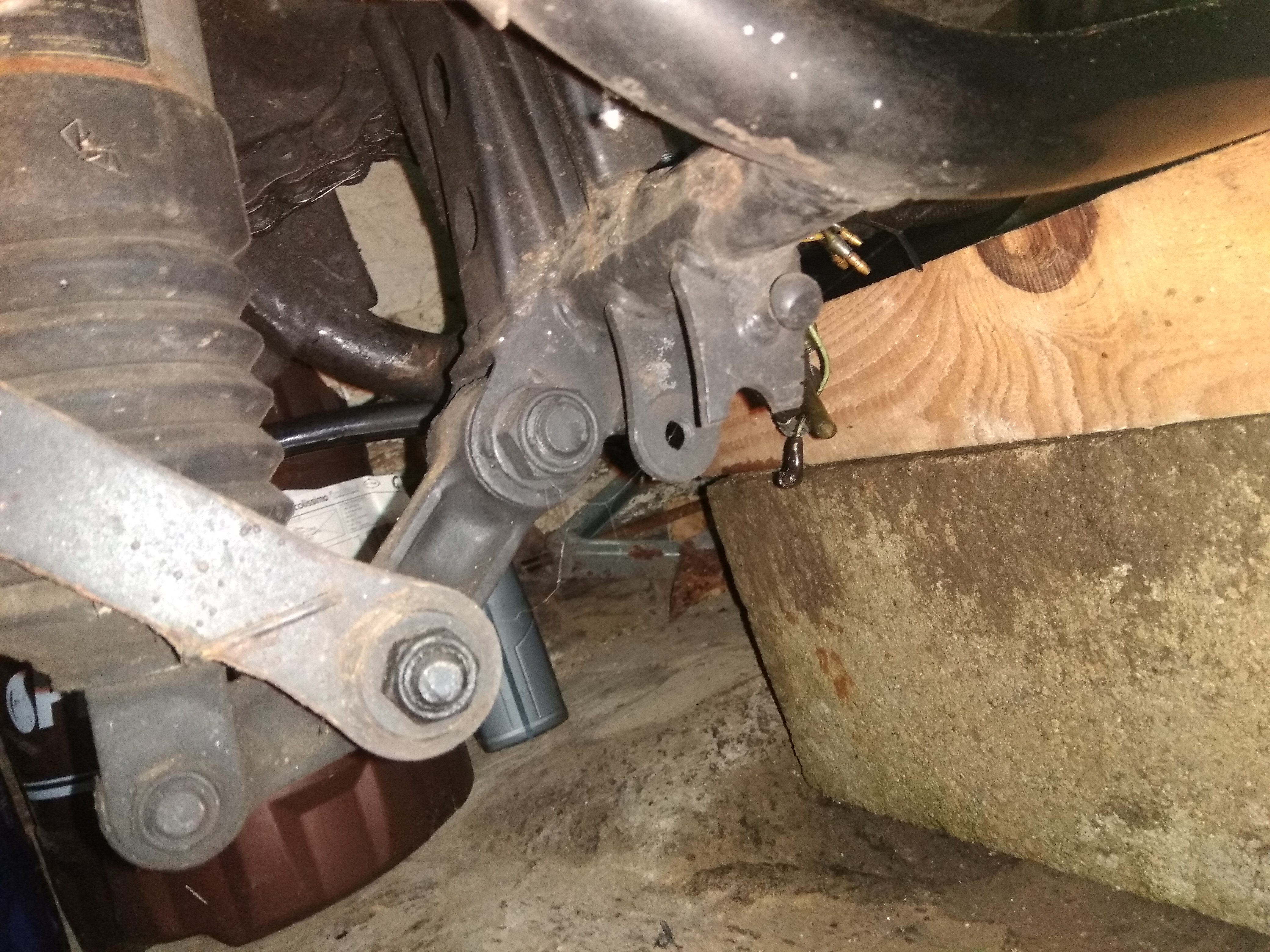

The rhs centre stand mount is bust so will need repairing
And the 'mounting' on the lhs lower frame by the side stand is bent

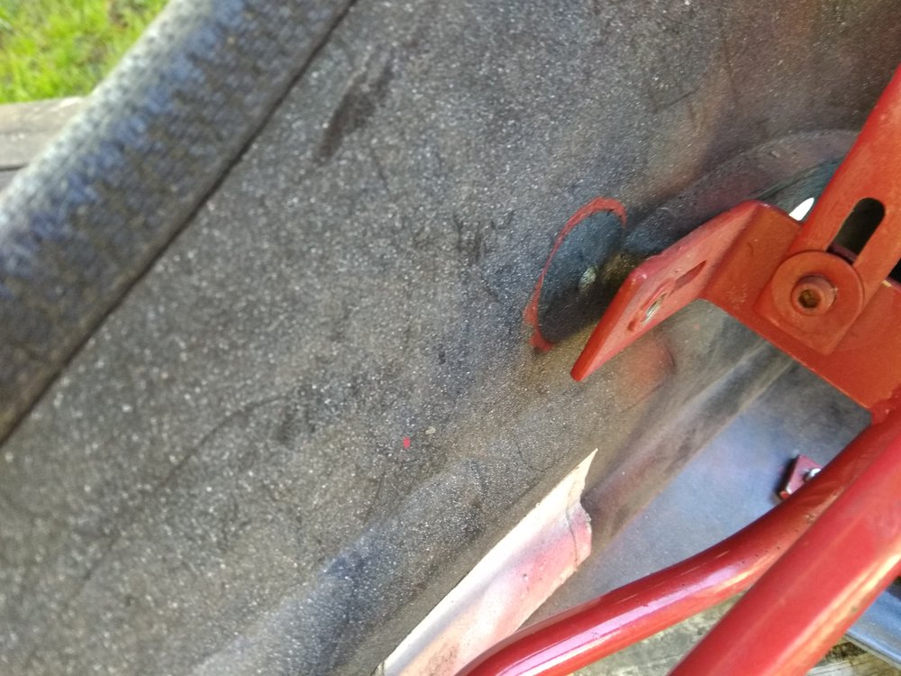

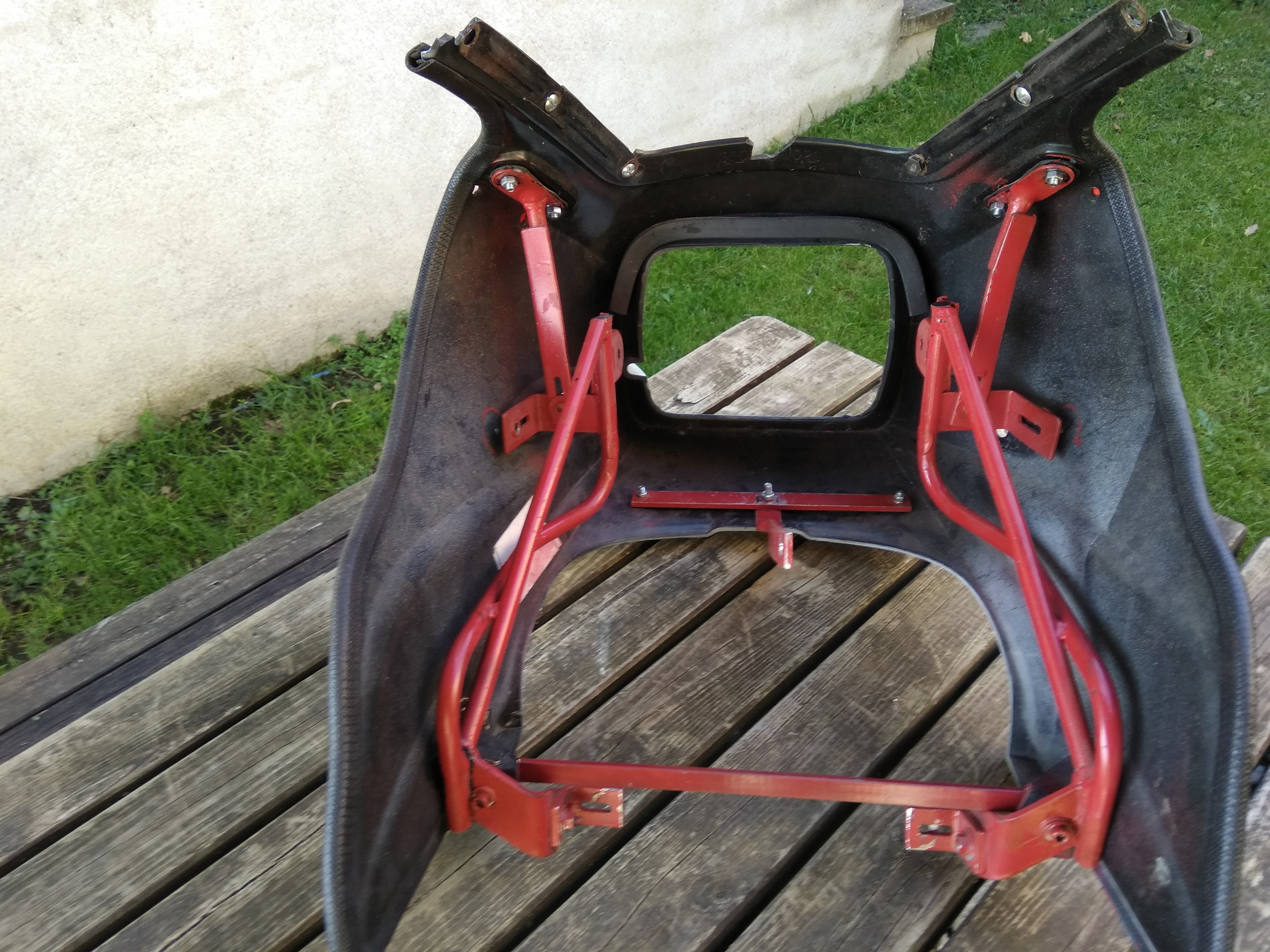

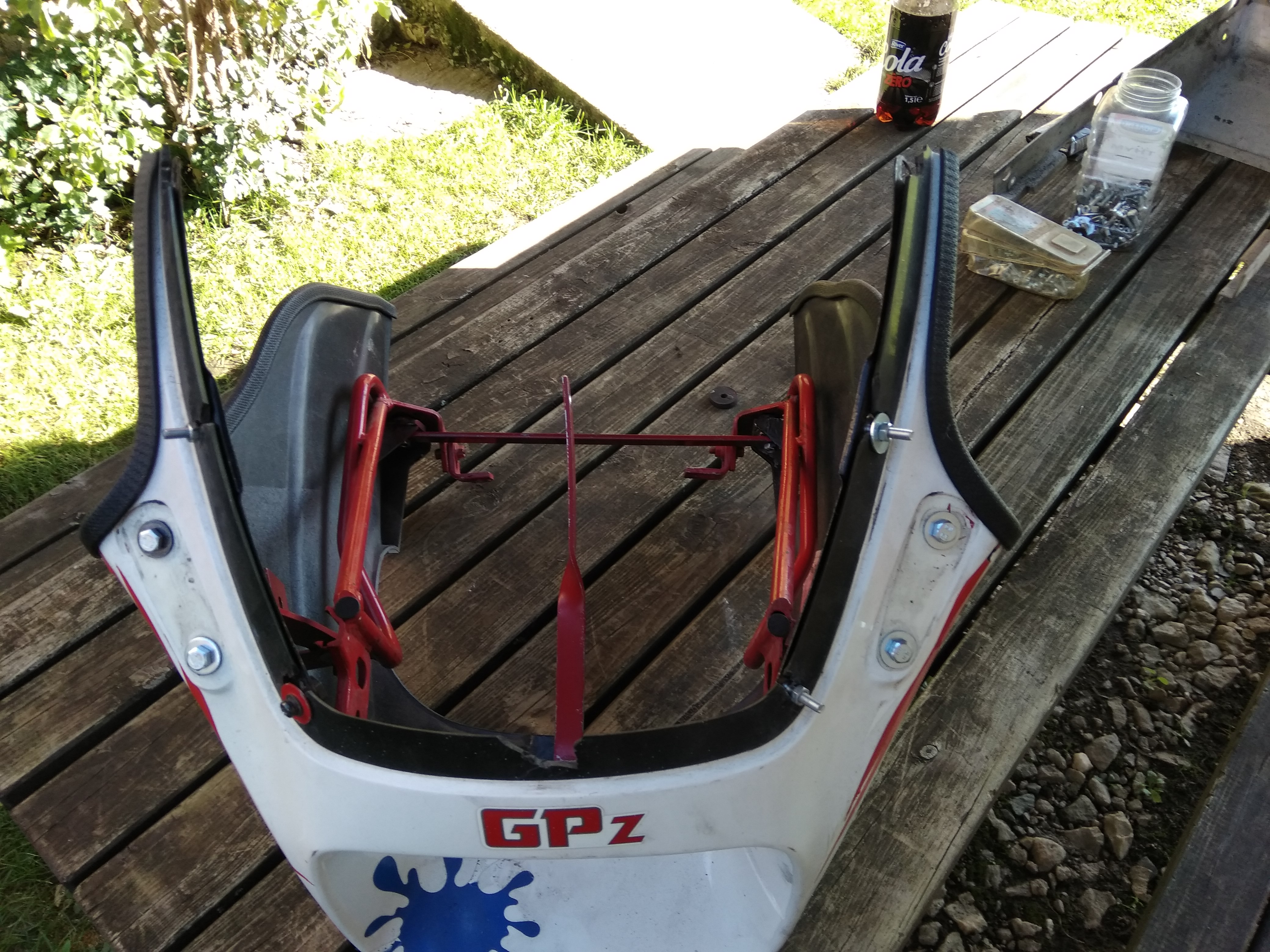

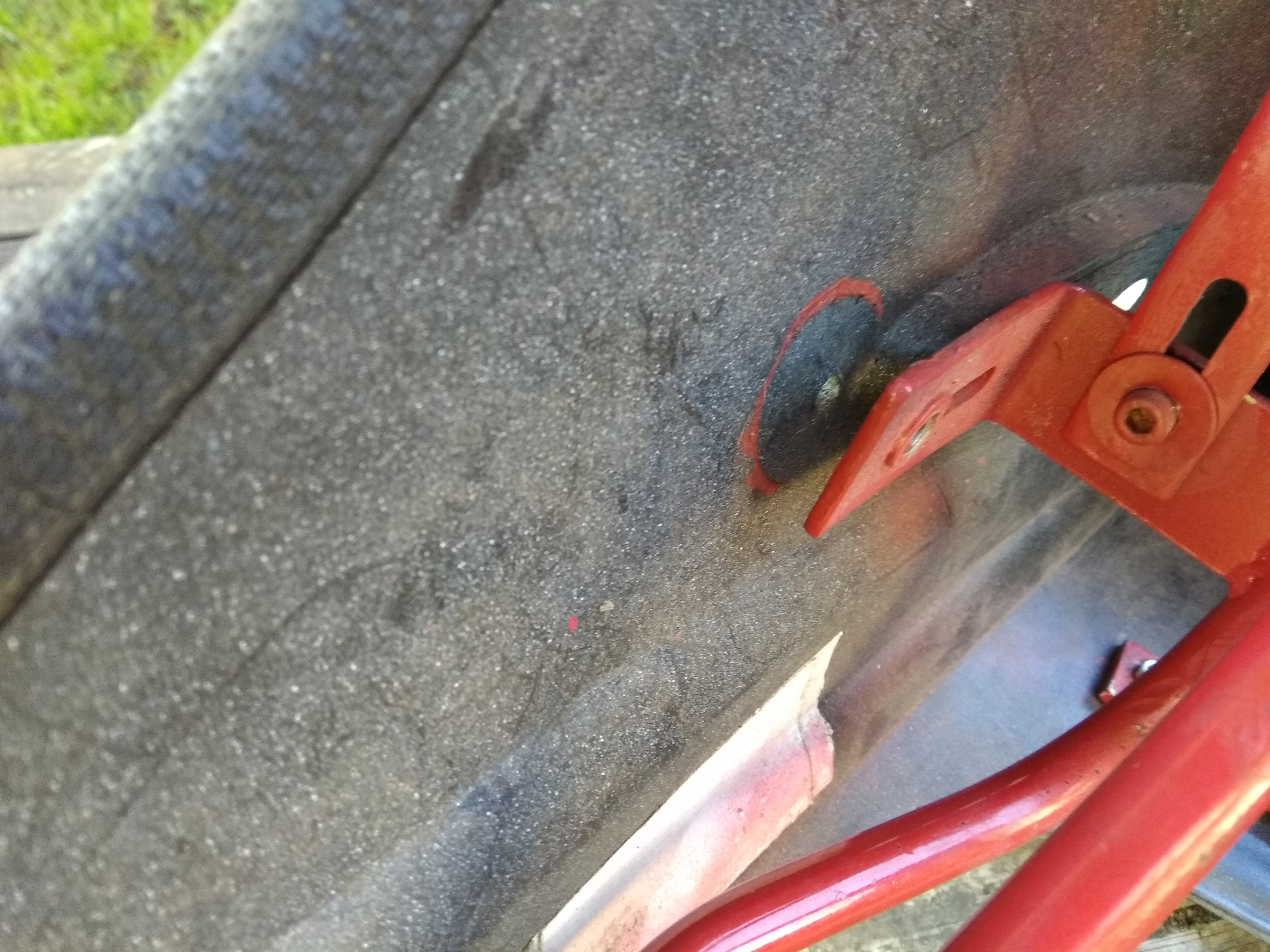

First off was trying to work out where the bits of fairing mountings go. The only one's I've seen are all in one units or in top and bottom pieces. Mine looks a bit home made in places.
I can't believe it's complete or correct as it is only held on by the 2 rear mounts and the centre 'T'?
What's missing here?

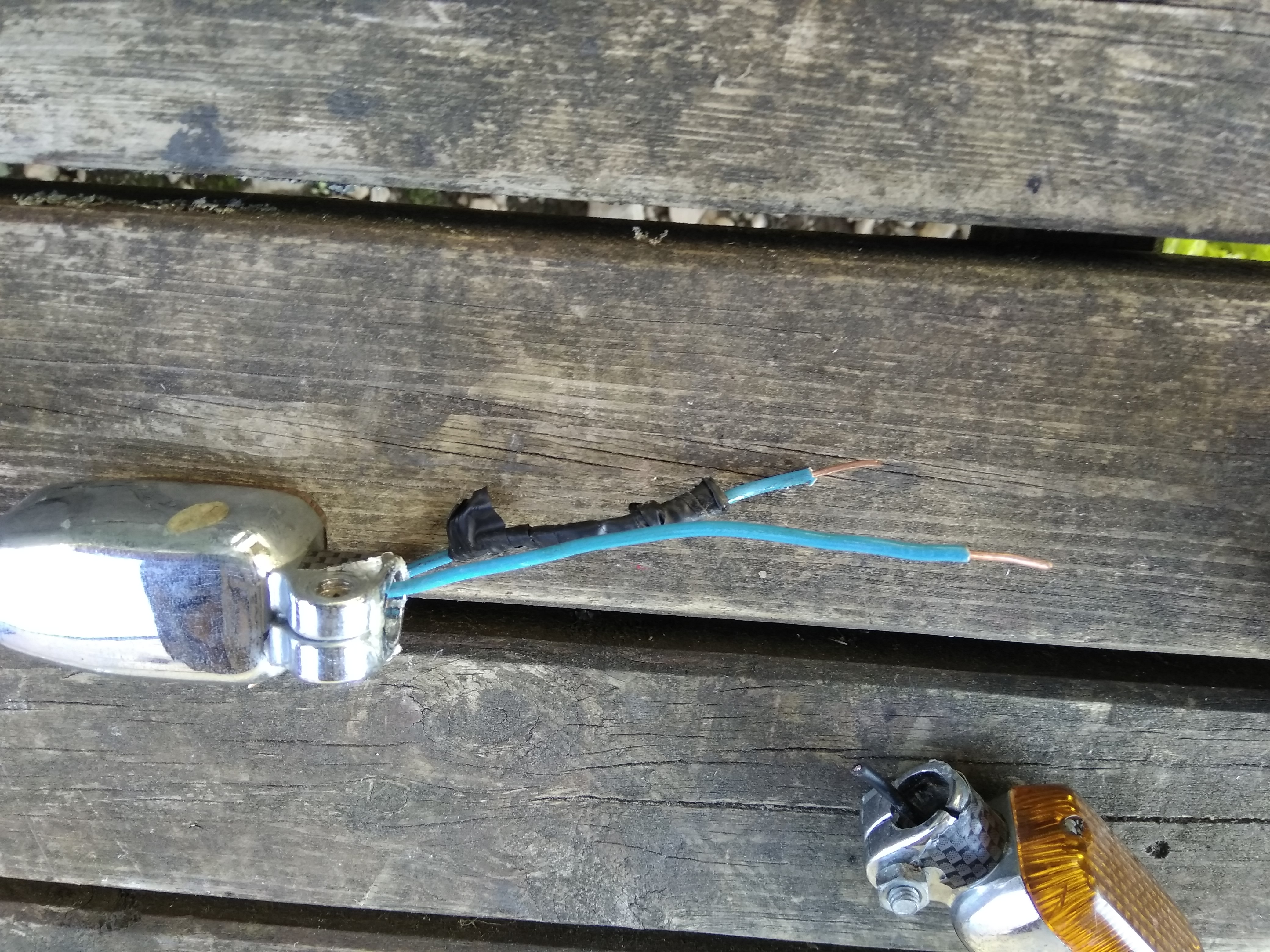

The indicators were interesting, bit of 1.5mm neutral house wiring and then fibre-glassed to the original indicator mounts

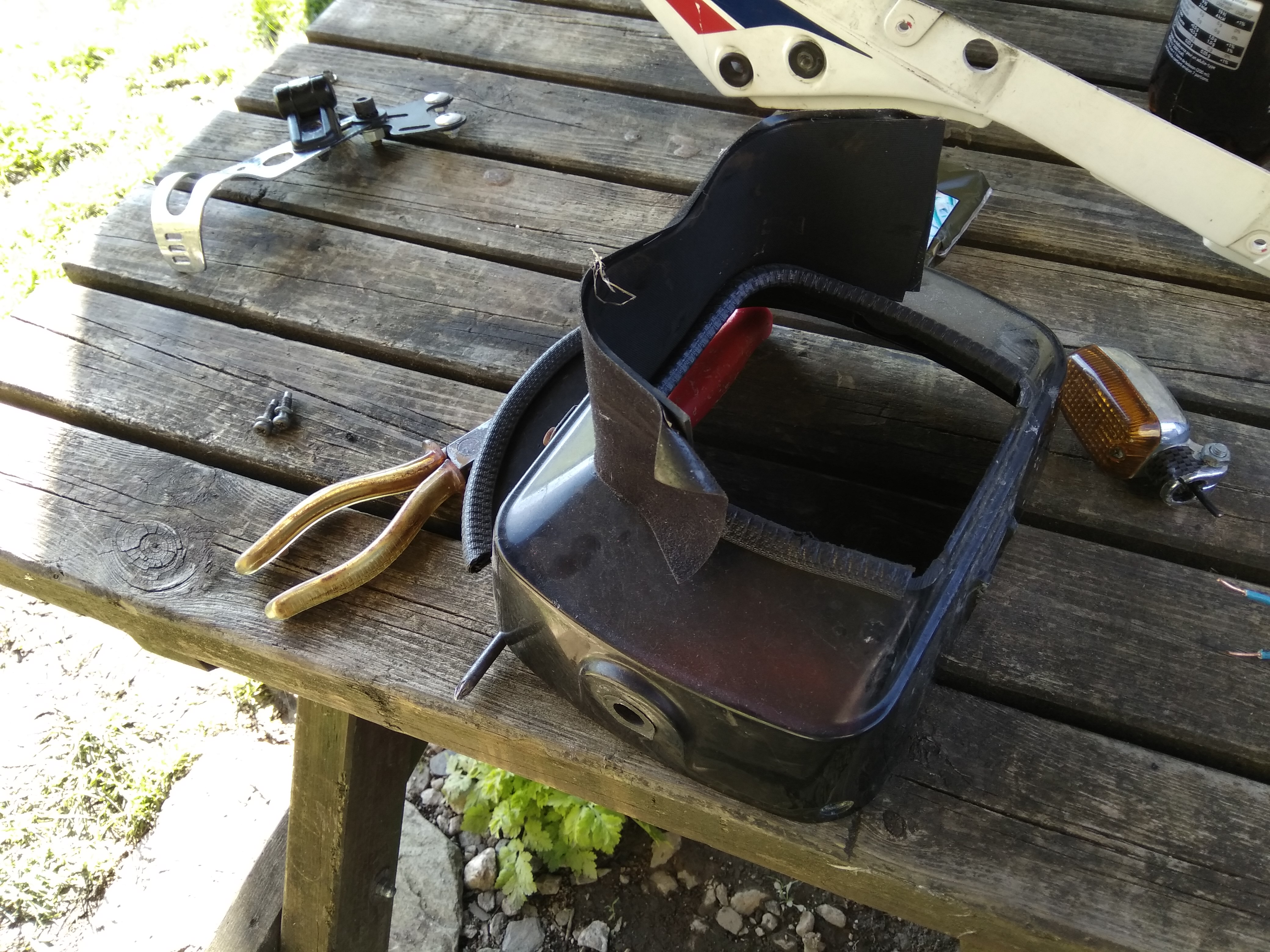

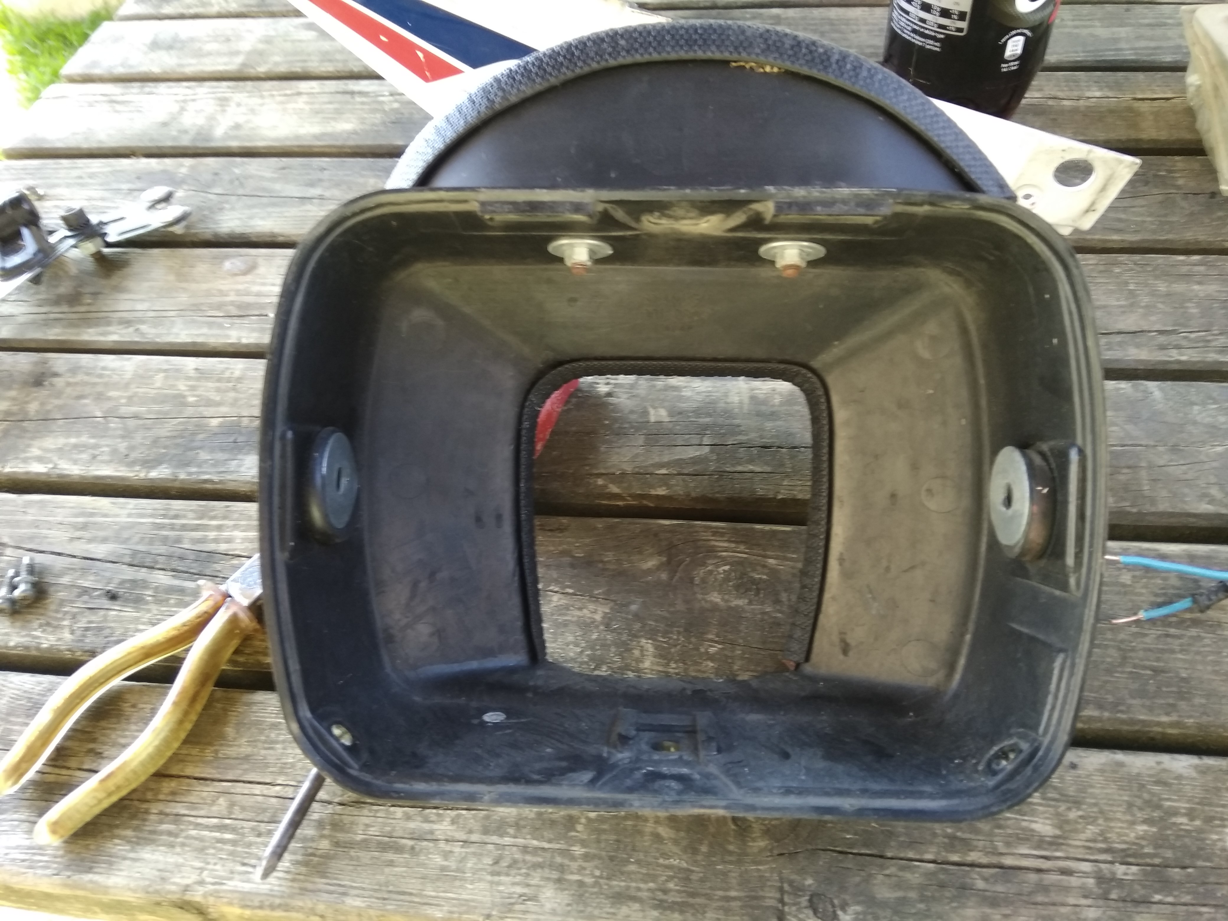

Which left the 'adjusted' headlight bowl

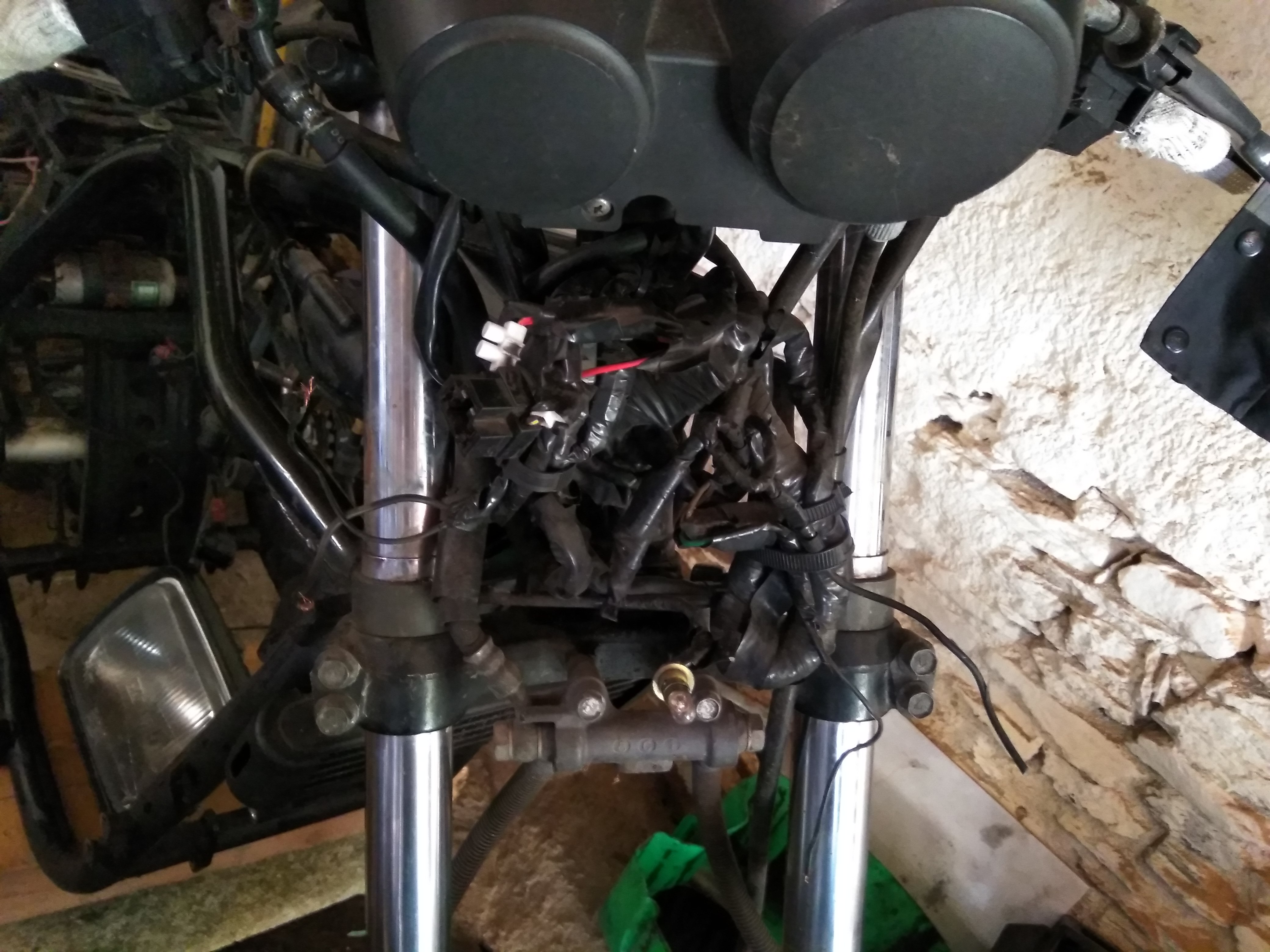

Which nicely exposed the wiring under the headstock

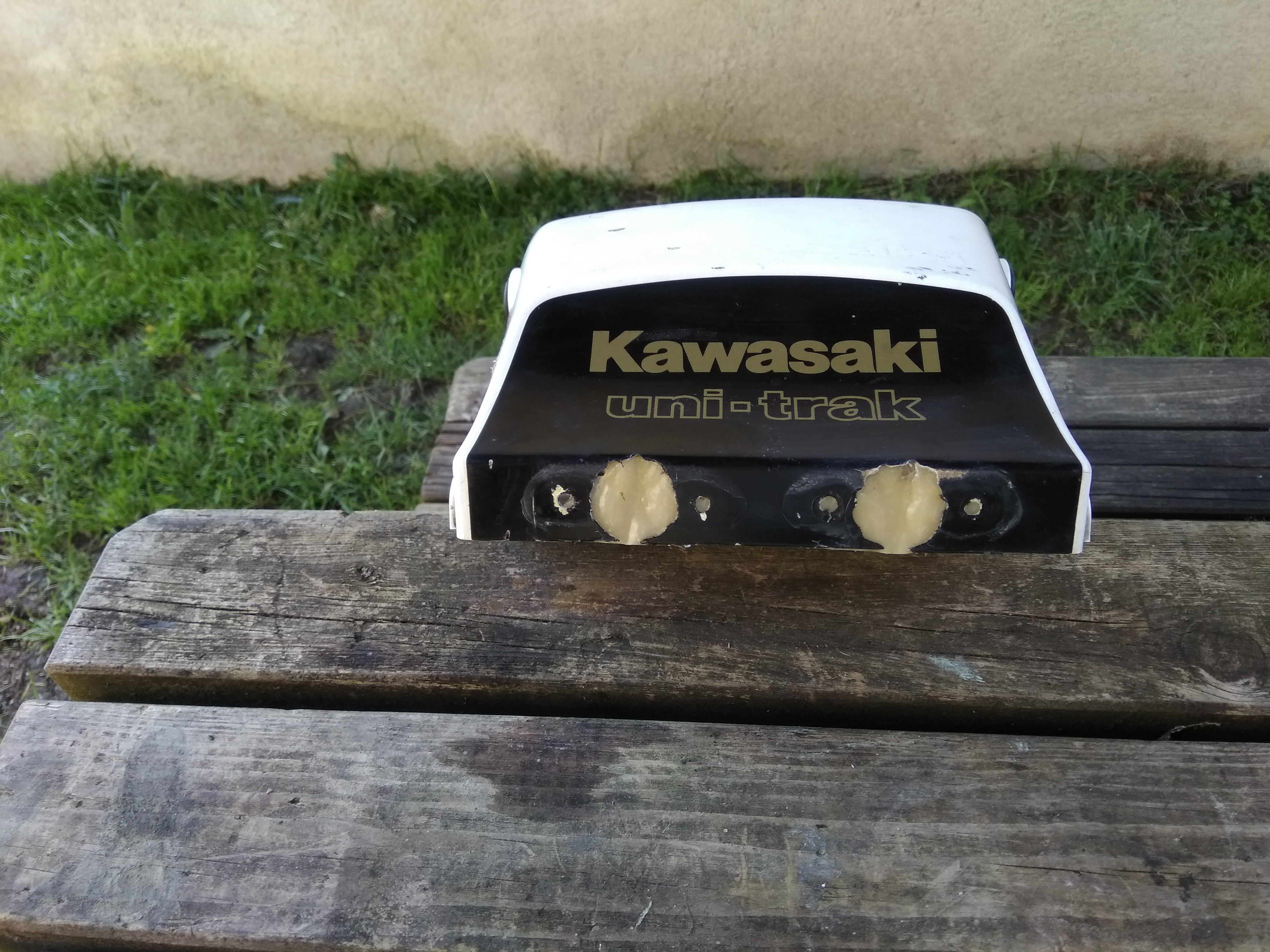

And lastly, got the first coat of fibreglass in to the 'modded' tailpiece.
The nose cone will need a bit as well.

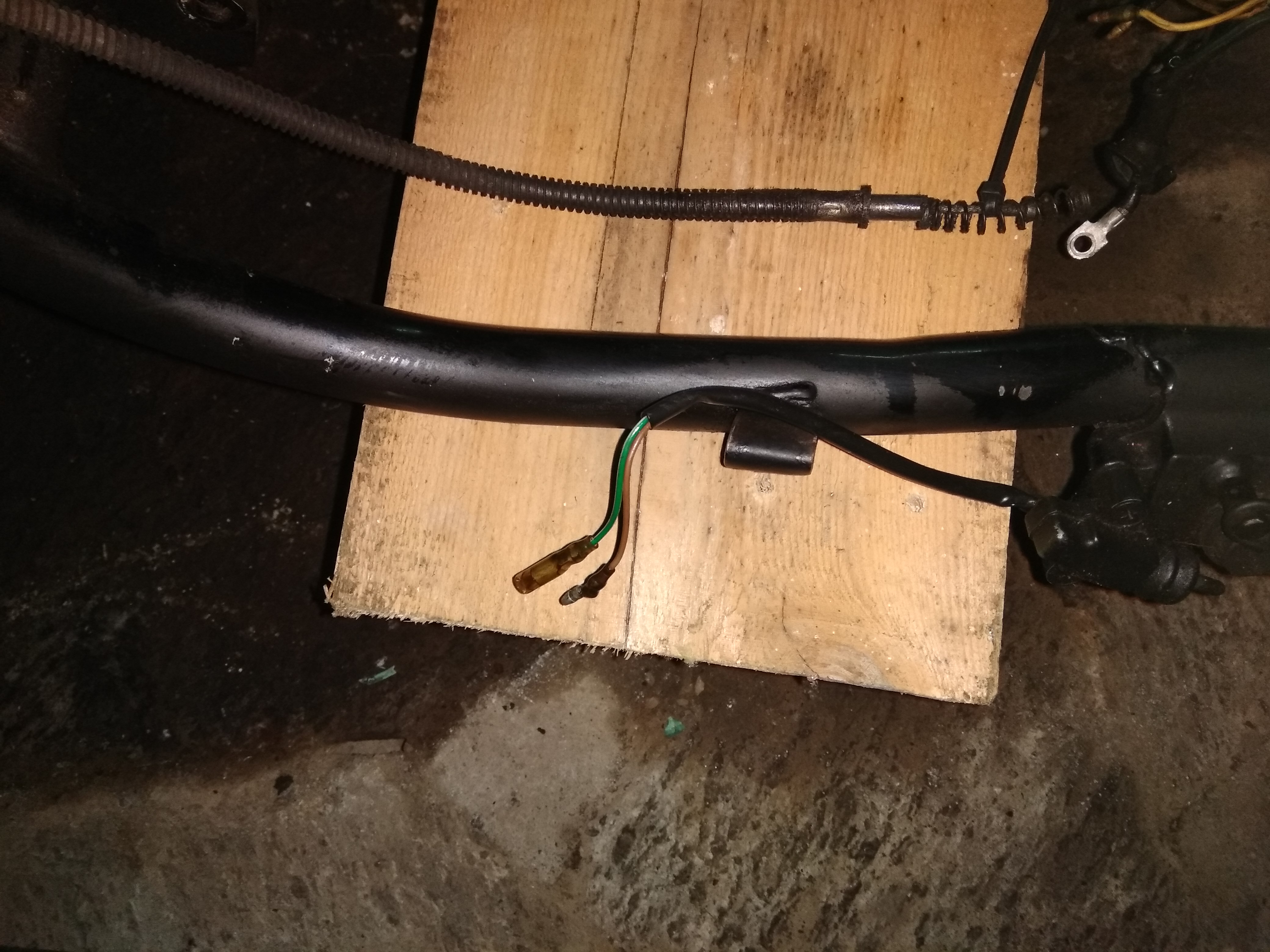

Re: GPZ11 Injection
Hi Pete
the frame for the fairing you have is not an original Gpz 1100 frame.
An original one is in one piece, not bolted together.
There's a difference between an A1 and an A2,A3 frame. The A1 fairing has no plastic covers inside, the A2 and A3 have them, hence the difference.
Take a look at "bike-teile.de" or "ebay-kleinanzeigen " you can find those frames in Germany.
Good luck!
Good luck!

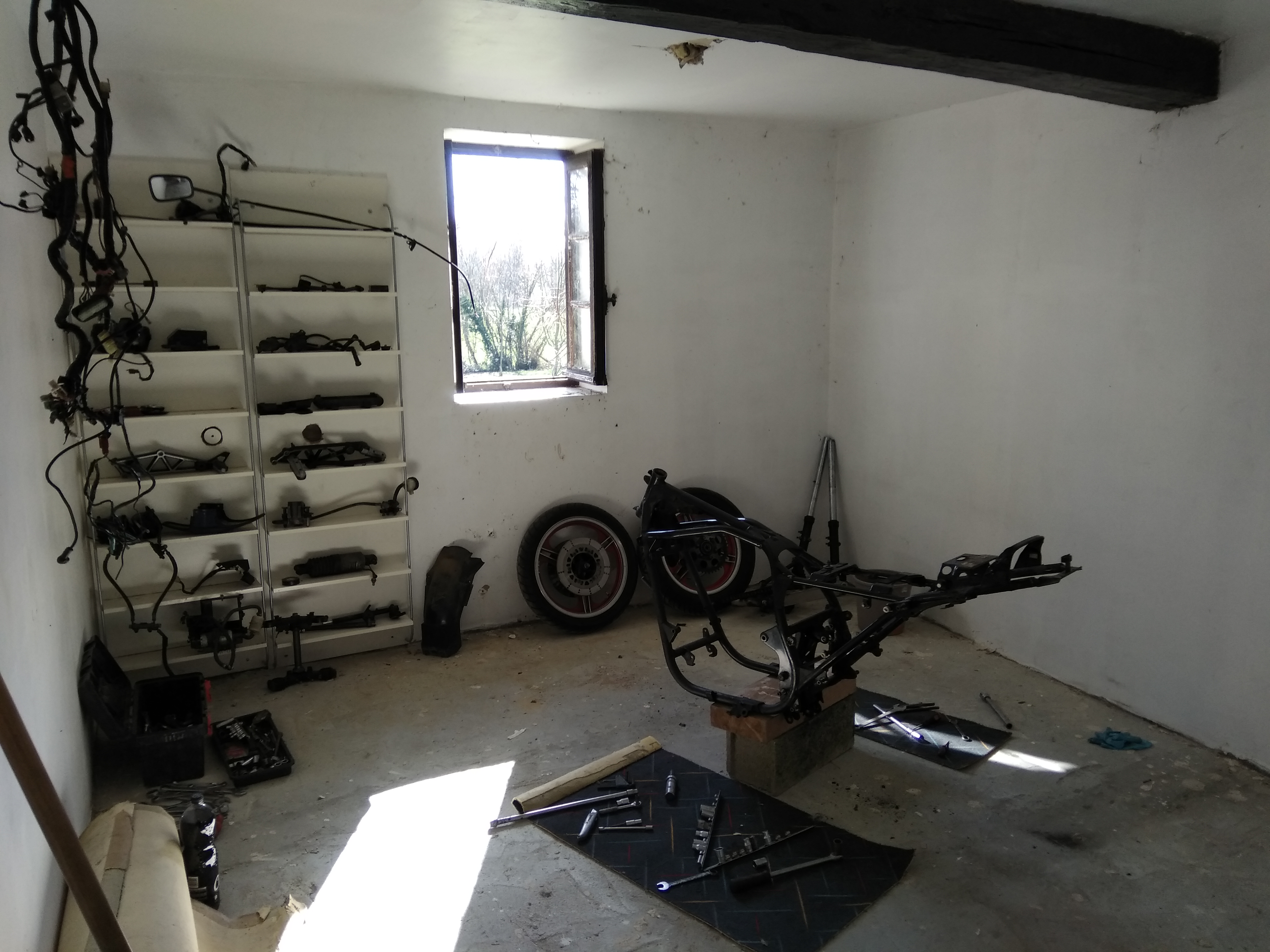

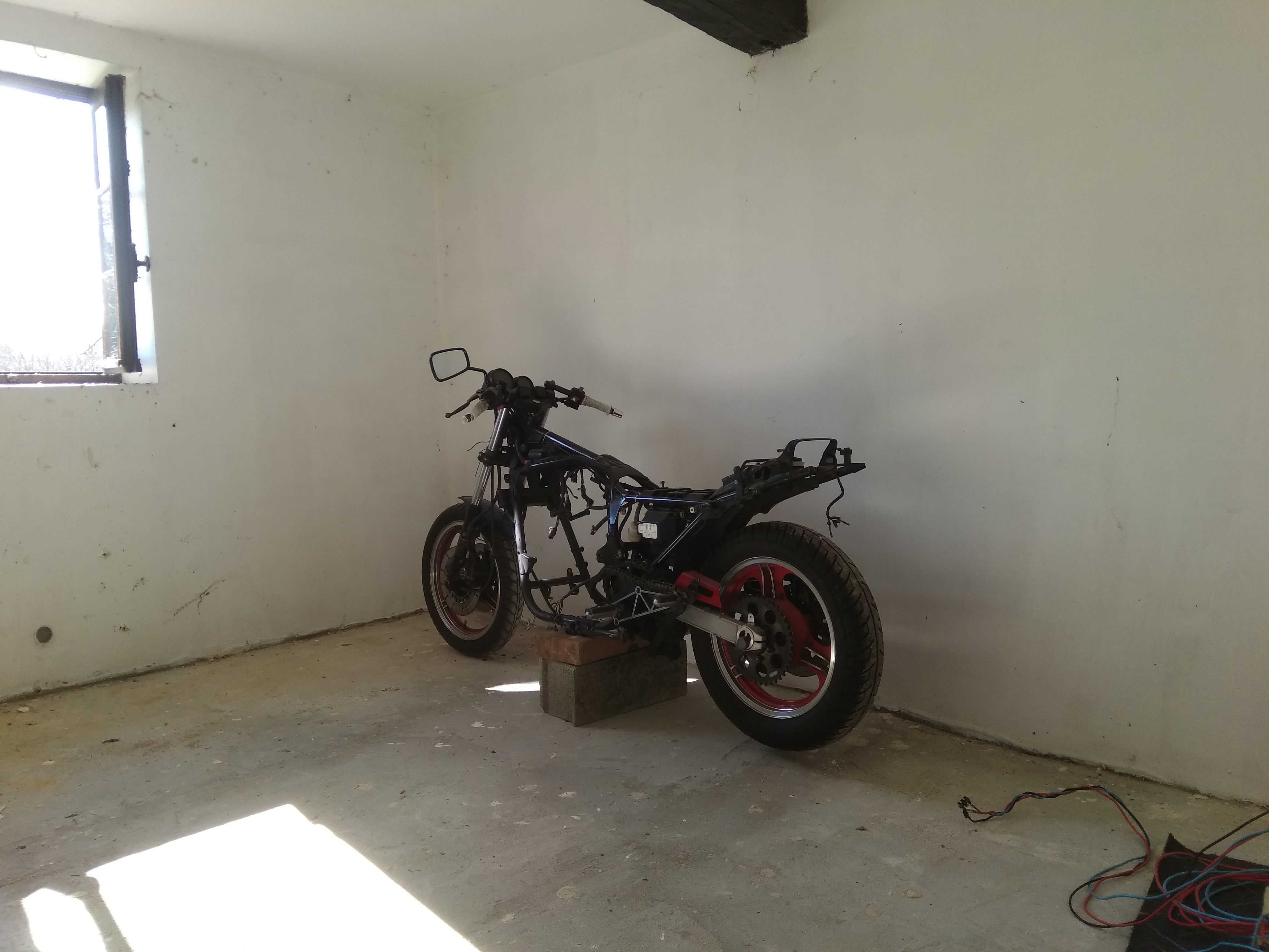

It's been a while, my workshop is full and with winter no chance of working outside but finally the old girl got re-housed yesterday.
And as of an hour ago now looks like this.
The forks have been off before, probably seals, because the handle bar brackets were on the wrong way round (little triangle pointing backwards). The 1500m of insulation tape 'protecting' the harness between the yokes took and age to remove and the pivot set up and rear shock has been off unless the chappy in Japan put the bolts in the wrong way round (according to the manual). The headstock bearings were a little ratchety but were over tightened a tad and dry but seem OK.
There are two jobs on the frame to do. The broken centre stand piece.

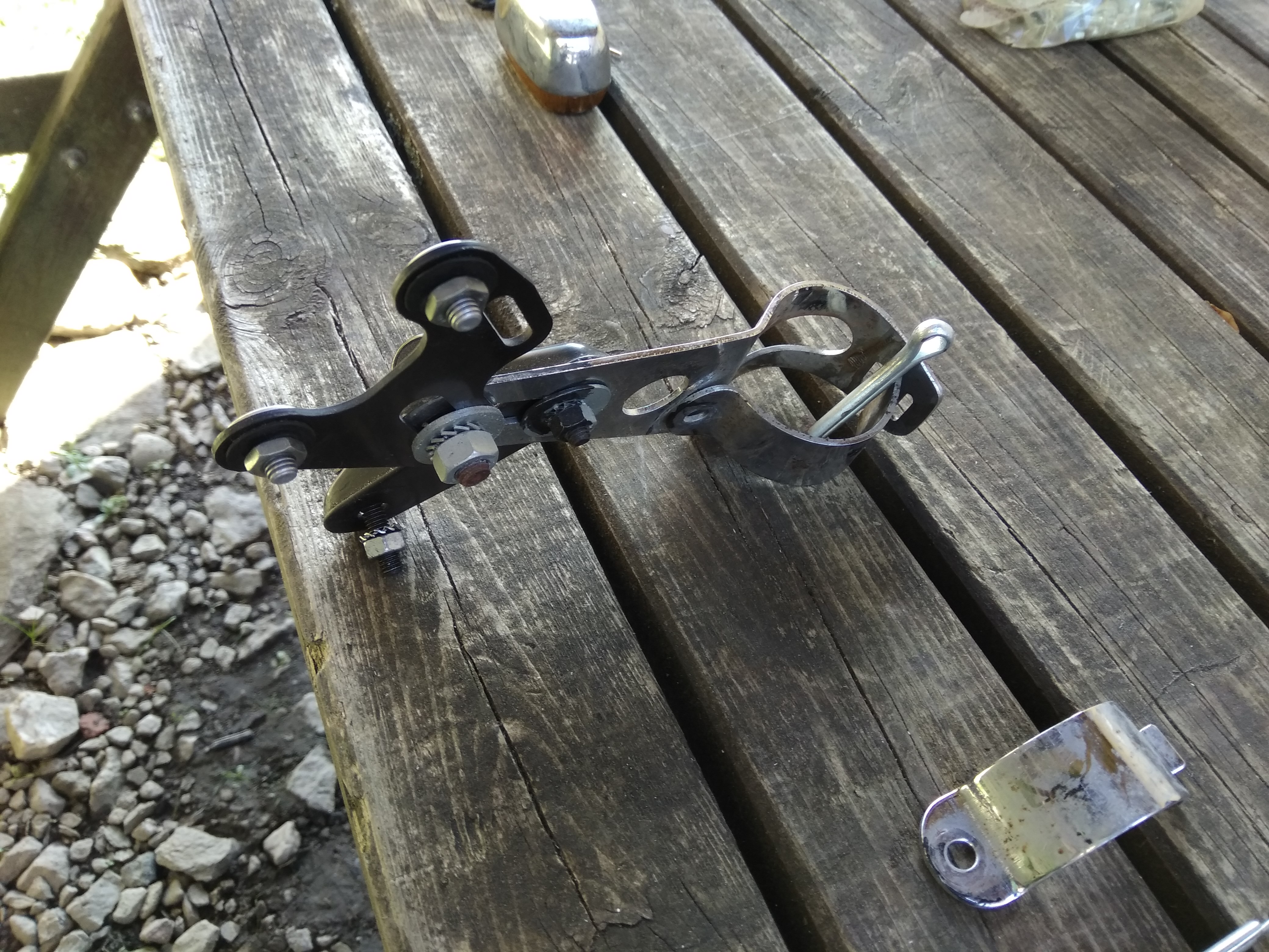

And this mounting.
And the pivot has a lot of play.
Then a re paint or powder coat. I've been quoted 180 euros to powder coat the frame. This includes degreasing, masking, undercoat and finish. Just got to decide whether the saving in hours is worth it plus there will be all the other bits to do.
Is the frame finish classed as gloss or satin. I've got plenty of the satin engine paint so may be an option for the small parts.
Next job is to get some workbenches on the walls so the engine can move over there so the prep work can be finished.
Regarding that small mounting, what mounts to it? Maybe easier to grind it off?
And this mounting.

Re: GPZ11 Injection
Hi Pete
it's good to see you're making progress!
Regarding the handle bar brackets they must be mounted with the "arrow" pointing backwards! Have a look in the shop manual. It's the opposite direction of the ones mounted on a Gpz 1100 B2 !
Regarding the bracket on the side of the frame: there's nothing bolted on to it...perhaps it could be used to mount some crash bars or perhaps there's something mounted for other markets. There's one on the other side too, strange thing, apparently it has no use. If someone on here knows what the purpose of that bracket is, just let us know pleae !

Hi Phillipe, yep it was from the base manual the supplement says the other way round. Regarding the bracket, must be crash bars or optional lower fairing??? Strange how mine is damaged to point that a bolt is sheared inside and it looks to have been hit from the rear and upwards. No other damage to frame can be seen and the wheels are perfectly in line.
Be interesting to see if anyone knows their purpose?
