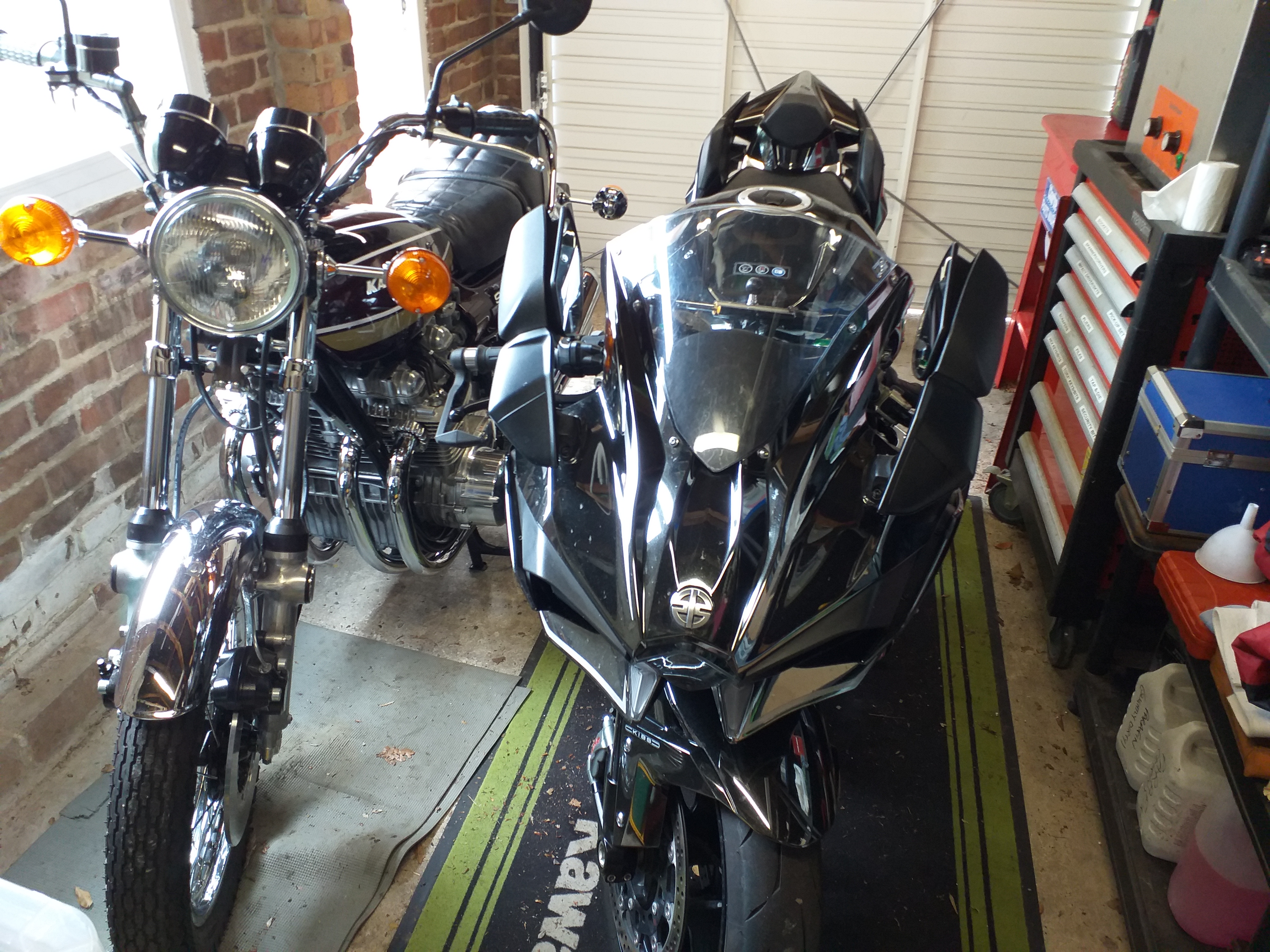

Just for your delectation pic shows Granddad and Grandson sitting together :D
Z1-B, 360bhp ZX1000NGF

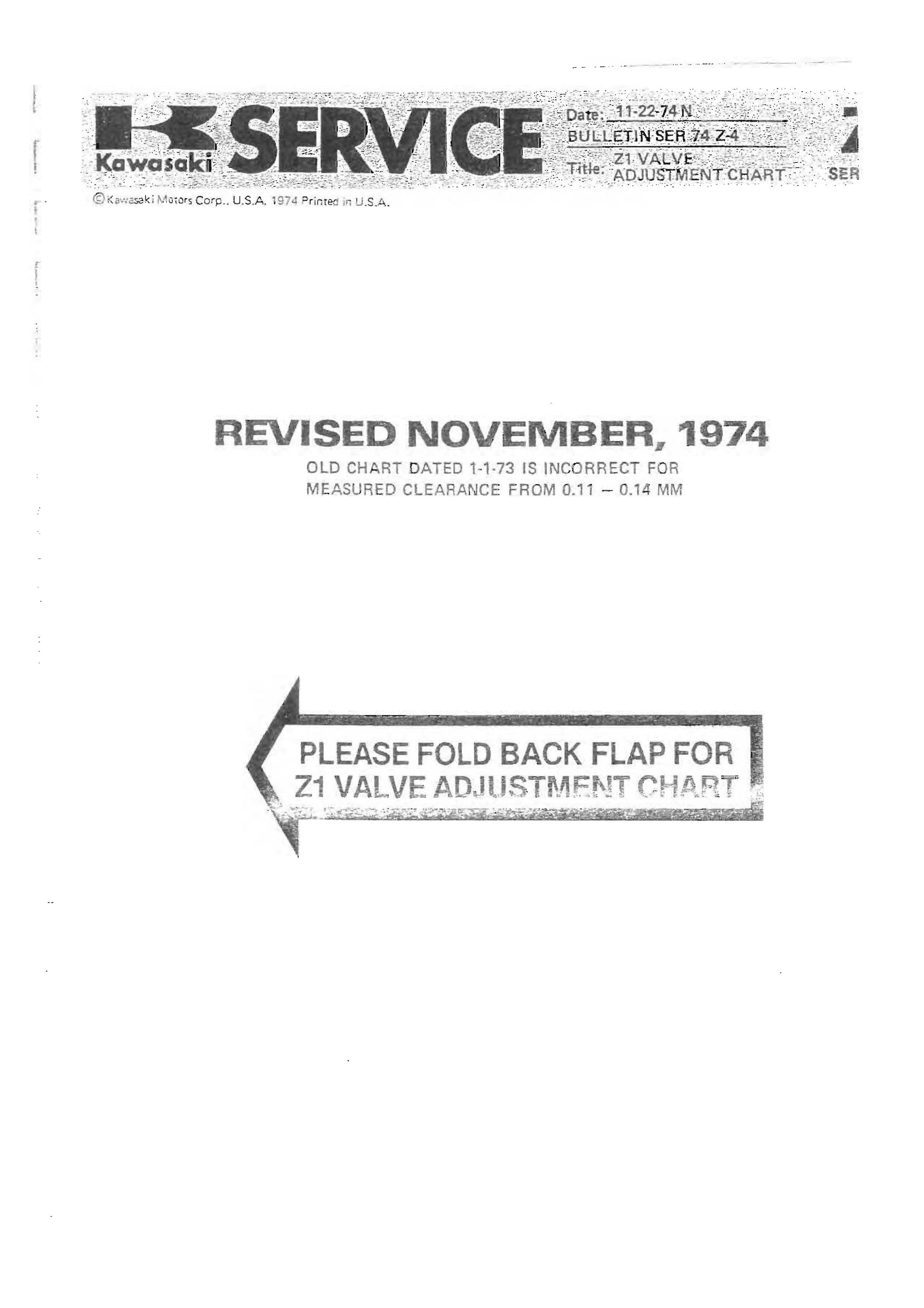

Service manual bullitin - 1974 Valve clearances should all be between 0.11 - 0.14mm.

#83 PostAuthor: steve452 » Mon Aug 02, 2021 2:55 pm
Thanks Adrian. I've got this SB but cannot understand a word of the process :shock:
It seems to be designed for people who can't subtract :oh
I'll recheck the clearances some time this week.
