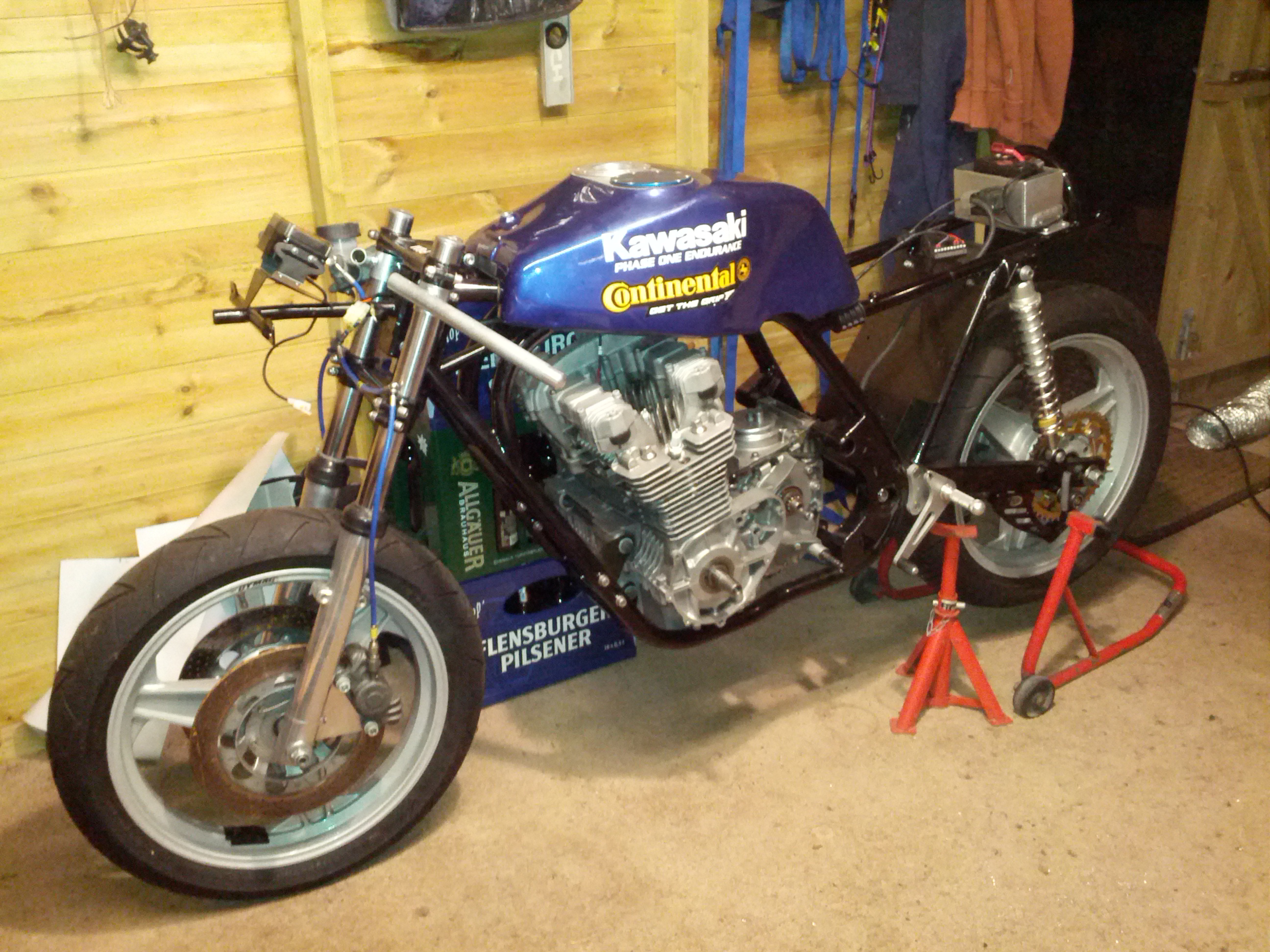

I have just purchased this lovely thing:
Not very good photos im afraid but it was a dark night in a barn in deepest Somerset :wink:
As many of you will know its an ex. Phase 1 (my neighbors) P&M framed Z1170 hybrid motor endurance race bike :P
General spec. is:
Frame 142, last frame they built, not been used, just been painted.
Freshly rebuilt 1170 Graham Salter with GPZ worked on head, Big valves, Wiseco pistons, welded crank, undercut gearbox.
Classic ally Dymags
Brembo discs
AP calipers
Steel fabricated P&M yokes
Marzochi forks
Falcon shocks
Also comes with:
Ally endurance tank 17l
Harris full fairing
Stainless 4:1 and reverse megaphone
Keihin CR carbs and bellmouths
Krober tacho
Needs:
Ignition system
Ignitor housing
LH side gen engine case (fabricated/machined)
Gear linkage
Clutch actuator and perch/cable etc.
Rear brake master cylinder/bracket hoses etc.
Oil cooler and hoses and engine connections/brackets etc.
Fairing brackets
seat unit
Chain and sprox
Front mudguard
Paint
Lots of odds n sods!
Heres a pic of its sister :D

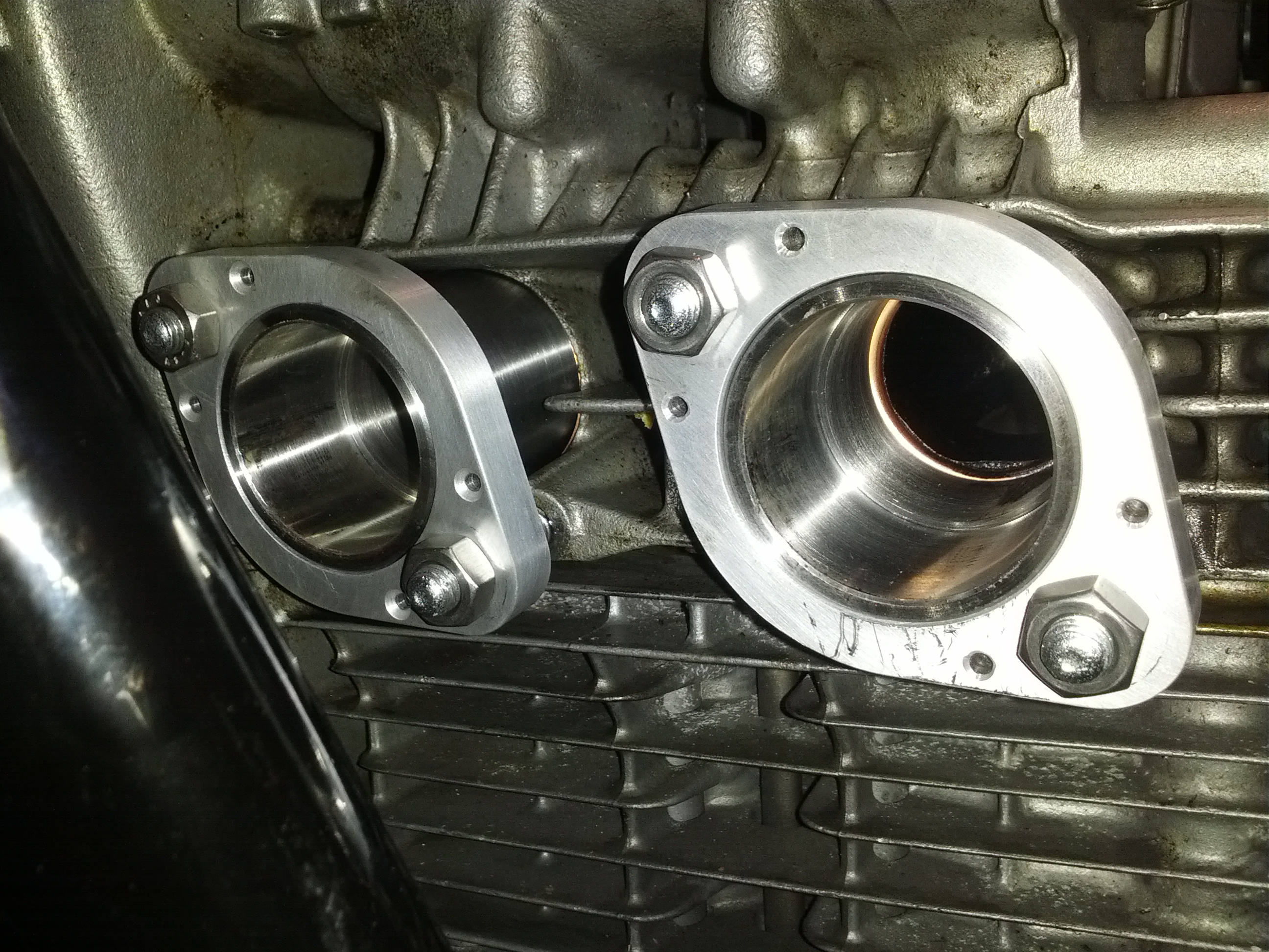

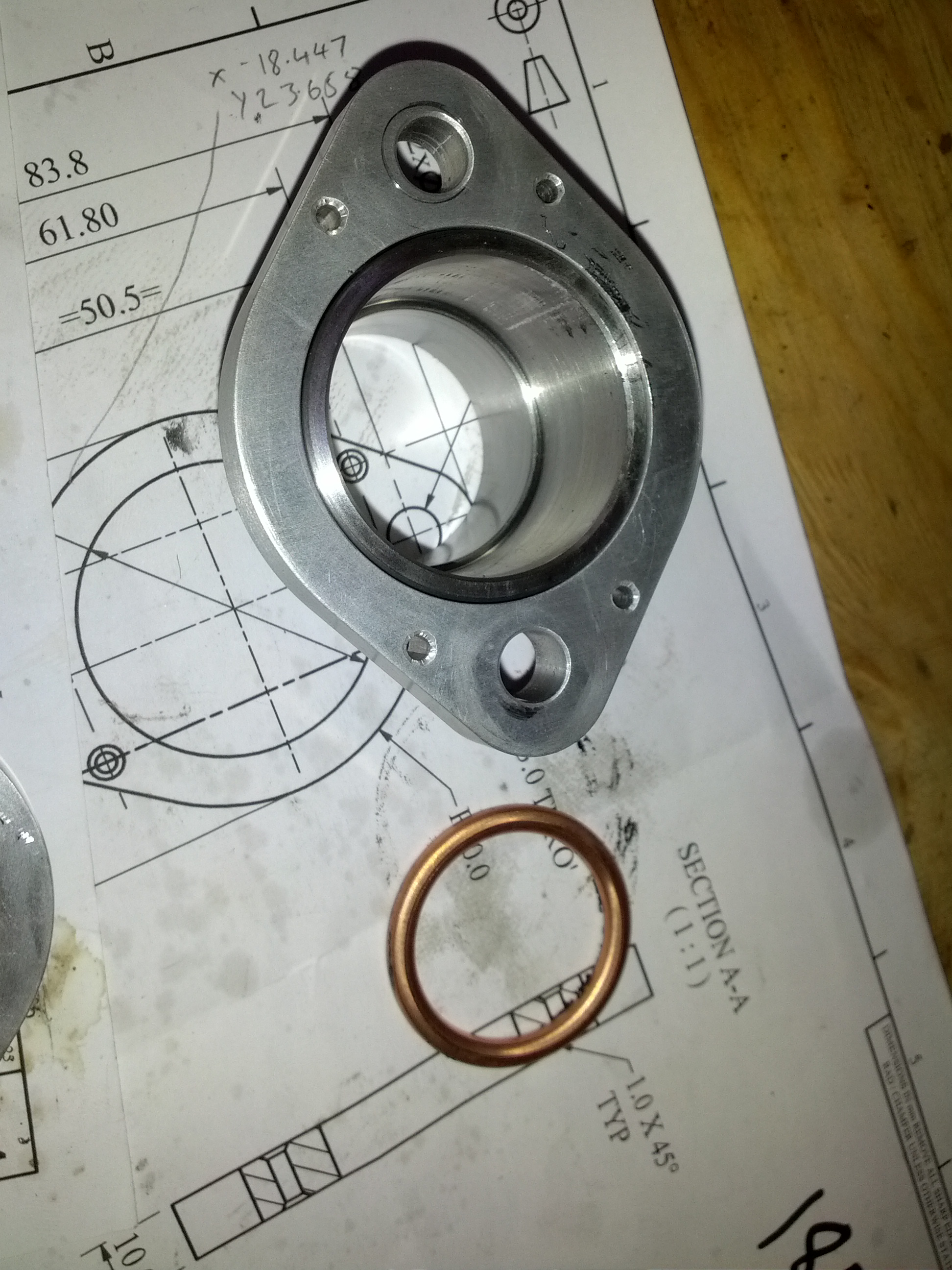

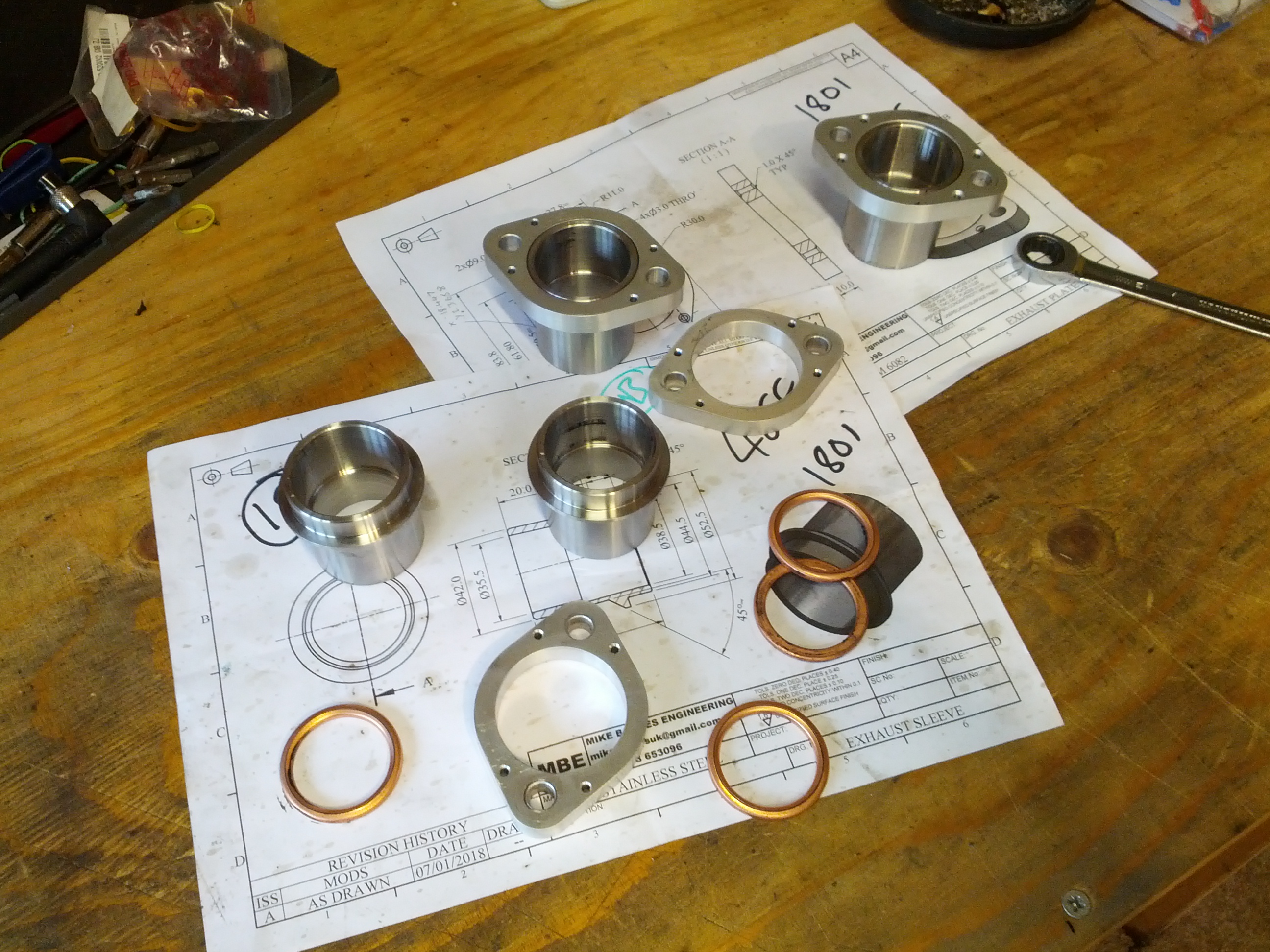

Exhaust studs and QD flanges:

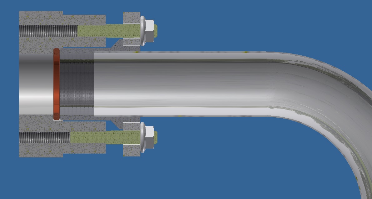

I used some left over M8 studs i had from the Zed project and had Mikey plate them for good measure. Did a quick CAD model of the ports geometry so i can get stud length and the design of the 2 part QD flange right:
It worked out that i should be fine leaving 30mm of stud proud of the head. I have a mixture of 2 different types of stud with differing thread length each end, so i wanted to work out if i could use both types. Works out i can.

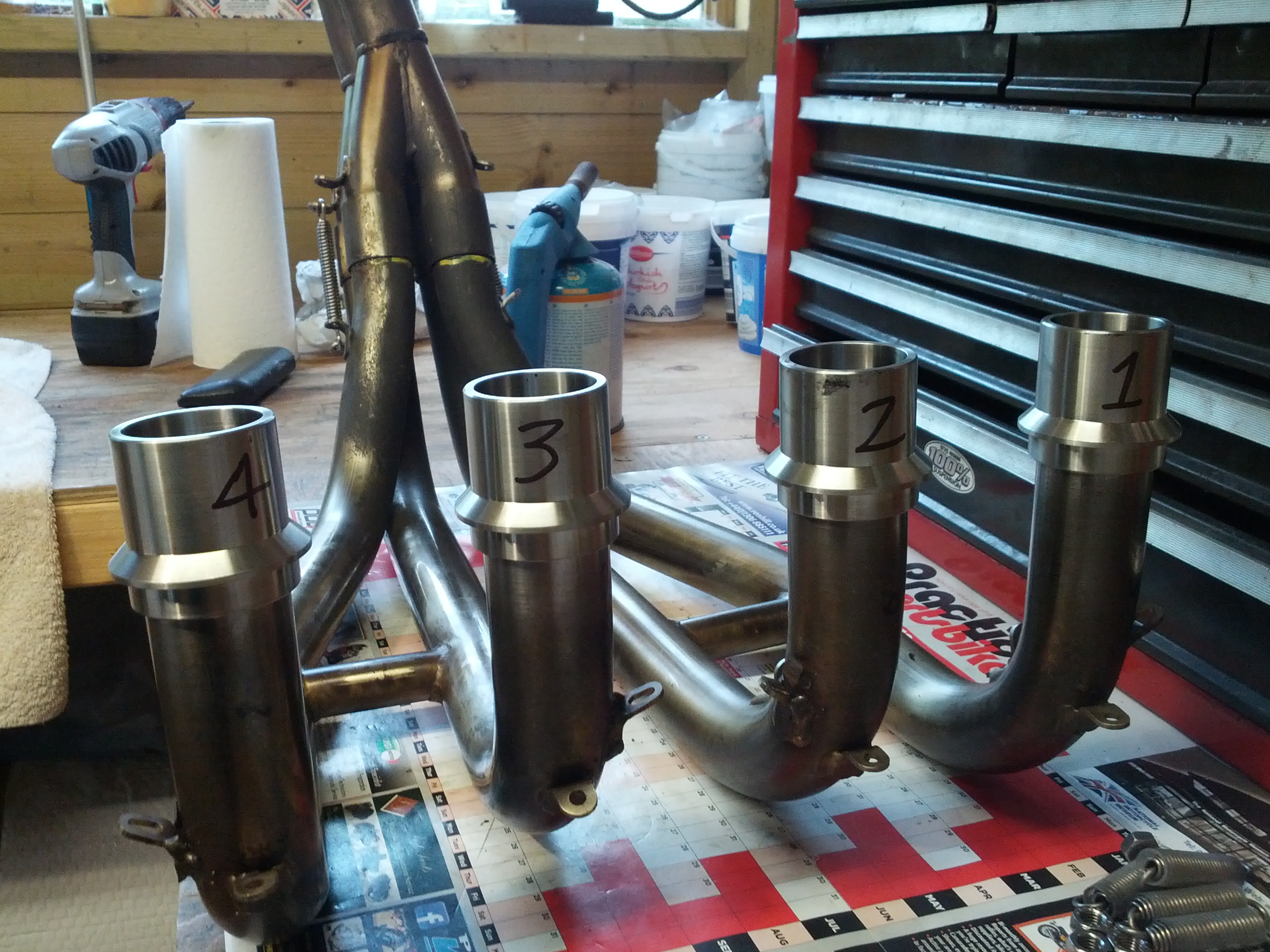

So i got the parts made up:

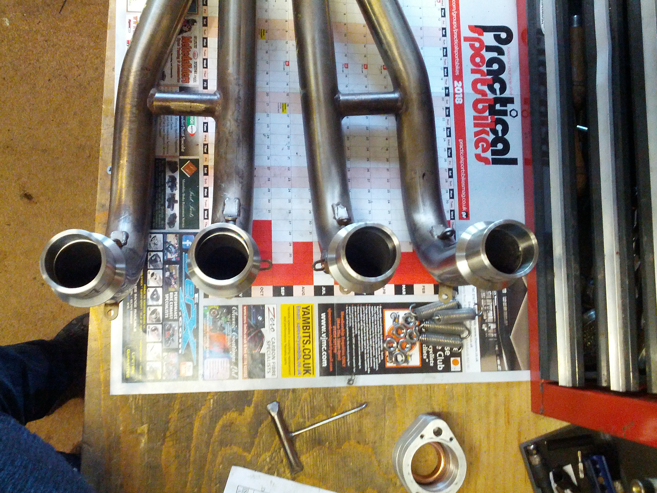

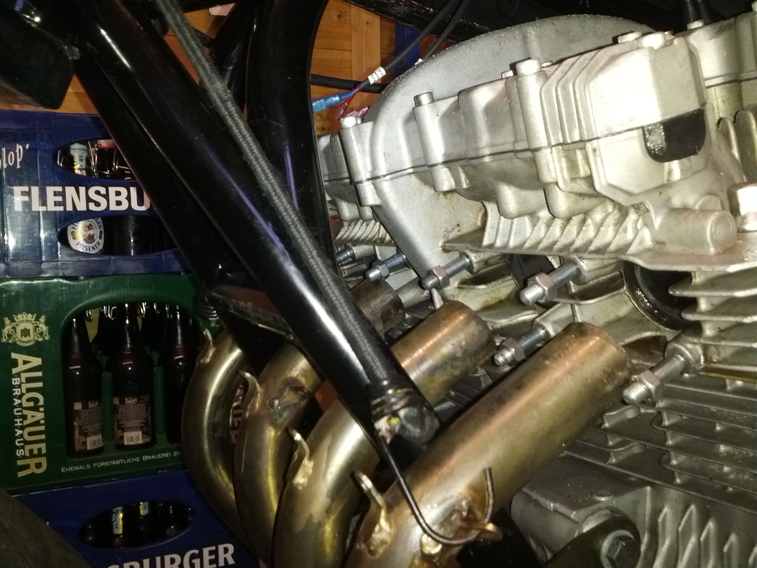

And offered them up to the headers:

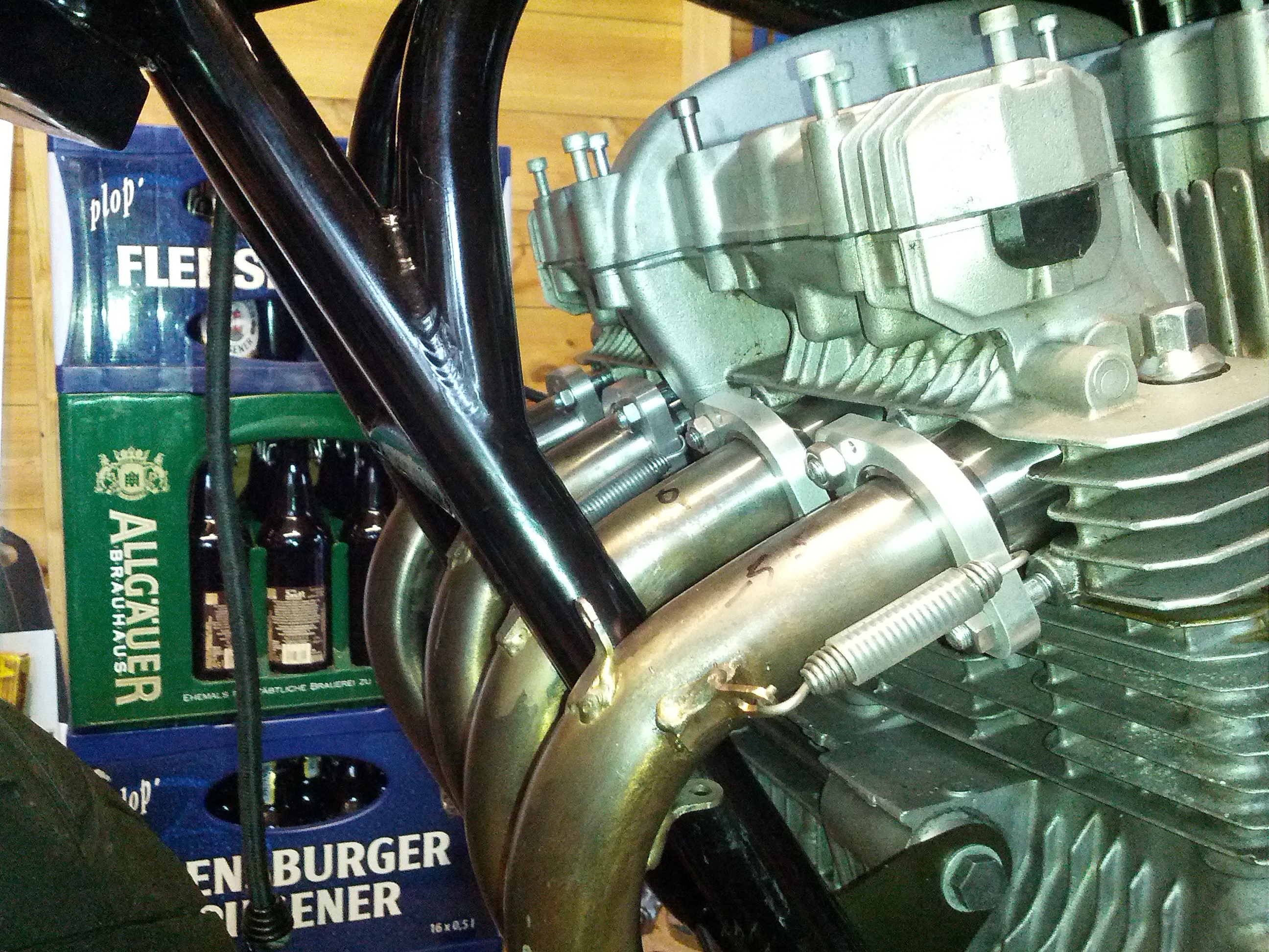

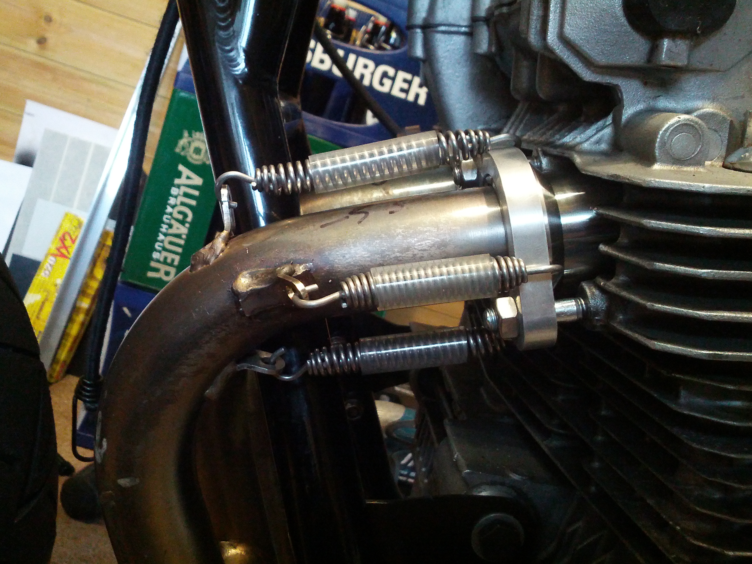

I will match the pipes to the spigots with a die grinder and sanding wheel later. I had to cut down 3 of the headers by 3.5 to 8.5 mm to get them all in line so they all seat in the spigots in line. This is important for a good seal and also for gas flow at high rpm :D
On the head:
Working out which of the 3 springs per header i am going to use:
End can loosely in place:

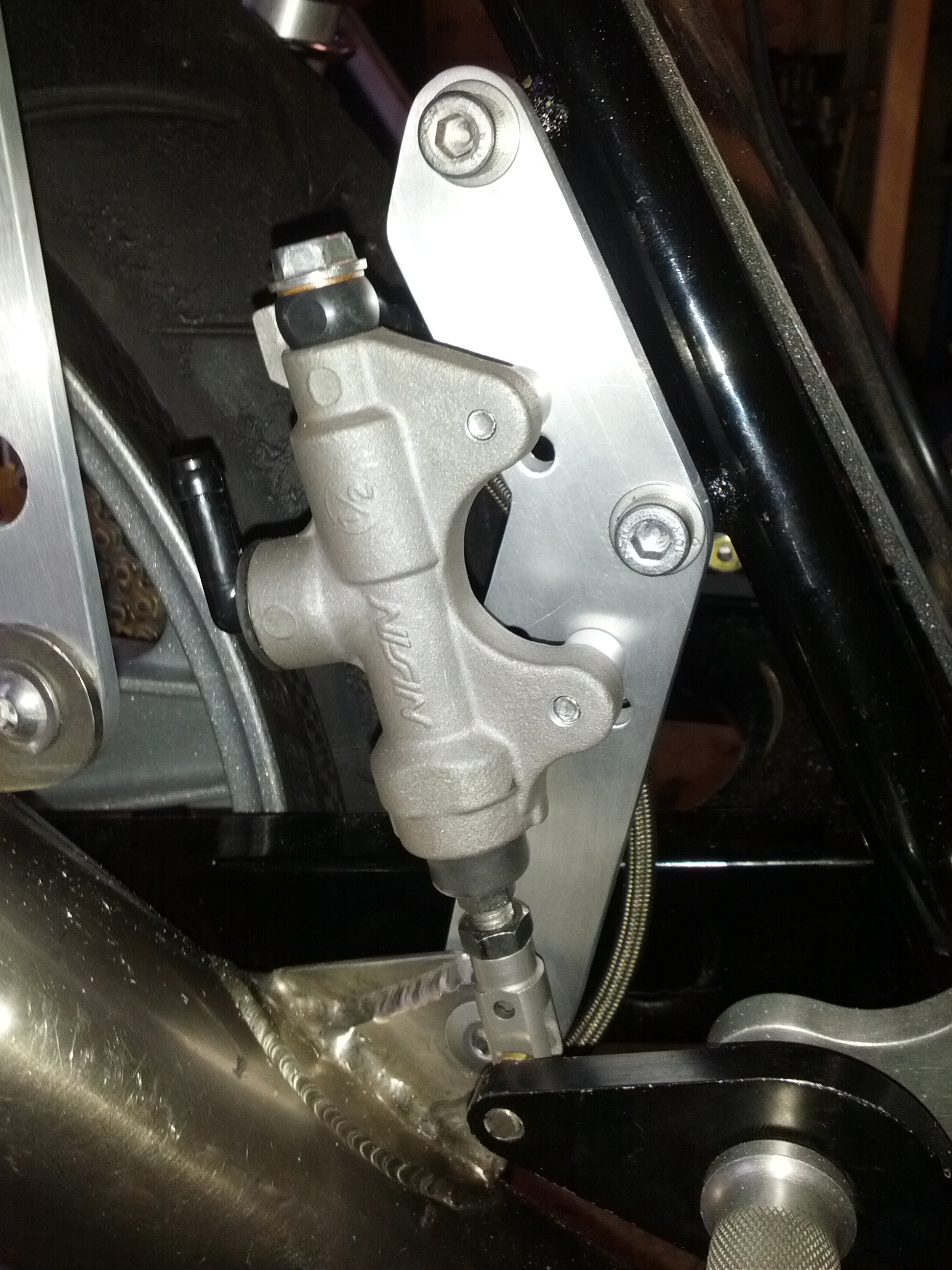

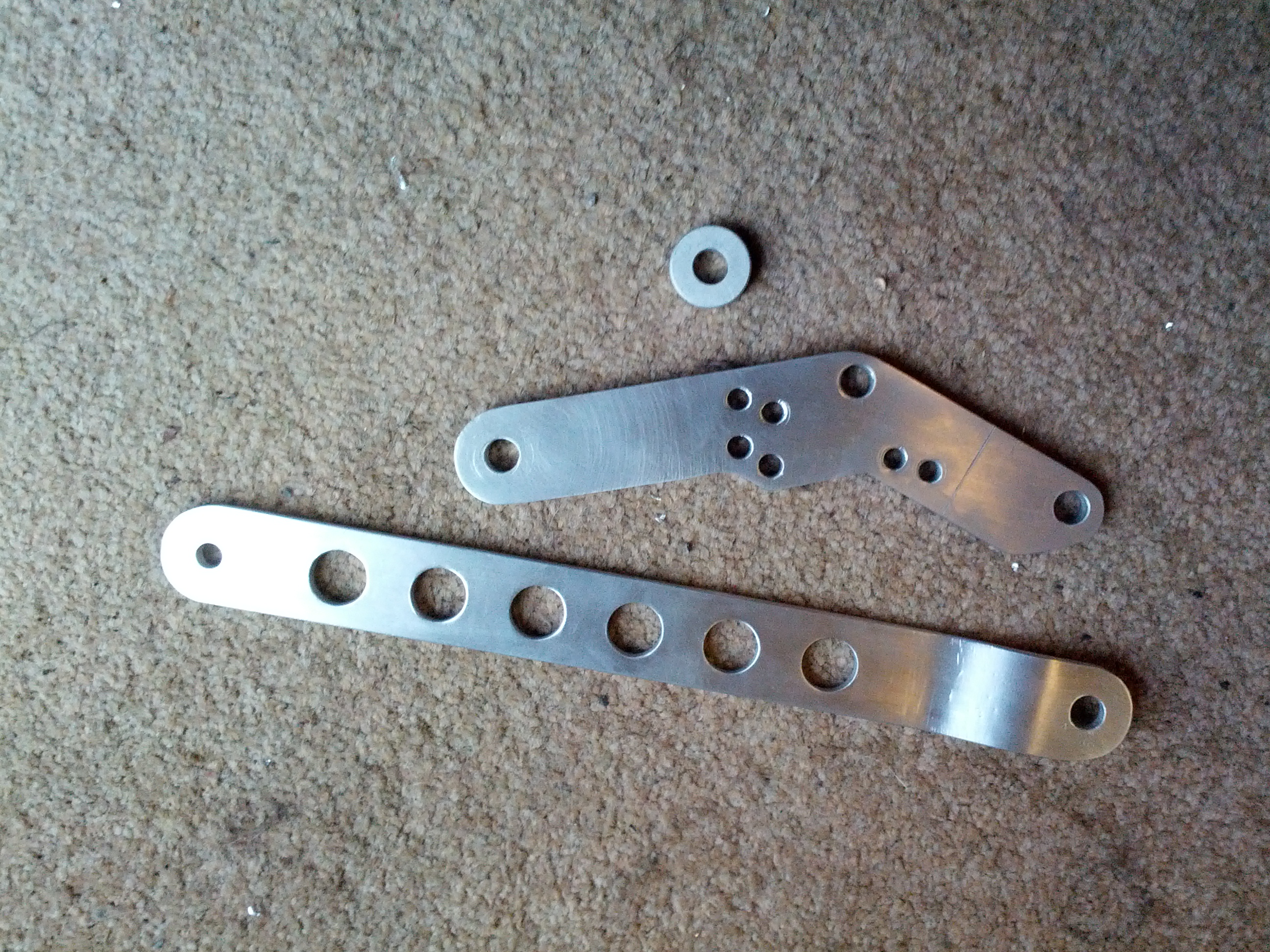

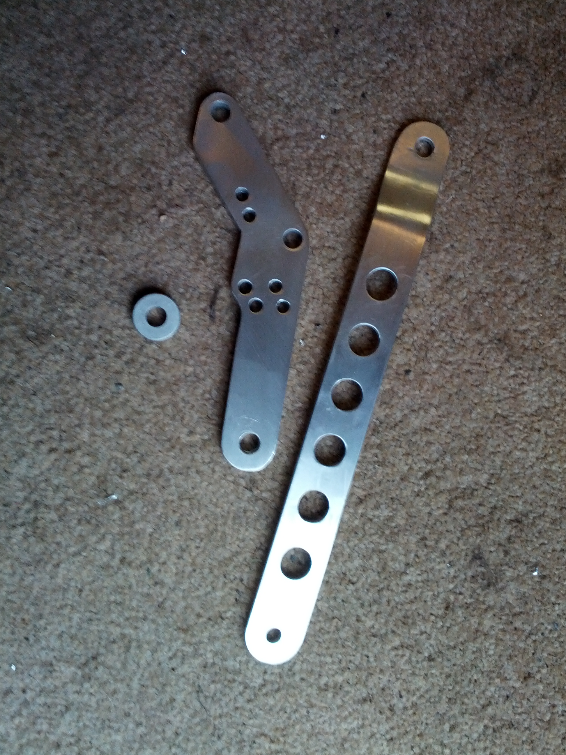

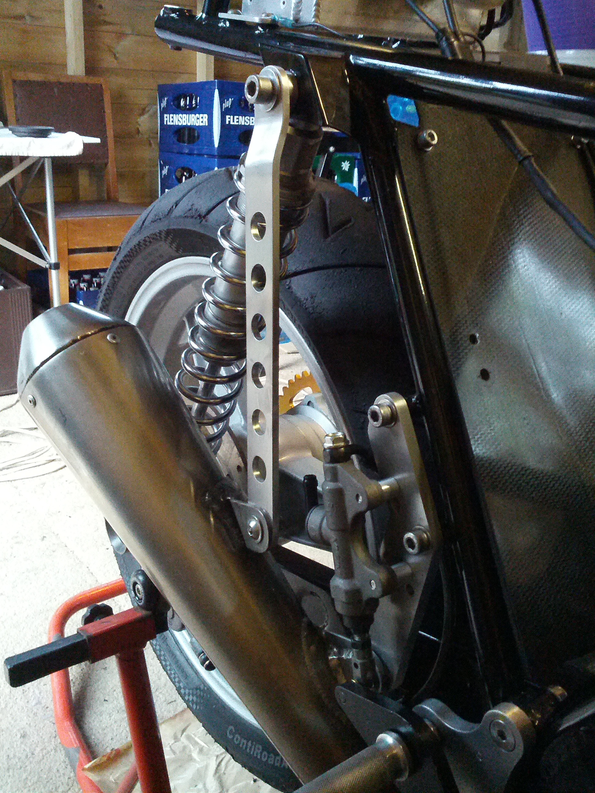

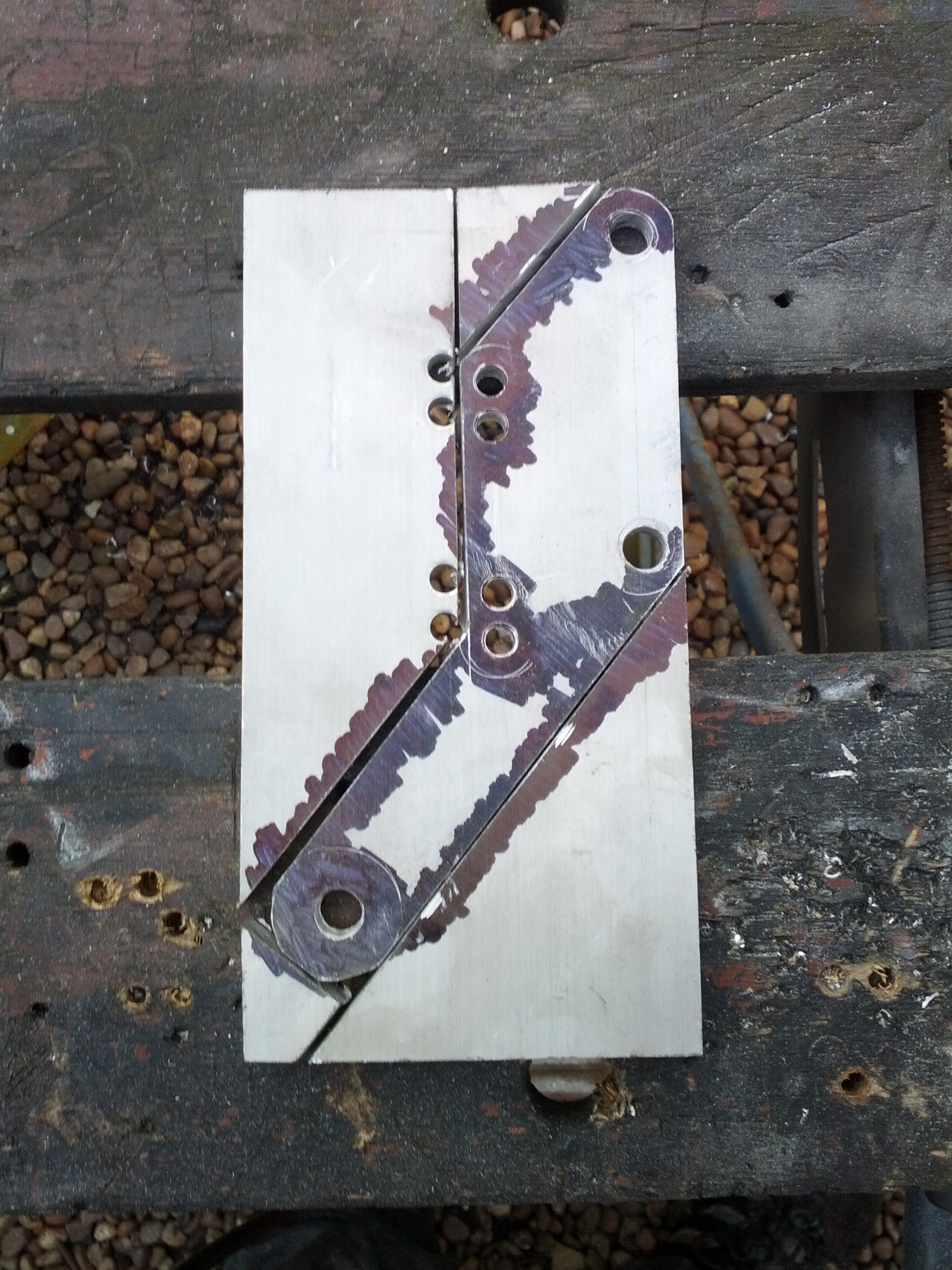

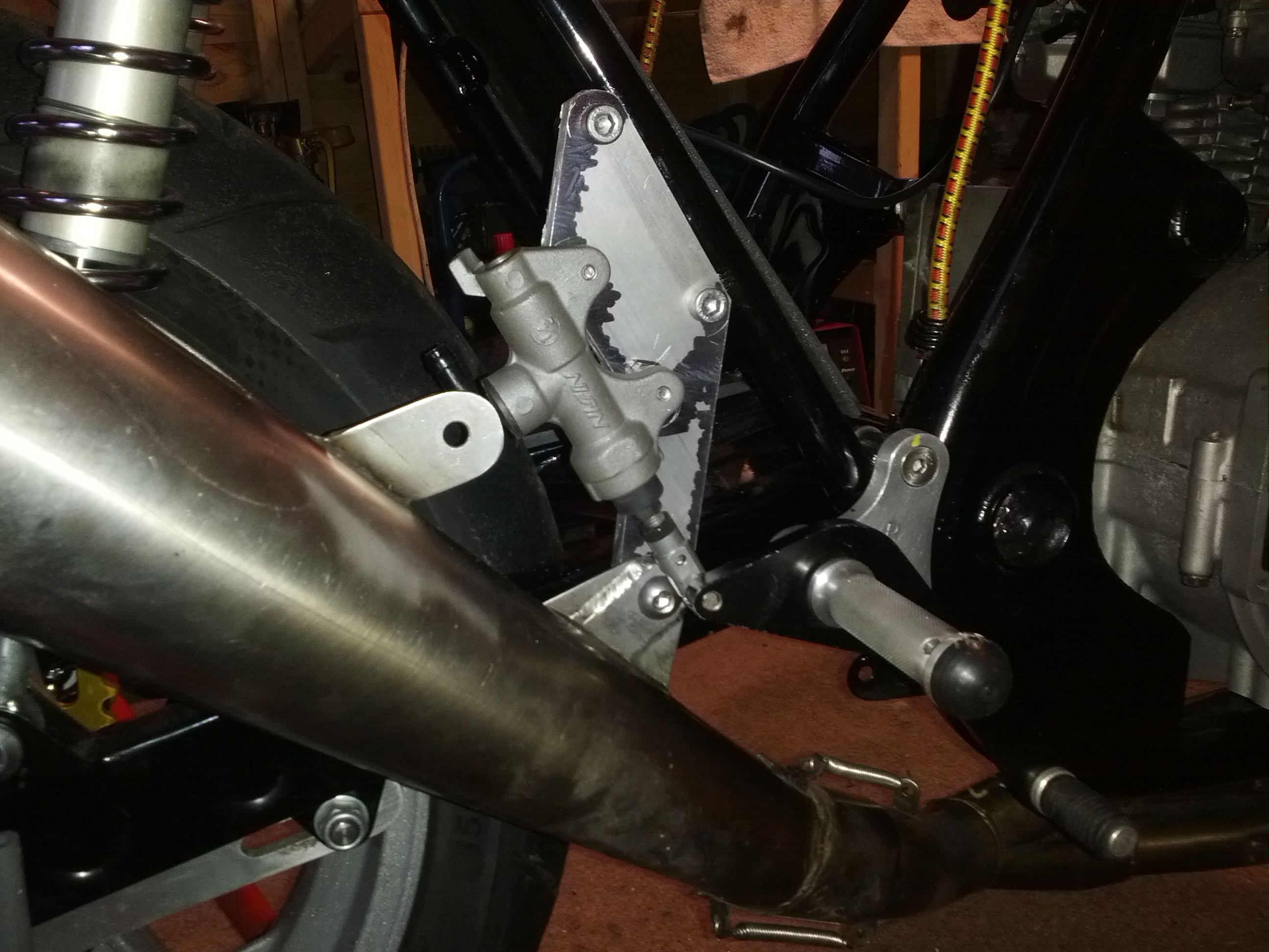

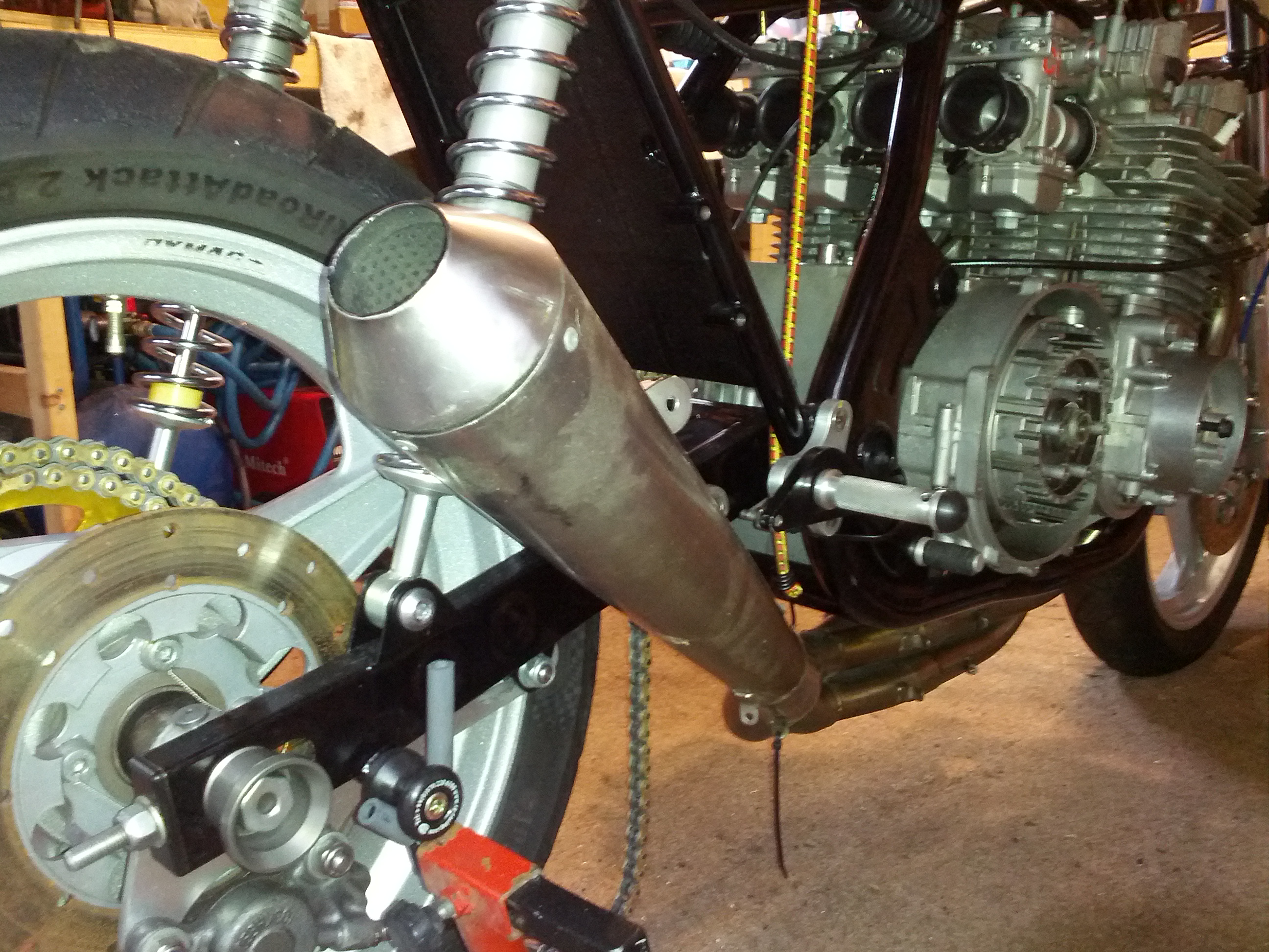

The bike was missing a rear brake cylinder and its bracket, so i got an R1 cylinder off ebay for £20 (like new) and started with cardboard, then progressed to 8mm ally plate. I chose 8mm because i wanted to have the bracket support the mega off its front mounting and this was the thickness between the frame lugs and the bracket on the Mega when offered up in a near position. First to cut it out:
Kinda fits but the brake lever QD pin fowls the button head M8 holding the mega on and the angle of the cylinder is too shallow and too far away from the diagonal frame rail for a super smooth and linear operation, so more cutting/drilling required. I have 2 sets of mounting holes on the bracket for the cylinder so i have a huge range of adjustment for the lever height which is difficult to get right without being on my knee trying to modulate the rear.
I knew there was a reason i usually design things on CAD, but i'm going back to "proper" engineering techniques (takes longer, but i am outside in the sun)

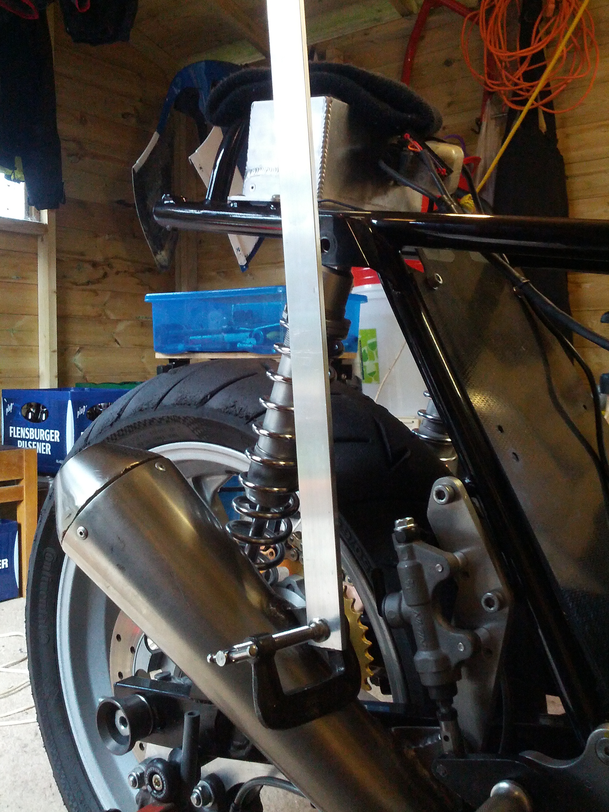

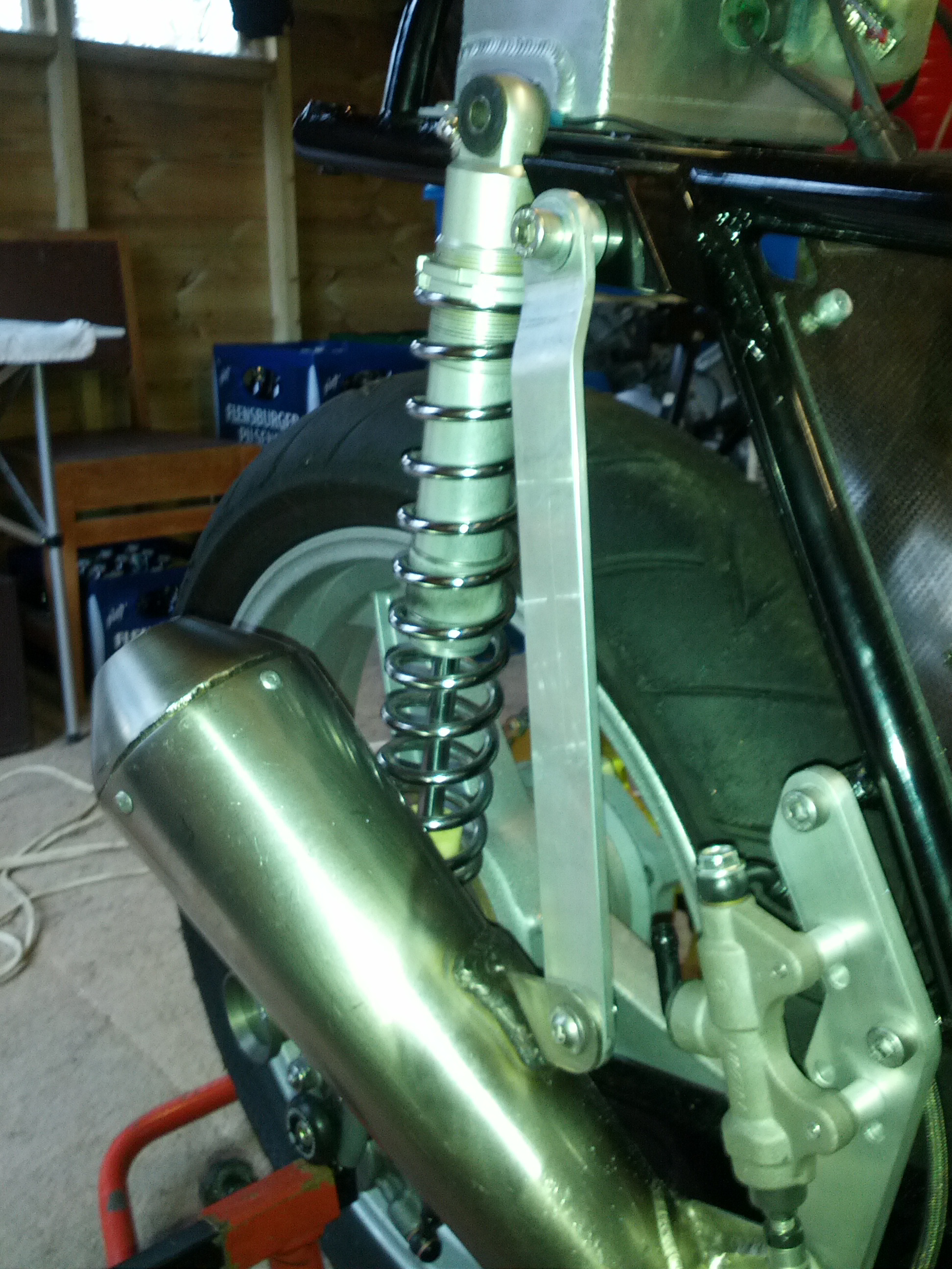

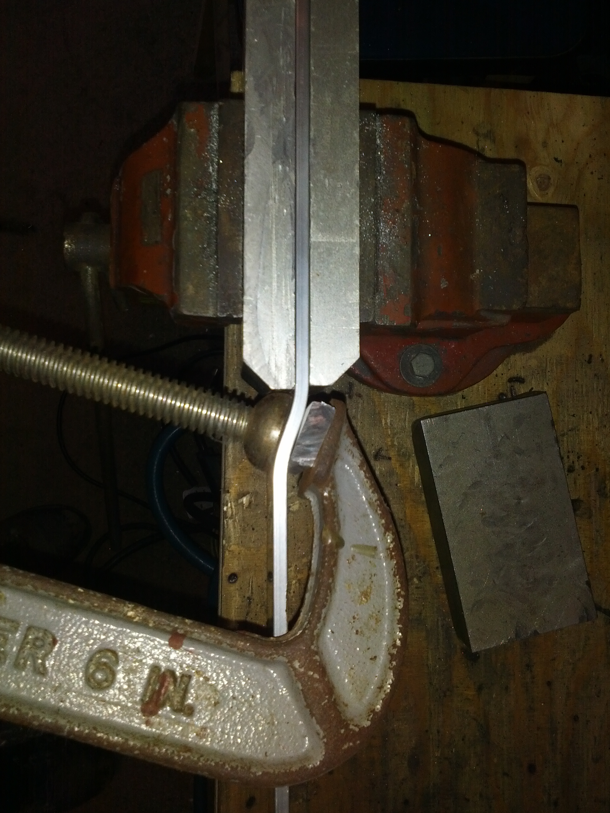

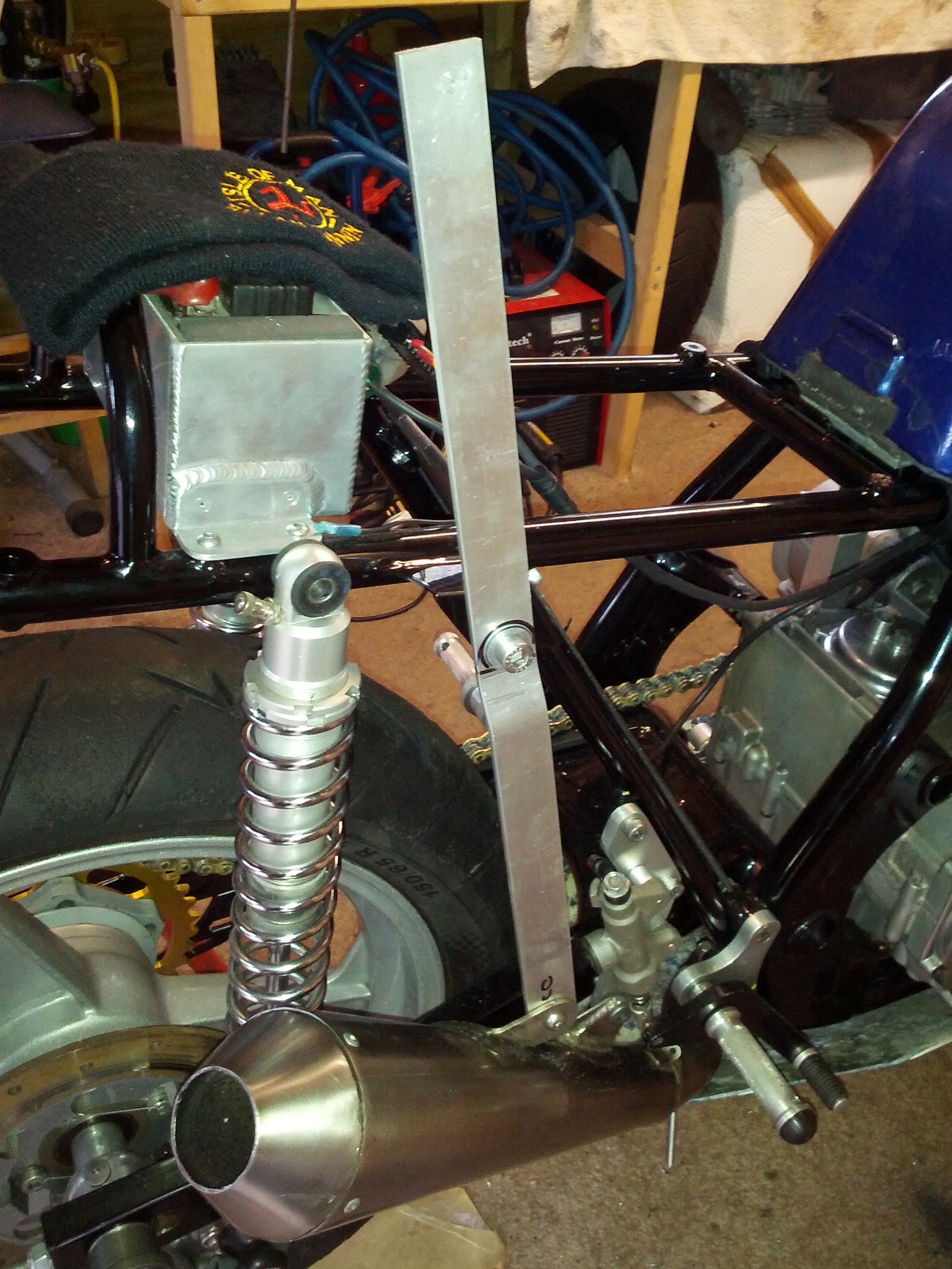

Also decided to make a secondary mega bracket out of 30 x 5 ally bar:
Using the old G-clamp and block of ally method in the vice to create a joggle to clear the top of the rear shock
Also made up an ally spacer to move the bracket out by 10mm:
All done :D
