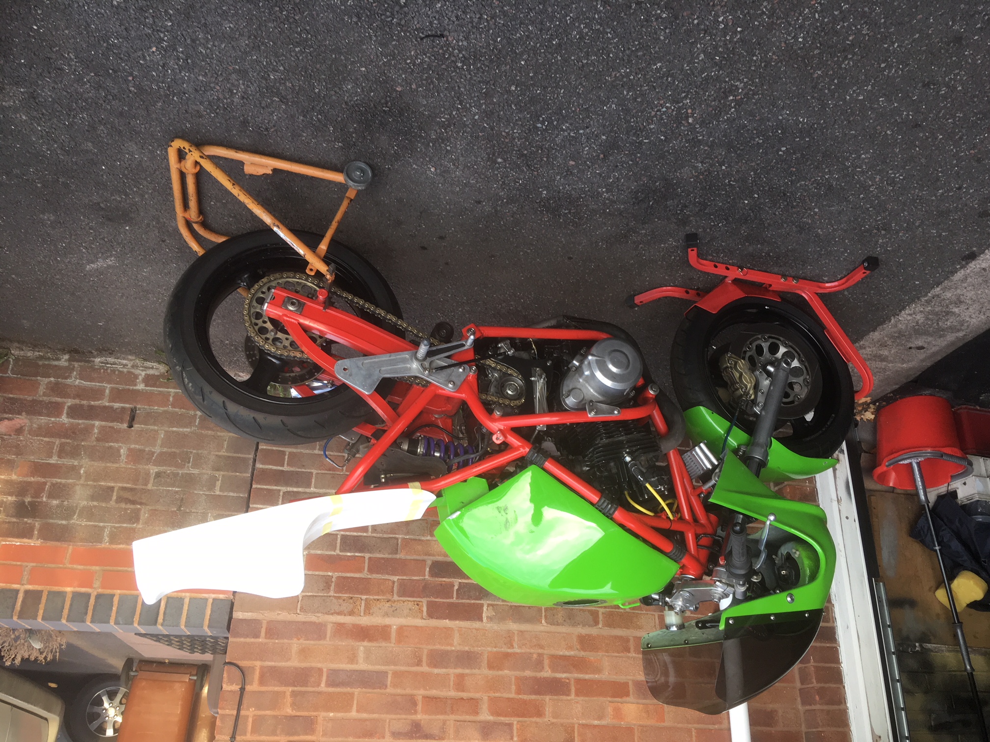

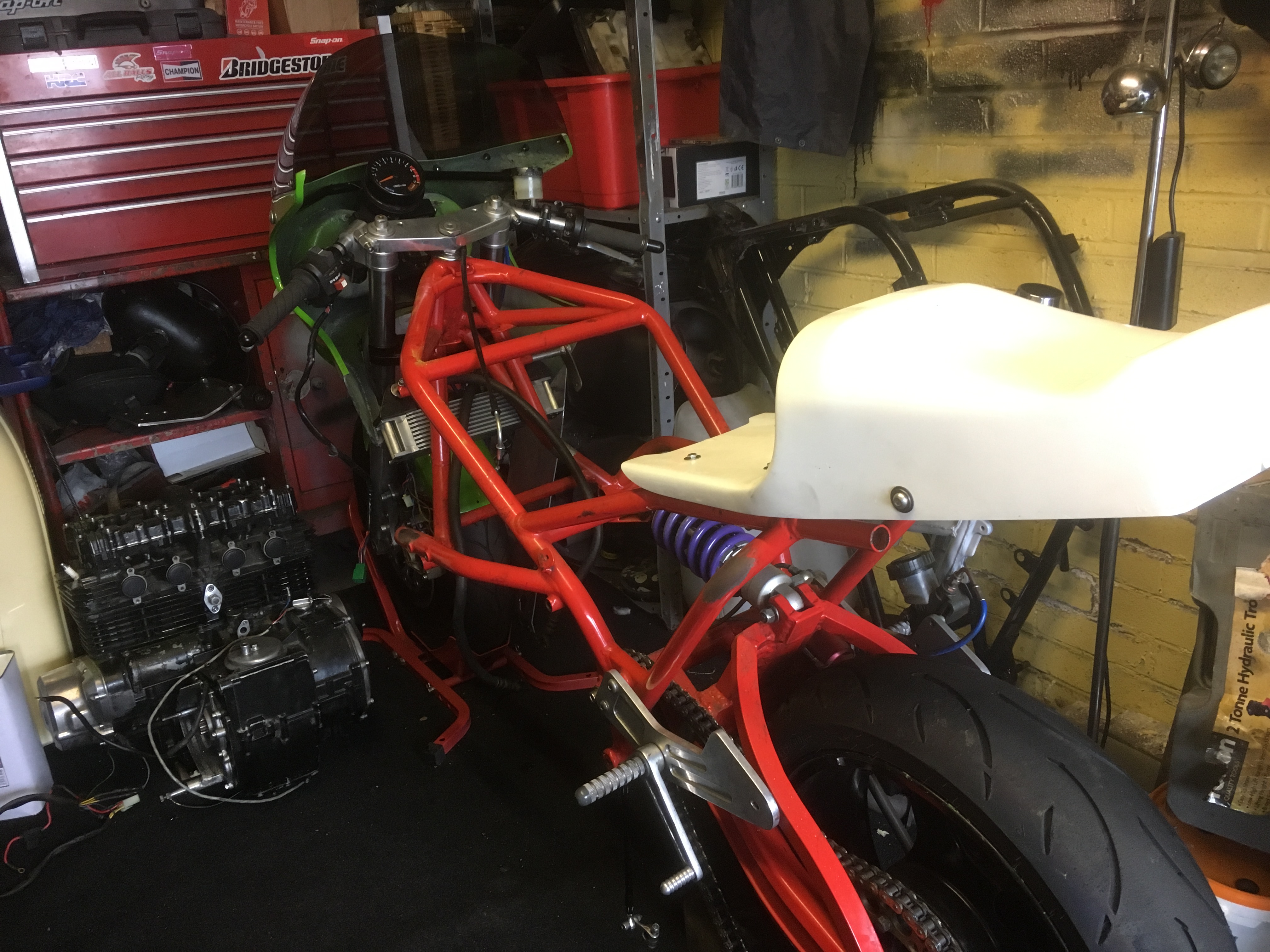

So I'm the new owner of KWACKERZ1's old Magnum 2 which I bought as this years winter project. I've got a few changes in mind, mainly cosmetic, so the first thing to go was the seat unit. I went through a couple of false starts but eventually settled on a TR750 seat and only using the top half of the fairing so the engine would be out on show,
Here's a quick mock up.
cakeman
Posts: 67
Joined: 30th Jul 2018
Location: Staffordshire
Re: Harris Build
#2 PostAuthor: cakeman » Wed Sep 12, 2018 5:27 am
OOPS :shock: Don't know why the pic's come out upside down they're the right way round in the file lol.
Anyway, after a bit of cutting and shutting the seat now sit's a couple of inches further forward and I've made an aluminium base and battery tray to bolt on so I don't have to cut the Magnum frame about. This is the base unit before I added a few more strengthening pieces to it and loosely bolted to the frame.

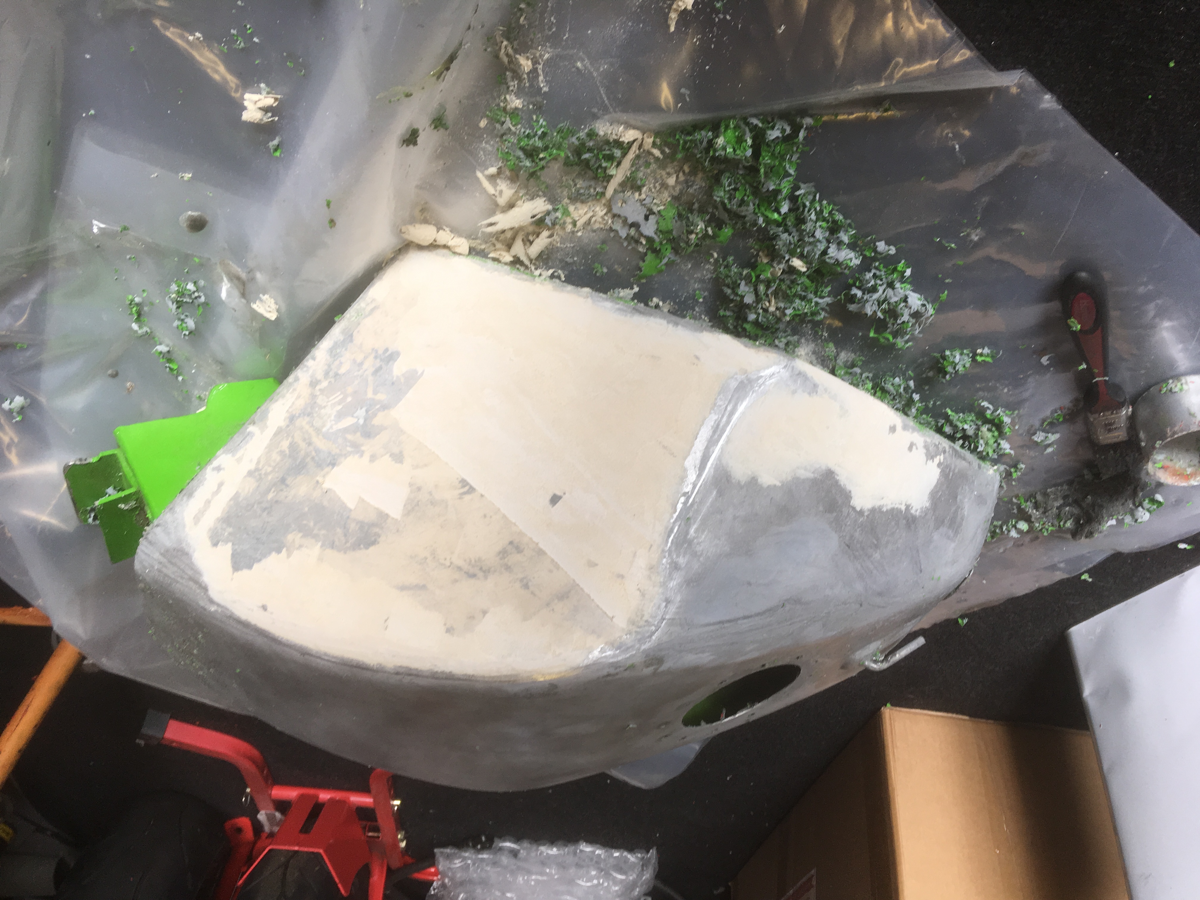

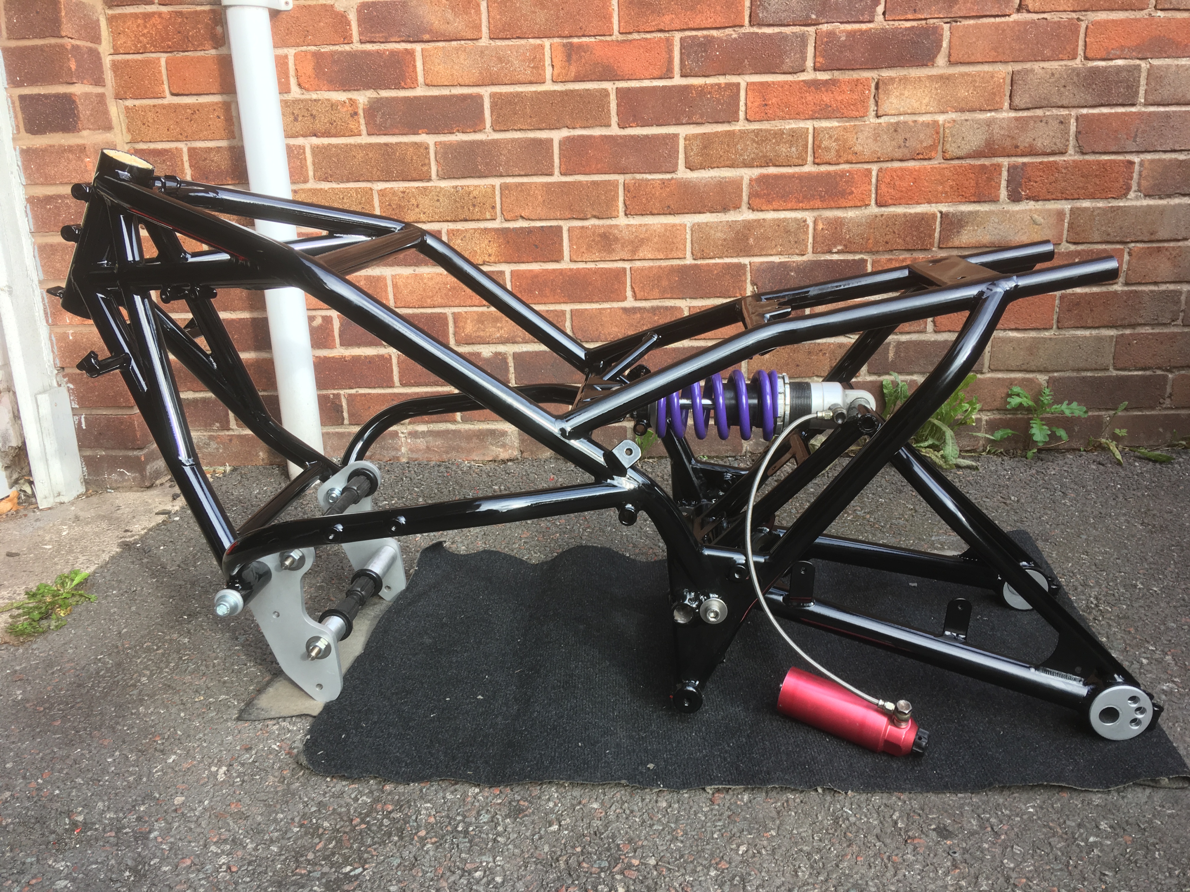

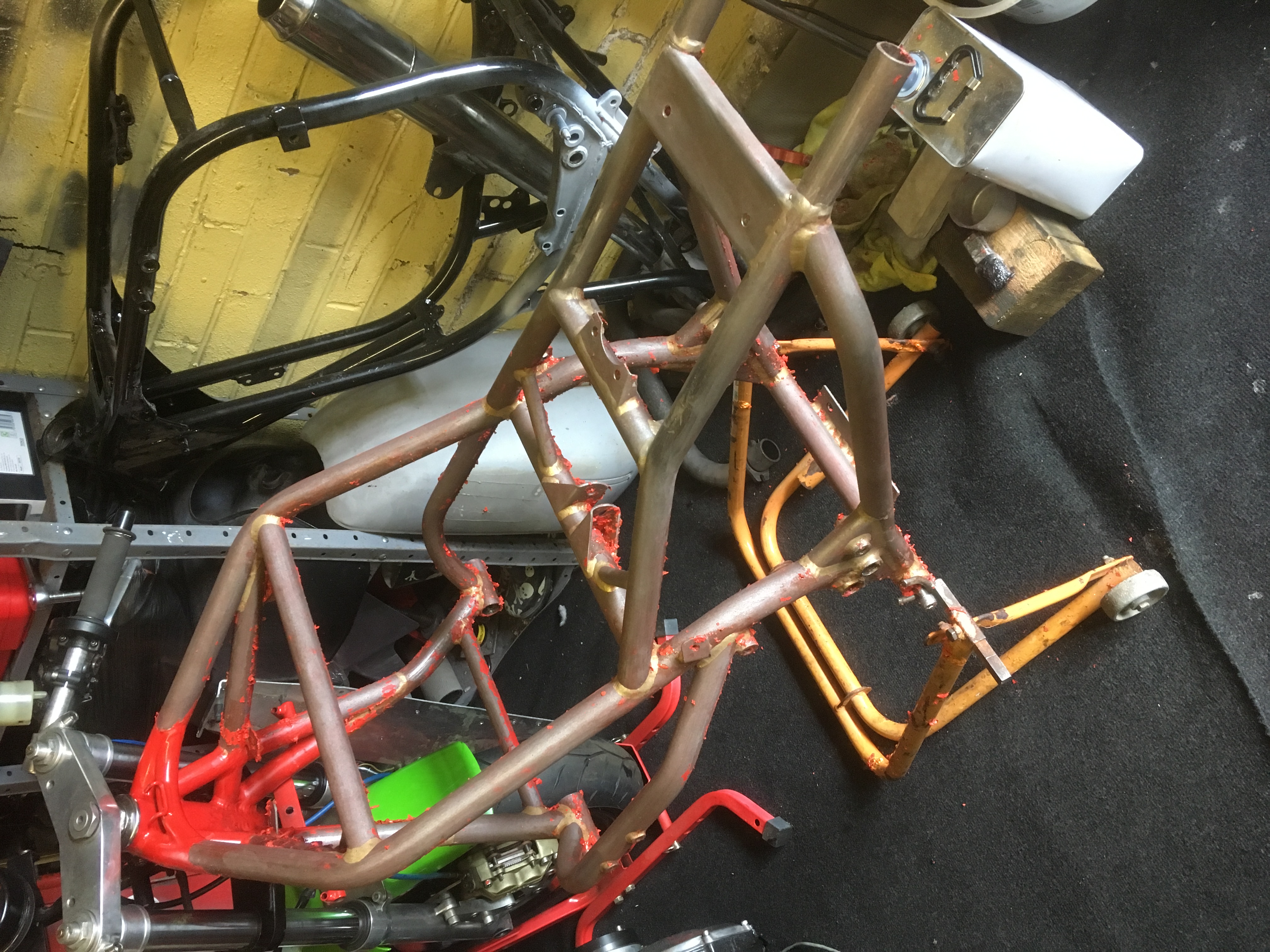

Next was a full strip down ready to change the powdercoat on the frame. Got a few daft quotes for stripping but in the end found some stuff on eBay called Powerstrip for £24 a gallon which fetched the coating off a treat.
It's just like the old Nitromors but stronger :)
Managed to pick up an original Magnum swingarm instead of the modified SV650 one fitted and had the lot coated shiny black
On to the tank.
Never seen so much filler in a tank, six hours of me life I'll never get back :shock:
Tank has had a couple of small pinholes welded up and has gone to a mate to have as many of the dents knocked out as he can.

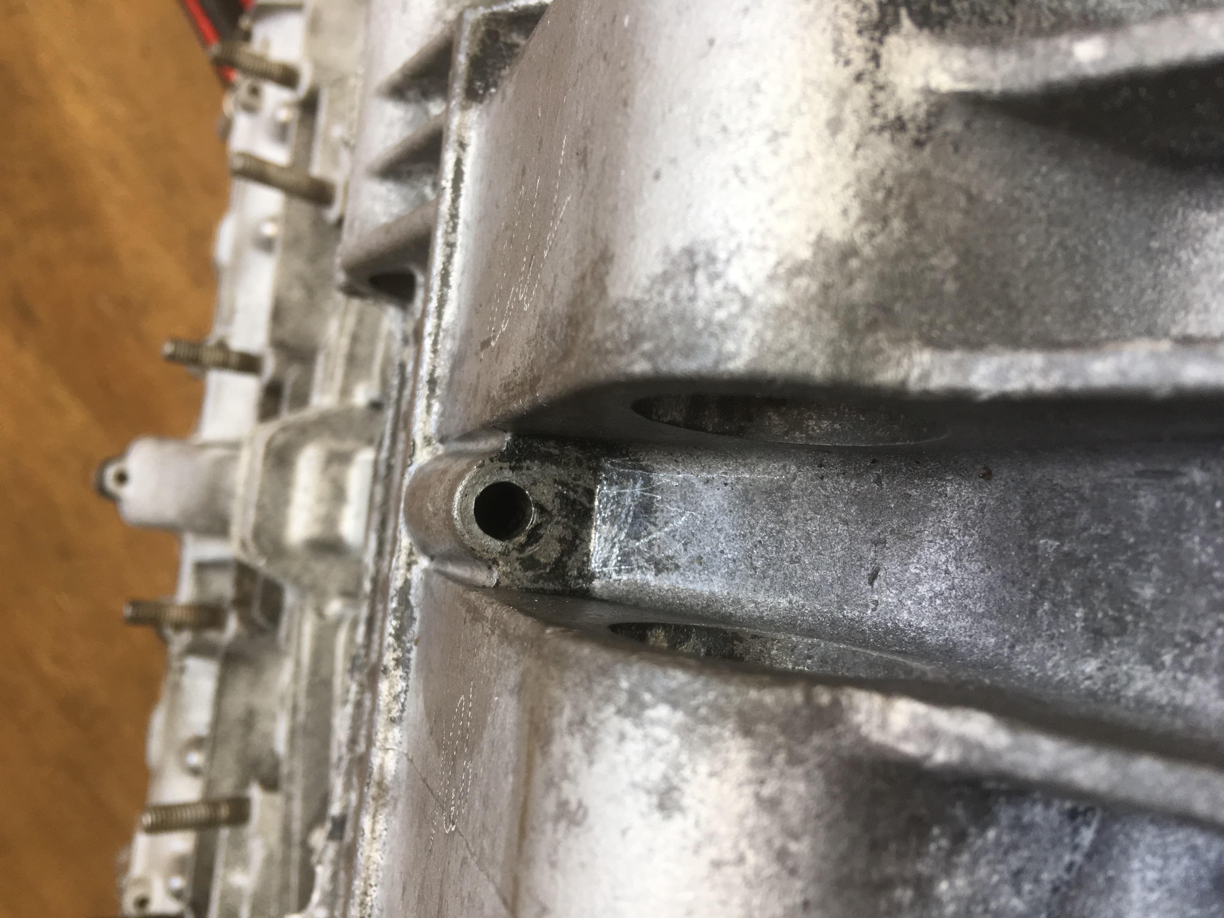

I had the engine soda blasted which uncovered a couple of small problems. The cylinder head needed a small repair as it had broken a piece off where one of the cam cap bolts comes through and had been filled with what looked like car filler and one of the 6mm crankcase bolts at the front which helps bolt the to halves together was held in with black silicone, this meant splitting the crankcases to remove what was left of the broken bolt.

#5 PostAuthor: cakeman » Wed Sep 12, 2018 6:11 am
One bonus of splitting the cases was the discovery of a welded an balanced crank and after the old paint had been blasted off I noticed the top crankcase had been engraved with “Robert “ and a serial number, dunno what that refers to but it’d be nice to find out.

#9 PostAuthor: cakeman » Fri Sep 14, 2018 8:54 am
If anybody can help with who may have tuned the engine it would be greatly appreciated, it's marked "Robert 17736"

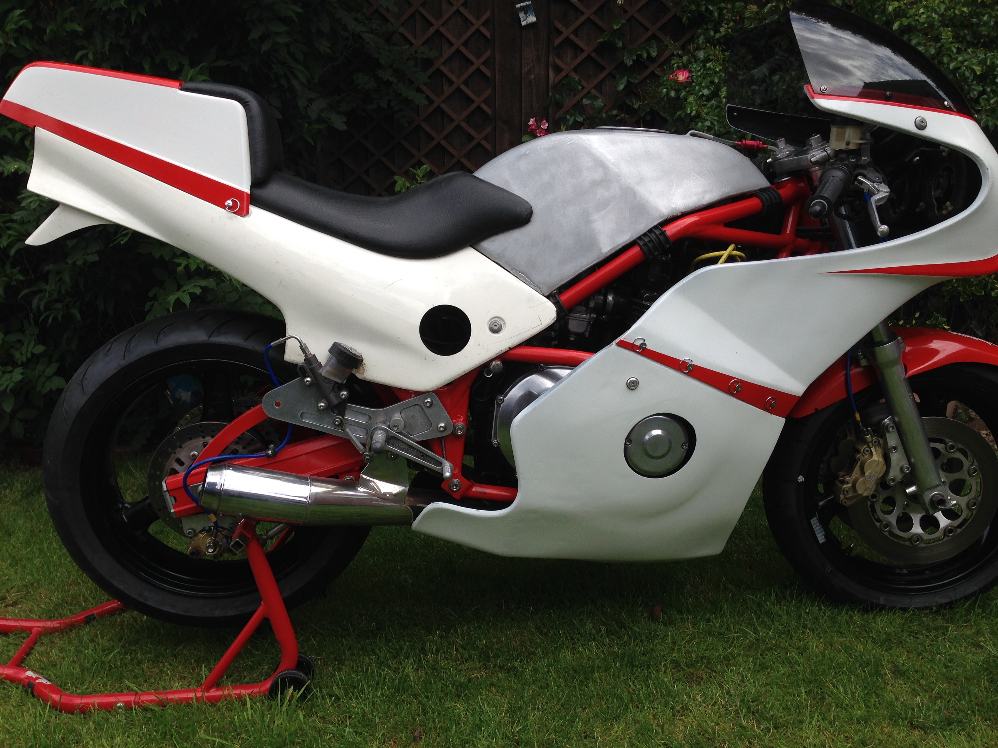

I never had the bottom end apart, the motor came from Marlin so may have been a graham salter motor.
Interesting amount of filler on the tank as before I gave it to the painter to do it green, I ran it bare like this.

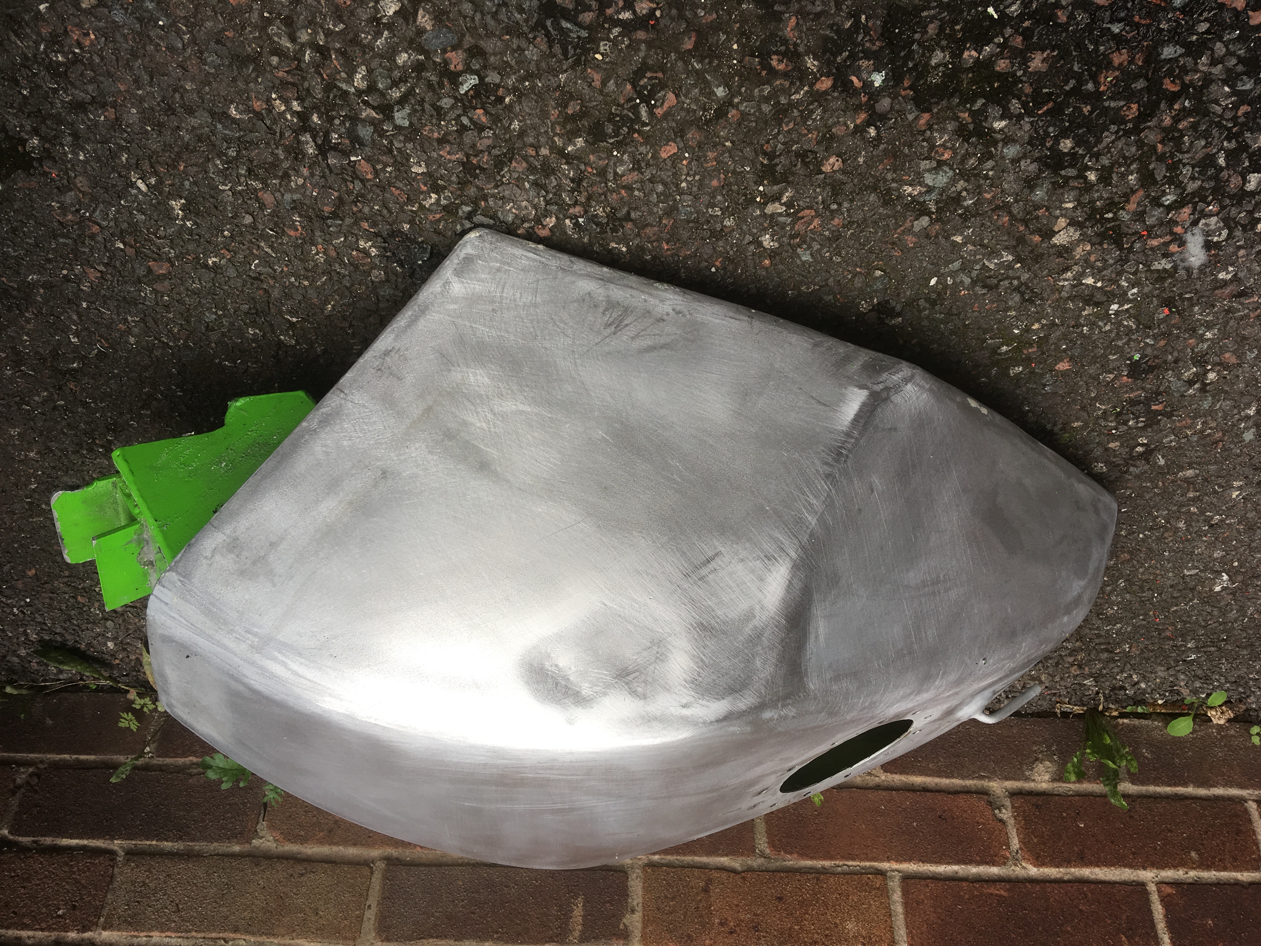

Yup, shed loads of filler in the tank Phil, the other side was just the same, strangely there was loads of filler but probably only about 9-10 small dents in it and one large one in the left hand side. It would be nice to find out more about the motor..... Here's a pic of the tank after all the filler was removed.

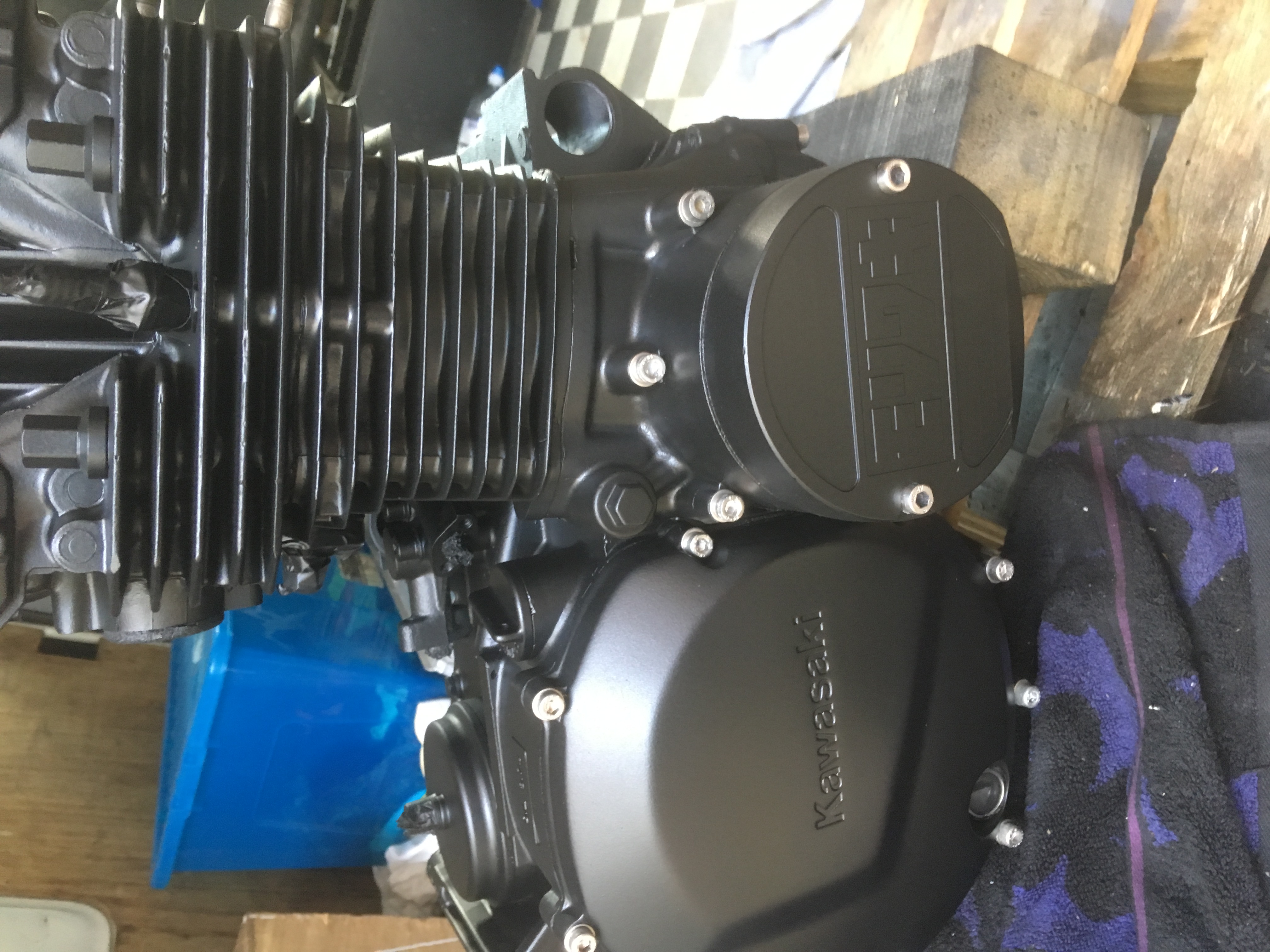

Well, a bit of progress at last after a bit of a false start with painting the engine silver.....Now satin black, pleased with the look.
