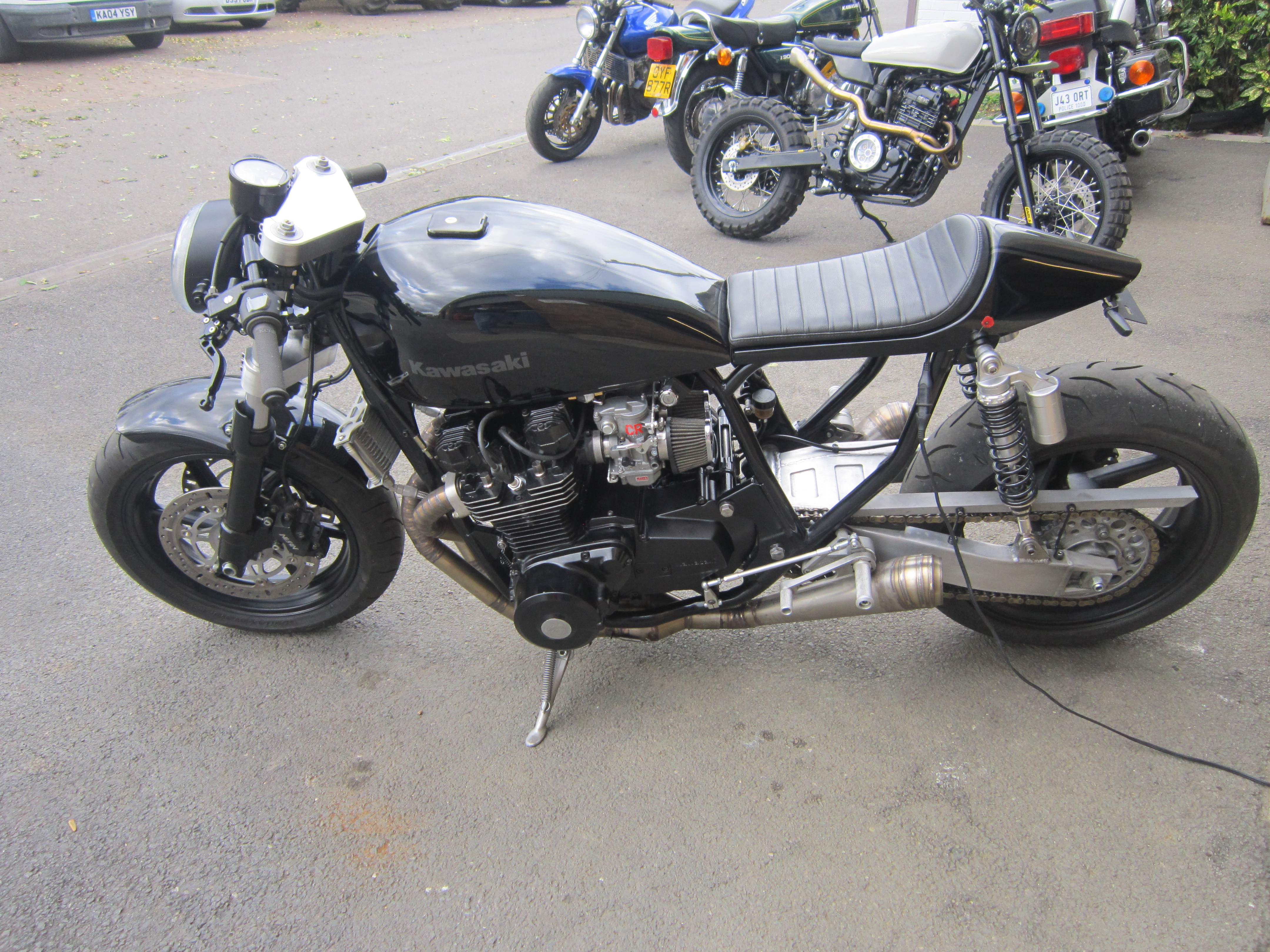

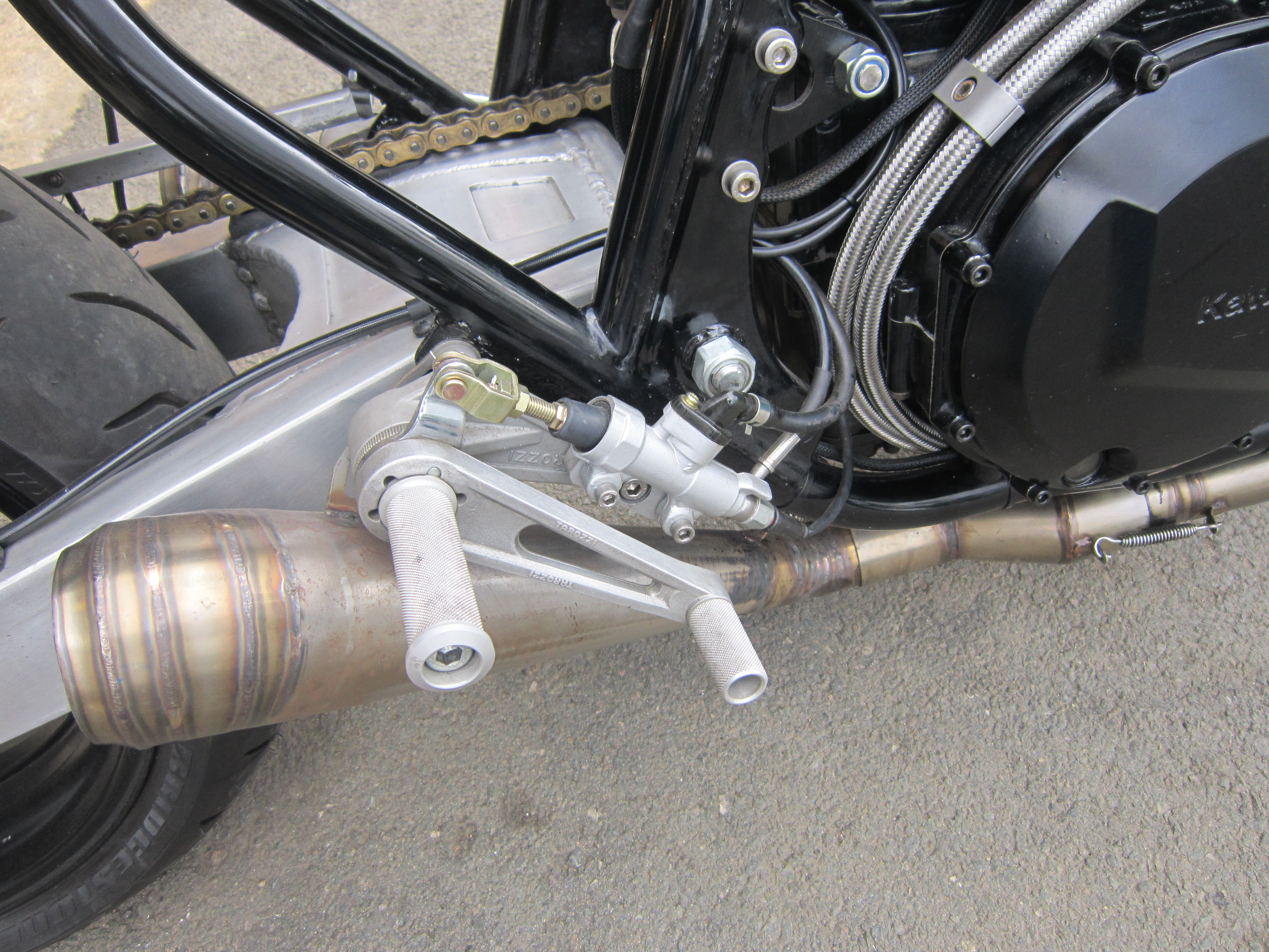

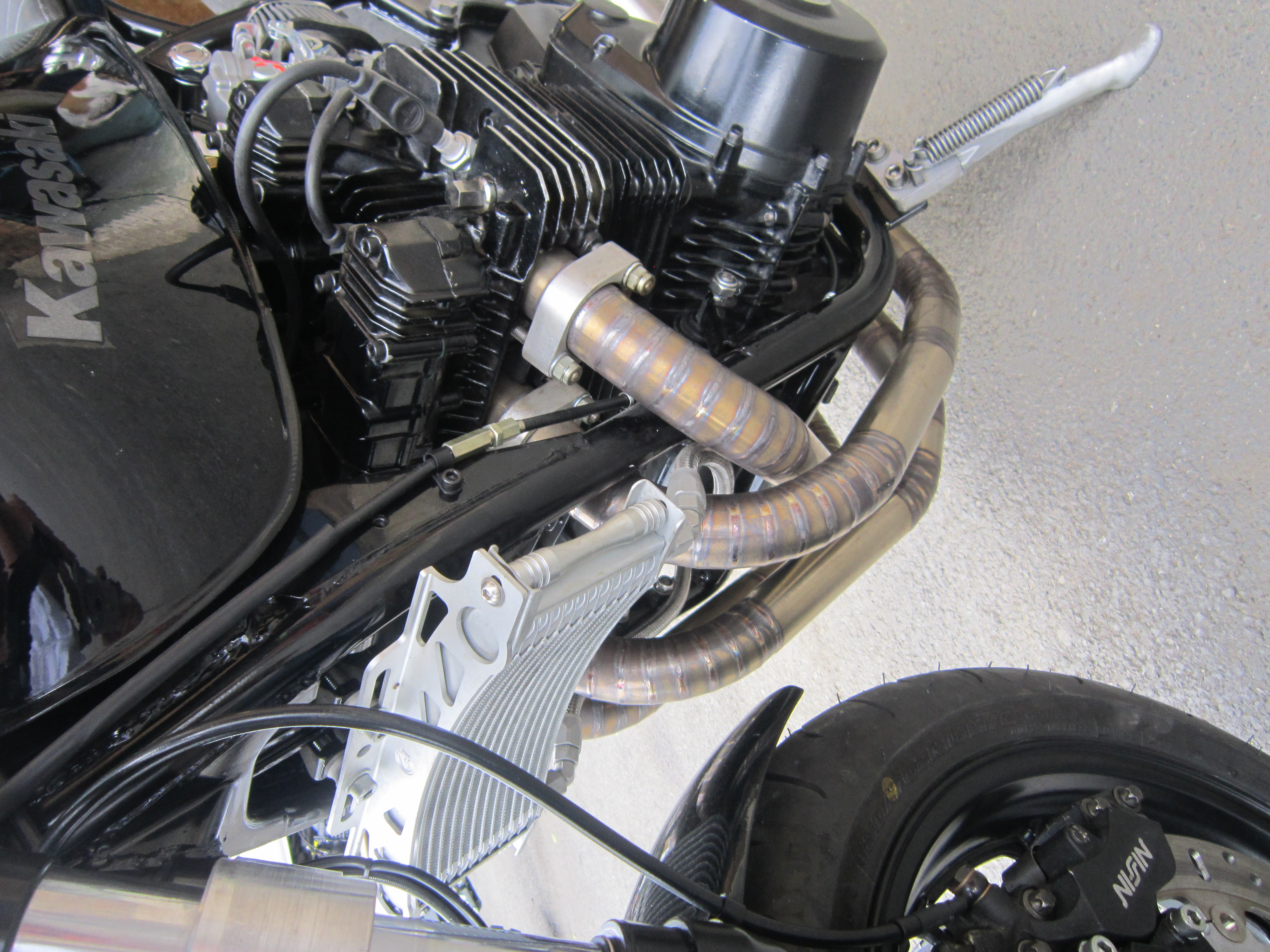

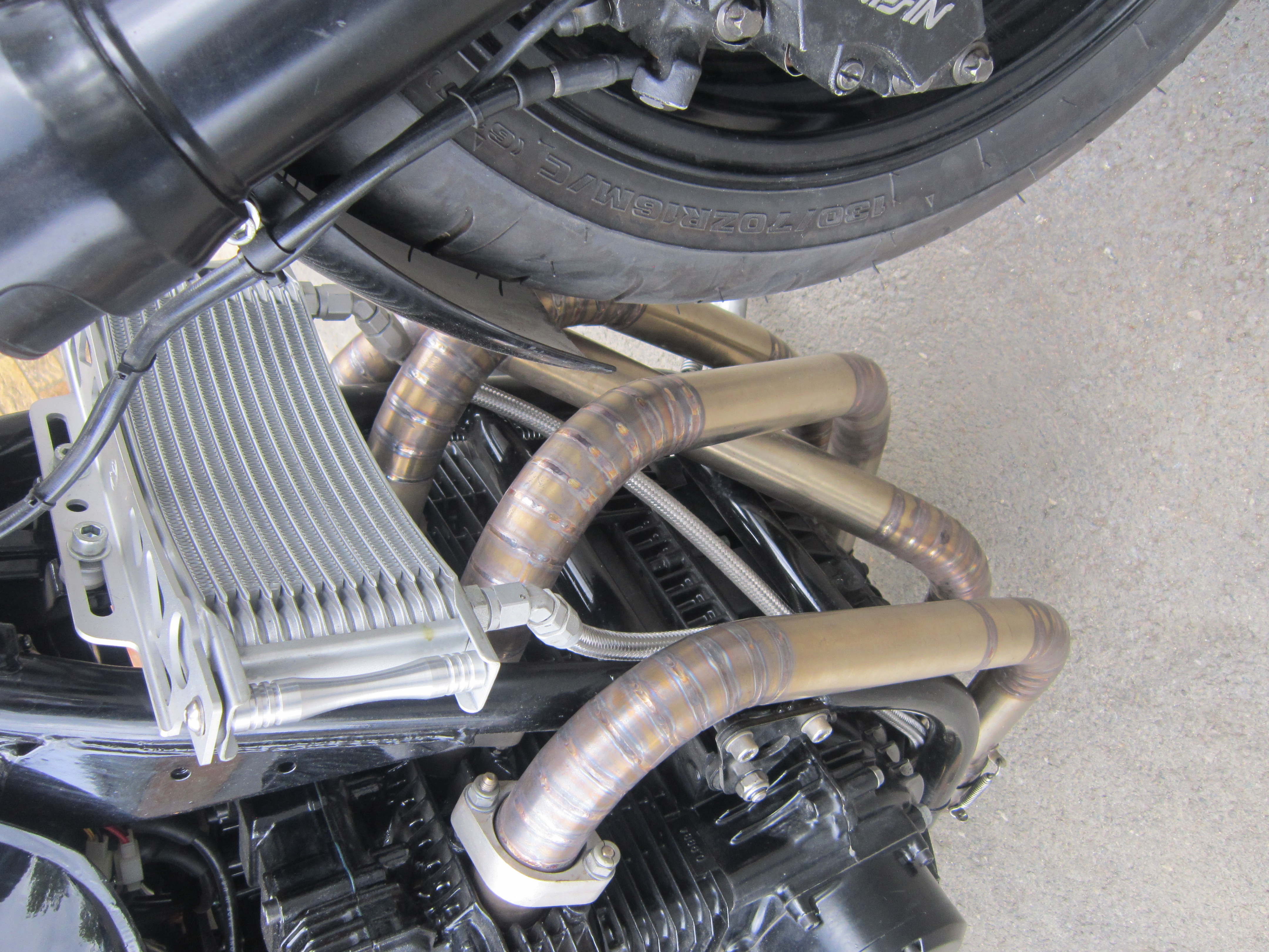

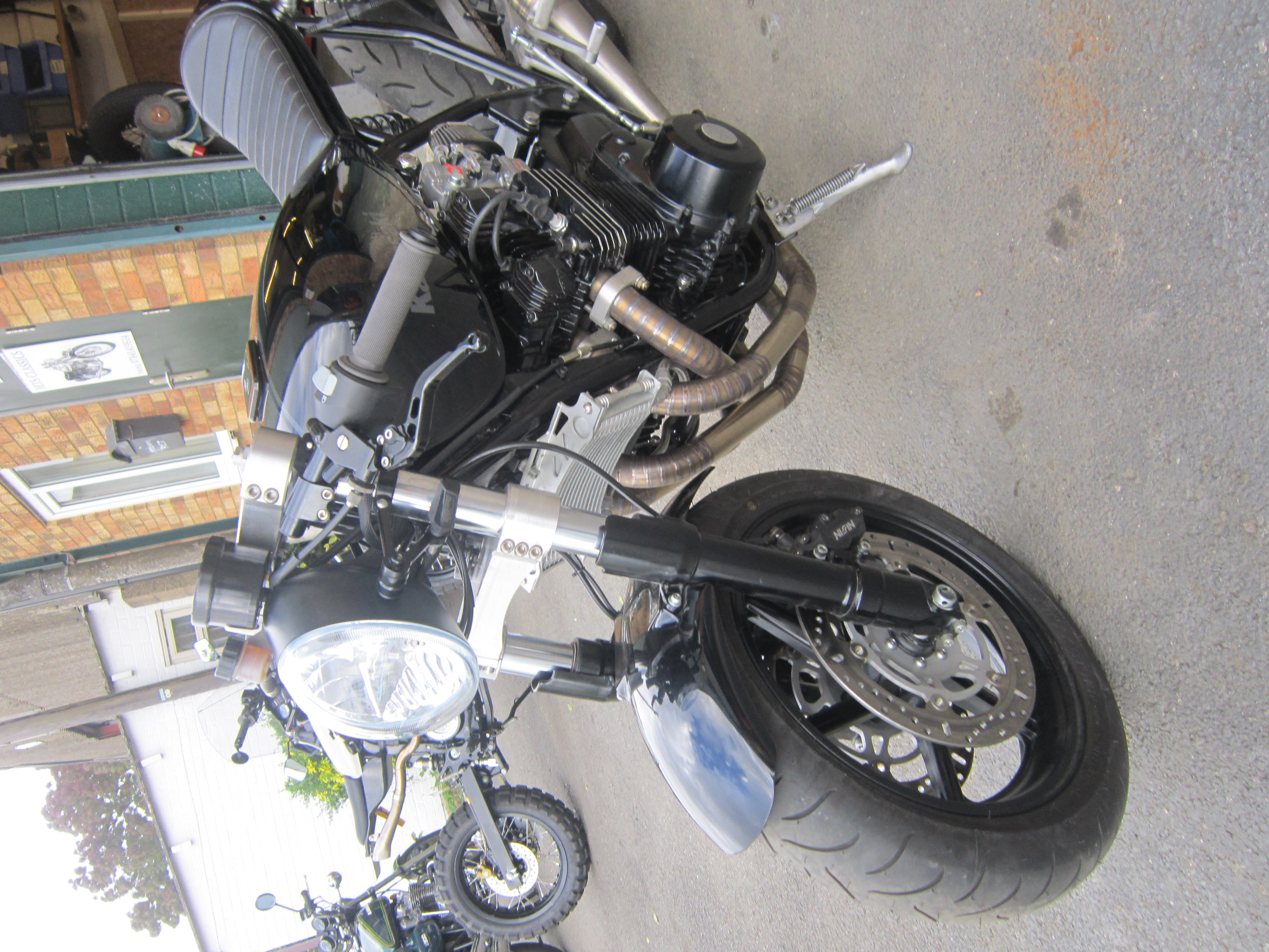

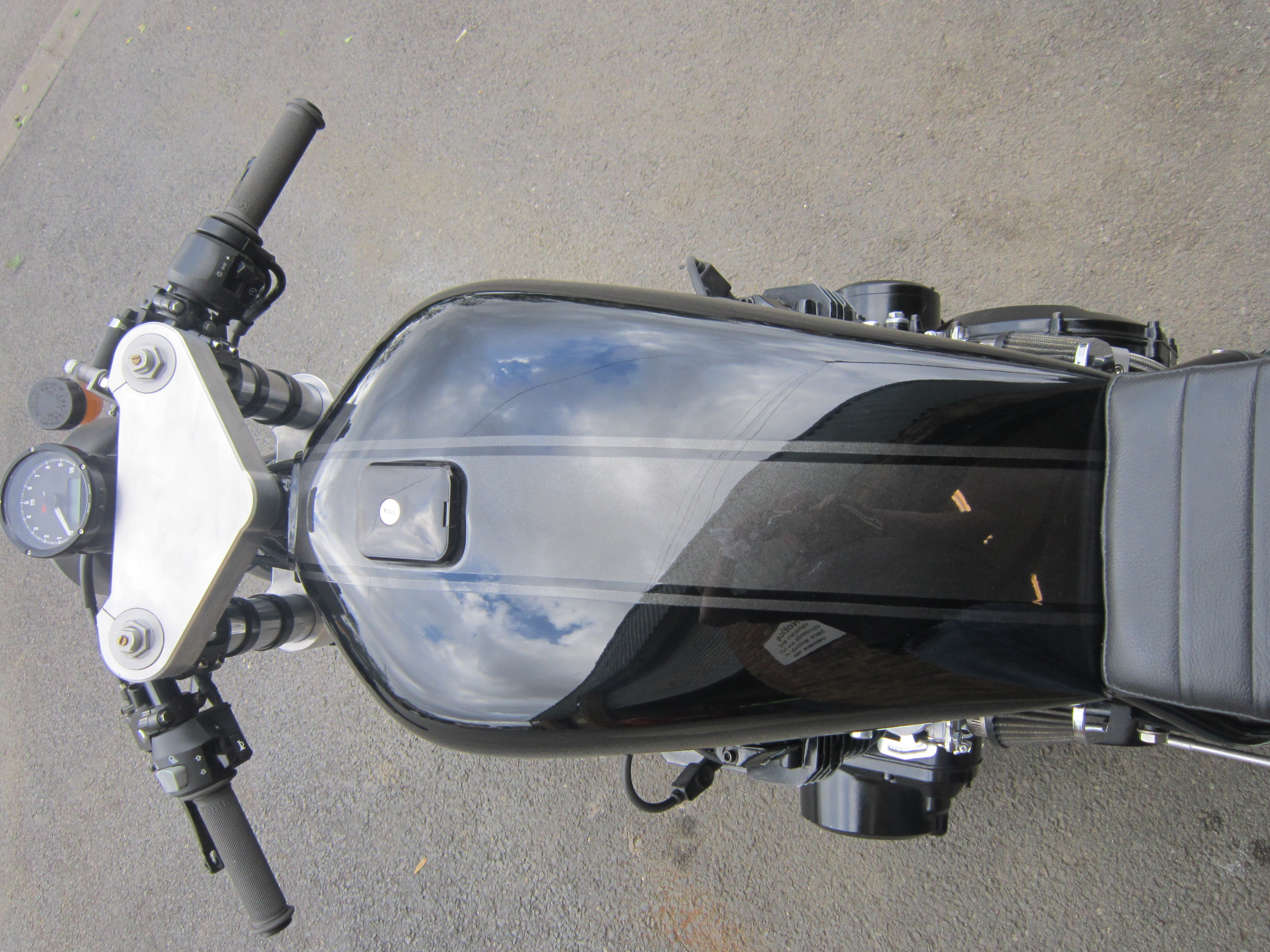

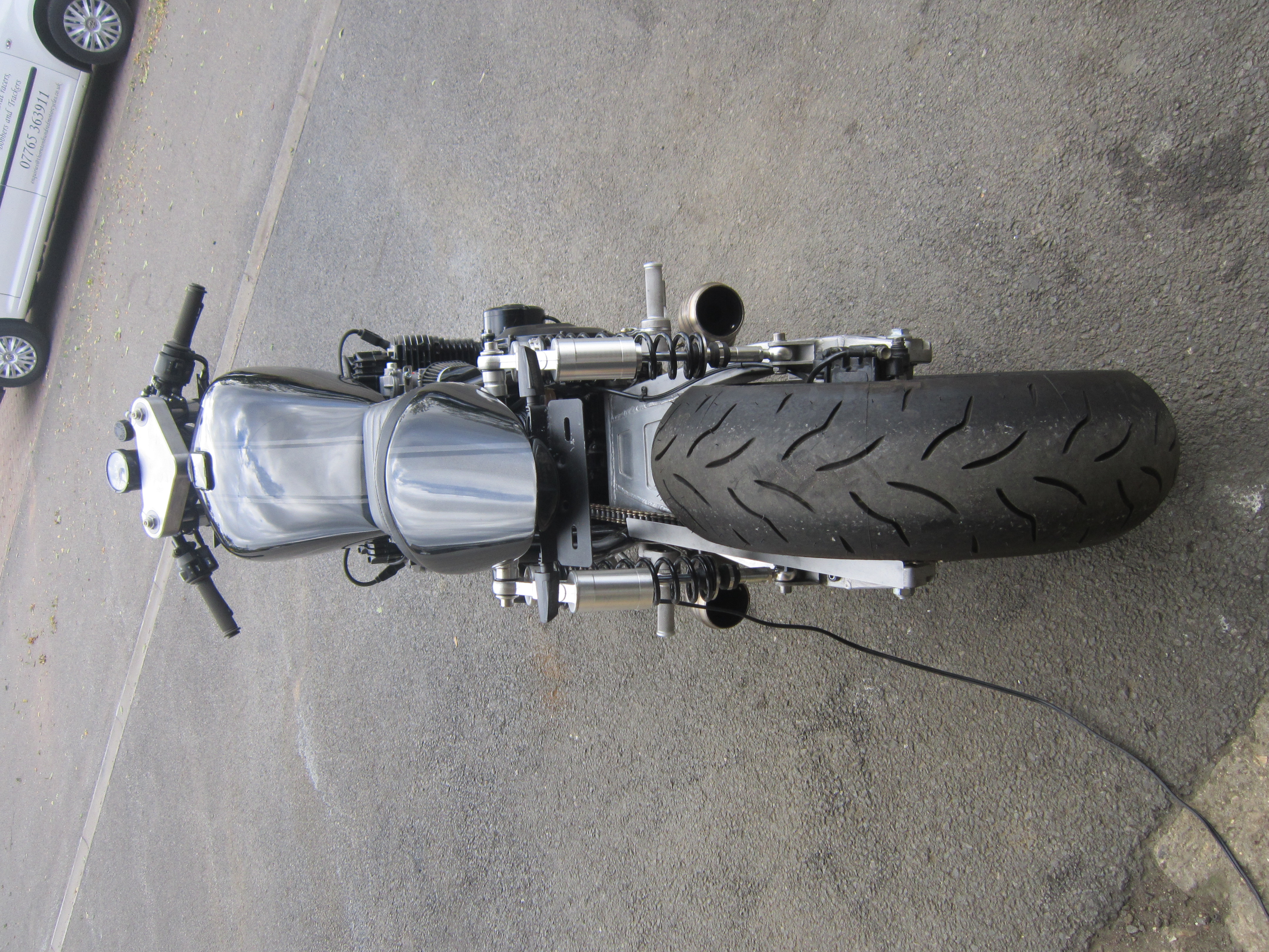

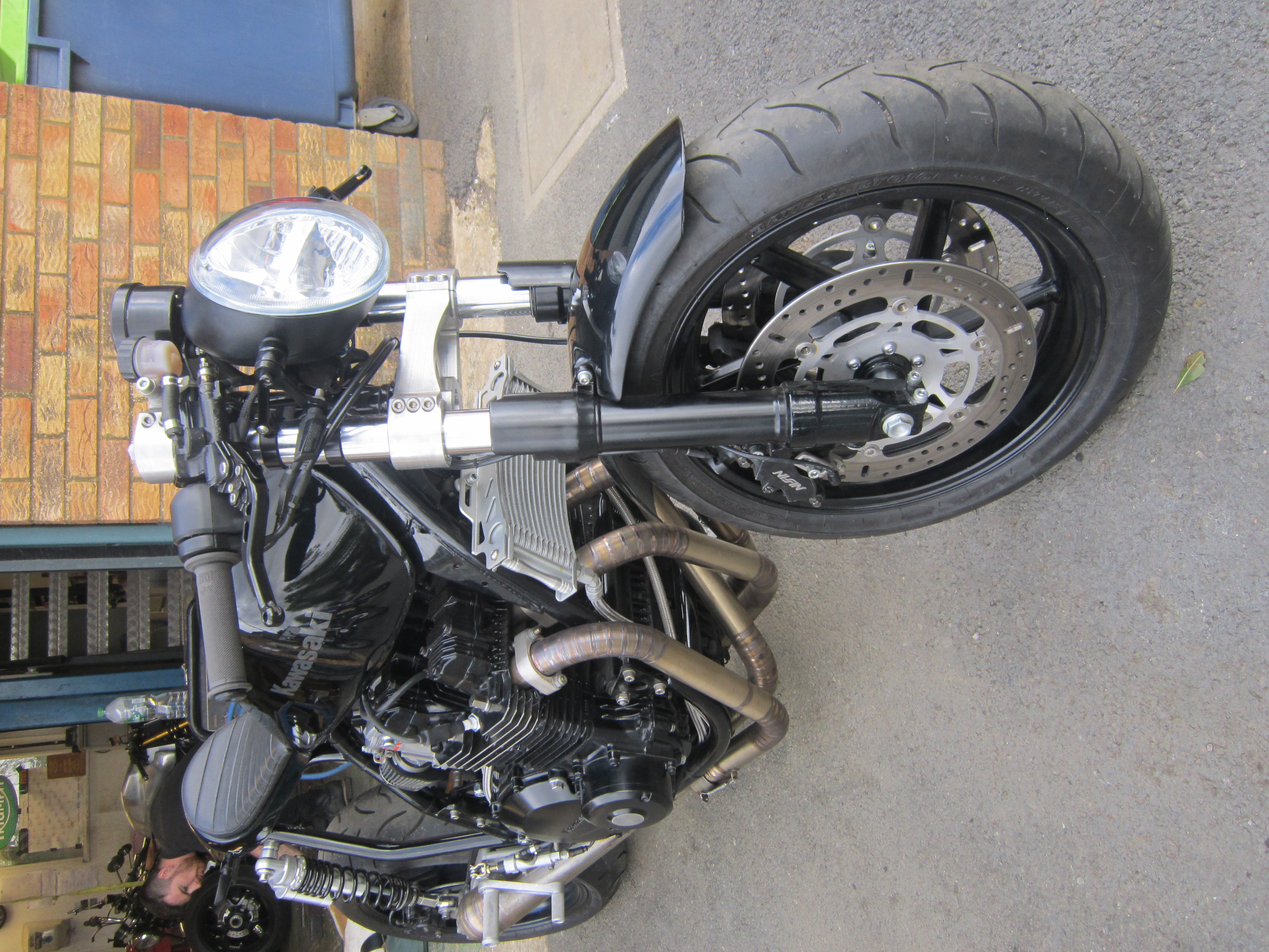

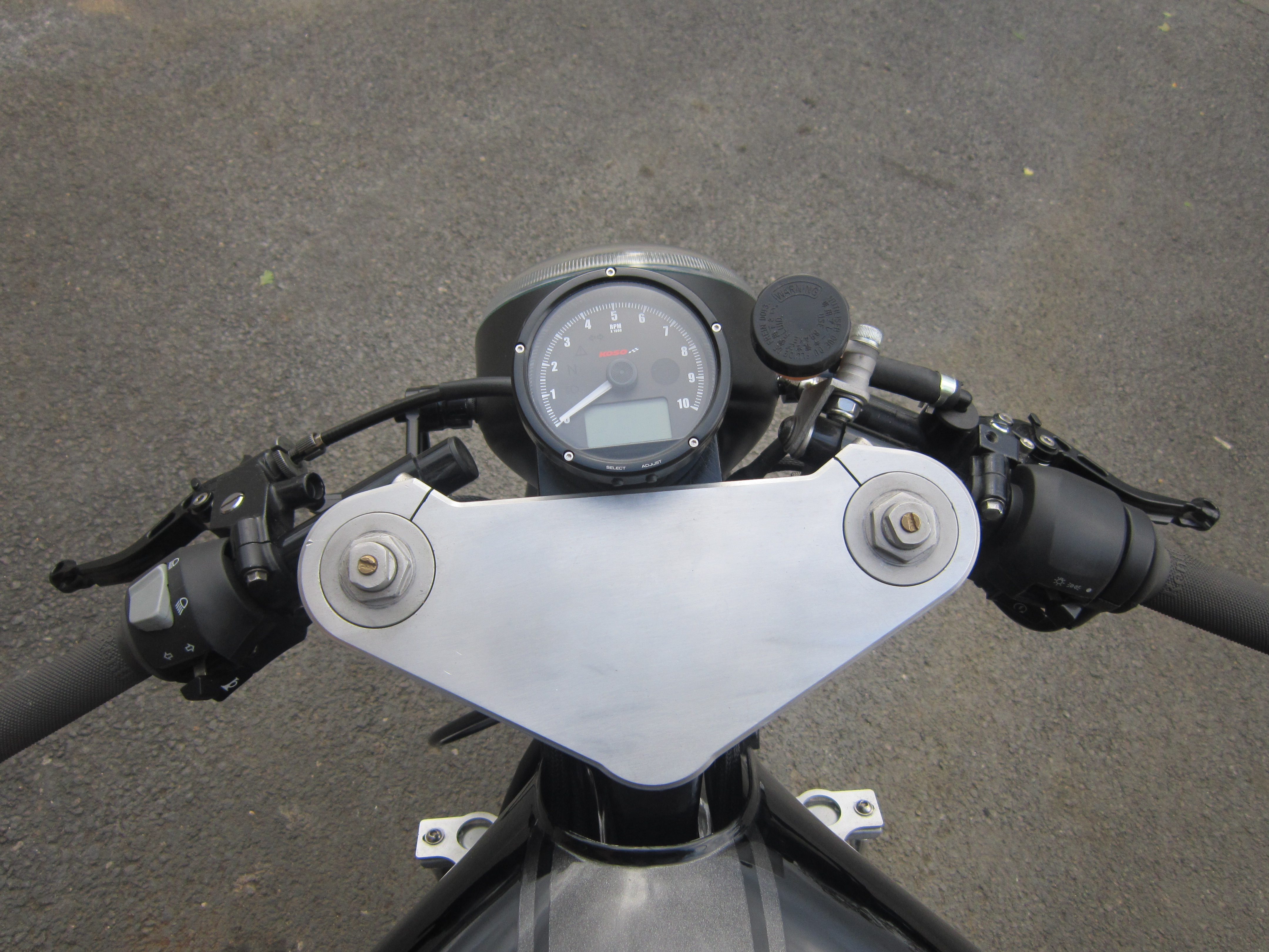

Thought you guys might like to see the latest build to be completed.Basic spec as follows:-
!983 Kawasaki Z1000-J2
Rear subframe replaced
Early Fireblade complete front end
Bandit swinging arm converted to twin shock
Early Fireblade rear wheel complete
Full engine rebuild
Early style tank
Full electro34 bespoke wiring loom
Dyna S ignition system
39mm smooth bore carbs
Modified rearsets
Full bespoke stainless 2-4 exhaust system
Loads of little detail parts!
Wooly

Very, very nice. Lot of work gone into that and it looks spot on

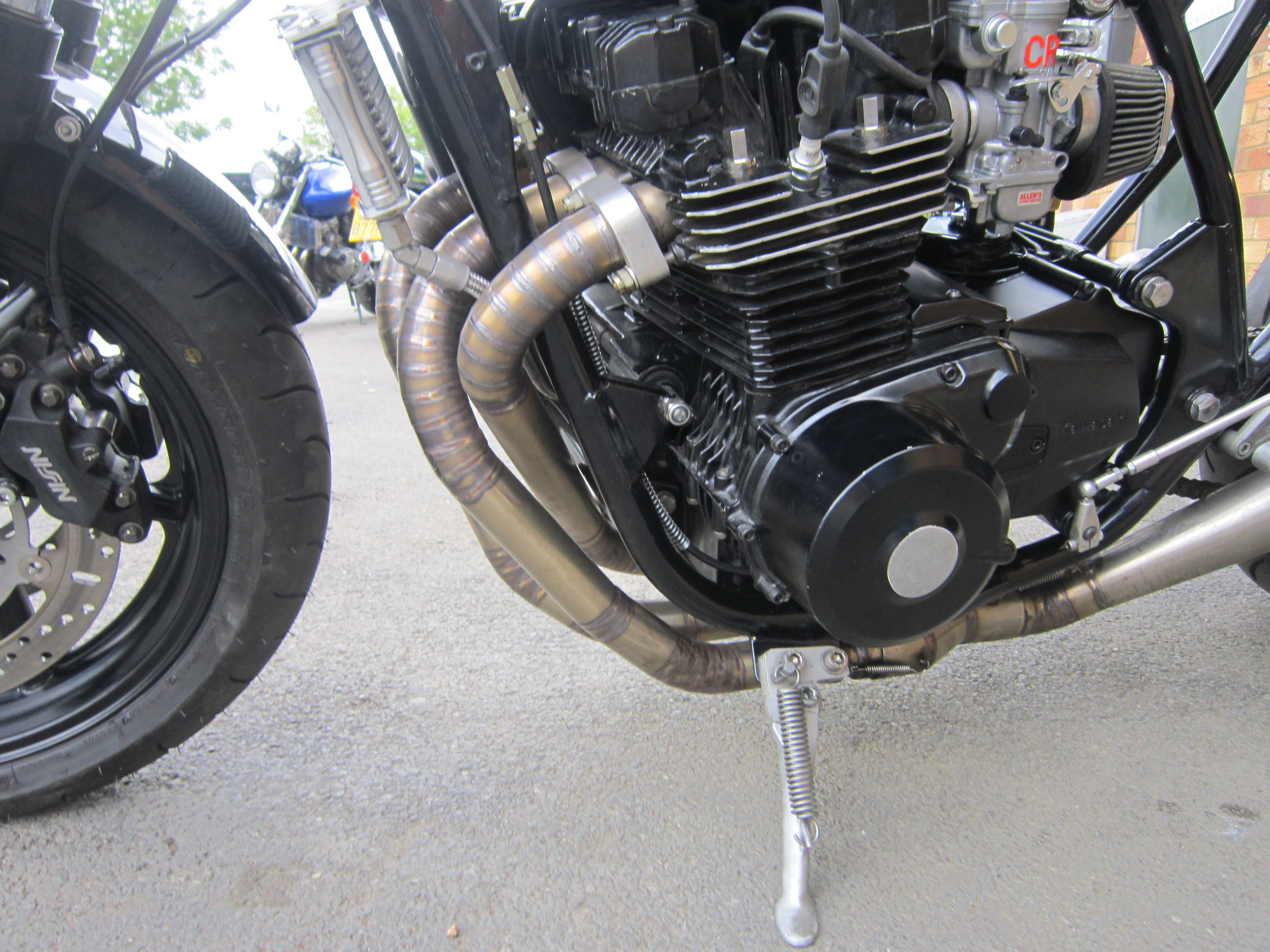

Bit of work in the exhaust headers.... :shock: :)

Very nice build wooly :vcool looks clean lines, seat padding looks a bit thin though :P

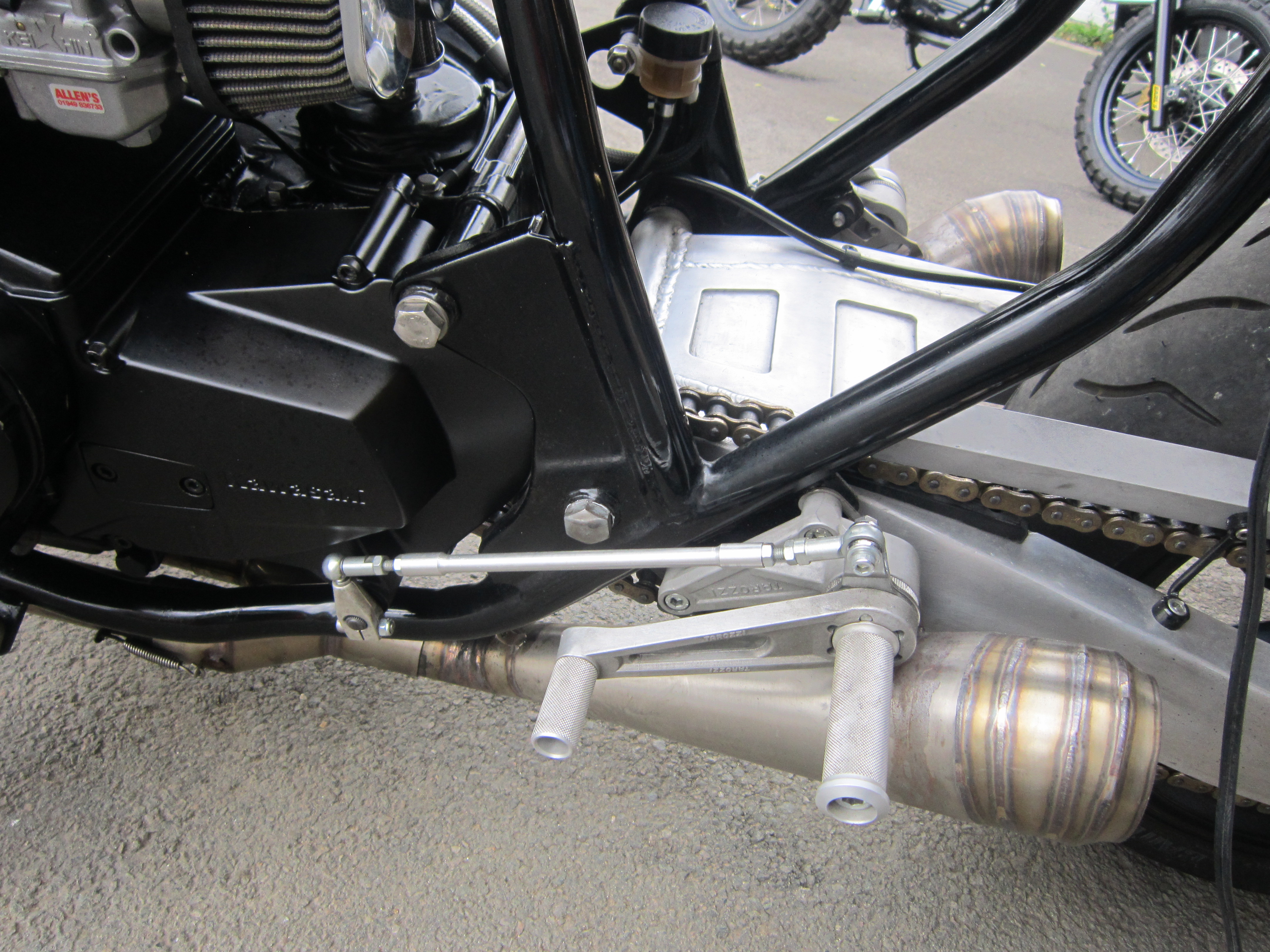

Very good engineering work, but I think the chain guard is a tad too long !
