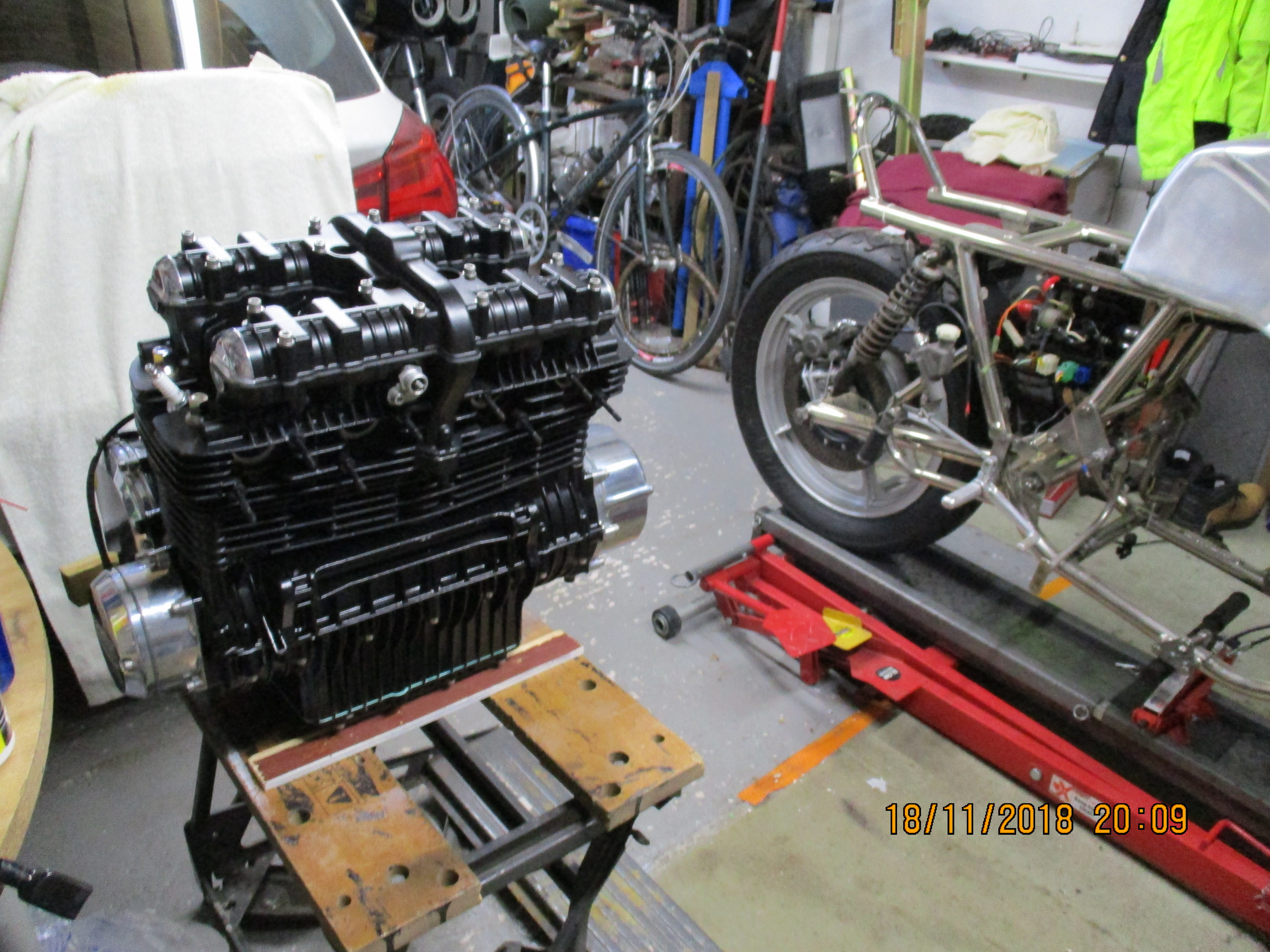

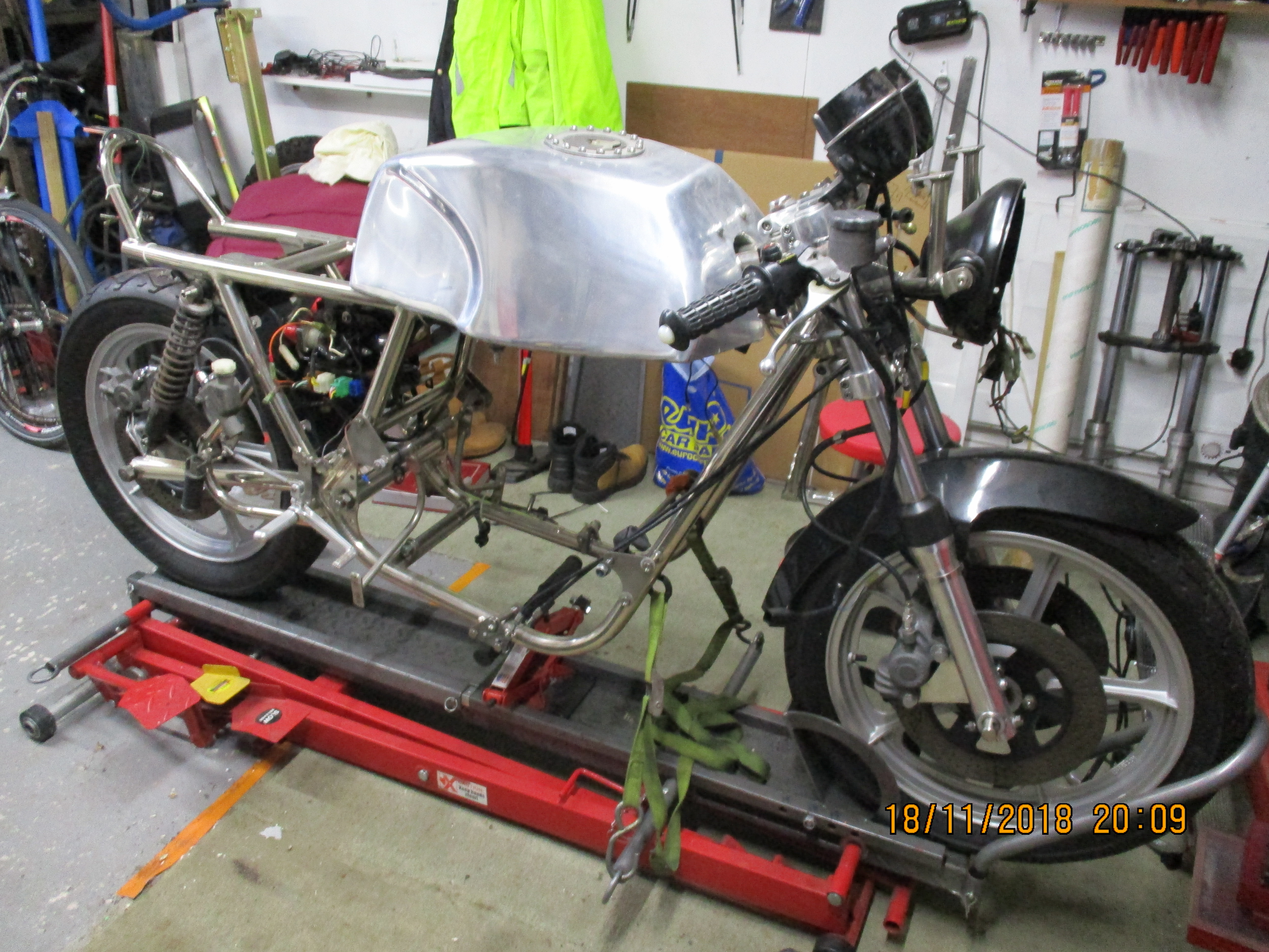

This is my Rickman, which i have owned for a number of years. It needs partial reassembly, new tires, brake seals etc.
This is the finished engine freshly rebuilt, it has omega pistons gas flowed head and big valves.
I will post more pictures as work progresses.

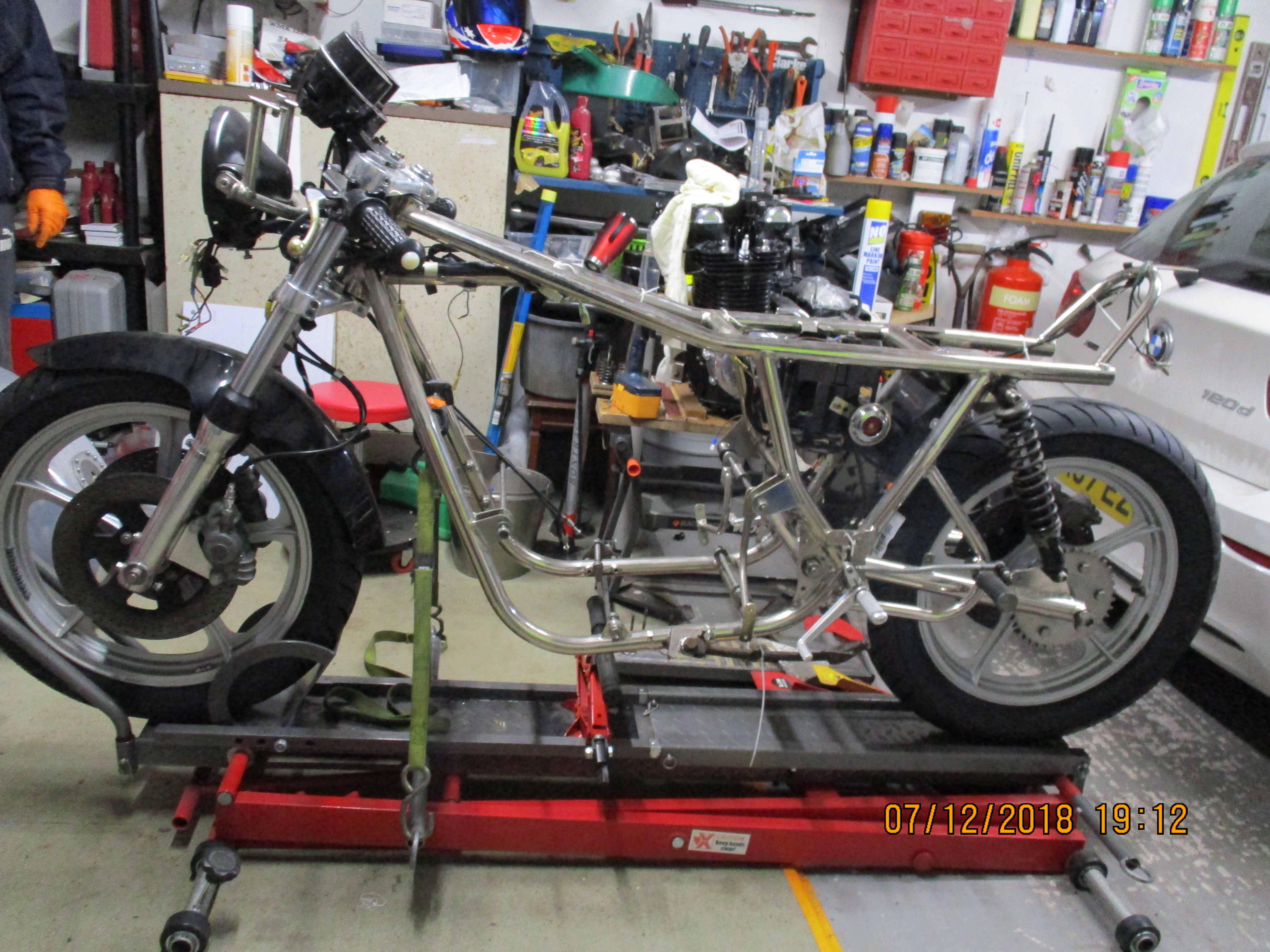

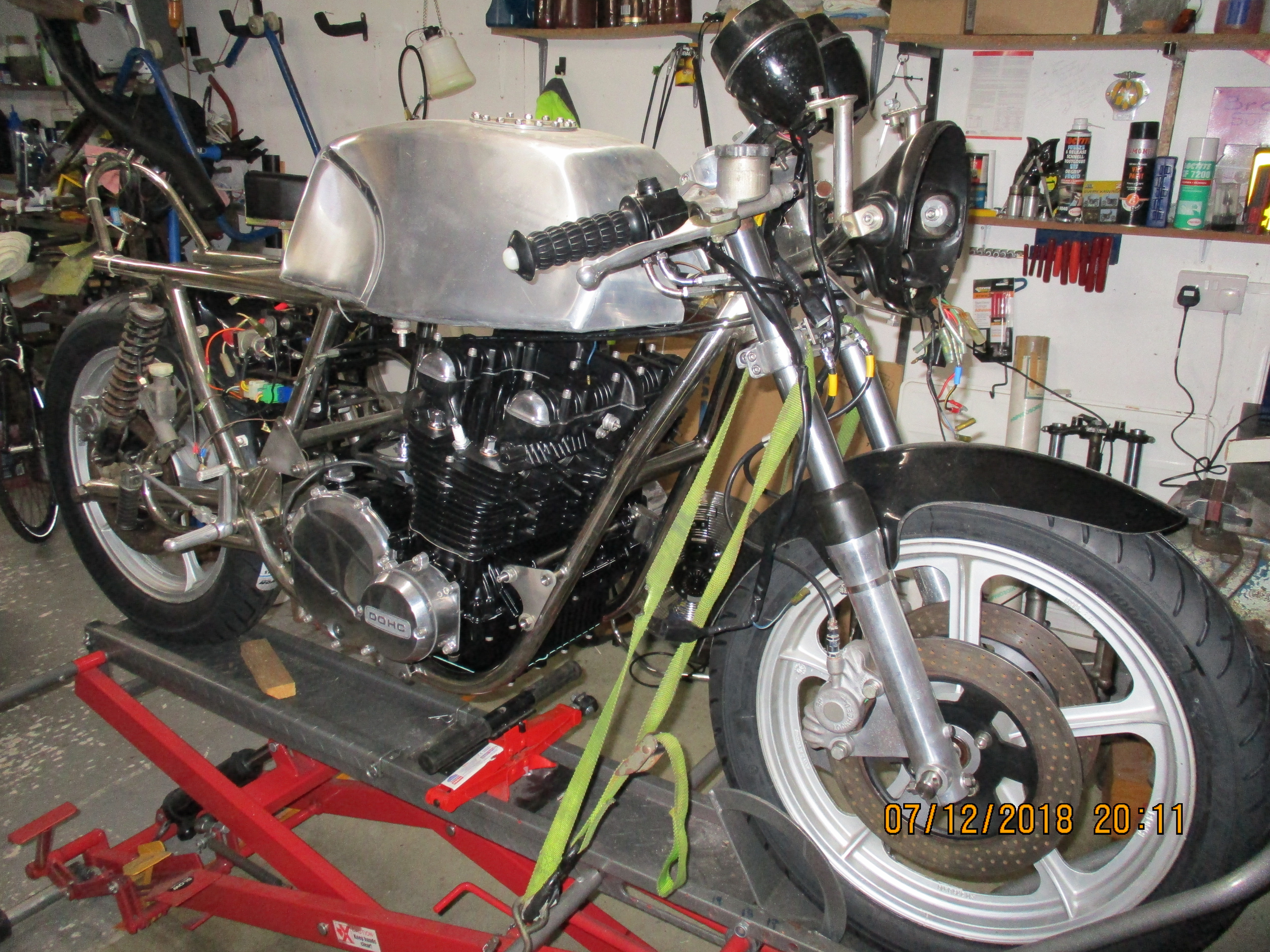

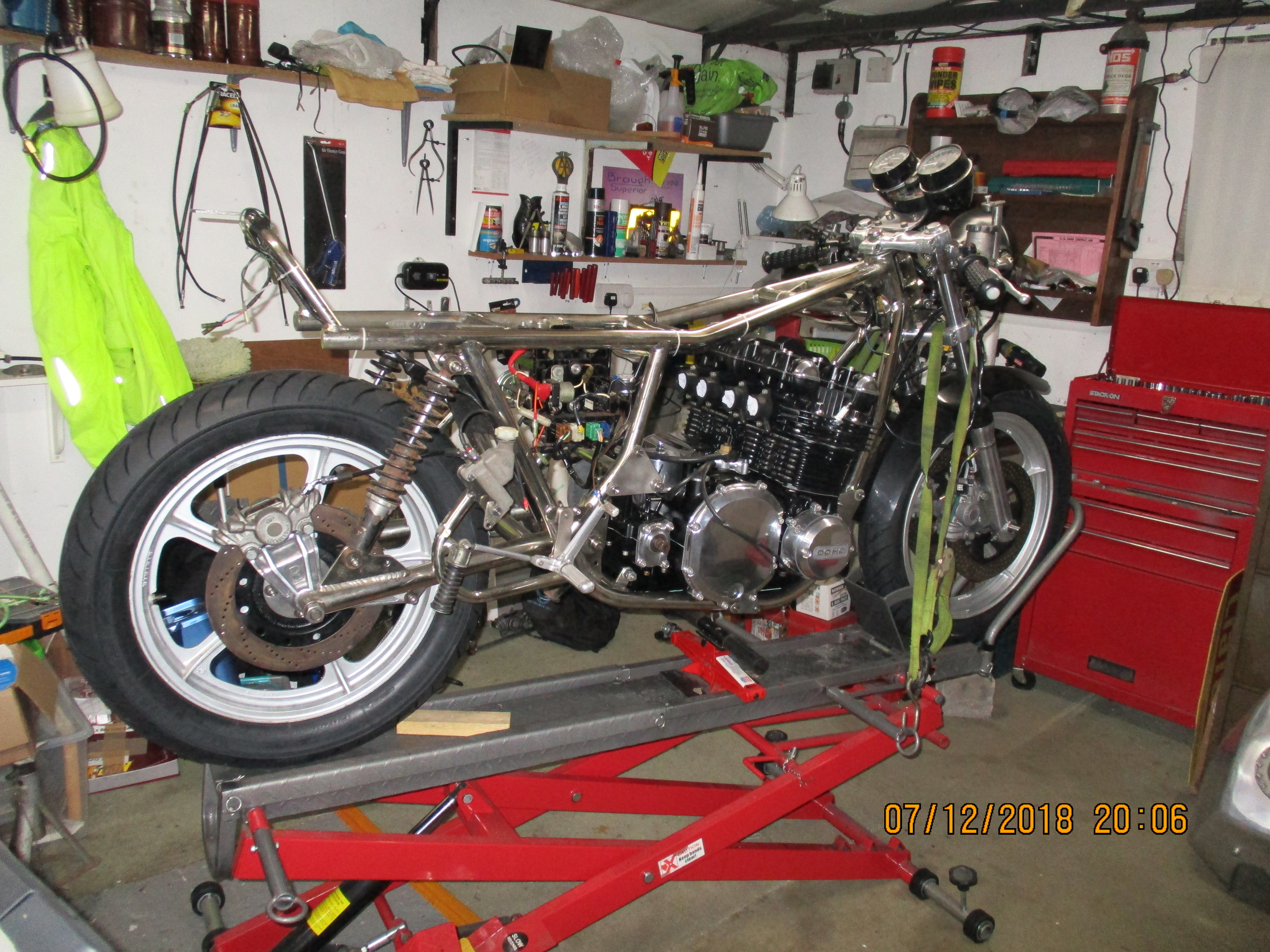

#7 PostAuthor: Dunlop4 » Fri Dec 07, 2018 9:22 pm
I had new tyres fitted and bolted the wheels back in the frame.
Next fitting the engine.
The contrast of a black engine against a nickel frame, looks quite nice.
Here is a picture with the petrol tank on.

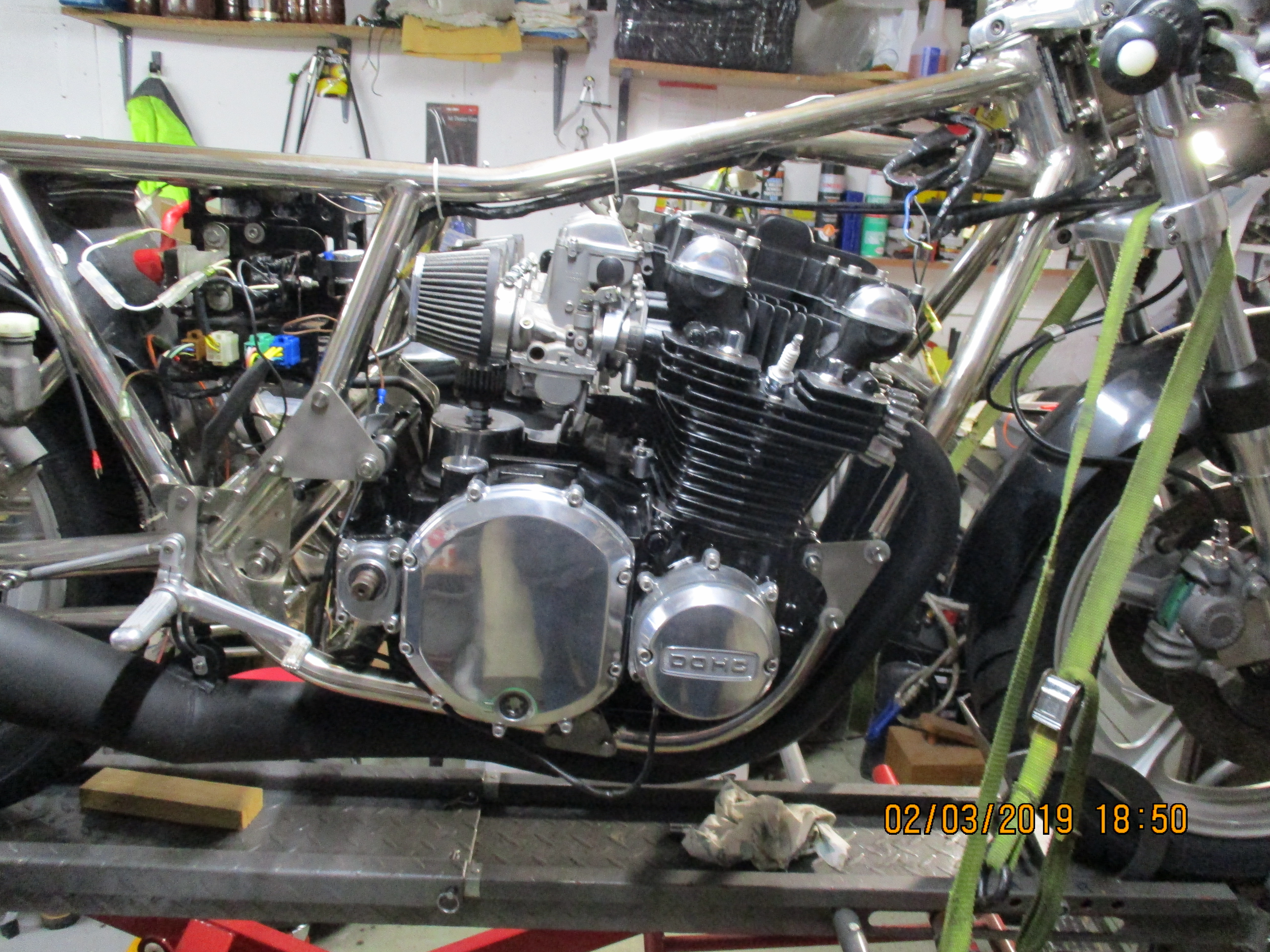

#10 PostAuthor: Dunlop4 » Sat Mar 02, 2019 7:29 pm

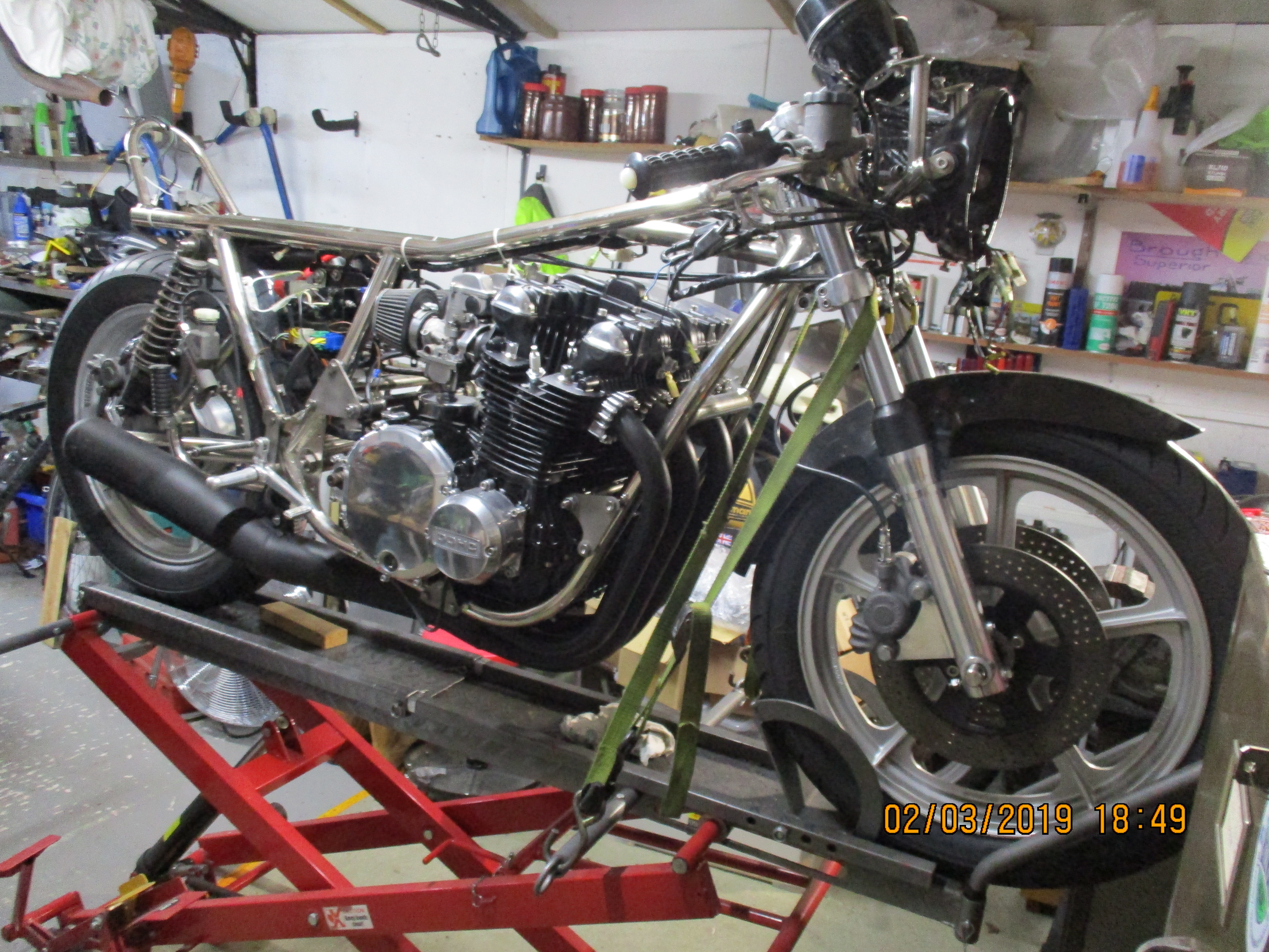

Update exhaust, generator connected.
Carbs fitted

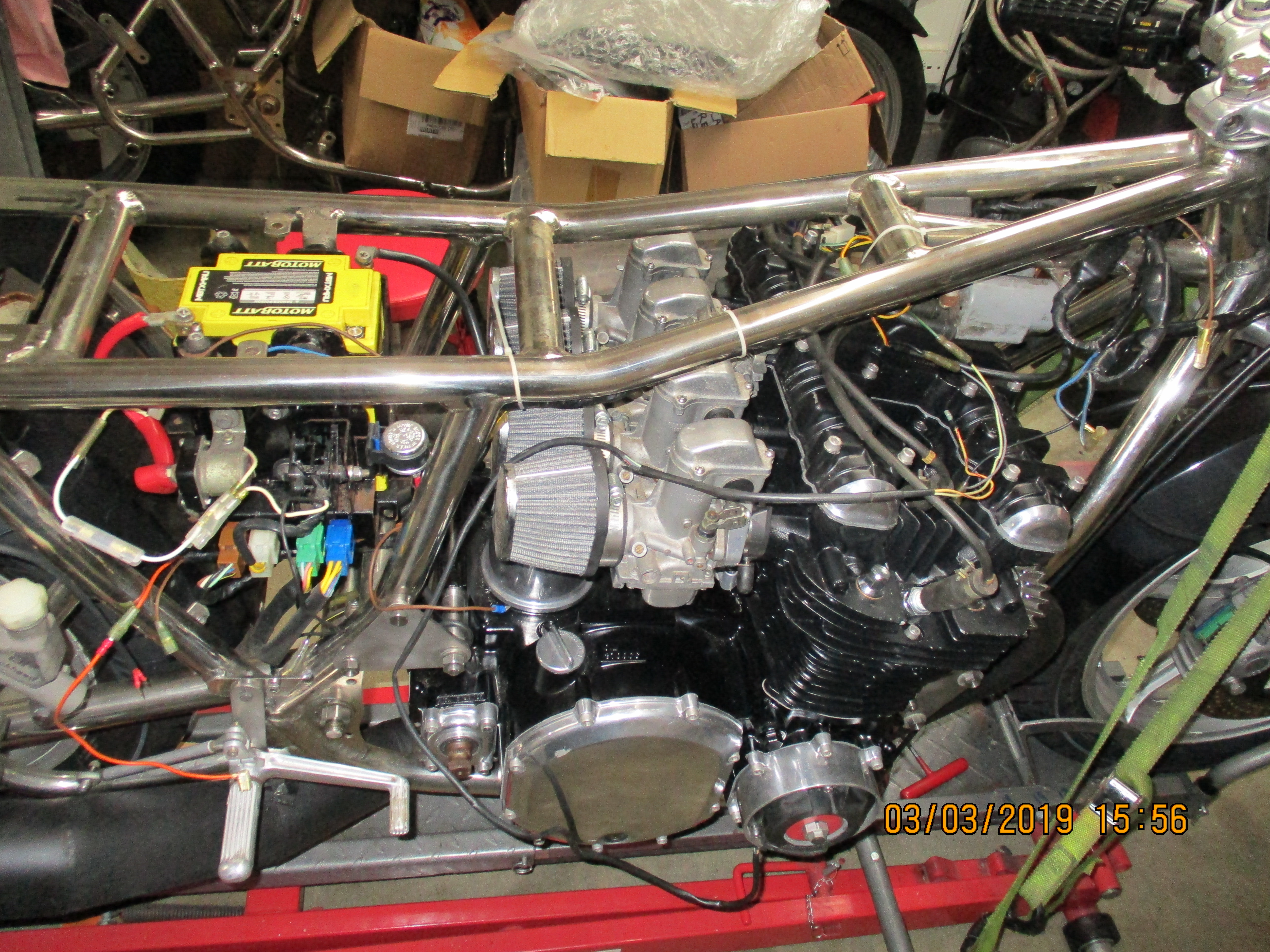

#12 PostAuthor: Dunlop4 » Sun Mar 03, 2019 4:09 pm

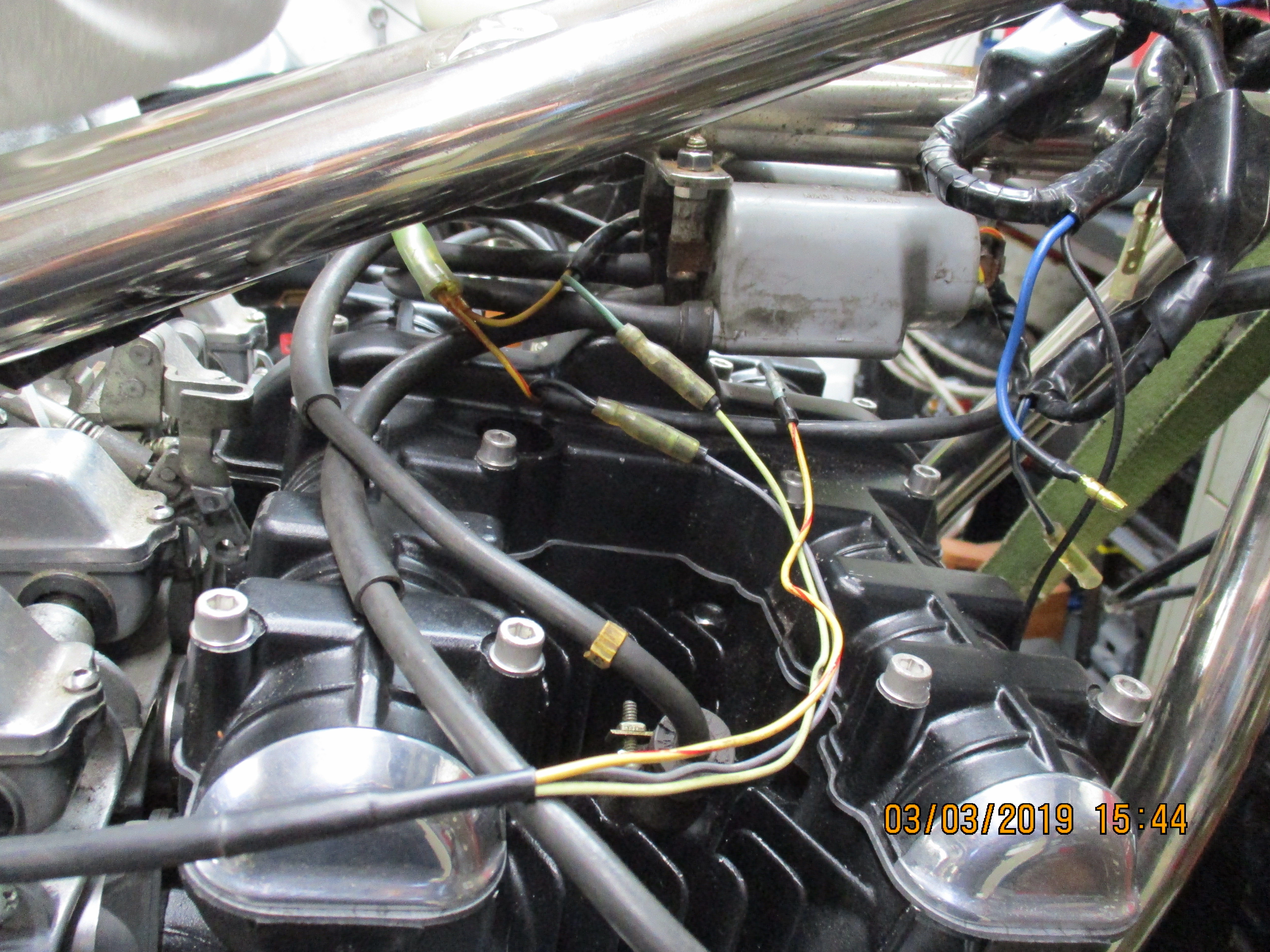

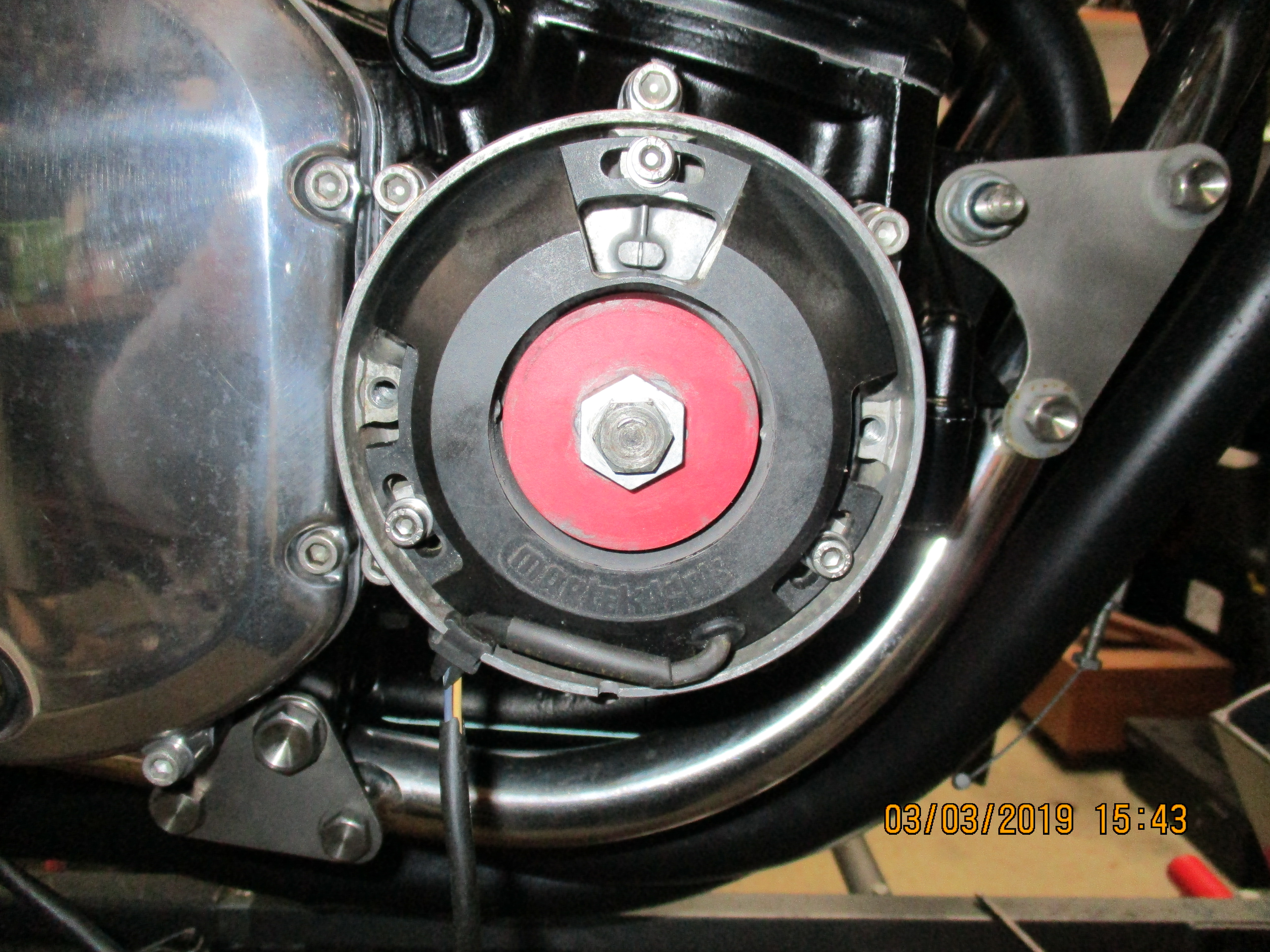

I installed the ignition system a Martek
I have an orange and red wire from the martek spare.
After connecting the battery there is no power.
Dunlop4
Posts: 224
Joined: 17th Sep 2015
Location: Cardiff
Re: Rickman

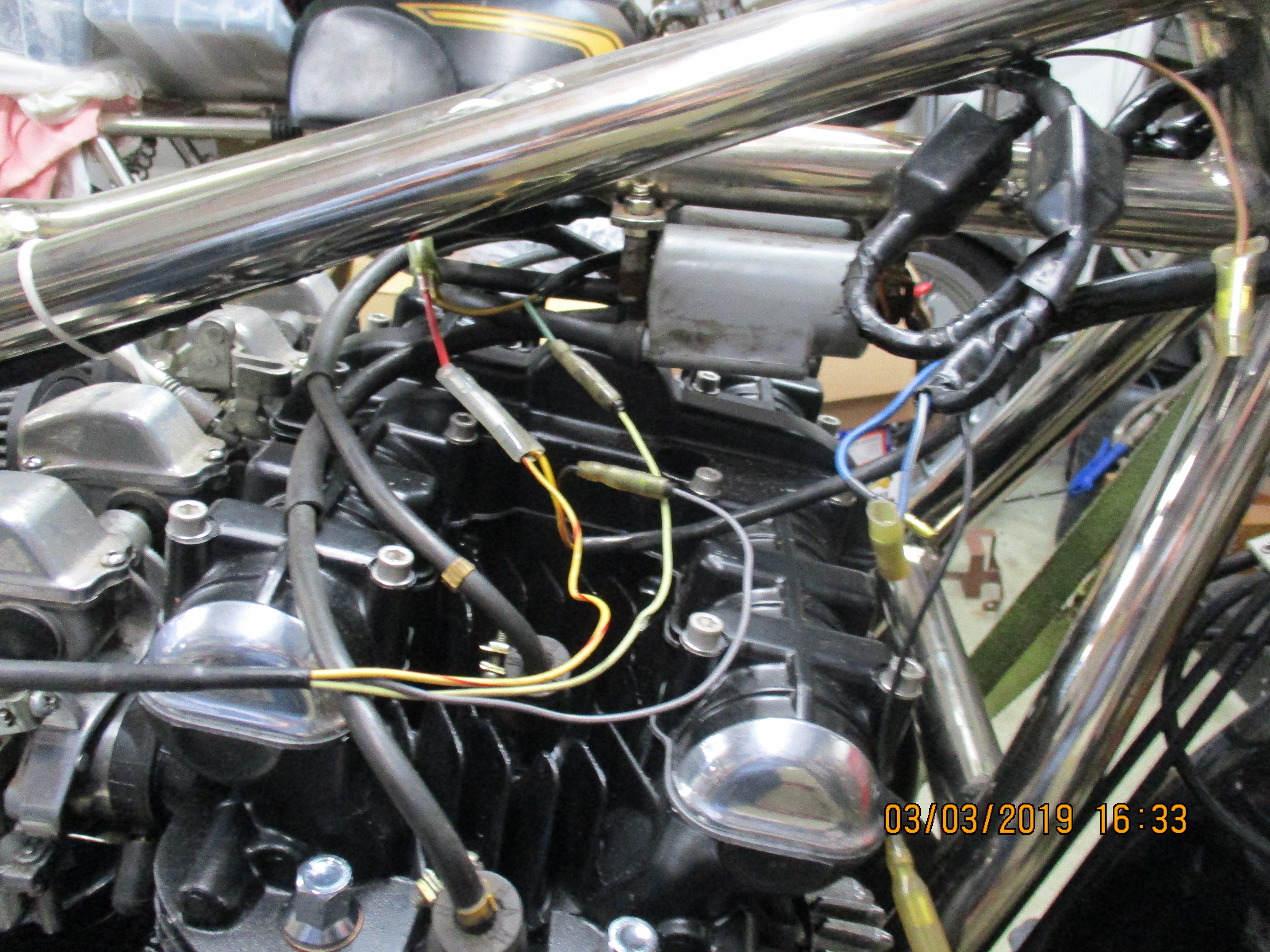

#13 PostAuthor: Dunlop4 » Sun Mar 03, 2019 4:40 pm
Spliced in the yellow and red wire from the martek, still no power.
Dunlop4
Posts: 224
Location: Cardiff
Re: Rickman

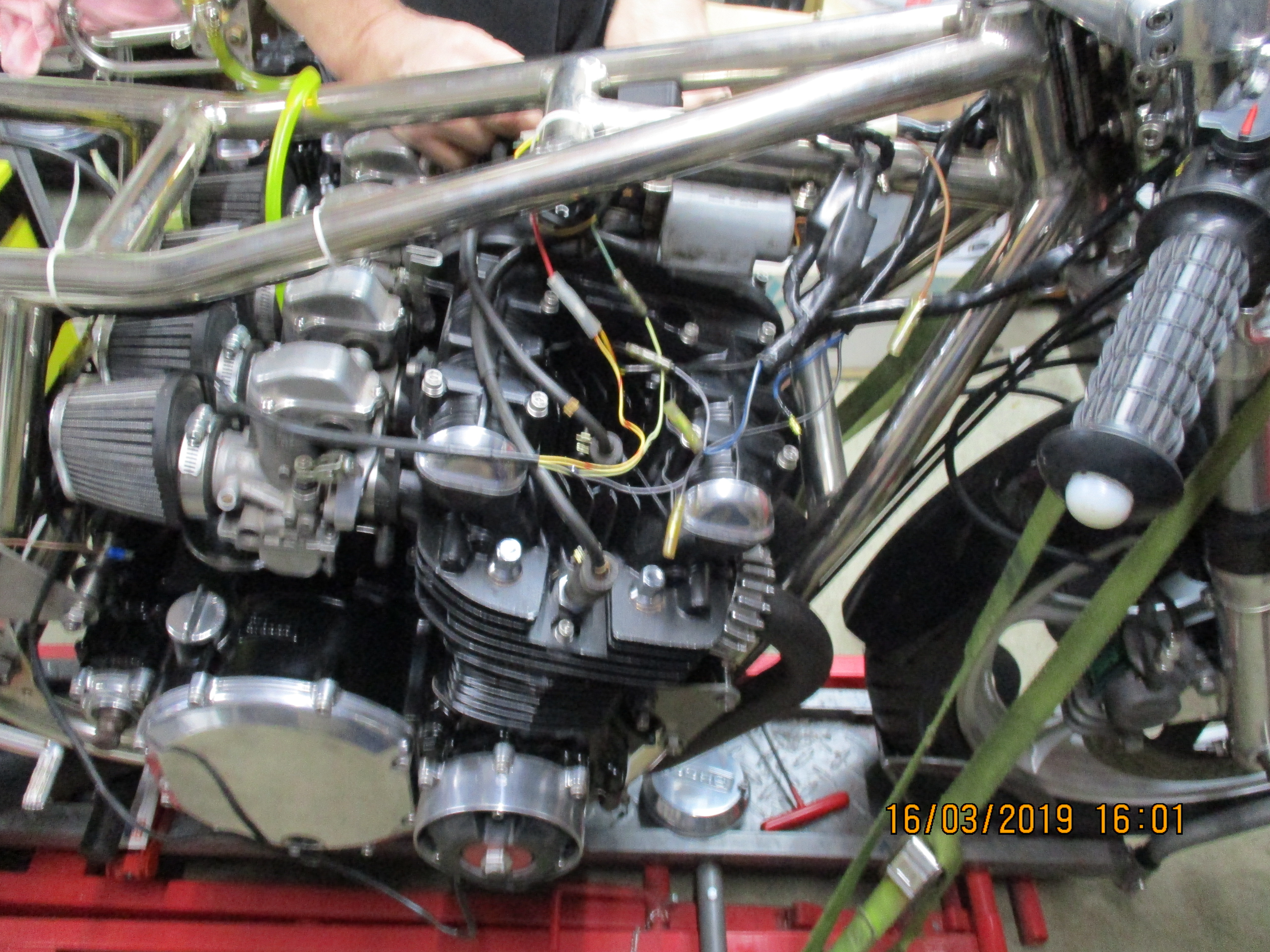

#14 PostAuthor: Dunlop4 » Sat Mar 16, 2019 5:53 pm
Success at last, have now got it started but only on two cylinders. The fuse needed connections needed cleaning.
The green wire from the martek is not powering up the coil for 2-3 cylinders, in effect running on 2 cylinders

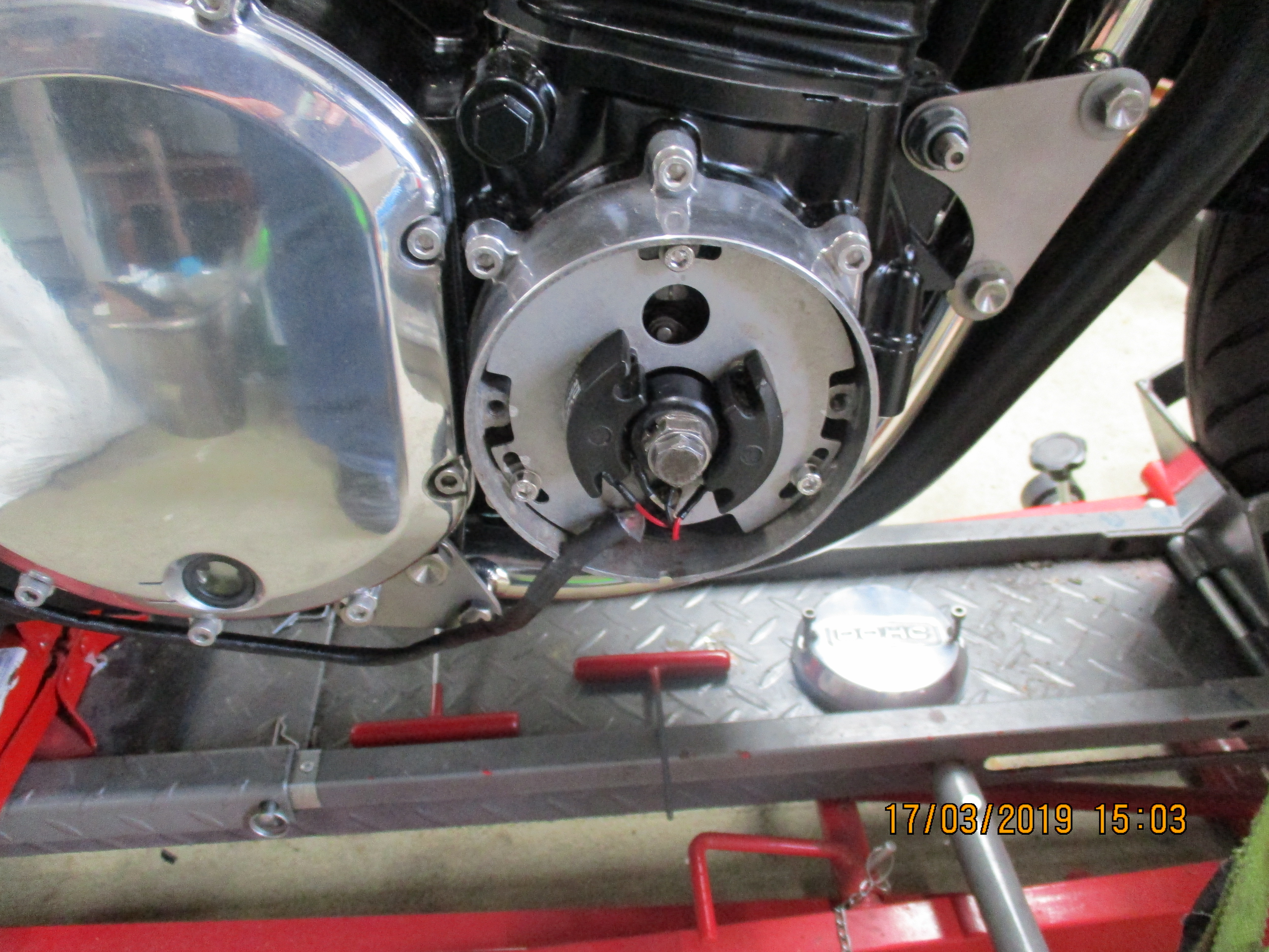

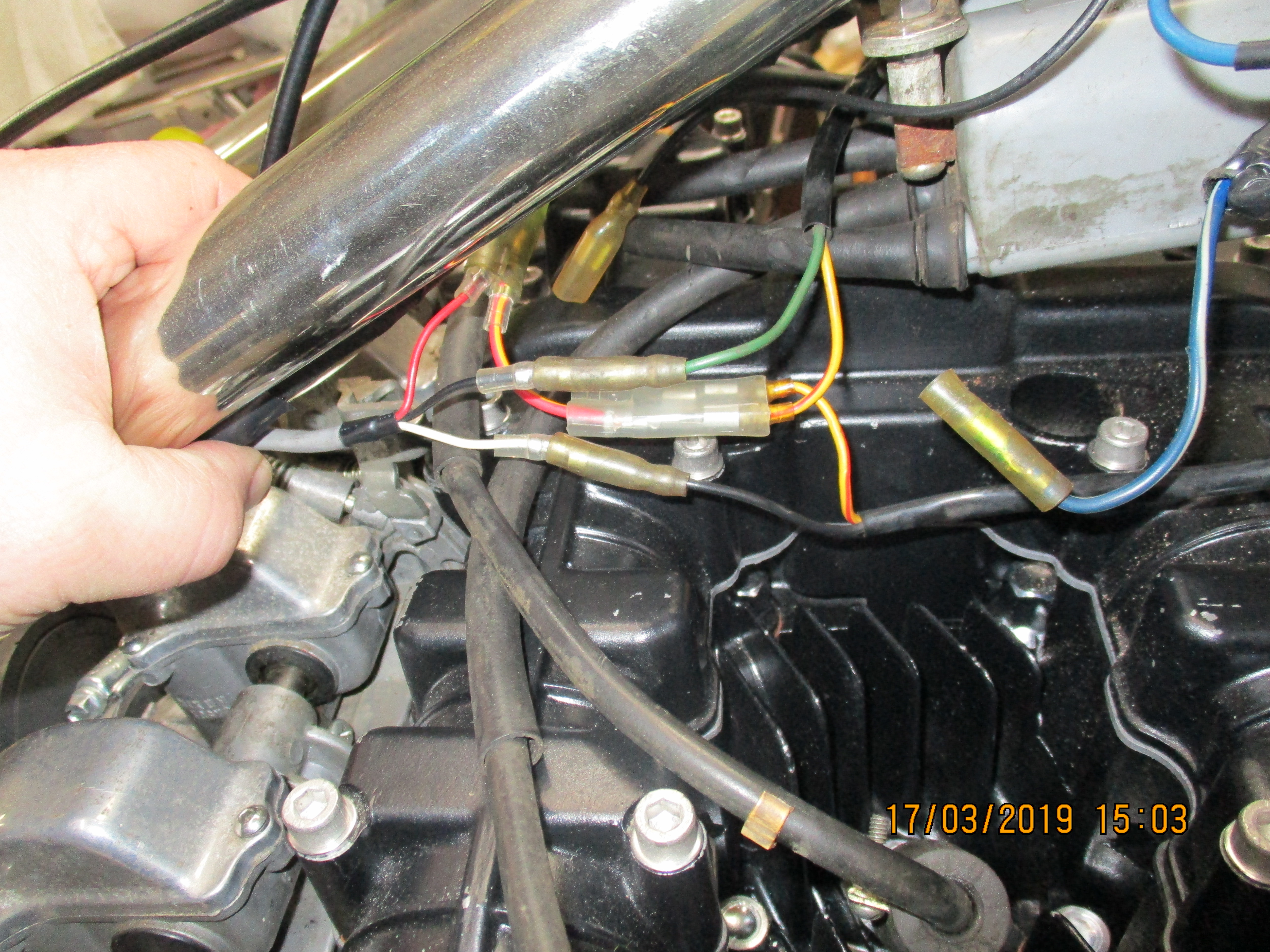

#15 PostAuthor: Dunlop4 » Sun Mar 17, 2019 3:52 pm
I fitted a Dyna s ignition
After swapping the wires around it started.
