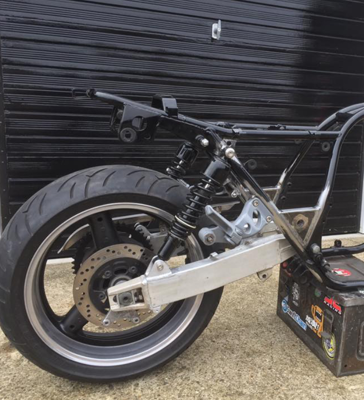

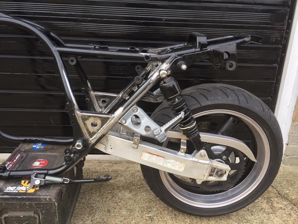

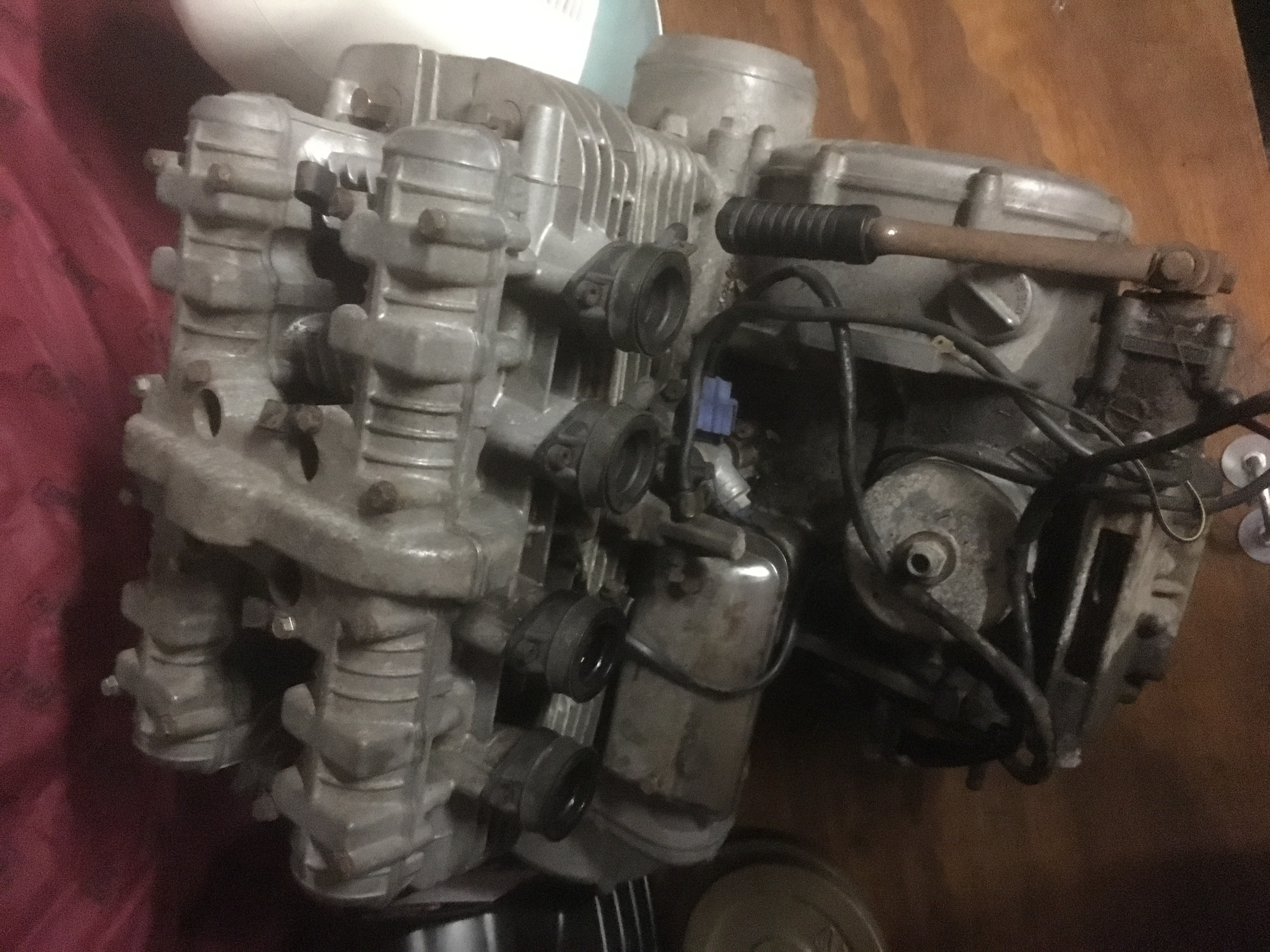

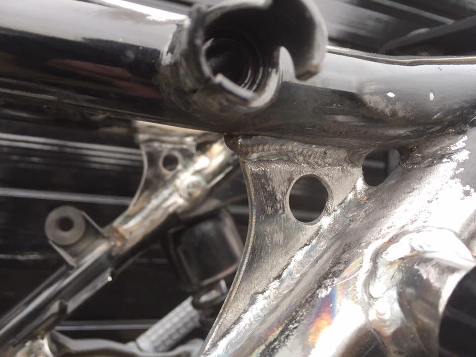

My winter 2019 build finally taking shape. Engine arrived (thanks Duane) and the frame is away being modified to take a Bandit 1200 swingarm, laid down shock mounts, bracing and rear footrest mounts. Simon will also cut off and plate the mono shock mount. The Swingarm mounts and top-shock mounts were supplied by Dave Solomon if any if you want some. Onwards and upward best get stuck into stripping the engine and see if I need to send any parts off to the genius Buzzard to fettle.

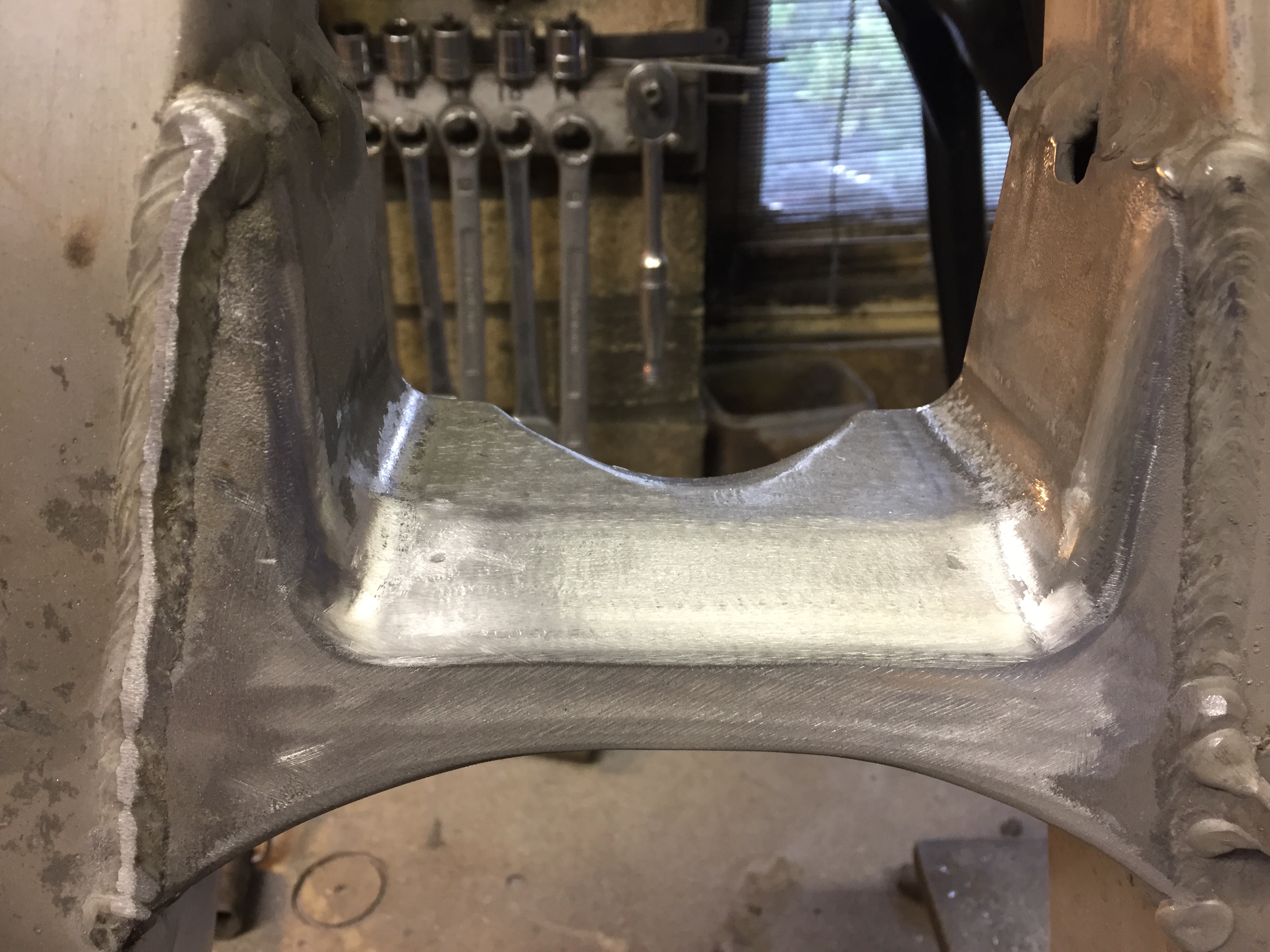

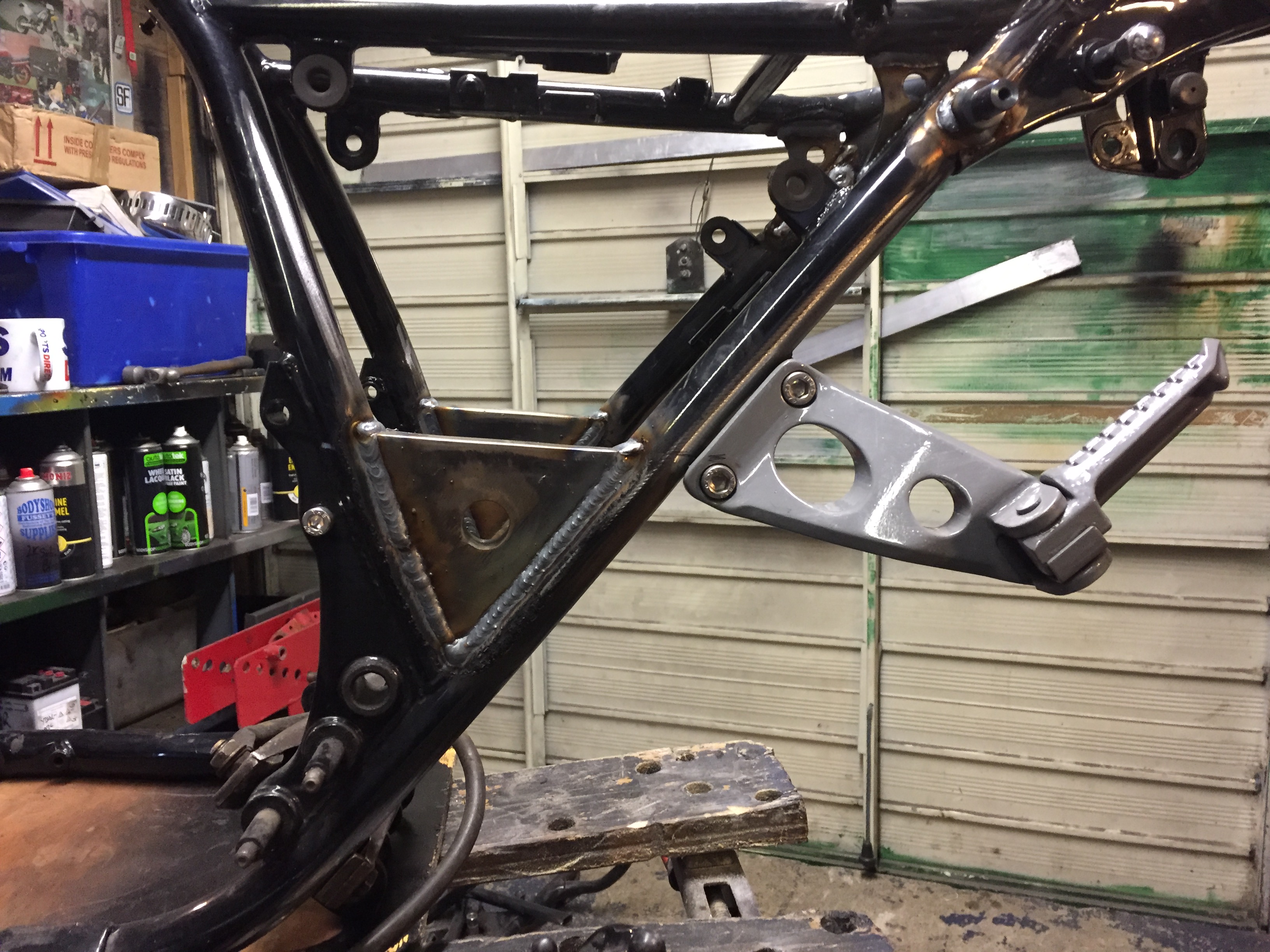

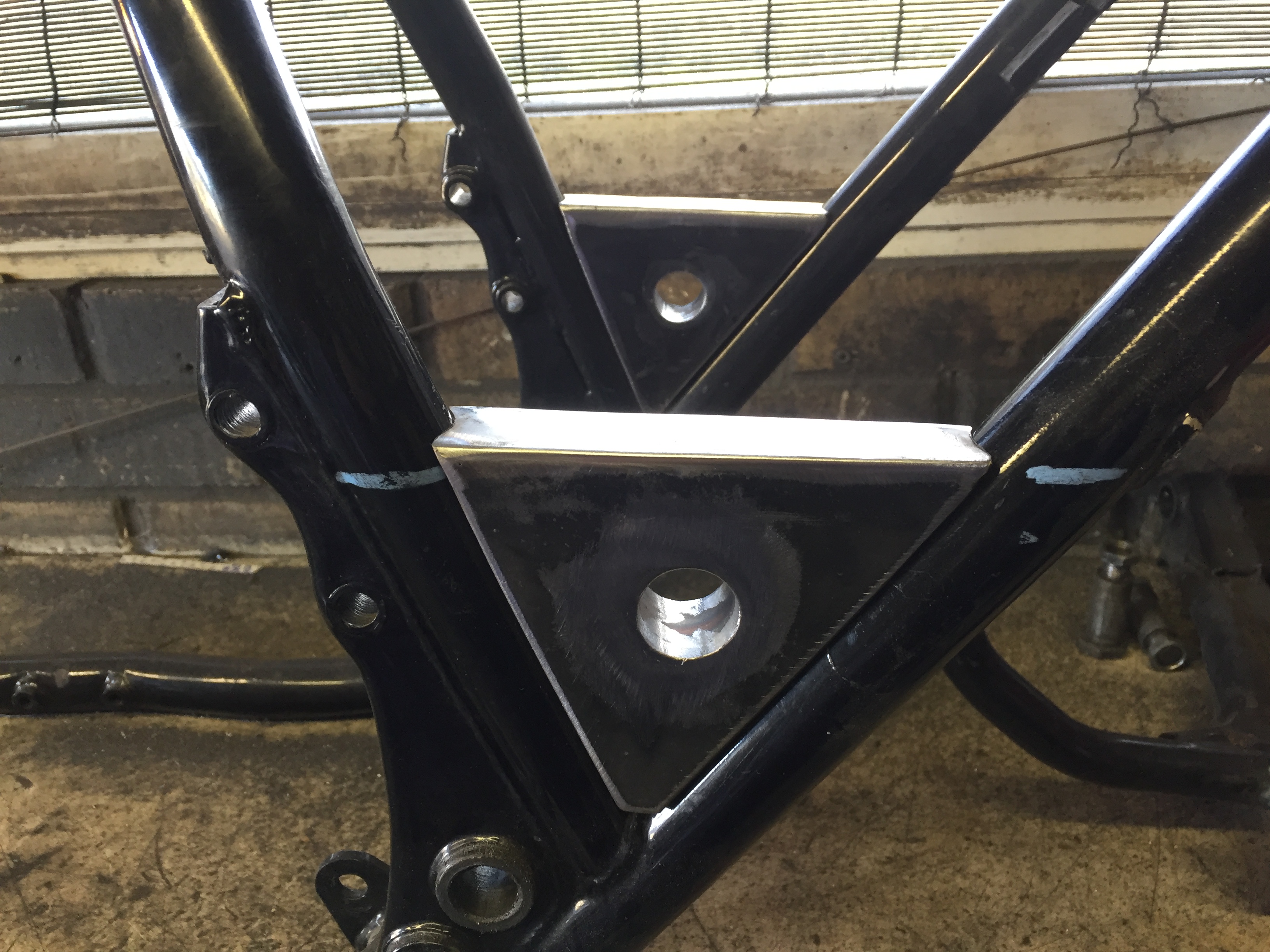

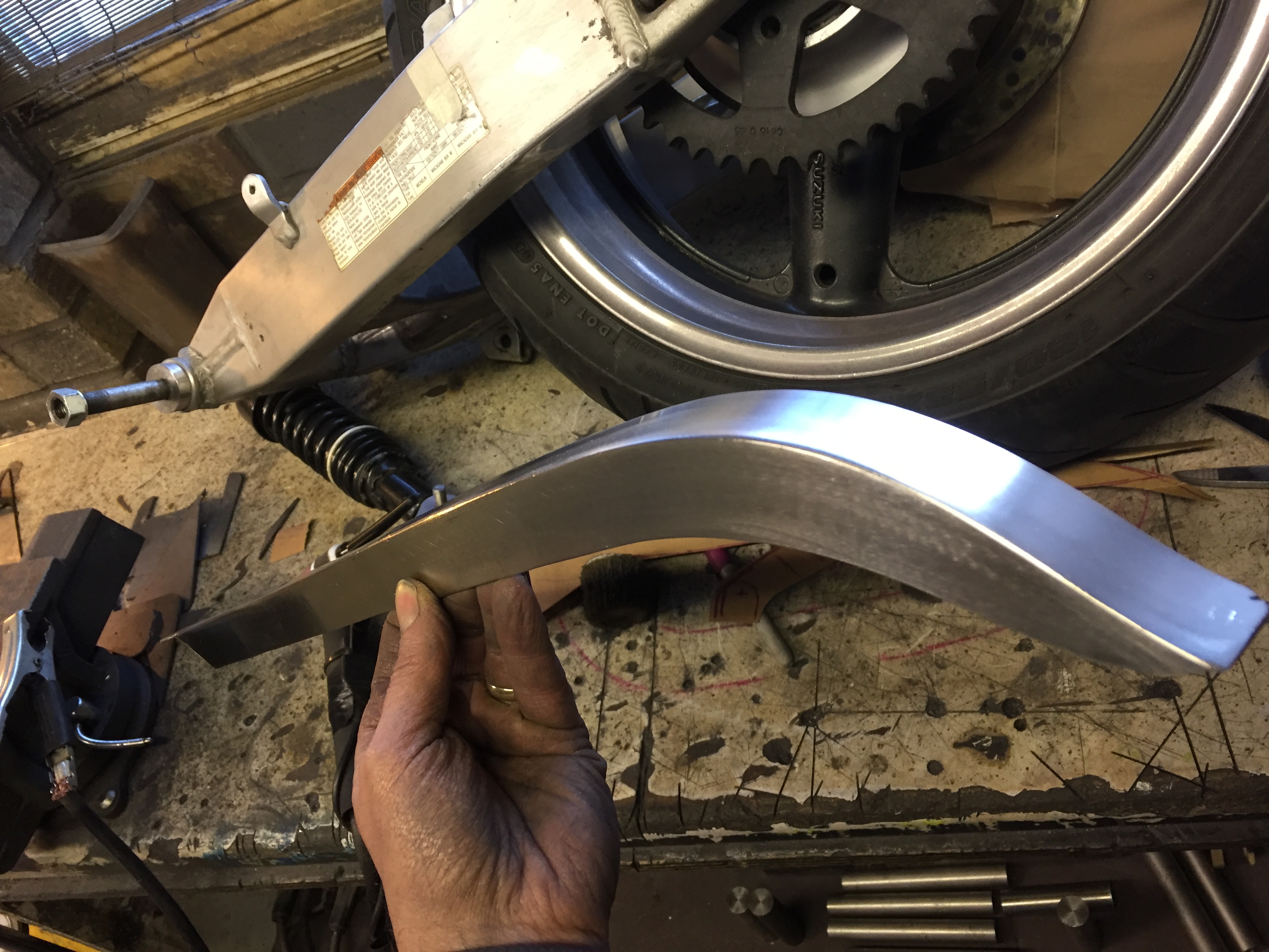

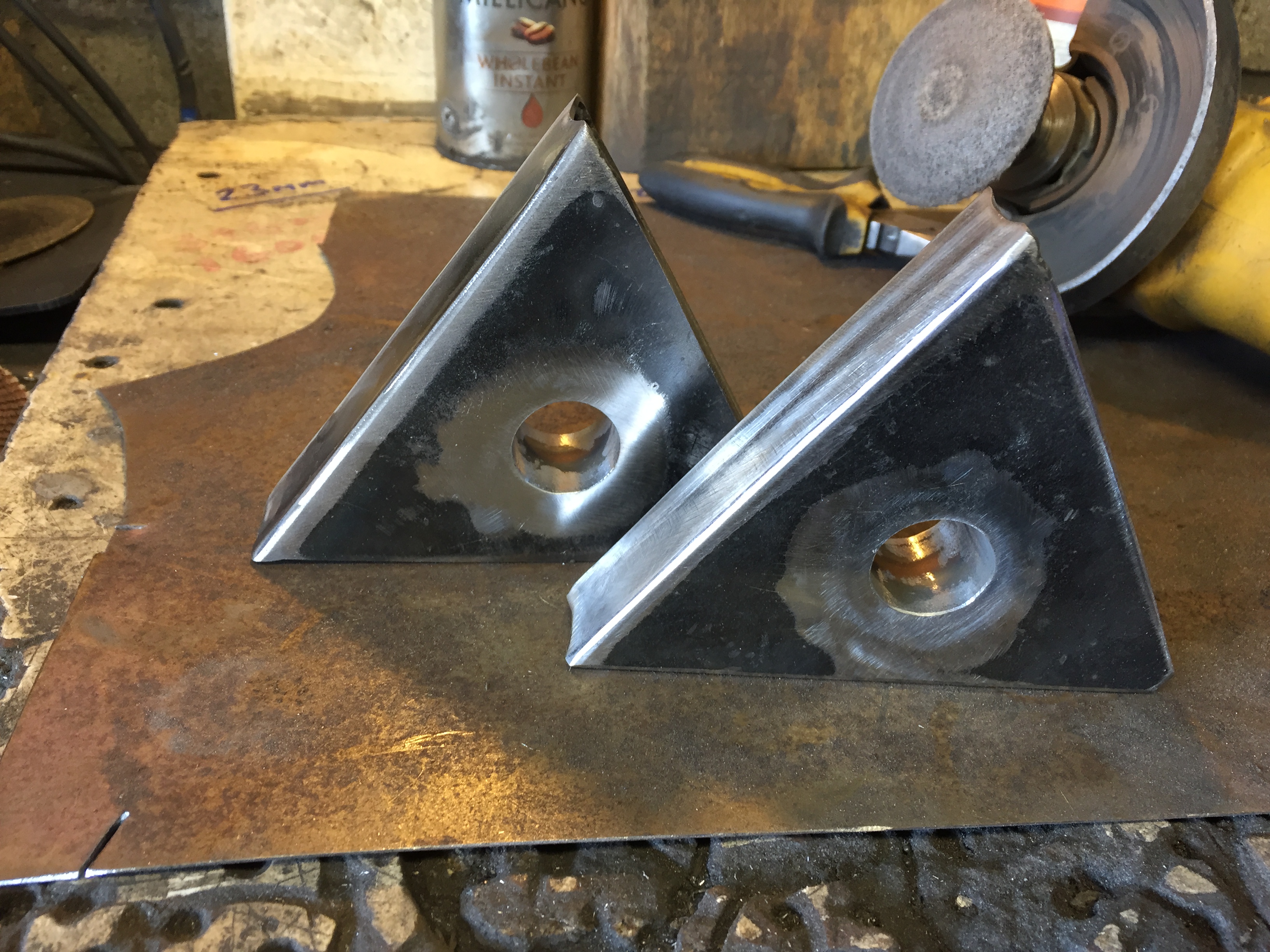

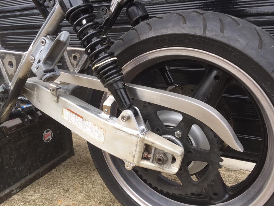

Mono shock mount taken off and plated. This always bugged me on my old Zed. Rear footrest mounts fitted and a Stainless chainguard completed.
Onwards and upwards

which bike did you get the rear foot rests from Ian?
Padders
Posts: 3046
Joined: 15th Jan 2006
Re: Z1A streetfighter build 2019
#7 PostAuthor: Padders » Fri Feb 01, 2019 12:51 pm
Zrx1100

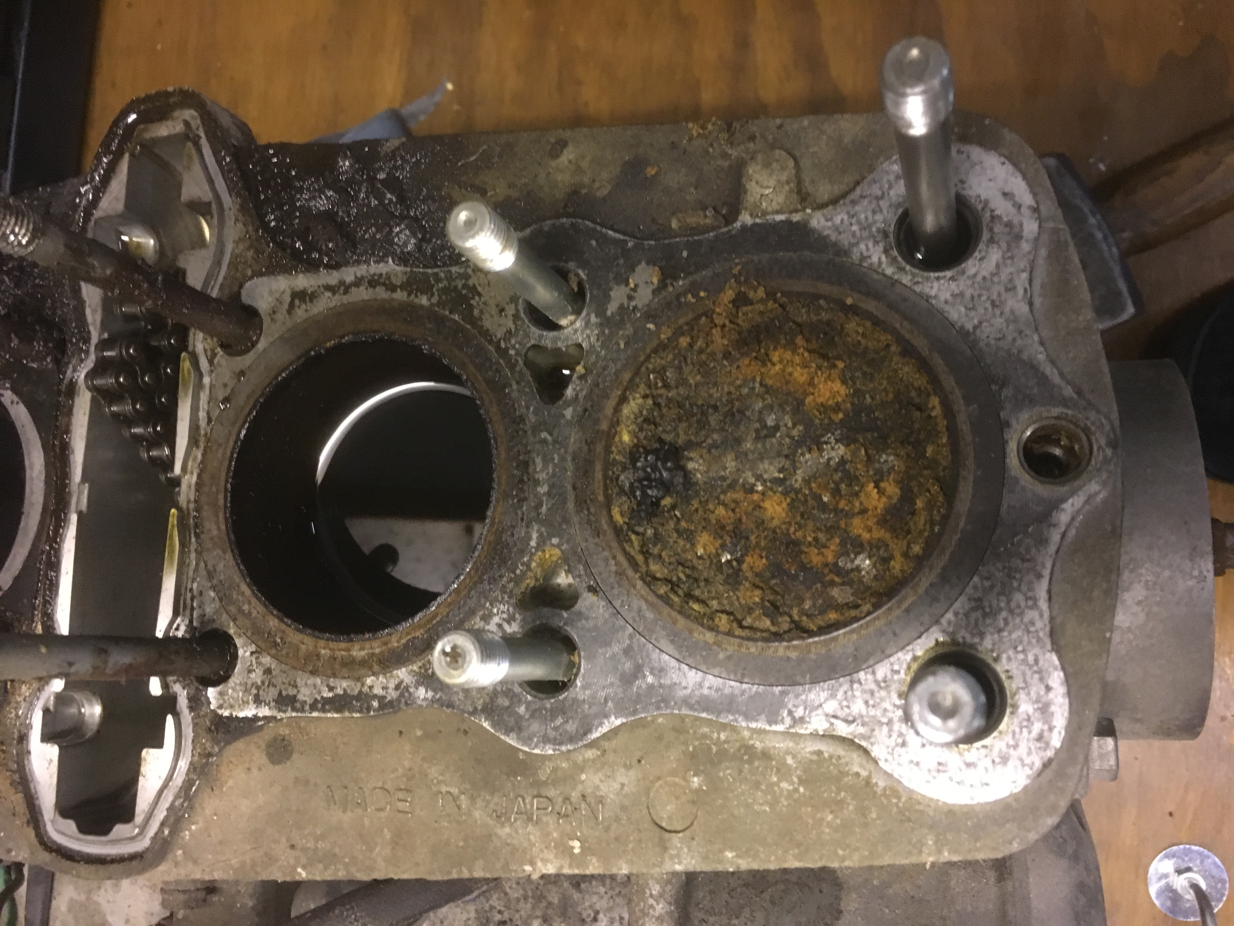

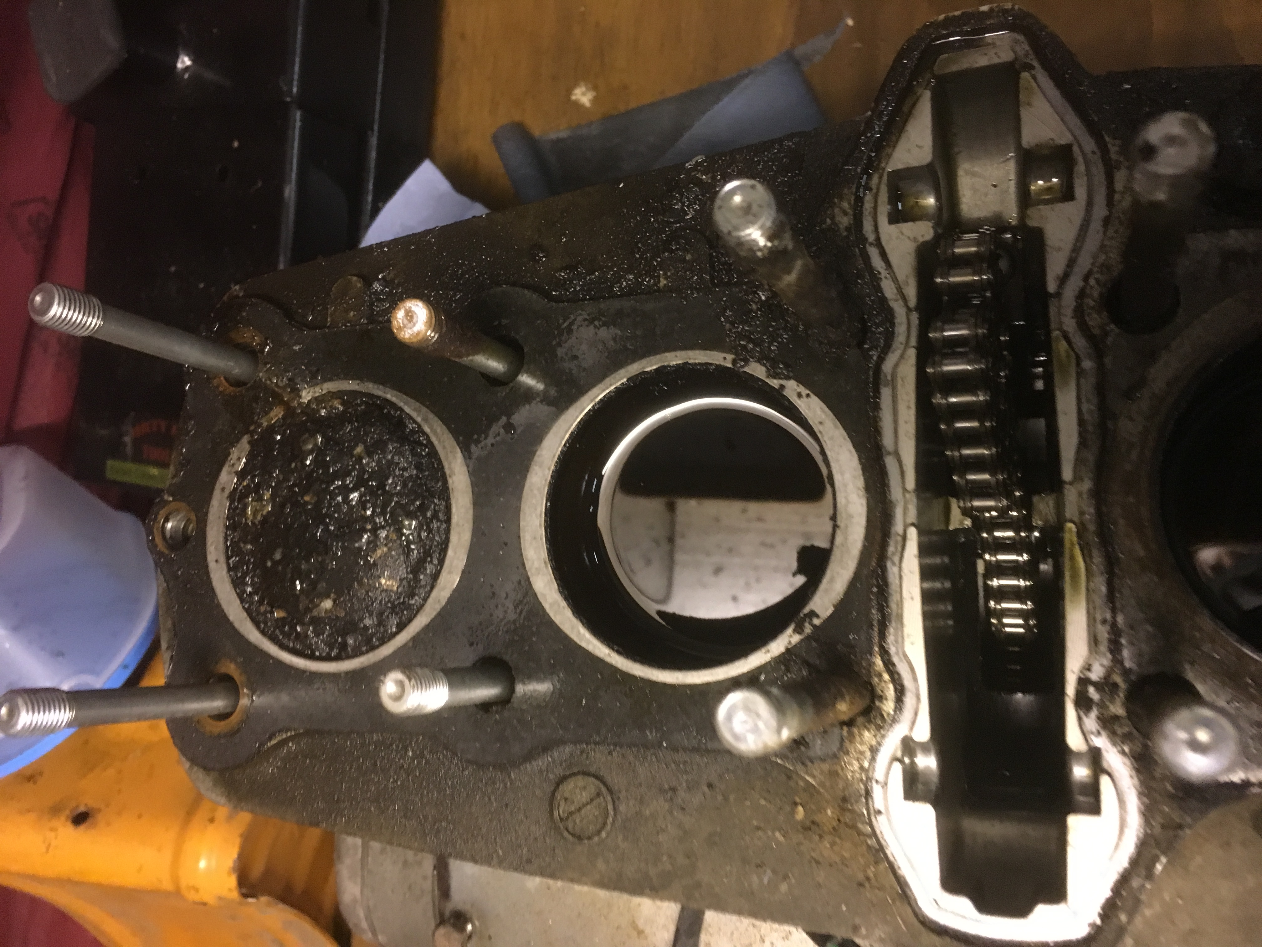

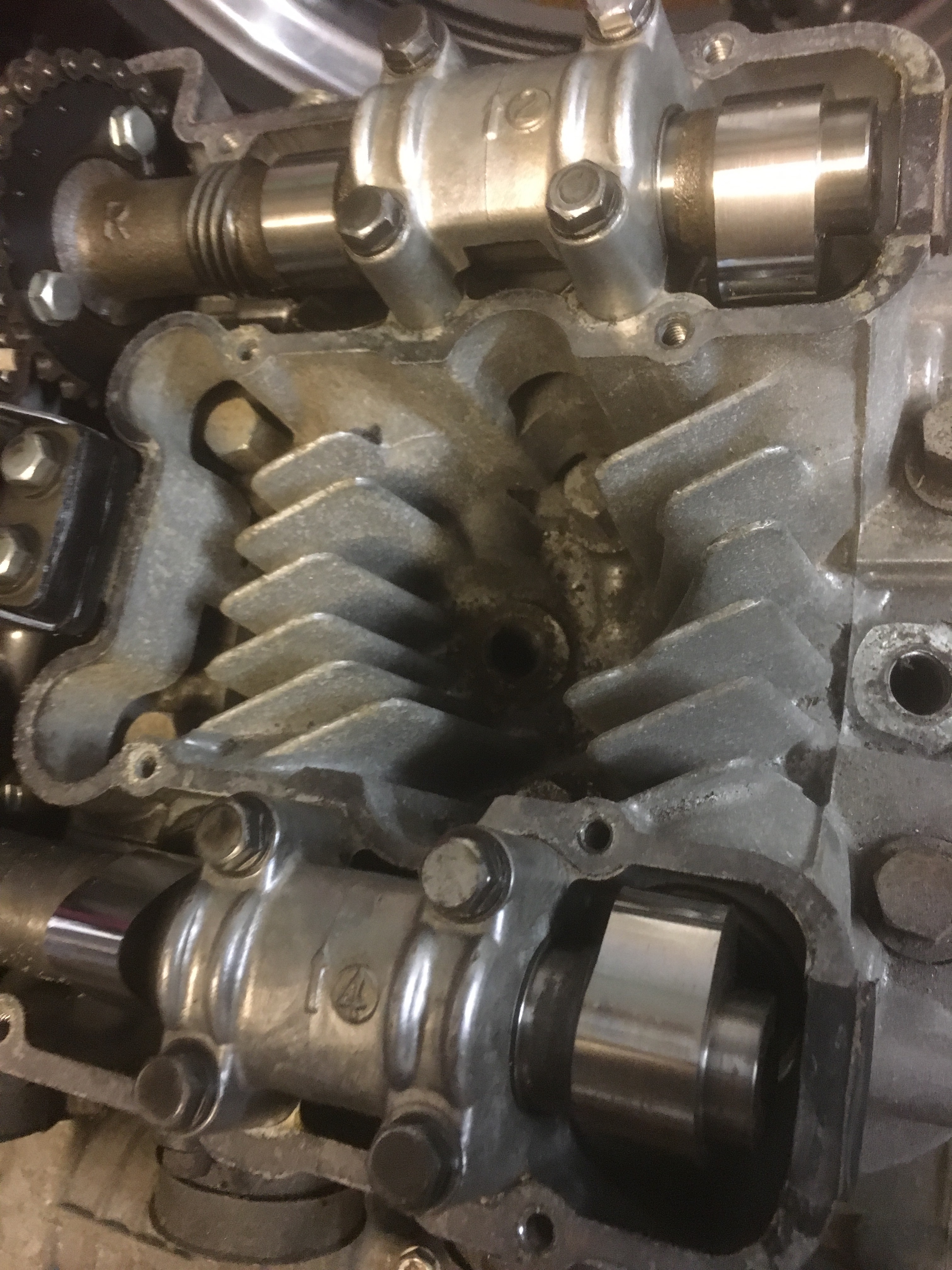

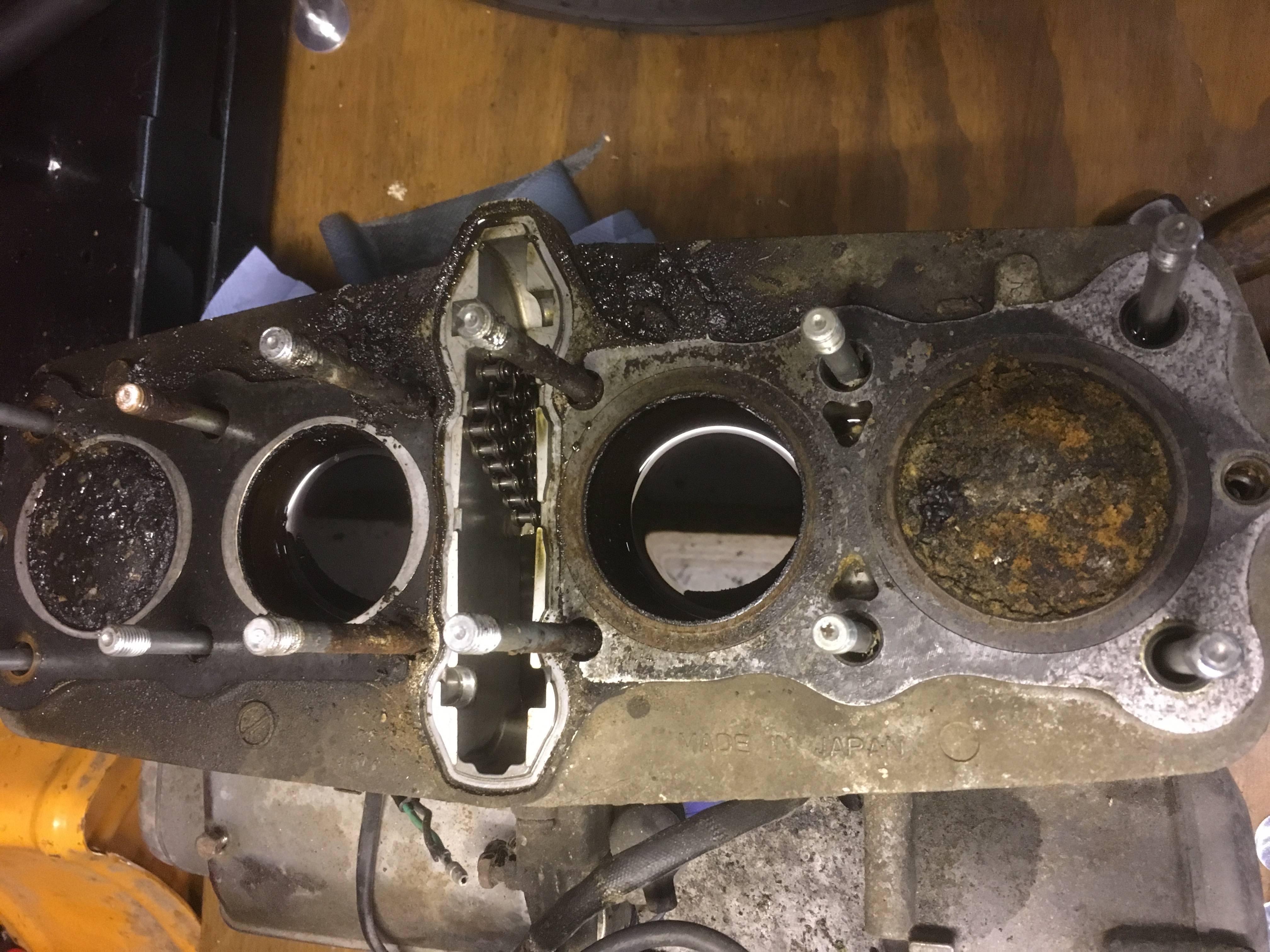

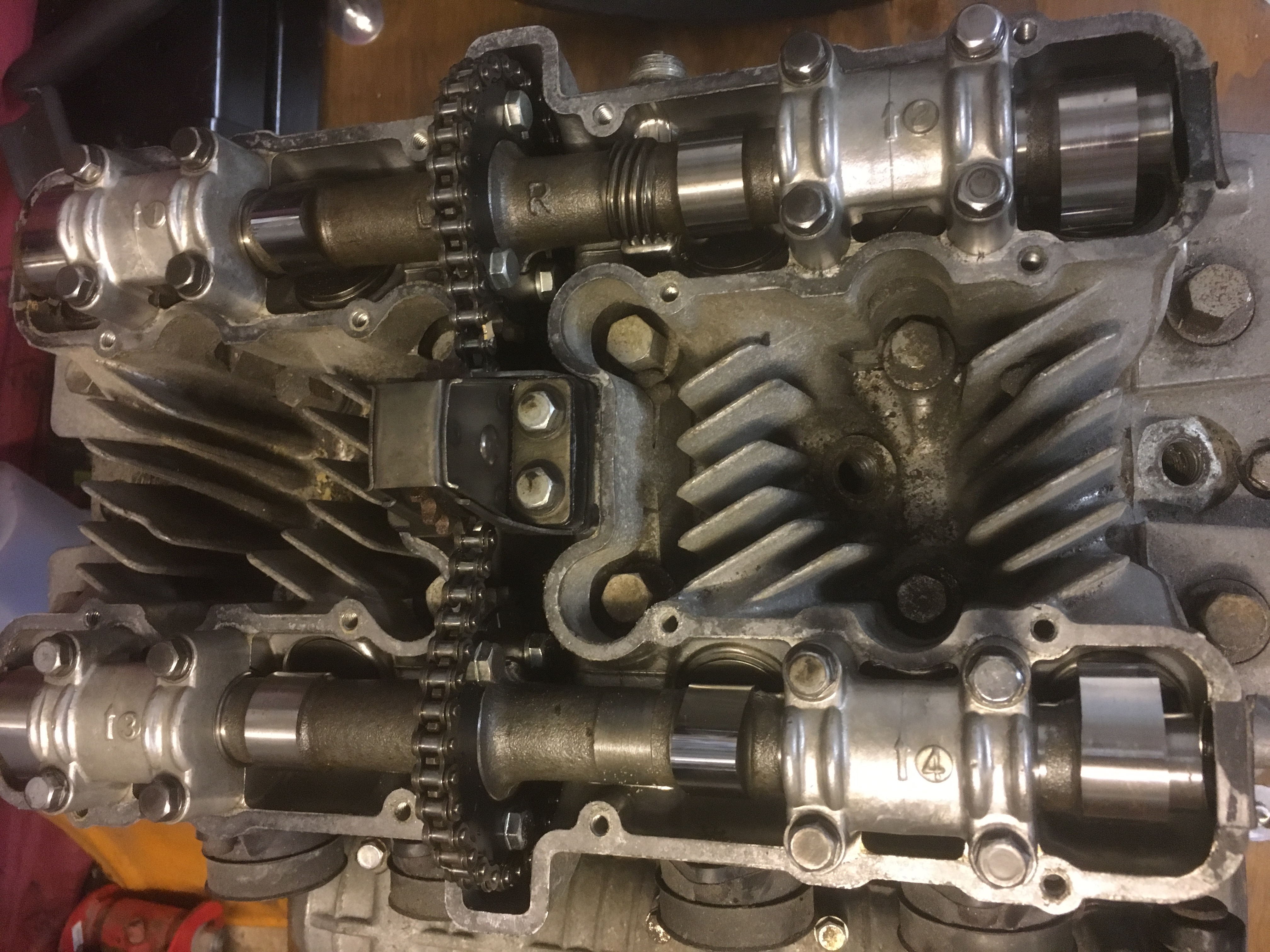

Head off in vgc but the reason for the seized engine is clear now.
Will continue the strip bottom up then leave for a couple of weeks to soak
PUM 13

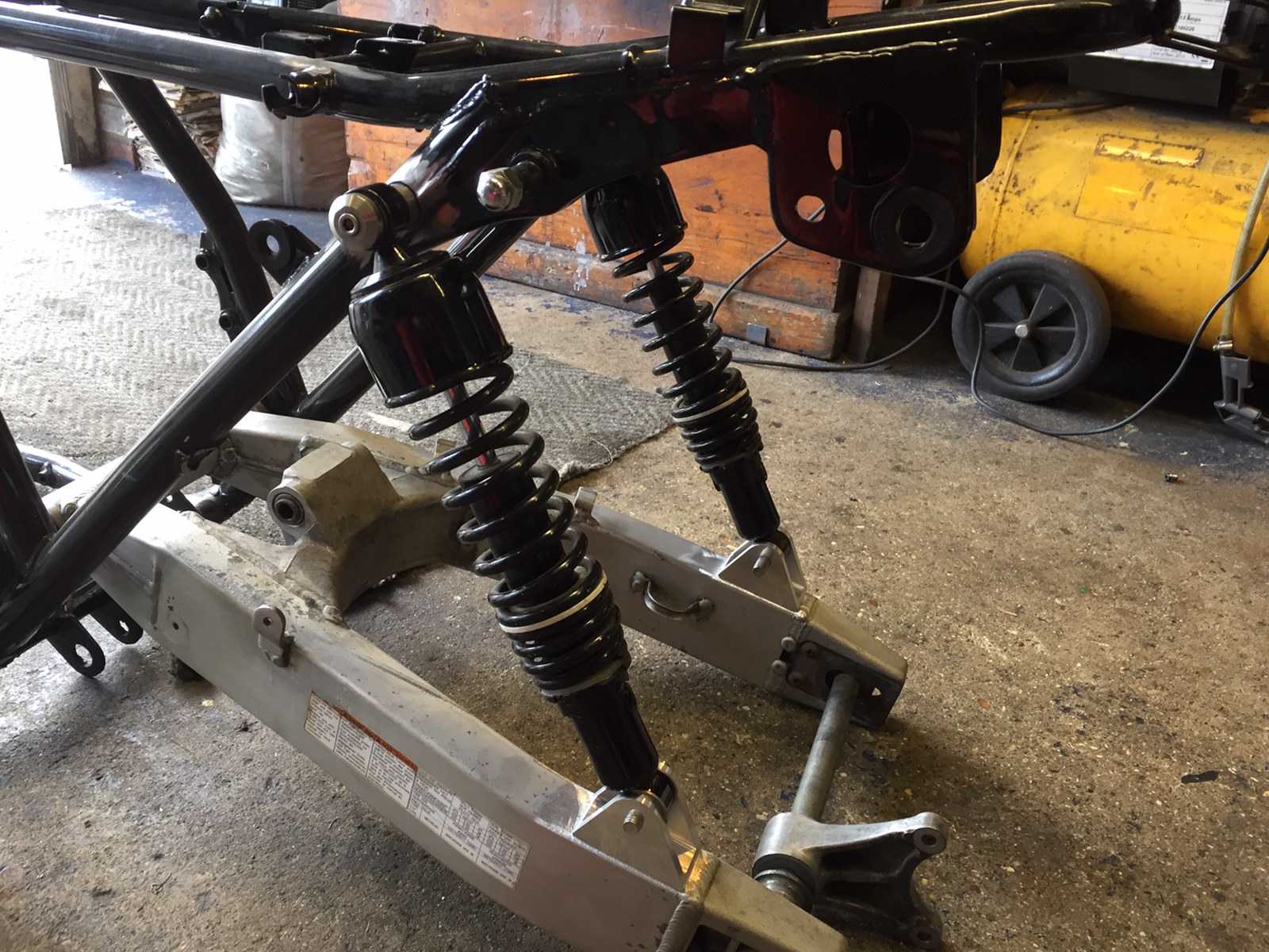

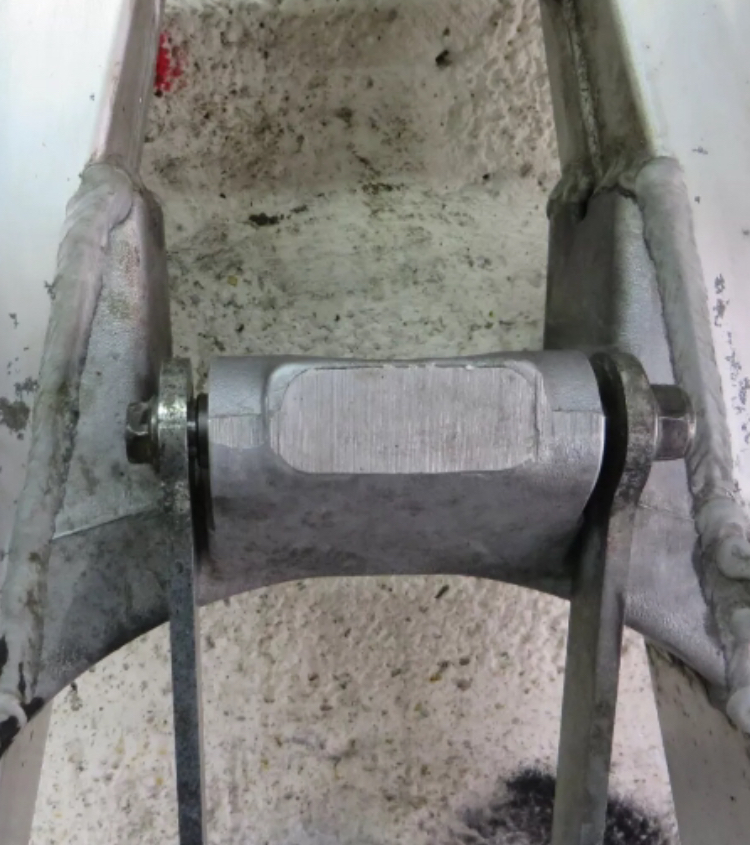

#13 PostAuthor: Padders » Tue Feb 05, 2019 11:22 pm

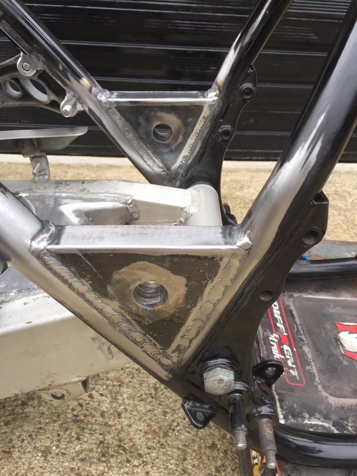

Frame modifications now complete time for powdercoat.

Looking tasty so far and I like the repositioning of the rear shock top mounts - when done, I think it makes 'moded' bikes look far better
