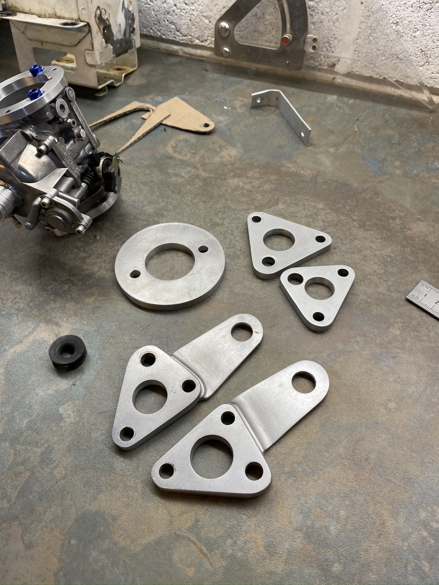

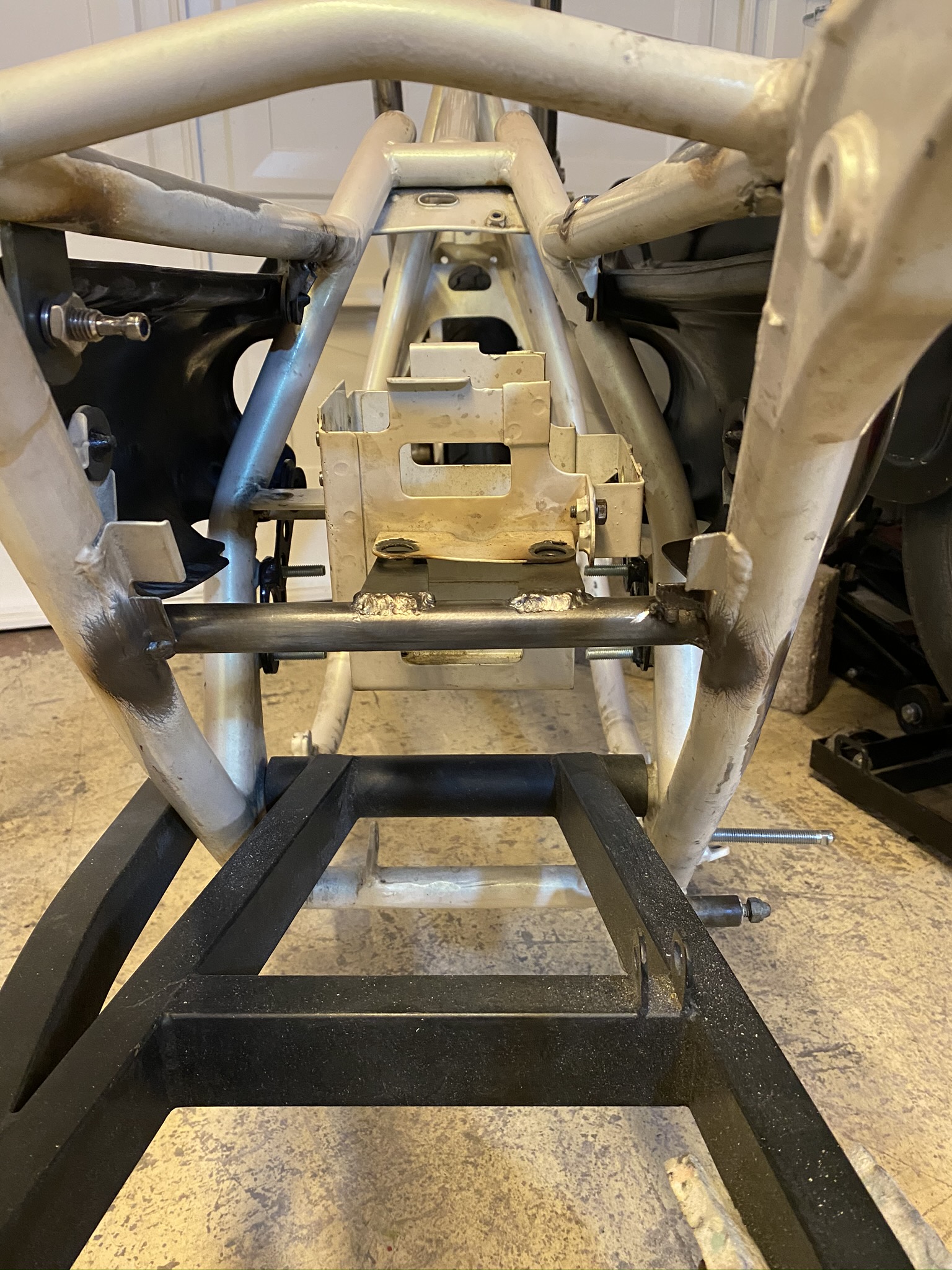

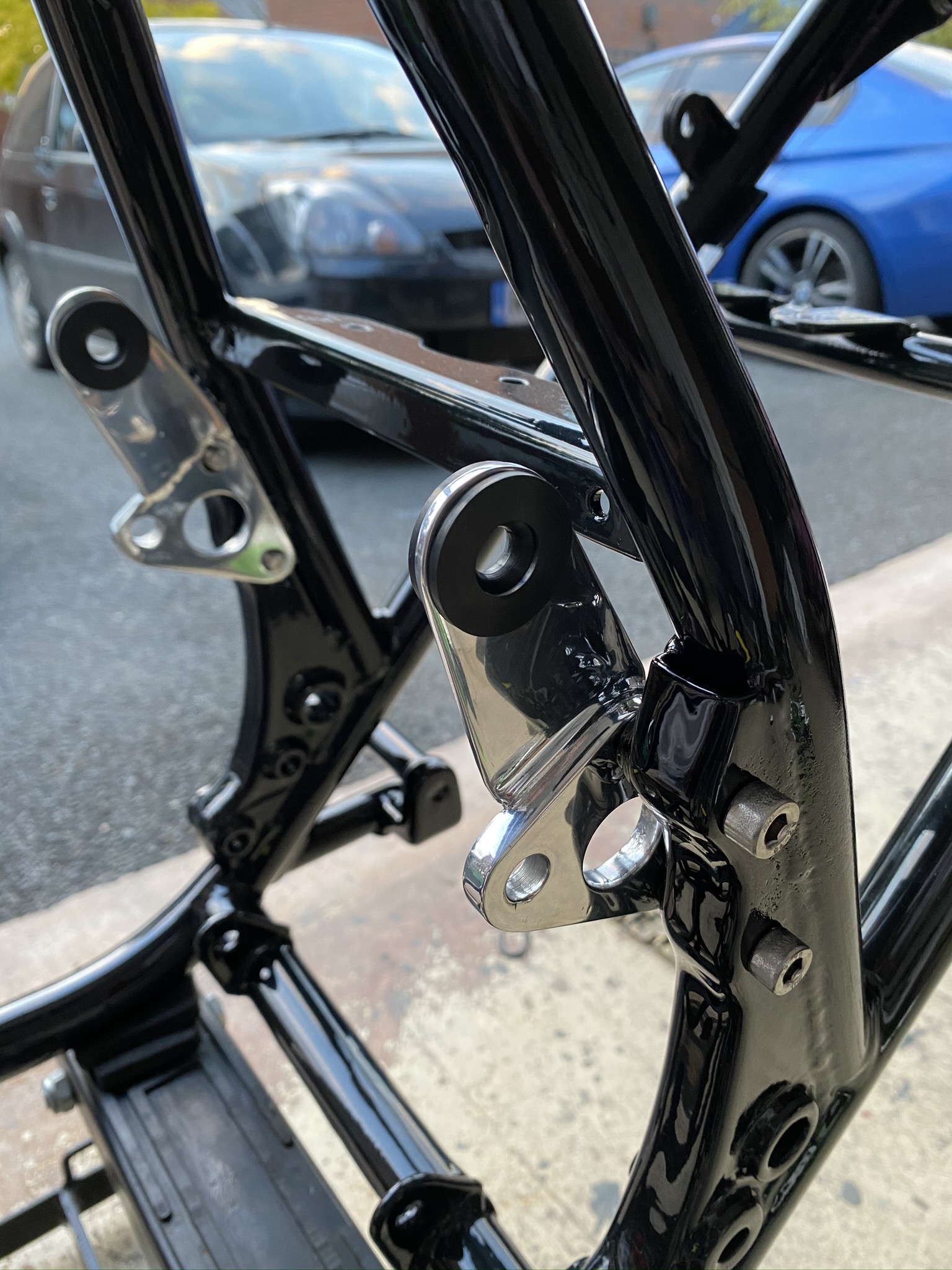

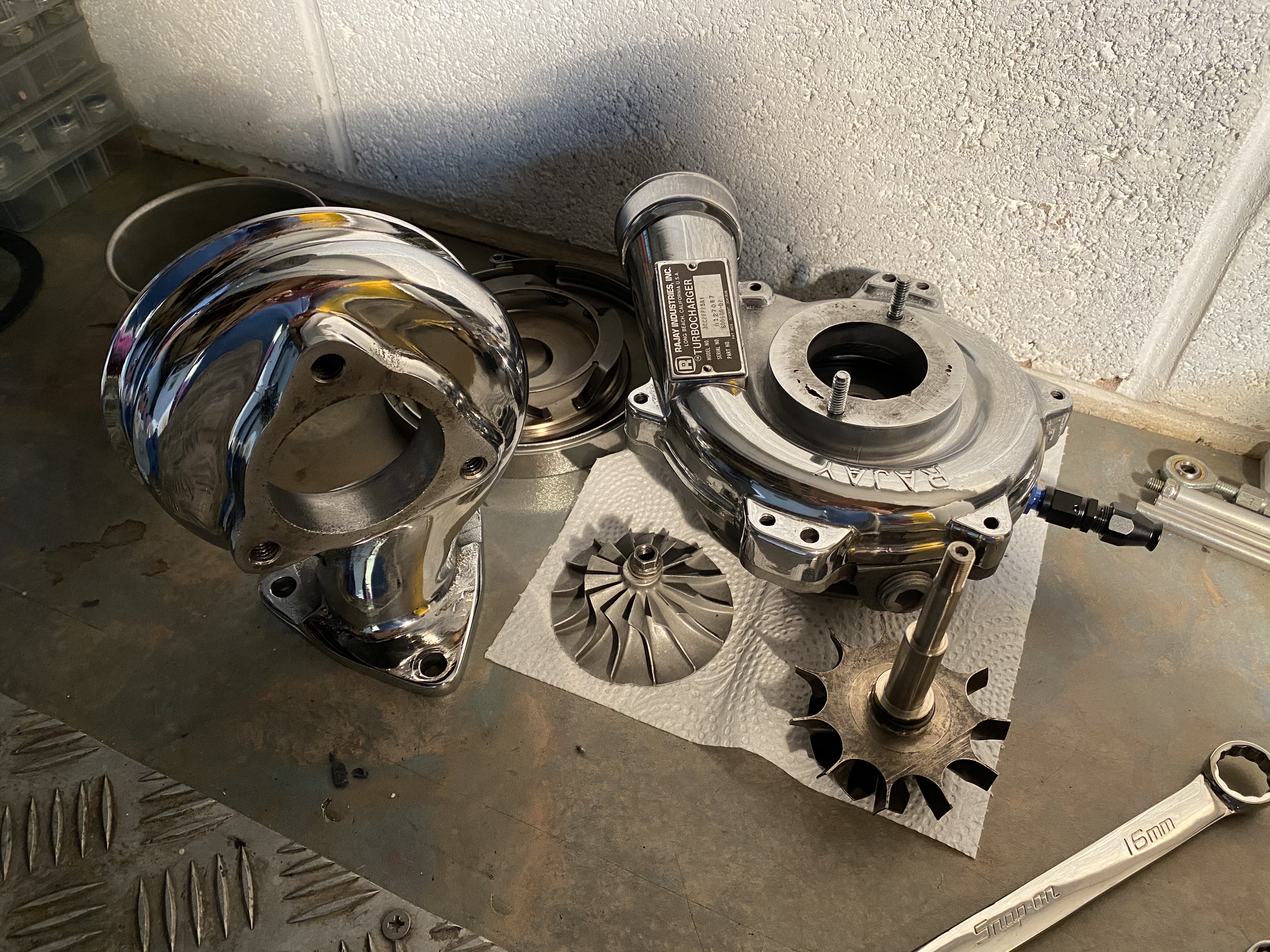

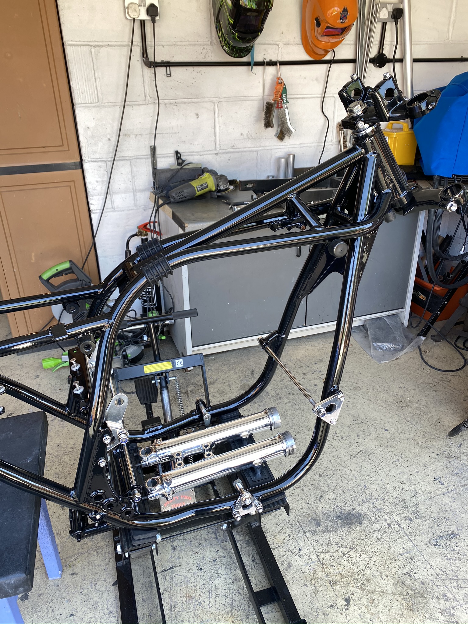

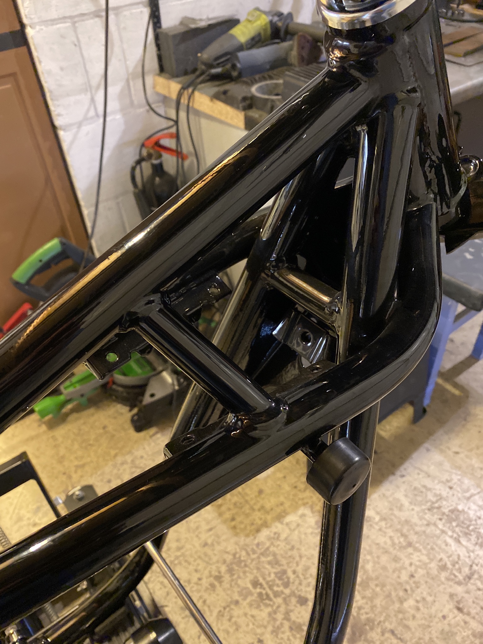

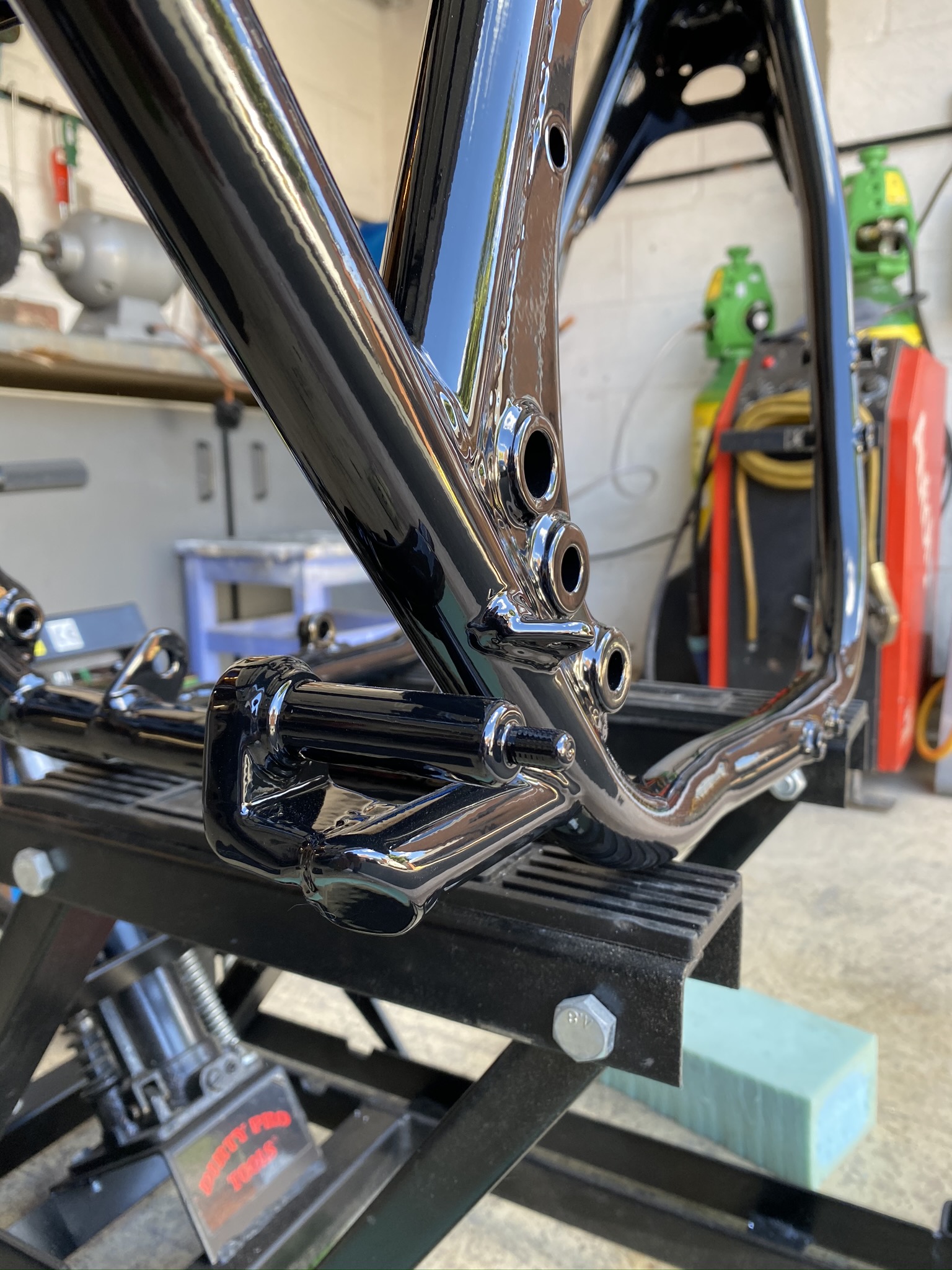

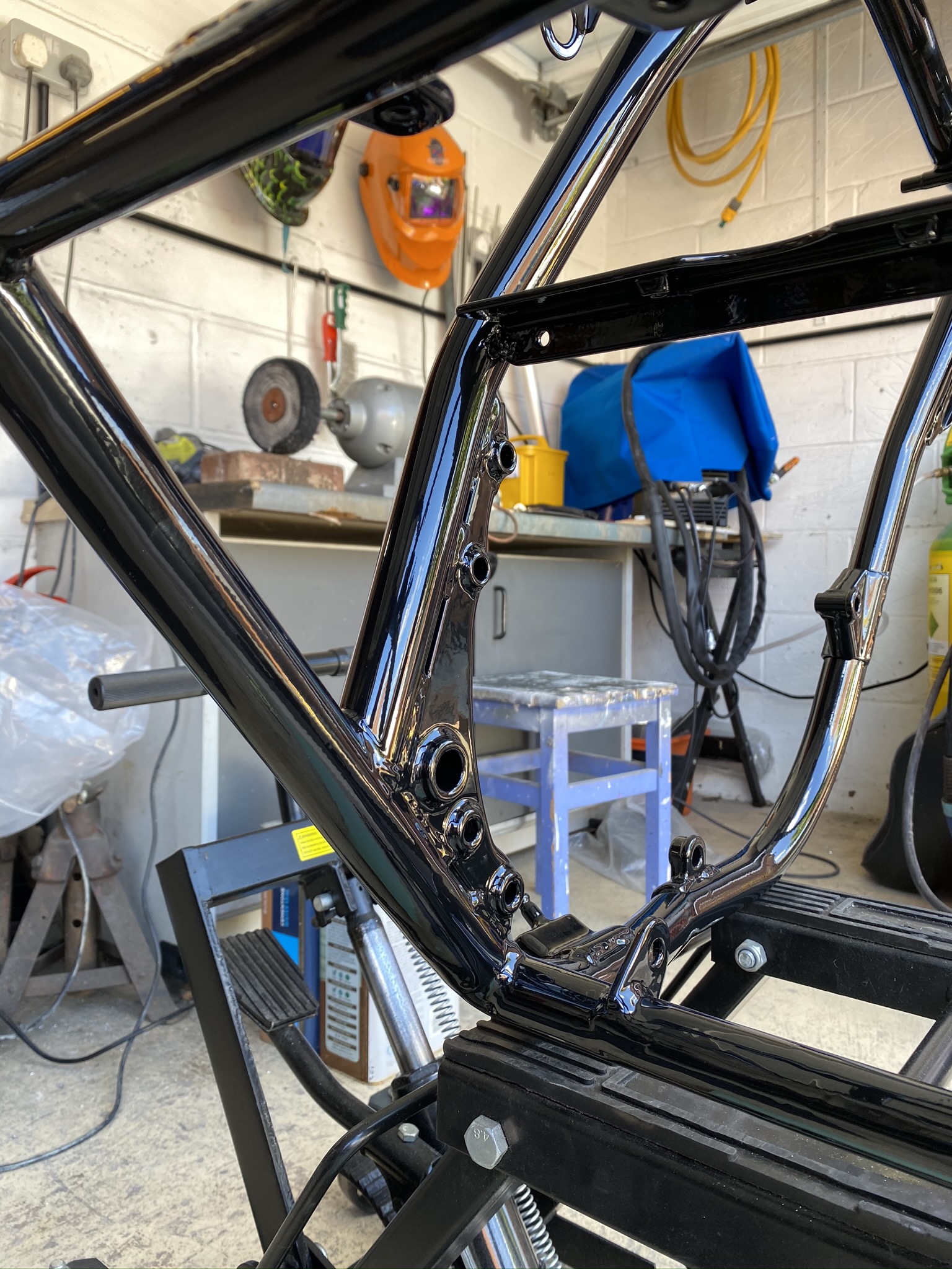

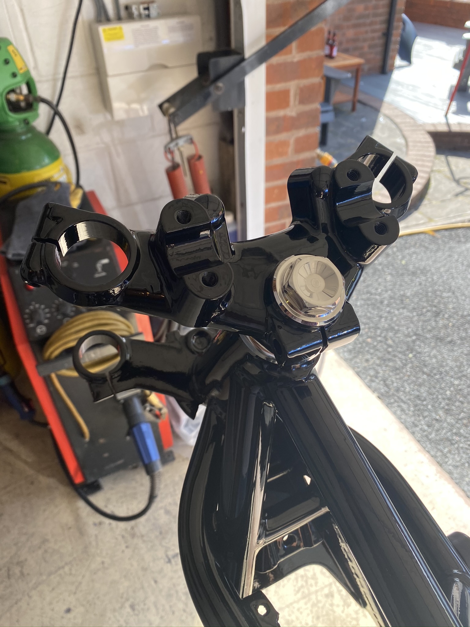

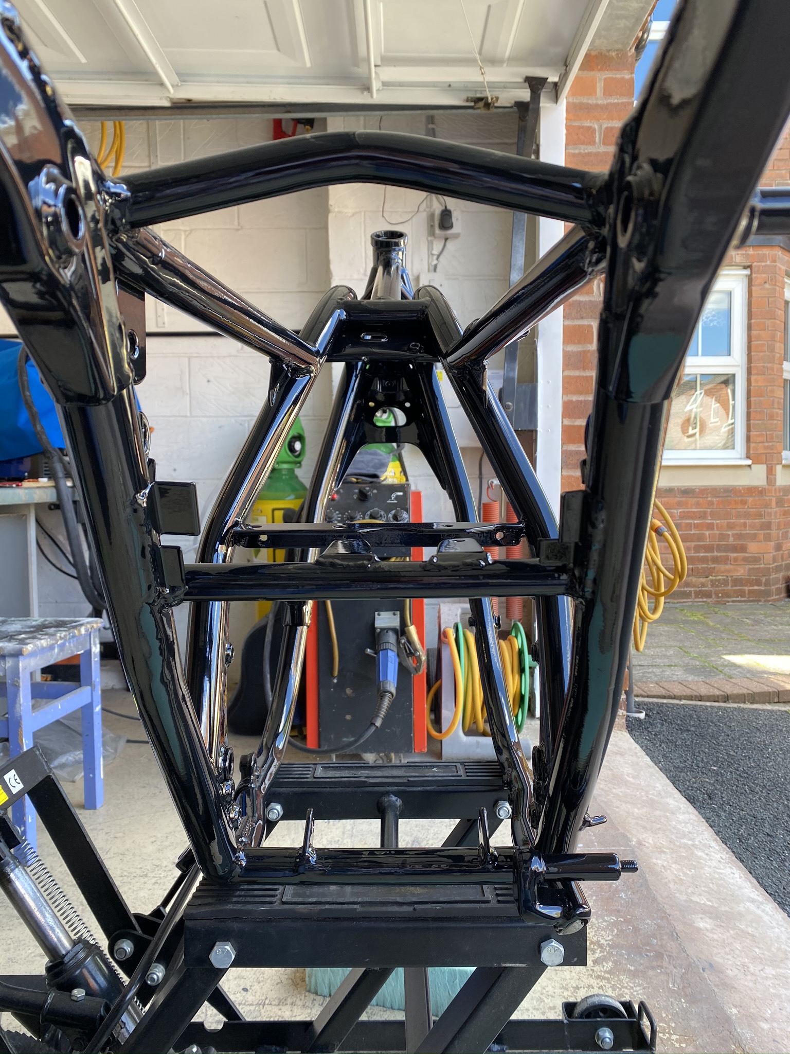

Always wanted to build a Z1 turbo and at last got the opportunity.

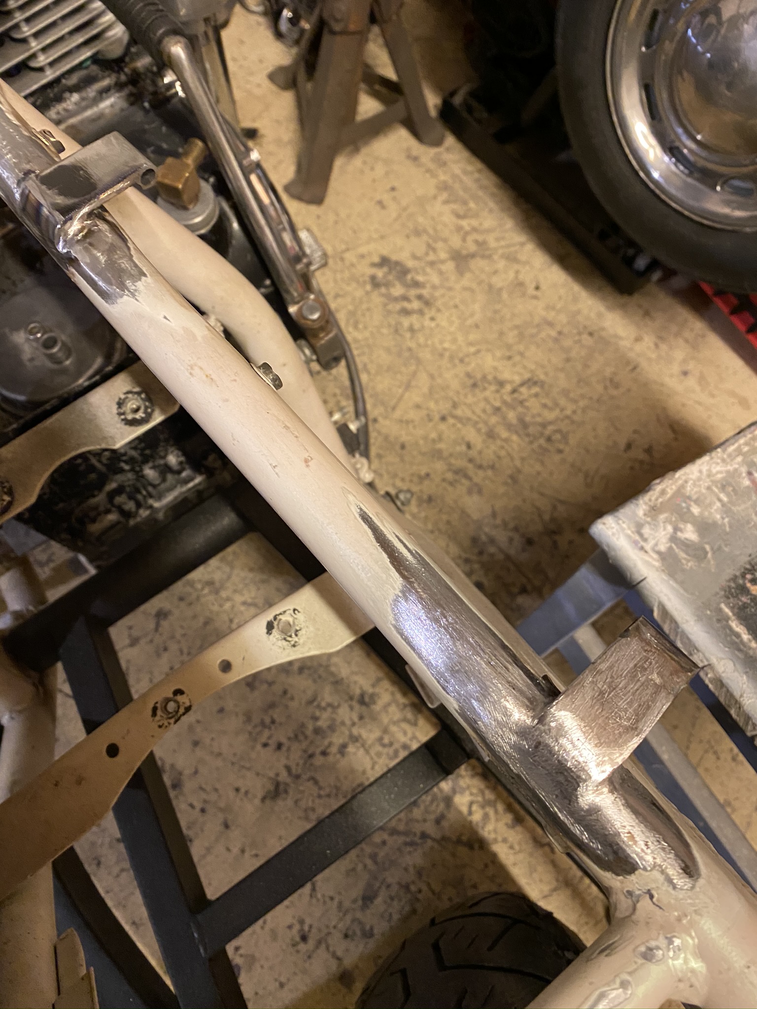

As an ex drag bike first thing was to sort the frame and put back on a lot of the missing brackets and tabs
As I’m intending on running a ridiculously short exhaust I’ve not added back the exhaust hangers
Project is moving along quite nicely partly thanks to the COVID lockdown and working at home (every cloud and all that) and enjoying trying to locate some period race/ tuning parts
Lots done but still lots to do!

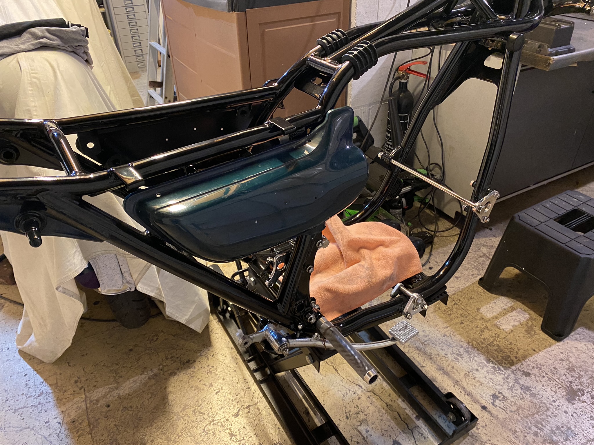

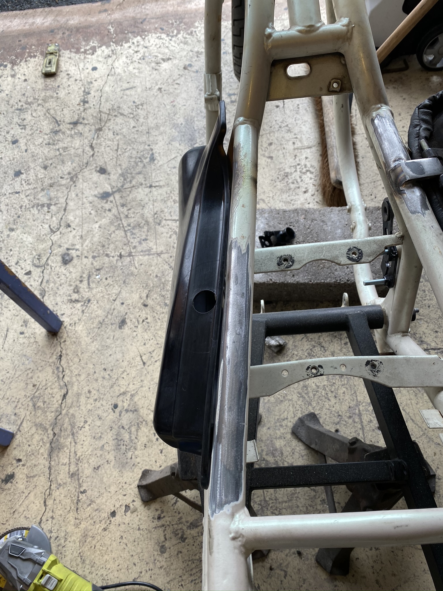

Some of the work so far

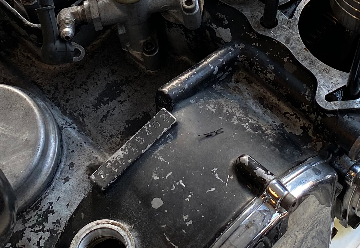

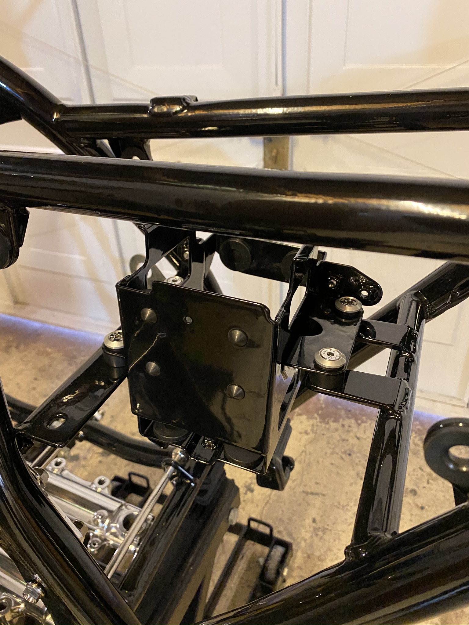

More pics to follow

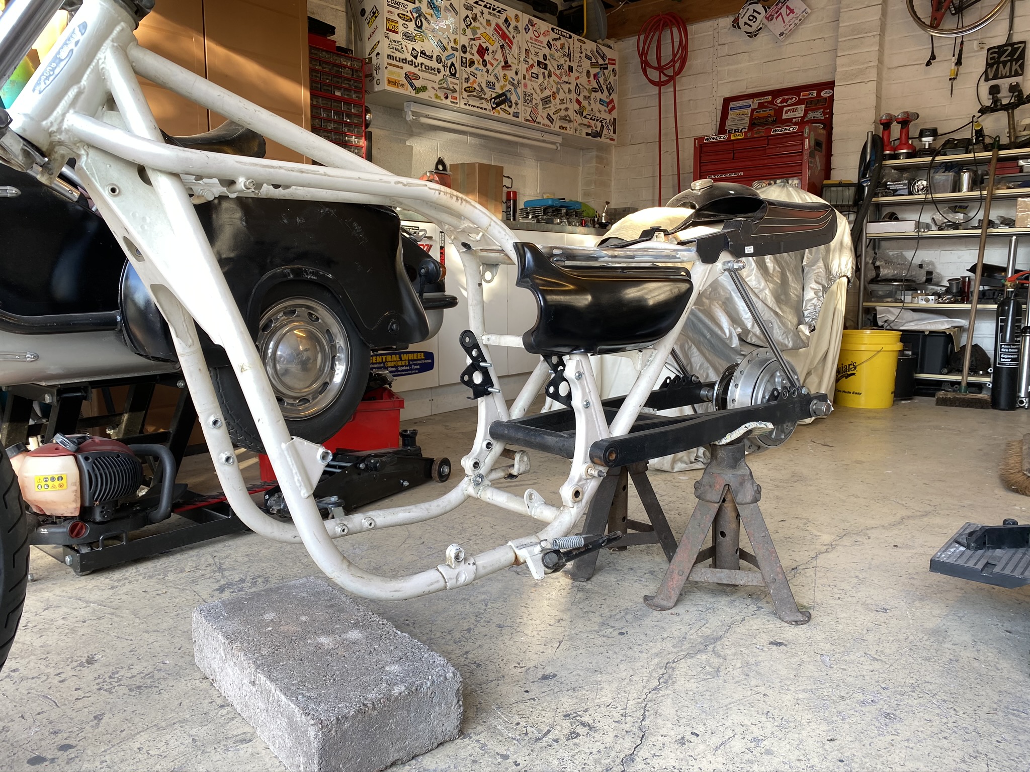

#4 PostAuthor: thebuelligan » Wed Jul 22, 2020 11:14 pm
Where the frames at

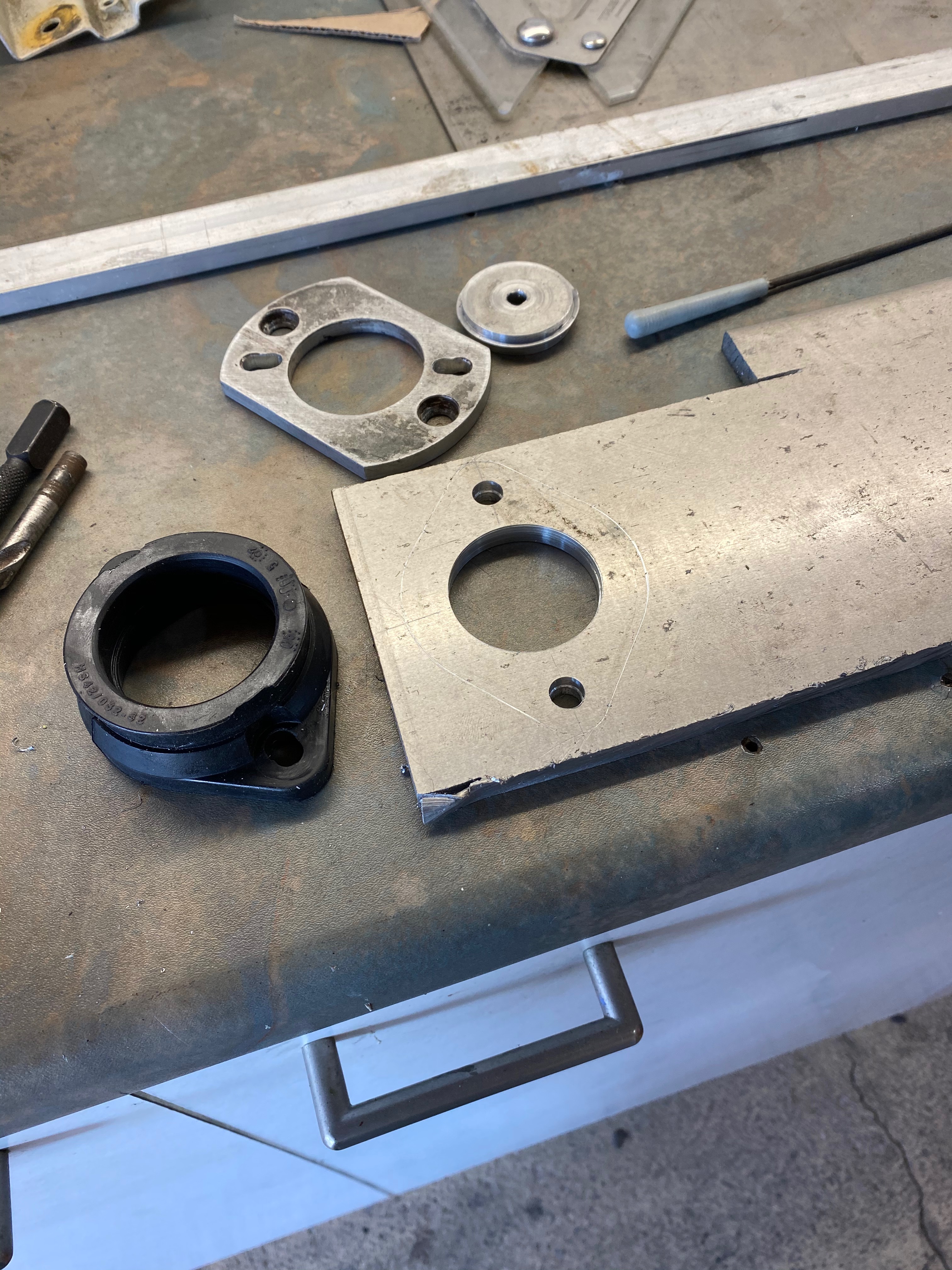

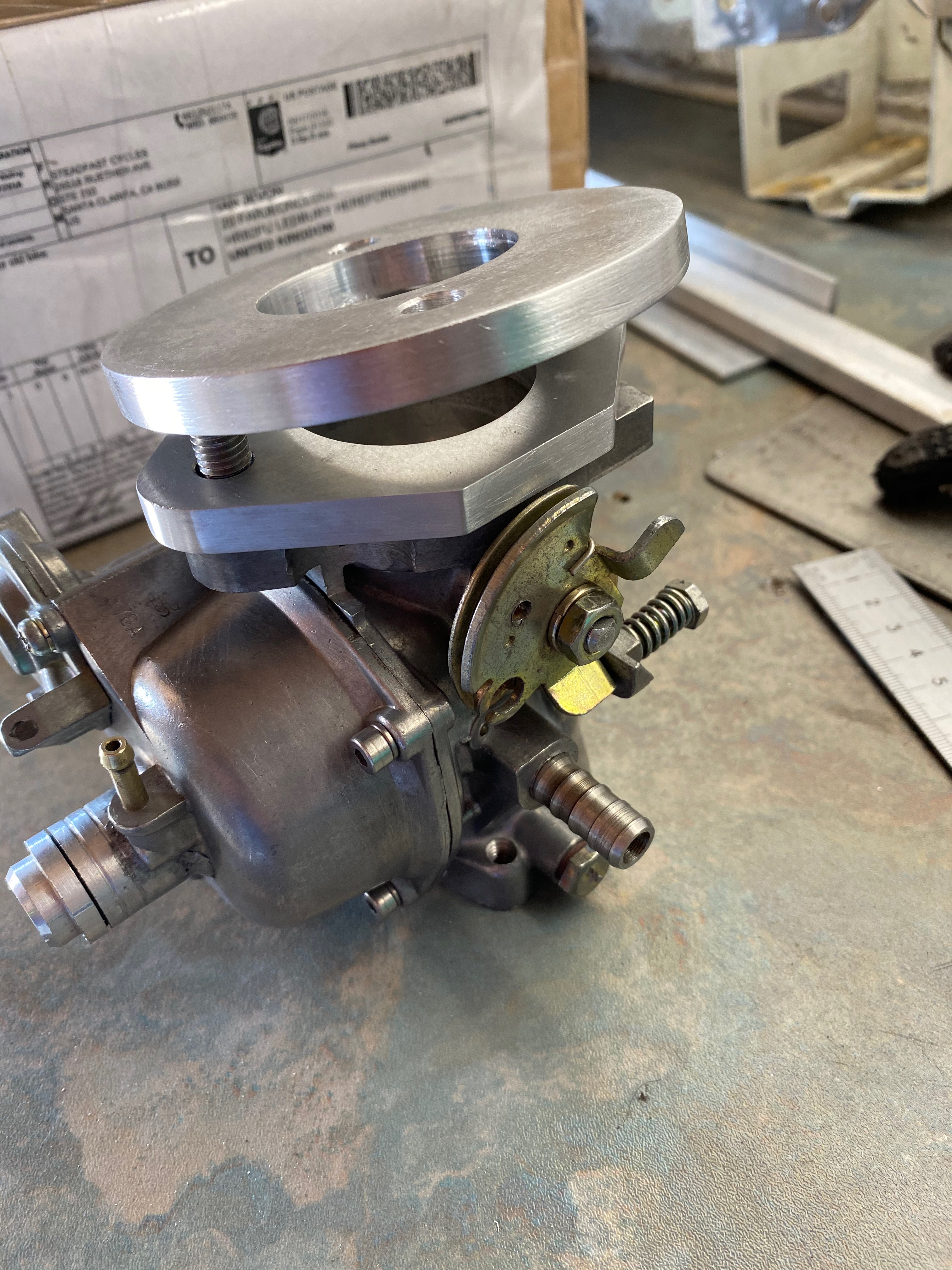

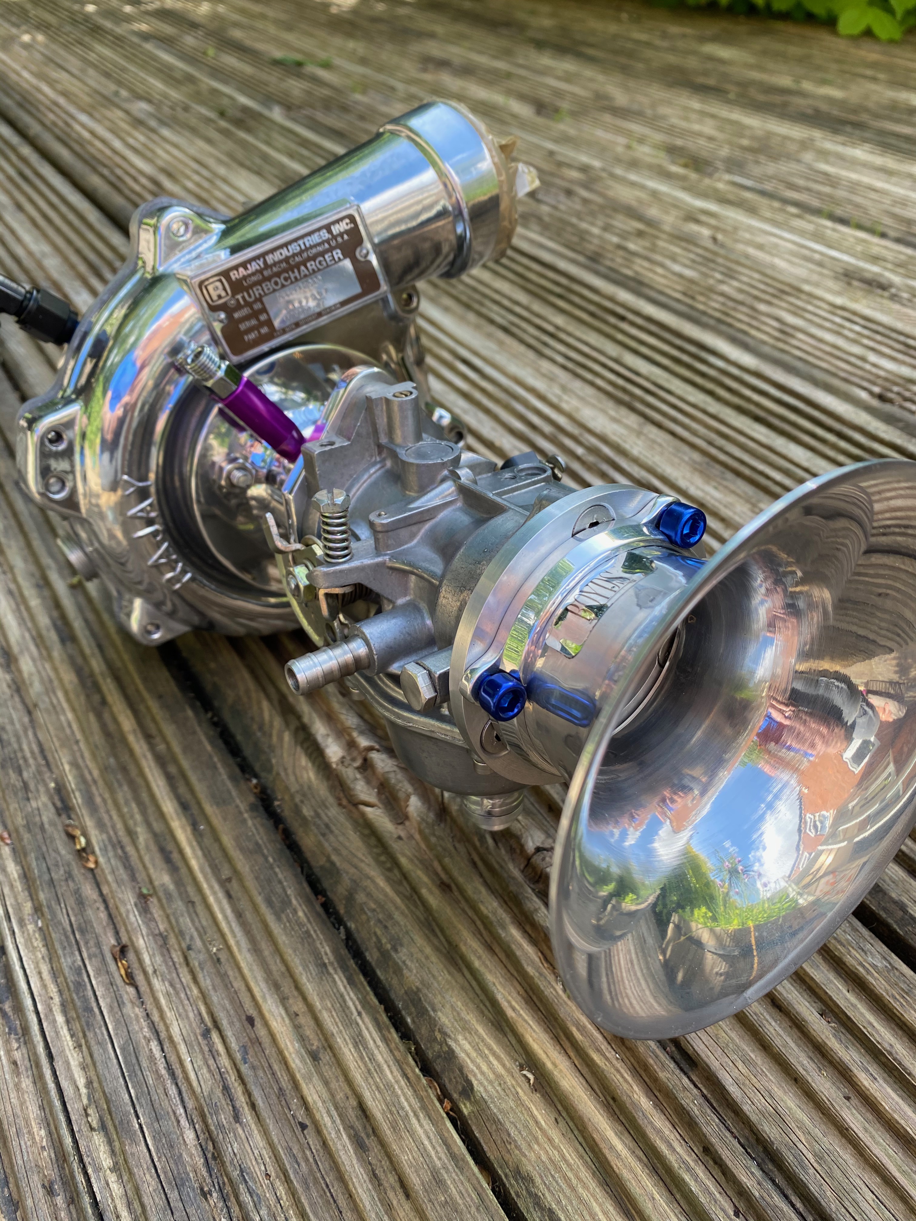

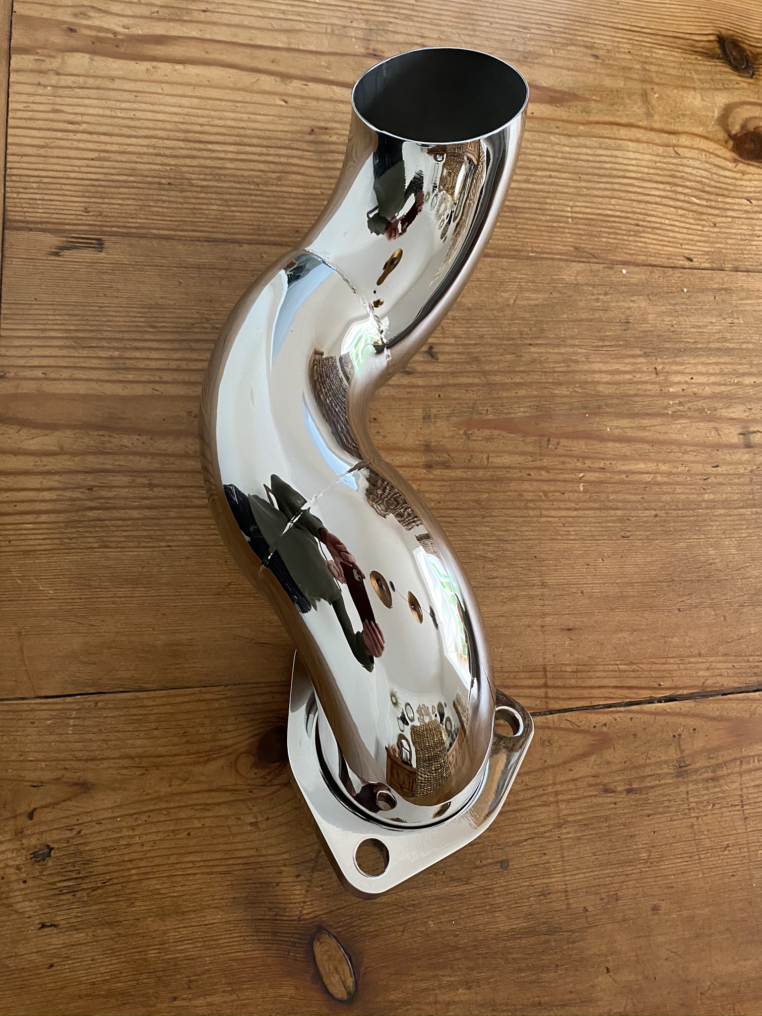

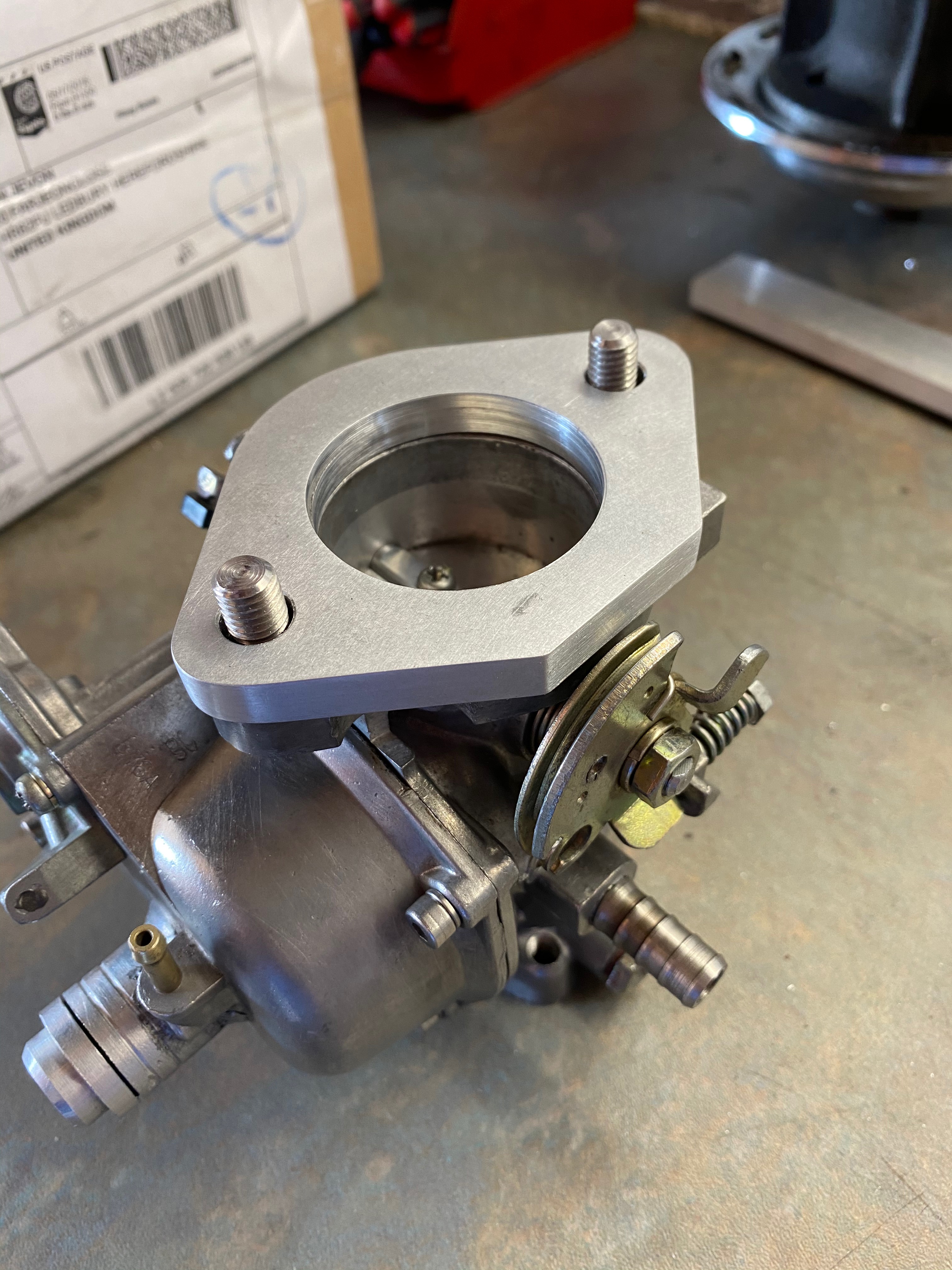

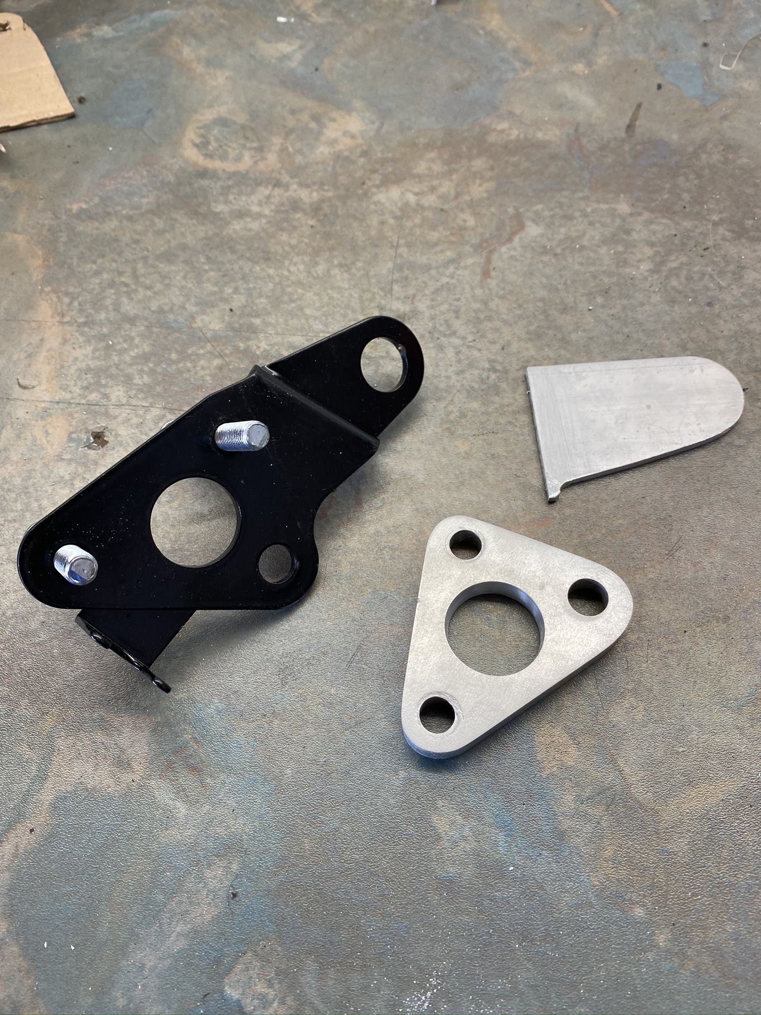

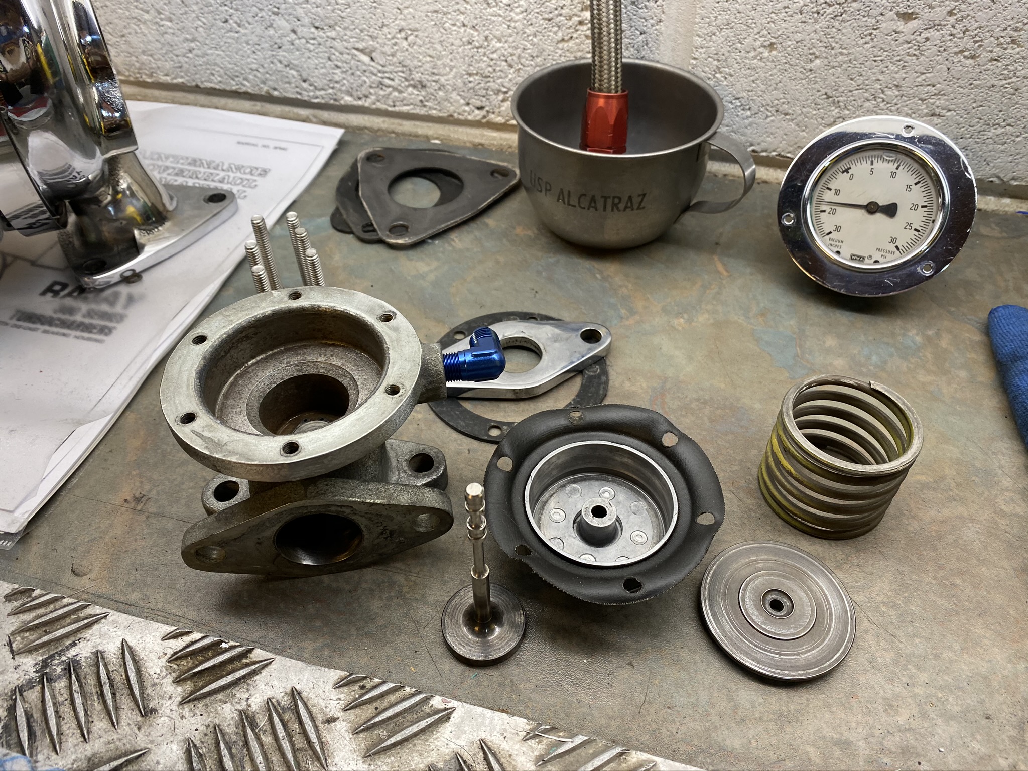

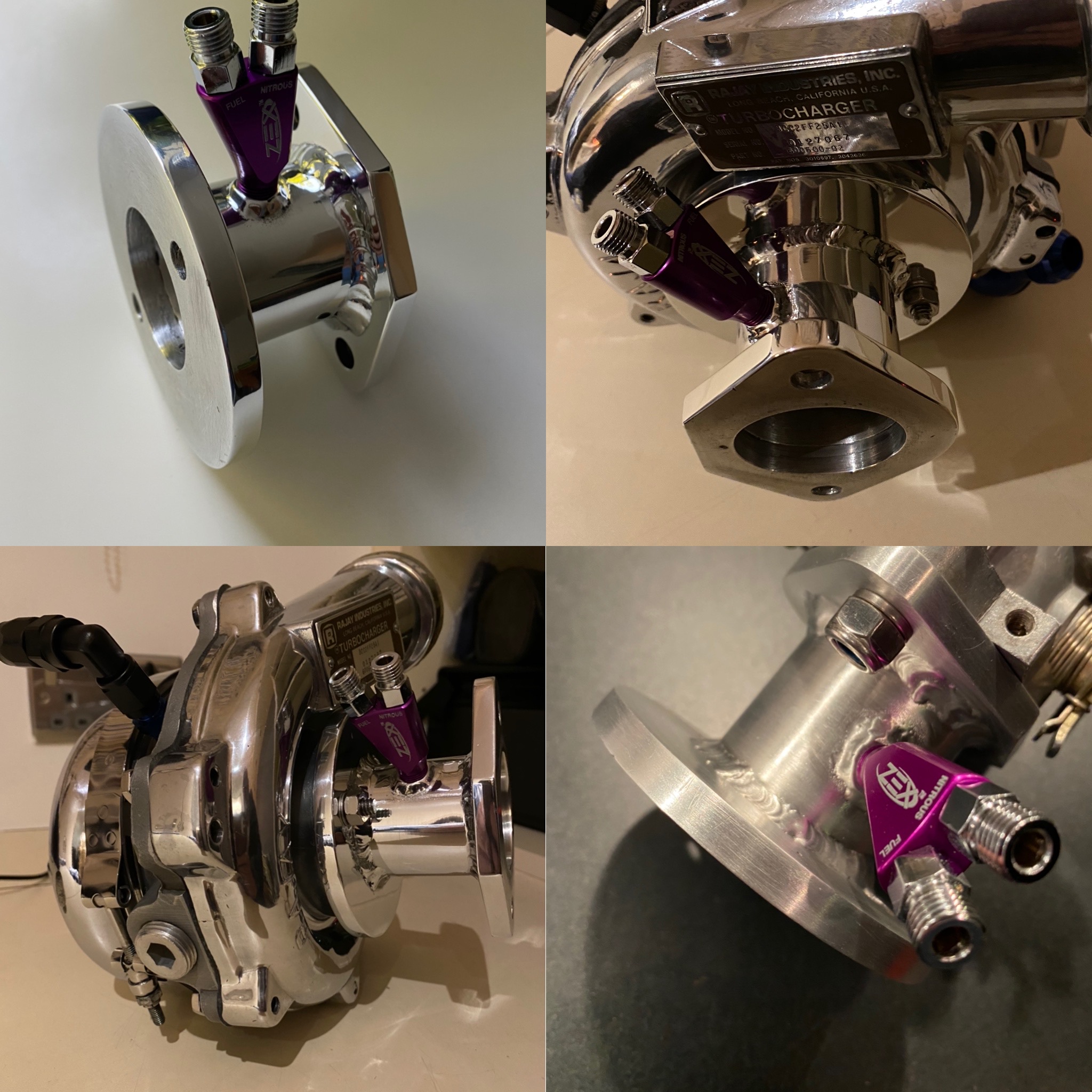

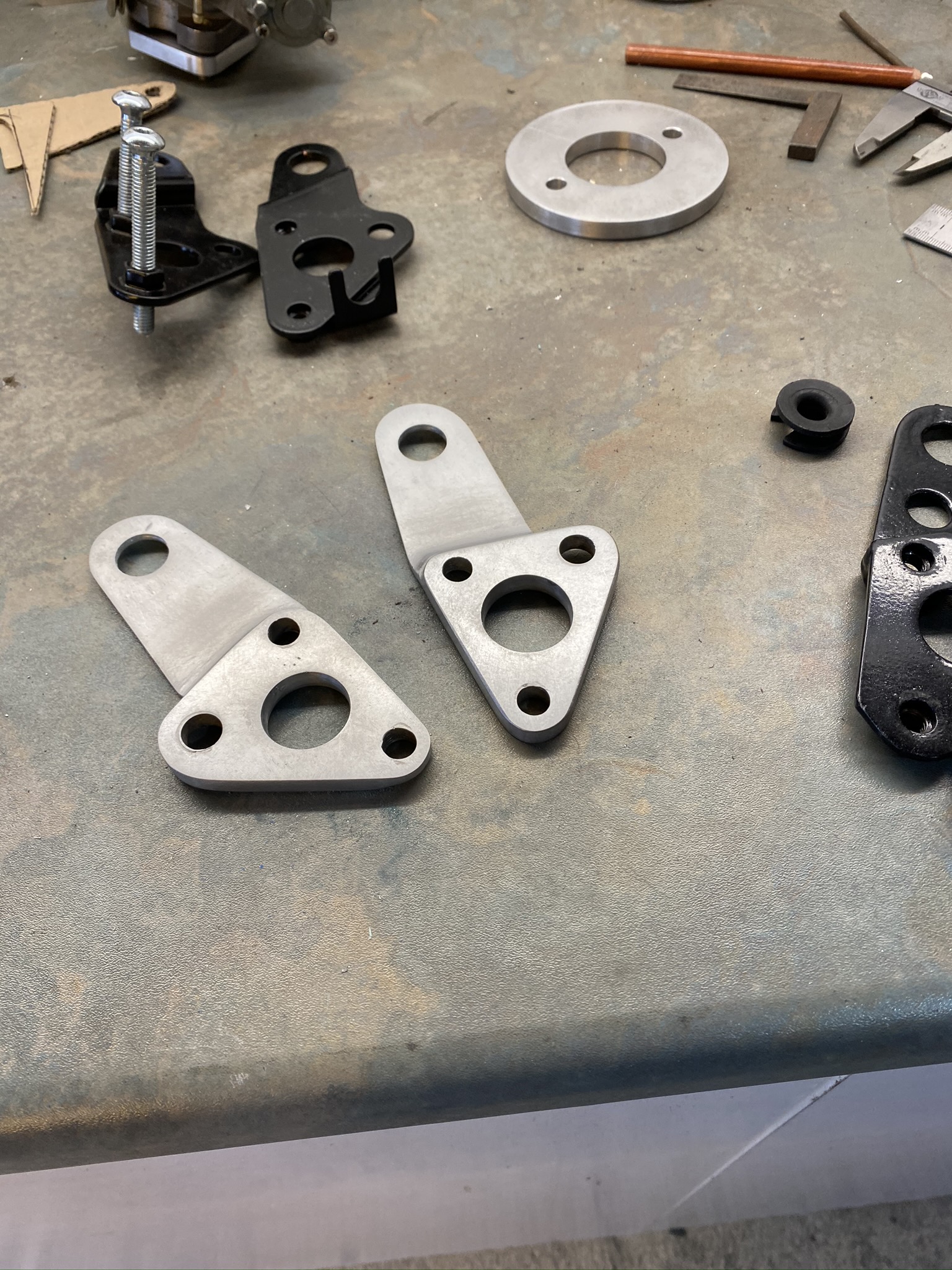

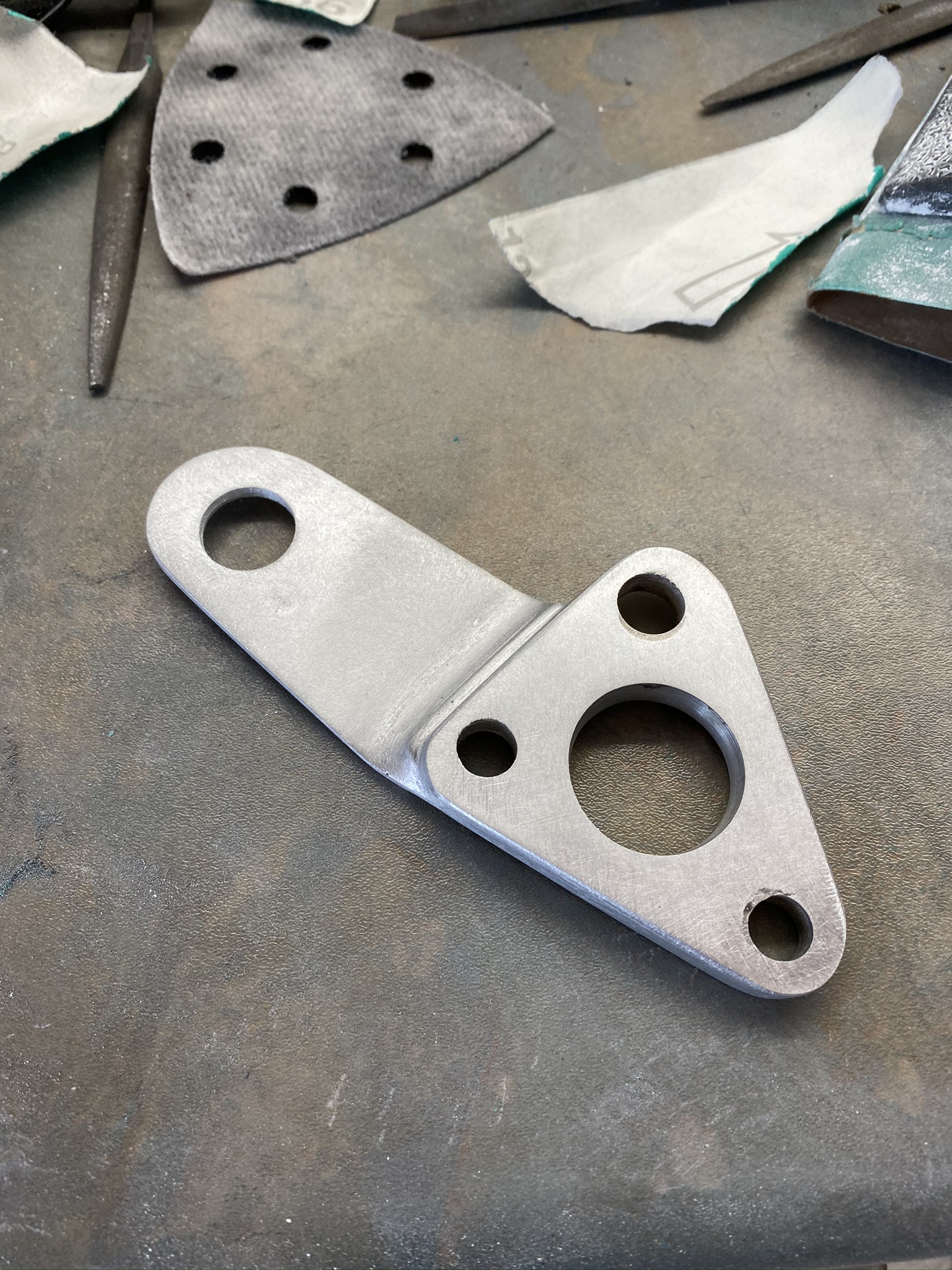

Few more pics of work to date Wanted to keep the draw through carb and rebuilt the original Bendix Zenith but wanted options when finally together so became the owner of a couple of Keihin carbs courtesy of Zed1015 :up
Needed to make an adapter so combined it to locate the nitrous fogger hand cut the plates and first real stab at ally welding.

#14 PostAuthor: zed1015 » Thu Jul 23, 2020 5:15 pm
thebuelligan wrote:Few more pics of work to date Wanted to keep the draw through carb and rebuilt the original Bendix Zenith but wanted options when finally together so became the owner of a couple of Keihin carbs courtesy of Zed1015 :up
Hey! small world :)
Great to see those carbs getting some proper use.
The bowl with jet access i made for setting up was only Lumiwelded on to avoid distortion .
Good and strong but worth a mention so you know.

#15 PostAuthor: thebuelligan » Thu Jul 23, 2020 8:12 pm
Hey! small world :)
Very small world :cool Thanks for the bowl info I was planning the same to use it for set up. Made an adapter for an S&S as well which I’ll kit out with a thunder jet Hope that one of the options will do the job but suspect a Mikuni may be the eventual route lol
