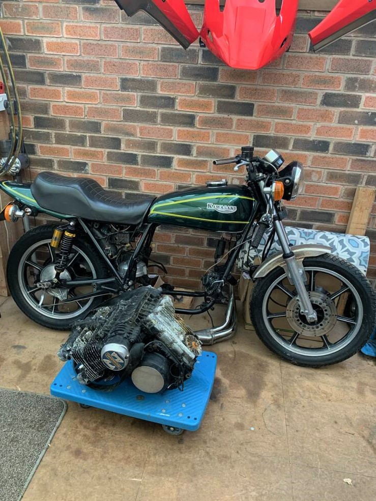

The ZRX12 forks are now rebuilt with new Tarozzi stanchions, the sliders had been powder coated satin black awhile ago, which caused a problem. The damping adjusters at the base of each leg had to be removed when they were powder coated, something that isn't supposed to be done. As the spring and ball bearing inside slightly damaged the 12x1 thread in the mechanism. Fortunately they were cleaned up with a tap and die and the forks could be finished. The chassis looks a bit nose down, but once the engine is back in the frame, its weight should bring the lower frame rails parallel with the ground. Also the wheels, rear shocks and bars wont make the final build.

Got the engine cases and block back from Triple S... powder coated in satin black, very similar to the factory finish.. excellent finish but expensive.

I tried the bodywork on the bike for the first time the other day, still need a seat, which is on back order via Z Power. I bought a used crank to get the one good conrod I need to rebuild the crank I want to use.. only to find the one I bought wasn't from 78 as advertised, but much earlier, with smaller big end bearings.. so cant use a any of its conrods. Then again it was in overall good condition, so I'll have it rebuilt and welded anyway for another future engine.
