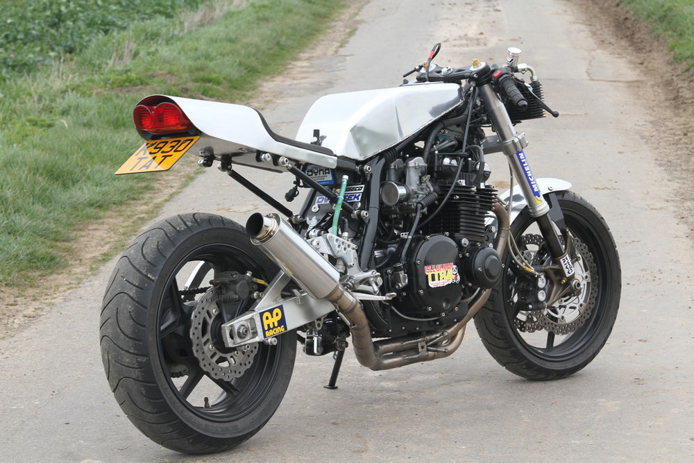

#7 PostAuthor: zed1015 » Mon Feb 14, 2022 10:56 pm
Used one of those on my alloy cafe.
They suit the zed style tails really well.
