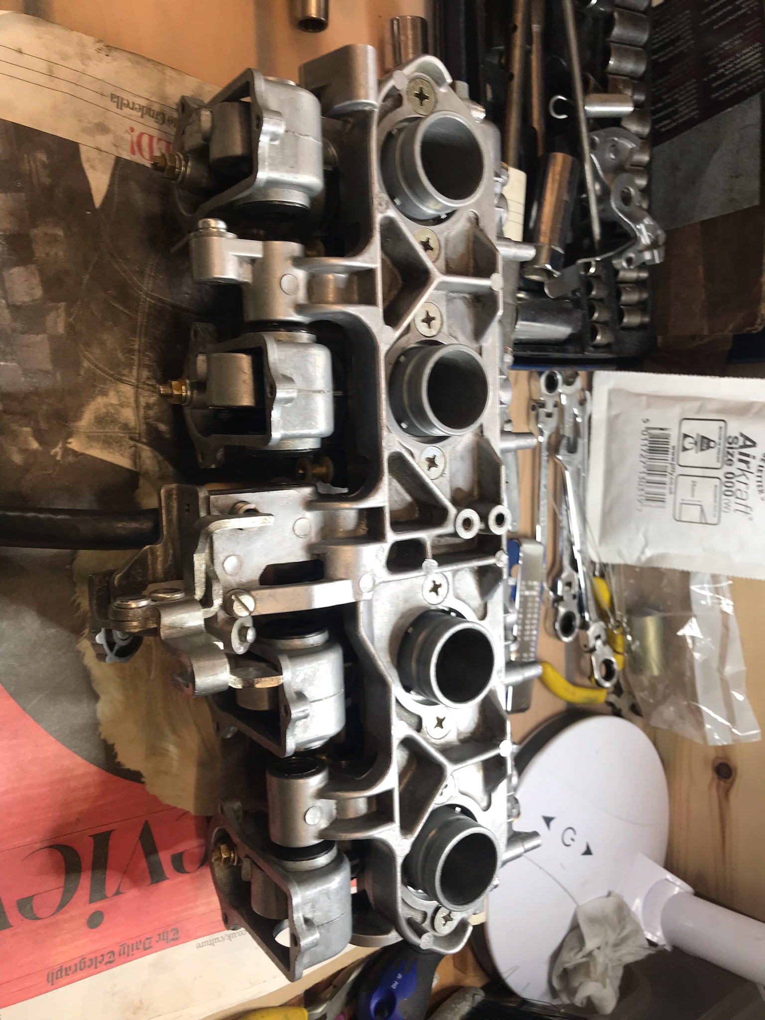

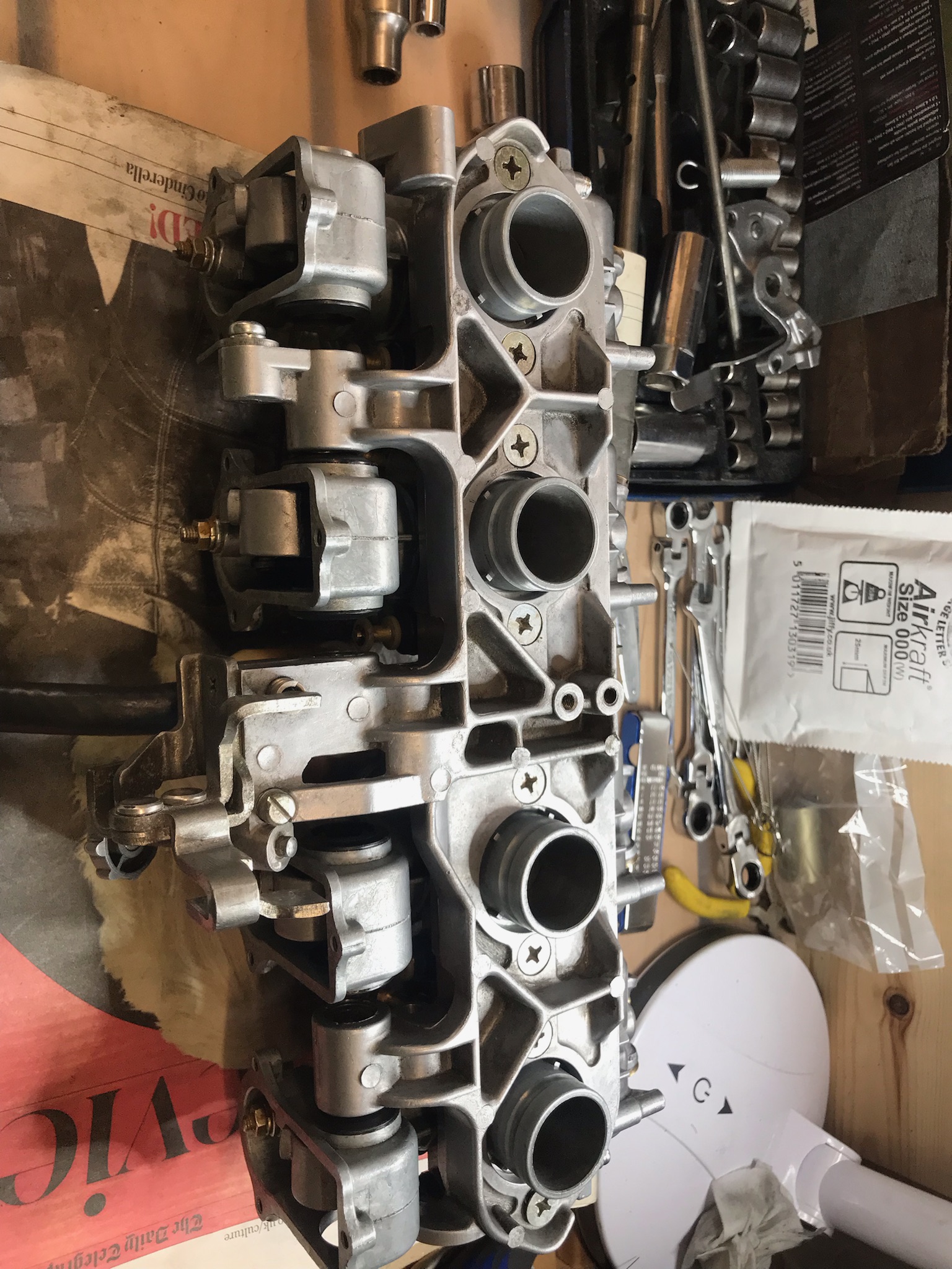

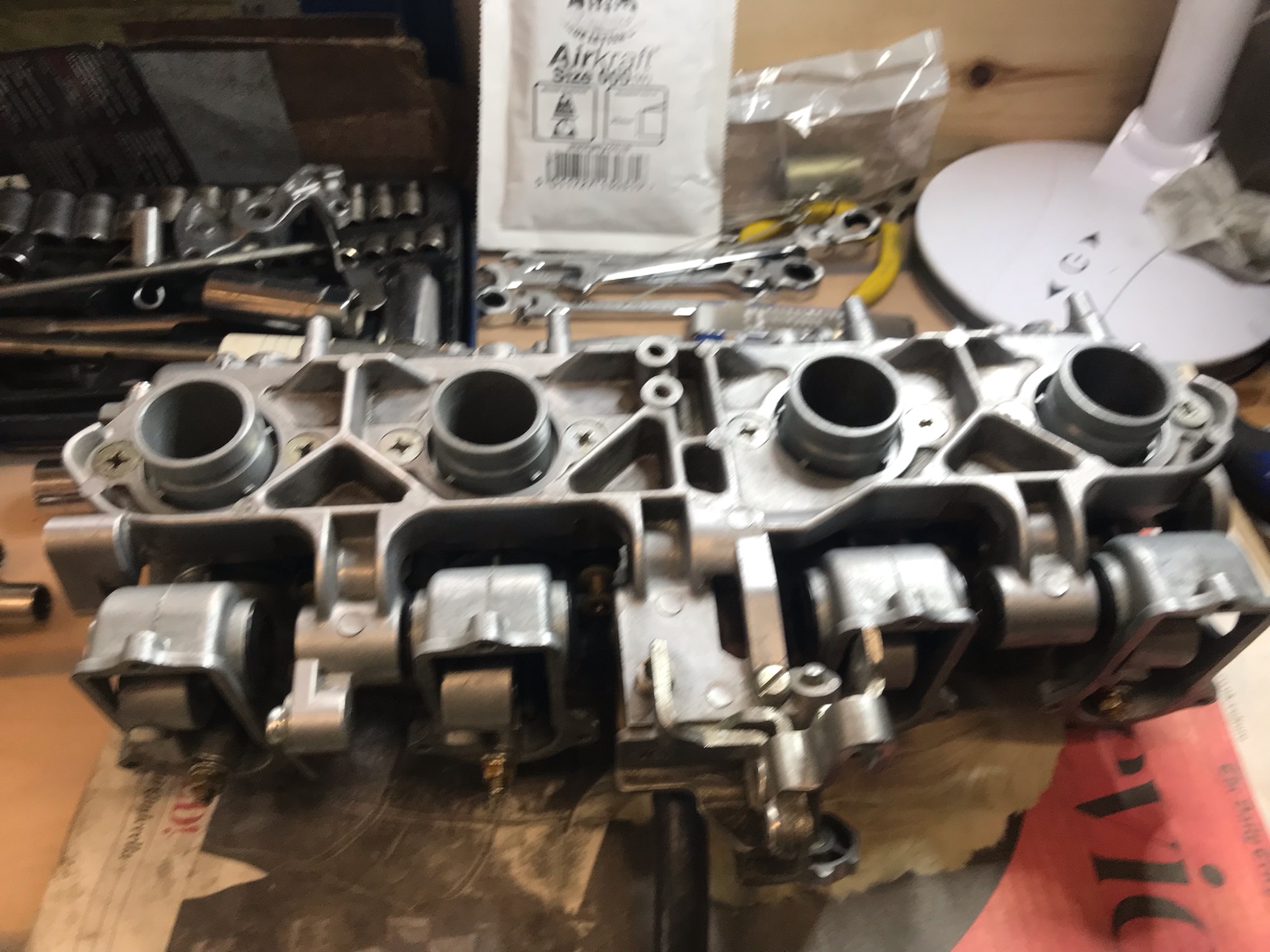

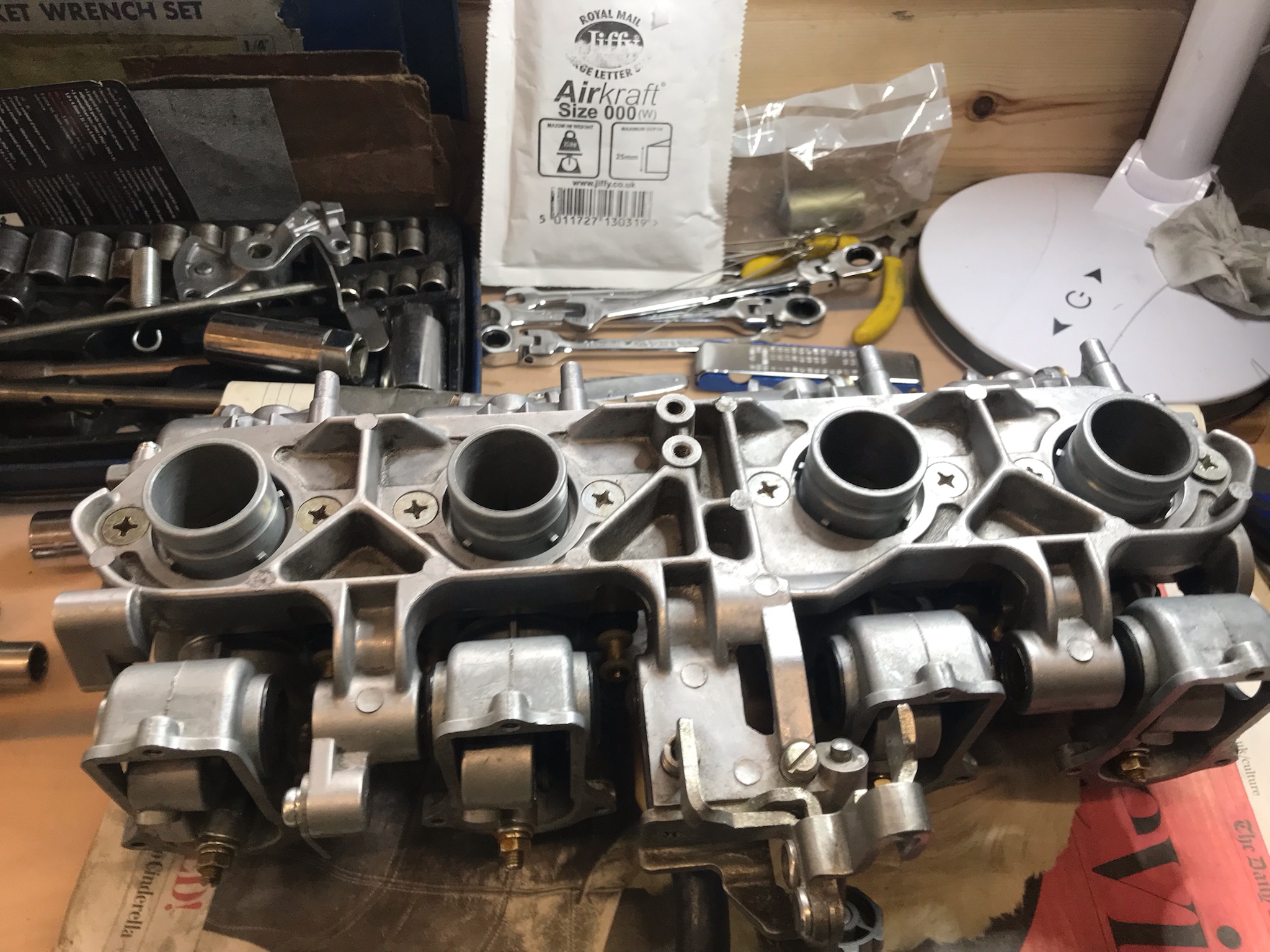

Got some choke plungers from Rob Meggitt. They arrived today while I was at work.
Got home just after 6 and started on sorting the carbs

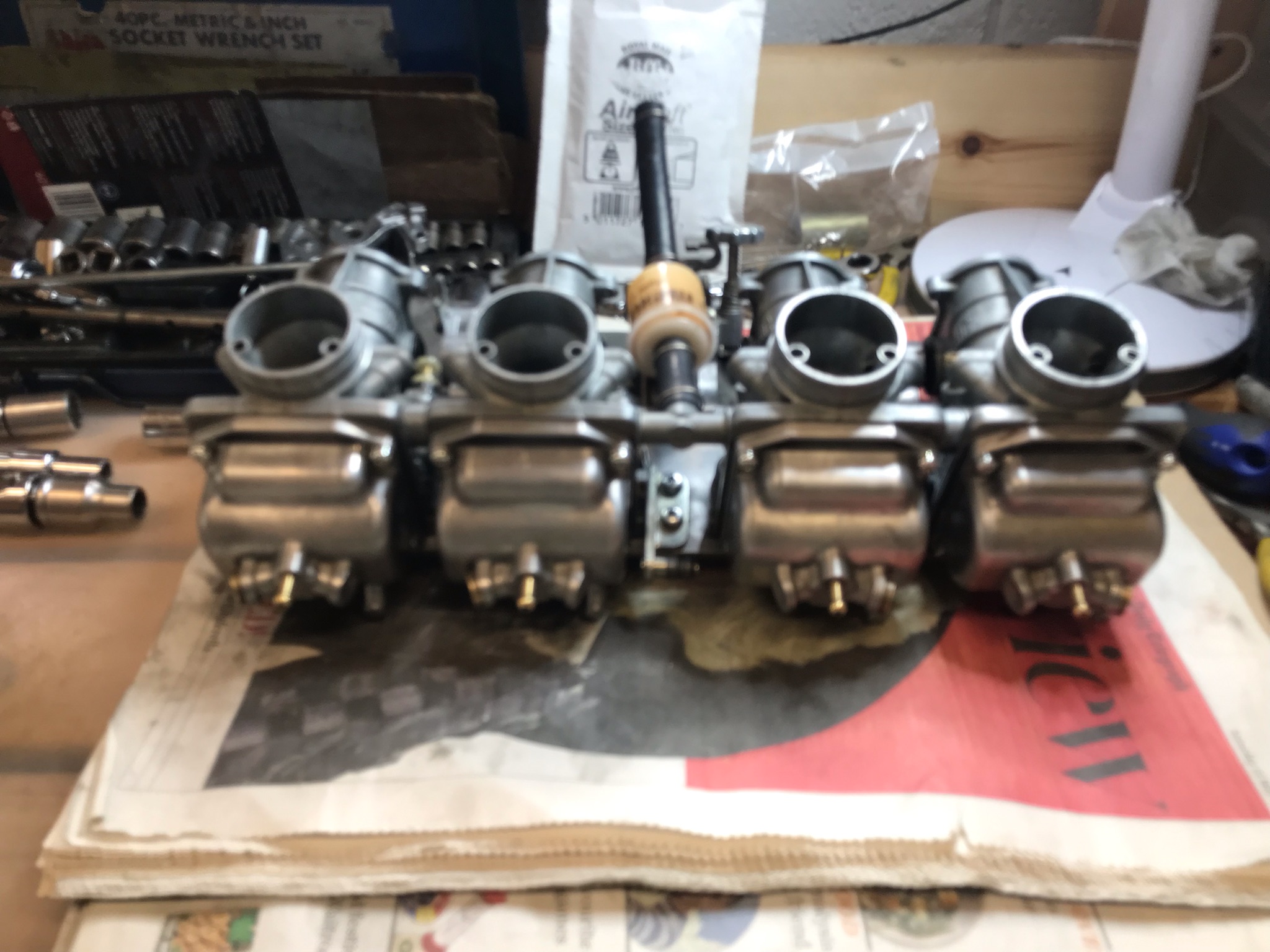

By ten I was hearing sweet music.

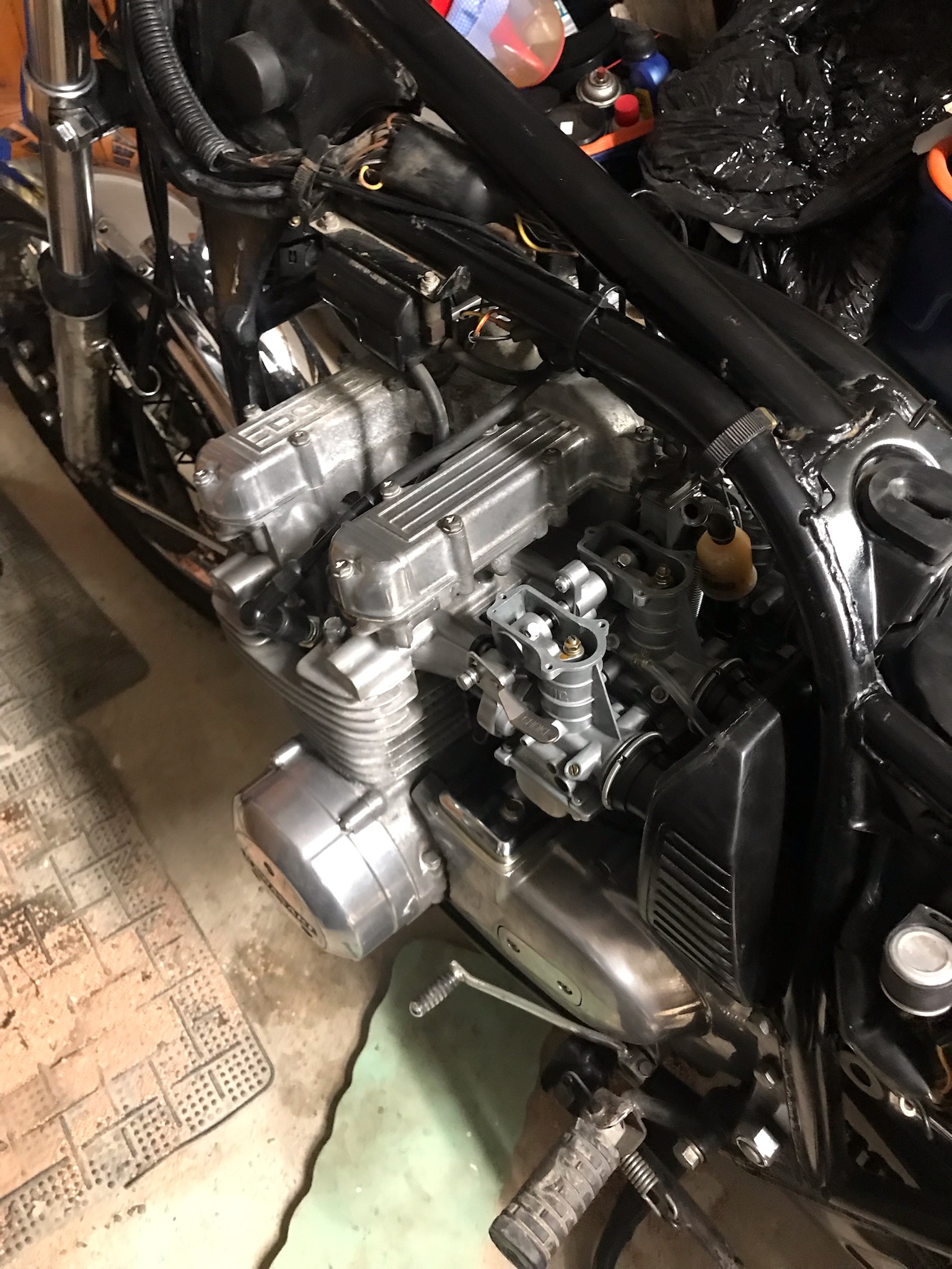

Re: Little zed carbs and Plungers

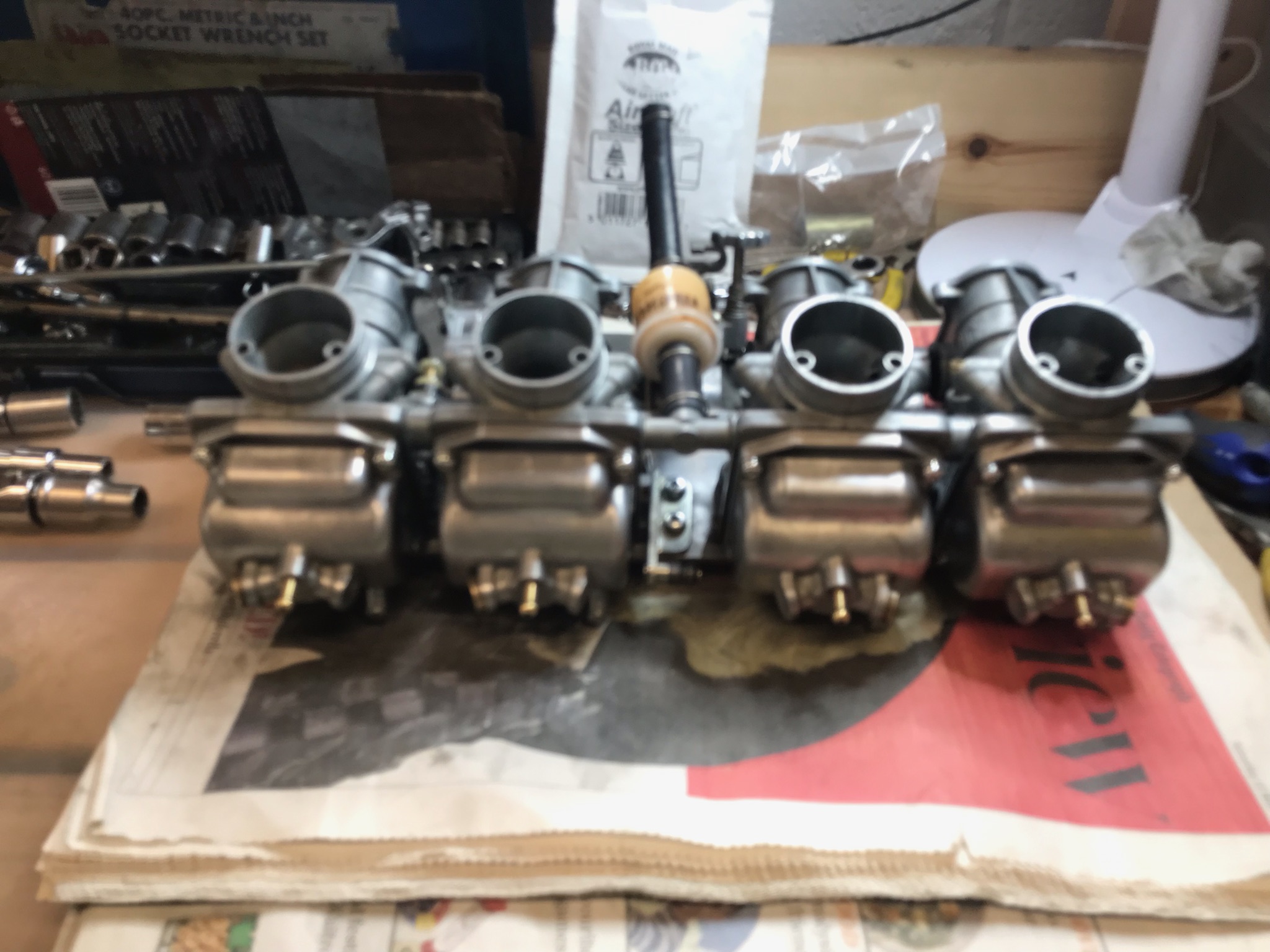

Adding a video of the bike actually running (started first time) has defeated me!), anyway she started first time and was so much smoother and more urgent.
Still need to balance the carbs but hopefully they cant be that far out. And then put the top caps on.
All in all
1. New O rings.
2. New pilot jets
3. New main jets
4. Clean bodies and all passageways
5. New gaskets
6. New choke plungers
7 Set float heights dry and wet method
7. Polished bowls and caps
8. Reassemble and refit.
9. Fill with fuel (no leaks)
10. Turn on tap (still no leaks)
11. Tap bowls (still no leaks)
12. Open choke
13. Hit starter
14. She starts

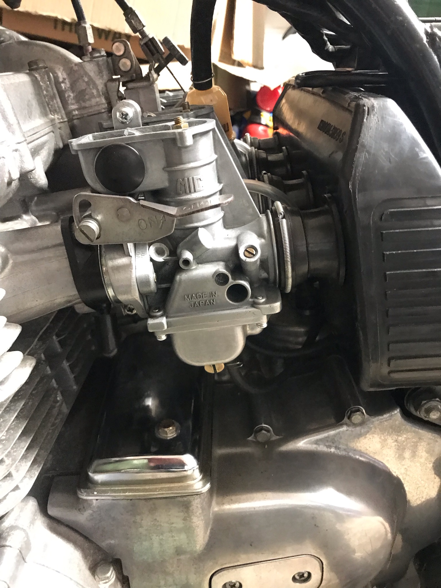

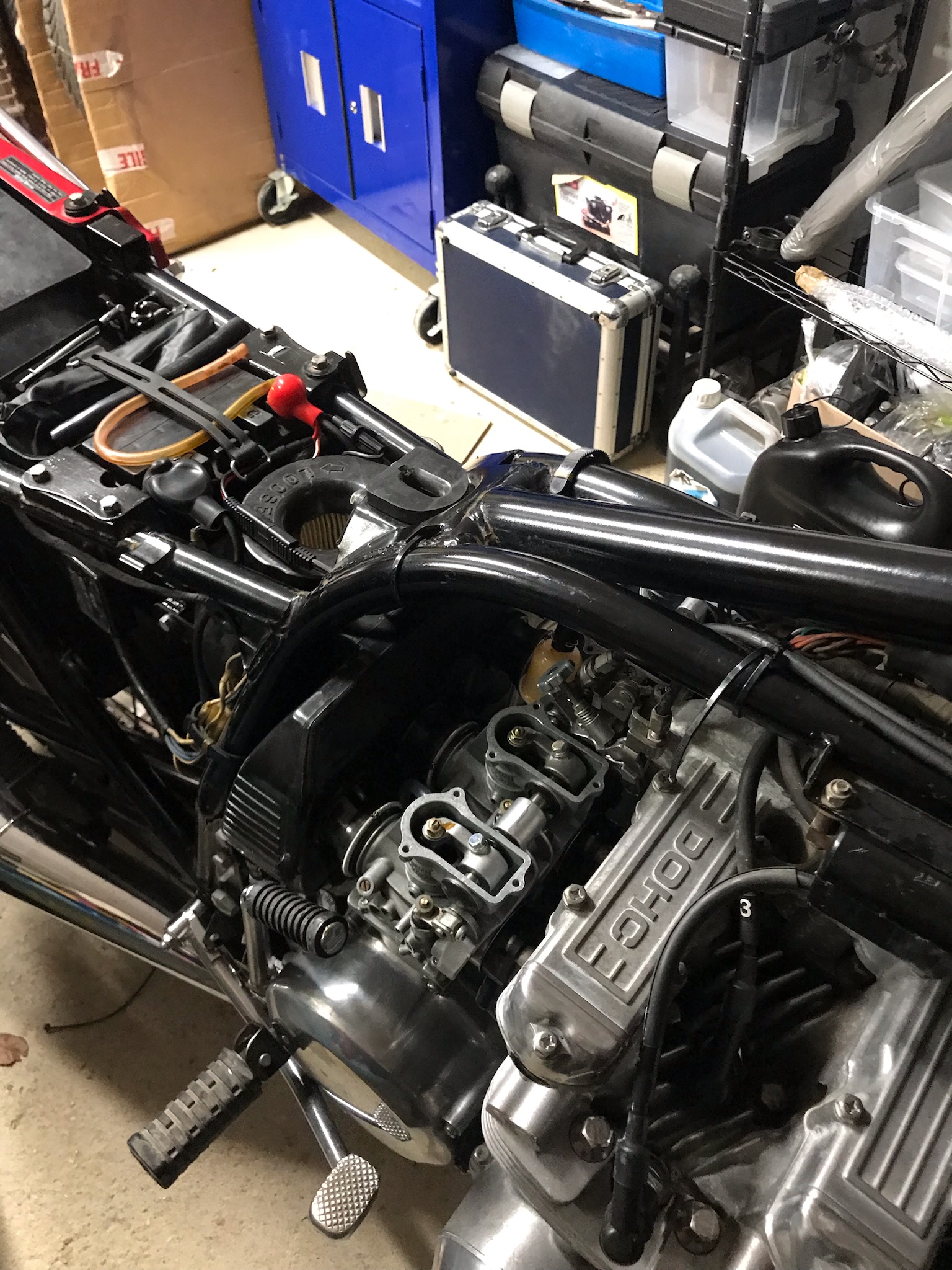

A tip from the last time I had the carbs off was I smothered the carb to airbox rubbers in a rubber treatment high in carnauba wax ( natural rubber treatment) and then put them in a closed plastic bag.
I then fitted the carbs to the inlet rubbers and inserted the carb to airbox rubbers through the top hole of the airbox and through the airbox holes and onto the carbs and as they were squasy and flexible it was relatively easy ( all things are relative on a continuum - right).

Well popped out tonight to see what the lie of the land was with respect to pick-up and fuelling and running.
Ran as smooth as and is great on pickup so all good.
Put two cans of fuel in and went to the local station and brimmed it so I can check how many miles/ MPG I get next time I fill up. Hopefully it will be a big improvement on the 15-18 mpg I was getting on the trip to the ace cafe after the firts carb rebuild.
