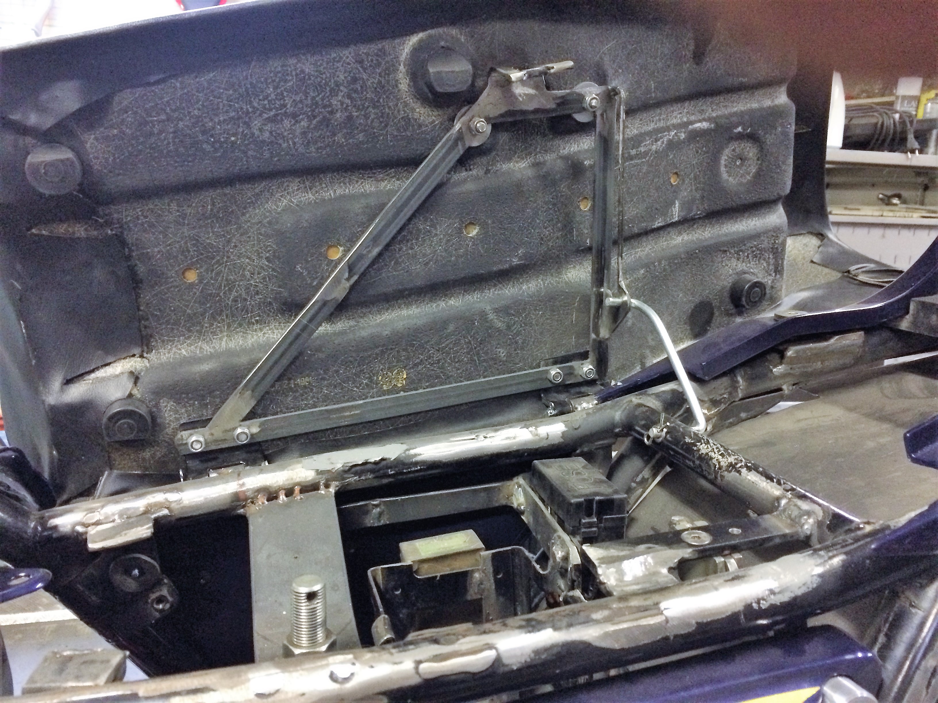

actually the seat is for a MK2 and made to fit. Moved the hinges on the frame and made a small subframe in order to keep integral strength of the seat instead of hinging it in the glassfibre only. Also added a push button lock and a seat stopper.

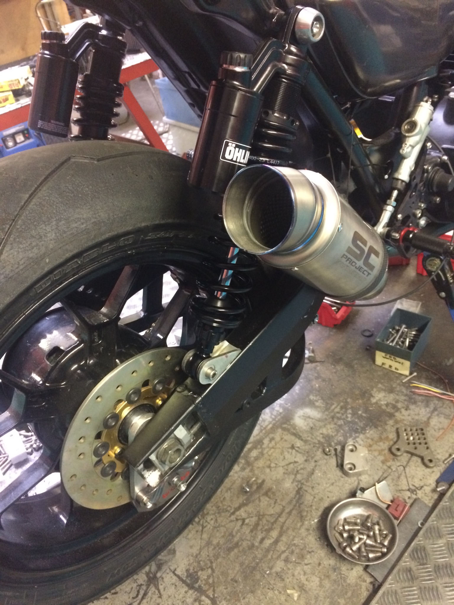

#30 PostAuthor: Mathh » Thu Mar 07, 2019 7:05 pm

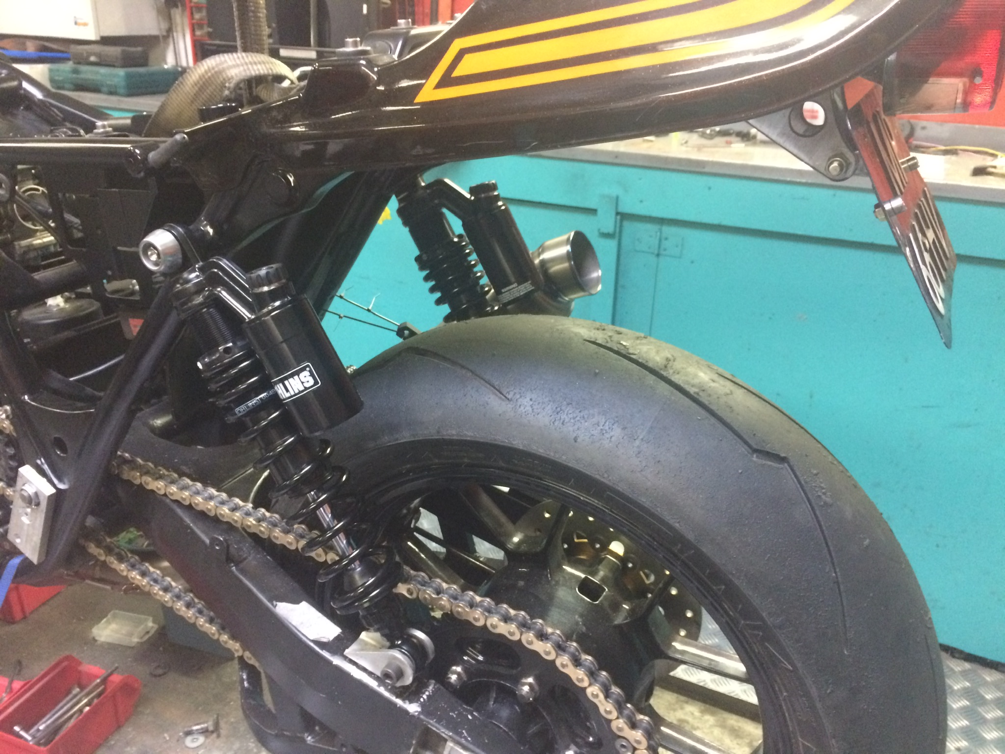

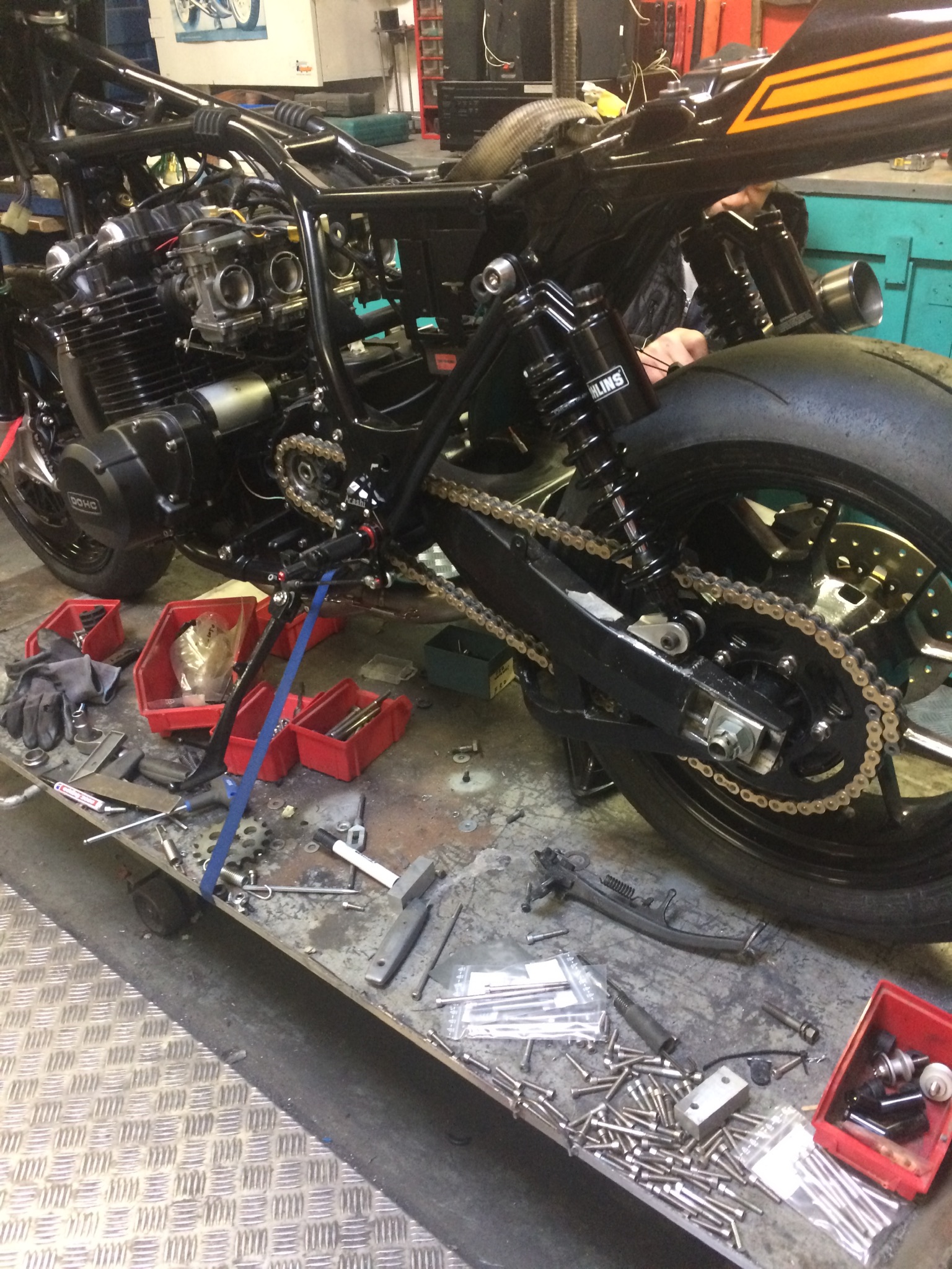

I got my late Santa gift today .....
Looking great ... still need to weld the brackets to the swingarm ..
