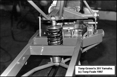

INteresting mount for swinging arm wonder where it mounts on other side, would be hell of a wide arm and may have been for fitting rvery wide wheel and tyre for drag racing.
Thats what i thought initially but found this which shows how the outriggers might look for the concentric swingarm pivot if using it as a road / race bike with a normal size tyre. That said; as a road or race bike, given the questionable nature of the mounting of the headstock to the barrels studs, i wouldnt like to have to brake too hard :shock:
Yam2_4 TF swingarm.jpg (23.13 KiB) Viewed 3675 times
