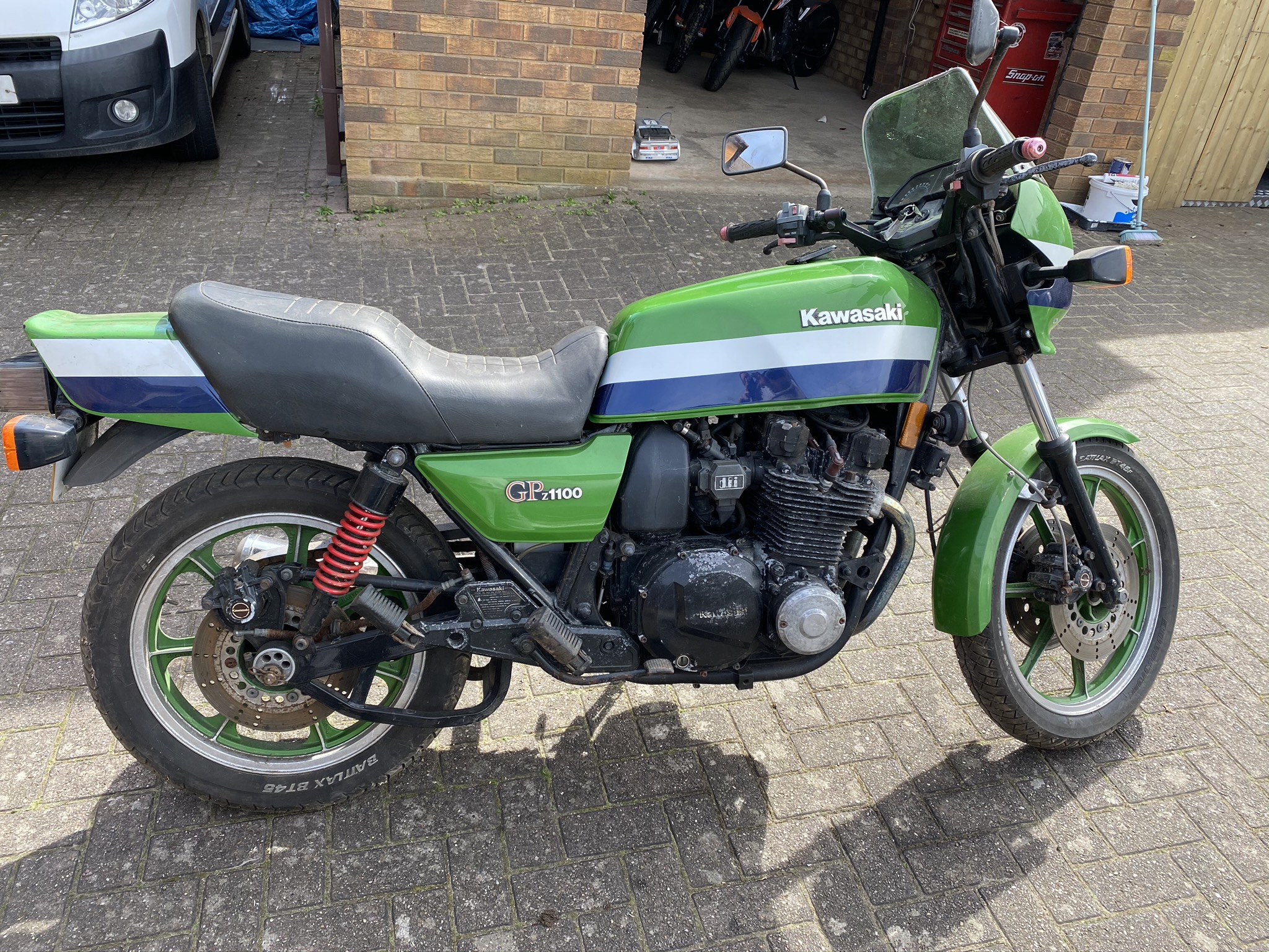

After having my bikes parked up waiting form”the right time” to do the long awaited renovation I have actually got round to starting
Before pic
one and would like to keep the momentum going.

Nice GPz 1100 you have there.

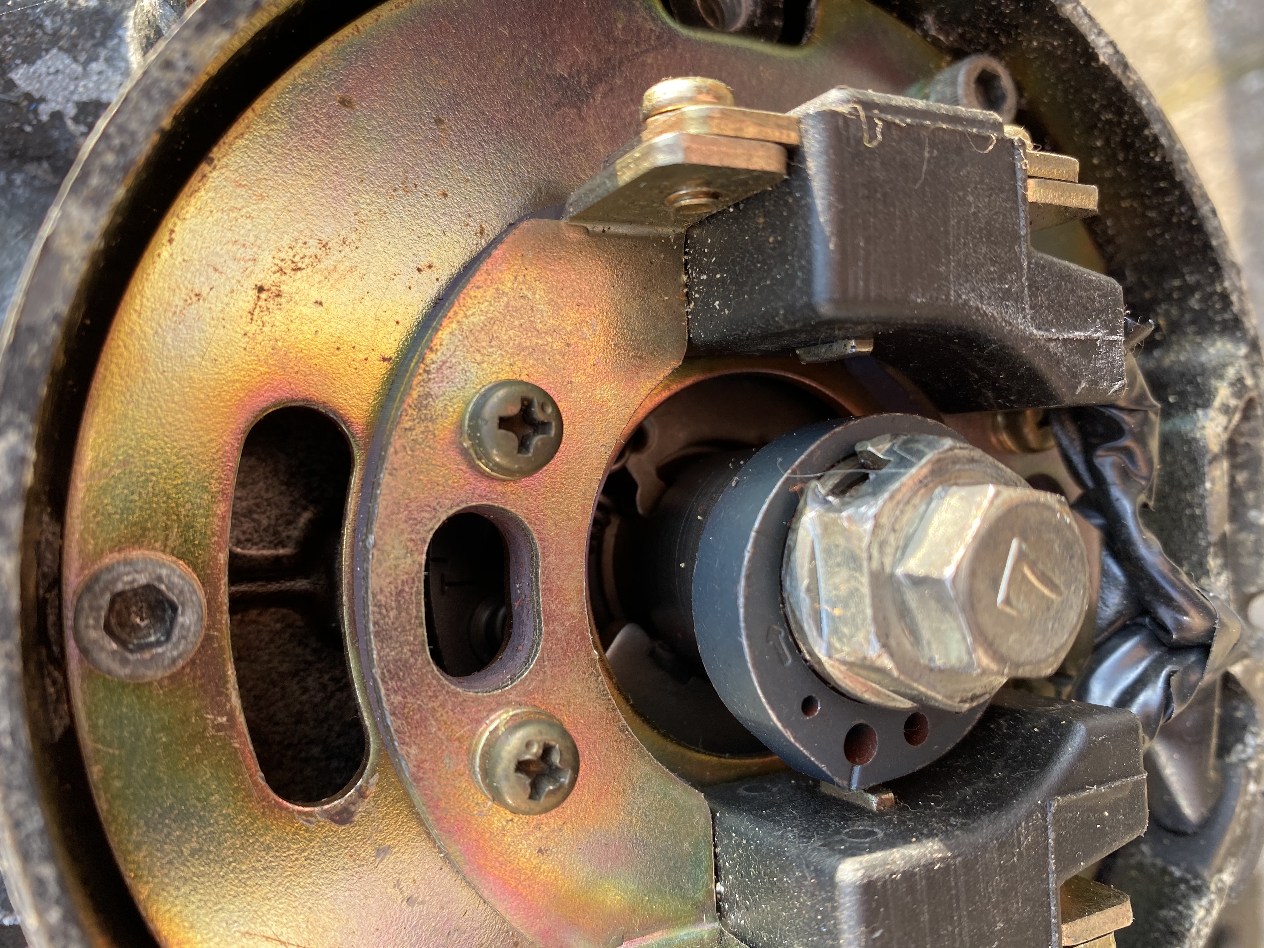

#7 PostAuthor: duanedb691966 » Tue Apr 14, 2020 4:36 pm
Hi, I have attached a picture for conformation.
Thank you

#8 PostAuthor: Gus » Tue Apr 14, 2020 5:07 pm
Mechanical advance
Gus

#9 PostAuthor: duanedb691966 » Tue Apr 14, 2020 5:13 pm
Hi Gus, so is this a J engine then ??
