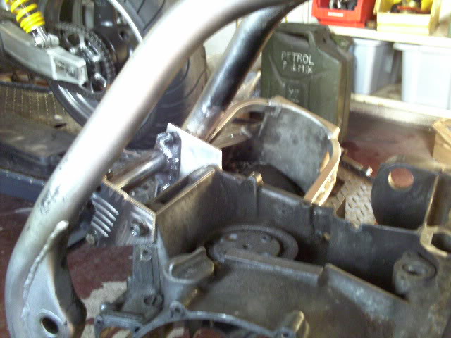

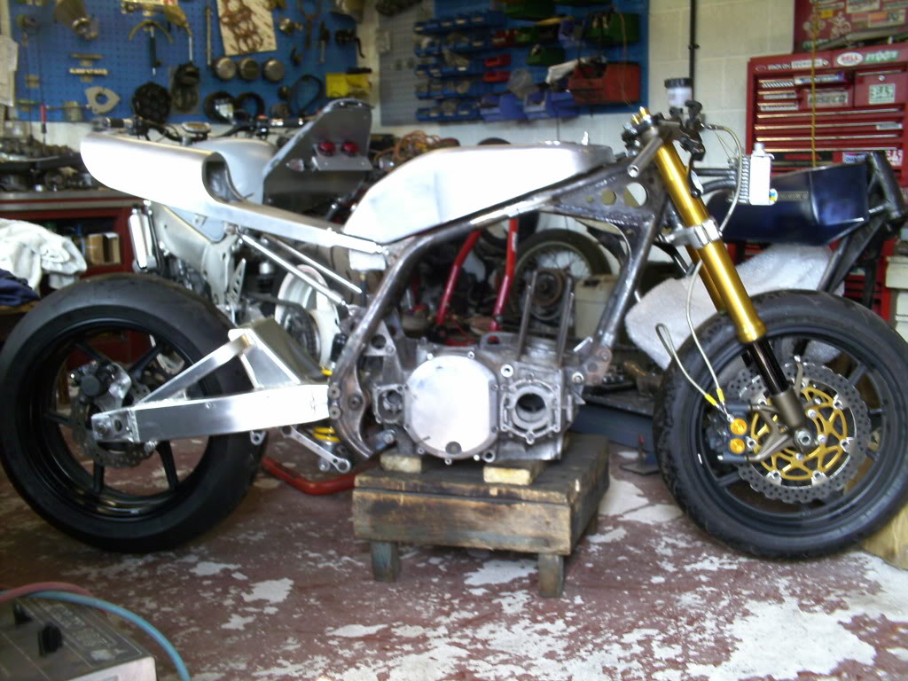

zed1015 wrote:I've decided that the 1428 motor may possibly be a tad too powerfull for the little lightweight cafe racer
Is too much power possible?? :)
Lightweight cafe racer with a 1428 motor and a Supercharger = Yummy!!
In the end i had no choice.
The frame is so tight there was no room for a blower.
There's literally only mm's clearance between engine and frame.
I've even had to clearance the swingarm pivot tube to miss the bulges for the rear 6mm engine bolts and the engine won't even go in in one piece.
Good job the bottom ends are bullet proof as an engine out job means a total strip, down to just the frame.

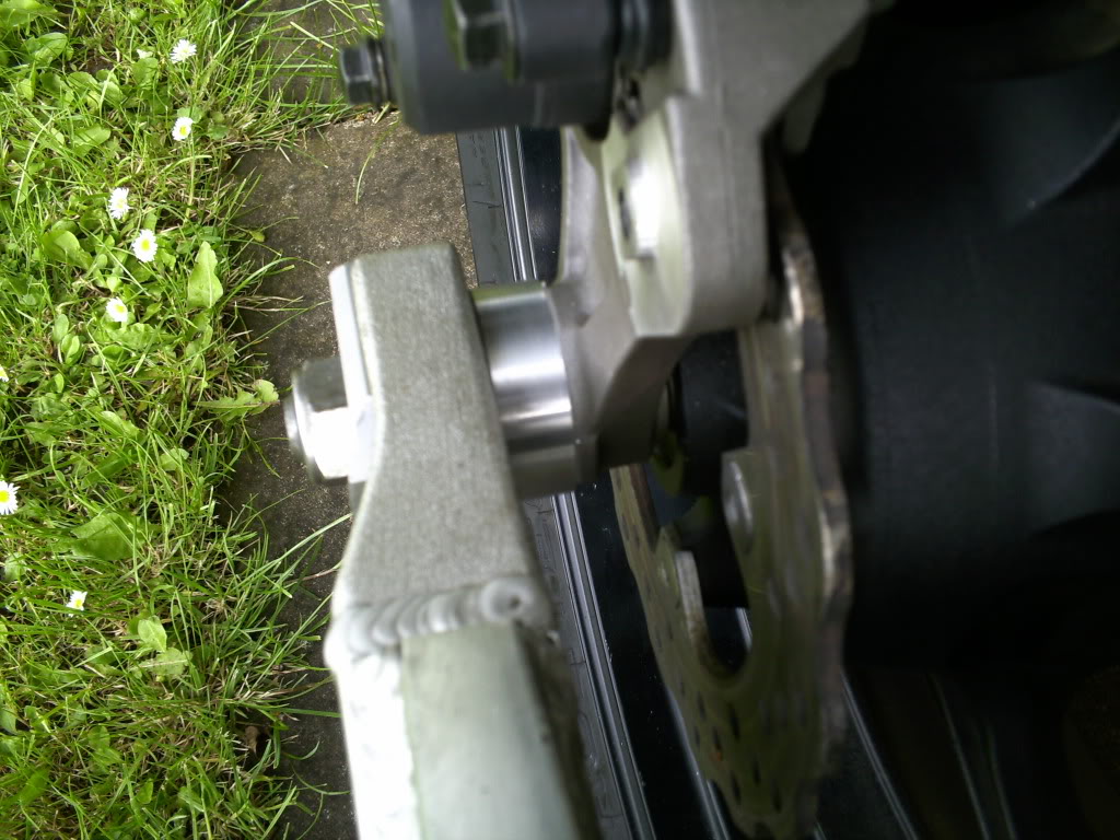

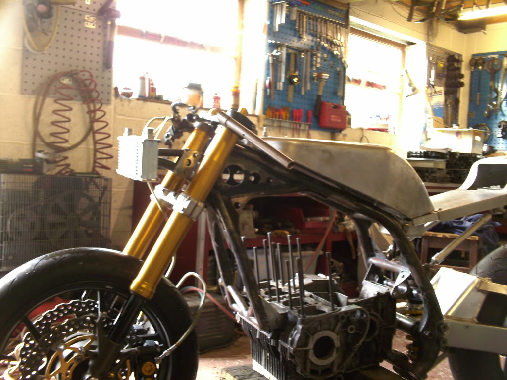

#37 PostAuthor: zed1015 » Sun Jun 10, 2012 5:36 pm

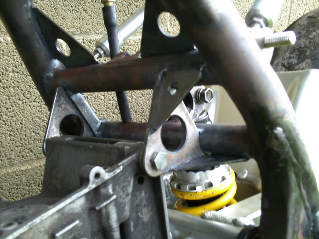

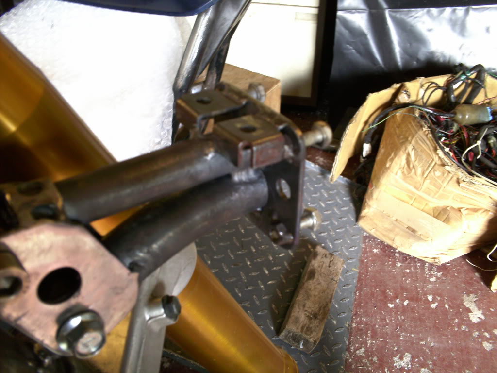

Been pushing on to get the frame and other odds 'n' ends finished.

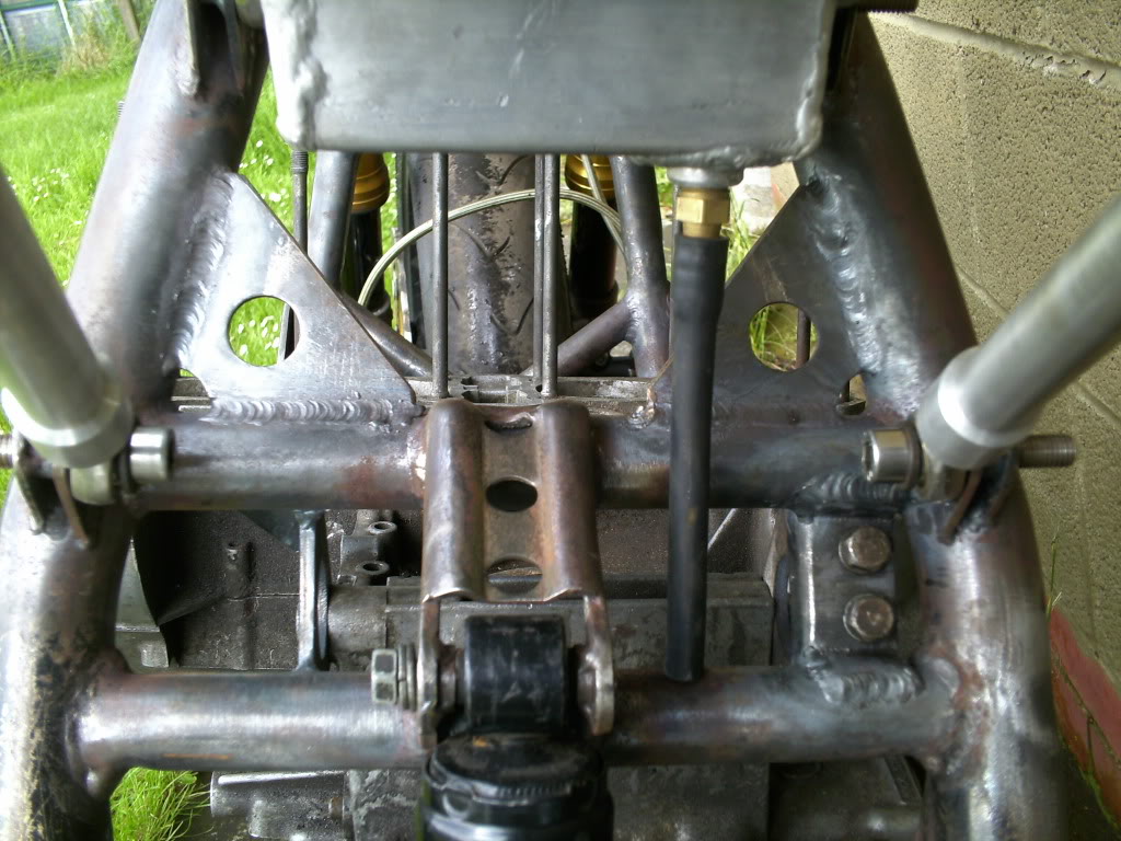

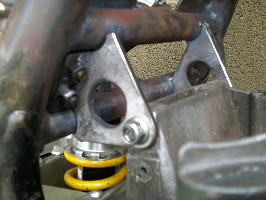

First up was a re-working of the rear engine mounts.
Gone are my original mounts which i was never happy with.
And in their place something much more fitting which tie in both rear bracing/shock mount tubes.
Right hand plate is removable
Left hand side is fixed and braced
Also added some final additional bracing at the rear so hopefully the whole thing shouldn't flex too much.

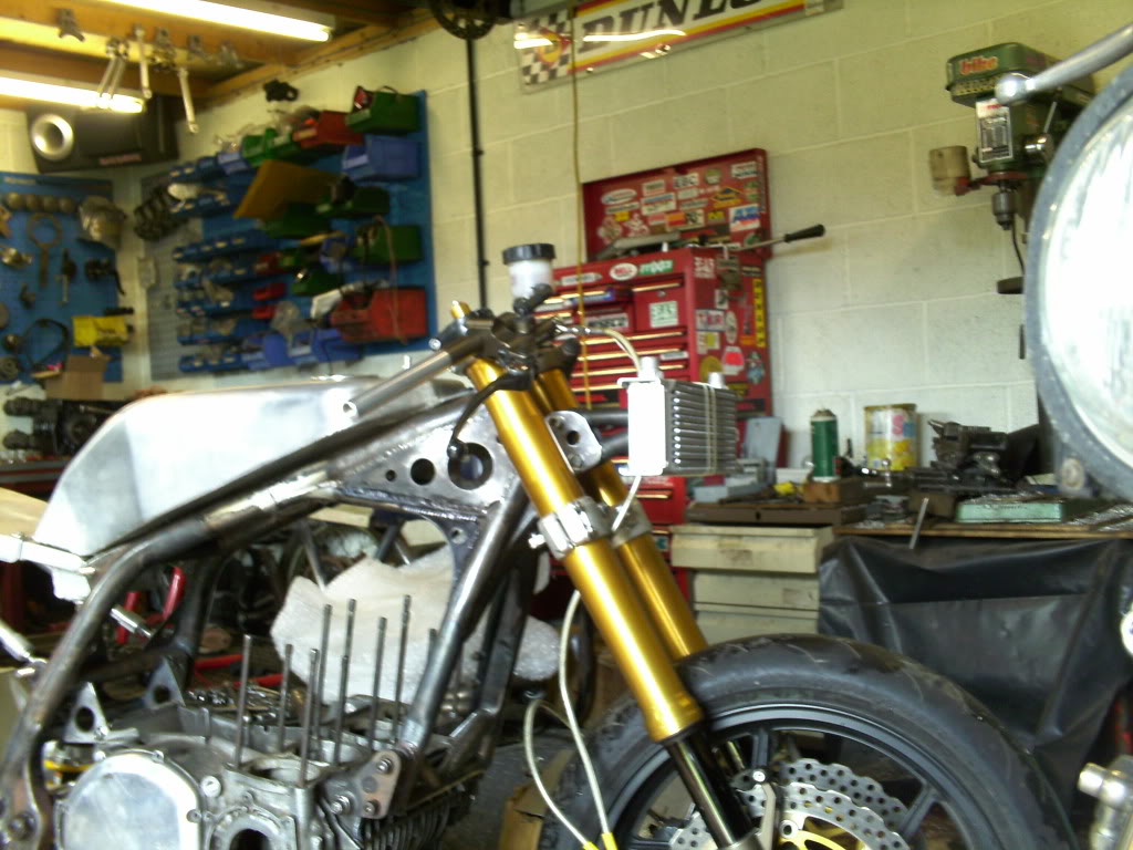

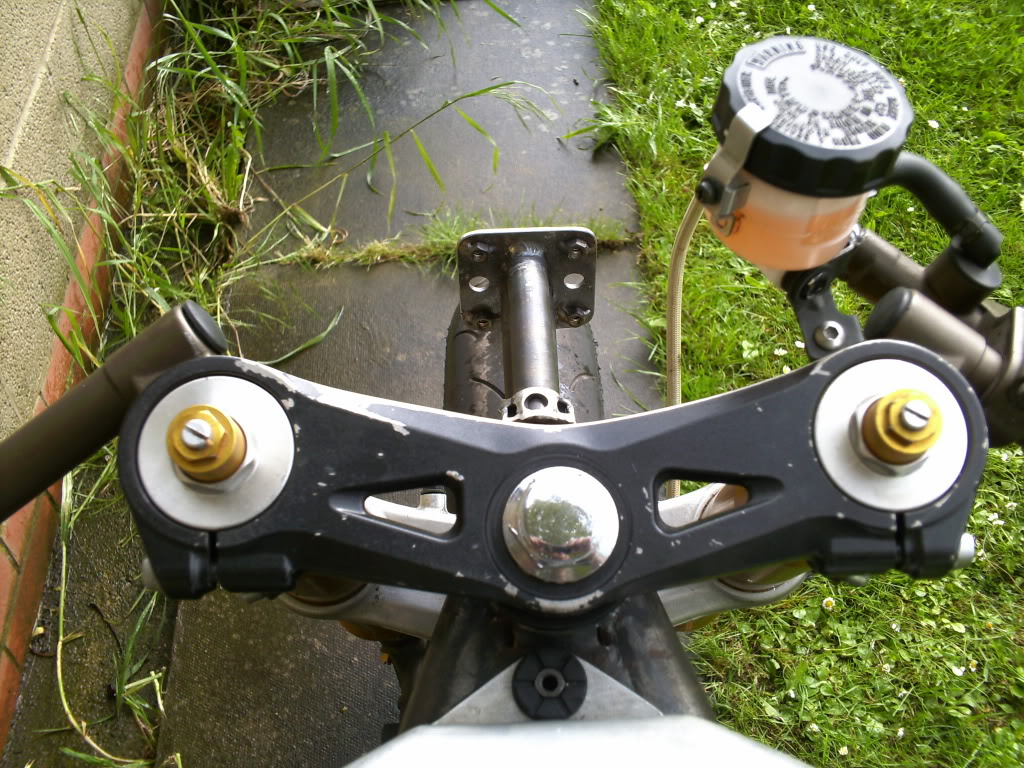

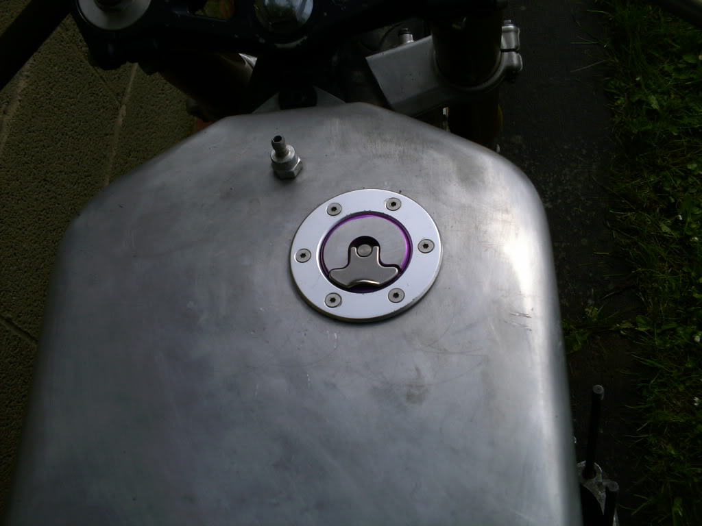

Next up was to mount a filler cap courtesy of mark (Pigford), cheers mate :up .
Remove the ignition switch mount to clean up the top yoke
And finally got the rear wheel aligned and fitted a permanent spacer/sleeve in to the rear caliper hanger.

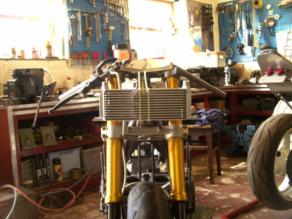

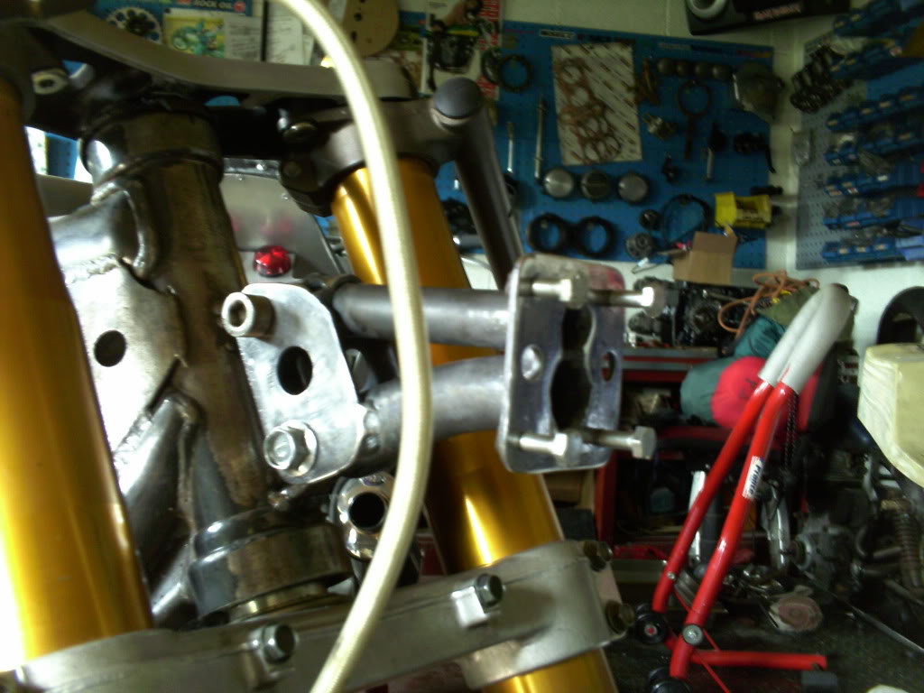

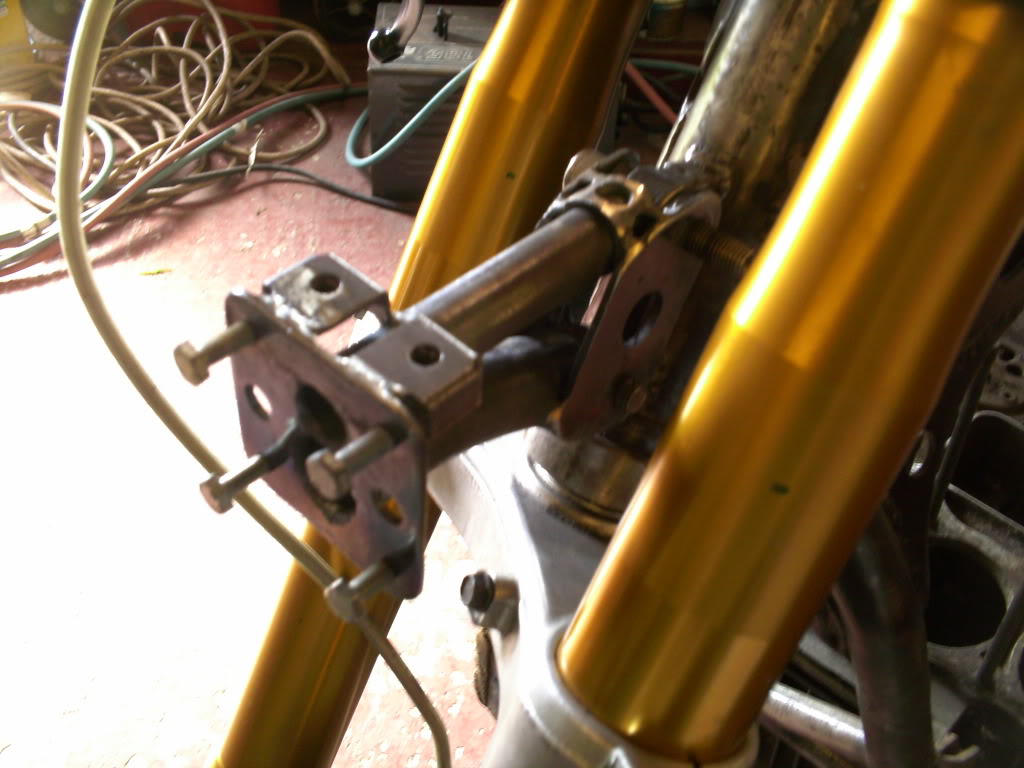

Made good progress today on making the headstock mounted oil cooler bracket
Couple of threaded tabs on top to mount pushbike or digi speedo.
Brought the open tubes through the mounting plate for less restricted air flow

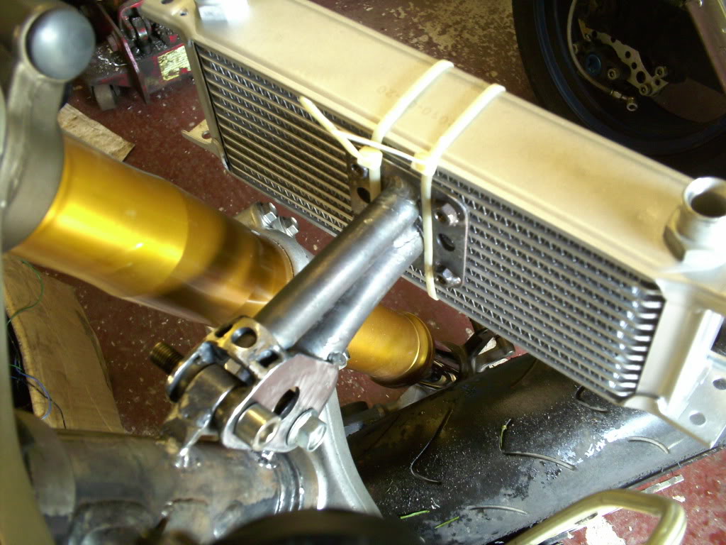

Cooler will eventually attach to bracket via a rubber mounted alloy plate and rubber straps
Front view.
Mounting brackets on ends of cooler will be removed.
Just got coil and cdi mounts to weld on and frame is done.

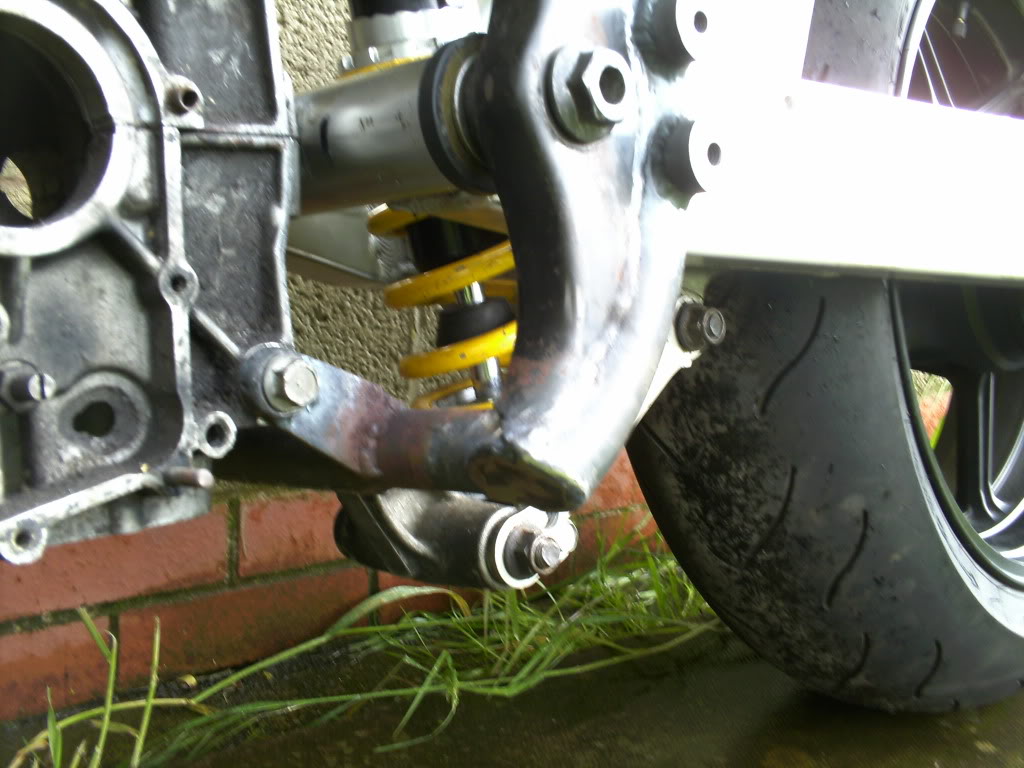

Also done away with the side stand entirely and capped off the tube for that proper racer look :D .
Will come up with some sort of device that slots in the hollow swingarm spindle, ala motocrosser stand type thingy that i can conceal on my person or somewhere .

Just thought, I can remember seeing drag bikes that used a triangular loop that slid over the footrest as a stand (carry it around in pocket type) bikes were 'low' tho' and pegs were obviously 'fixed'
Wots up DOHC
Posts: 4040
#45 PostAuthor: zed1015 » Wed Jun 20, 2012 9:03 am
Yes ! that's the sort of thing i was thinking of.
Plenty of options when it comes to it, there's the defunct lower engine mount that i might use which will put the weight directly over the stand.
I can always make a sidestand bracket that bolts to the engine if i can't come up with a niffty foldaway design for the prop.
