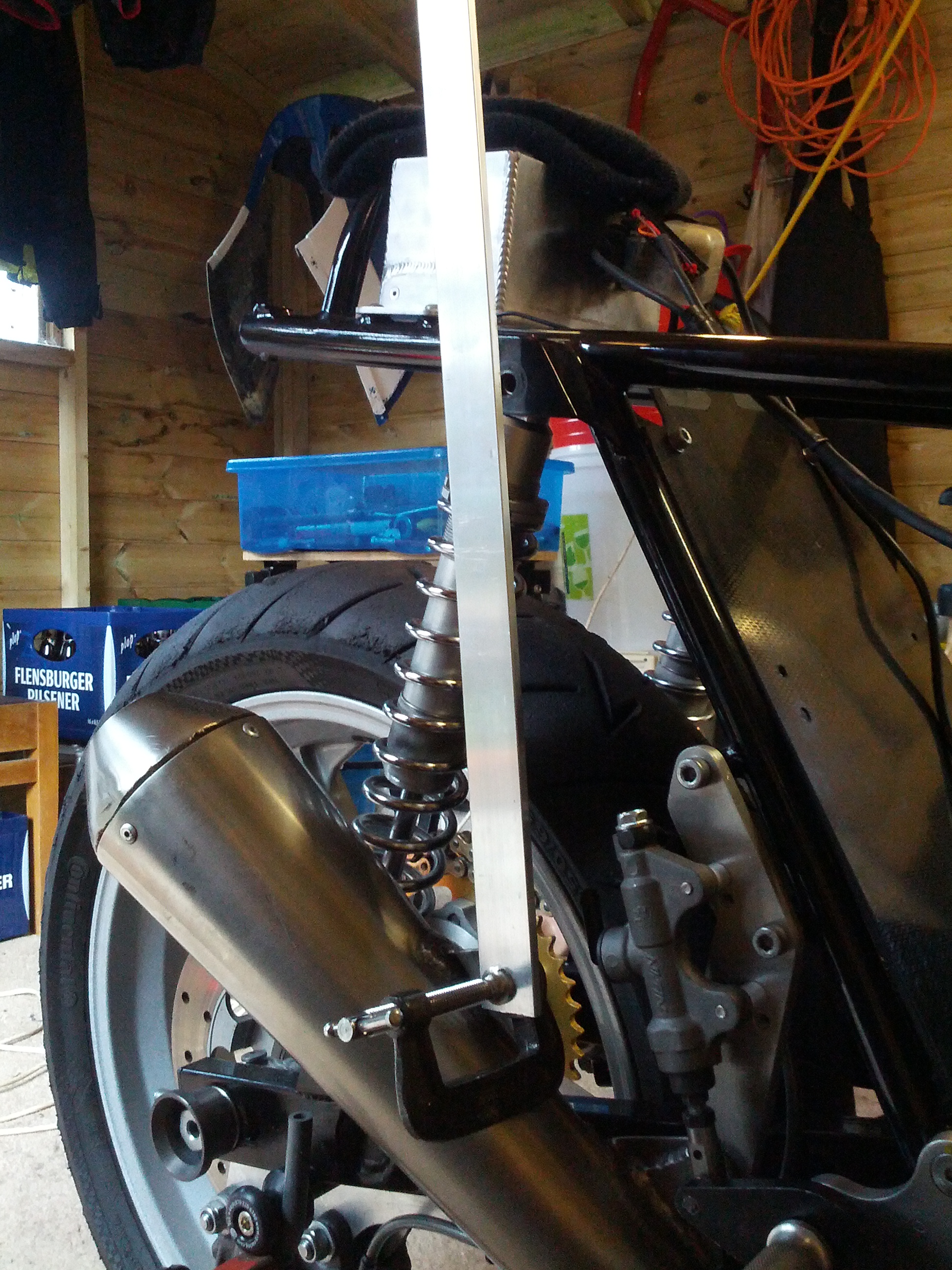

Also decided to make a secondary mega bracket out of 30 x 5 ally bar:
Using the old G-clamp and block of ally method in the vice to create a joggle to clear the top of the rear shock
Also made up an ally spacer to move the bracket out by 10mm:
All done
