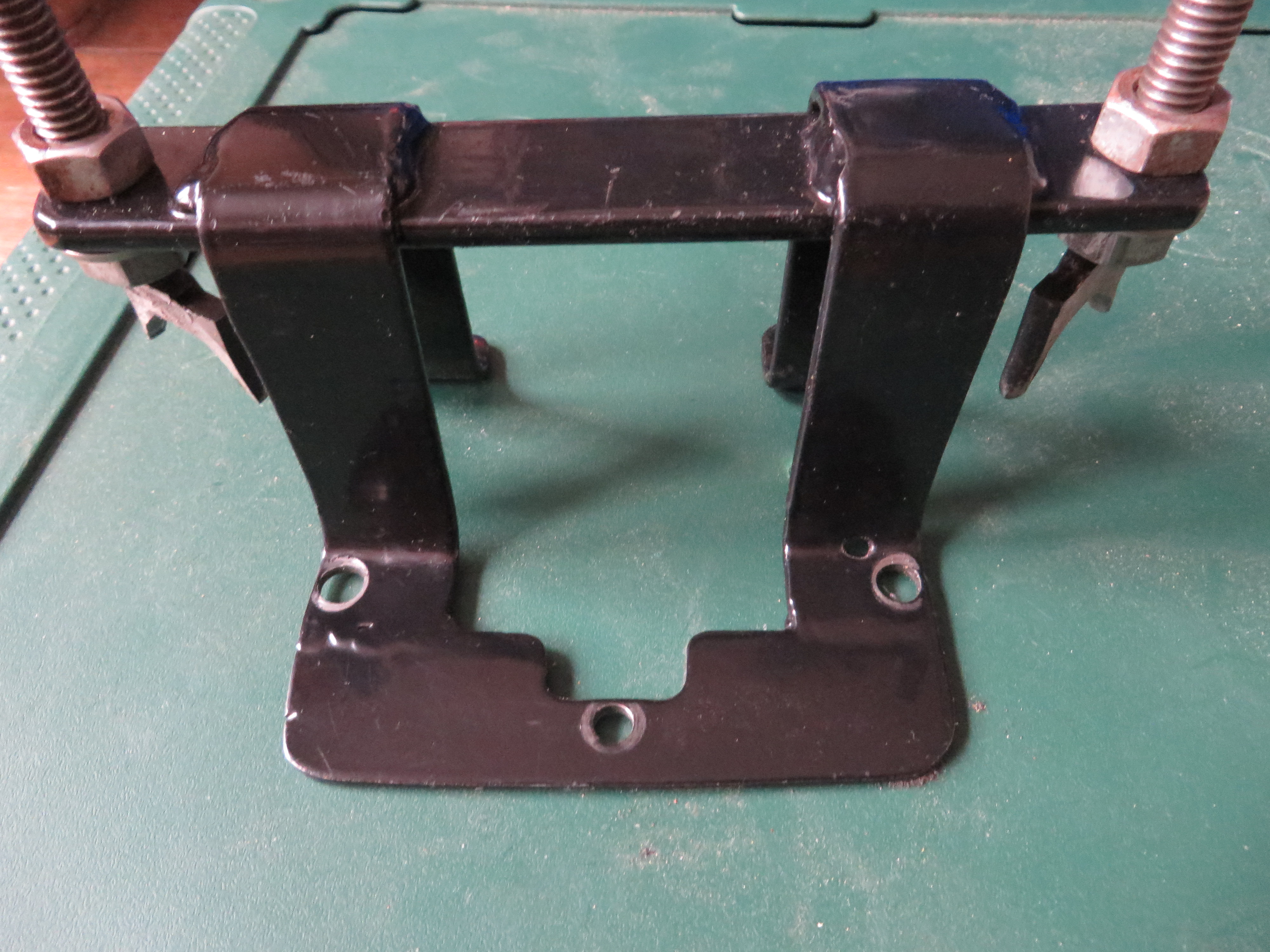

Made a modification to the cam holder because it looked a bit frail holding onto just two head bolts. Now with bridge to beef it up a bit.
