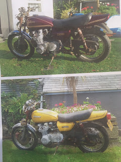

S'funny how things have a habit of coming about - Long story short I visited a customers house some 15years or so ago and dissolving in his back garden was a BMW R80, and a bigass furred up Z. My customer was about to leave the County and start a new life, I was living in a small Cornish Cottage and just did not have the room for either of them. Fast forward 12 years and I had self built a large garage with a nice detached house (priorities)! Somehow I had also acquired a stripped down Hodna Monkey bike (don't ask) which apparently some poor souls pass off as interesting motorcycling metal.
My old customer had also found his way back into the County and, when we caught up I asked him about his old bikes.
The BMW he had built into a very nice bespoke KATHY RAZER. No seriously! The Z he had passed on to a current work-mate of his who had stripped it from this -
Image only significantly more corroded, to this -
Apparently the fellow who had the Z stripped the bike had left it under his bench and all but given up on it as he was now consumed by a new passion. Yep he was into Hodner Manky Boikes!! So like a rat up a drain I accepted his offer of swapping his Z for my childs beach toy and promptly packed it into my van and got it home. Image

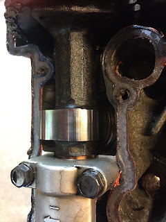

First step of my motor strip, not really sure whatI going to find and if I'm honest I feel pretty daunted by the job. I was going to get a local shop to dot he job but decided to get stuck in. Externally the motor looked rough as rats in terms of furred up alloy and grime but thankfully no obvious damage. I had been spraying the nuts bolts and head studs pretty frequently as I have had issues with seized and corroded fasteners on my XS850. Another thing that I learnt was to spend some time with a stainless pick and clean out all the cross head screw and Allen head caps to enable the drivers get a good purchase.
No obvious wear or scoring.
Plenty of gasket gak visible down the cam chain tunnel.
Cams removed and followers labelled. Everything bagged as I go.
White metal cam shells look pretty good on first inspection.
Head off to reveal more nasty liquid gasket and very oiled up pistons.
Bores looking reasonable though.
Worrying that someone had been here in the past with loads of liquid goo
First sign of internal damage was this broken cam chain slipper - this could be the reason the bike was stripped - it wasn't going to make any friends down here on it's own.
Another set of pics from a different viewpoint - more for my own reference really.
The barrels came away without any drama and the pistons look pretty good.
no obvious signs of a previous rebore - perhaps when I clean them up.
Alternator cover off - more Goo.
I got quite a bit further that this but running out of time to post up my progress - plus I walked away from my initial posting attempt and bloody lost it all - that will teach me not to blog it first!

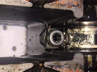

Managed a few hours tonight - hopefully get the cases apart and get a good look at what's going on. Obviously someone has been in the motor before but judging from the gaskets and goo used I don't think that they got much beyond taking the head and barrels off.
Flipped the motor and removed the oil filter housing and then the sump.
Pretty telling in here - loads of metal flakes and more gasket goo on the strainer.
Just spotted this lil' beauty as well - a trip to the Tig guy is on the cards
Sump pan was filthy with goo and tar.
Multi coloured gasket and alloy heaven
Worryingly - I could see a crank cap bolt missing. Nothing like that in the motor so I guessing that one was removed from the sump aperture ?? Strange.
Another sheared crank case bolt. Hopefully shouldn't be too much of a problem.
Cases apart - crank out - nice and easy - just had to clean up the threads on the jack bolt points.
Just a reminder to me of another sheared bolt. This time it's a starter motor bolt.
These marks could be when the cam guide let go
Close ups of the marks
That'll do for tonight - everything bagged, labelled and stored.
Next jobs will be getting the broken studs out, weld up the crack, clean up all the threads and get the external alloy head and barrels off for vapour blasting.
