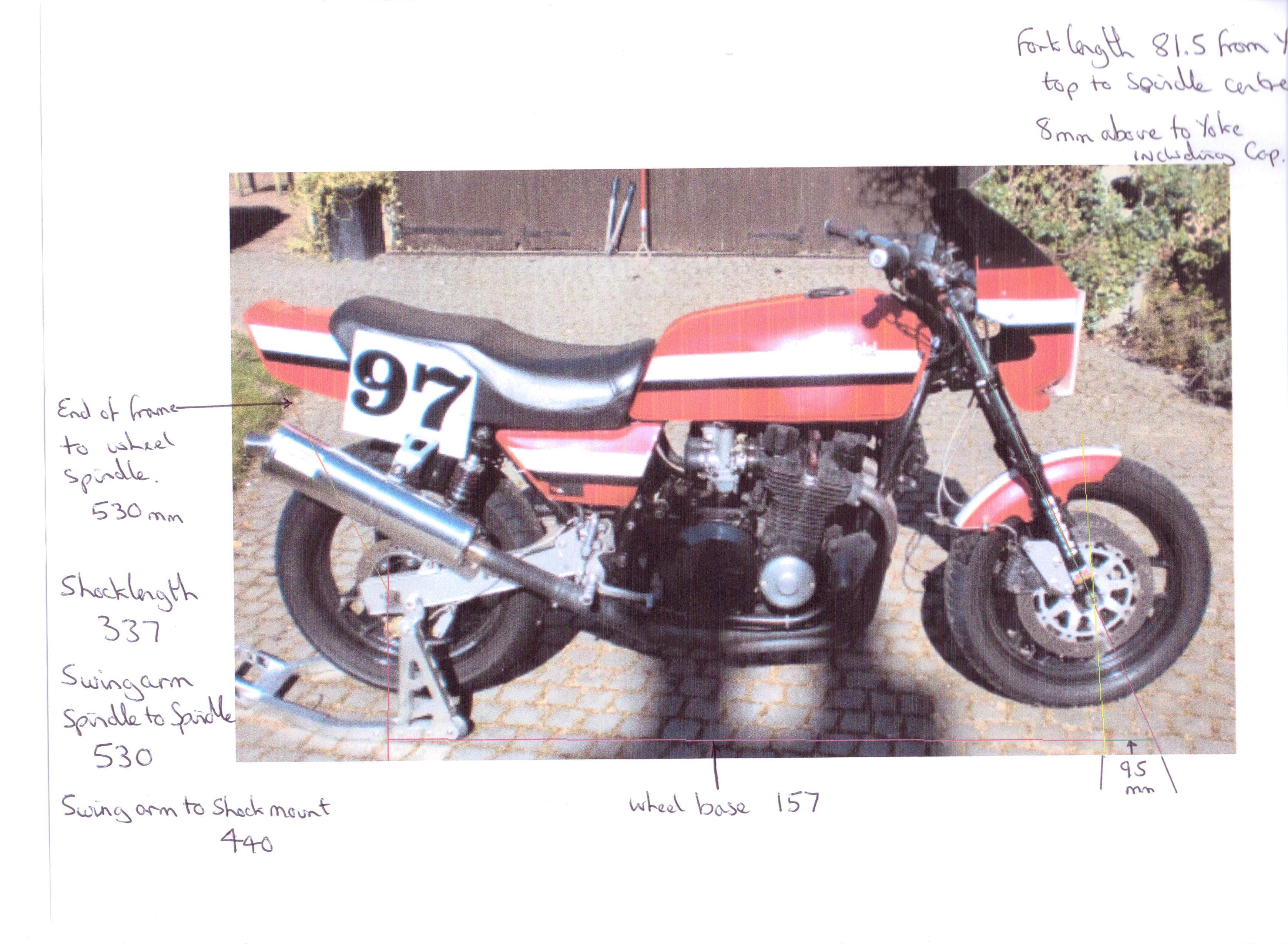

dims
ALS j dims.JPG (84.69 KiB) Viewed 10057 times

#25 PostAuthor: KWACKERZ1 » Tue Jul 11, 2017 8:15 pm
This also worked But mine currently will be even longer. :cry:

Longer wheelbase is more stable in corners and the rear wheel takes a tighter radius across the corner. The place where a shorter wheelbase might be more useful is Cadwell because its all sharp and jaggedy but its uncomfortable having the rear wheel follow you around so closely. Any mistakes are magnified proportionately. I'm sure it will be fine as it is. I think i would put more attention into getting the rake and trail set-up correctly as the back end has a direct impact on ride height / trim height. I'll try to re-measure mine at the weekend as that pic is with the old arm and therefore with the front pivot point further back in the frame. You may not like eccentric rear wheel spindle adjusters but they do have a lot going for them in terms of adjusting the rear end if youre looking for a 'quick and dirty' solution to ride height or the proximity of chain run to swingarm or to increase / decrease squat.
Keep at it

1520mm, needed to know myself :D
Could go 25mm less or 25mm more as the adjusters are right in the middle.
Probably a bit too short for its own good. It shakes its head just perceptibly going from flat out into a corner like Chris Curve Cadwell, Redgate Donnington and End of Pit Straight at Snetterton. :oops:
