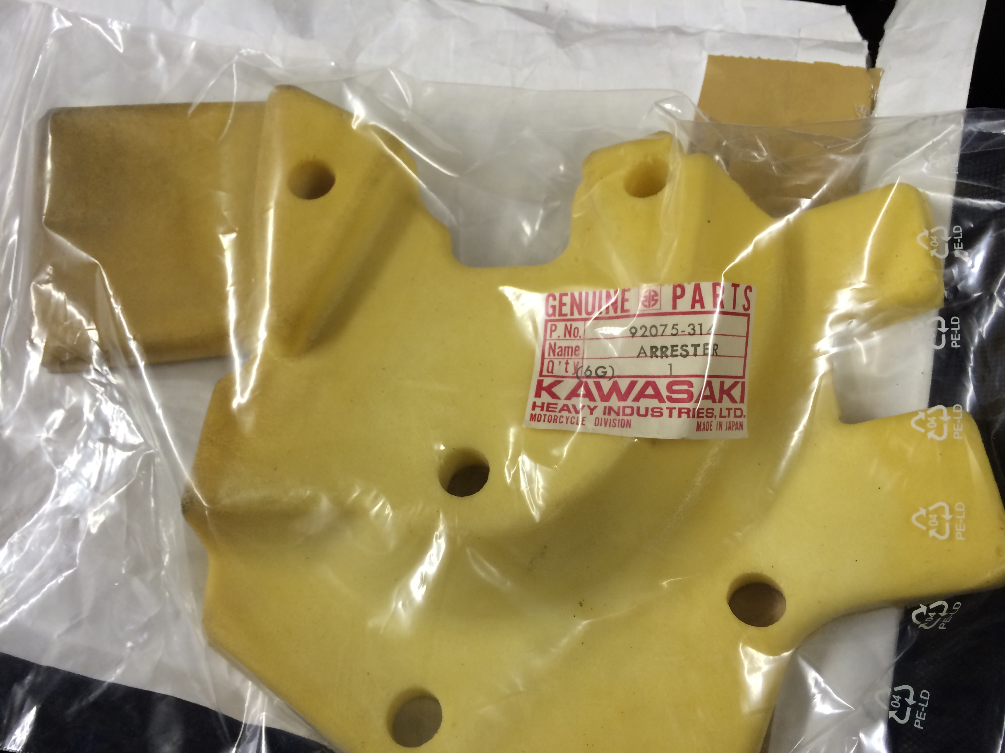

#4 PostAuthor: compo z1r » Fri Feb 02, 2018 2:06 pm
z1bman wrote:no it has a foam damper which is held in place by a steel cover & not the same as z1/ z900
you should have a sound arrester cover and damper
https://www.ebay.co.uk/itm/NOS-Kawasaki ... 1438.l2649

compo z1r
Posts: 1181
Joined: 25th Sep 2008
Location: SQUIRES NORTH YORKS
Re: Z1R Sprocket Cover
#7 PostAuthor: compo z1r » Fri Feb 02, 2018 3:47 pm
s-l500 arrester cover.jpg (19.97 KiB) Viewed 4477 times
